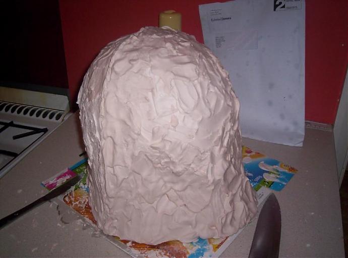

And the plaster jacket

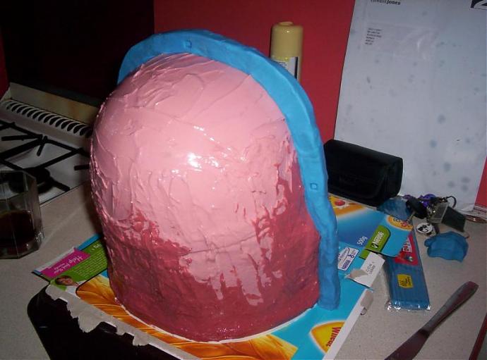

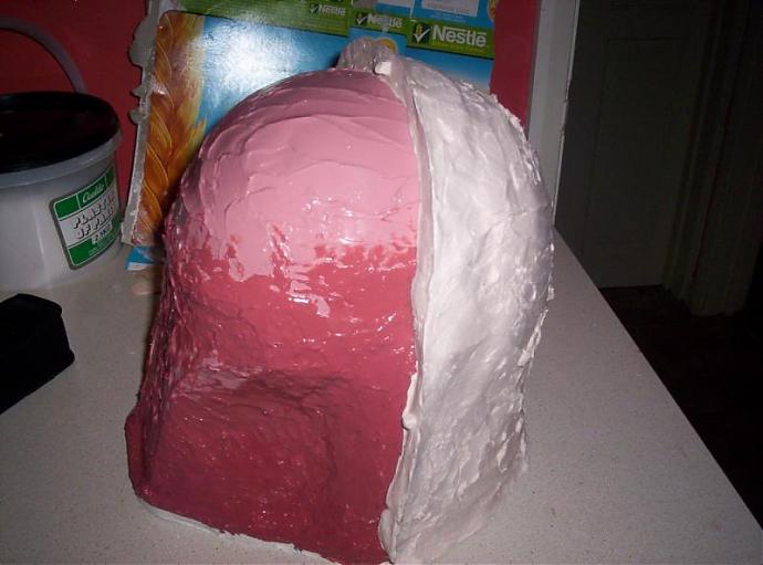

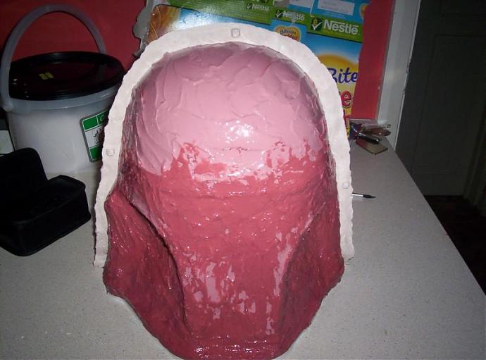

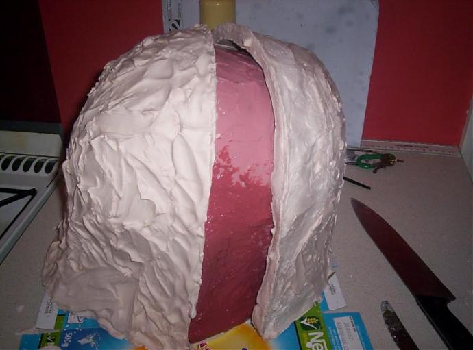

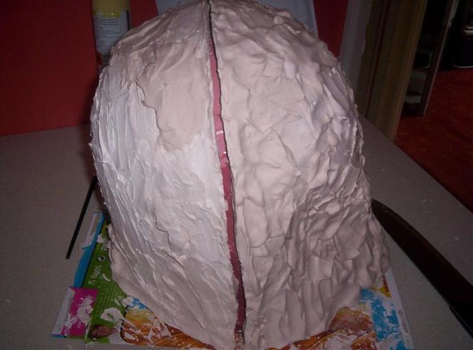

i put a plasticine barrier on with 3 small indents to act as keys. then applied my first half of the plaster jacket.
IT WORKED, IT WORKED :thumbsup: :thumbsup: :thumbsup:

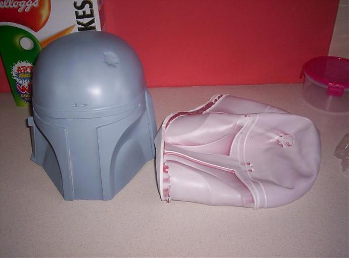

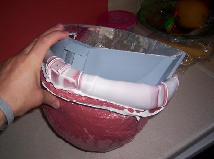

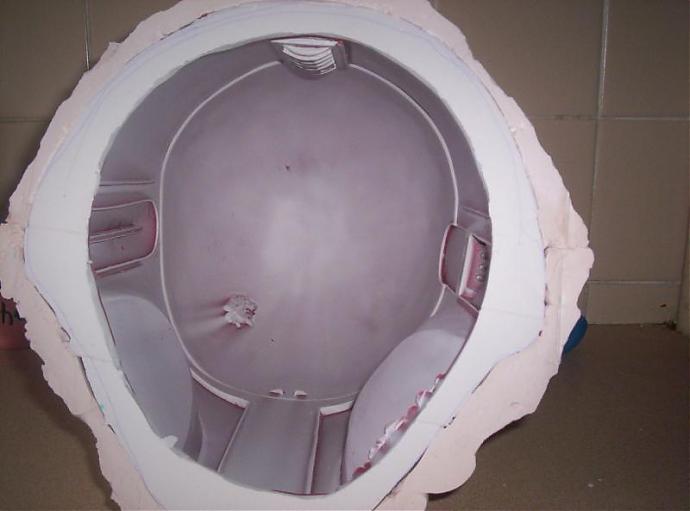

i have not uploaded the pics yet but i now have a perfect silicone mould of my scratch built bucket, and the male cast came out whole as well (will keep it just for sentimental value).
the silicone mould is lovely and has picked out every single detail, i am happy :)
will post pics ASAP
Awesome job, dude!! Those pics really help out with putting in the keys to line up the mold. How did you do the other half? I know that putting on the second half of the plaster jacket would create the holes for the pegs to lock into, but did you have to coat the separation line with something so the new plaster wouldn't stick to the existing plaster half? Hope that makes sense. :p
