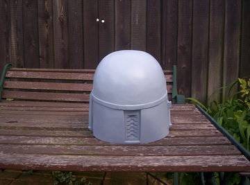

i have been putting it off and putting it off, and the plain truth of the matter is i am too scared to start the silicone moulding of my scratch built bucket :facepalm
I have the silicone, the hardner, the 'thixo thingy' and the release agent. All i need to do is cover the bucket in silicone and hope all goes well. The thing i have never done his before and i am worried in case it all goes pear shaped. and this is before i attempt the fibreglassing :facepalm
someone kick me :p

Trust me it really isn't all that bad! The silicone is so flexible that pulling it off is easy. Are you thinking of going for a one piece mold? A one piece is probably the best way of doing it. Here is what I would suggest:
1. Layer the silicone qute thinly all over the helmet using the thickening agent and allow to cure.
2. Add a second coat of silicone to thicken the mold. I would probably recommend making your mold 15-20mm thick.
3. Once the silicone has cured apply a jacket around it so that mold will keep its shape. I usually make a 2 or 3 piece fibreglass jacket. In this case a 2 piece would be best, with a join going from front to back in the middle. See the pic below.
4. Once the FG has cured you can take apart the 2 side and then peel off the jacket. You can then put the mold back in the jacket and secure the two halves with bolts.

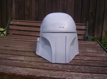

Well i finally started. I have been given lots of really good advice and have taken bits from everyone and devised what i believe is right for this situation.
Terminal Fettler - thanks for your tips mate. I could not go for an attached recessed collar in the end due to the way i have constructed my bucket so had to compromised. Thanks anyways, just thought i'd explain as the pics make it look as though i am doing the collar thing slightly strange:lol:

need some advise. As you can see i have just applied the first coat of silicone to my bucket. I have followed the manufacturers instructions of applying 5ml of 'catalyst' to 100g of silicone. it should have cured within 12 hours. Well i am now 24 hrs later and it is still wet. any advise?
:( i knew it would go wrong :cry
