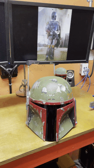

I got me a ROTJ Boba Maker VX Helmet back in 2020. And when I started out in the beginning, also wondered about this. I ended up just getting a Light kit from Neo Fett . Which consisted of the following:
1) Machine Craft Replicas - Metal Hollow Stalk
2) Servo Kit
3) Topper
4) Hand Cut Acrylic Block
5) Two Red LED's
6) White LED (Lights up Acrylic Block)
The kit was already all assembled when it arrived at my doorstep, and once installed (Kind of a Plug-N-Play experience), it worked great! And 3 years later, STILL going strong! I see that now his kits (Link here) are JUST the servo components and LED's. But perhaps a DM with Neo Fett could lead to 'other' arrangements.

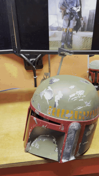

Here is a couple GIF's of my setup....
I ended up also doing the 'Glove Button' option - Using my Ring Finger to my palm. While touching my thumb to the helmets ear cap, mimicking like we see Boba do in that episode (S2 E6 - "The Tragedy") of The Mandalorian.
:cool:
Hope this little bit of information helps you out.
