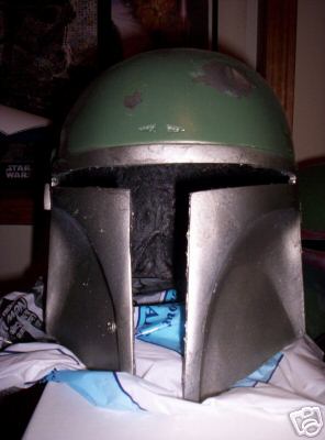

Decided not to go for a resin bucket as i wanted a spare FG one. I have just bought a FG off ebay (just got to sort out P&P), what do you think? (be honest). it comes with RF, stalk, both ears complete and even the casio plate for the grill. apparently its about the same size as a mystery bucket.

From the looks of it, it's most likely a mystery recast. It doesn't look too bad though, considering the conditions a lot of eBay buckets turn out like. If you are only using it as a spare and for practising it's a good start. I hope you didn't spend too much though!

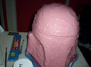

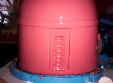

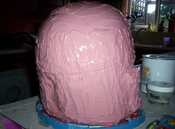

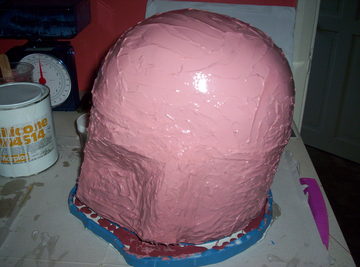

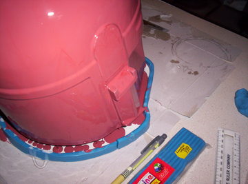

The good news is ppl, the first thin silicone layer ha snow set. After an in depth disscussion with the supplier i think i did not add enough 'catalyst' to the silicone. They recommended 5ml of catalyst to every 100g of silicone. It should have been 5.5ml to every 100g (if done by weight). so when you consider the residue left in the pipette, i probable only added 4.5ml (so a short fall of 1ml), and hence the very slow curing time. So i am going to add 6ml next time and some pigment to ensure an even mixture. I will attempt this tonight and post more pics tomorrow. :)

When using silicone, I tend to add a little more catalyst all the time. I found that the suppliers recommendations tend to be a little "sparing" with the catalyst. My first layer took ages to dry and I started to play around with the ratios and measurements until I found what was best for me. As with all things it just comes with your experience and through practise.

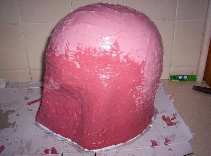

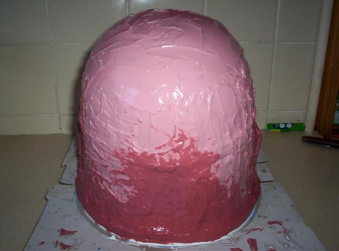

Well i puth the second thin coat on last night and this morning it had cured completely. I guess i have the mixtures correct now :lol: .

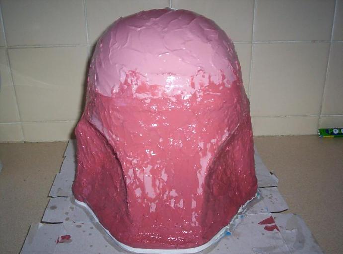

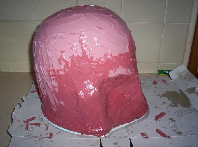

I will attempt the thick final layers this weekend and keep you all informed.

Are you going to be adding any keys to your silicone mold for it to hold with its jacket. And what were you planning on using for your jacket?
