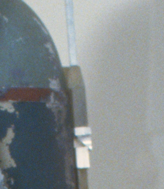

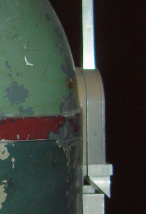

Ok, so for today's Accuracy Tip... Missed Paint
If you were ever in doubt that this costume was made on short notice, I present you this...
Here's a better photo from the Art of Star Wars in 2002
This is a spot of missed paint at the back of the ear. The funny thing is that the gray is actually primer, which means they primed the ear pieces, painted them tan, then realized they missed a spot and proceeded to do nothing about it at all.
This one is really simple to replicate, I just shot the back with gray primer before painting the rest tan, making sure not to touch that part.

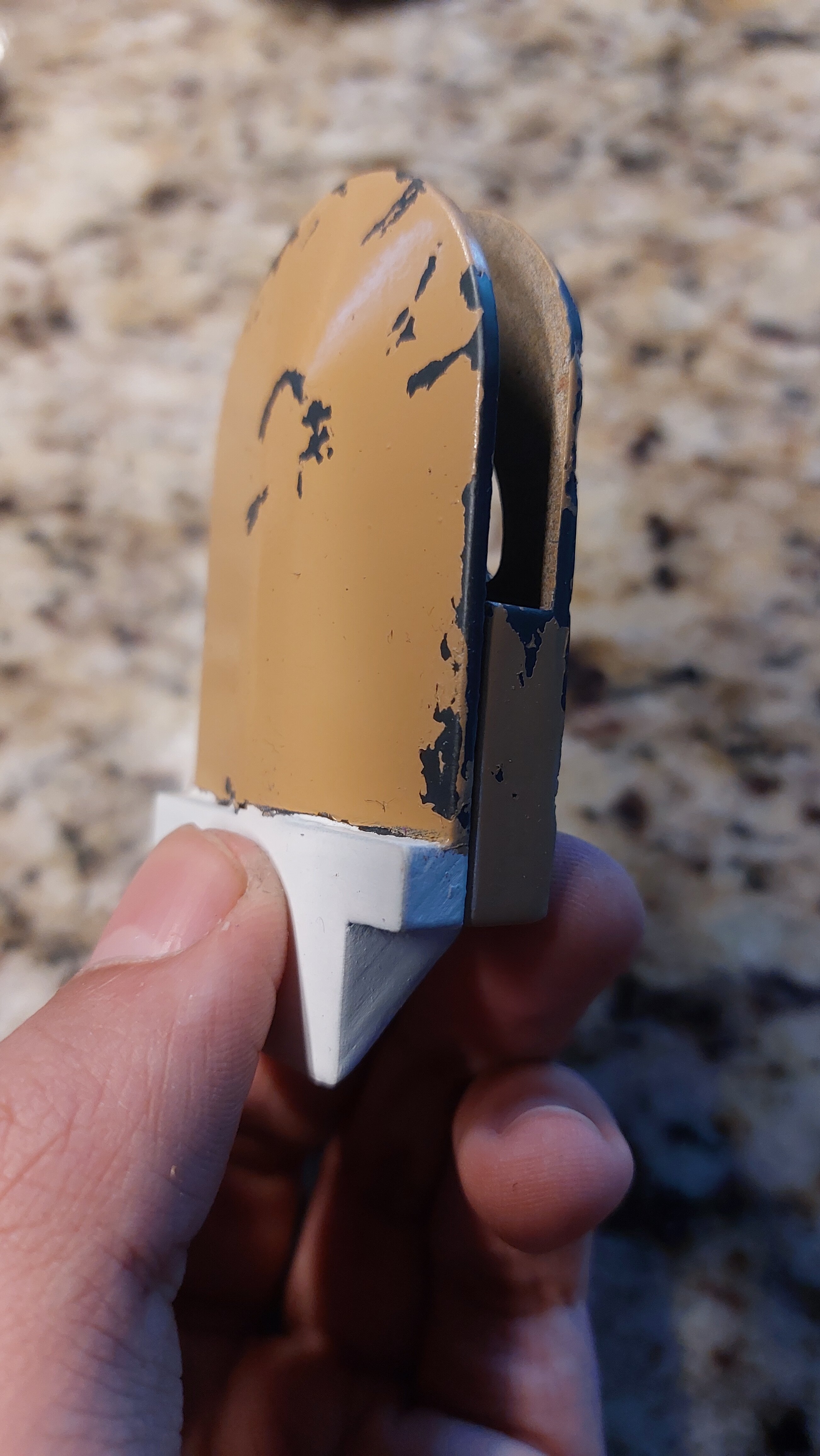

Hit it with some fine steel wool. Might be subtle enough to keep from sanding and repainting the whole thing
Thank you! I was looking for something I could do to keep from restarting. I was even considering leaving it and hoping nobody would notice.

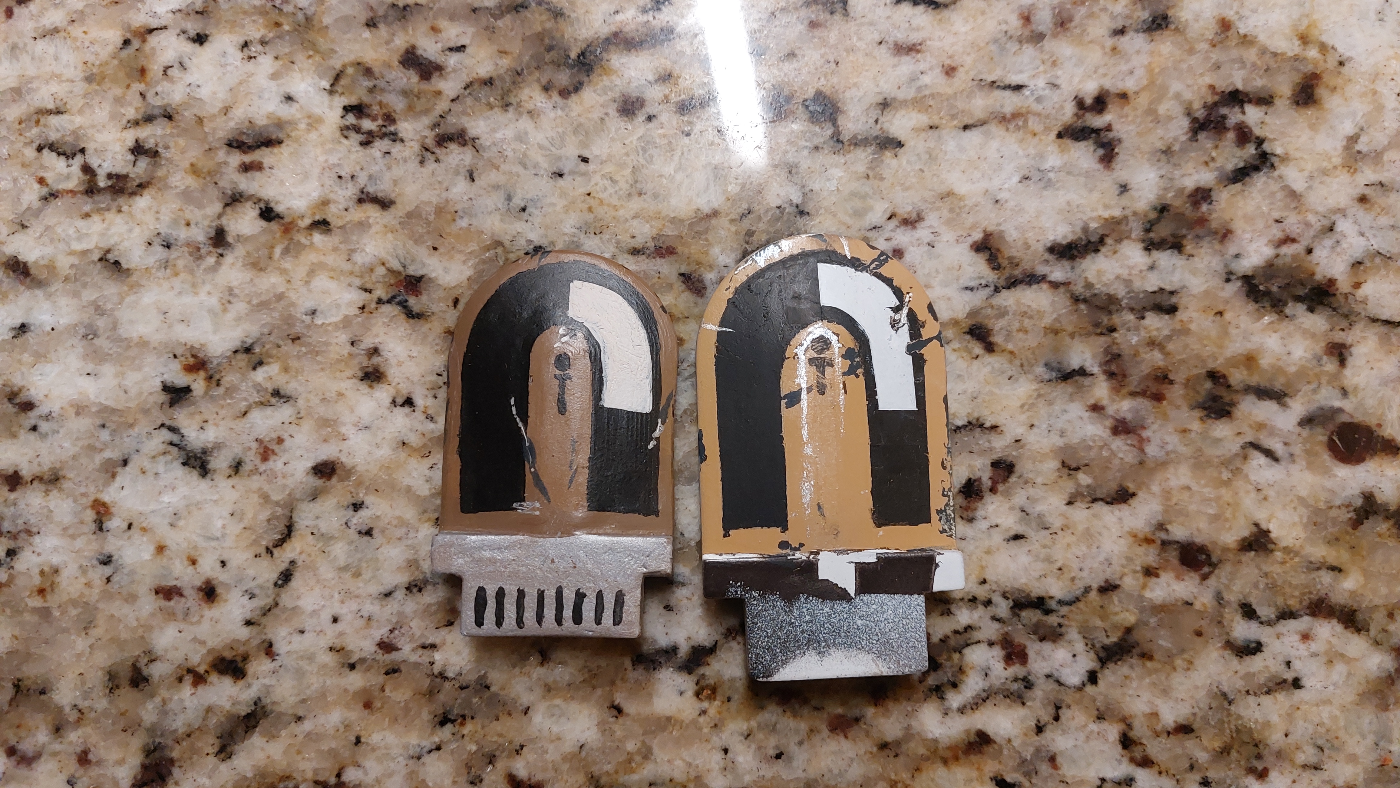

October 2022 on the left to March 2023 on the right:
I neglected to get that good Tamiya curvy tape and I definitely should have. These curves were torture, but I tried as hard as I could.
Obviously I will paint the metal part later.

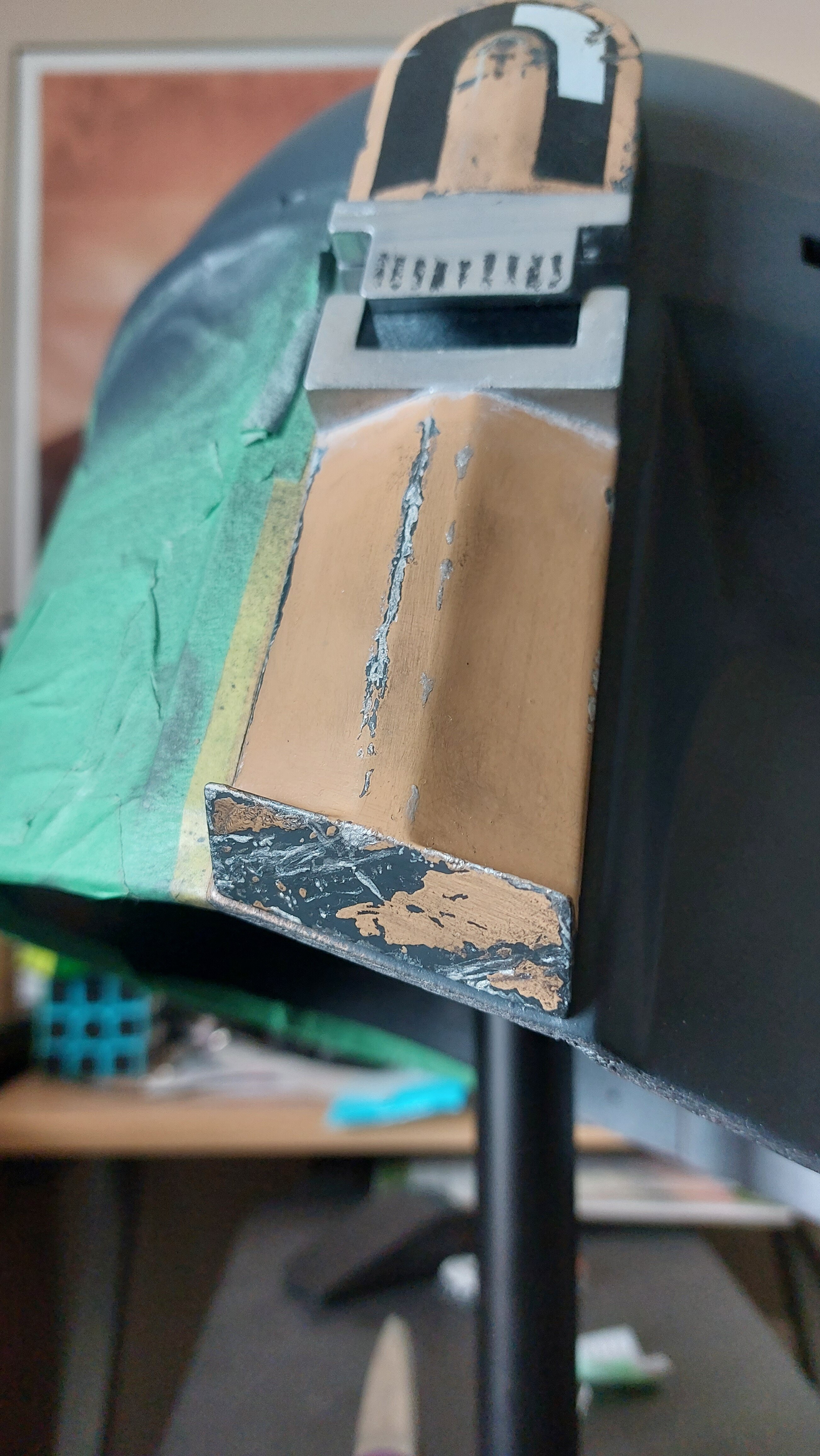

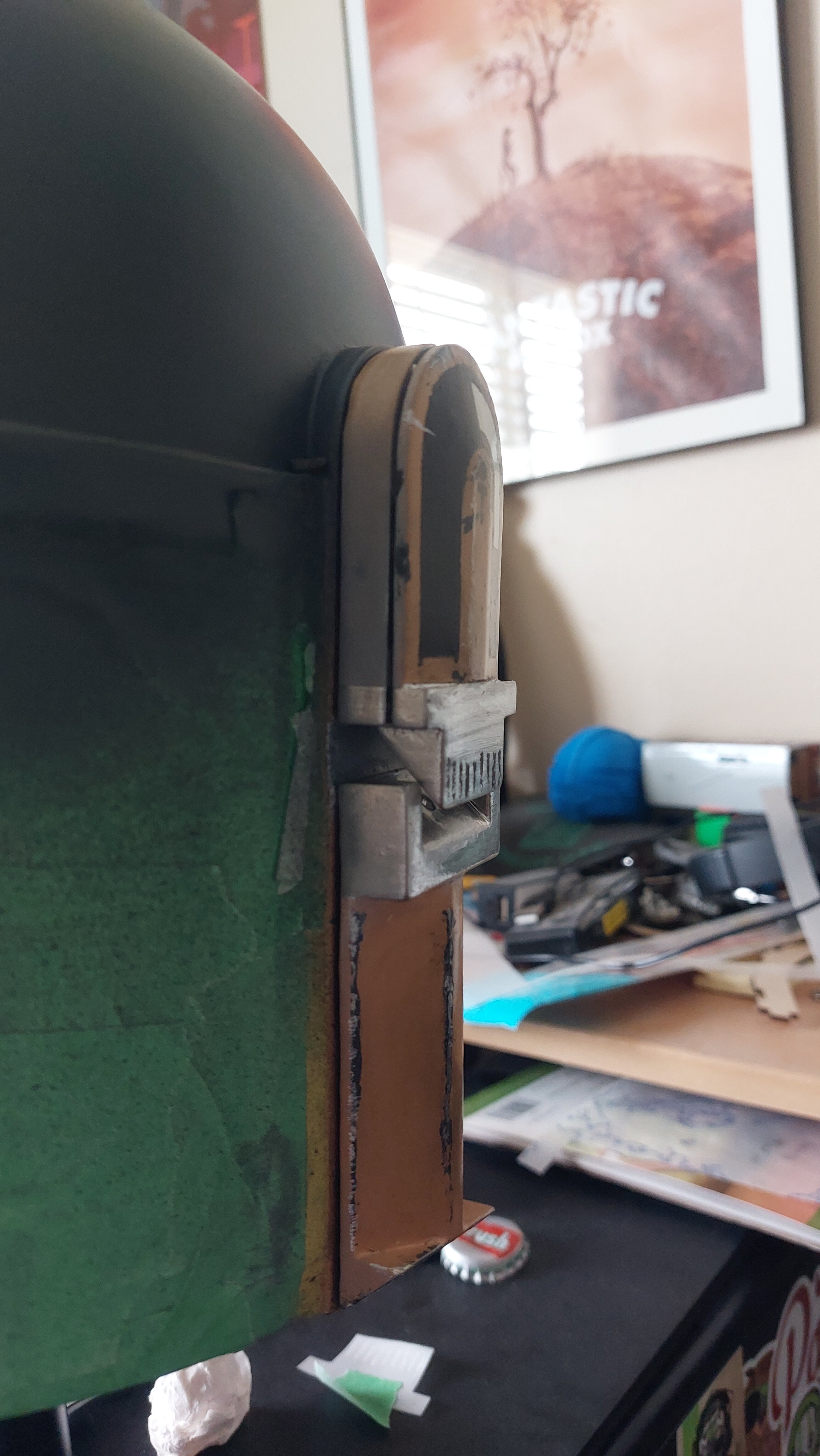

First, I took some steel wool to the helmet, but the lint was so cemented into the surface that by the time I had buffed it out, there was damage to the paint. No big deal. I just gave it a quick sand and repainted it gray.

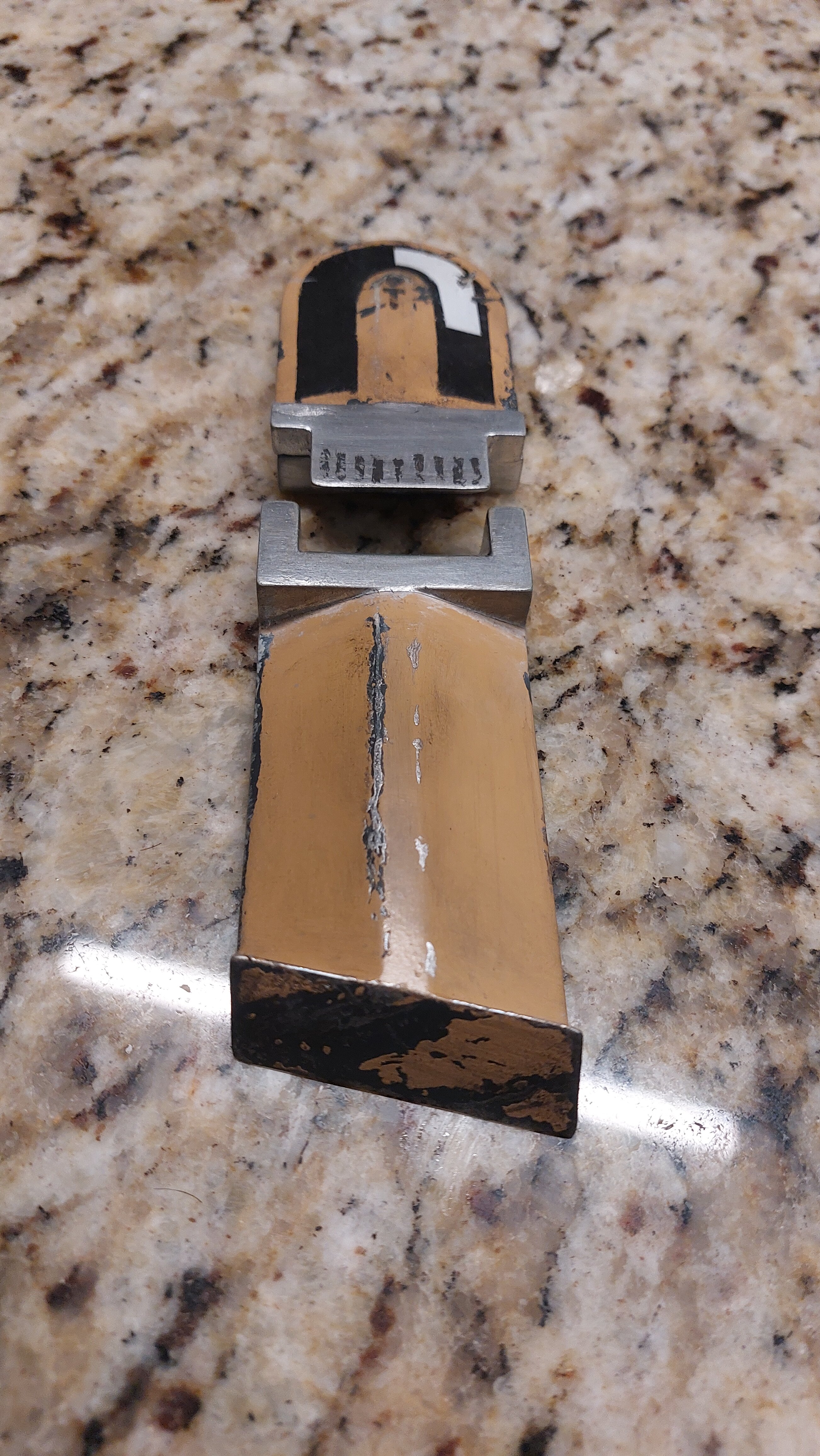

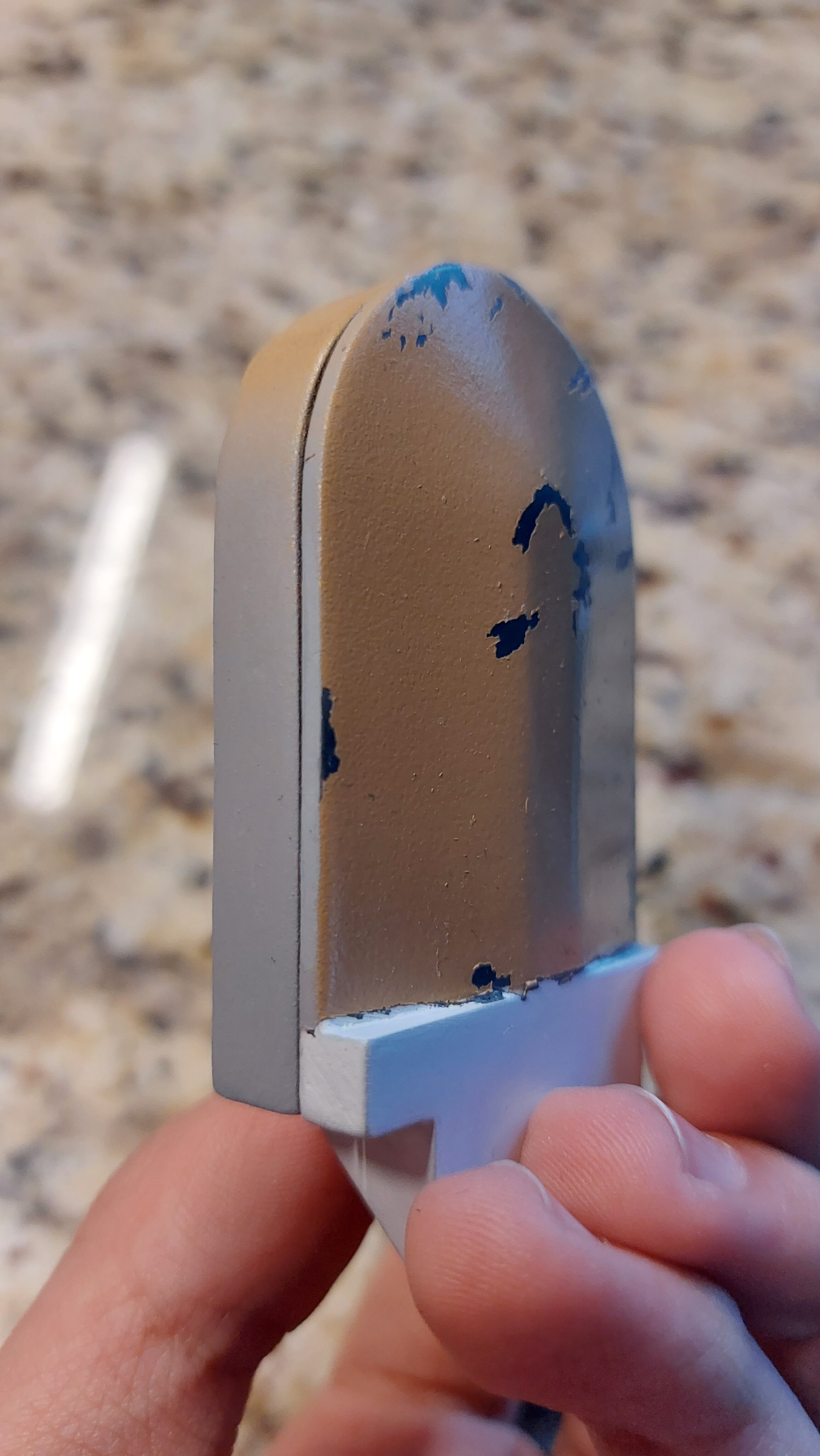

Then, I took the lower part of the ear and masked the gray off before painting it Khaki like the upper ear. Super simple stuff.

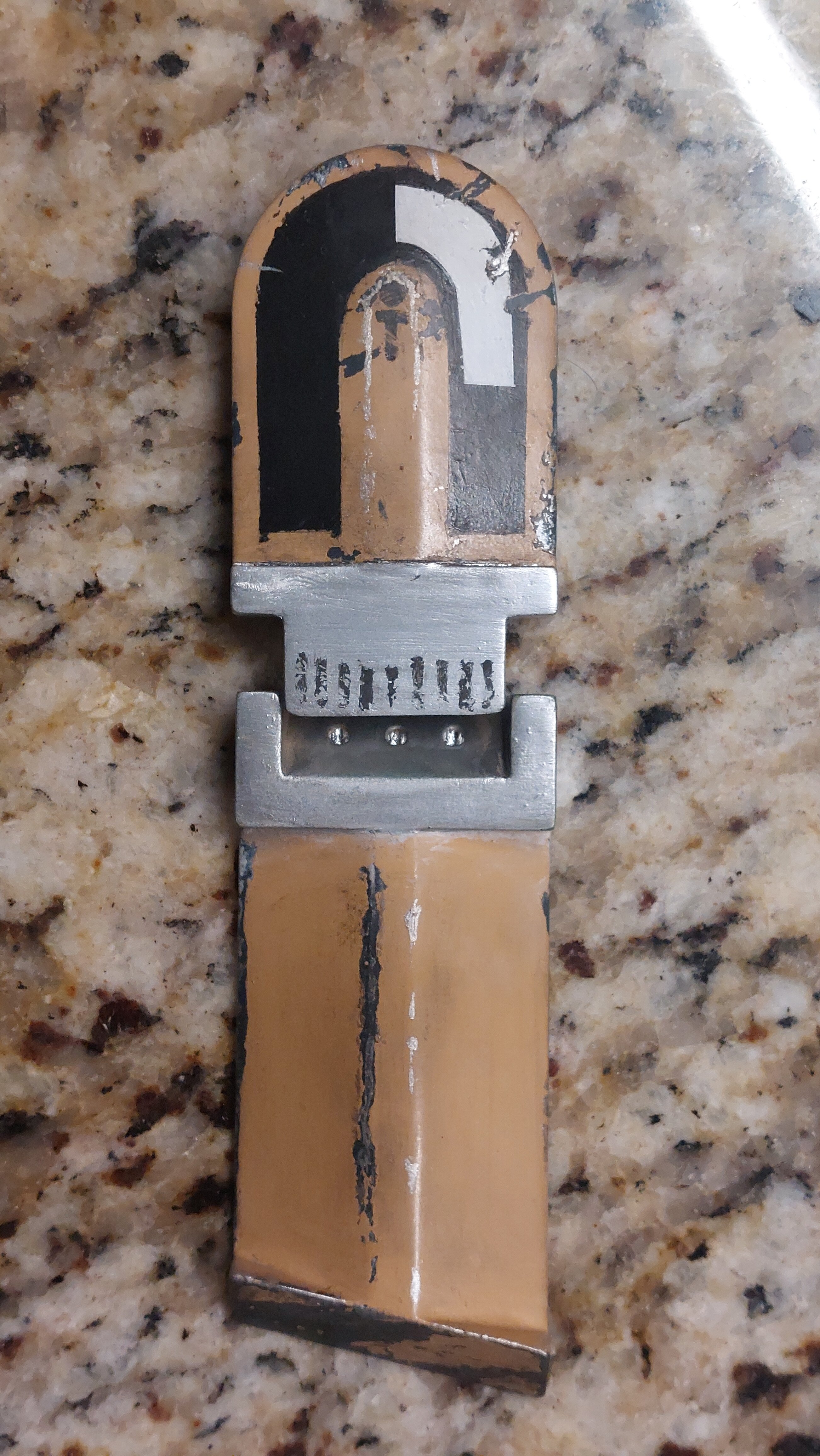

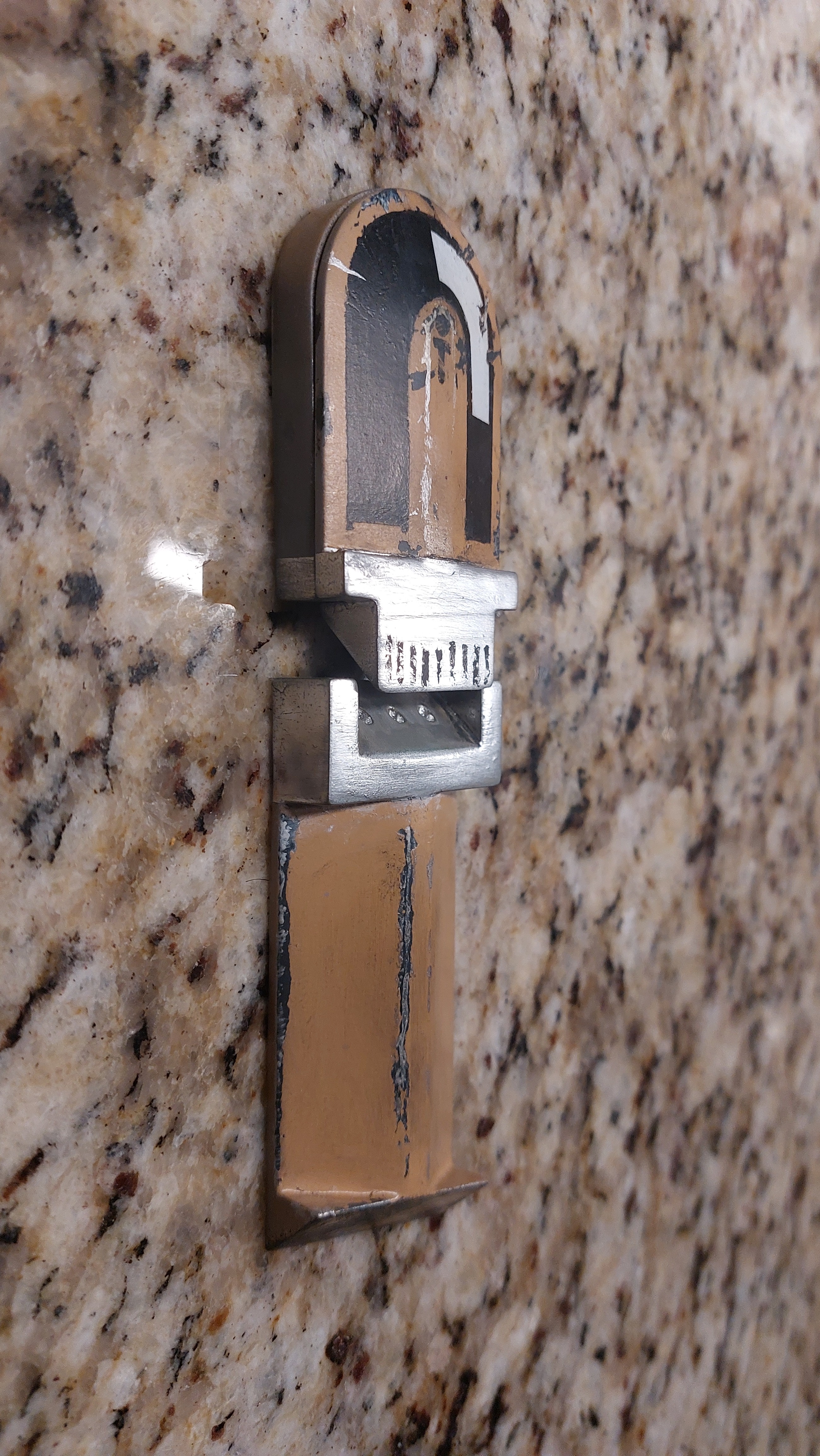

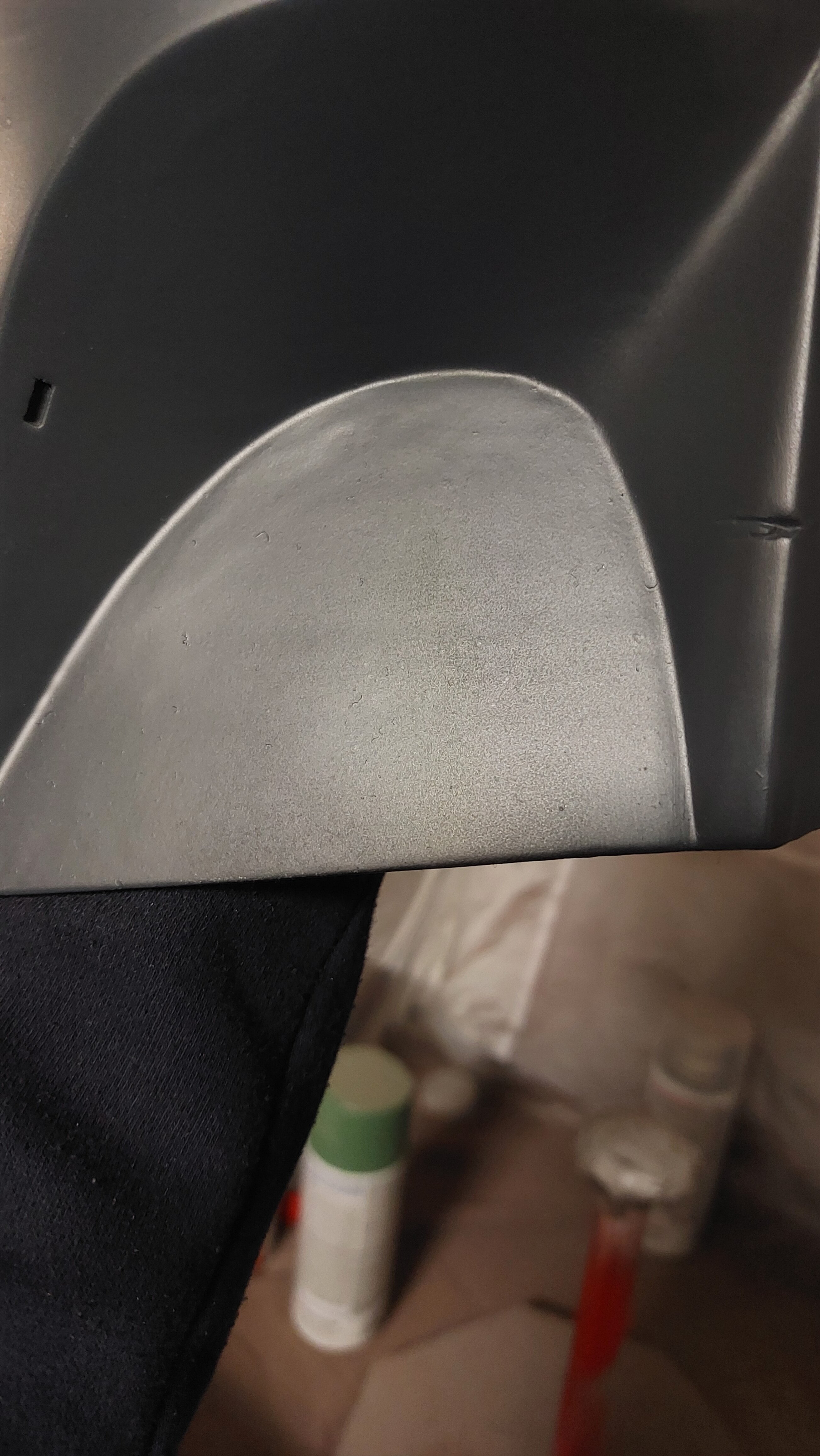

I also got some machined aluminum in a can, otherwise known as Rustoleum Mettalic (there's like 20 different "mettalic" paints from Rustoleum so I got the one in the plain white can with the chrome lid). Seriously, this stuff was a game changer! I wish I could show you guys so bad. I sprayed that on the exposed metal parts and the inside of the earcap before lightly scratching it one way to emulate not only wear but the directional patterns you see on machined aluminum parts. I think I could have done a bit better job on that, but it's okay.
I also forgot to clear coat the earcap before painting the silver onto it, but I was surprised to see that the satin clear coat had no affect on the shine of the silver paint. Even after buffing it matte, the silver was just as shiny. I think I might try the clear coat on the mettalic paint as well since that stuff definitely needs sealing.
Then, I painted on the Letraset Decals by hand, and since I was painting with matte black on the slick, shiny surface of the mettalic paint, I was actually able to scratch off bits of the "decals" with my fingernail. I probably should have used a toothpick or something but it certainly was easier than trying to paint already scratched up symbols.
Finally, I gave the ears some weathering, following the Celebration VI photos as reference. I believe the weathering on the ears (reddish-brown splatter included) that we see at Celebration VI is also present in ESB. There's no really good photos where you can clearly make it out, but the shifts in color point in the direction that it was present from the beginning. Plus they just looked weird without weathering.

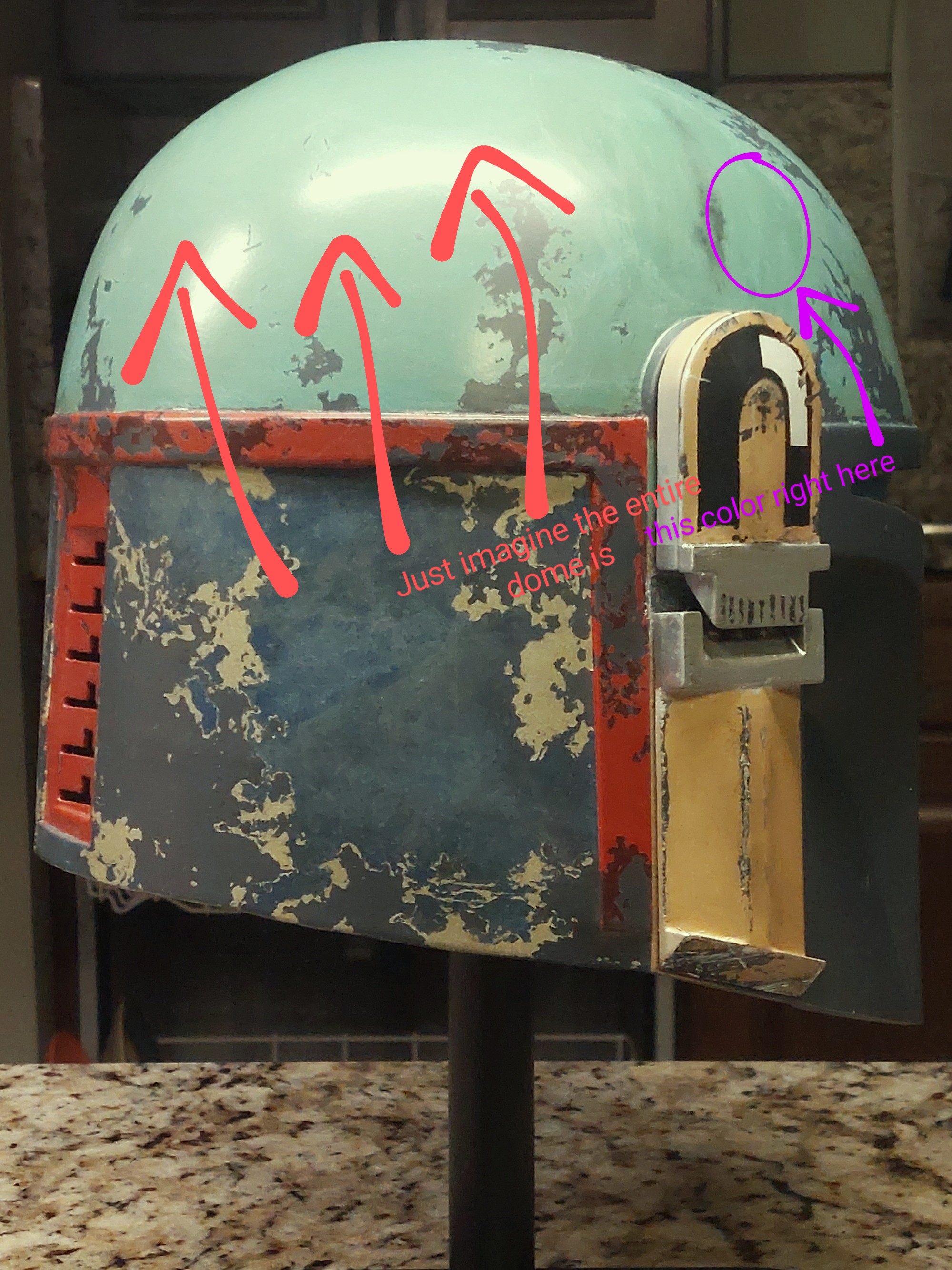

Here's the comparison before and after repainting the helmet. Before on the left, after on the right:
Still not perfect but I doubt anyone will notice.

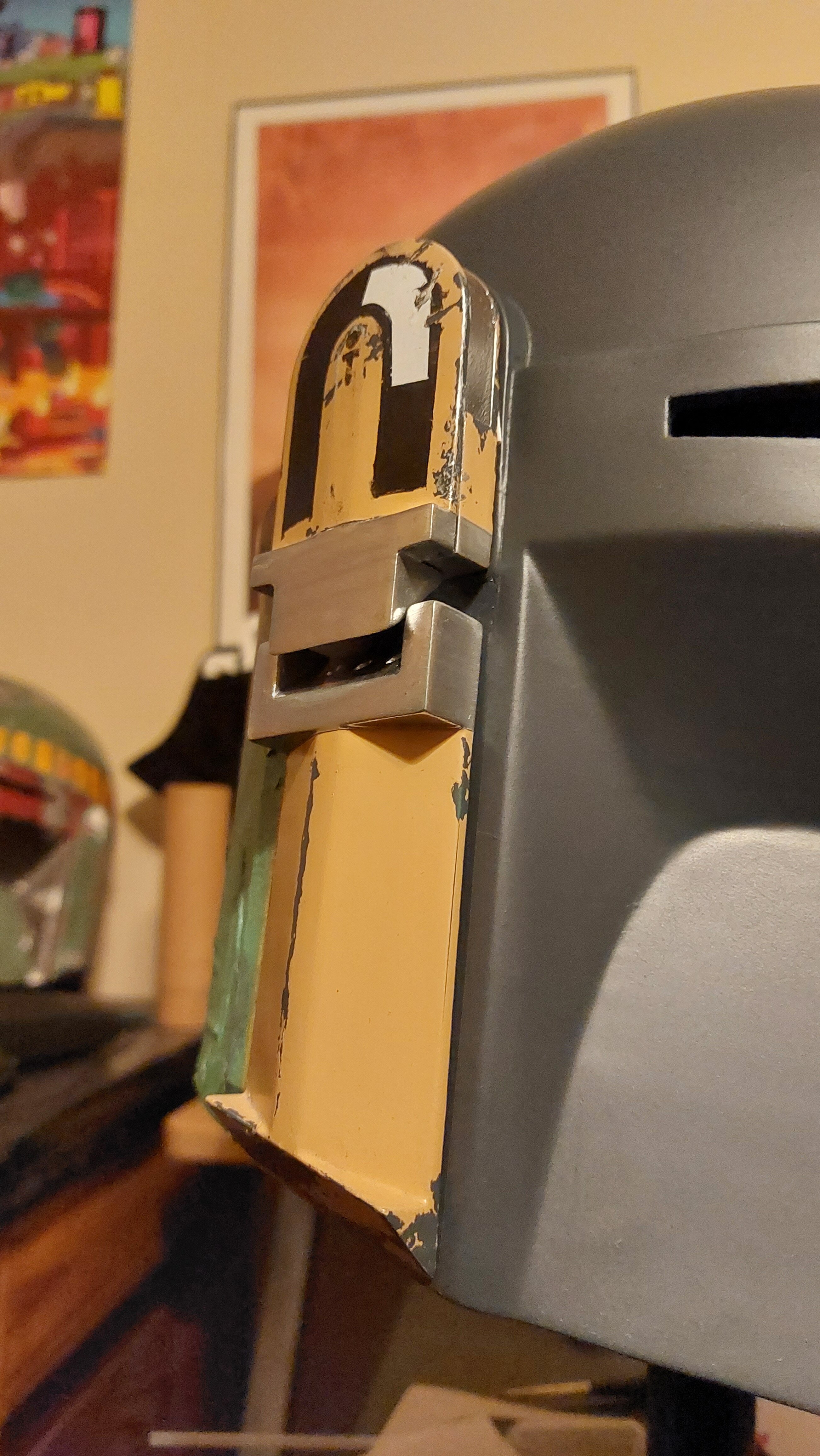

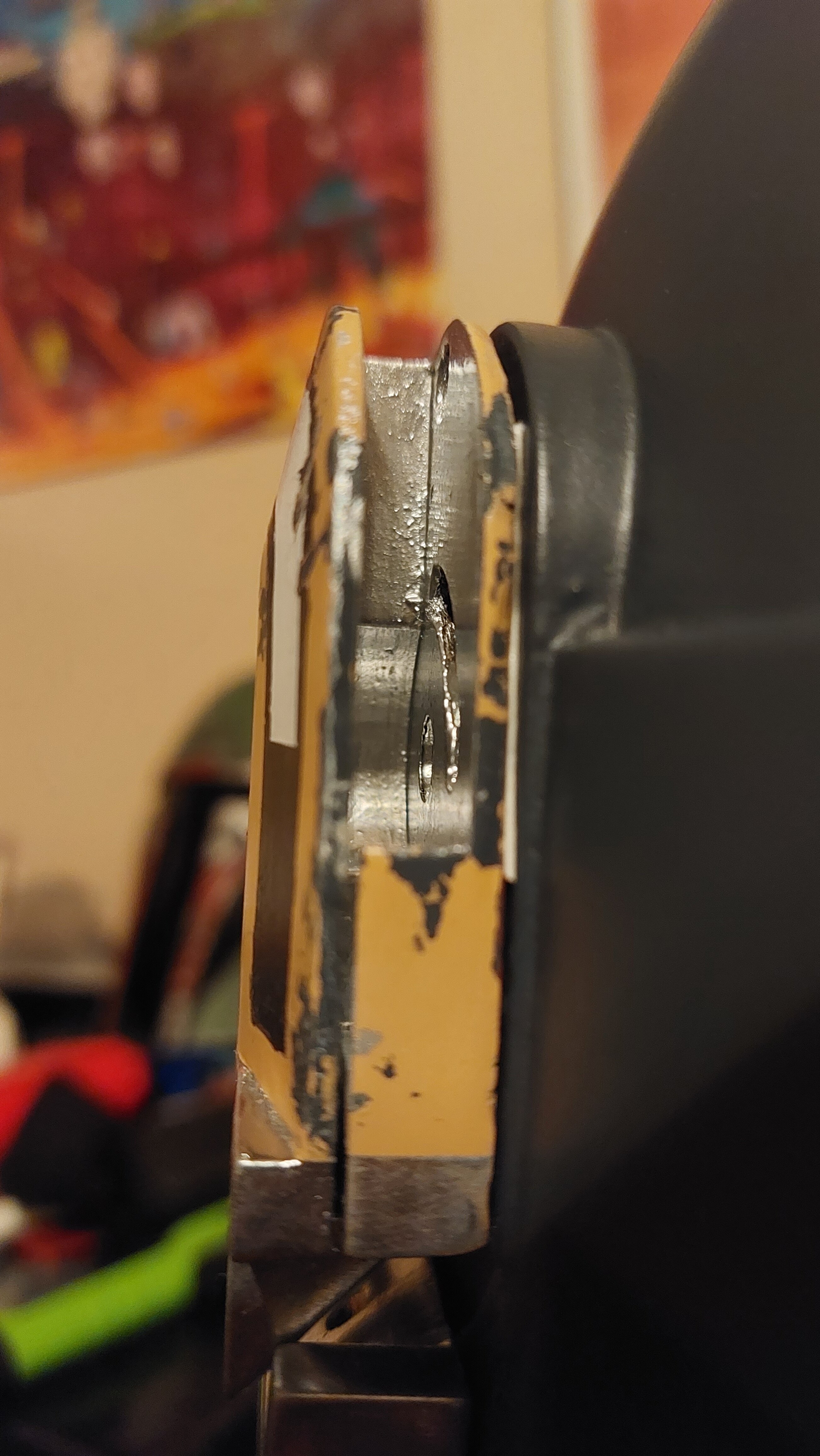

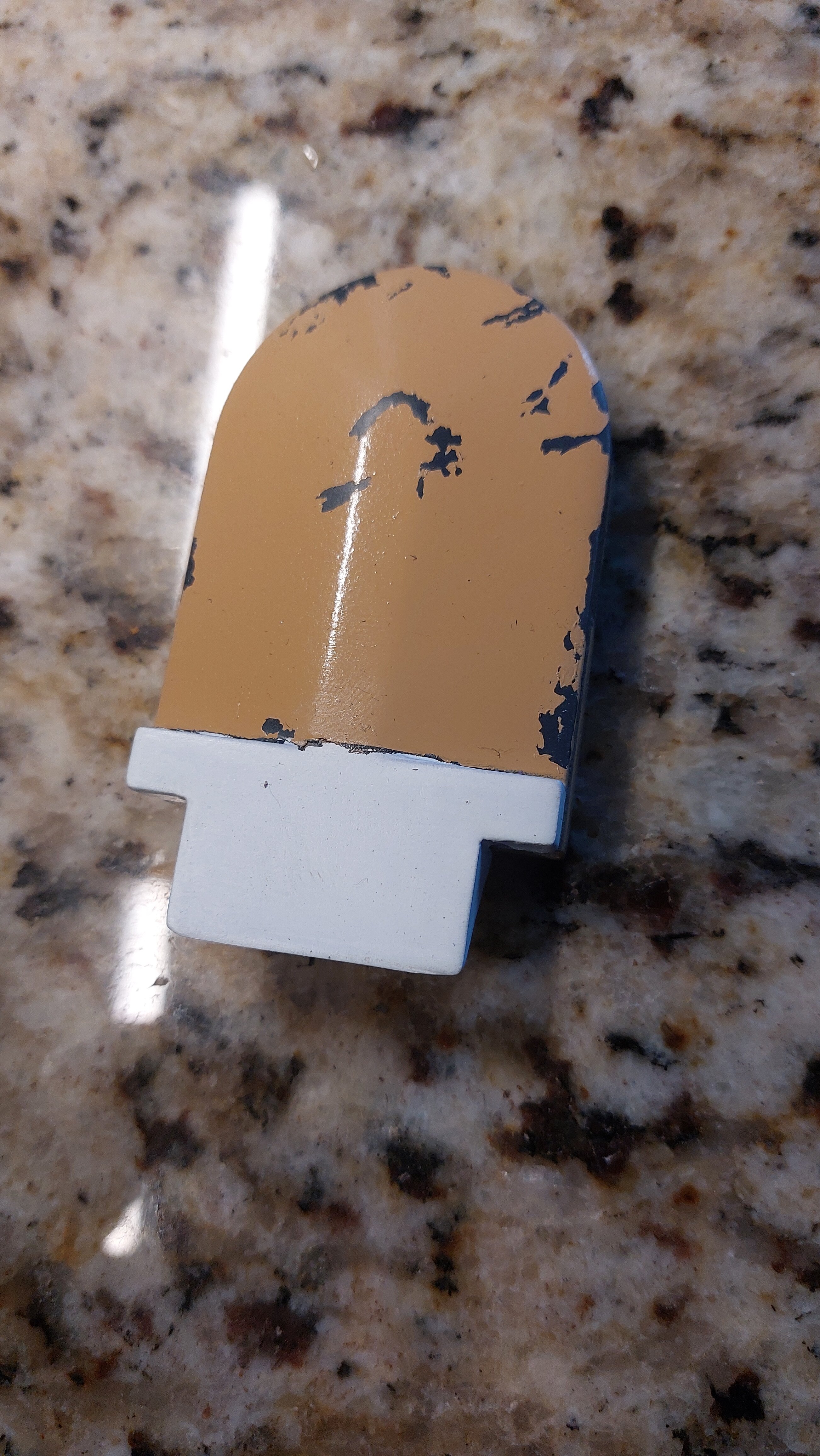

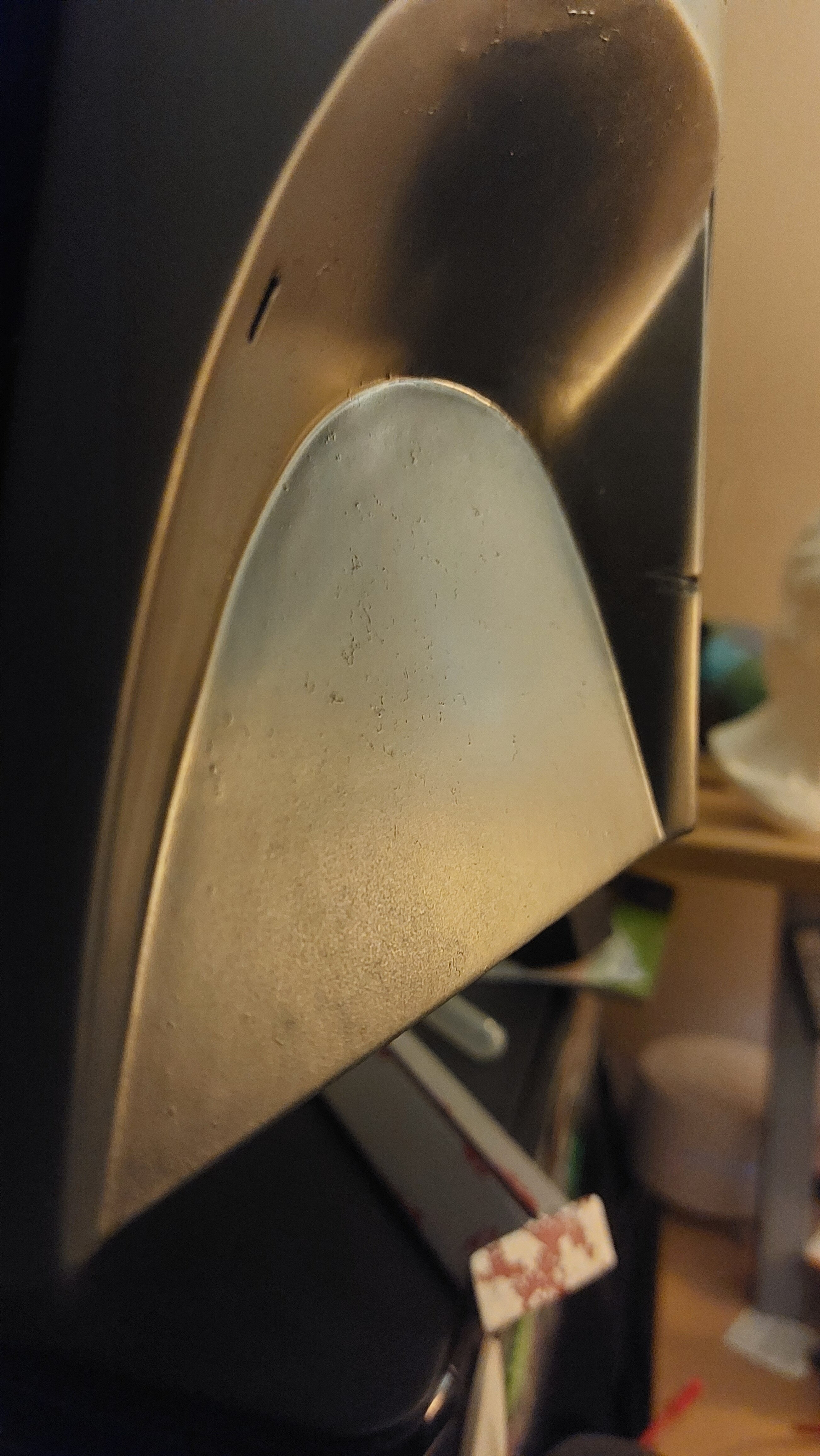

Here's the mettalic paint on the ears:
And after decals + weathering:
There is silver on the very bottom, it just fades into the gray under this lighting.

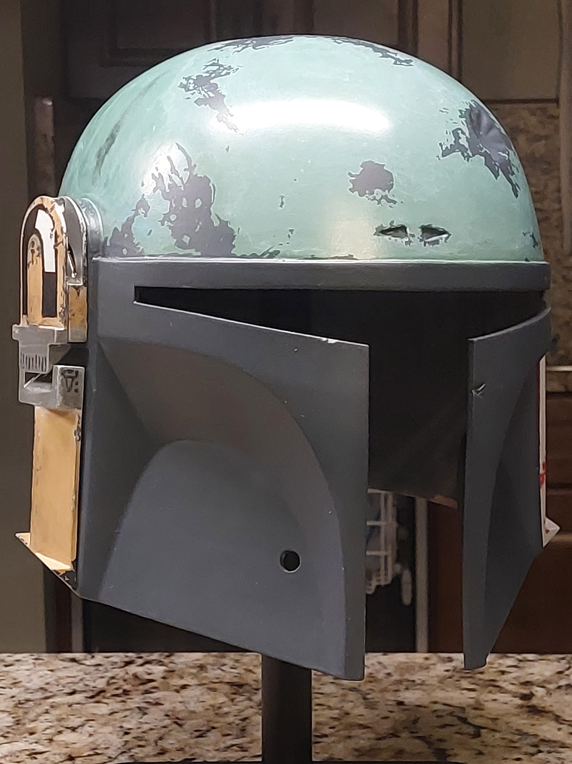

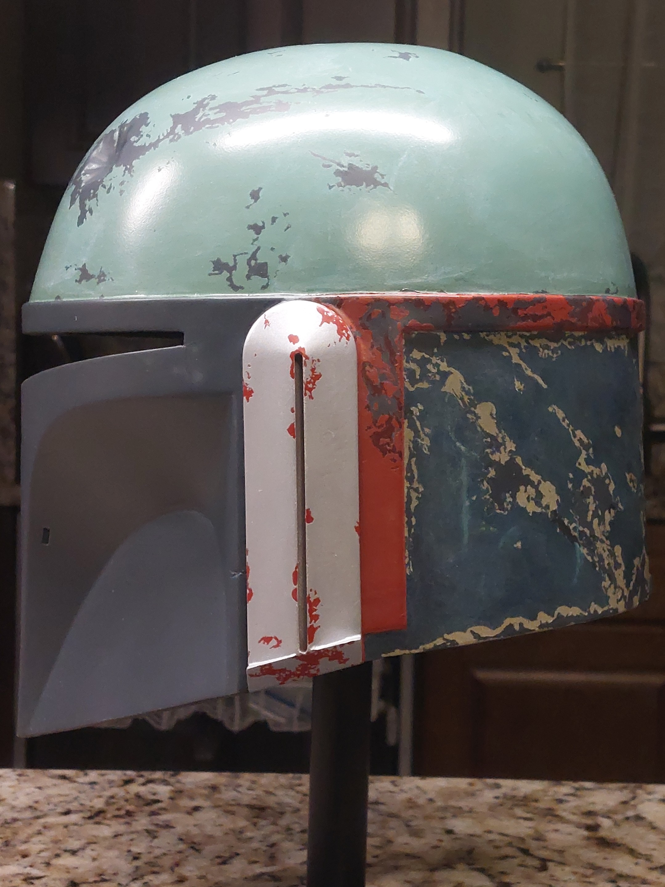

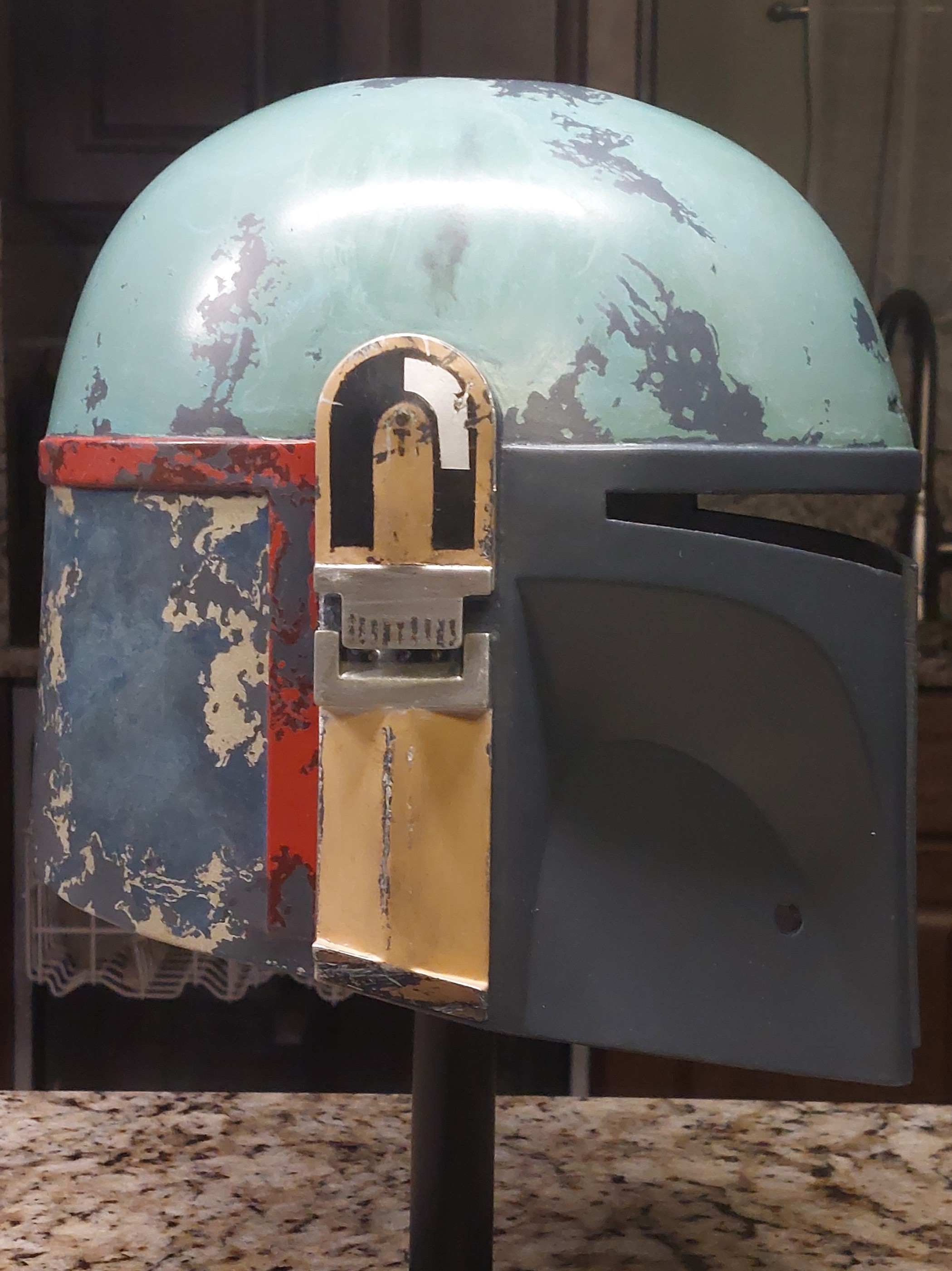

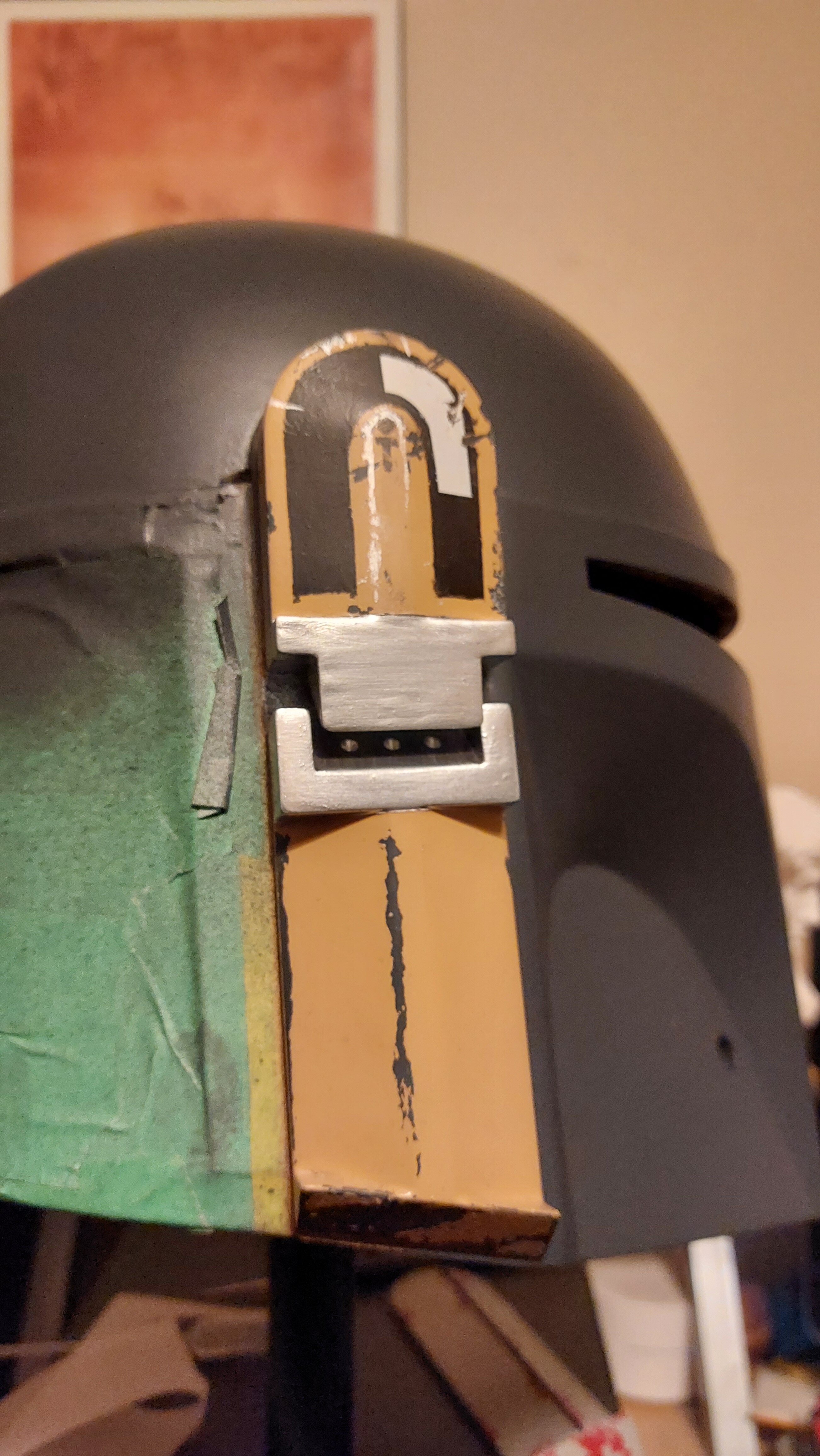

Here's how the final ears look on the helmet
Do you think I should add more weathering to the bottom here?

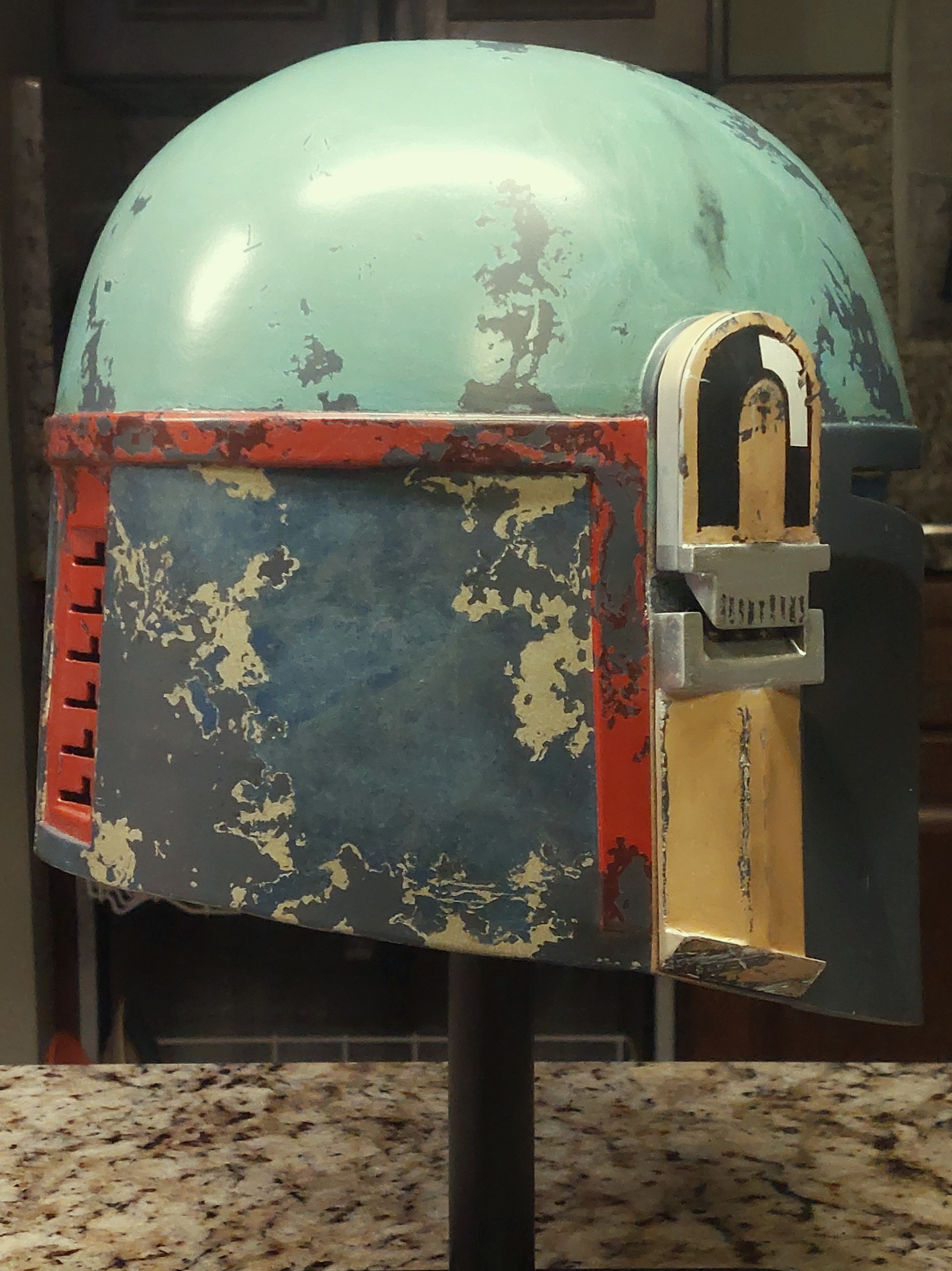

I'll be adding the reddish-brown splatters on at the very end because they appear to go over the top of the dome and the cheek and the mandible.

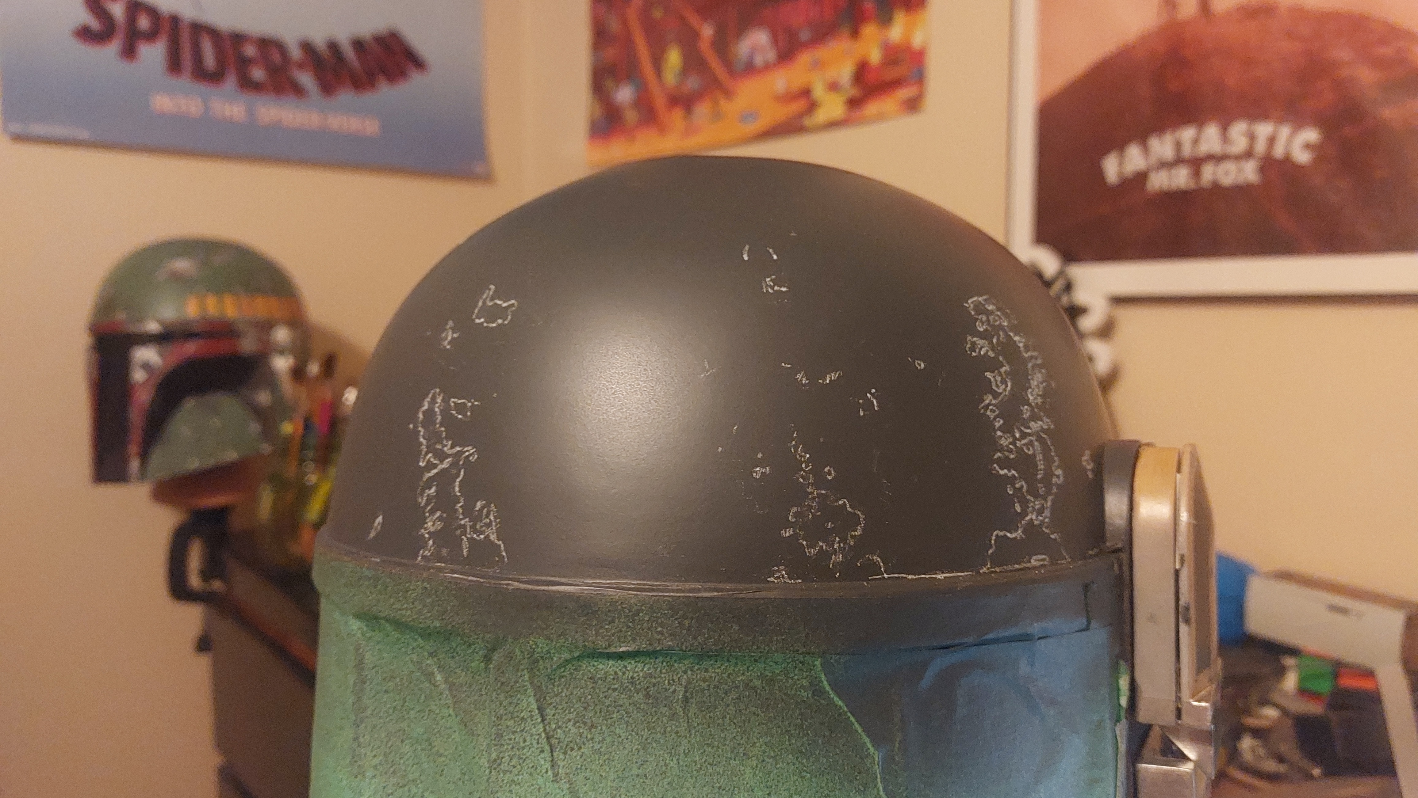

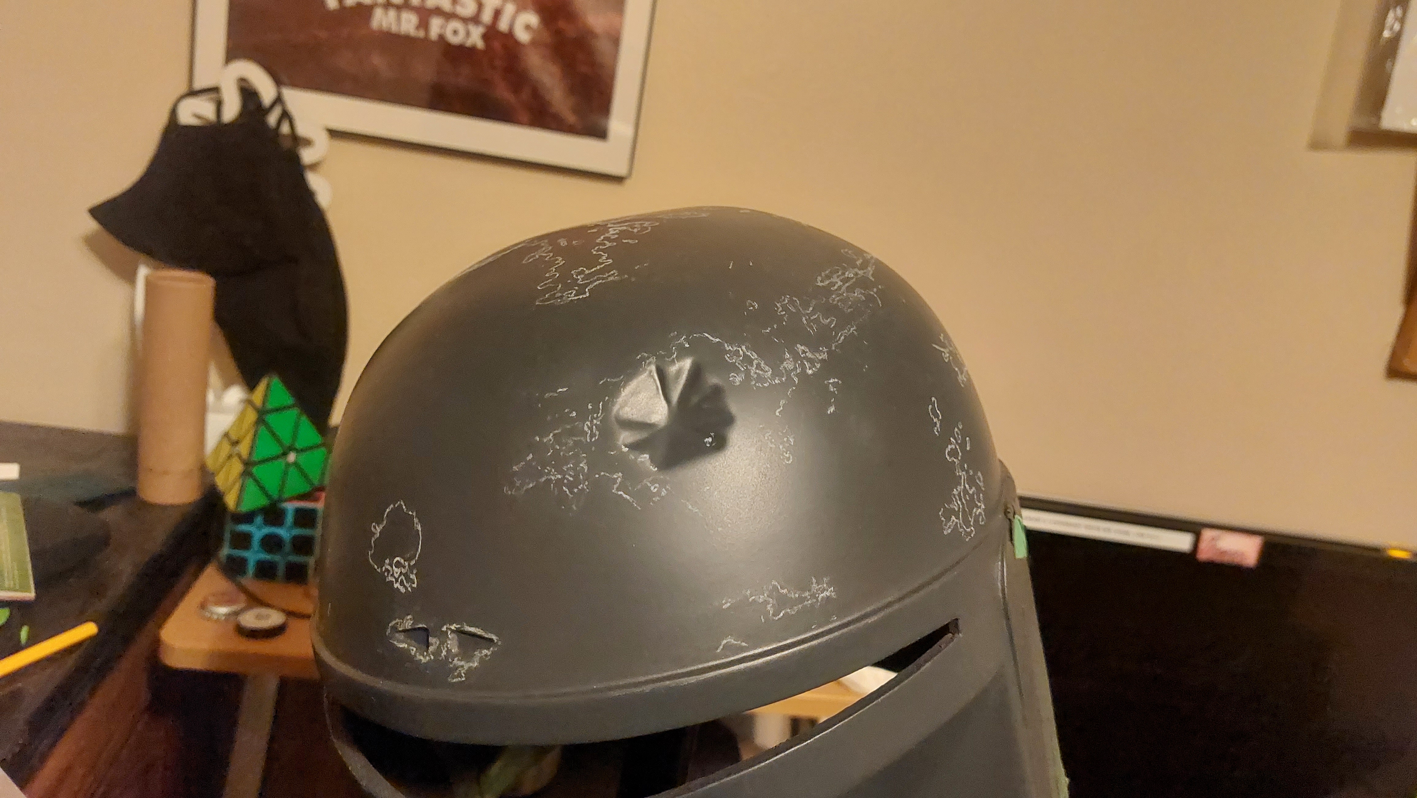

You remember when Short4ATrooper said this?
Alternatively, I suppose you could start with the dent and use that as a "navigation point" to base the other damage areas off of.
Well I sure didn't.

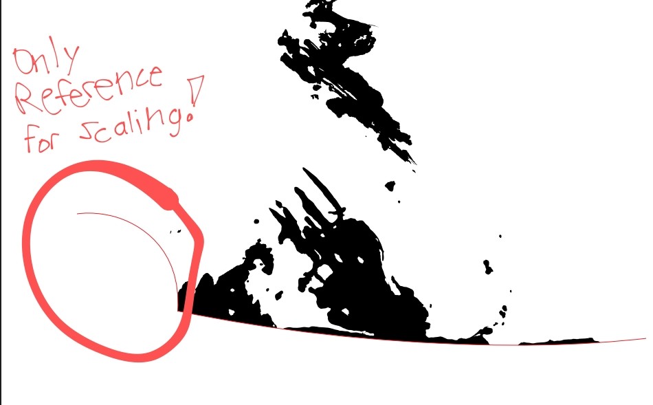

Actually, I don't think it was that I used the wrong stencil method. I think I just got the scaling wrong yet again.
If you don't see it, here's a pic of the actual helmet.
In my defense, Mr. Rafal's stencils for this area only have one sub-par reference point.
I think the cat scratch looks good, it's just the patch above it and the giant scrape across the top that needs work. So I'll erase that and scale it down and maybe skew it a bit. Man, working on a curved surface is scary!

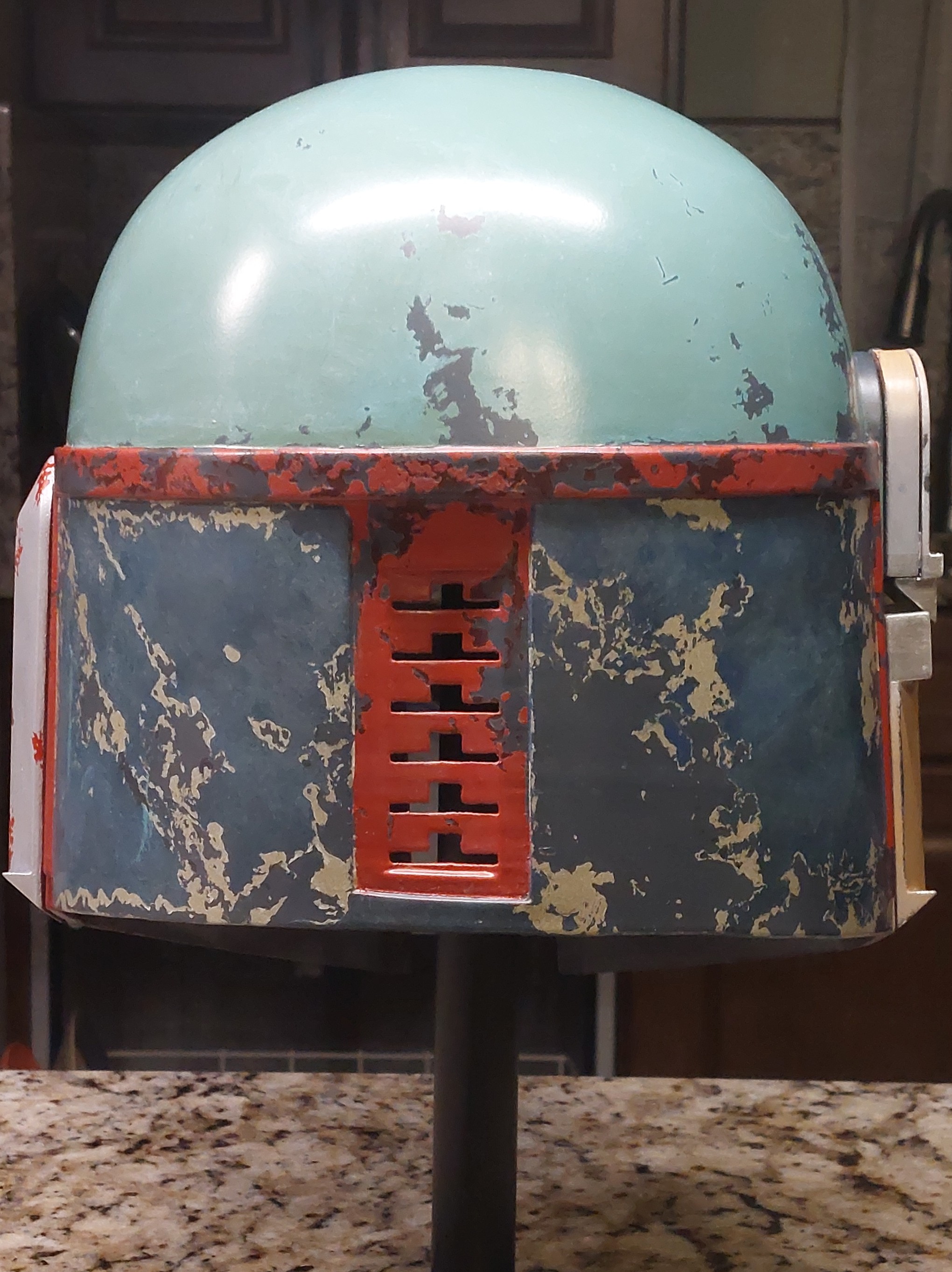

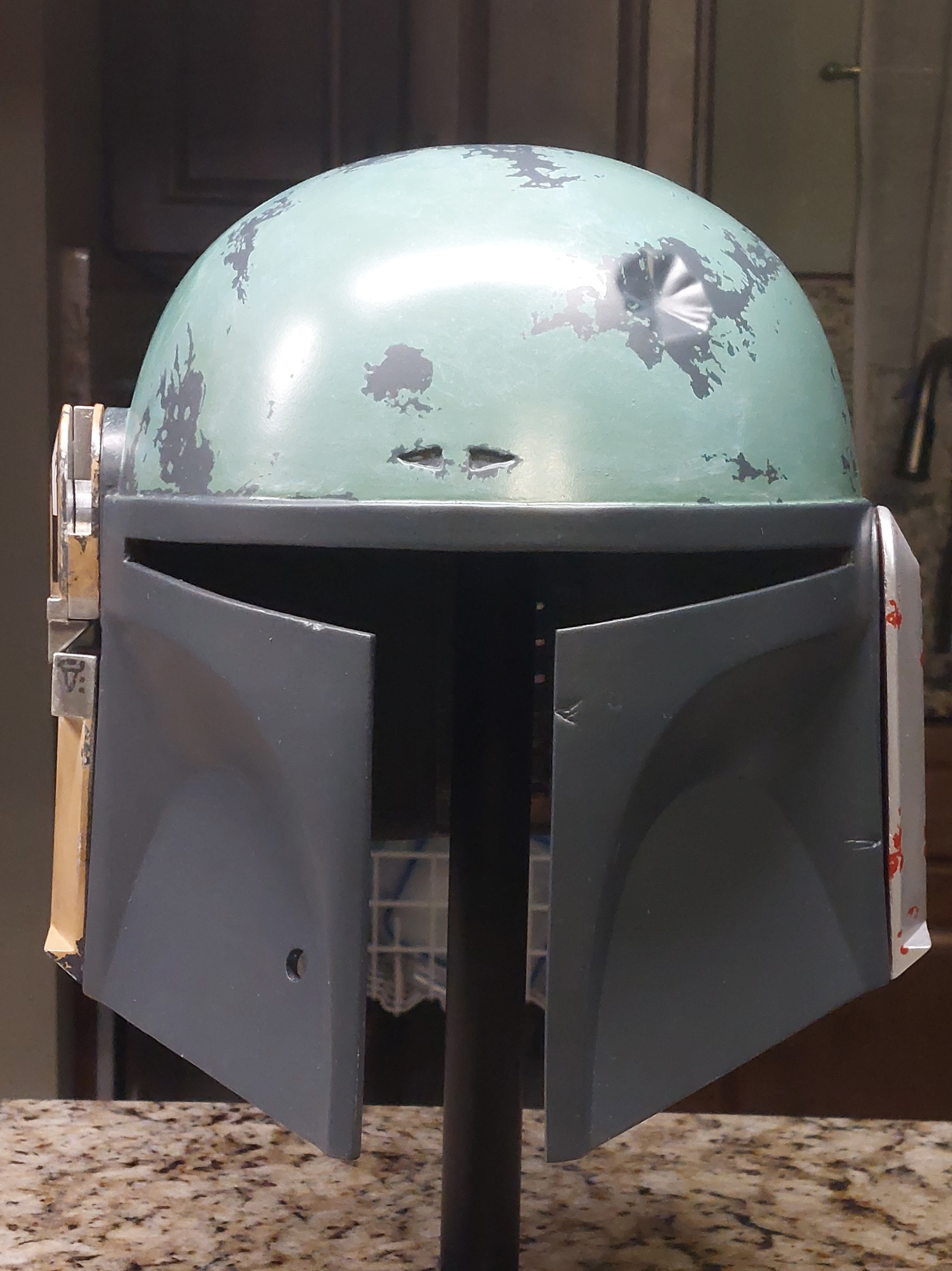

I'm not exclaiming because I'm angry, the exact opposite actually. This frickin dome was the bane of my existence, and it’s done(for now)!
I used Rustoleum Moss Green for the dome, then washed it first with a very light blue and then teal. I also added the little black smudge near the rangefinder, which is on the ESB helmet. Wait, should that be an Accuracy Tip? I dunno, I think most people already knew that...
You can probably make out the outline of the area around that smudge because I re-did it so many times. Also the green on the dome is much less of that bright almost baby blue color irl compared to what the camera picks up.
Anyways, the next thing to do is steel wool the dome because it is way too shiny at the moment, then either finish the left ear or start the mandibles!

After I returned from my spring break vacation, I decided to add another dark green/teal wash to the dome, since I was dissatisfied from the green I had used. I don't have pictures of it, and you wouldn't be able to see the difference anyways, so...
It's subtle, but I think it's much better now.

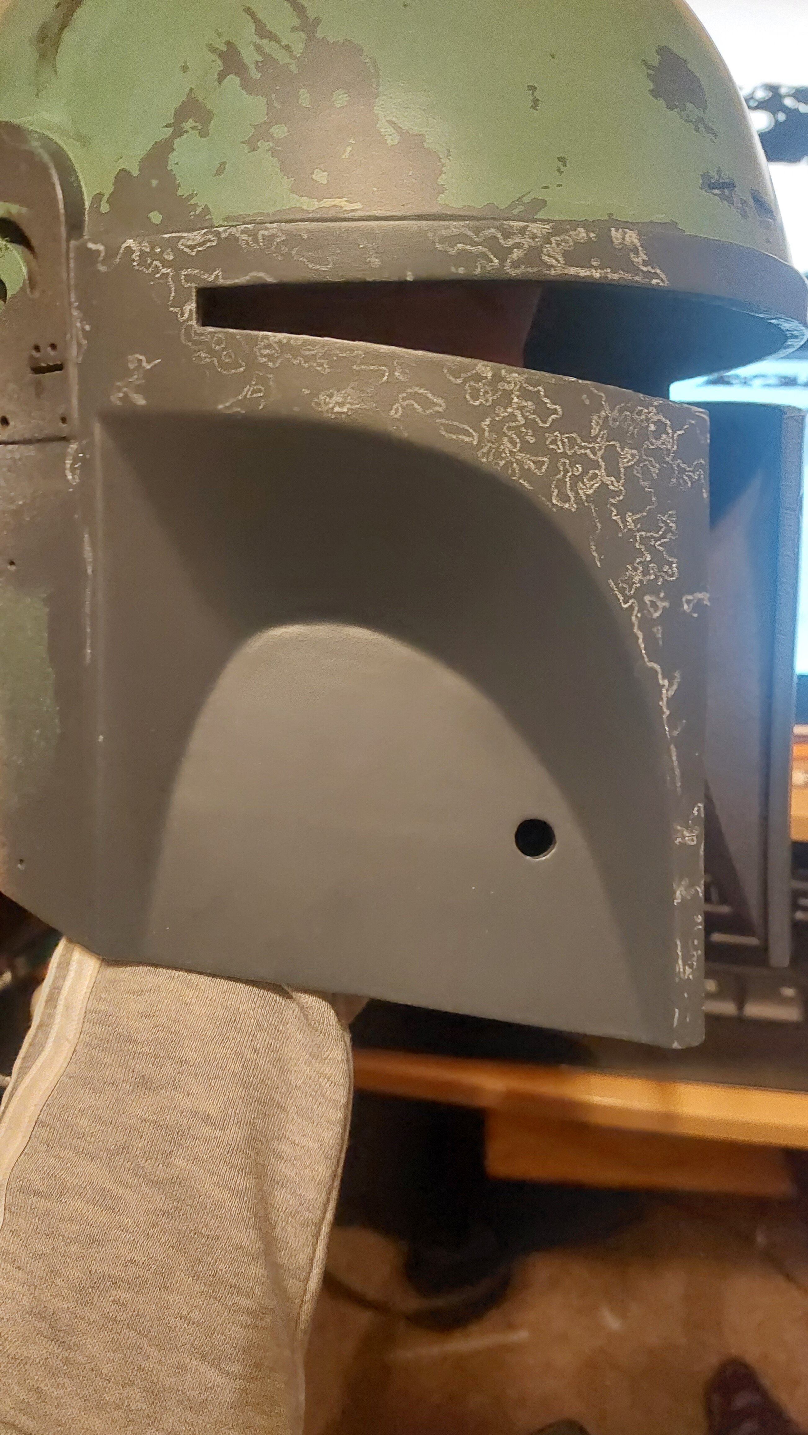

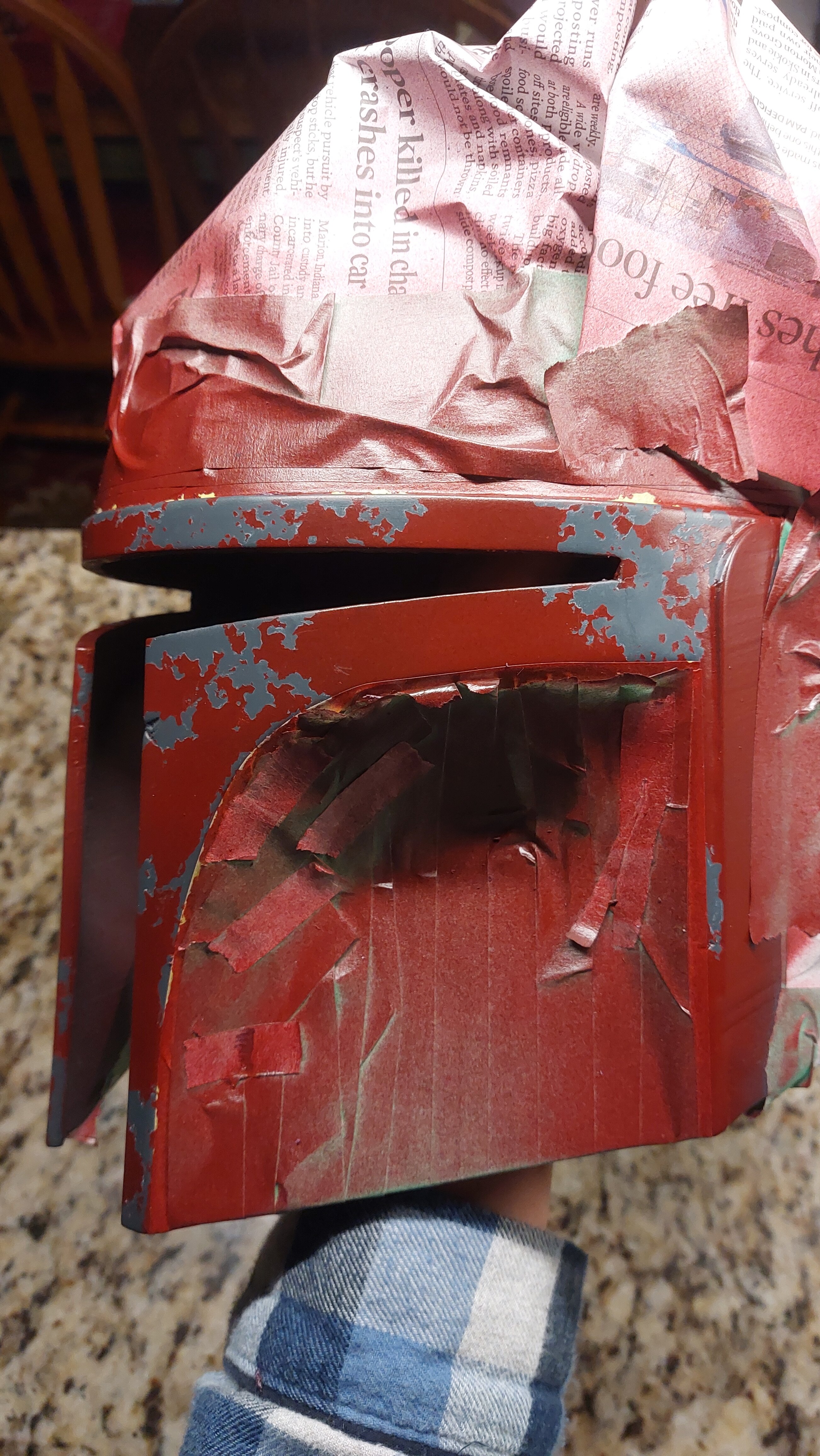

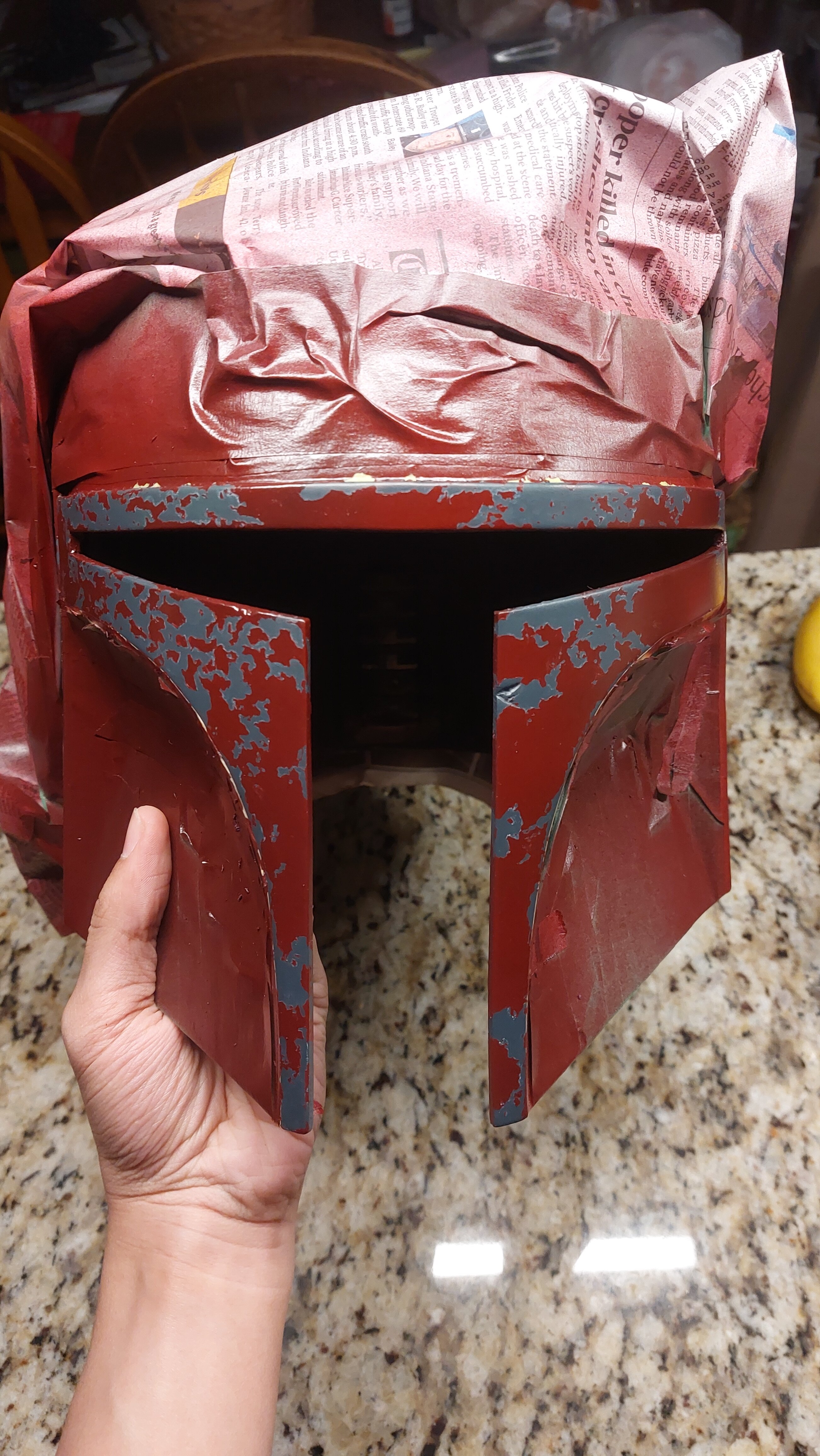

I started stencils on the mandibles, and I am seriously confused now as to how anyone can say the backplates are the hardest part of the paintjob. That was so easy compared to this.
Gray is masked and maroon sprayed.
Don't mind the hack-job tape lol.
I definitely like the idea of using purple for this layer instead of maroon. I think if I still don't have an airbrush by the time I paint my next bucket, I will certainly reevaluate my paint list. What to do with all those barely used cans though?
Who is the make of your helmet?? I only ask because that’s why you might have been having so many problems with scaling for the stencils. If you don’t have a lineage helmet for ESB than the stencils won’t work quite well and things will look off if you aren’t careful.
