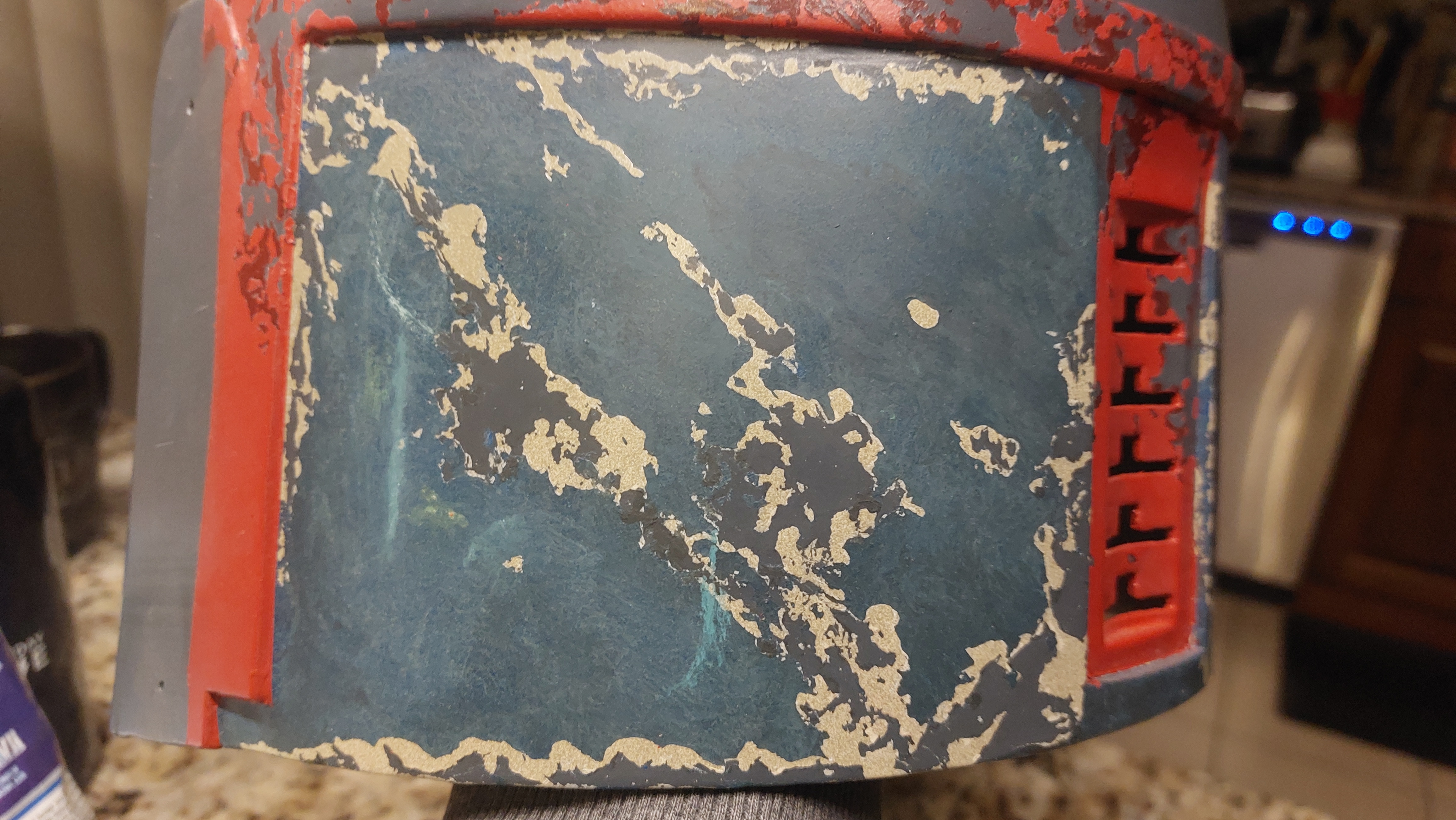

Shorter update, I have the gray damage on the keyslots and headband masked and the maroon sprayed. For this color I used Claret Wine misted with Dark Walnut, which I think is a really nice color, although I guess I should have checked how it will look against the Colonial Red...
I've seen a lot of people use purple for this color, and maybe I will have to resort to that, since I still have a feeling this may be too light of a color. Also sorry about the lack of updated. Man, if only I could take off school to work on my super most definitely important Boba Fett helmet at home! How come the American Education System can't seem to understand that I am a complete nerd artist?!?
Jokes aside, I really want to take a moment to thank TheDentedHelmet not only for all the incredible information they've provided for free and the awesome community behind it, but more importantly its welcoming nature. You can't begin to understand how much joy it gives me to see the "Big Boys" taking an interest in some high school sophomore messing around with spray cans on their turf. I know how annoying us newbies can be, and believe me, I already have a few threads I wish I could delete, and I sincerely want to thank all of you for putting up with me.
Oh yeah, the helmet, so I'll mask off the maroon and then spray the red, which will be the last color on the red areas... obviously. Then I'll move on to the dome. I'm working kind of from the back bottom up and over the helmet, ending with the lower cheeks. I also need to paint the ears at some point.
The back headband and keyslots are finished (again, minus the silver)
The headband area went terribly. I was looking at the wrong stencils multiple times, I screwed up the sizing, and the transfer onto the helmet was practically invisible. Plus, I still think the maroon could be a touch darker, so I'll have to list out a better color for that. Now I can move on to the dome, or maybe perhaps I could eventually start to think about looking into starting the ears...

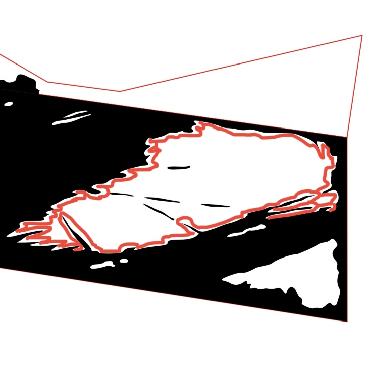

I leave a 0.5 - 1mm gap, like this:
This is the grey damage layer on the lower right ear. Now, bear in mind this was done on my phone with my finger so it’s usually a lot cleaner! But, this way, when I come to applying the masking fluid, I know to stop just short of the pencil lines and then I don’t have to worry about removing them afterwards because they’ll be painted over. With a 0.5mm mechanical pencil - it’s fine enough to get in and do really intricate detail and it never needs sharpening as it’s always in a point.
The next challenge is finding a method of applying the masking fluid as intricately as the lines you’ve traced. Up until now, I’ve always used a pointed silicone brush but I always felt I could do better and recently have had better results with a wooden skewer or toothpick. The trick is to apply it in single drops from the end of the skewer and then gradually draw the fluid into the tight areas. I’ve also done this with sewing needles but there’s something about the way the metal doesn’t pick up the fluid that well that means you have to load the needle with a lot of fluid which kind of defeats the point (pun intended). I found the fluid ‘sticks’ to wood a lot better.

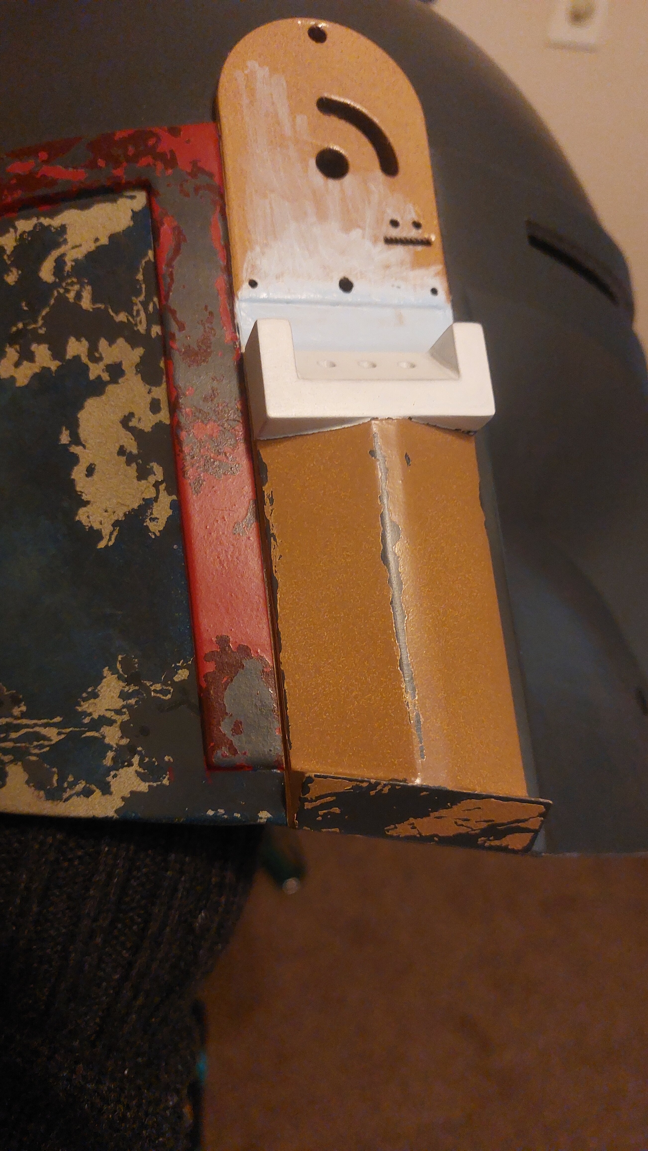

For the tan I used Khaki heavily misted with Nutmeg. Not a huge fan of the color, I feel like I shouldn't mist on "main colors" and I should have gone lighter on the Nutmeg, but it's good enough for me.
Look at how I massacred my boy...
I dropped the helmet. Even though it landed on carpet, the fall was too high to leave it undamaged. I did find out just how much paint I've put on this thing though. The paint layer is thicker than an apple skin, so I can't just put another coat of gray on and call it a day. I was actually looking for a reason to redo the whole face area, since the crack was still visible, there were dustings of overspray on the cheeks, and there were simultaneously areas of thin paint and drips on the mandibles. I'll spread some bondo in this chipped area and sand down most of the face so I can repaint it.
I know how it feels, I dropped my first bucket early on and the pain is real. ShortFuse is doing a helmet paint up where he repaired the crack. Definitely worth checking out since he did it the right way by drilling a hole at the end of the crack to keep it from spreading. Looking really good so far!
While I continue to twiddle my thumbs on the idea of fixing the crack on the face, I decided to add more topical details to the backplates.
People say the backplates are the hardest part of the helmet to paint, but I just find it the most fun. Maybe I'll change my mind after I add the silver.

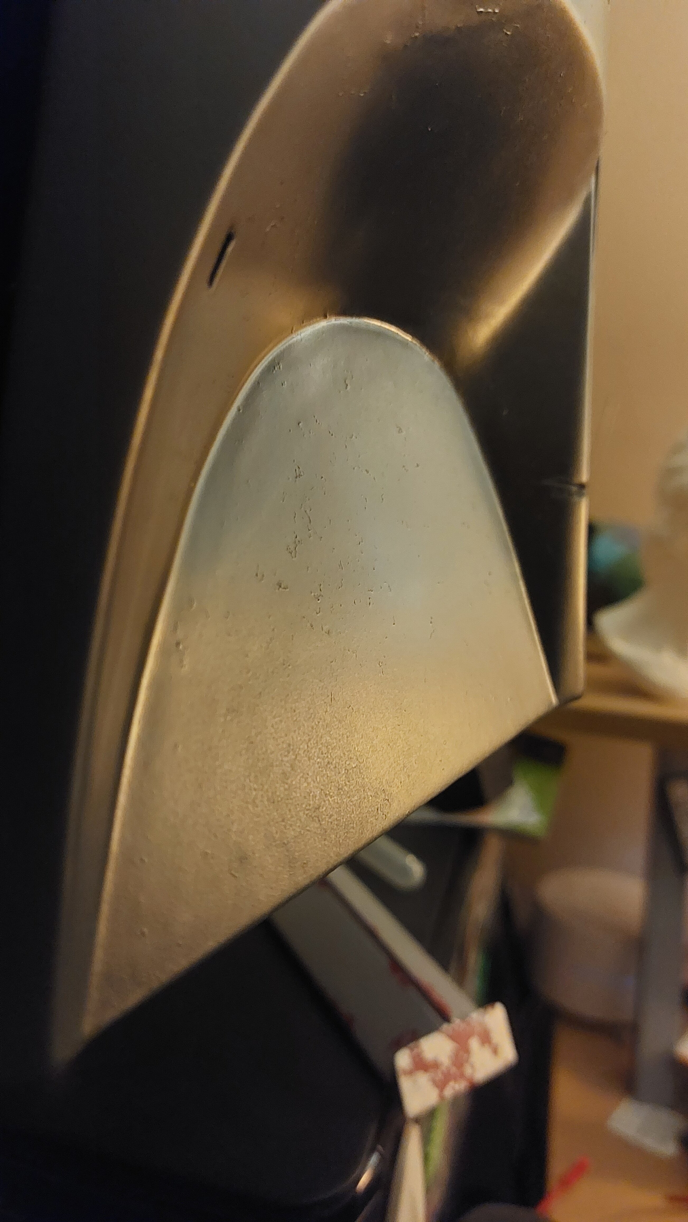

Speaking of silver, I added some to the left ear.
I debated whether or not to paint this gray or a dull silver, and decided to do silver with the intent to add a matte clear coat on top, which should dull it out well enough. I'm also in love with the masking job I did on this piece! The only thing I did differently was a lot more dabbing with the silicone brush and almost "dry brushing" the masking fluid to create the sporadic dots in the red, which worked out really nicely.
What didn't work out nicely was that other ear. I'm realizing that the misting of Nutmeg was way to dark, and I should have just stuck with the Khaki all the way. I will repaint that ear and its platform. Oh yeah and also the crack on the face.

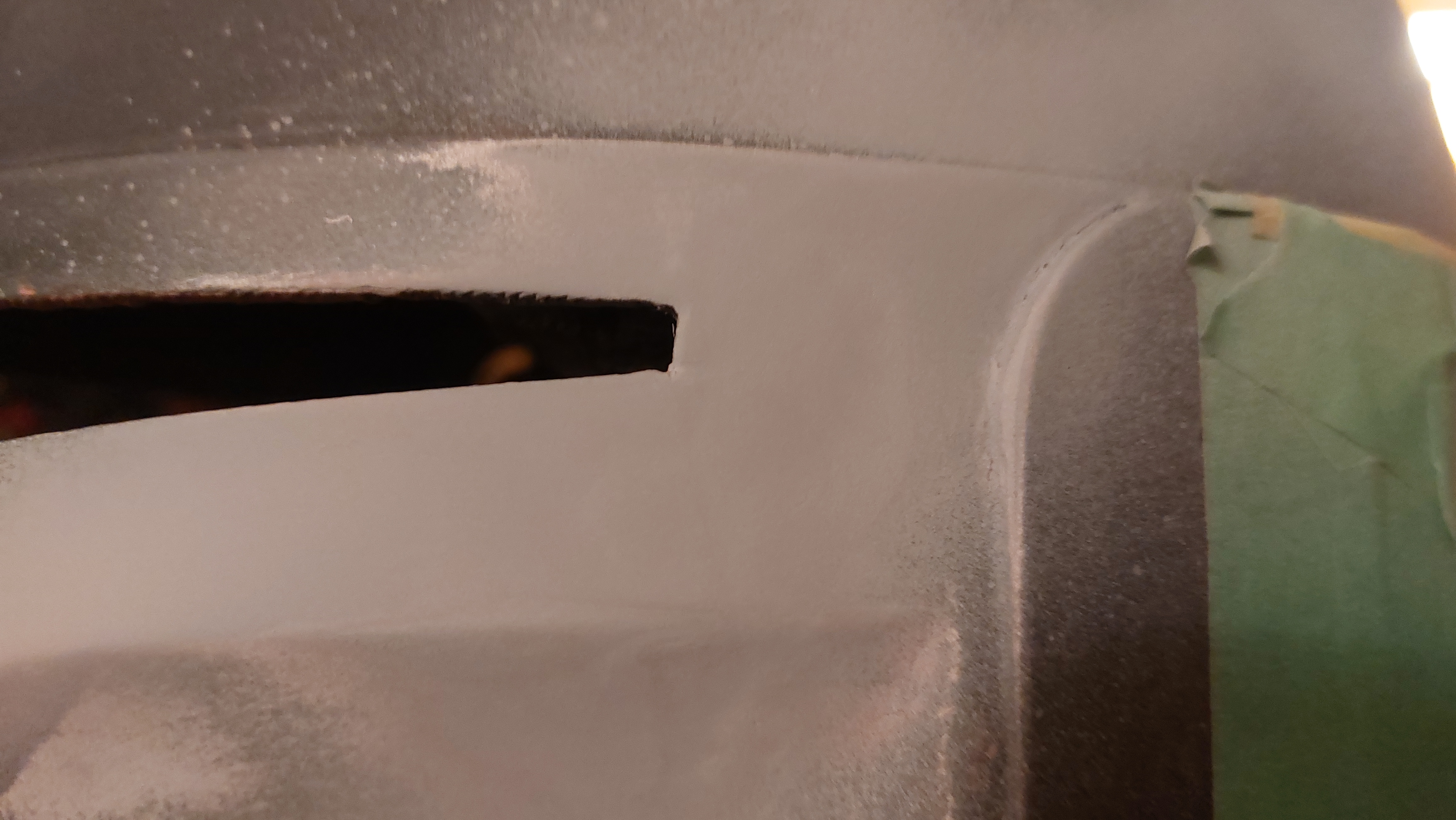

I also sanded some spots on the face that were bugging me

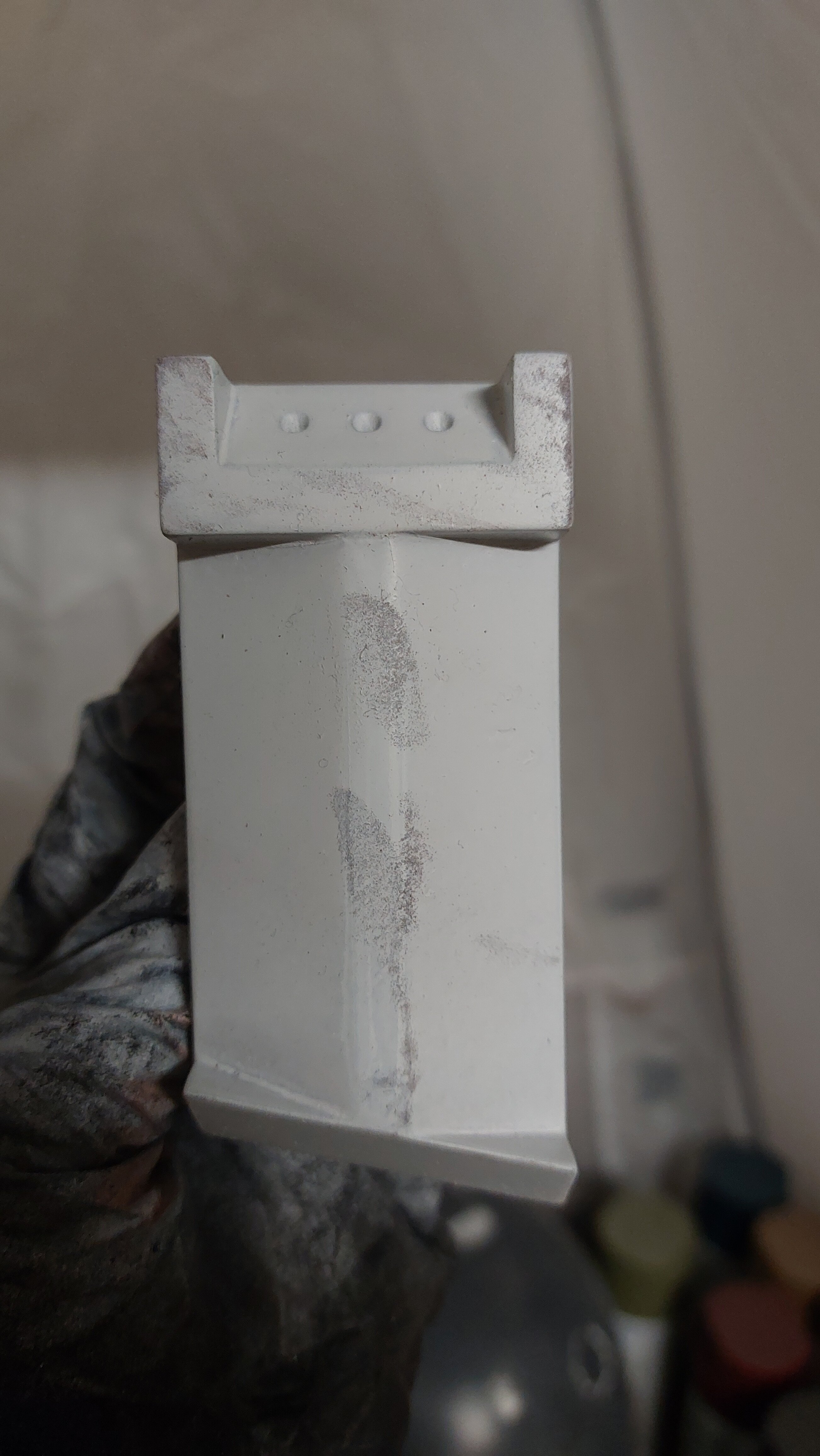

And I re-prepped the right ear for paint, before swiftly dropping it wet side down.
Because literally what other side would it ever fall on?
Ughh...
I forgot the towel I use to wipe off sanding dust is an old cotton rag that is certainly NOT lint-less.
So I have to sand that off and start over...
And I got drips again too! Oh well.
