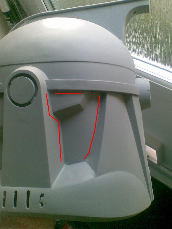

Well, I hoped to get more done on this over the weekend but alas all I've done is tidy up all the horrible large seams on the back quarters of the helmet, I have put a red line on the picture to illustrate the real pain in the backside areas, I do intend to make a copy of this helmet now as was mentioned in a previous post, if I were to end up wearing this as part of a costume it would weigh a ton, therefore I will tidy it up as best I can and then consider getting a copy made, its nice to see other people tackling the same project :thumbsup:
