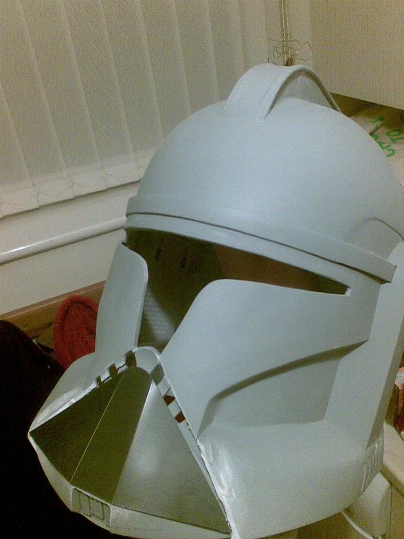

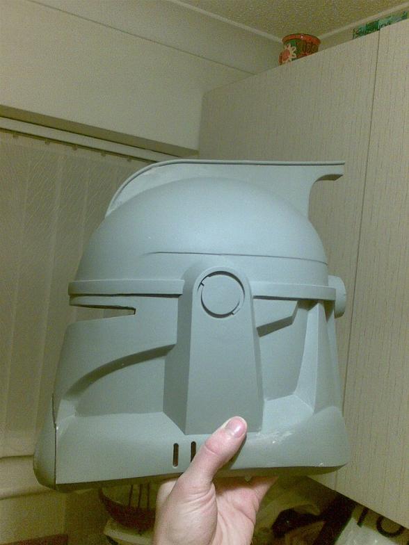

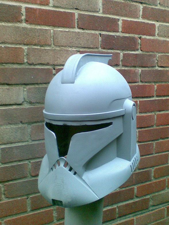

Ok after a few weeks of not even looking at this helmet I decided to pick up and carry on, mainly thanks to the fact that Brian got his finished and cast in less time than it took me to primer mine :lol: All I have done lately is to round off the corners of the visor as they were a little to angled for my liking, I have also built up the around the top of the visor by a few MM as I felt it was too wide, I am nearly there with this, although I need to decide what to do about the chin, its massive, I may just cut it off and rebuild it! :thumbsup:

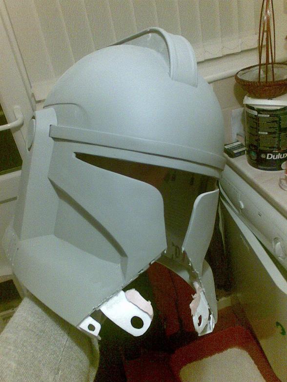

Argh!!! Ok, I have been feeling unwell lately and so whilst highly medicated I decided to bite the bullet and cut off the clones chin!! I have been toying with the idea of this for a while as the chin is very cartoony, it sticks out quite far, really I want a helmet that leans more towards the AOTC clones, so having removed this section I will now start re-building it, giving the clone a face lift if you like! :thumbsup:
:eek::eek:
Man you really did bite the bullet buddy... I'm sure you'll pull it off as I've seen what you can do to little projects...! ;)

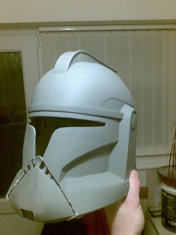

Ok, here is the slightly trimmed back chin, taped into position to give the overall look of how the new profile will appear, I think it looks loads better, next up, tons of filler, my favourite...........:lol:
Ha, may be able to help you out with that real soon mate ;) Ok I decided that instead of slapping a load of filler on the chin and sanding and sanding endlessly to get the right contour I would just build another chin out of styrene, lay it over the old chin and fill in the seams, lazy I know :lol: :thumbsup:
