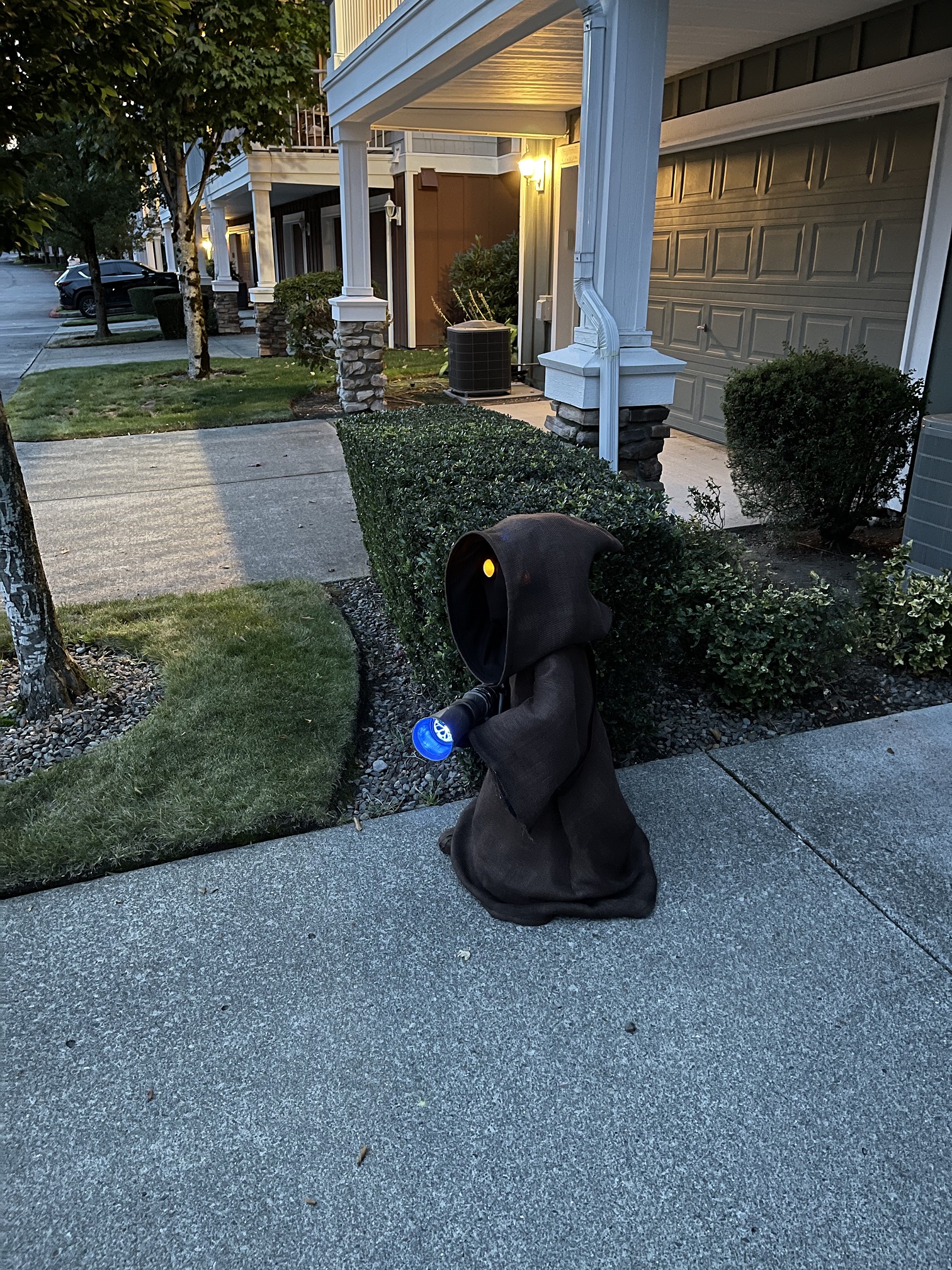

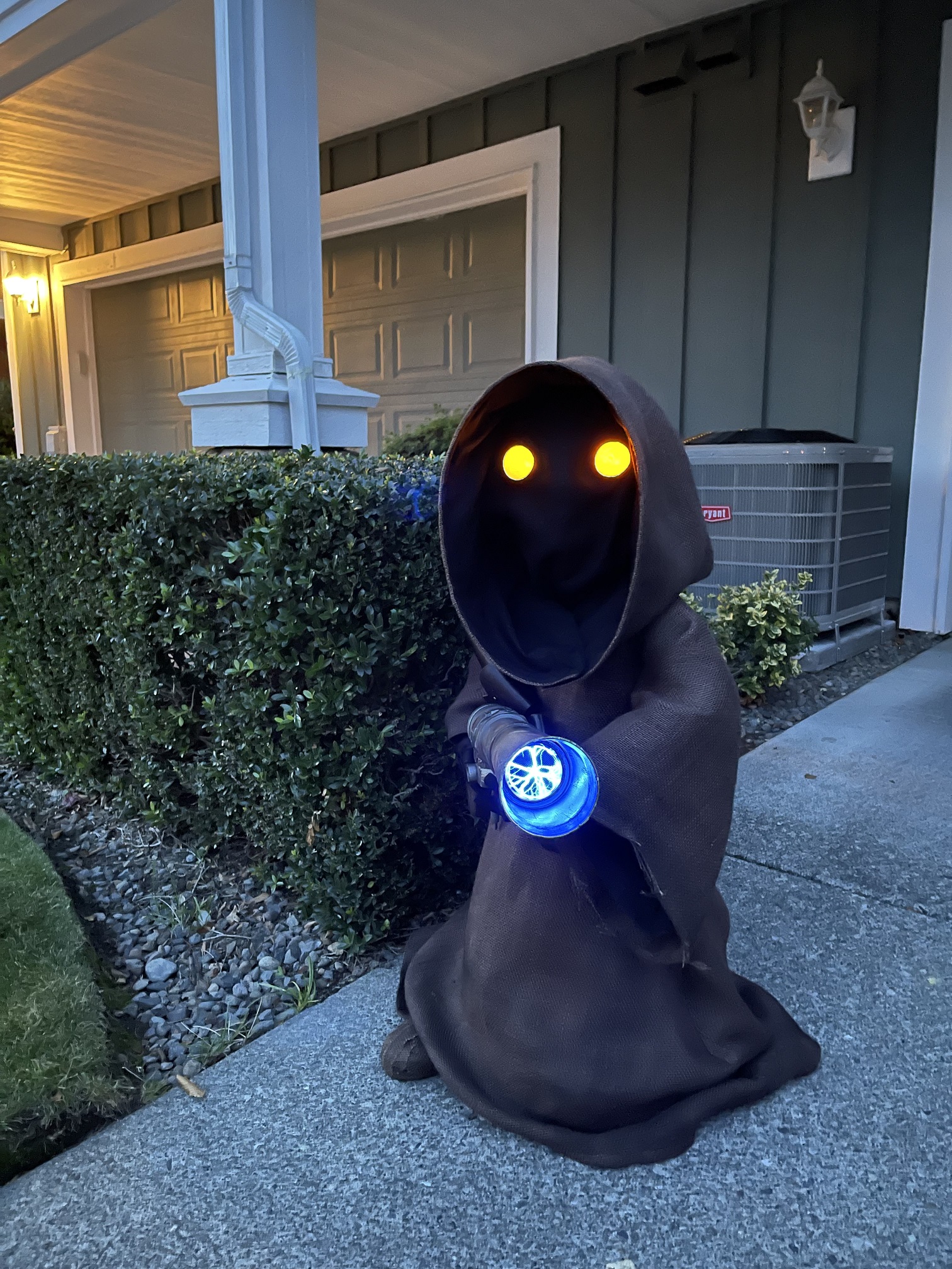

I got the bottoms of his robe a bit more weathered and the ends of his sleeves torn up a bit. Oddly the black doesn't show up all that well on the robe, but it is there.
And he looks excellent in the dark!
I've got some of the Jawa sounds able to play. I just need to refine it a bit more, and include some pauses so he's not such a blabber mouth.

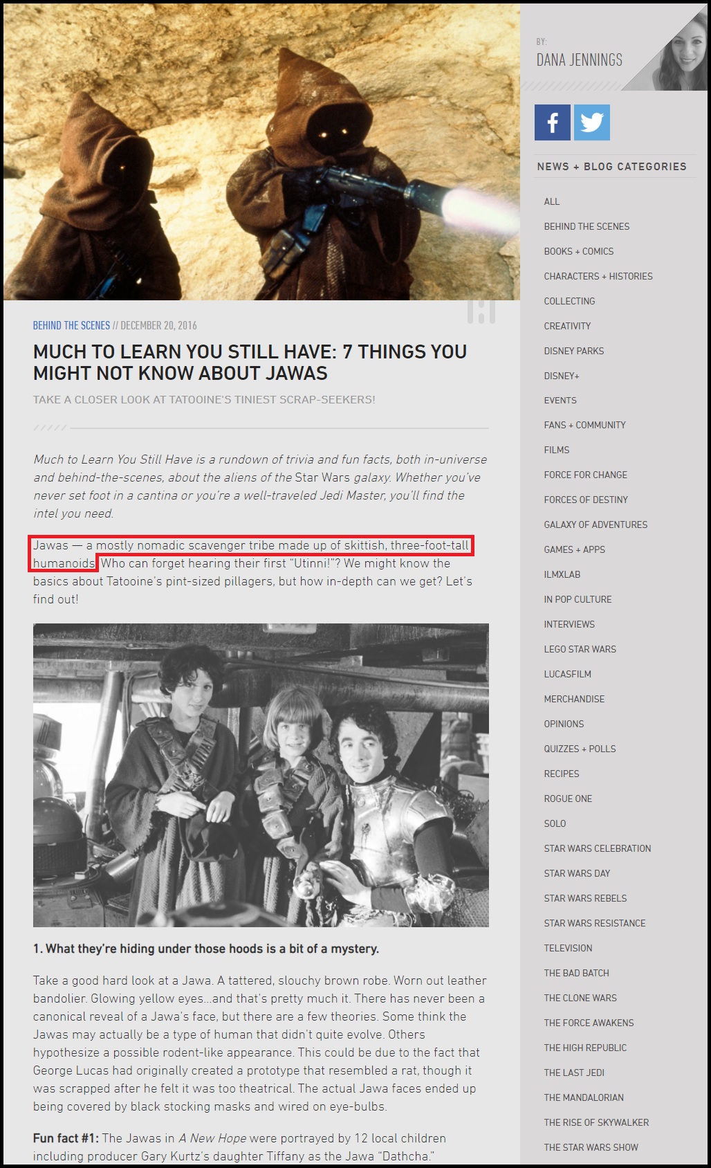

But enough of my ROTJ Fett, today I wanted to start to walk you though my process of building a static 1:1 Jawa prop. This Jawa will stand at exactly 36" as per the article on starwars.com.....
