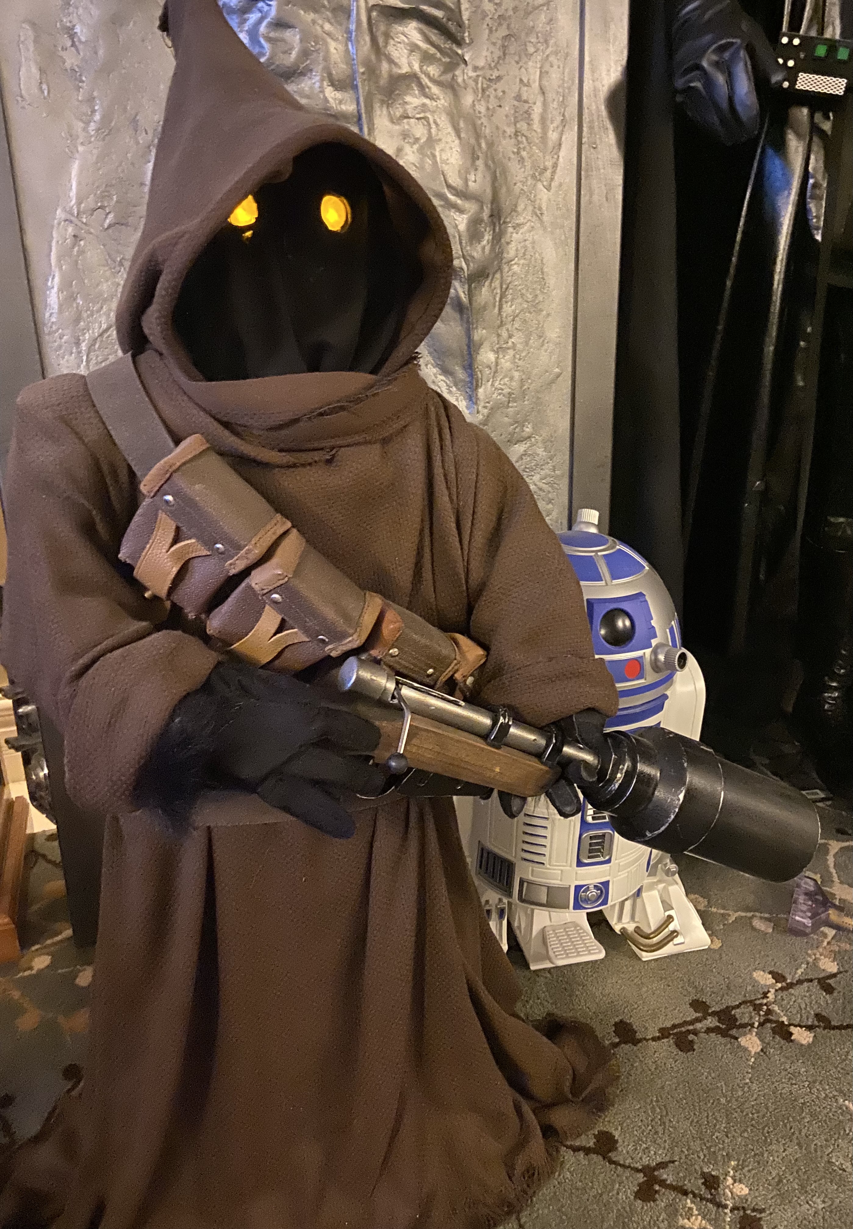

Looking good Iron. Here is one I built years ago before I embarked upon Fett-def not as good as yours but thought I'd share. Also think its a good time to finally give you and Lazer a big shout out for your threads helping me on my ROTJ hero approval- BH60313 finished last March! Couldn't have done it without both of your build threads and many others here on TDH!! Awesome community and support here.

That's a great looking Jawa you got there! (y)
AND....Bravo by the way, on gaining entrance into the ranks of the 501st with your ROTJ Fett! Would love to see pictures of your setup!

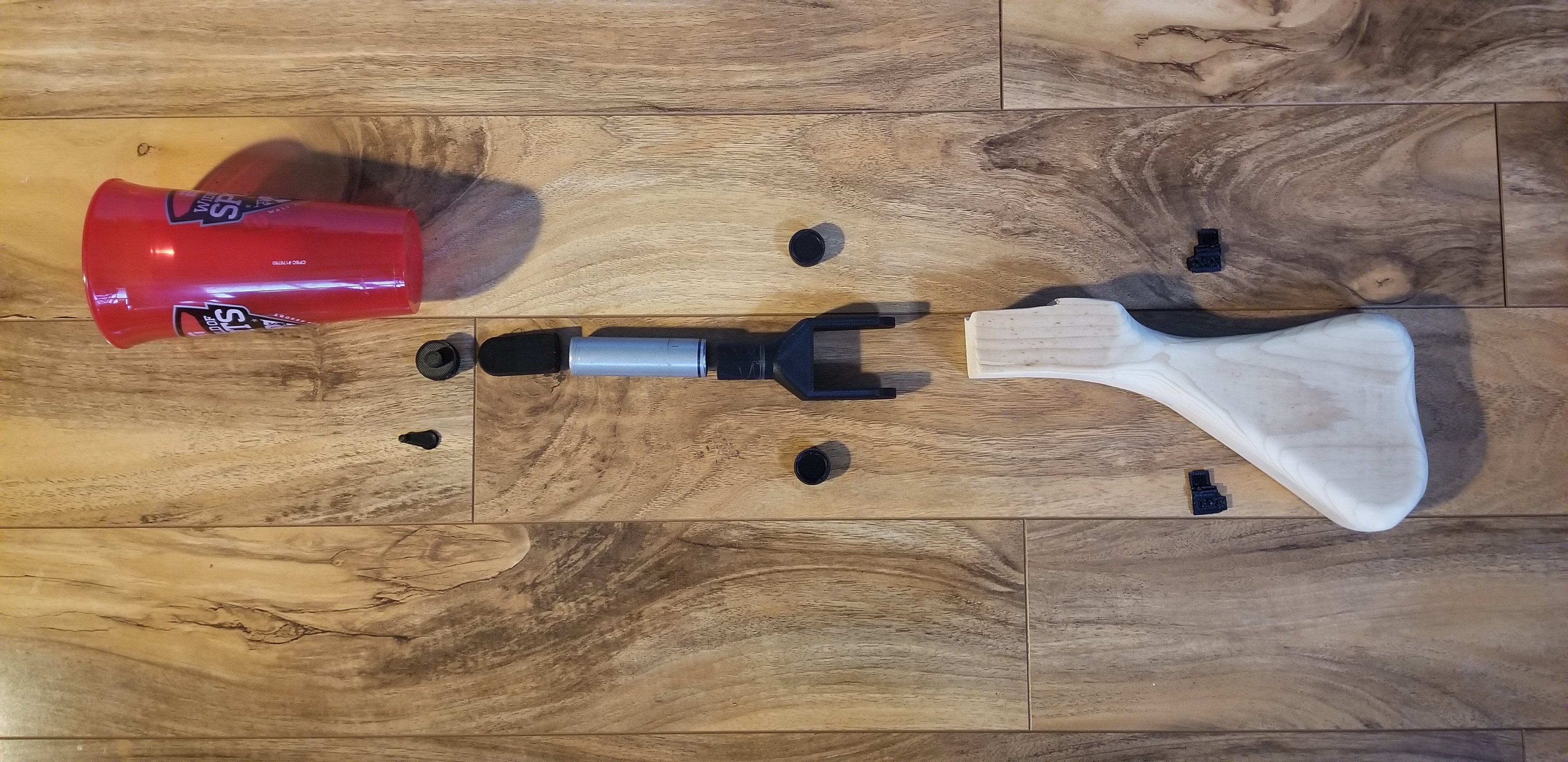

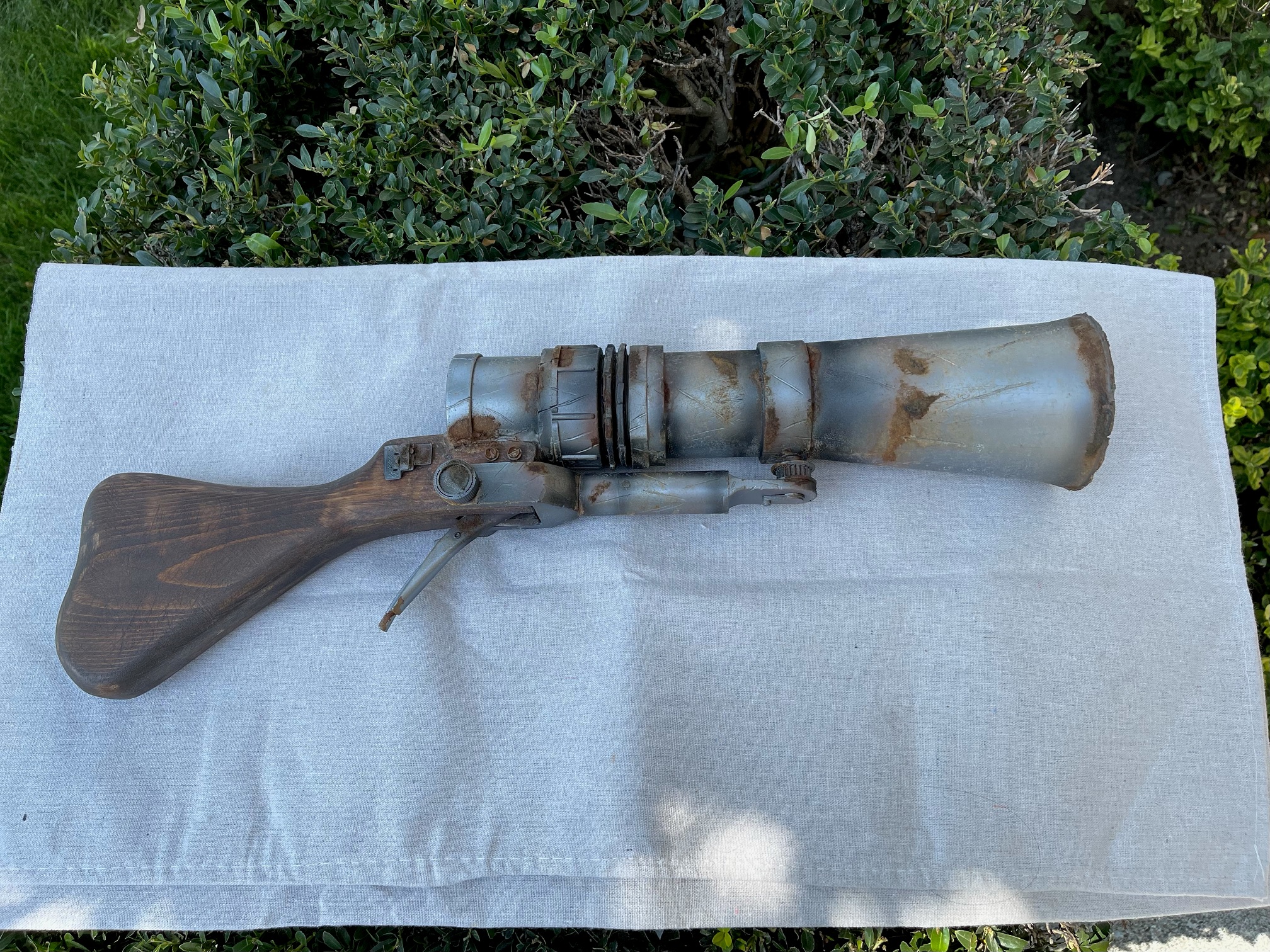

So, I think I'm nearing the end of the Jawa Ion Rifle - just need to seal it up. But it is crazy to think that it came from just this.....
(Photo Credit to Lazerjock )
To this.....
The Rusting Effect from that youtube video....
.....worked wonders! I was completely blown away by the results. Kinda hard to beat REAL Rust I guess huh? To do this I airbrushed a little rust color onto the blaster, which again all by itself looked horrible (I thought). Then I applied the Mod Podge, Iron Powder to the Ion Rifle and then made a mixture of Hydrogen Peroxide, Salt and Vinegar into a spray bottle and it definitely gave it the look I was after! Here was what I used for that mix.....

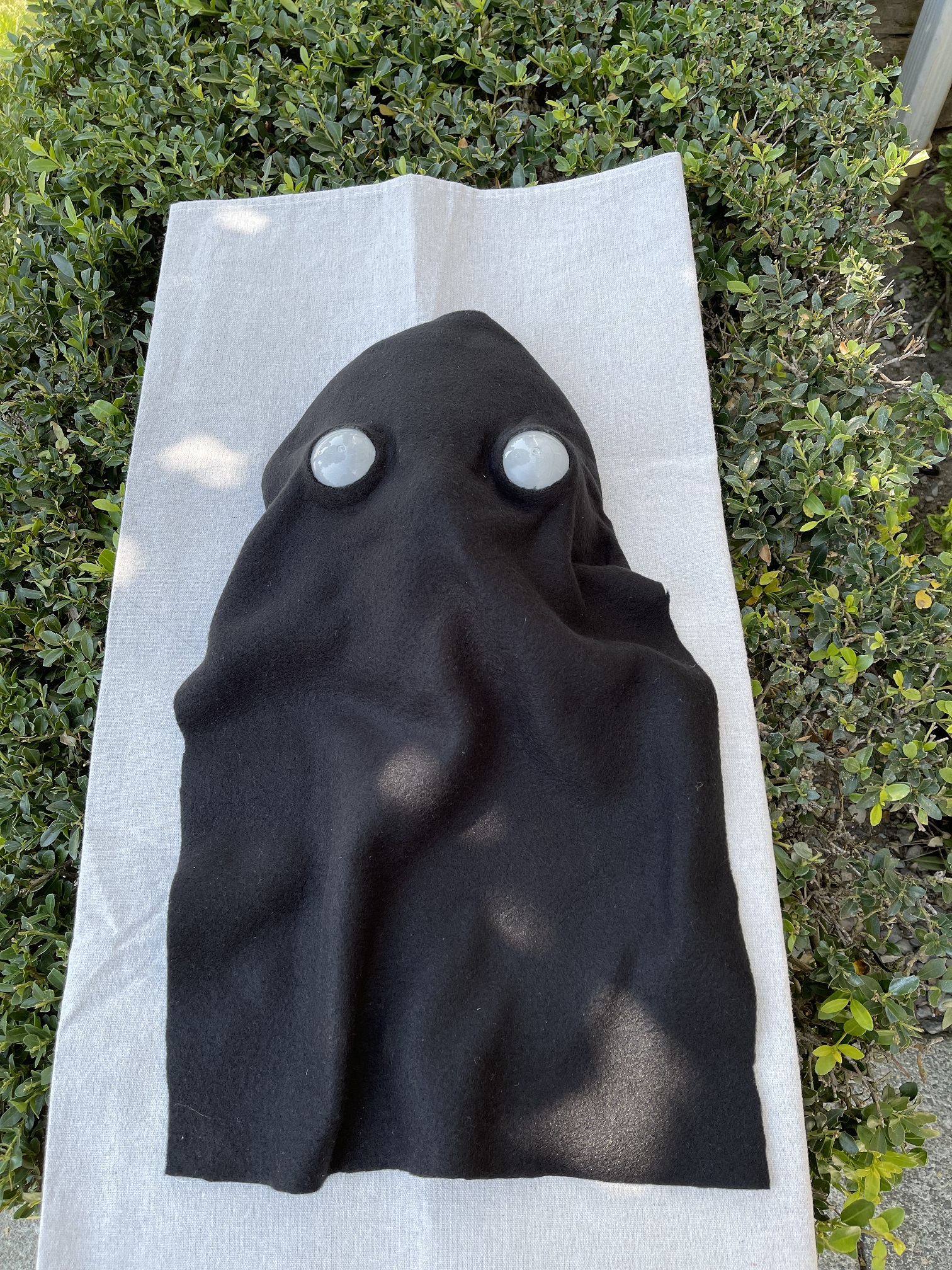

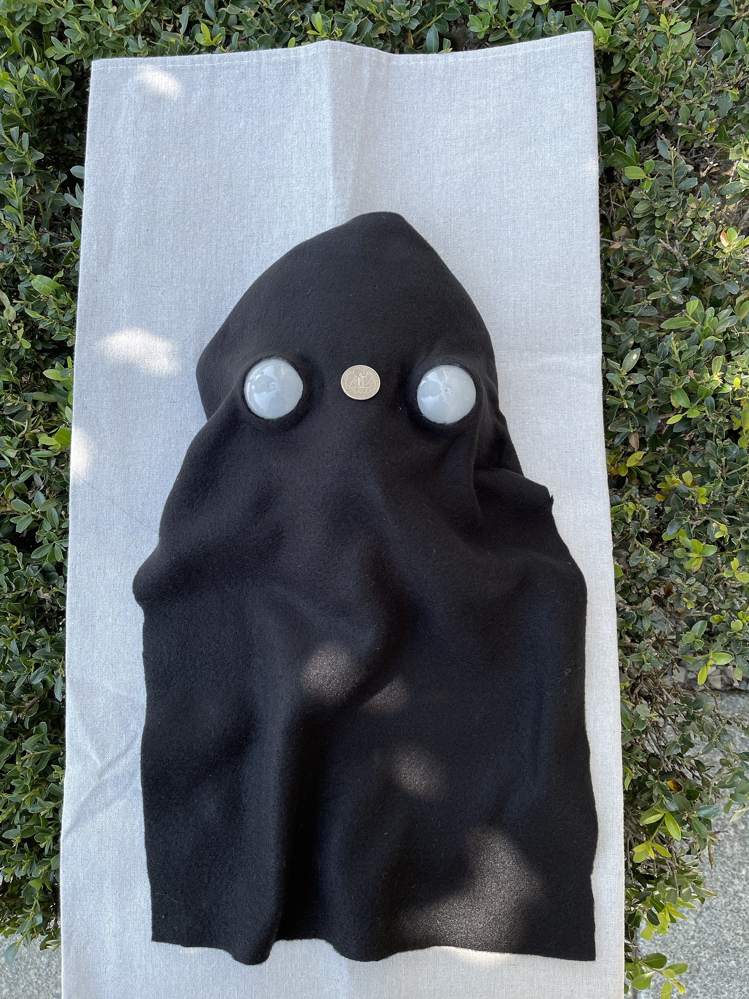

I also completed the face mask too.....
And here is a quarter for comparison on the eye size.....
I'm not overly concerned about the fabric and the way it is fitted to hide the bulginess of the gumball containers as when this is displayed at night it will not be noticeable.

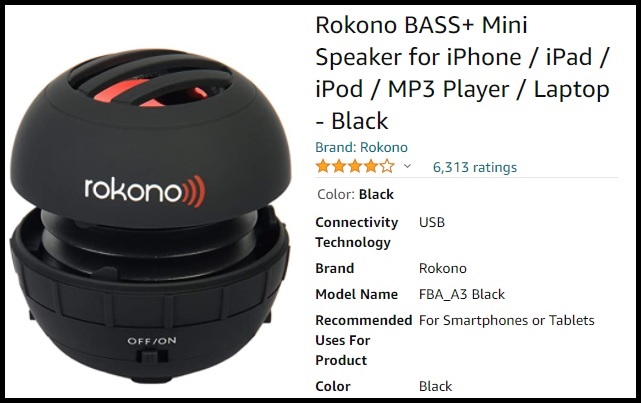

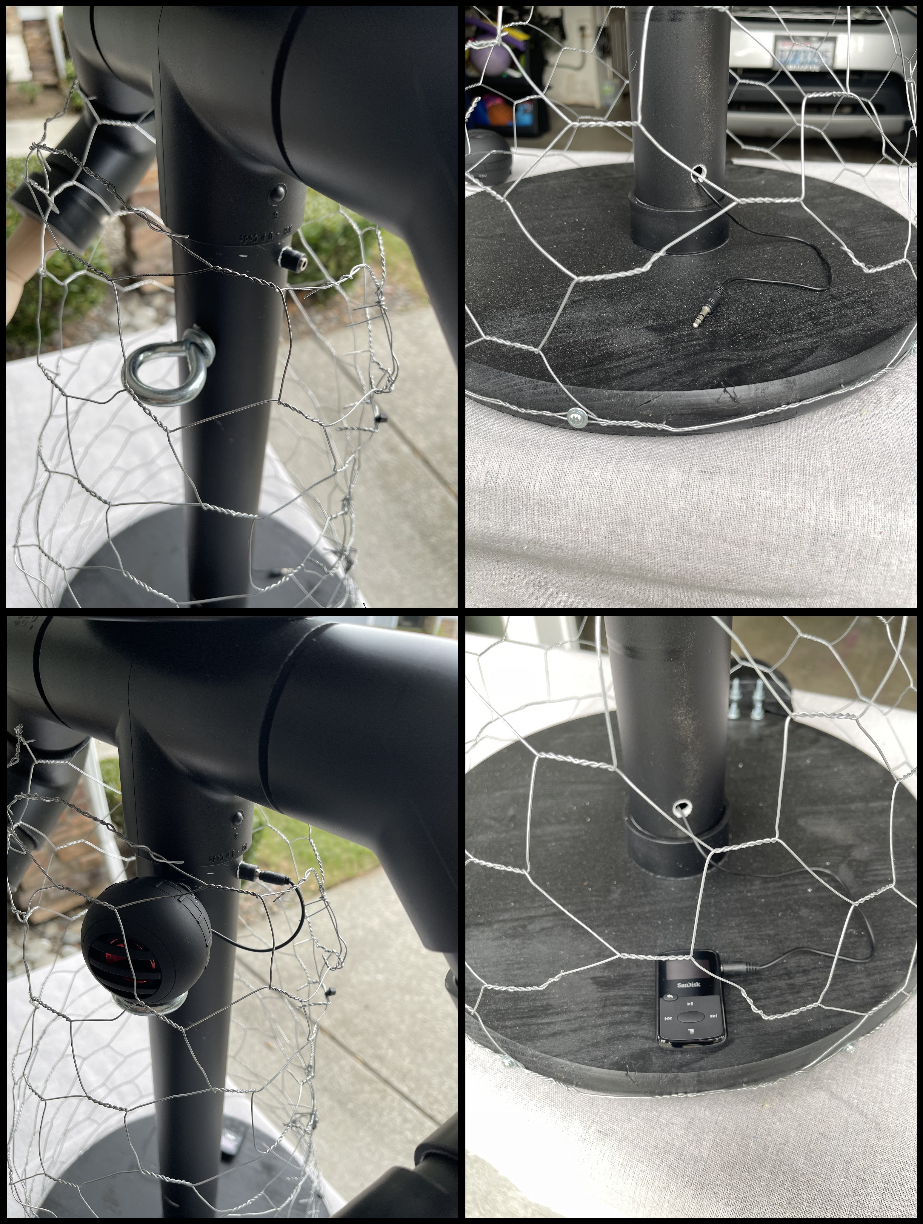

Moving on to the sound system for my Jawa. I went looking for a small low profile wired speaker to play the Jawa sounds through. I found this from Amazon for about $15.00, which also had the added benefit of coming with a small 3 foot audio extension cable!
I also needed an MP3 Player, so I grabbed this with it, also from Amazon, for about $20.00....
Not that I was terribly distraught by it, but the screen on that MP3 Player I can tell you is NOT Color - Hahaha! Saw Gerrera would say.....

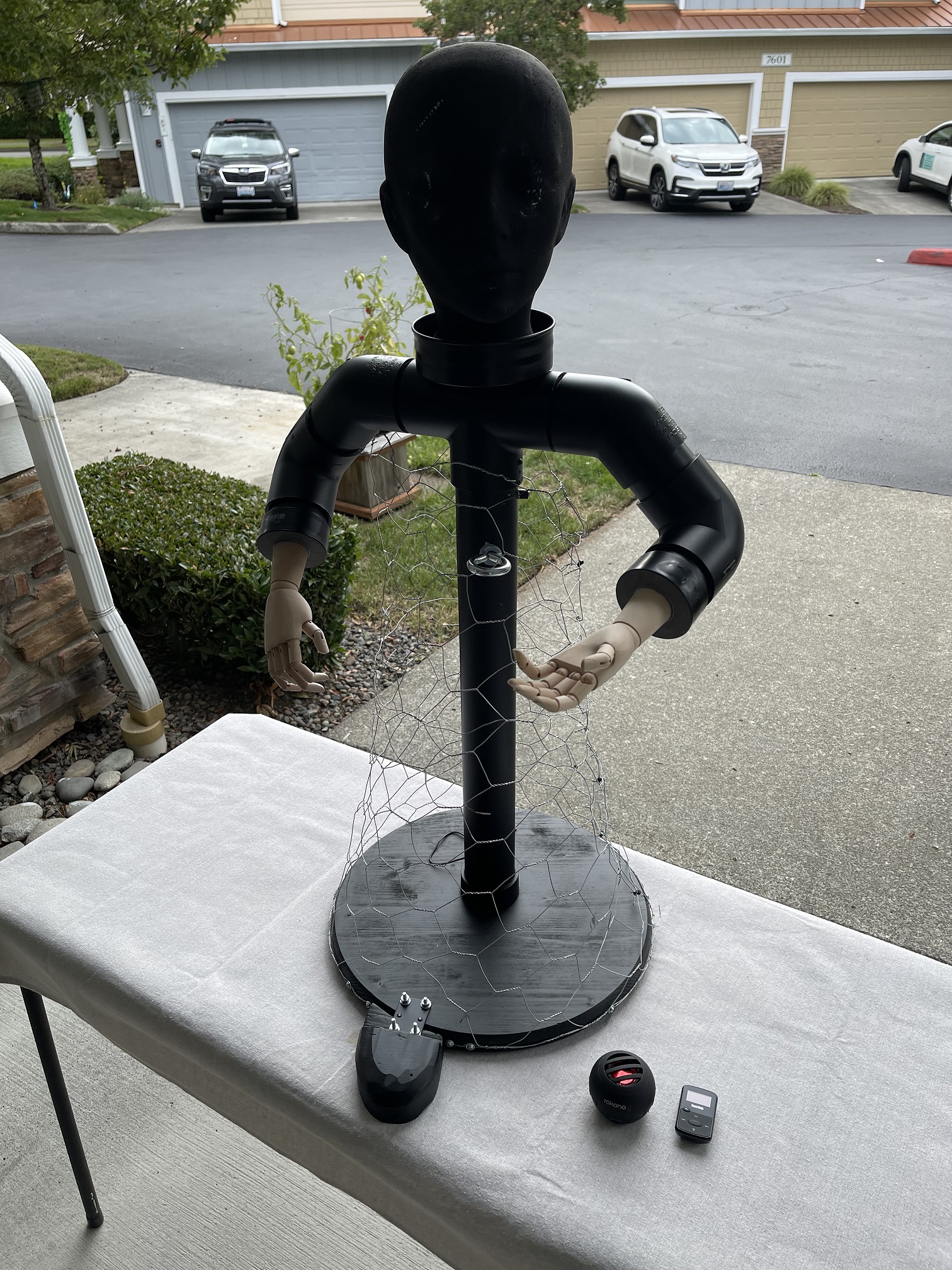

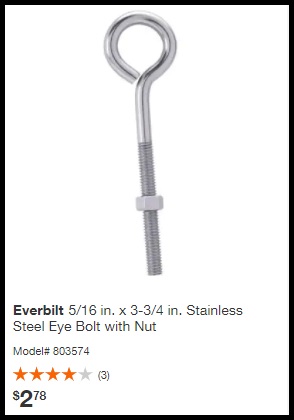

I wanted the speaker to sit somewhat close to the head and for that I grabbed my speaker and headed to Home Depot. I grabbed....
5/16 in. x 3-34 in. Eye Bolt - Due to the shape/size of the speaker, I found that it fits in it perfectly.
And here is what I came up with.....

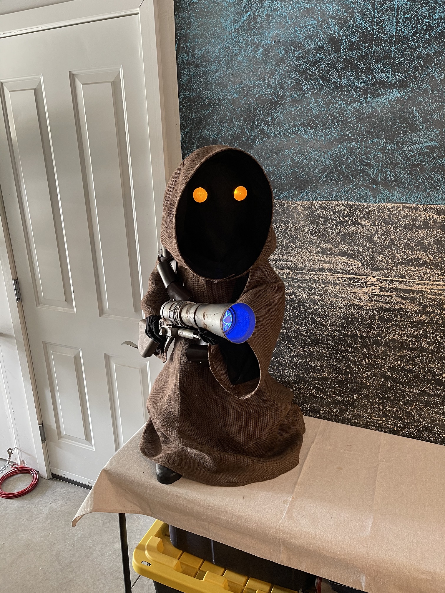

**Jawa Update**

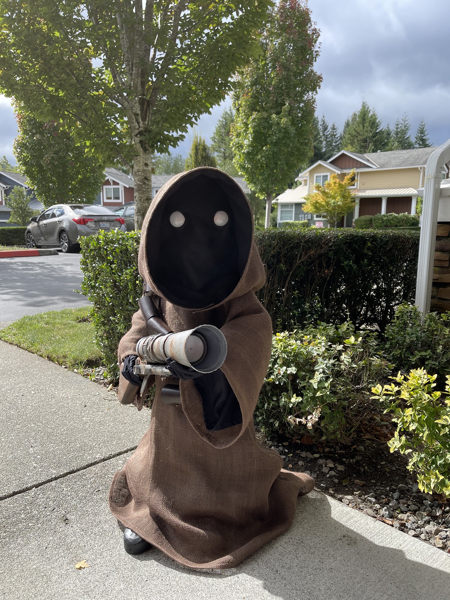

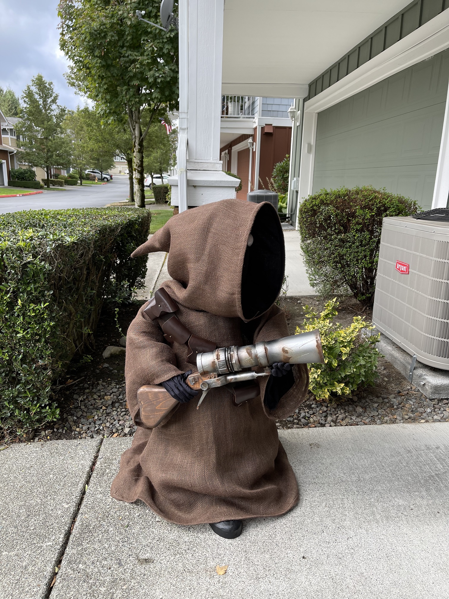

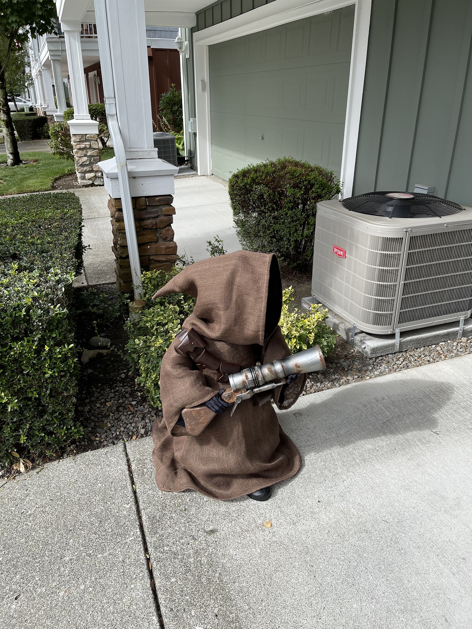

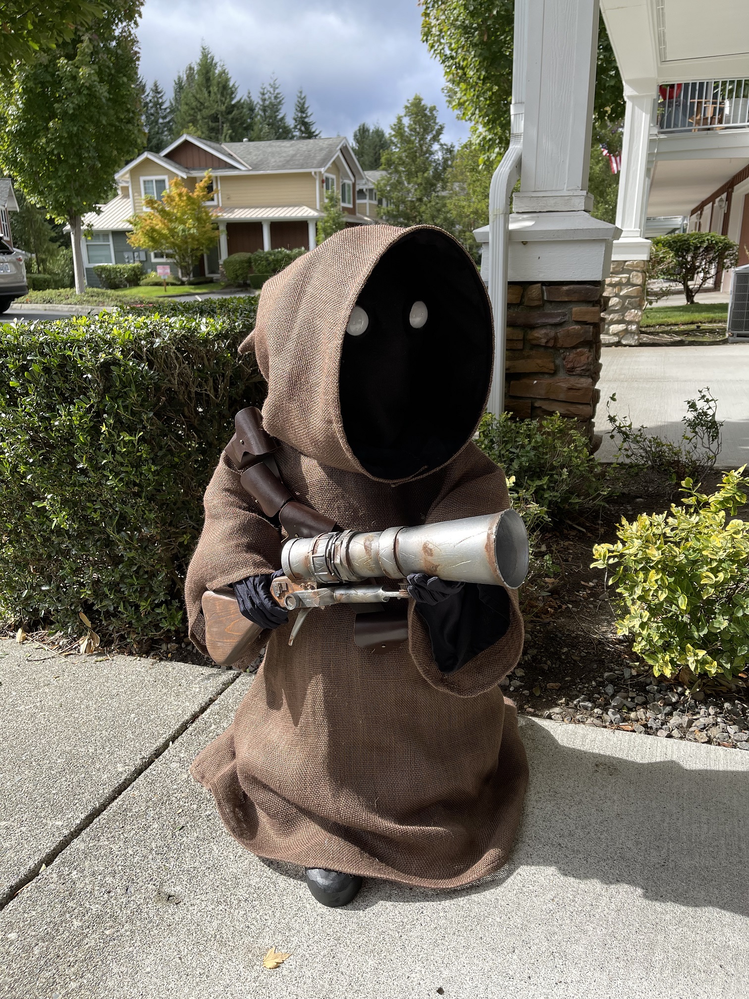

I got my Jawa Robe and Hood back from my Alterations Lady yesterday and got everything fitted last night. I couldn't be any happier with her work! She did such an amazing job on it....
Unfortunately the LED's (Eyes and ION Rifle) are NOT bright enough to show during the sunlight (and yes they are on). So, I've taken the Jawa to a little darker location where the electronics show up better (My garage).....
I love the way the lighting LED bounces off that clear gloss finish on the inside of the barrel!

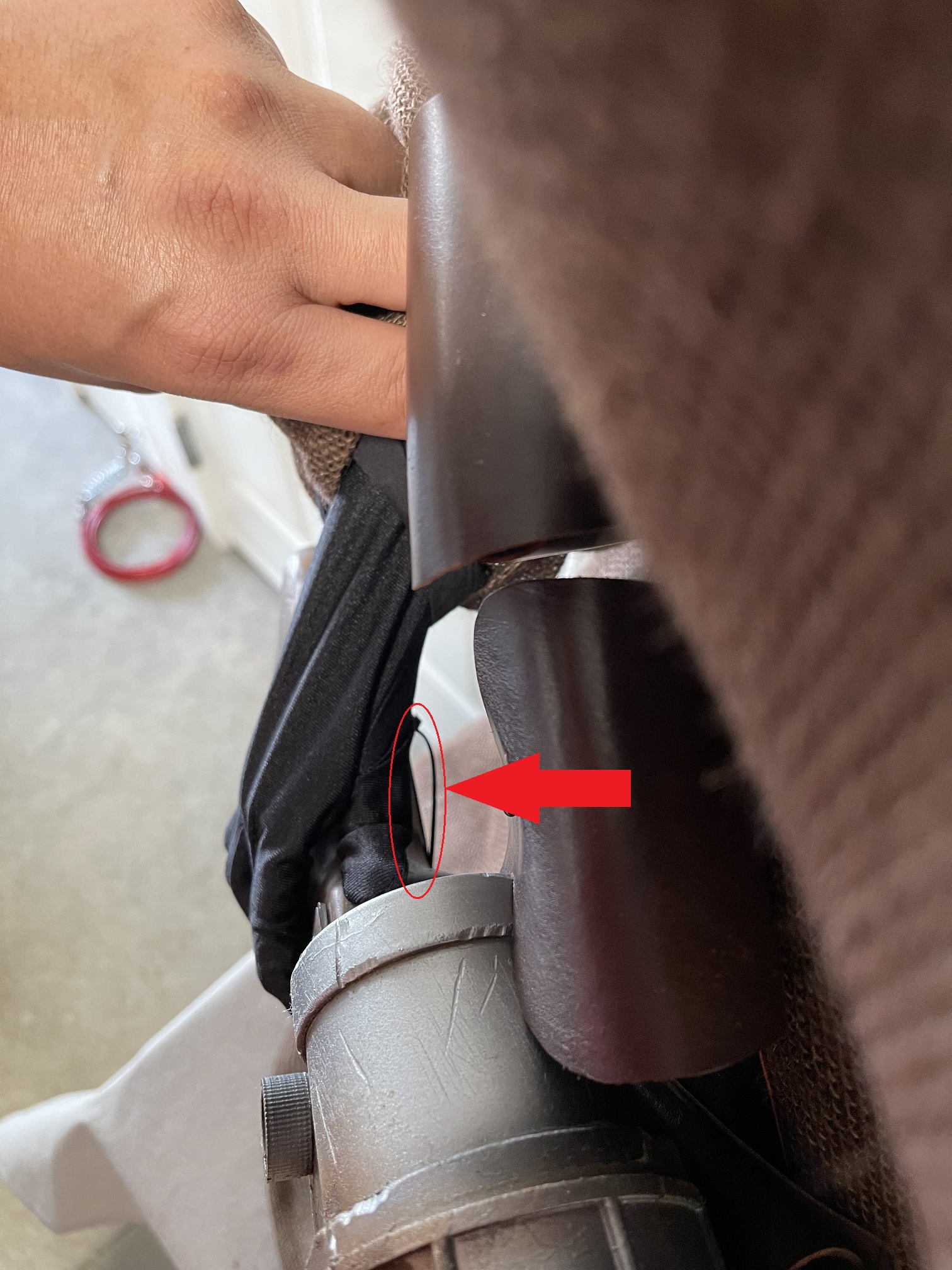

I also had to tie wrap the middle finger to the palm of the wooden hand in order to hold the Ion Rifle, but as you can see from the pics it is NOT noticeable. In fact,you have to get lower than the Jawa to just barely see it or lift the Jawa's sleeve up to see it.
You may have noticed that I still have to dress up my wooden foot that peeks out from the robe, I'll be doing that this week and then adding in some final weathering, mists of black and some fraying on the ends of the sleeve. But I'm getting closer!

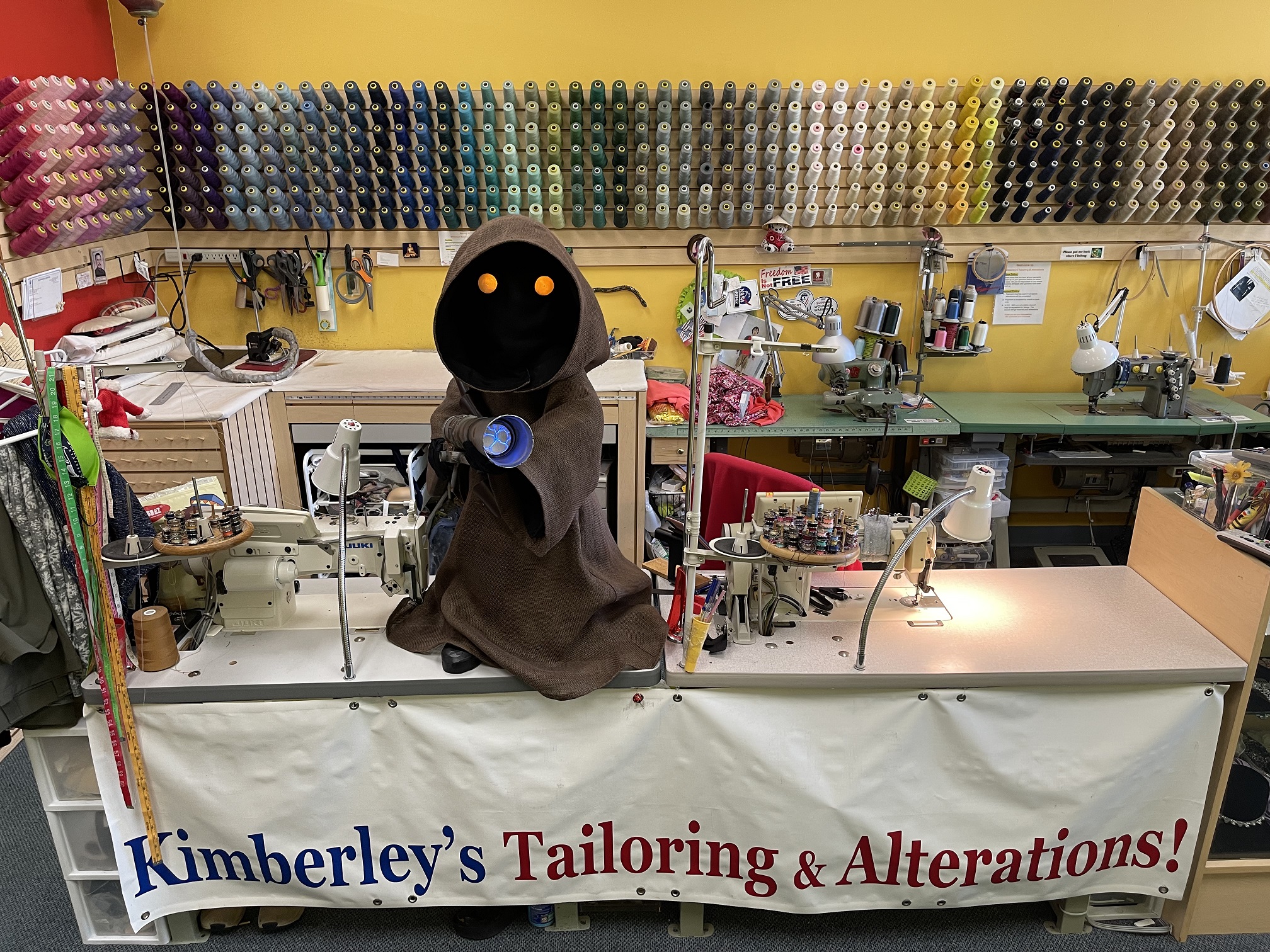

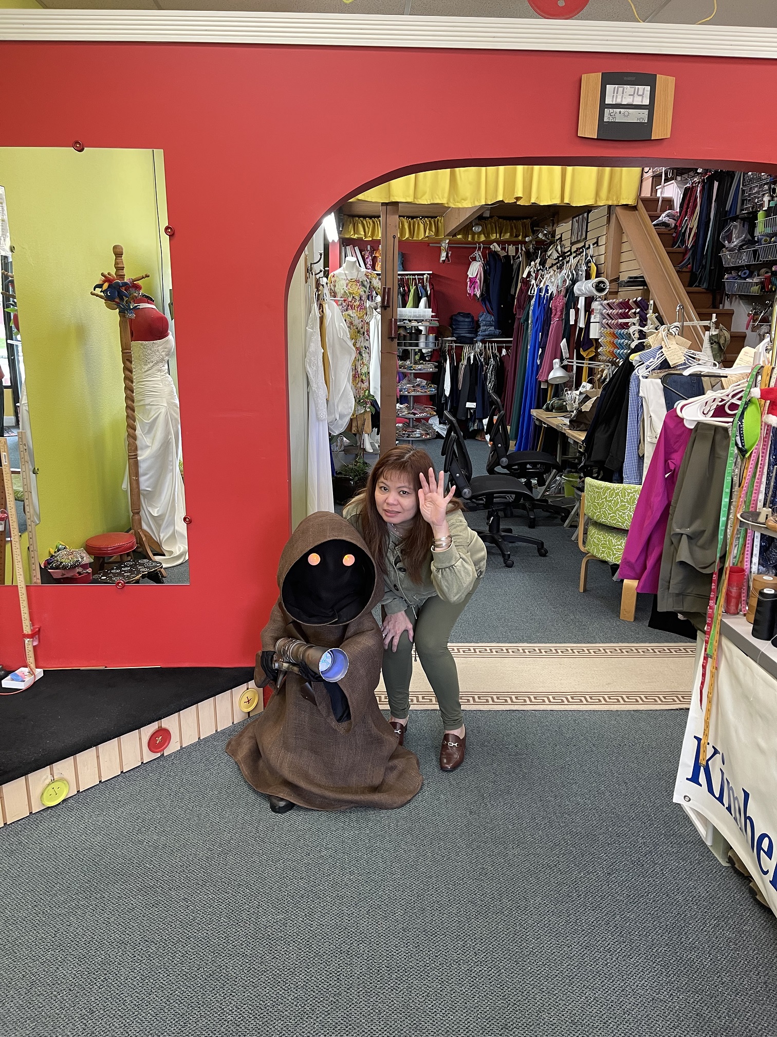

I went back in to the Alterations Shop today for some final Jawa adjustments. I took my entire Jawa in. Kimberly (that's her name) loved it. I guess something about seeing something like that up close and personal. Pictures I guess don't really do it justice.
I'll be putting on the strips of burlap on the Jawa's boot today and start the weathering process.
