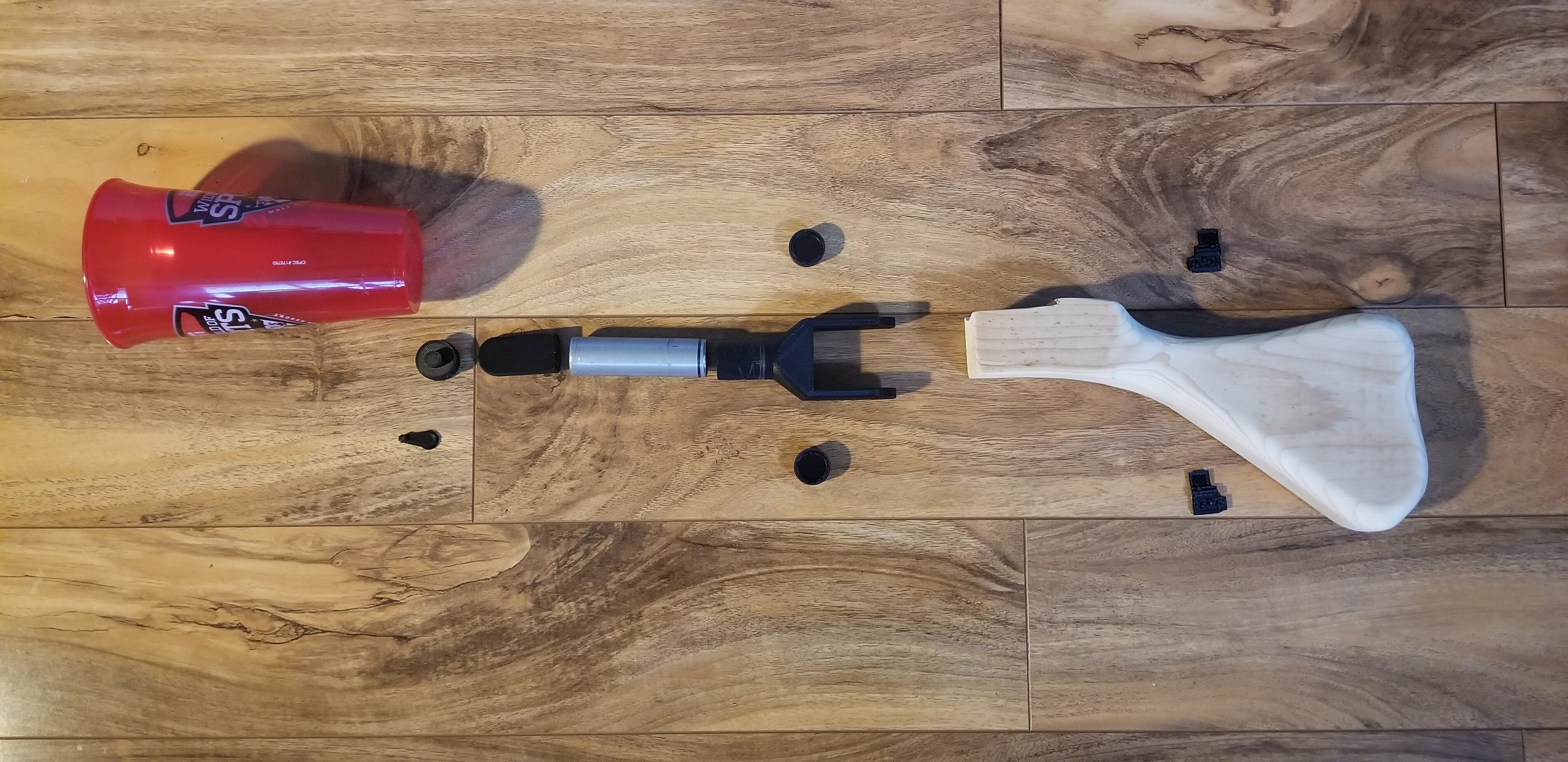

Which was made from these parts and all held together with Hot Glue.....
(Picture Credit to Lazerjock )

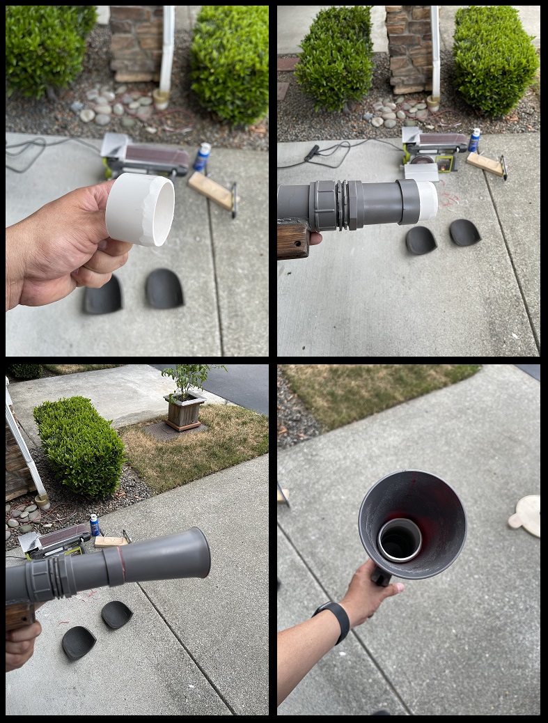

You may have noticed but the barrel also came unglued, so I had to find a creative way to get it back on there and if you know me I like to improve on designs and took it upon myself to strengthen & reinforce it! Since I was using 2" PVC for my Jawa Mannequin, and seeing as how Lazerjock used 2" PVC pieces to create the Ion Rifle, I was able to cut off a small piece and sand a little of it off so the barrel could be reattached! Using super glue, it'll probably be awhile before this comes unglued again. ;) Also, my little Ryobi Sander is just great! It makes such short work of things.
I'm not too worried about the PVC Peeking from inside the barrel, because much like how Lazerjock had that little blue lightning effect. I got the same thing, which hides that PVC Piece! (y)

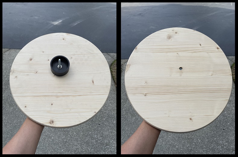

I started working on my Mannequin and began with the base. I started by mounting the end cap to the base via bolt. I also counter-sank the bolt so it wasn't so tipsy. ;)

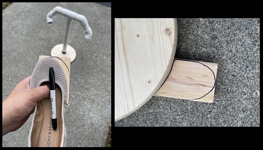

Then, using my wife's shoe (Size 6 - shes petite hehe!) I trace out a portion of the toe onto my scrap block of 2 x 4 and also trace out a circle from the wooden base.....

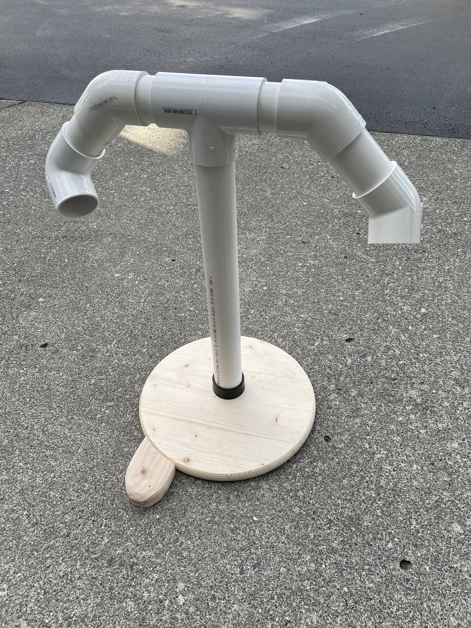

I then proceeded to build my mannequin, cutting various sizes of 2" PVC Pipe and putting it all together. In addition, I also used my handy dandy Ryobi sander and was able to form the wooden foot....
Now I just have to secure the foot to the base - but I have an idea for that!
I also made sure my height was right at 36" (3 feet).....
You can see the yardstick show it at 35" but with it being on the 1" base - well, there ya go! ;)

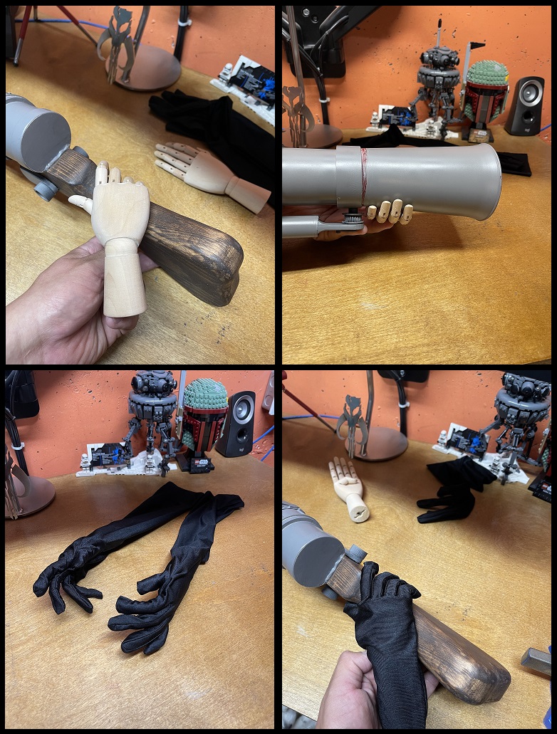

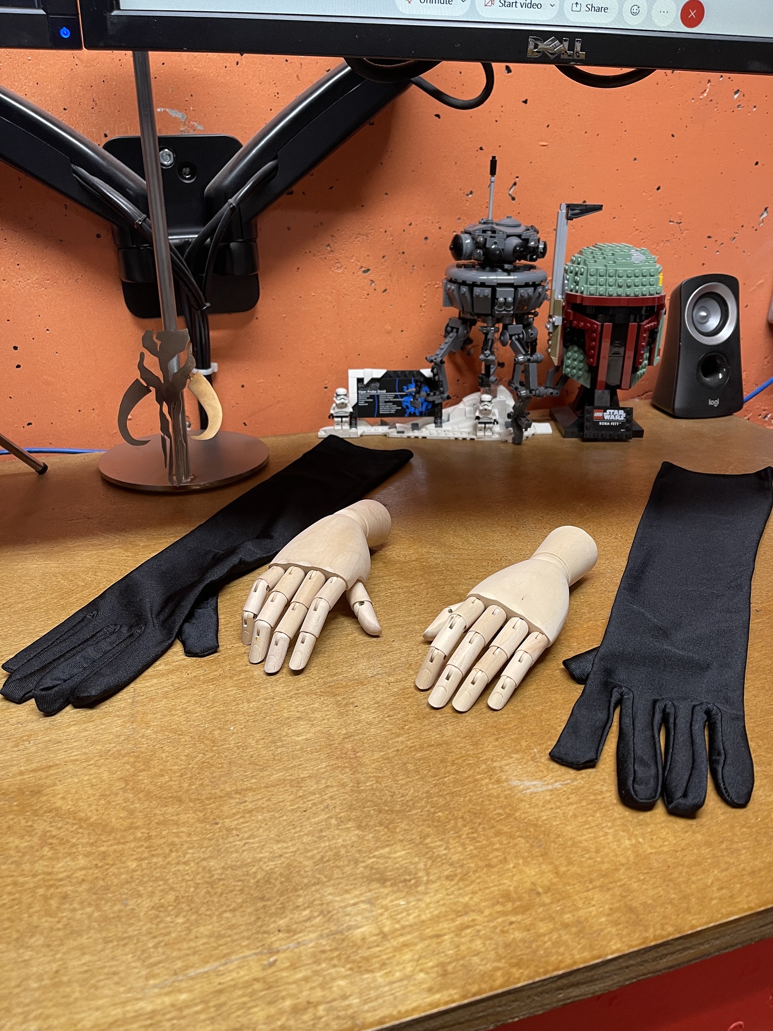

I've seen many options out there for how to do the hands. I've opt'd to go with a set of child/Jawa sized wooden hands that can articulate and be positioned. Please note, that these hands are stiff and could possibly hold the blaster by themselves. But knowing me, I'll probably reinforce it so the blaster doesn't slip and fall off. I also needed to get a pair of child/Jawa sized black gloves to fit the hands And both came this past weekend!
And how do the wooden hands look when grasping the Ion Rifle and the gloves fitted on the wooden hands?
I felt that the gloves properly fitted them and it look very good in the way the hands grasped the Ion Rifle. Now, how to get them attached to the Mannequin? For that, I decided to use 2" PVC End Caps with the Wooden Hands Attached directly to them via wood screws.....

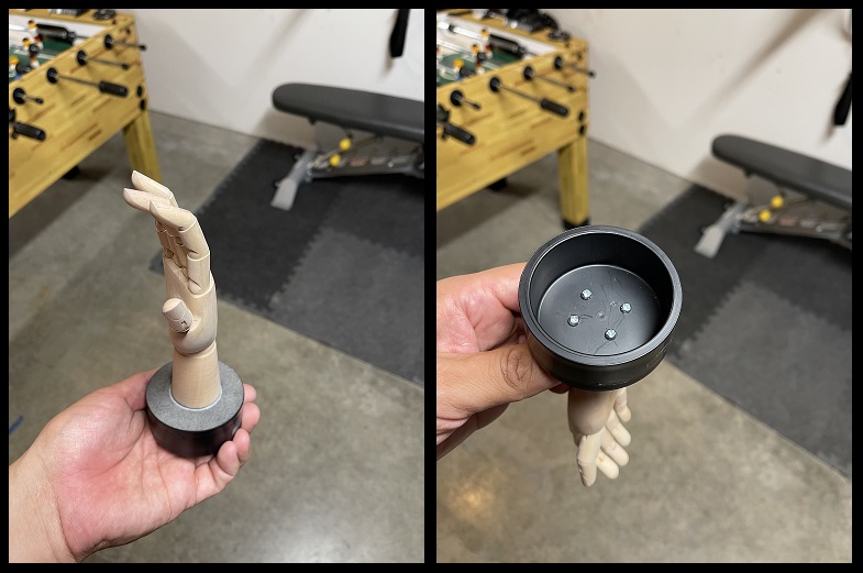

The base of the Wooden Hand is 1.5" in diameter. I tried to look for a PVC adapter locally that would go from 2" to 1.5" and couldn't find one. So I opt'd for the End Caps instead. My hope is that the robe will hang off just before the wrist which will hide the 2" PVC End Cap. If not, I may have to look for an alternate solution. Let me know what you guys think.
Cheers.
-Iron
Those are really small hands even for a child.
Eagar to see them holding the blaster on the Jawa.
Lazerjock
My wife is a Pre-School teacher and she teaches their "3's Class". On average, most 3 year old kids are about 35" to 38" in height (about the height of a Jawa). Yes, school is out but the Pre-School is doing summer camps! My wife forgot her lunch yesterday and I went out with her lunch and my Wooden hand and Yardstick. I found a boy that was about an inch taller than my yardstick! And his hands were the same size as the wooden hand! It was funny, those kids had never seen a wooden hand like that and were absolutely fascinated by it.
:D
Even though the Jawa's are NOT human (Humanoids) they were played by actual kids in ANH! I just wanted to make sure the ratio of the hands were in line with someone that would be about 36" tall. Because like you, I also felt like they were really small. But it seems like they'll do the job and look right.

Got a little further on the Jawa today. I turned the white PVC into black PVC, so as no white will show through the robes.
Here was the idea behind getting the wooden foot attached....
I had to get a little creative and carve a notch into the 2x4 for the bracket. (Also had to paint the bracket black)

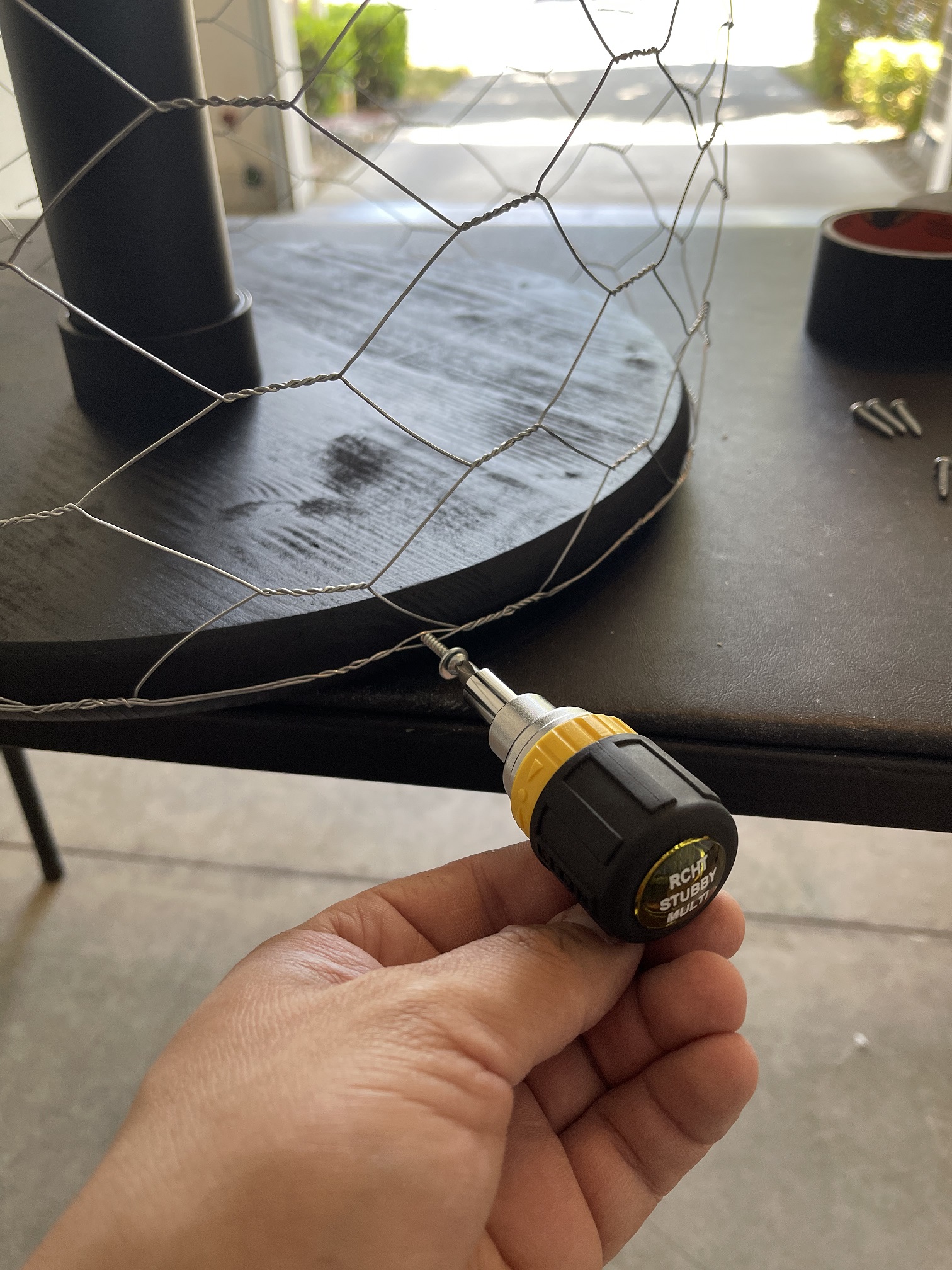

I also worked on getting the chicken wire fixed on the wood base. Which was pretty easy, just a washer and a wood screw that went between the twisted wire. The chicken wire is so that when the robes fall over the Jawa that they have some shape to it. I just need to form it up a bit more

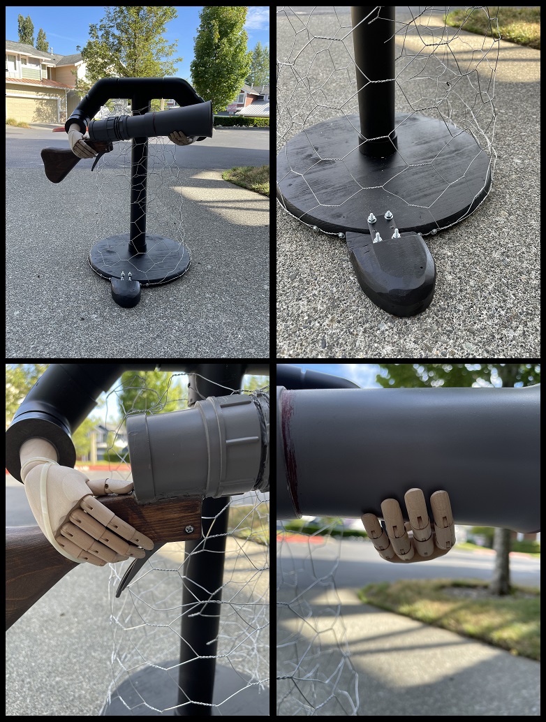

And here it all is so far! I have it pictured with the Ion Rifle a little too....

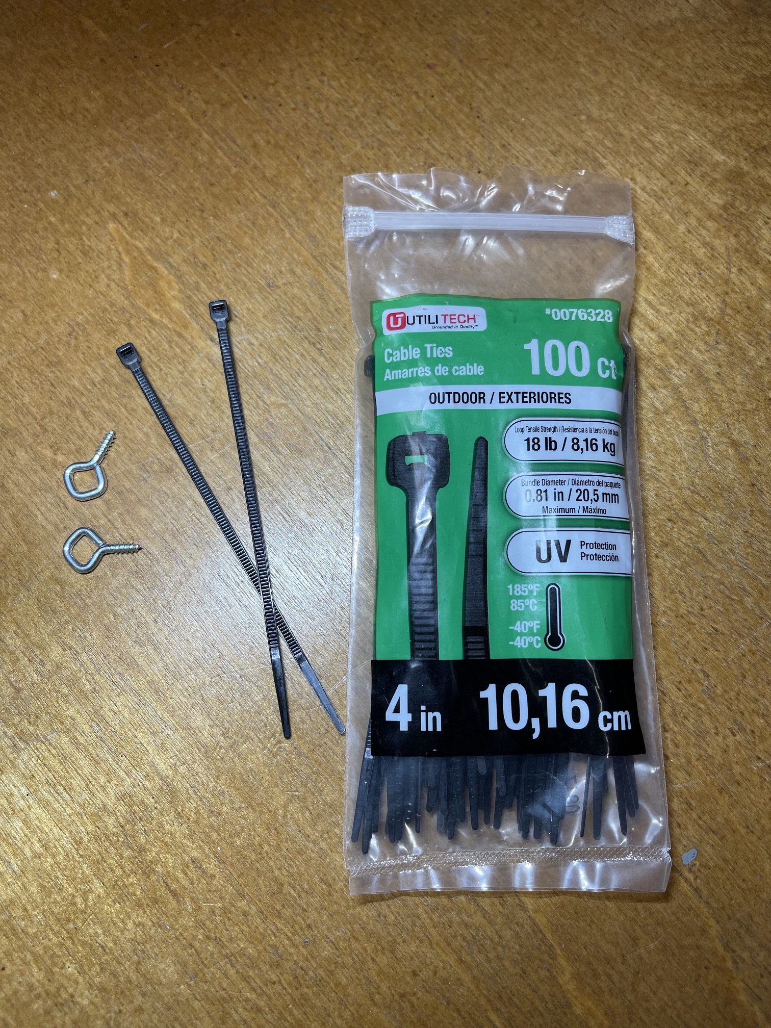

For the Ion Rifle I WILL have to come up with a solution, it is too heavy for the fingers to hold it in place - as you can see the tie wrap I have on it to secure it. The other hand that's underneath the barrel is fine. And the wrists are definitely strong enough to hold up the Ion Rifle. My idea is that since it is wood hands to use an eye hook and with smaller tie wraps get it locked in place. Maybe in the Ring Finger and Palm.
The other thought was maybe Velcro. I just don't wanna stick Velcro on the Ion Rifle.
-Iron

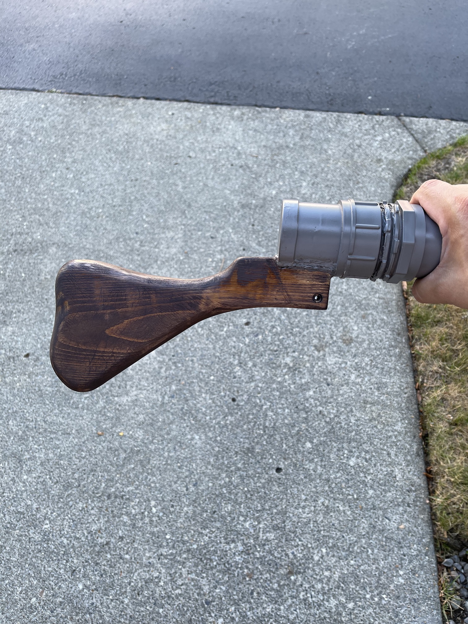

On mine I drilled 2 tiny holes in the back of the blaster at the balance point then fished stove pipe wire through and attach it to the chest of the Jawa. This way it is removable if I want to and the holes are so tiny no one will ever see them. I can also fill them if needed.

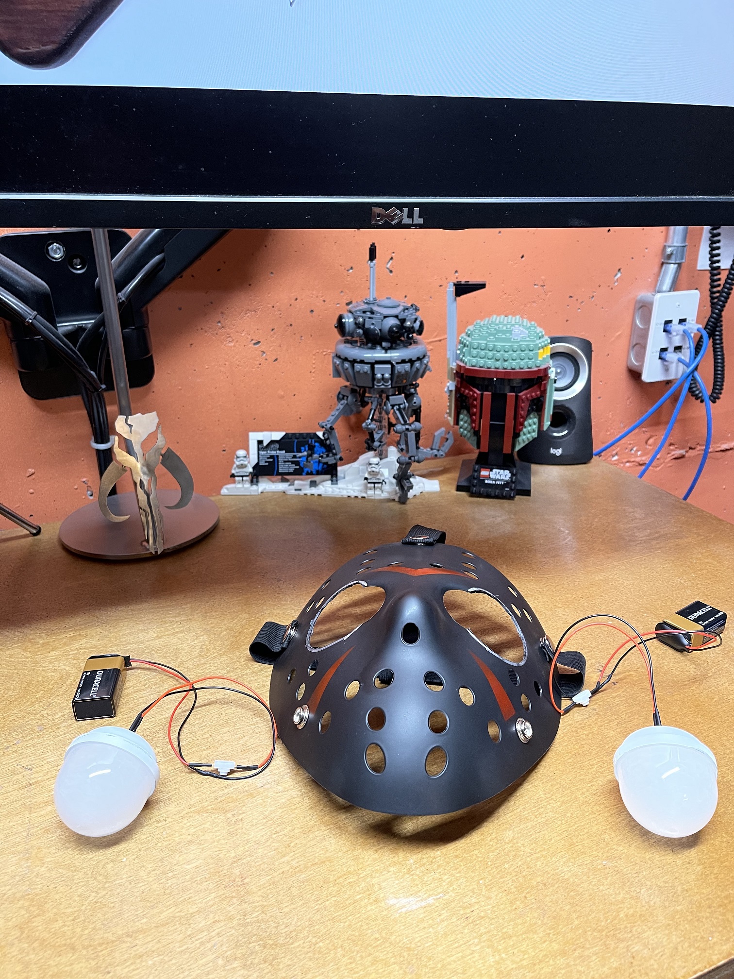

I also spent some time getting the Hockey Mask prepped to be made....

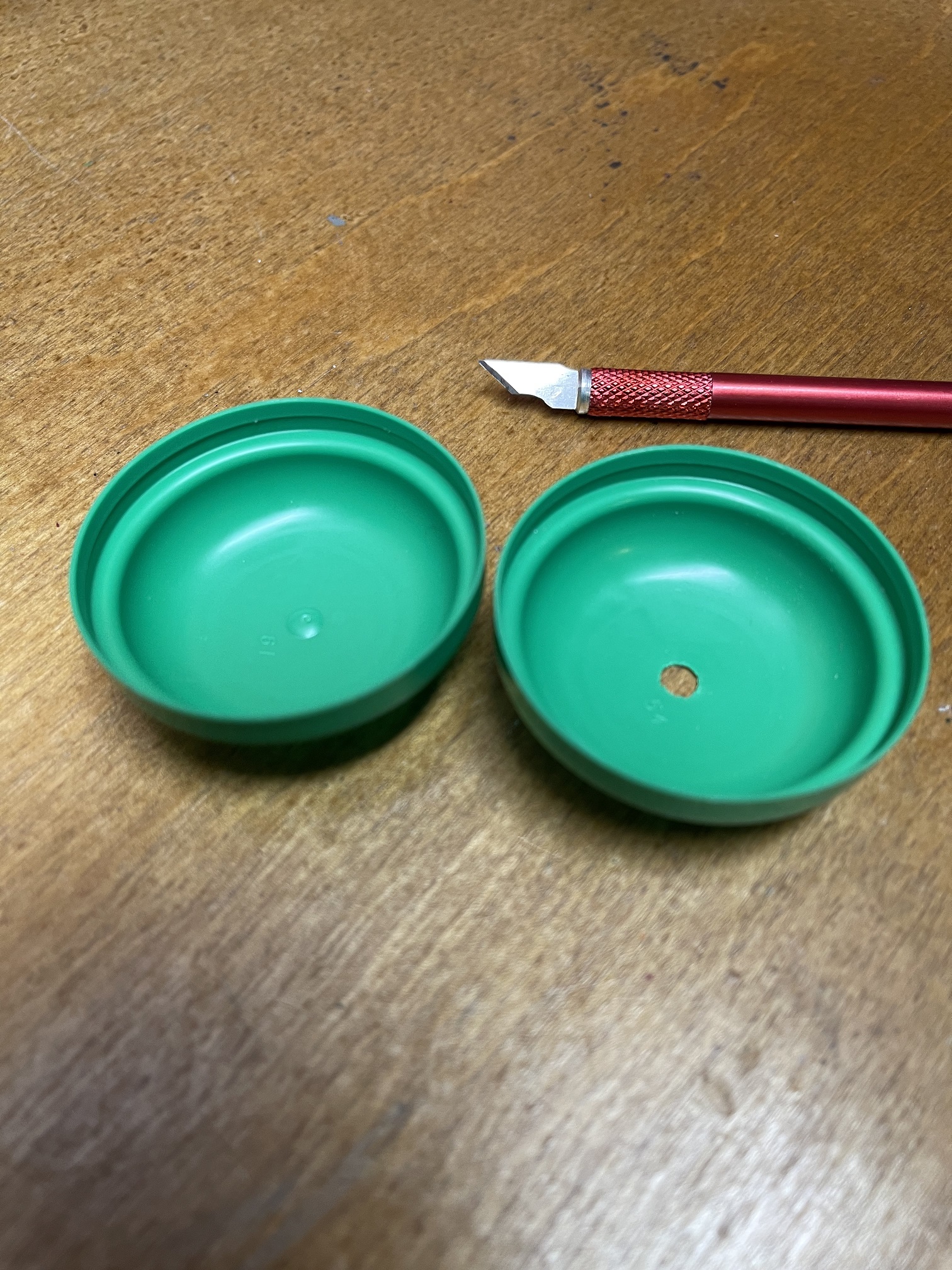

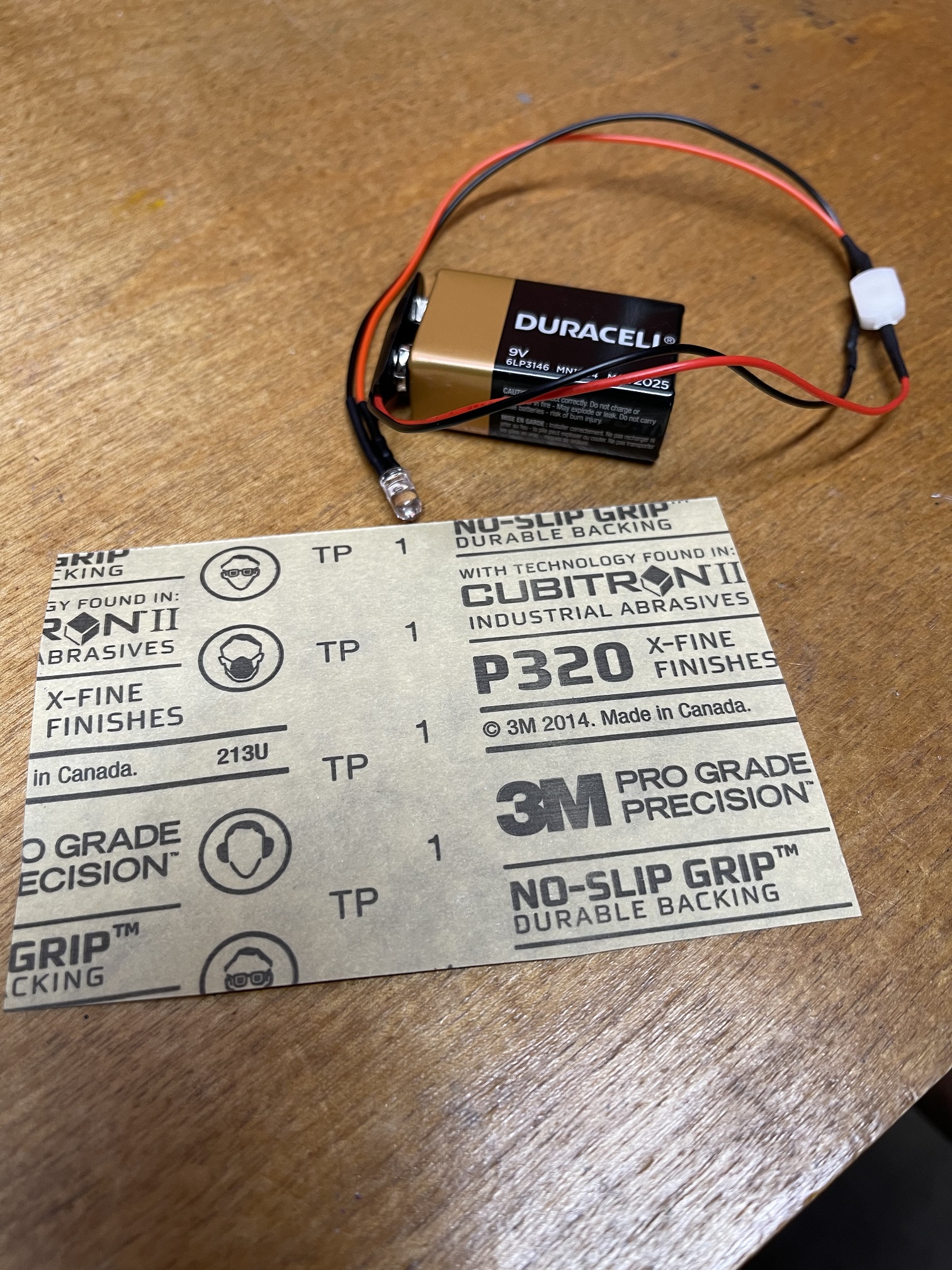

For the LED eyes a lot of people use empty gumball containers, using sand paper you scuff them out from the inside to give it that frosted-like appearance. I'm also using the Gumball Container Caps to hot glue the LED's in place. Thankfully the little bulby thing from the inside of the cap was a good, in that I didn't have to measure where the center would be and make my cut....I simply cut it out.
After I cut it out I also painted the inside of the cap white in the hopes that the LED will reflect off of it and shine brighter.
Speaking of shining brighter, the LED's I have when turned on in a dark room seem to have a very hot center.....
I was able to remedy this issue but lightly sanding with some 320 grit sand paper the bulb of the LED....
Note, sand just the top and a little on the top's sides, till you find that happy medium.

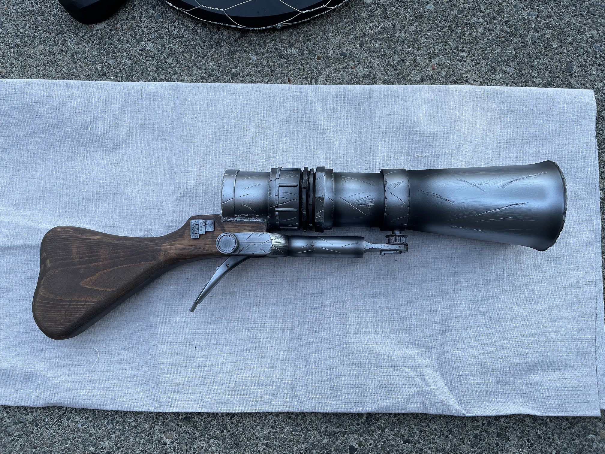

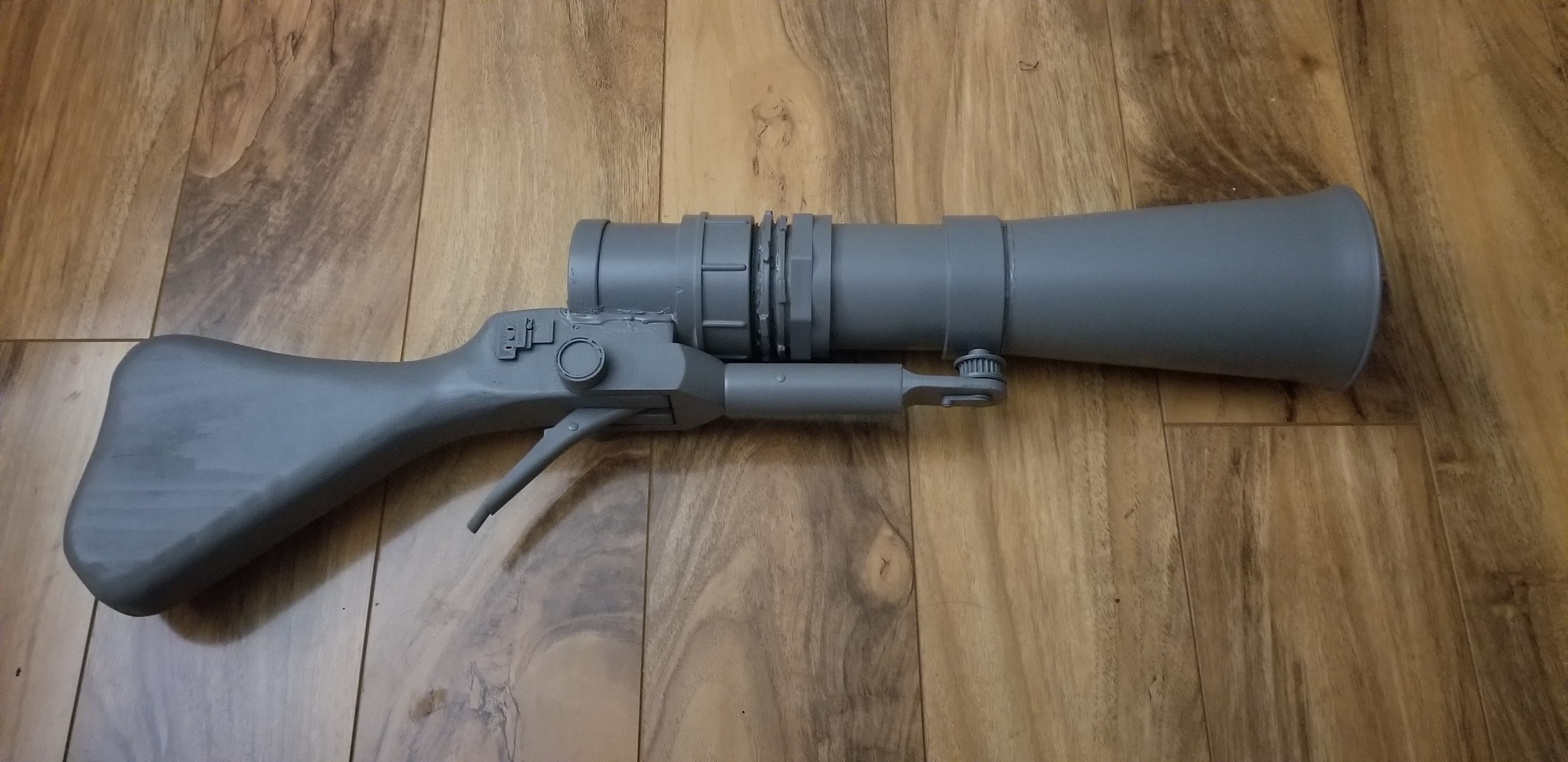

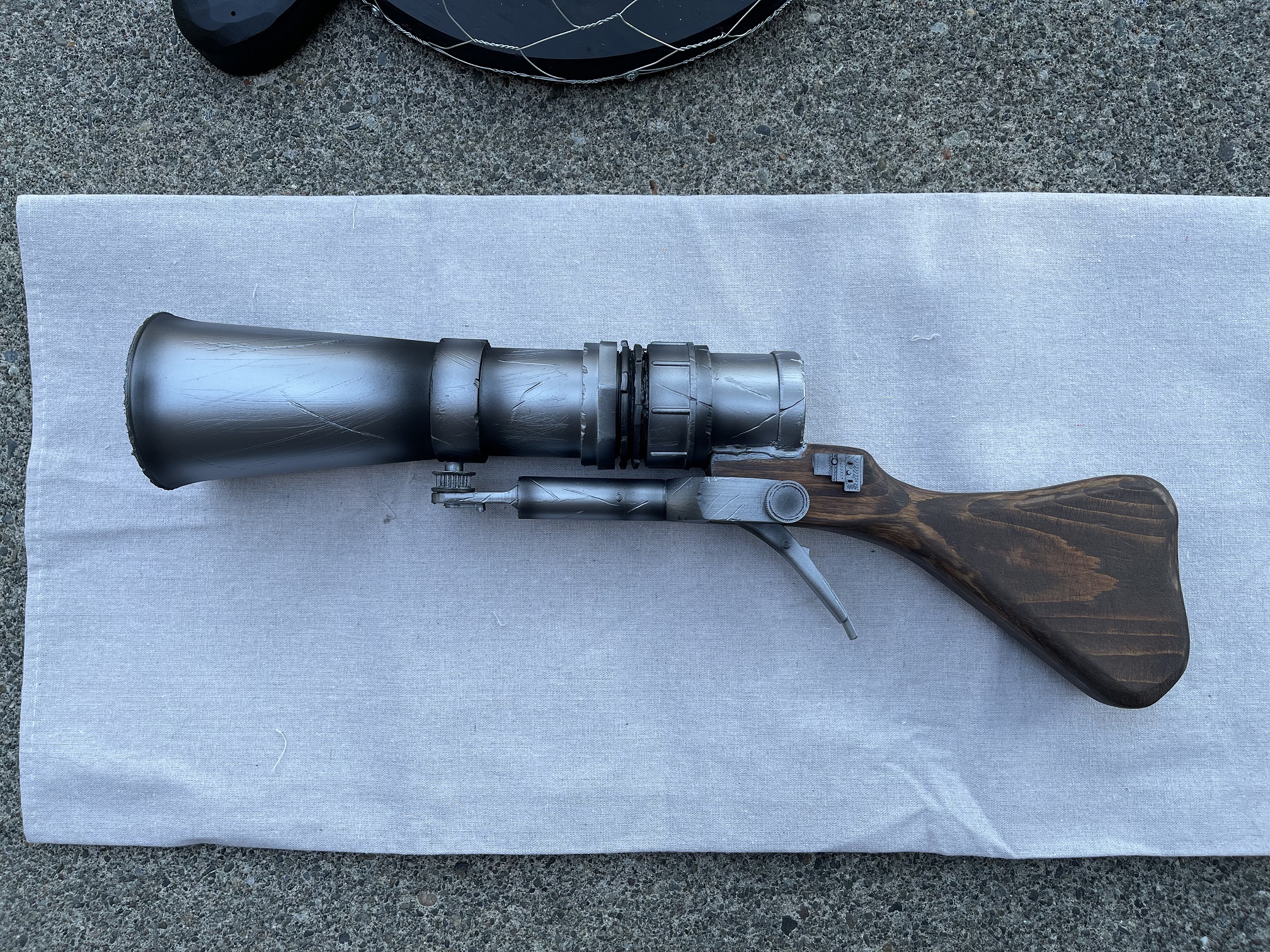

In addition, I also got a little bit further with the Jawa's Ion Rifle, I was able to paint it up with some Vallejo "Natural Steel" (70.864) and then using some Vallejo "Black" (70.950) for soot/burn effect. I wanna attempt little spots of rust as well, but I'm super nervous about it, as I'm NOT good or confident at all with rusting effects using paints. So I found a little video on YouTube that I may take a stab at trying. The video I speak of is this....
He got some pretty good effect off of it, So I'm pretty stoked to give it a try, if successful, I'll be re-doing my ROTJ Fett EE-3 Blaster with it too!
But here is my rifle now......using a dremel I was able to give it some good scratching effect showcasing that this Jawa has been through some stuff.

It's really coming along. One thing I noticed...The gum ball acorn containers you chose seem to be too large.
All of the Jawas I troop with use the mini containers.
Other that that I think you nailed it!
