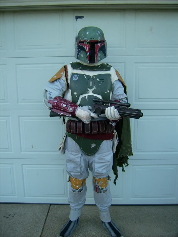

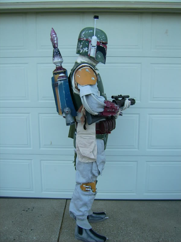

As promised here are some pics taken of me in my RoTJ Fett. Please note this was the very first time I wore the jet pack, it did slide around a bit on me, but I'll get that fixed. The weight was barely noticable using a TK409's type harness. The only thing I want to replace as of right now is the girth belt, it has shrunk too much.
Over a year later and around $4400 spent............
:eek::thumbsup::eek:
Dude, that costume is VERY impressive ... worth the wait and worth every penny if you ask me! I do hope you plan on going to Dragon Con as I would really like to see that costume in person. Regardless, I'm glad you took the time to post those pics!8)
