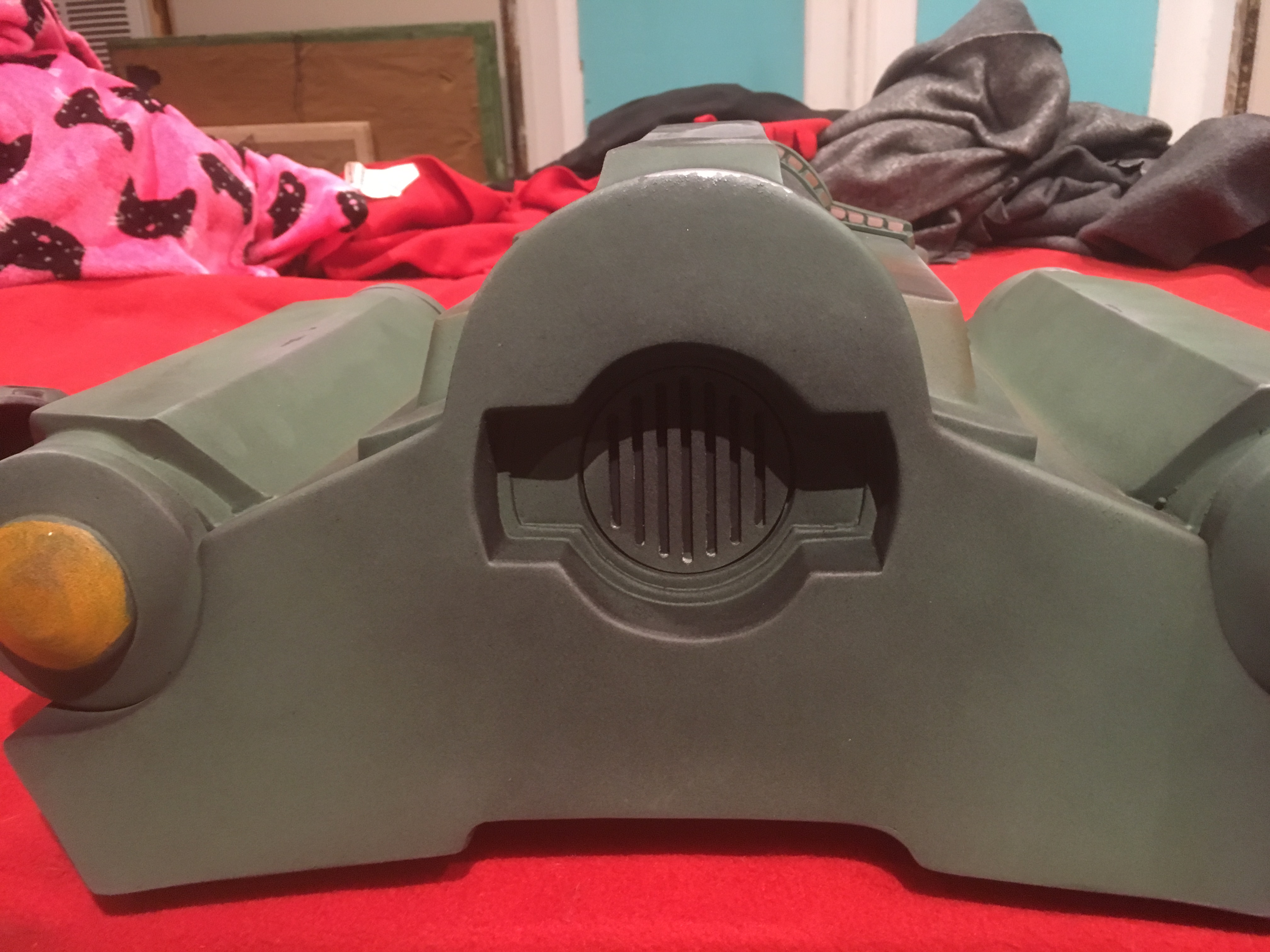

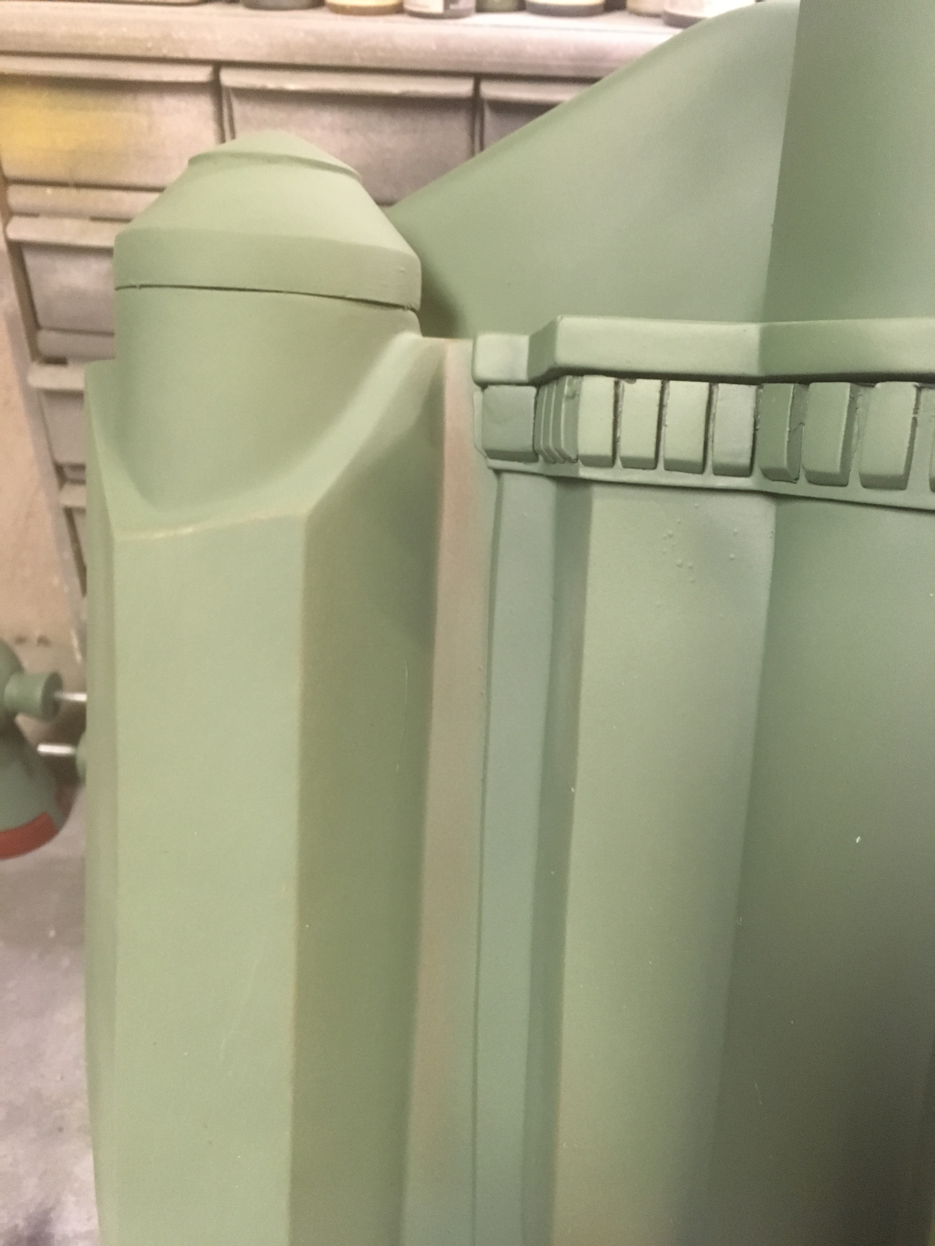

3- spray the body thruster and rocket parts with the rustoleum spruce green(this gets the bulk of the green down so you dont need 3 bottles of the MM paint to get good coverage)
4- (this may seem odd, but i always do this! lol) Immediately after you spray the spruce green put on a coat of the matt finish. (this helps tone down the sheen a bit and also speeds up the dry time.) Wait at least 4-5 hrs till fully dry.

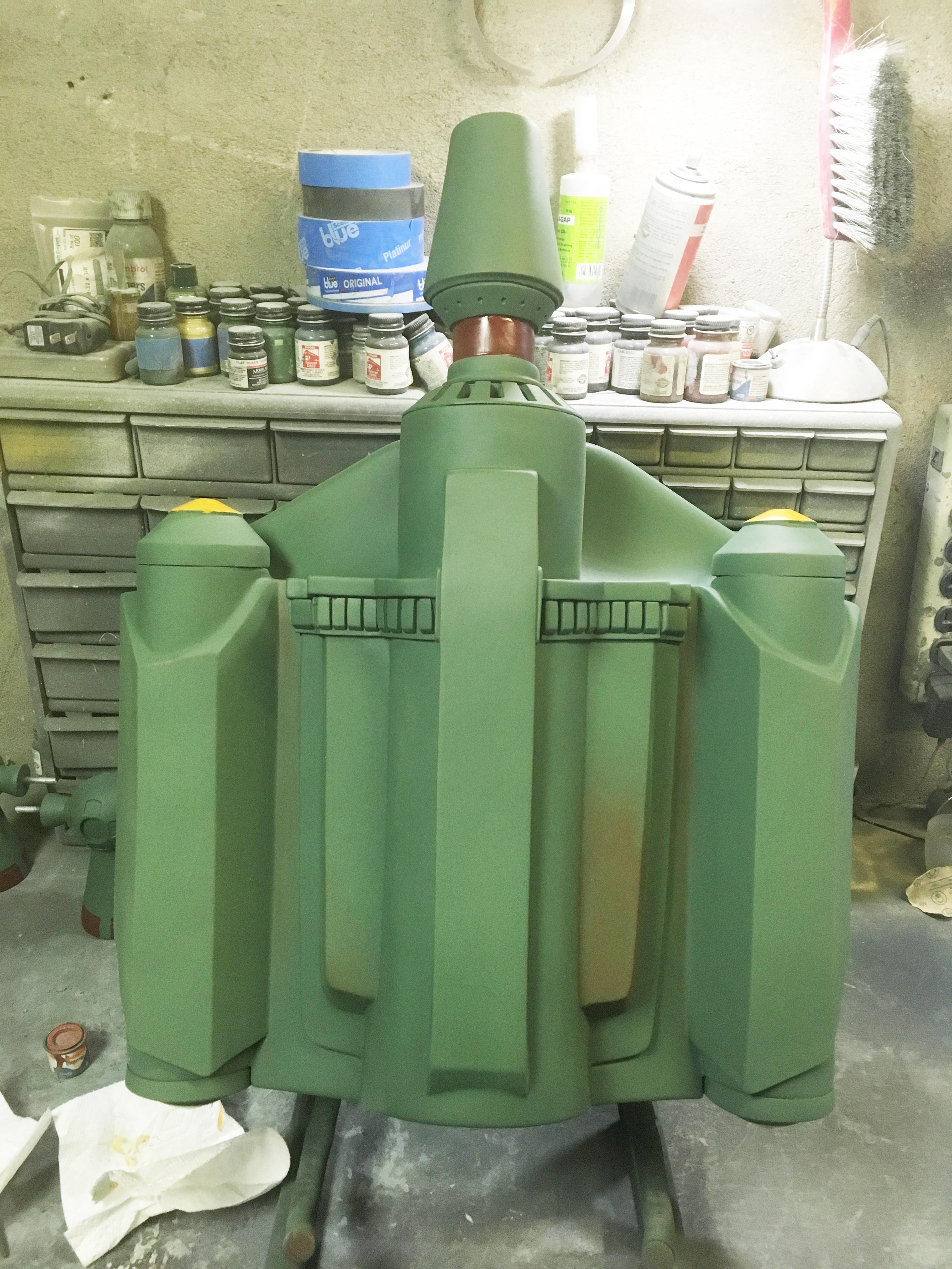

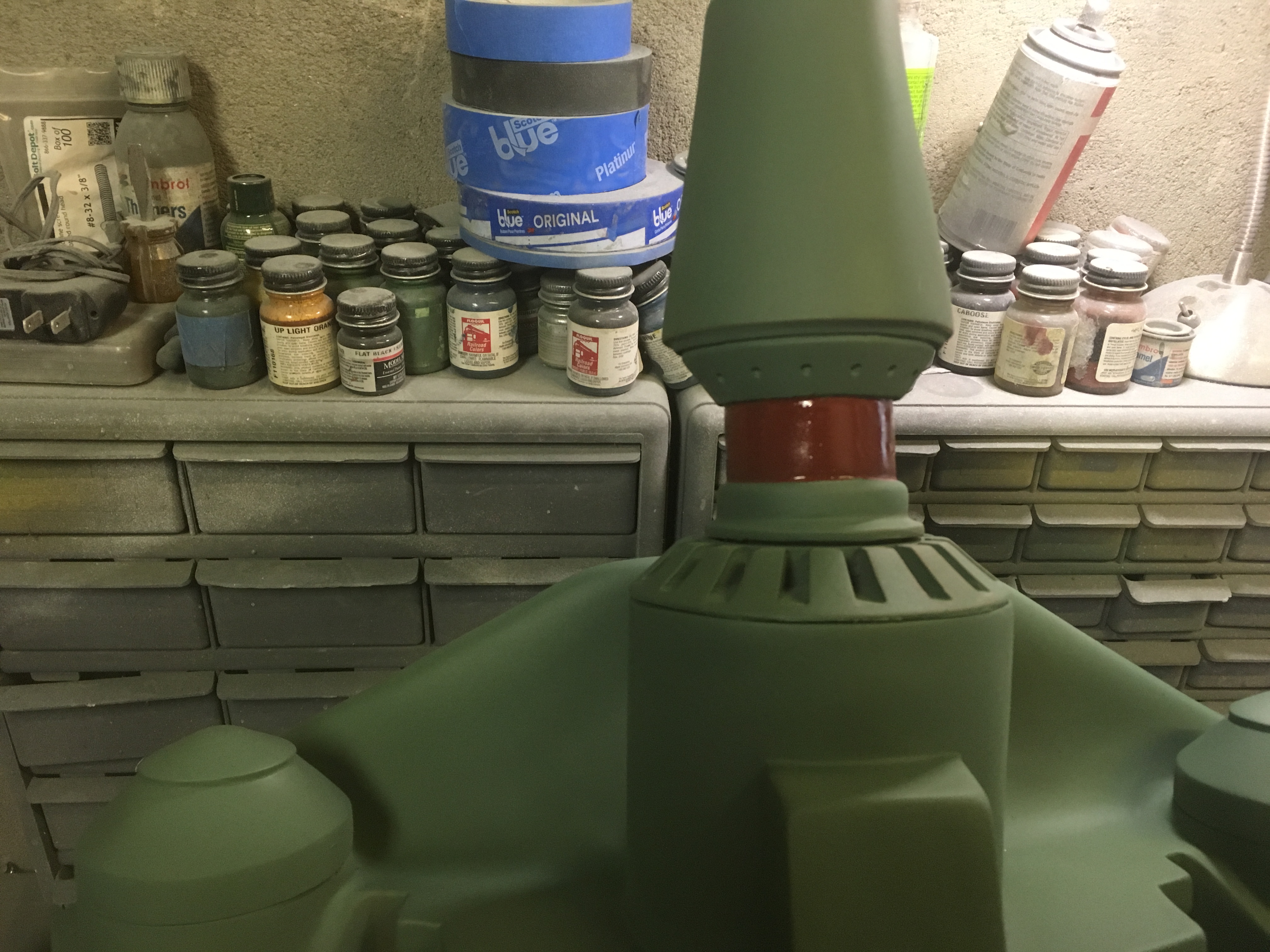

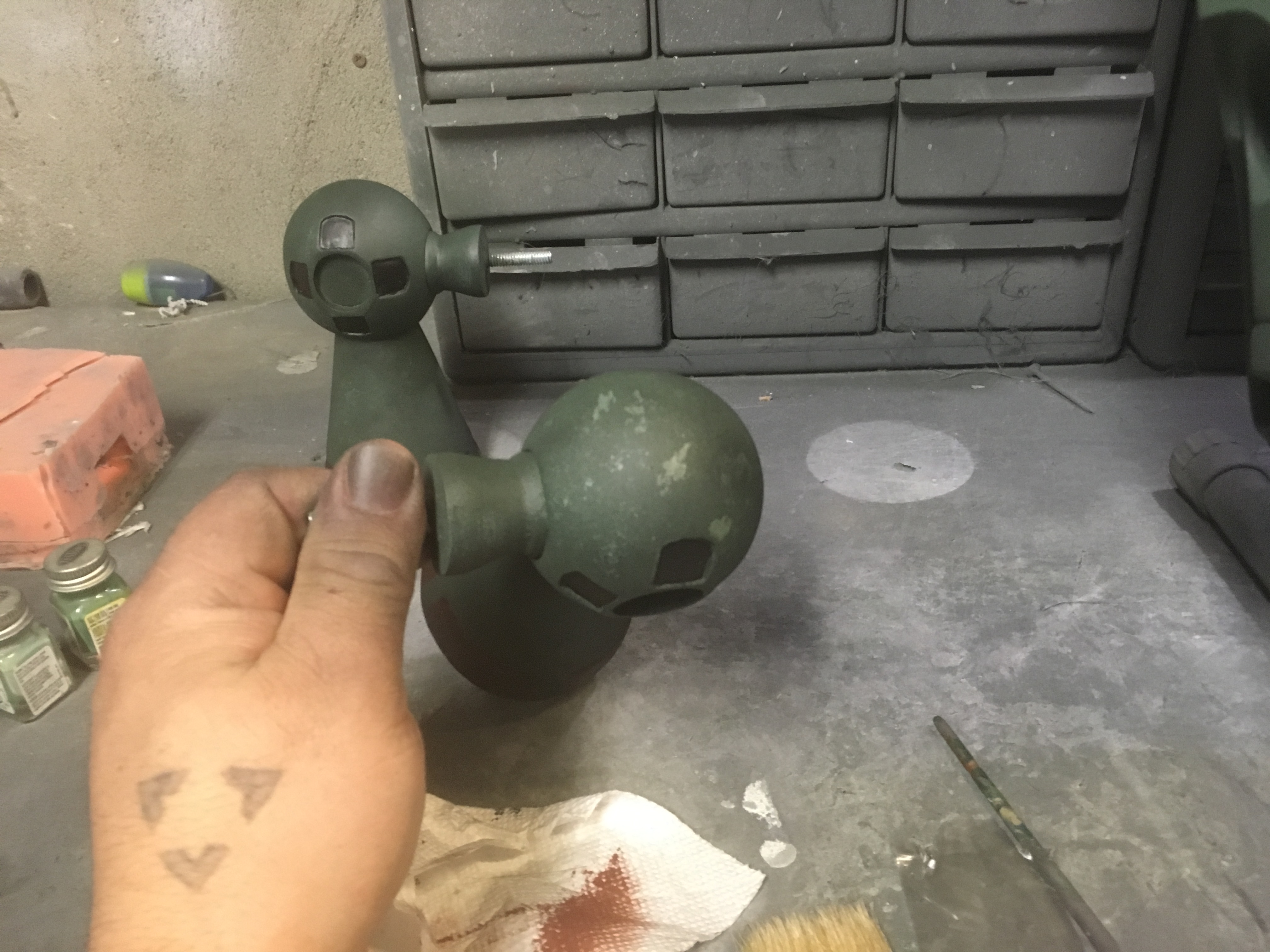

5- UPDATED MAY 2018- Airbrush 1 or 2 light coats of the MM Panzer Olive Grun mixed with the RLM76 and a little Humbrol 27 (grey) which is the final green tone. It will be lighter than whats pictured here as this is an update to the colors and more accurate. ihavnet nailed the ratios yet, but just mix em till you get something slightly darker to the reference s it will dry slightly lighter.

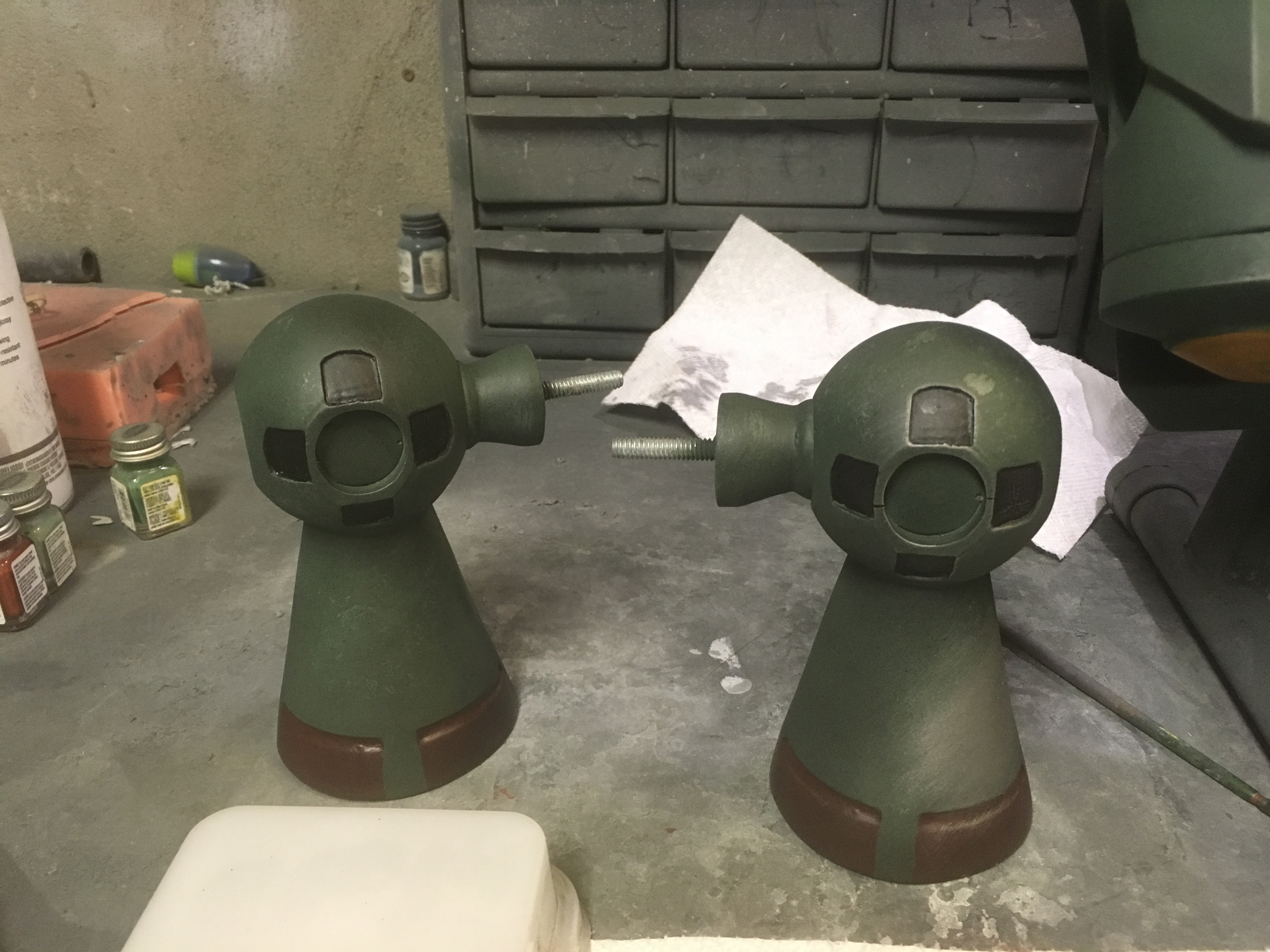

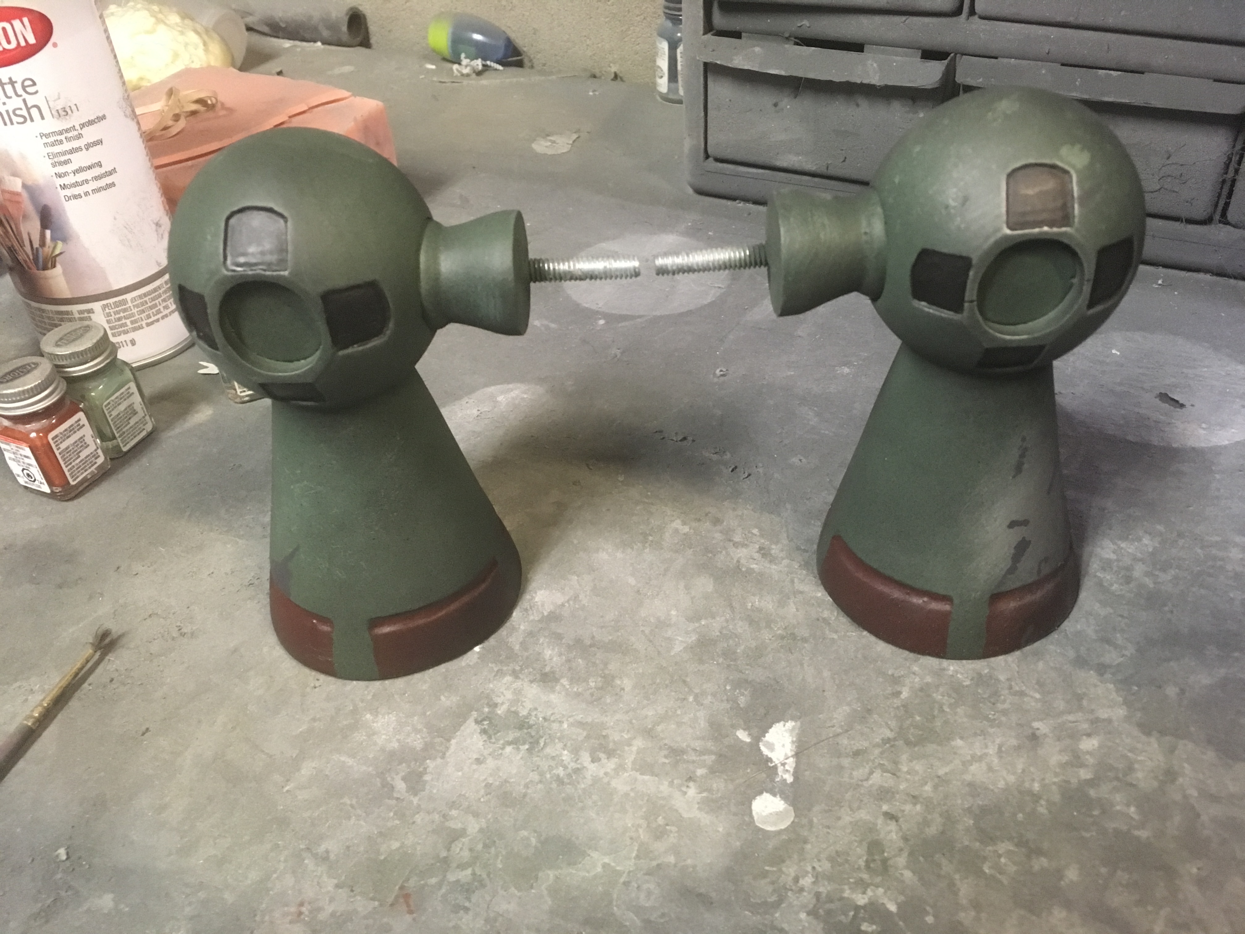

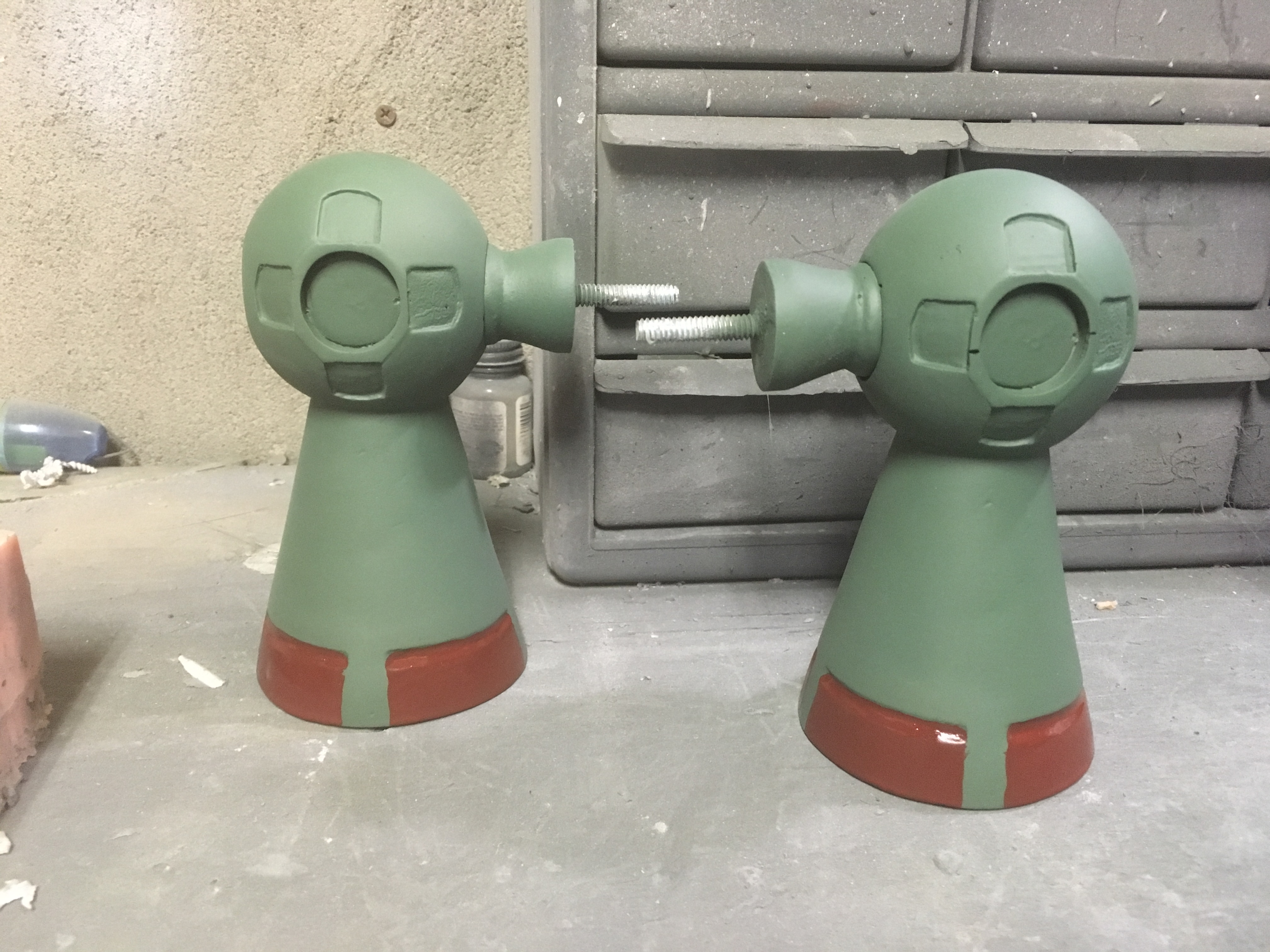

6- Mix some of the Humbrol 73 with a touch of the Humbrol 33 to obtain a dark burgundy/red color.

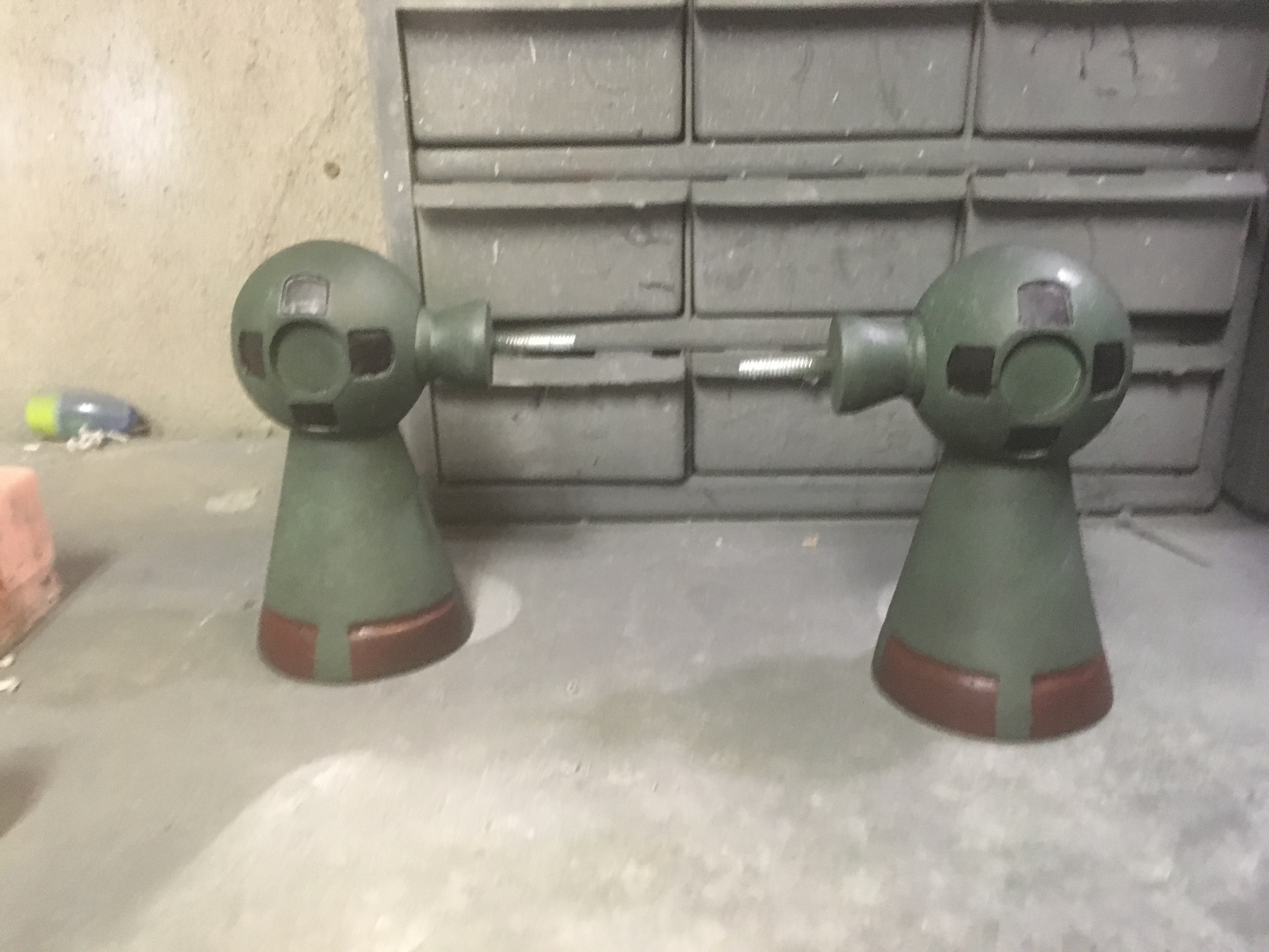

7 - Apply this color to the lower half of the rocket on the "stripe"and then on the slots and below them on the lower part of the thrusters.

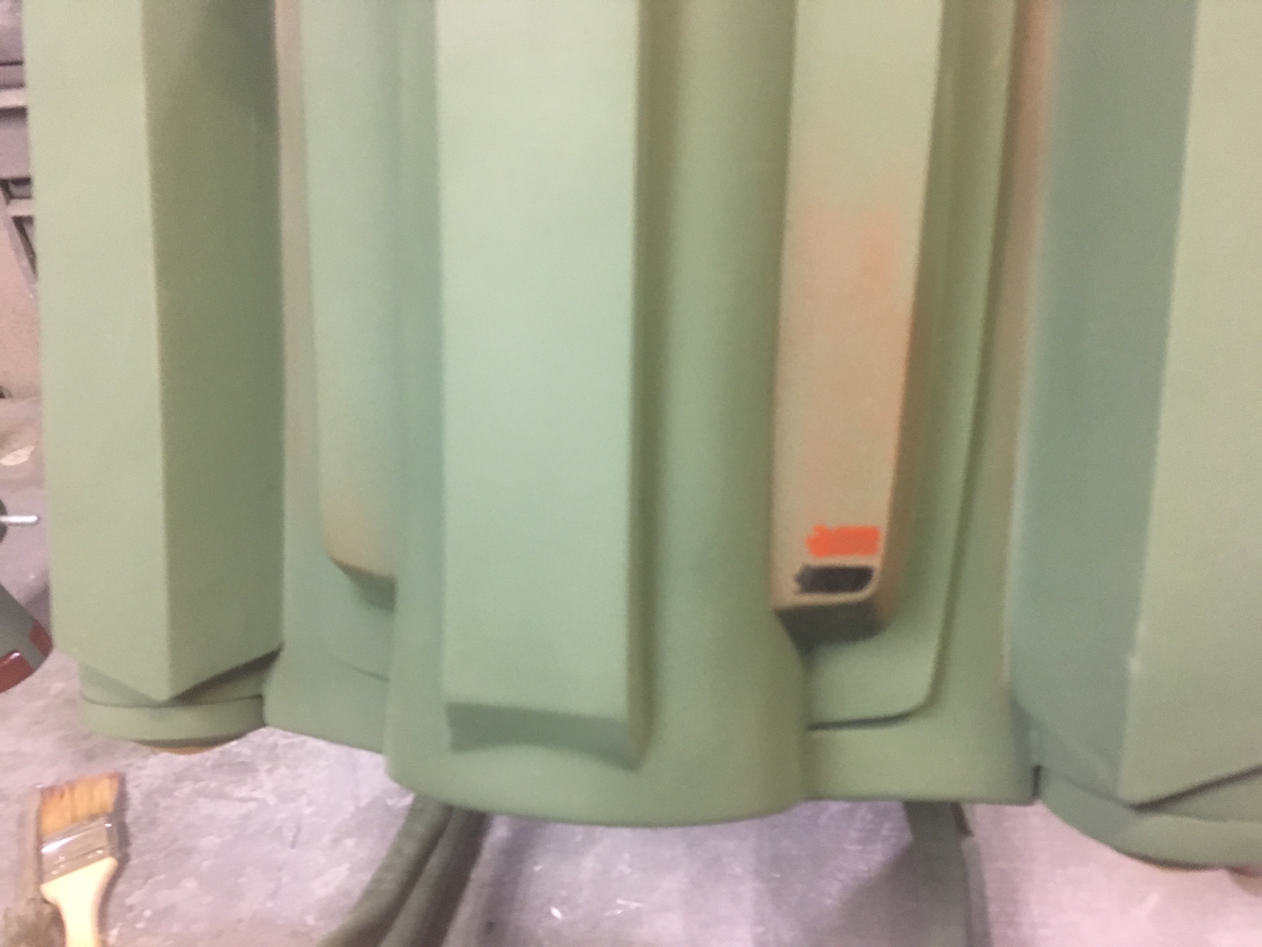

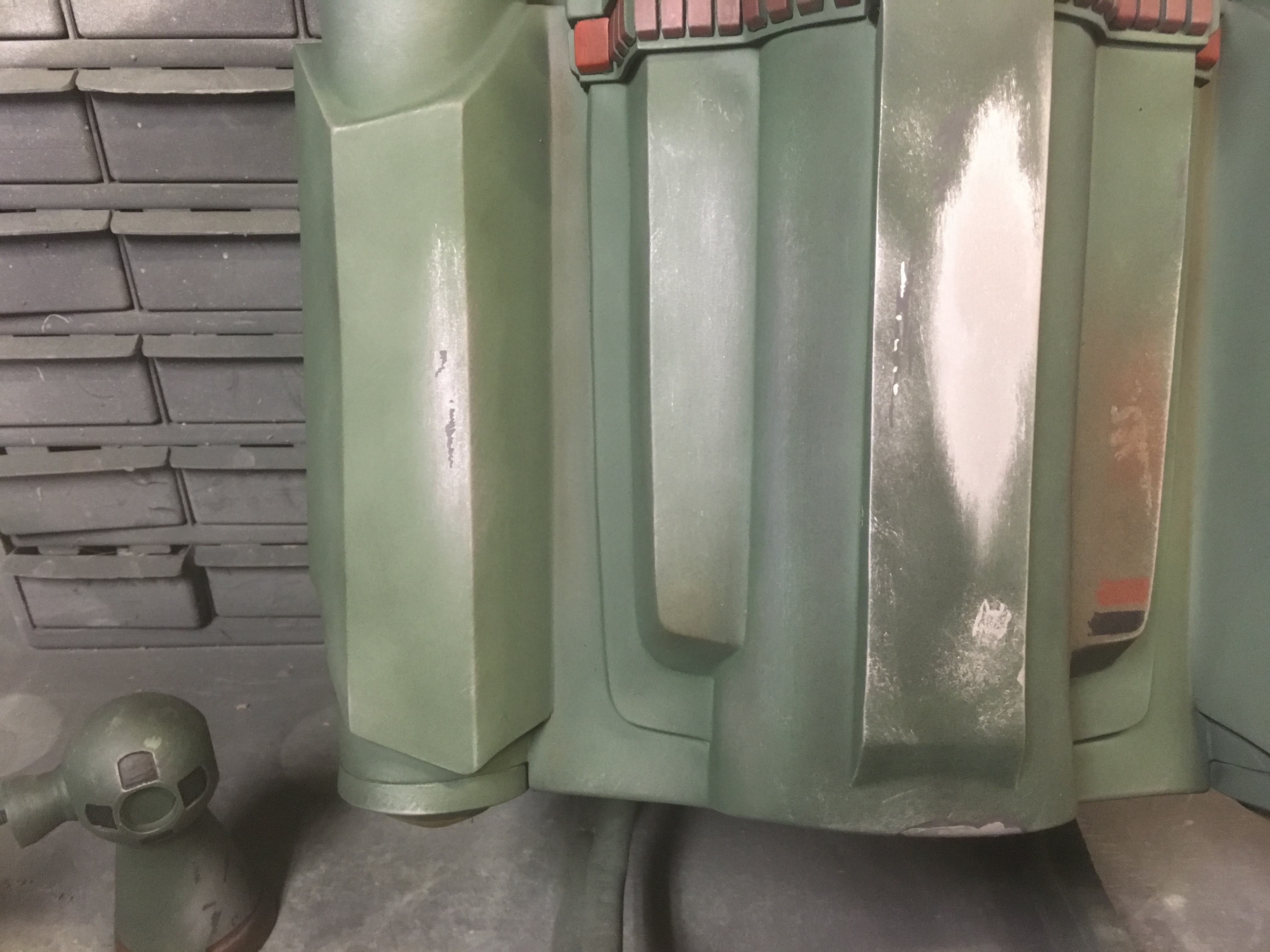

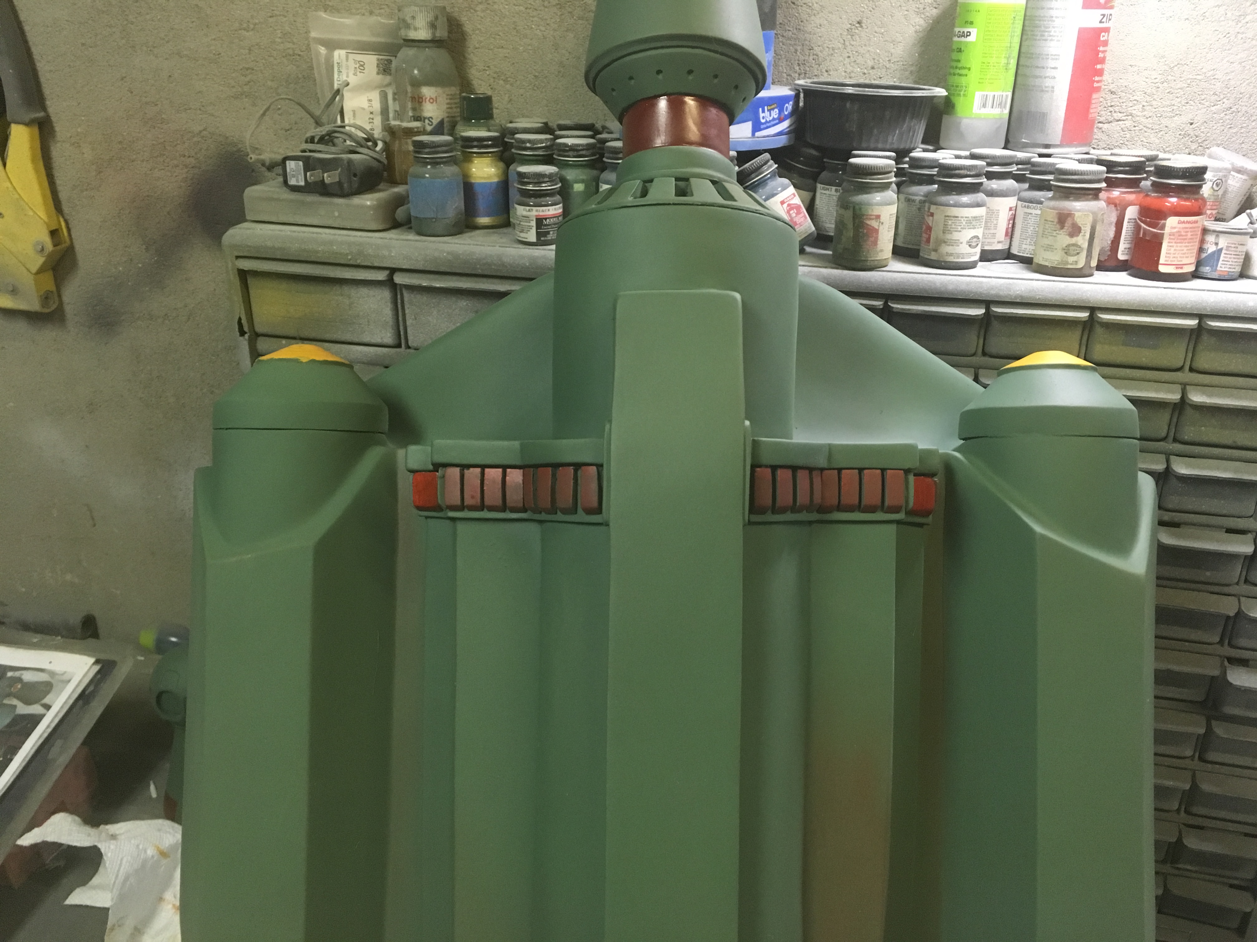

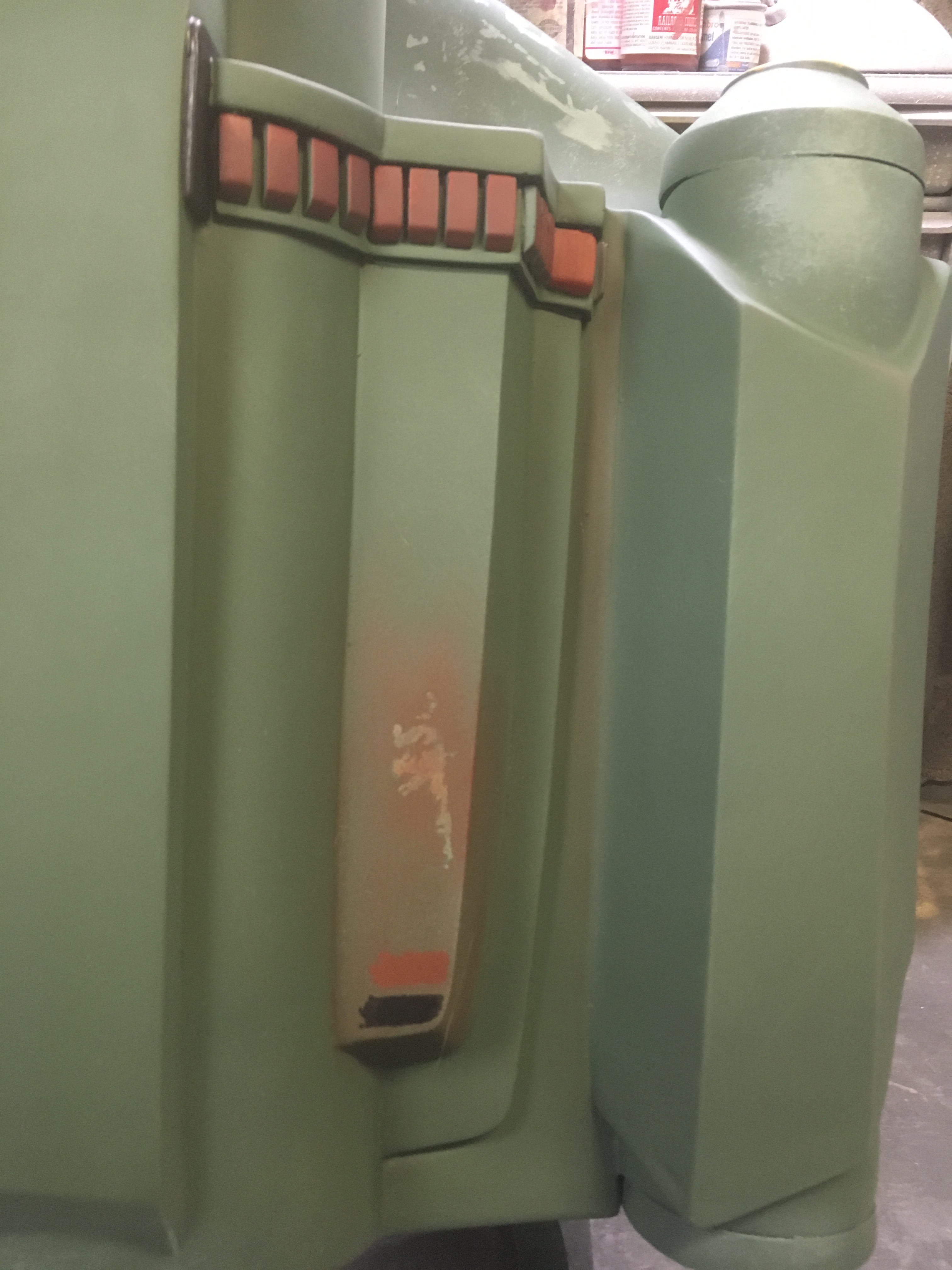

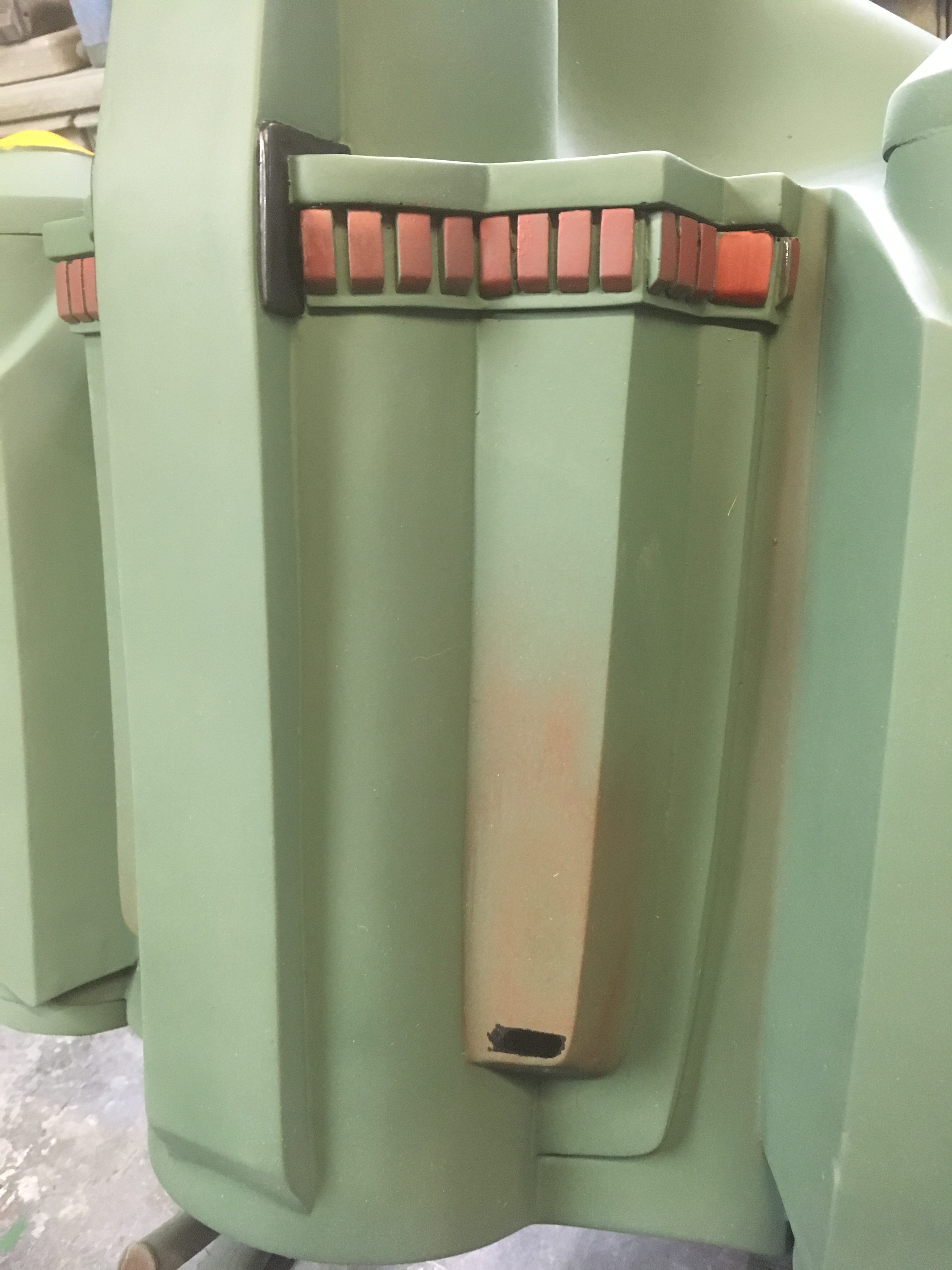

8- Put a little of the Rust paint on a plastic or paper dish dab the chip brush in it then brush it on a paper towel a few times and dry brush the lower part of the rectangle section to the right(as your looking at it) of the center cylinder of the pack. Also brush it on both side on top between the fuel tanks and where the piano keys start.
You may need to put a touch of mineral spirits on the brush as well to get it to blend well. be sure you dab/brush it on the paper towel and test it first before going to the pack!

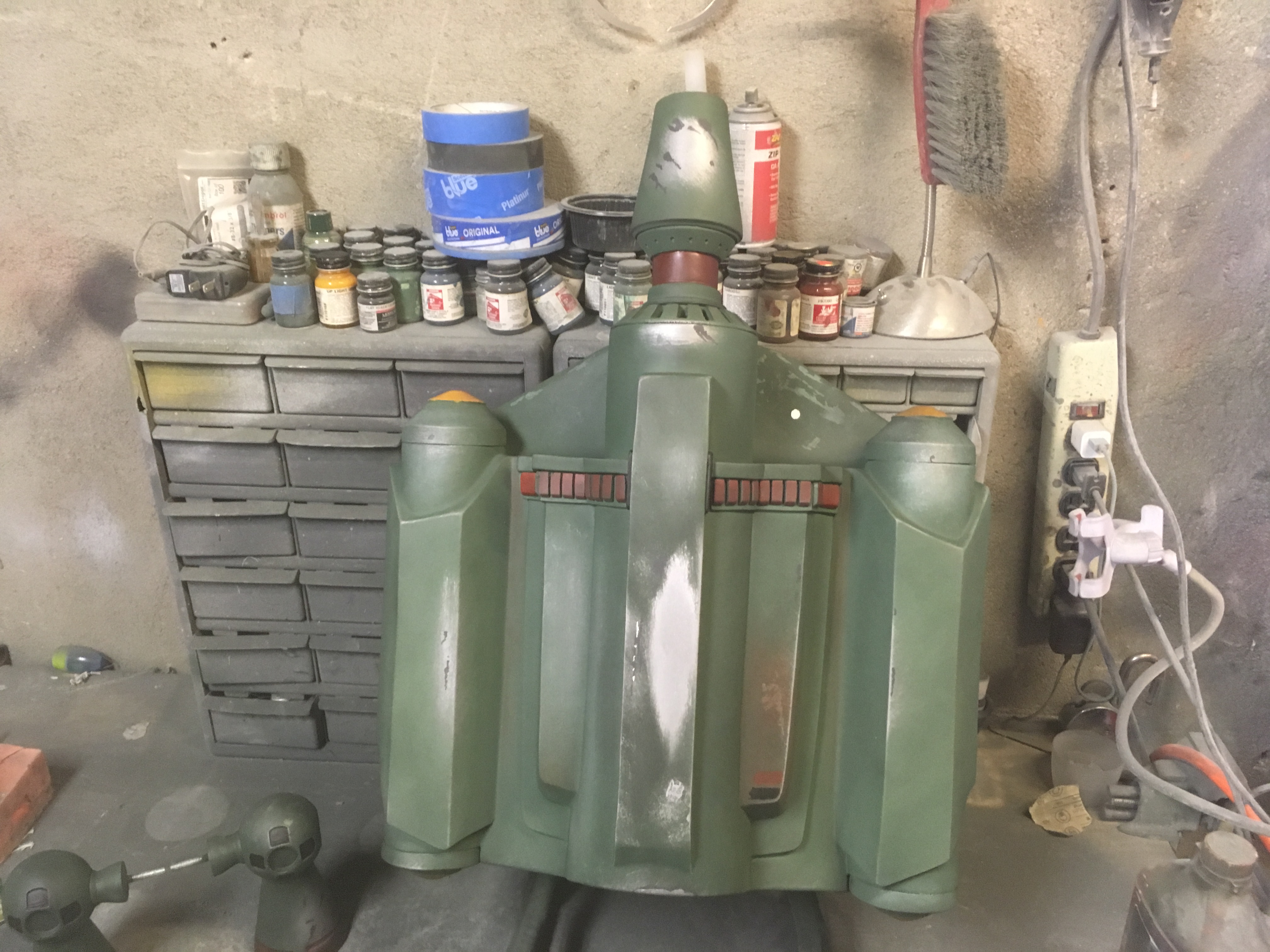

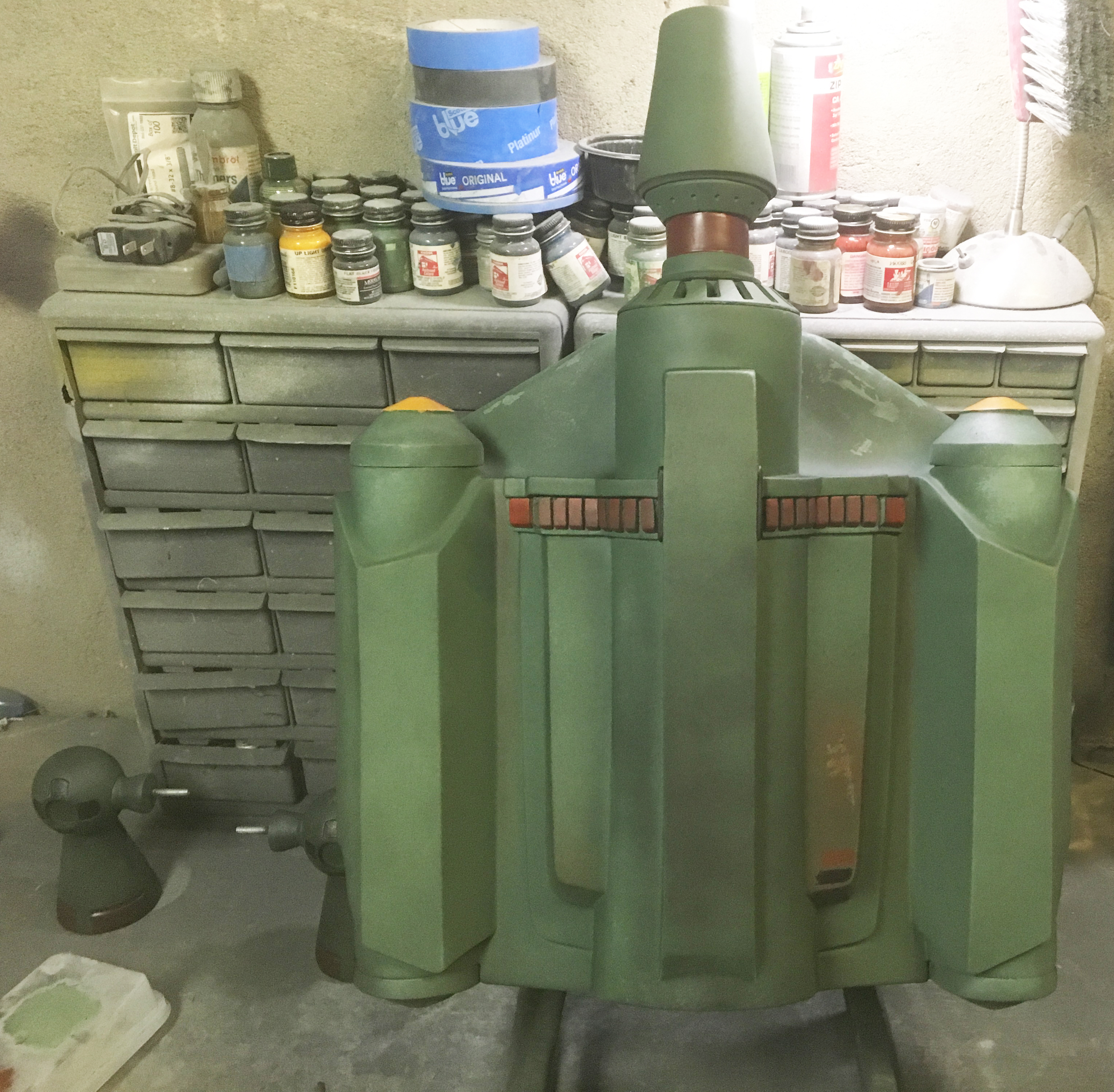

So..this is where we are now...

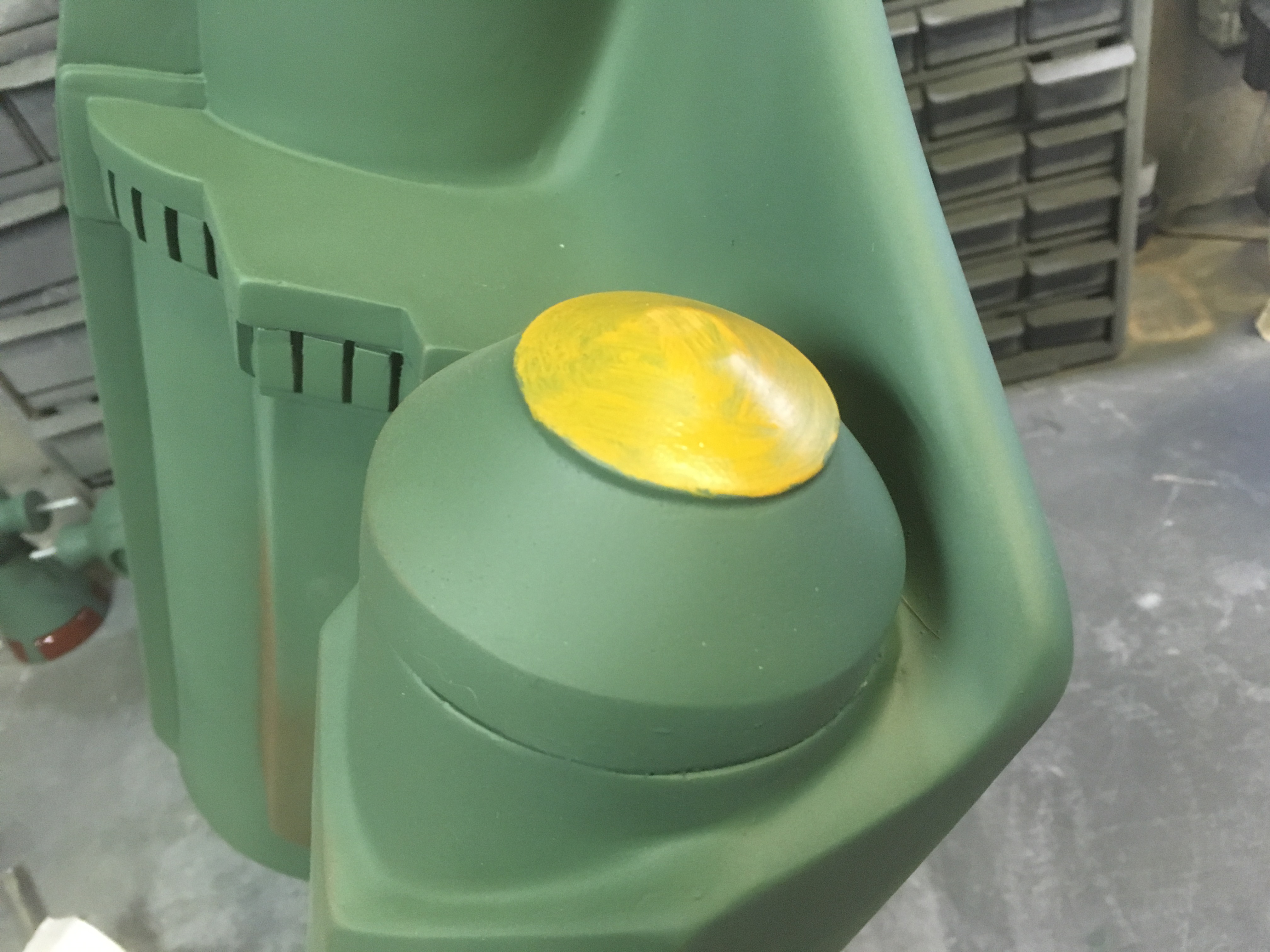

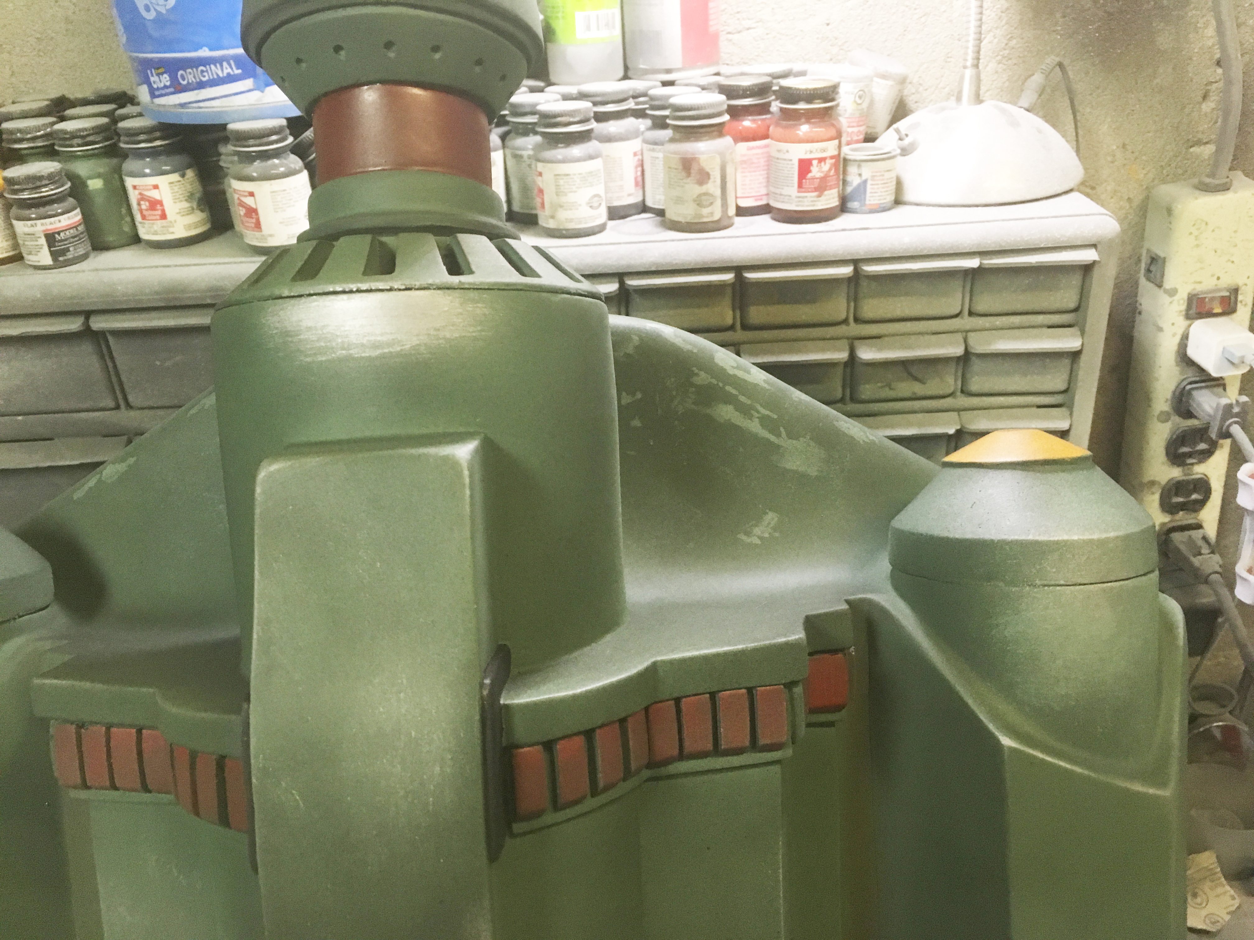

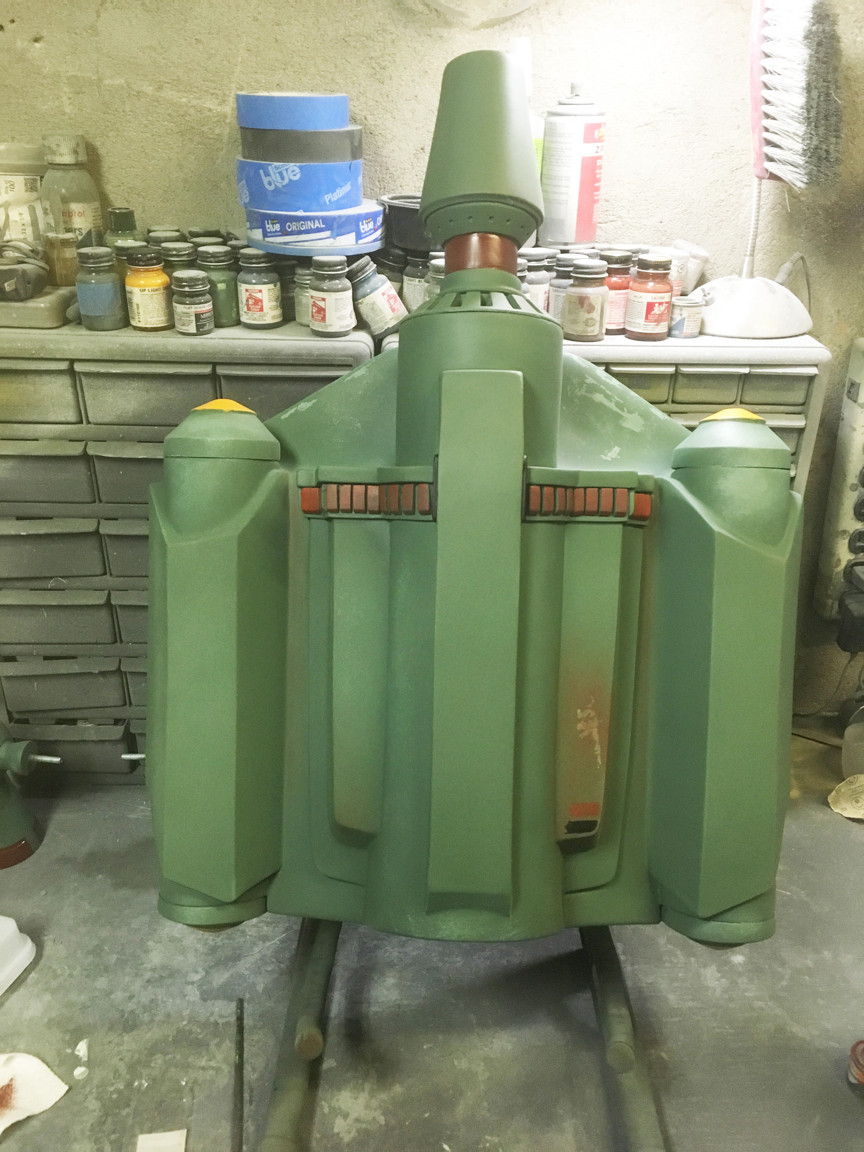

9- Now we do the fuel cap "yellow" This is the same yellow i use on the top part of the rocket collar as well. On some kits this may be attached to the bottom of the upper half of the rocket. Use the floquil UP Light Orange mixed with Humbrol #154. Not sure of the exact mix i use because i mix a half bottle of the floquil with one tin of the 154. Thats way more than you will need, but since i do multiple paint ups i mix larger amounts. I brush this on in 2-3 thin coats. I like the look of the slight unevenness and feel it adds to the weathered look. This pic is after 2 coats...it also looks a little more yellow in the pic ..the color does have more of an orange-y tone, similar to the darker shoulder armor color.
So now we have the fuel cap tops done, both on the top and bottom of the pack

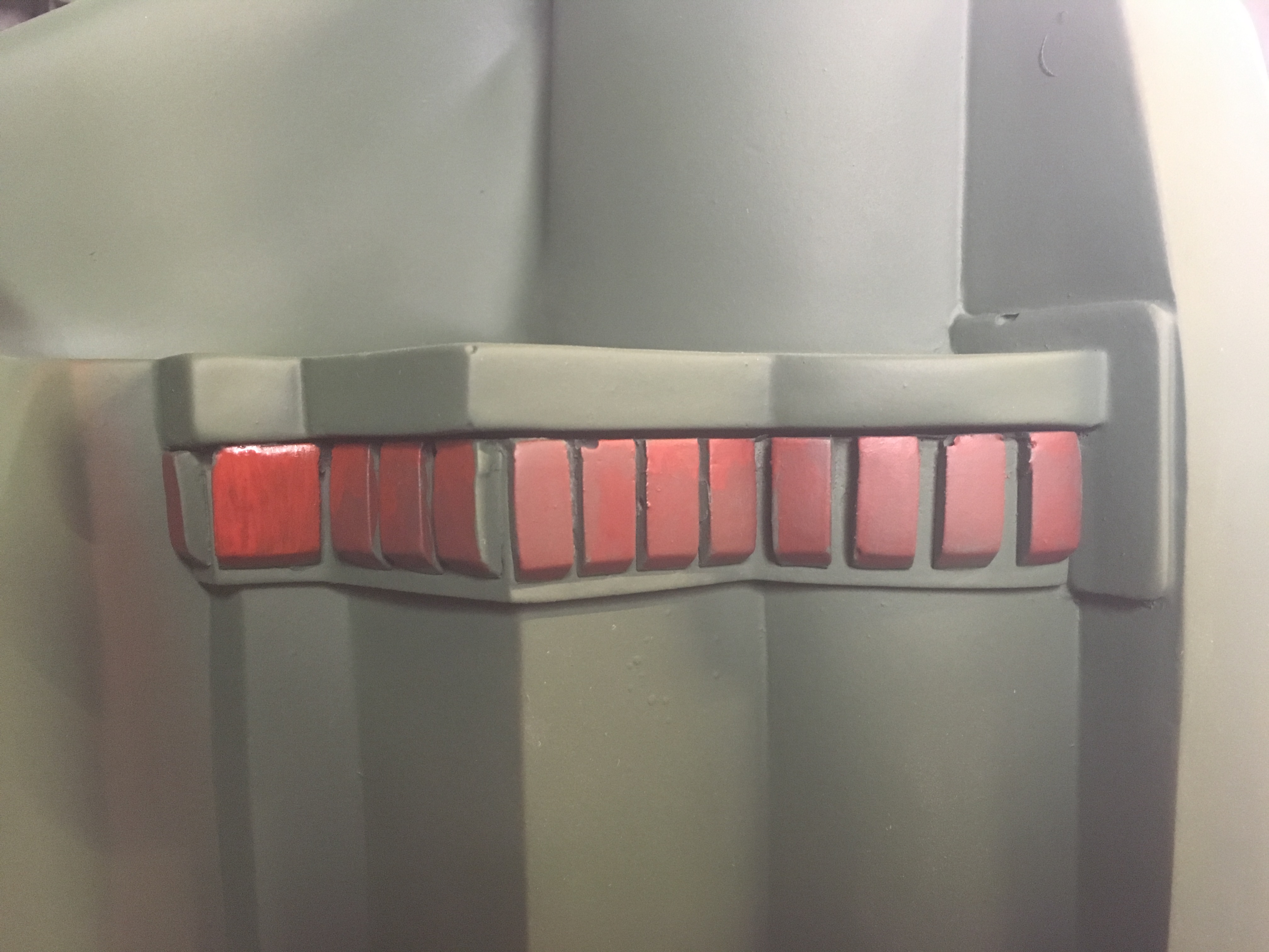

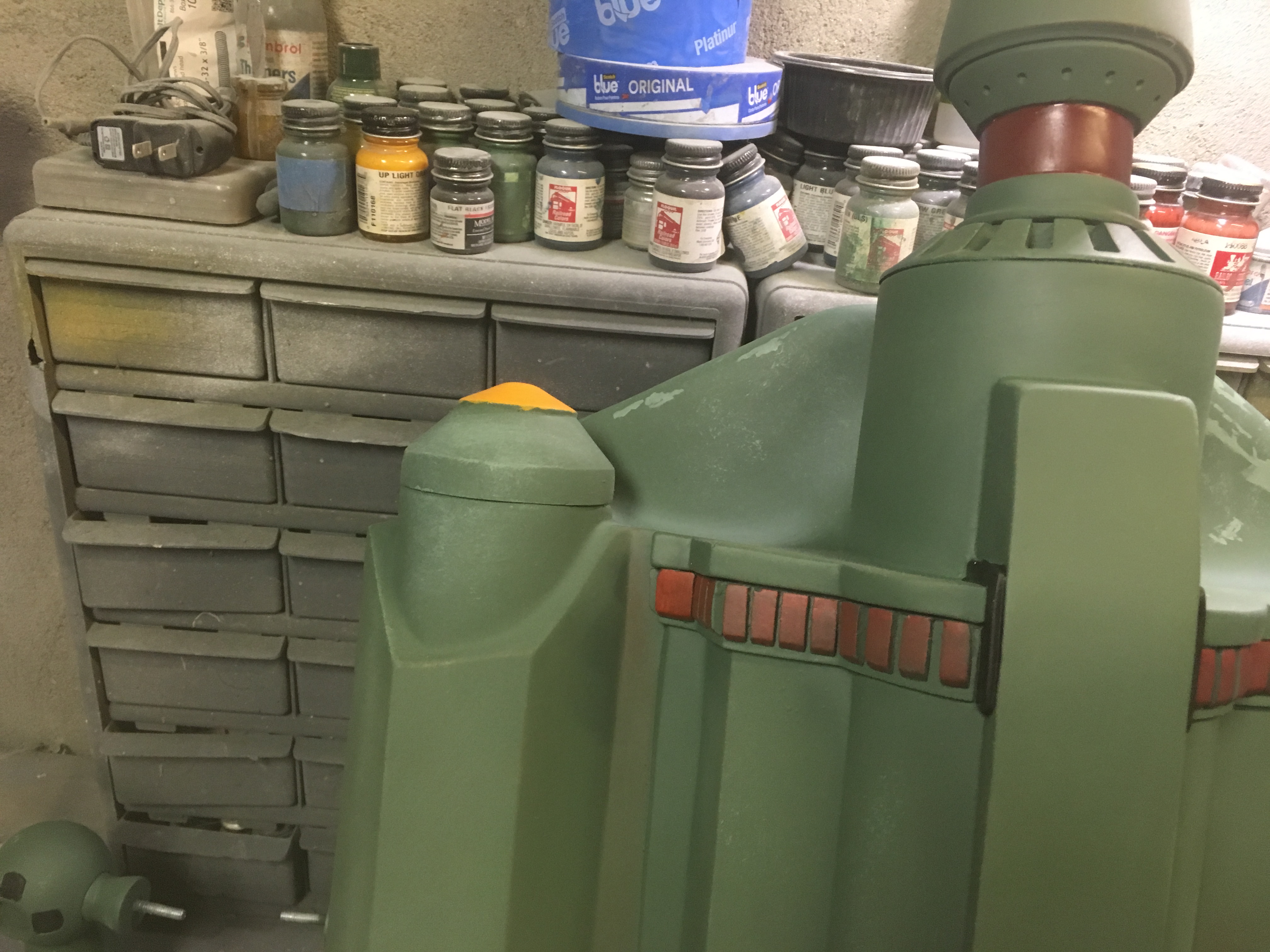

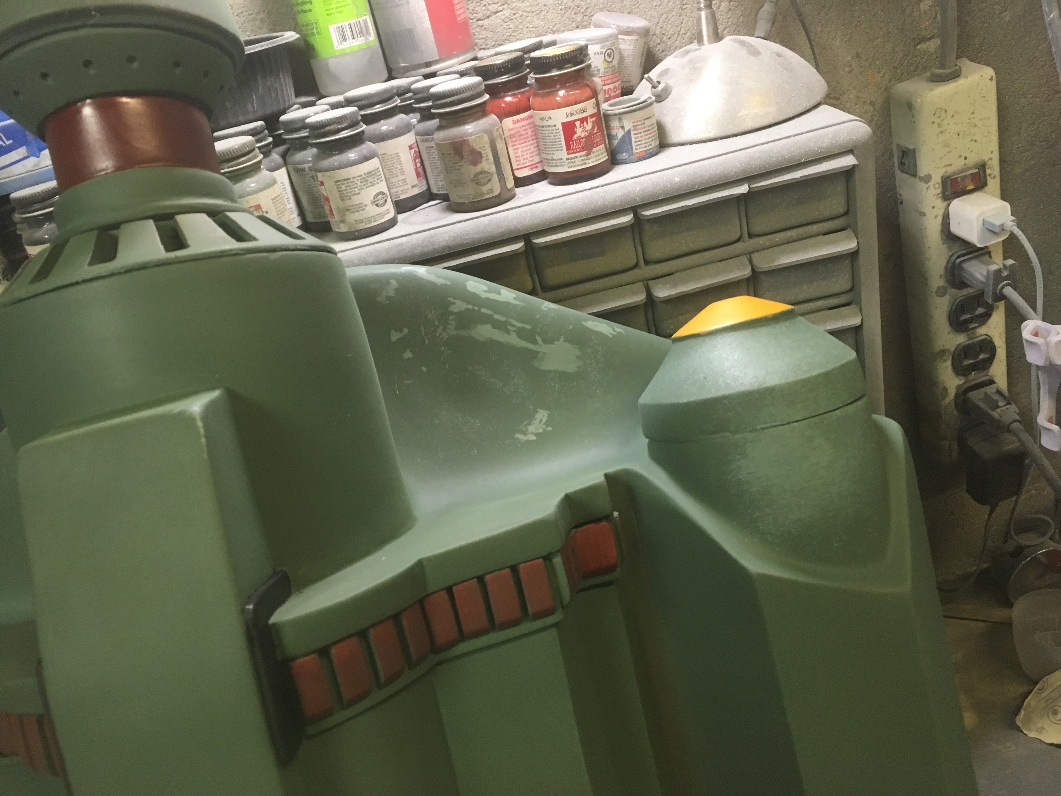

10- i now do the piano keys. They should only be painted on the front face of each key. I do these with the floquil caboose and do some highlights with the floquil rock island maroon. the farthest 2 keys on either end i also go over them with Humbrol #60. Red is a transparent color so if you put it on sparingly it will just brighten up the key just enough.
Now i do the flat black near the piano keys and the stripe on the lower right. I also do the "directional" details on the thrusters.This is literally just flat black so its pretty straight forward lol
Now i do the red stripe on the lower right. I do this with the Humbrol #100 The stripes from what i can see look to be rough on the edge towards the center of the pack so i do that by just dabbing with a small brush on that edge and just cleanly shaping the rest of them.

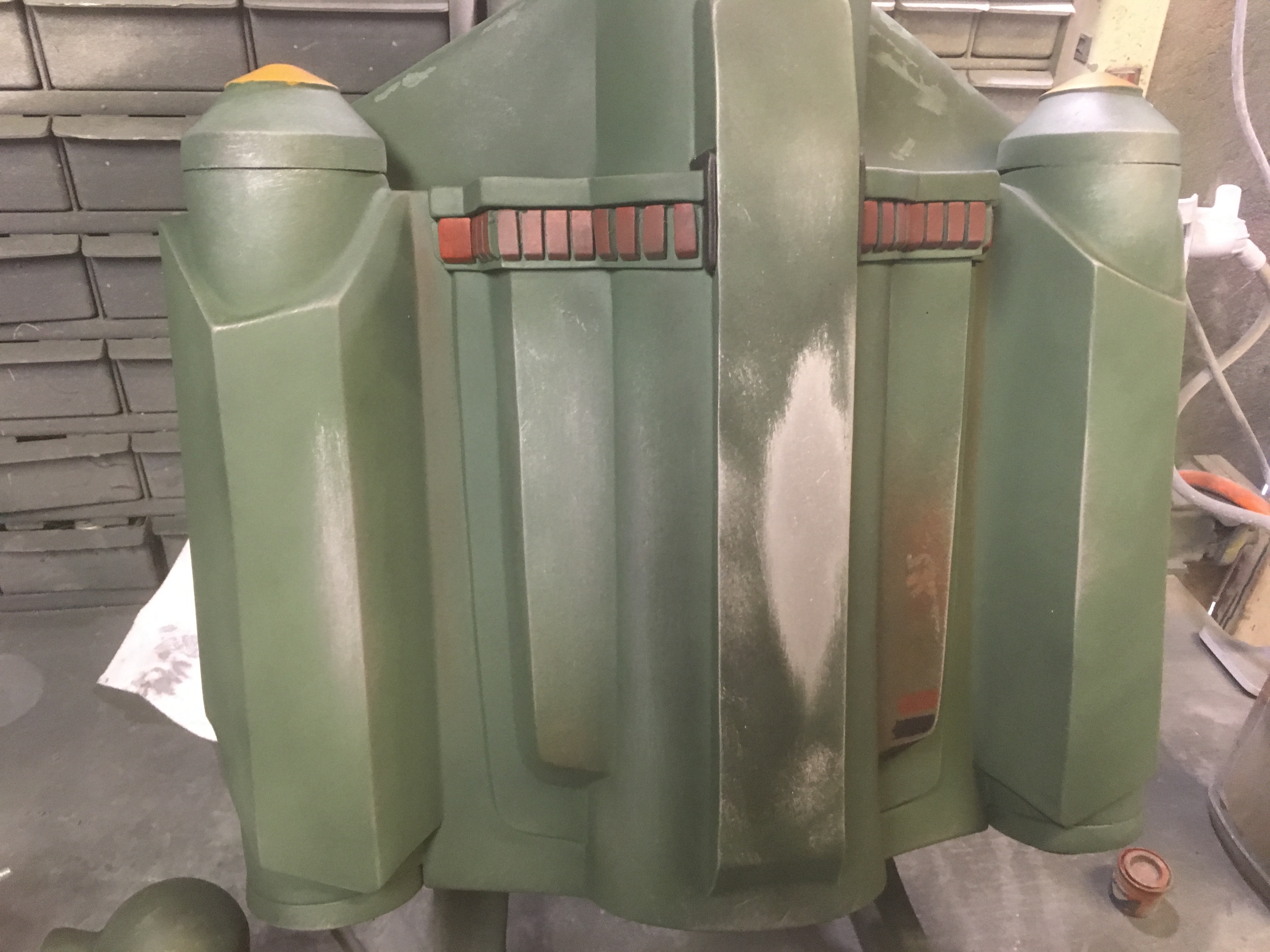

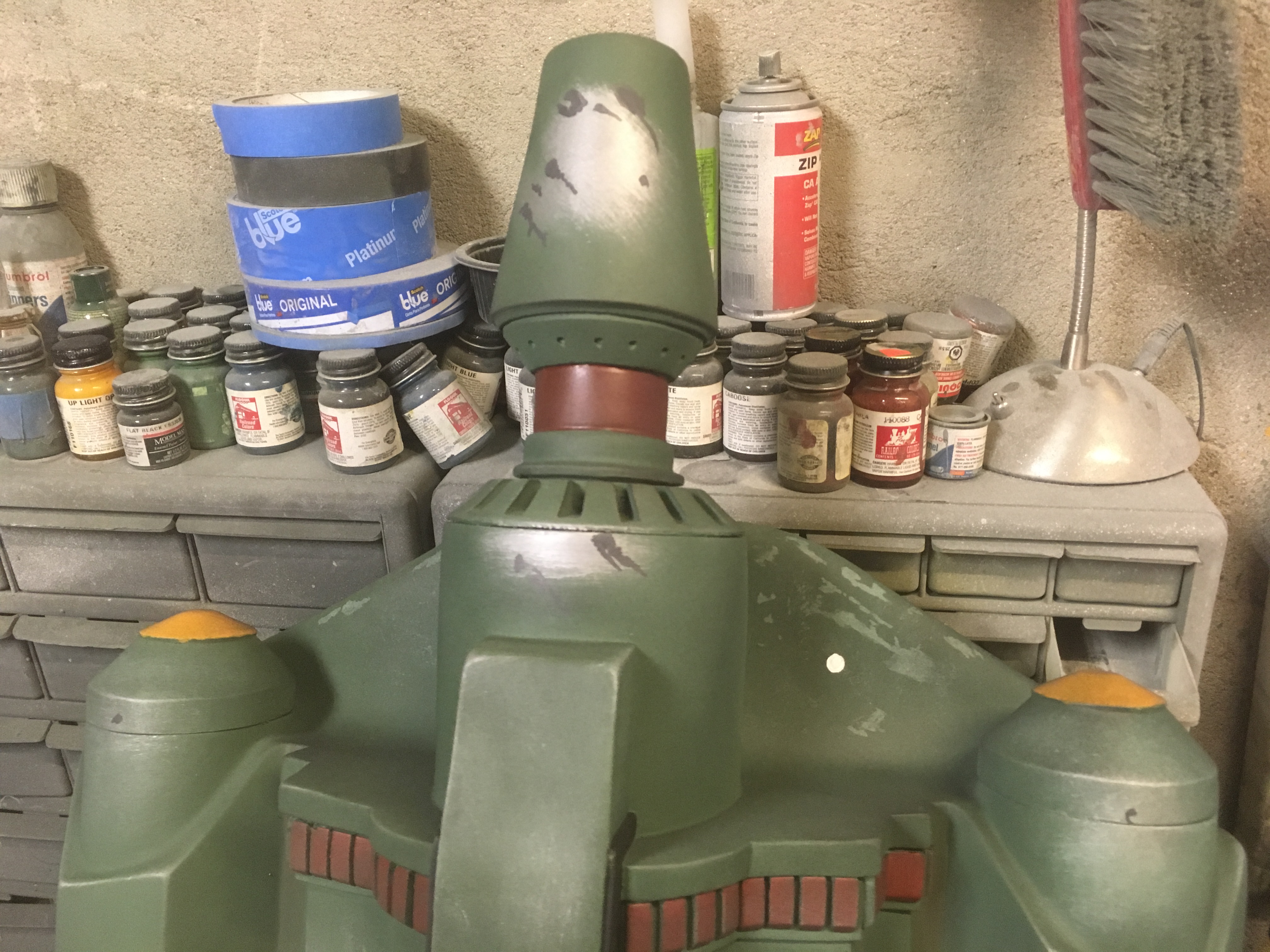

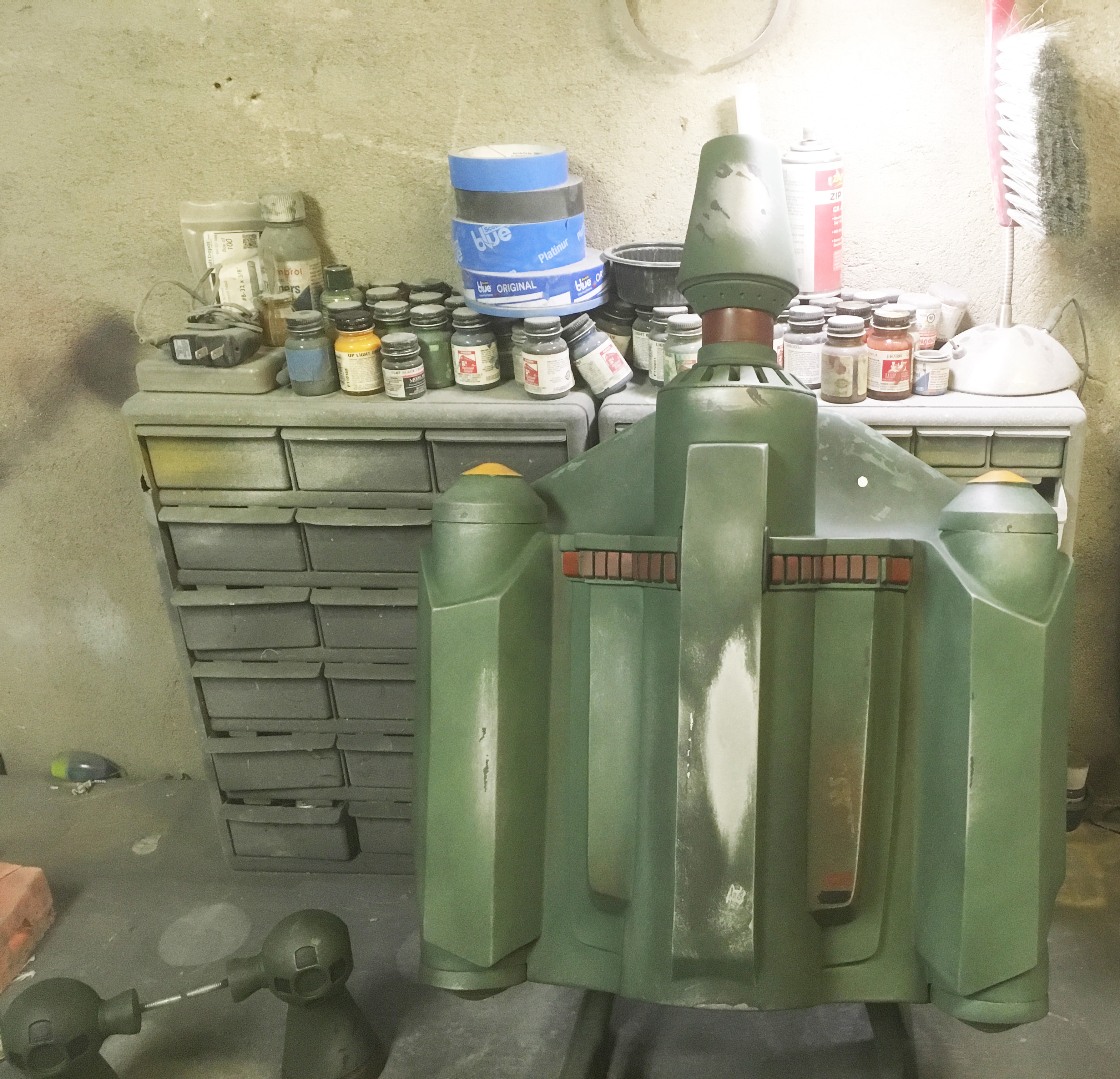

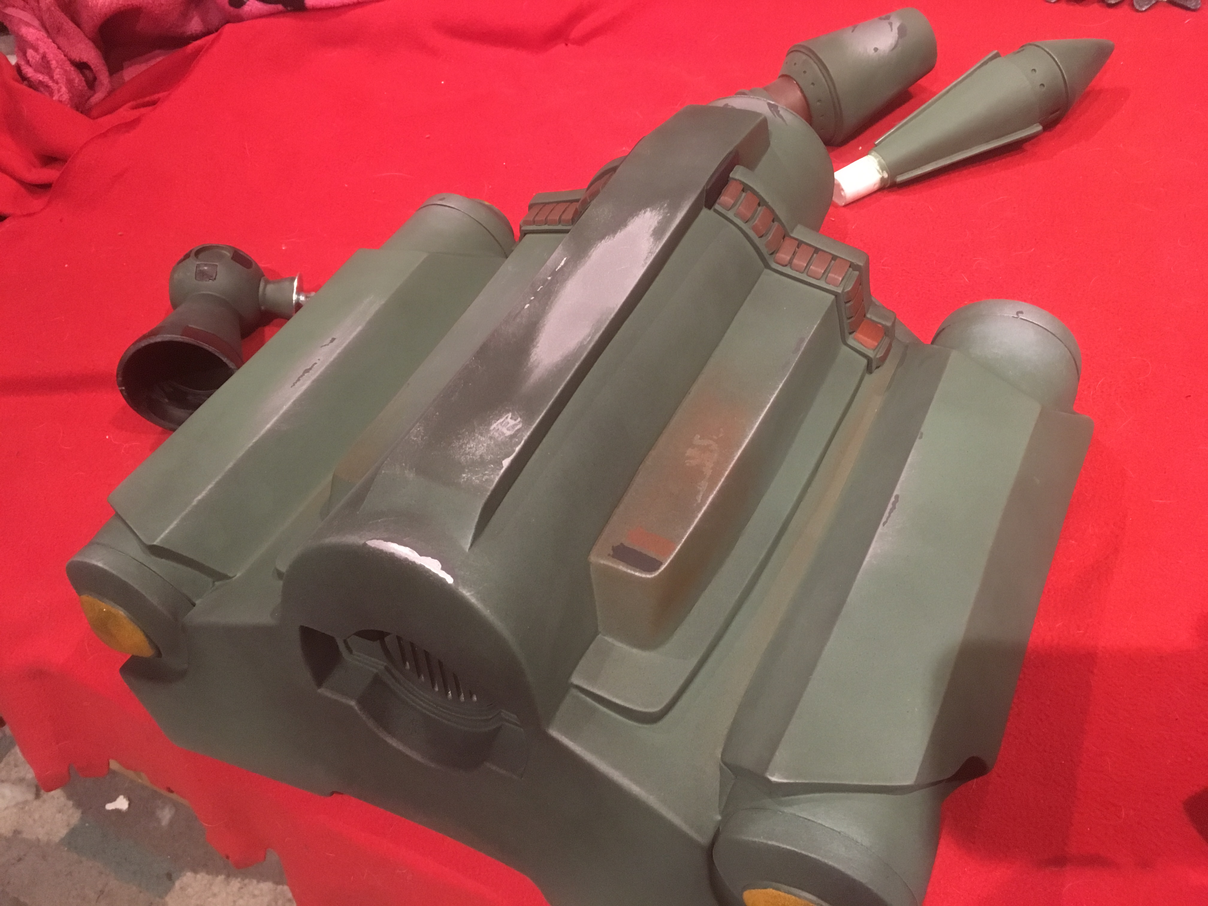

Now i do the faded scratches seen on the ESB Cloud City promo shots seen here:1.png

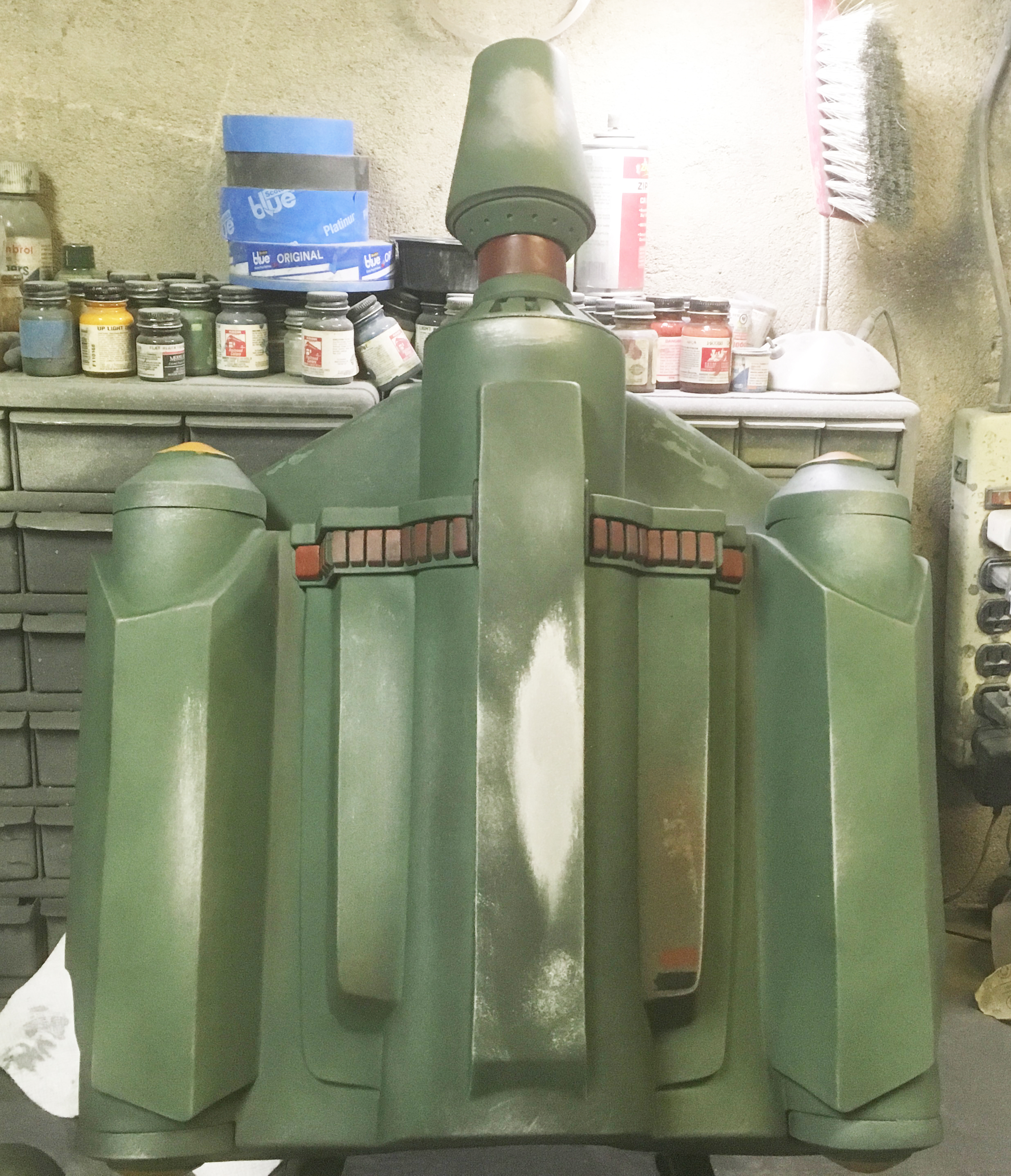

i mix some panzer olive grun with white to get a fairly light shade of the green. You could even add a touch of MM RLM 76 light blue to it rather than the white to make it slightly more blueish. Its hard to tell what color it REALLY is. I just added white this time and by eye just added the main damage i could see. I also use one of the chip brushes and dab it on a paper towel and tap the brush on the upper back panels and the tops of the fuel tanks to match reference best i can. I also added the little backwards "F" mark above the stripes as well. In hindsight i should have done that before the rust. But i just dabbed some more of the rust color over it to match reference best i could.
I forgot to take a pic but i also did this on the tops of the thrusters to match the promo shots.
Now i take the Krylon black primer and mist it lightly over the entire pack. i then concentrate the mist more on the center strip and the top flat panels i had previously added the "light green damage" to, as well as where the rust ara is where the stripes are. I also did this on the thrusters to match the reference.
Now we move on to the silver damage. I do this like i did the rust. I put a little silver on a plastic plate dab in a chip brush, brush it on a paper towel and dry brush all the silver areas on the pack, rocket and thrusters. I also go over most of the edges once there is very little paint left on the brush just to get a slight worn look. I also add floquil weathered black for the small little dark grey areas that look like chips.
IMG_3356.JPG IMG_3357.JPG IMG_3358.JPG Thats pretty much it! Just add the decal, and the greeblies in the thrusters...you can mist it with more of the krylon black primer if you want it more dirty. Just remember to seal the entire pack with the krylon Matt finish! I do a few light coats so it doesnt get too much sheen!
Oh yea, the top of the rocket i just mist the black primer on it over the MM panzer olive Grun/RLM76/H27 mix base coat..it doesnt have much detail paint wise on it. but here is the pack completed. Customer has metal collar, beacon, stabilizer and thruster greeblies so thats why they arent there. :)
