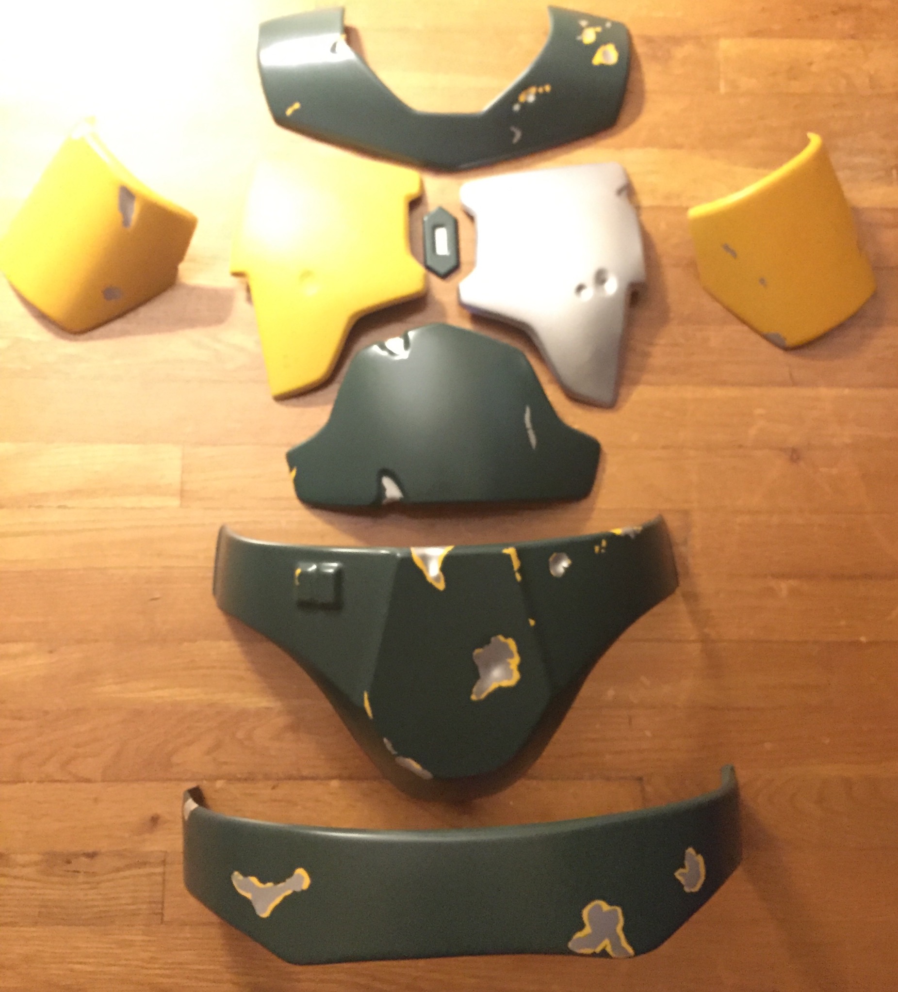

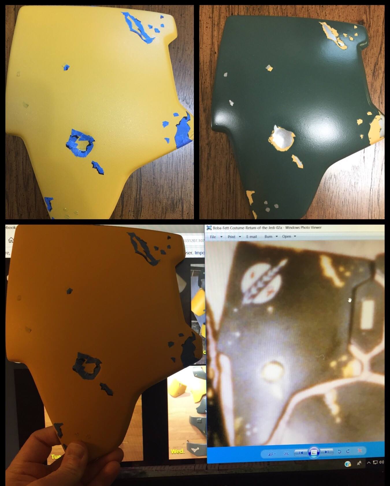

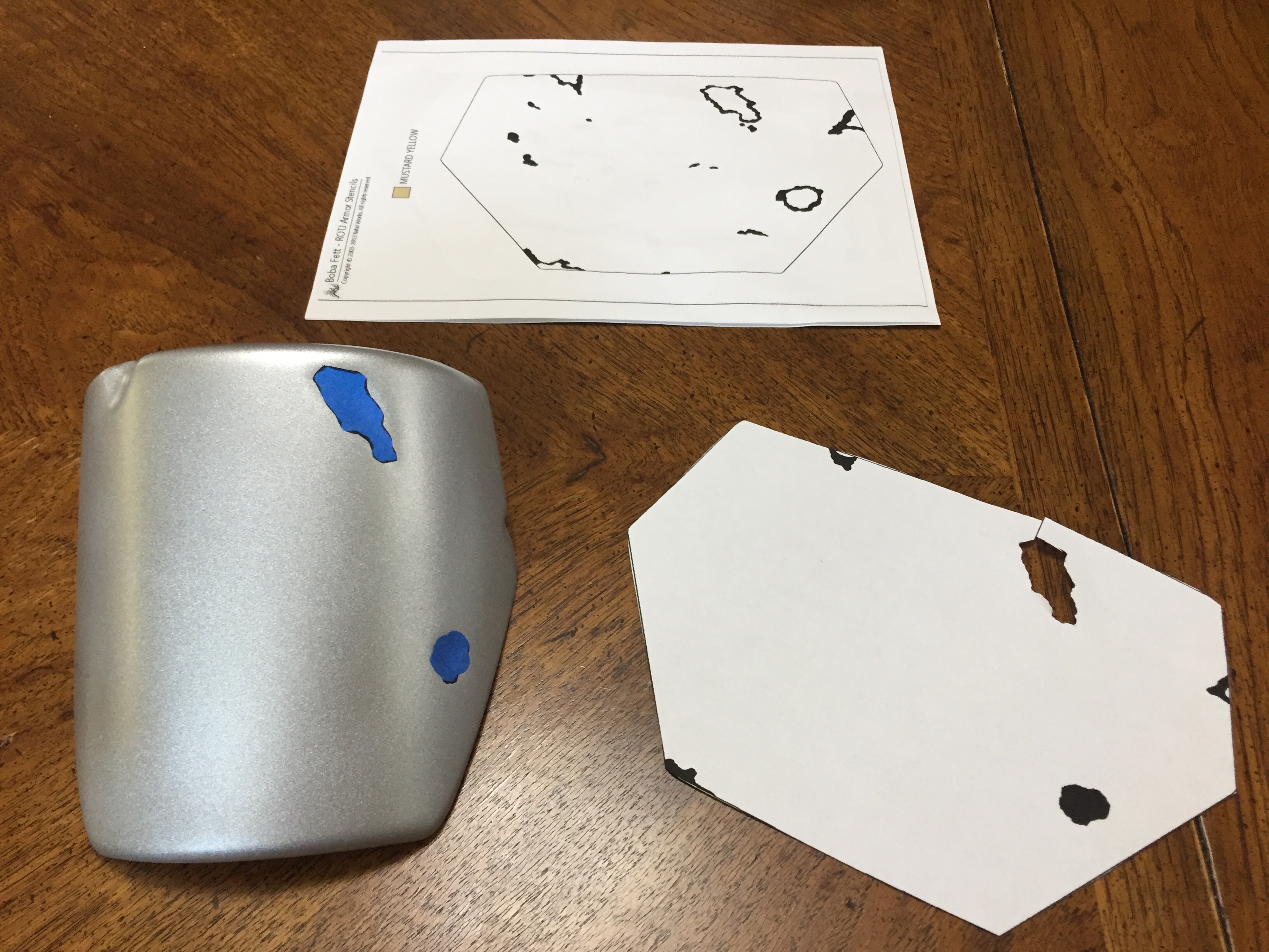

Armor is from Will/RKD (presumably one of the last sets he made and I was very sorry to hear of his passing). After lots of sanding and trimming, it's coming along well. I'm using Rafal's ROTJ templates (which are amazing) to mask out the large damage areas with a combo of mask fluid and plain old tape. Smaller bits and details will be added topically with acrylics.

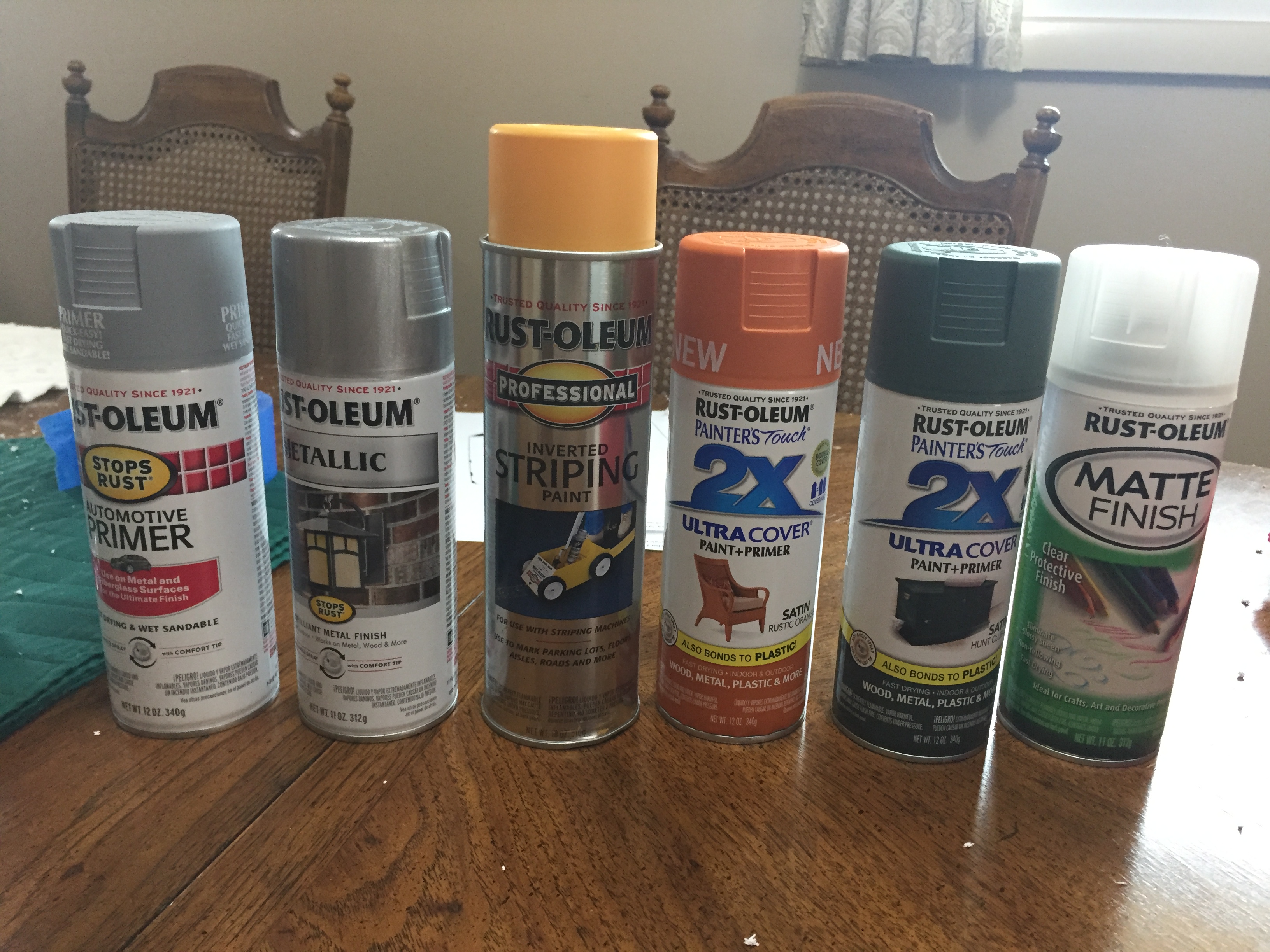

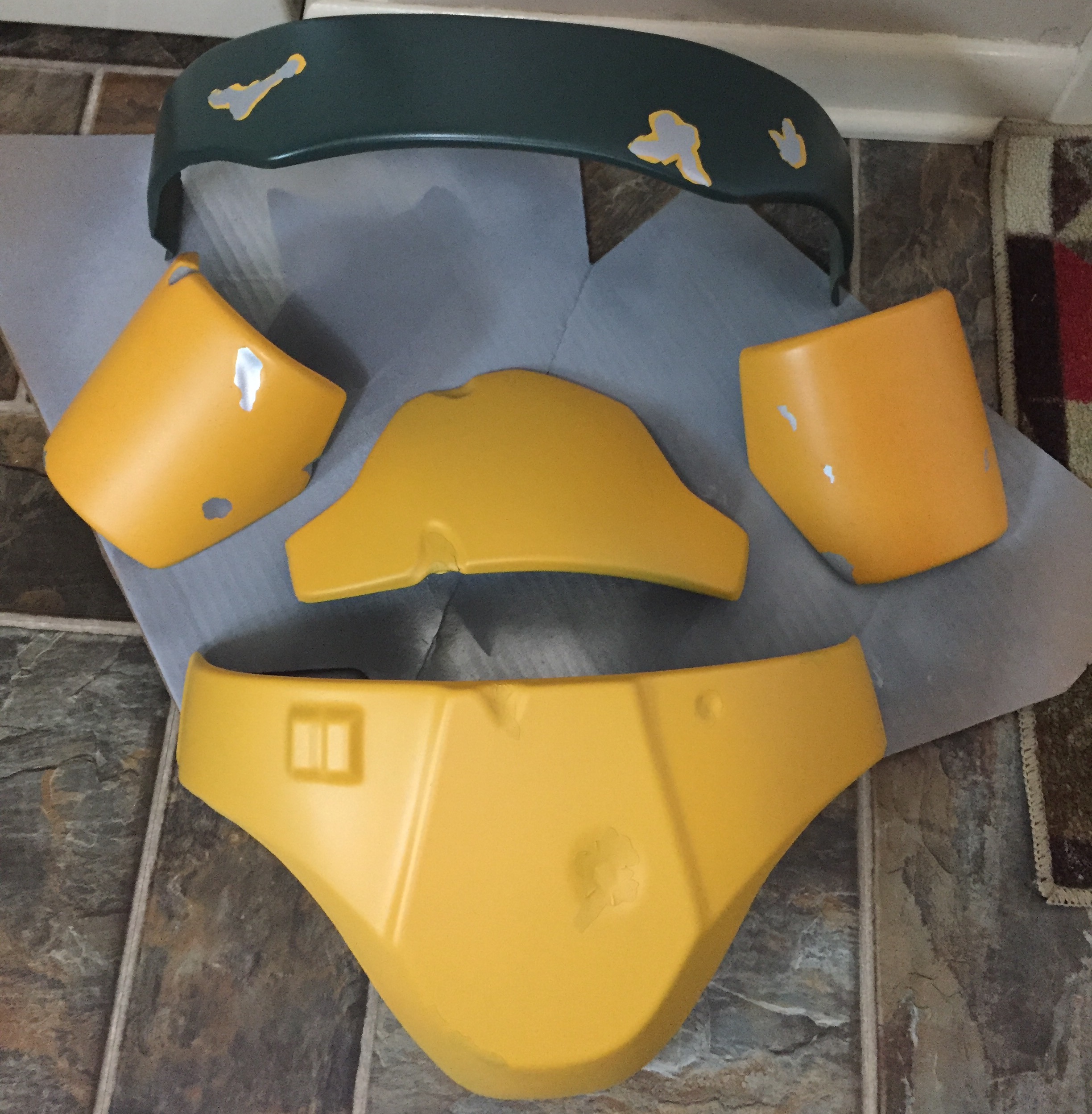

For paint, I decided on rattle cans and after lots of research on this site, settled on a layered approach of Metallic Silver, Striping Yellow (inverted can), and Hunt Club Green. The shoulder bells also got an under-coat of Rustic Orange, as well as a mist over the yellow. They still don't seem orange enough to my eyes. The additional detail colors will be applied topically, along with the weathering. I'm awaiting my decals from Delucks Designs.

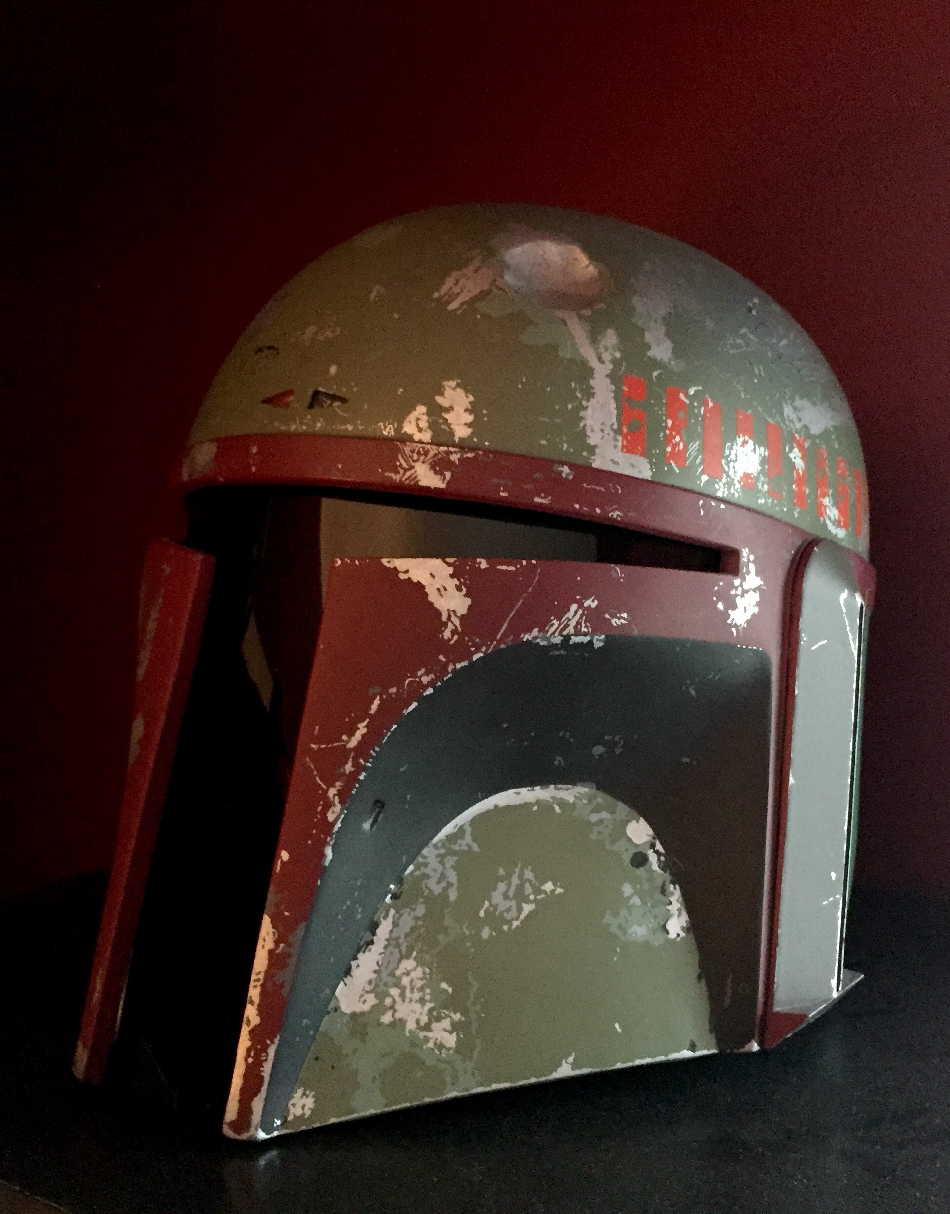

Fiberglass helmet is from AnimeFan with a commissioned paint job by AFFo$. Of all the pieces of this costume, I knew I wanted the helmet to be 100% perfect. I briefly entertained the idea of painting it myself, but after seeing AFFo$'s work and effort, I have zero regrets about commissioning him to do it. I think it's an absolute work of art.

It looks like you're making some good progress so far. Looking good! Usually for stenciling I've seen, the carbon paper placed under the stencil, positioned in place and tracing the outline of the stencil and it is transferred onto the piece. The outline and other markings are filled in with a liquid masking fluid, like Maskol or some other brand and then the paint is applied for the next layer of color. Most guys peal off the masking for each color layer and re-masking everything previously painted for the next layer (be sure to wait at least 24hrs between layers). The liquid masking is probably easier to apply than masking tape and will allow finer detail for your masked areas. In this thread you can see some of the steps taken as the different colors that are applied to the armor ROTJ Repaint and Modifications: Hope this helps......Don
Thanks Don. I’m using a combination of Micro Mask masking liquid and tape for the larger areas in between paint layers. I’ve learned that each have their own advantages. I plan to do touch-ups and super details topically. Carbon paper is definitely a great idea that I’ll keep in mind for future pieces. Thanks!
Progress! Touch-ups and smaller details will be added topically. Some of the square edges on the paint specks are bugging me, so I'll round them off with a sponge brush and a bit of paint to more closely match the reference. Looking forward to sealing and weathering it all.

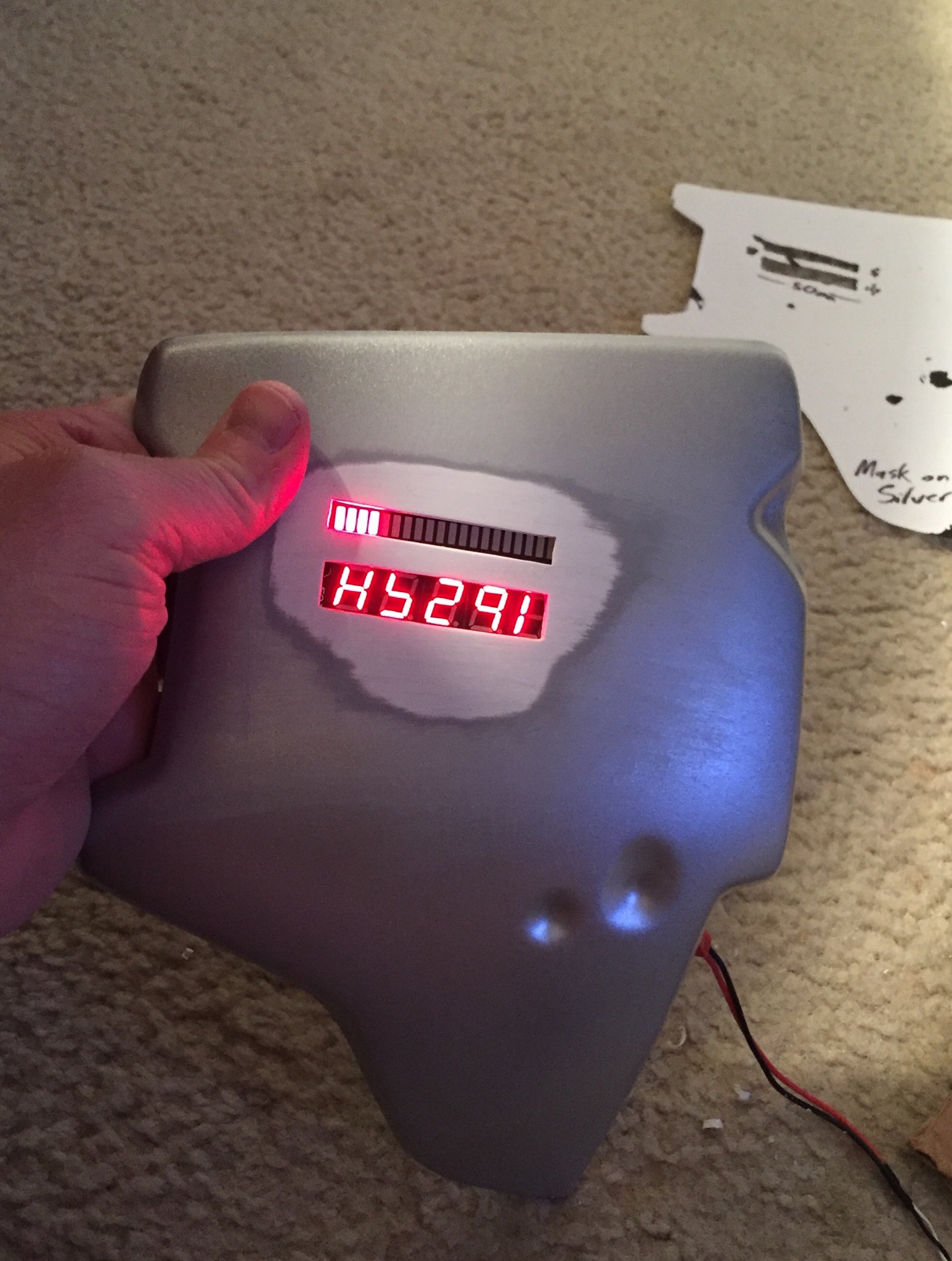

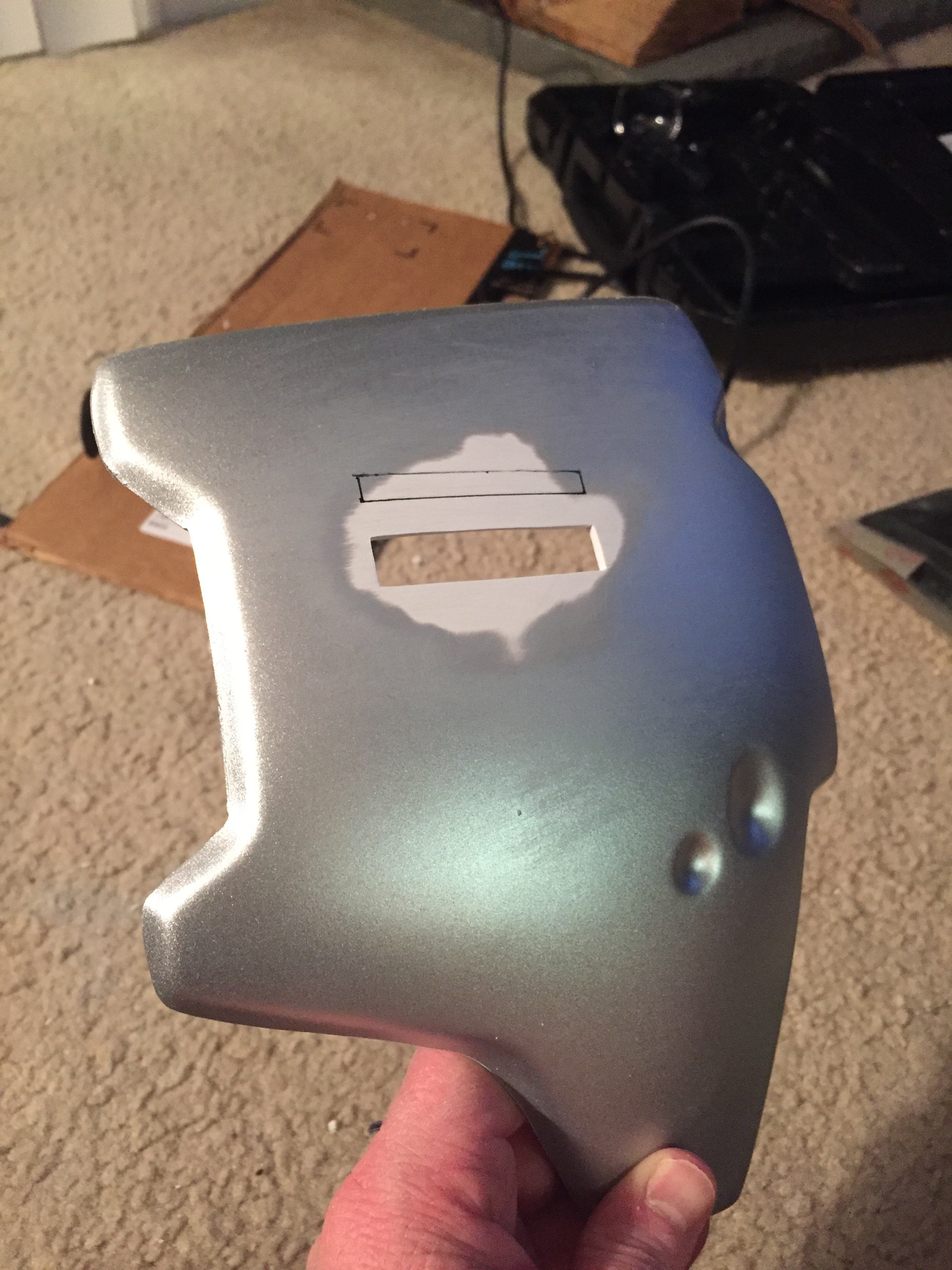

Made some progress tonight and cut out the chest display slots for my Fettronics lights. Awaiting the “smoke” plastic screen to arrive from Amazon.
Slots are very close to 10mm and 5mm by 50mm, with an 8mm gap between.
Will have to wait for a more humane temperature to resume painting.
Thanks! I'm trying to figure out a translucent screen option for my ESB build. Maybe I can find something based off that item.
If I’m not mistaken, DV8r used the film screen in conjunction with another piece of firmer, clear plastic to give it some rigidity. I’ll need to experiment once it arrives. Good luck!

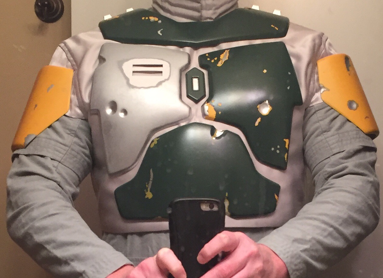

Spent the last couple nights getting my armor placed using the jewelry pin technique with locking backs. I must say, it’s a really durable technique, and as much as I’ve taken my vest off and on (by myself), I can’t believe the pins are holding up to all the wear and tear (locking backs and adhesive). I was going to use magnets, but the pins have won me over.
As for placement, I really want a little more gap between the chest plates and the collar, but since I’m a bigger guy (6’2”) and I’m using RKD’s large armor, there’s not a lot of real estate left on that vest. Maybe it can all come down a quarter inch or so.
Not the best pic, but should give an idea. Since I was test fitting alone, the vest is not 100% closed in the back. I’ll try and get more pics this weekend when my girlfriend comes over to help dress me. Lol.
The low angle of this pic makes the gap between the collar and the chest look more narrow than it is, but I may move everything down a quarter inch. It “feels” right as is though. Opinions are welcome!
DeathProof
I think the chest armor looks fine. Nice placement. The RKD armor fits you well. The shoulders I feel are sitting a bit low (not much), however they are in the right place on the vest. Maybe nudge them up a bit and see how you feel. You don’t want them too high so the bells start jutting out.
