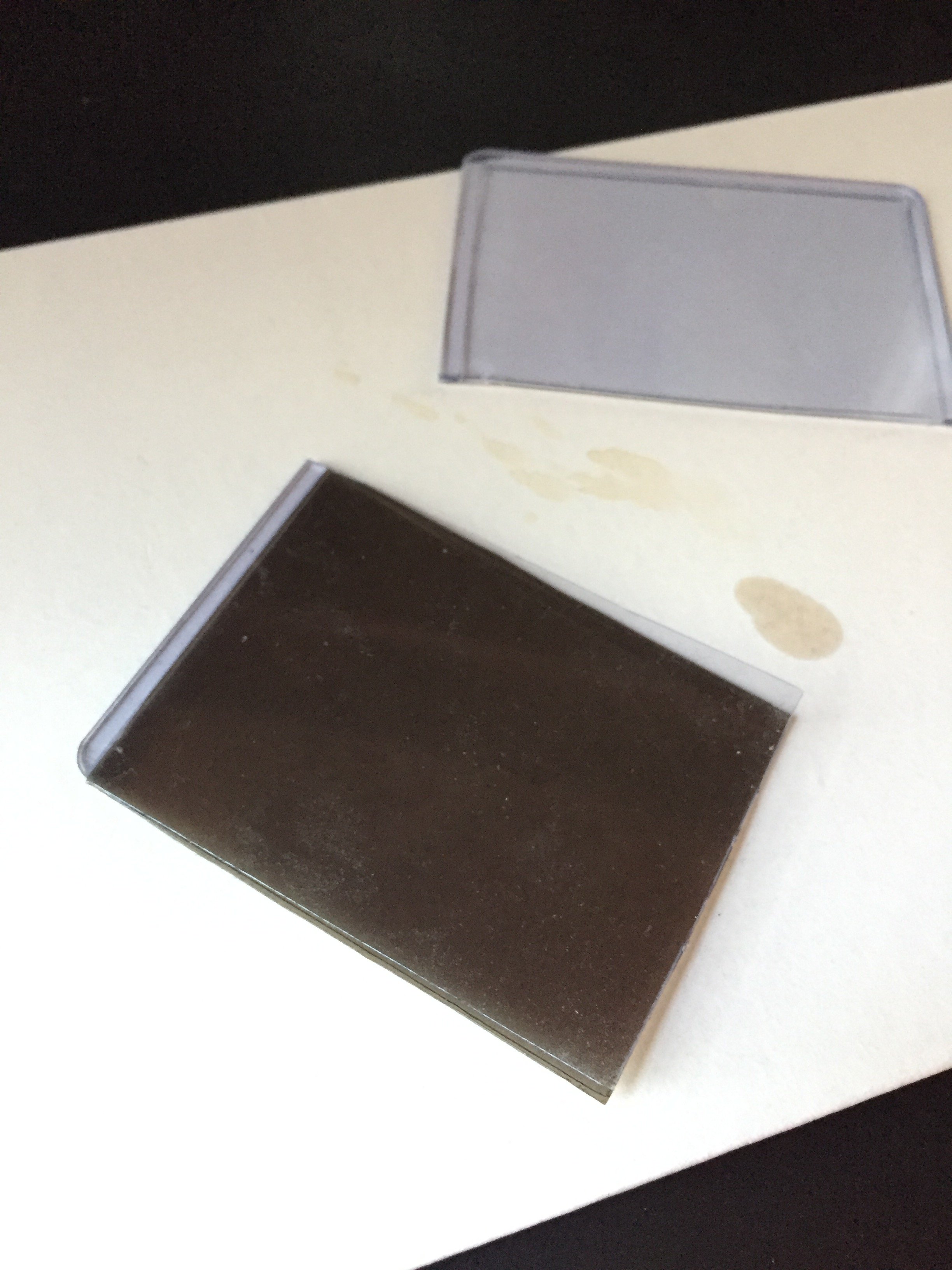

On a whim, I used half of a baseball card protective sleeve for my chest display and stuck my “smoke” film sheet in there (self adhesive). The film is protected from both sides from scratches and dings, and should be easy to mount since the sleeve is flexible and will contour to the underside of the chest. I have no idea how everyone else does this, but it seems to work well.

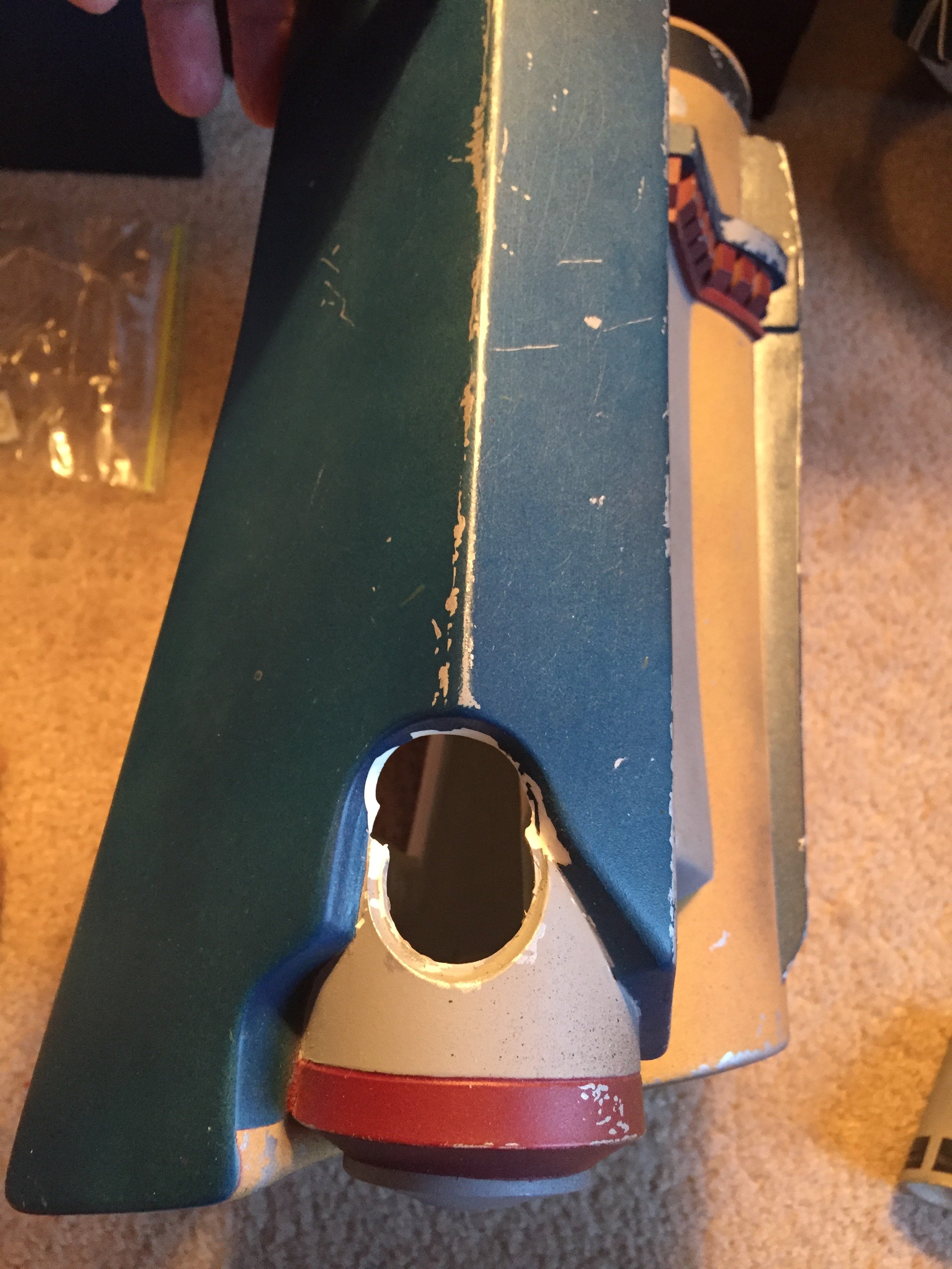

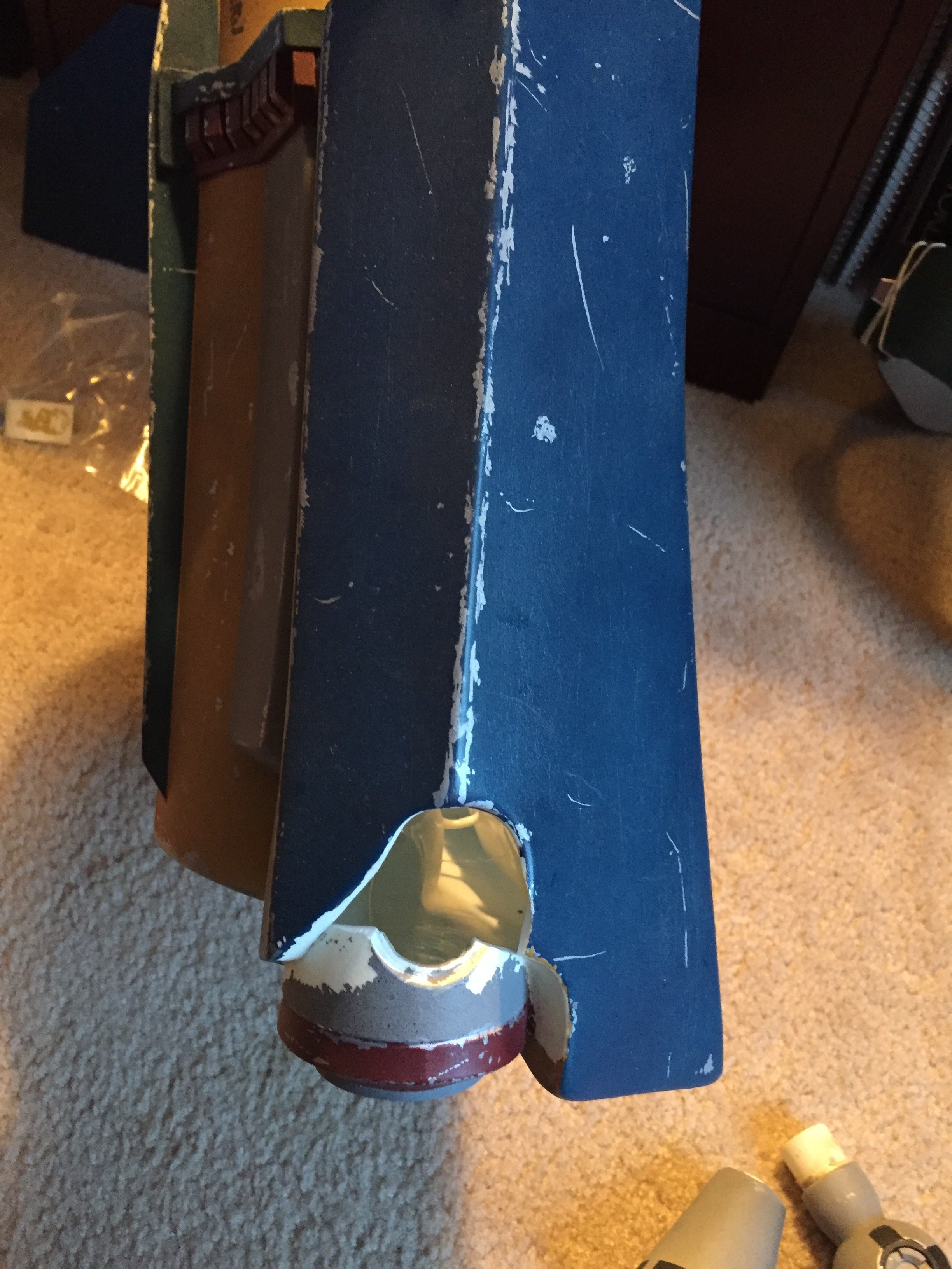

On to bigger problems... my MoW jetpack arrived that I bought from a fellow member here and the postal service appears to have certainly had their way with it....
I wanted my thrusters to be removeable (planning on bungee cord method) so on the plus side, USPS did some of my work for me!
Unfortunately, the shell is cracked on both sides where the thrusters mount and I dread the unforeseen work I’ll need to dump into this. I need to salvage this thing because I dig the AFFo$ paintjob!
Besides staring at it and crying, if anyone has better ideas please let me know!
You could fiberglass from the inside and then build up bondo on the outside to shape and then re drill the holes for the thrusters. I have the same jetpack and the material on mine is pretty thick there. They must have tossed it around quite a bit to get it to break like that. Were the thrusters permanently attached before? This is why I like mine removable. The only thing you might have to worry about is the temp from the fiberglass getting too hot while curing and damaging the pack. I’m sure others will have better ideas. Good luck.
You might want to put down the fiberglass on the inside first to hold the bondo in place as you put your pieces in and build back all the missing areas. Kinda like a
backer to hold it all in place. I'm thinking that is what SF was referring to...
