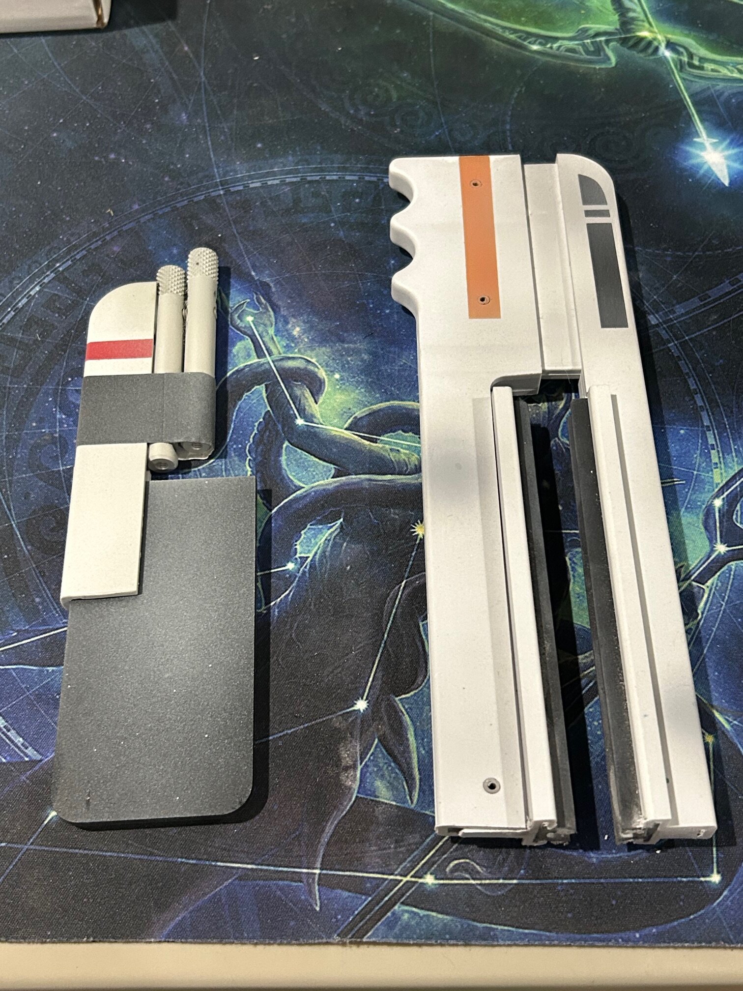

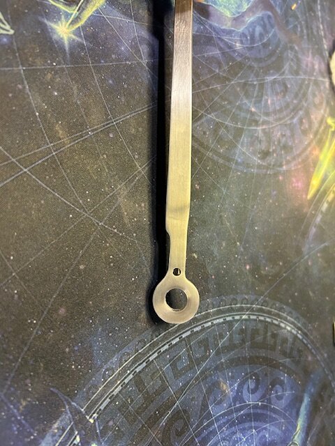

My helmet came in and I started working on the electronics and motorized stalk. First problem was that the hollow stalk from MCR doesn't match up size wise with the bobamaker stalk. The Outer diameter of the rounded part at the bottom is too big (by 1-1.5mm). Next, the bobamaker stalk itself was a little narrower so the "stops" at the top and bottom are a little small. I didn't want to modify that part of the helmet in case I ever want to go back to the bobamaker stalk, so I modified the MCR stalk instead. The MCR stalk is also a little thicker than the BM one so I had to deal with that too.
The left picture is the bobamaker stalk on top of the MCR stalk. It's not super obvious, but there is a difference there that made it so it wouldn't fit in the ear cap housing. I took a grinder to the MCR stalk to modify the outer radius and then ground down the parts so it doesn't smack into the stops. Once that was done, I polished up the aluminum again to get rid of the grind lines. It's not perfect, but I figure the small imperfections will line up well with the weathering when that gets done. Also bored out the hole in the middle to handle the shaft extension for the motor kit.

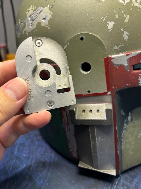

Next was modifying the helmet. I bored out the hole on the ear cap and helmet with a little room to spare (like 1/64" over the 3/8") so the motor moves freely.

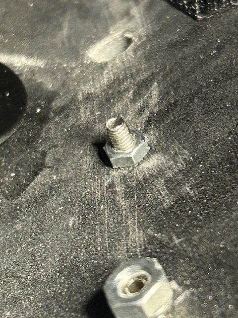

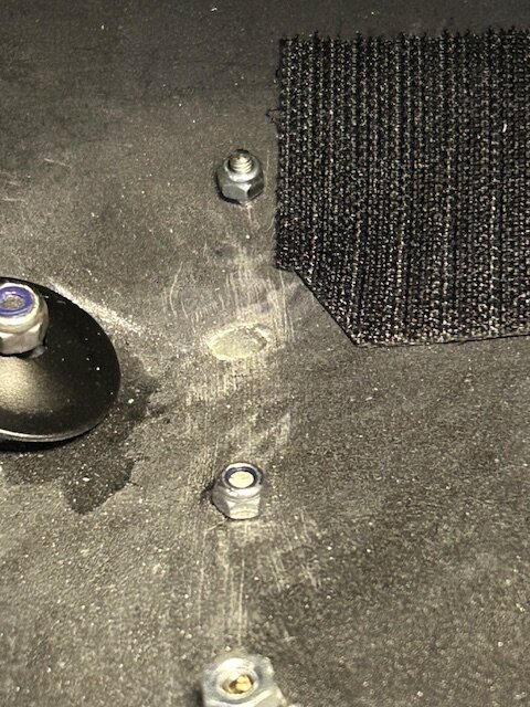

The next issue was mounting the motor itself. The bolts that came with the BM helmet were about 1/8" too long and prevented the motor from sitting right. I cut them down and replaced the nuts with nylocks so I don't have to worry about them coming loose with the motor kit installed.

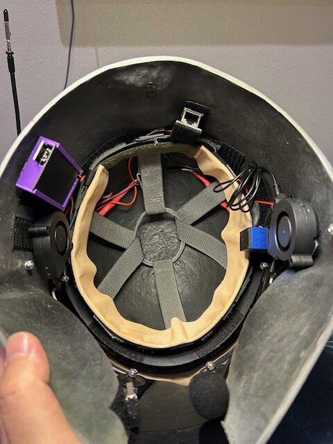

Once all that was done, I mounted the motor and control box. To balance out the helmet, I moved the control box to the other side of the helmet. After that was the switch to control the motorized stalk. @NeoFett was kind enough to mod her kit to allow a switch to actuate the motor that is tied directly to the control box (vice using wireless which still does work if I want that option too). I mounted a lever switch just inside the visor that I can activate by sticking my jaw out. I can talk freely with it in and it doesn't activate which is good. Next up was putting in the suspension system (thanks Irongladiator) with sweatband. After that was wiring all of the power to my ethernet breakout so I can connect to my main power system. Next came fans with the outputs blowing across the face shield. Last but not least was the microphone which was mounted in just in front of my mouth. Haven't fully tested that yet to make sure it doesn't pickup too much, but the testing didn't have too much noise on it. Other than the mic, everything tested out perfectly and the bucket fits great!
Pic of the inside of the helmet.

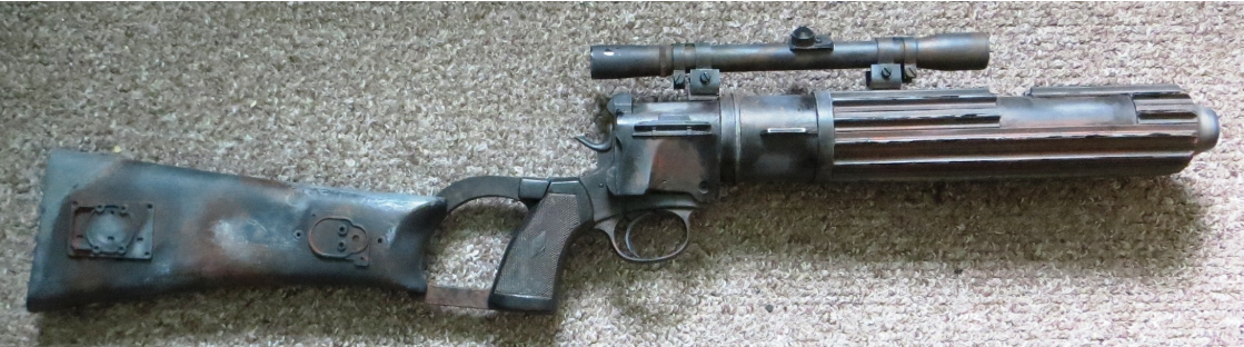

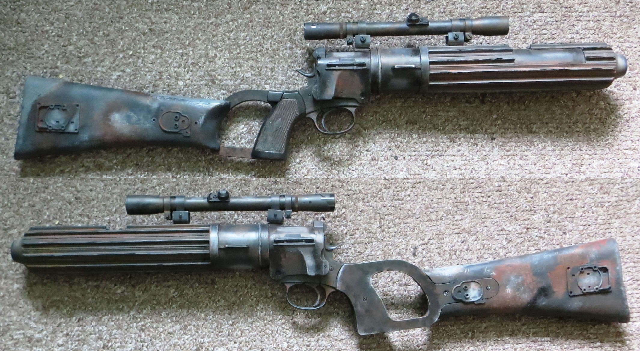

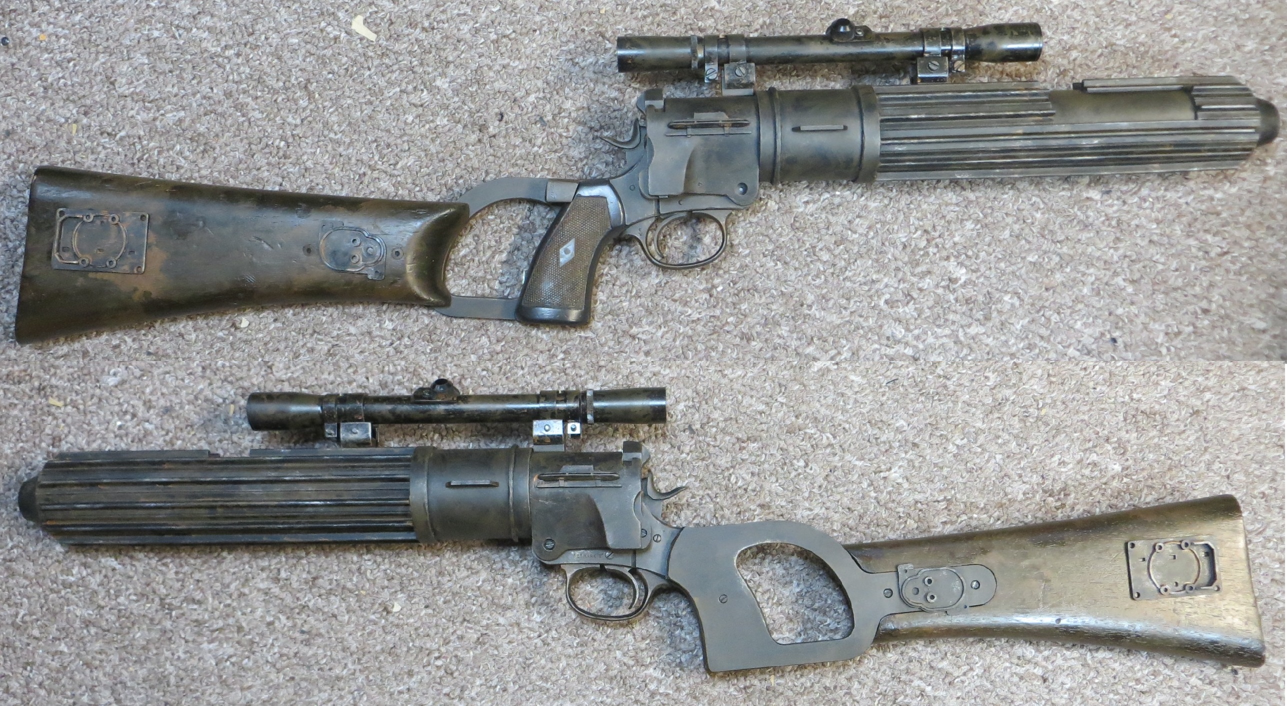

So I have my EE-3 on order from Sidewinder but I need to provide him with what paint job I would like. He sent me 5 options, but I have narrowed it down to 2. Would appreciate the communities thoughts on which to go with. I am hoping one day to go for Level 2 so I am trying to keep that in mind with my selection. I am personally leaning towards #1.
Option #1
Option #2
I like option 2 personally, BUT If your goal is to be approved at a higher "infamous" level they will require it to match the ROTJ hero blaster weathering patterns which option #1 is closest too.

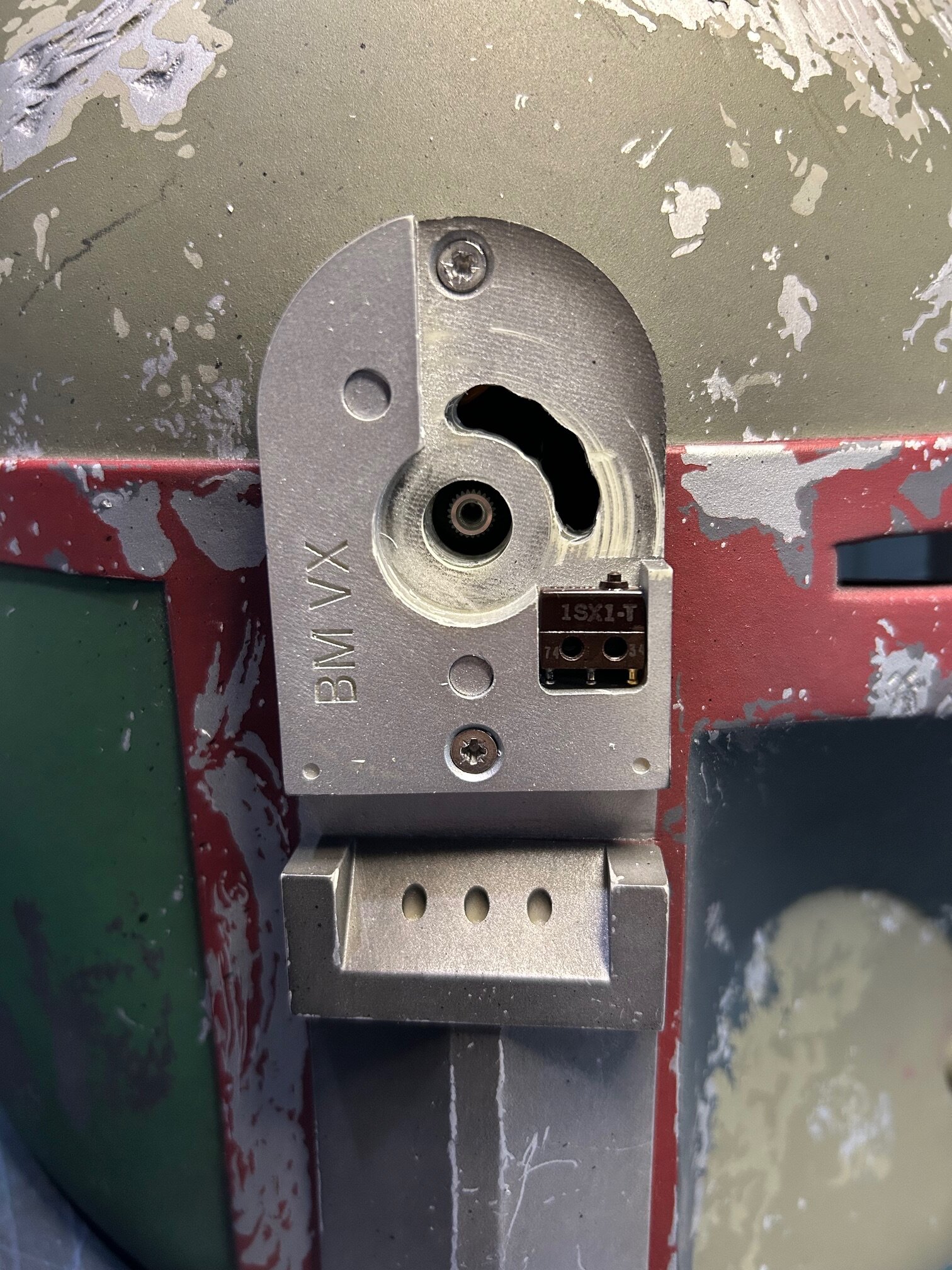

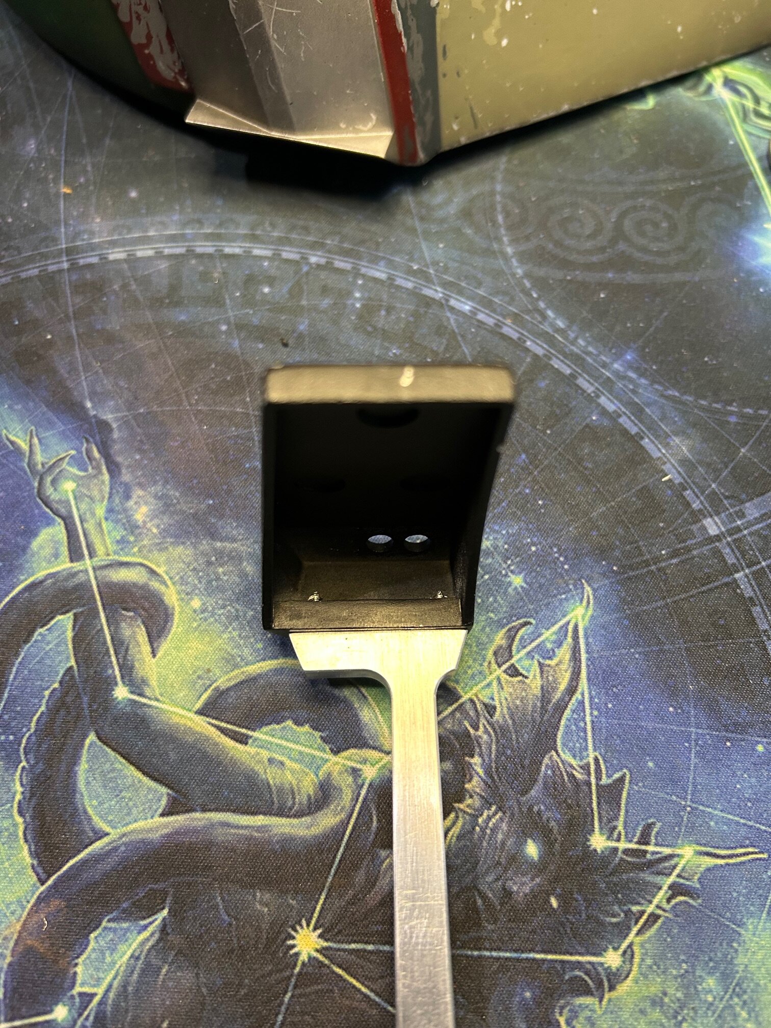

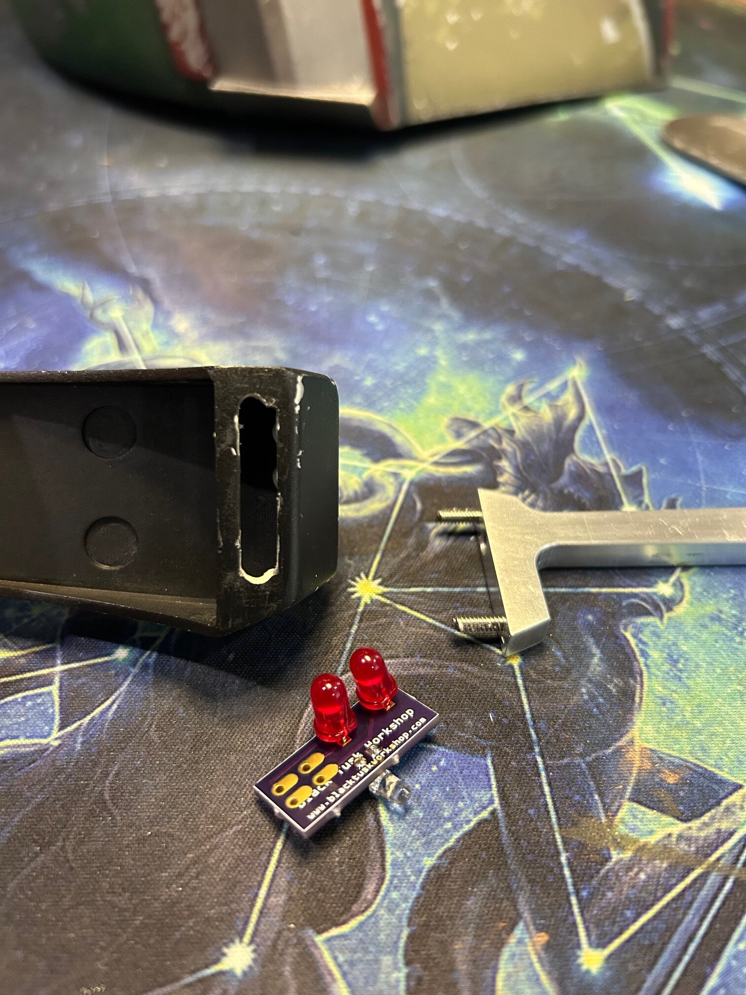

Small update today. I got the slot milled out on the earcap for the wires to go through. I expanded the hole on the base of the stalk where the wires go in to be a little longer so the wires don't rub too badly when going in. I can't actually put them in until I get the stalk weathered, but I wanted to get that part setup now.
I took the time to solder the lights onto the circuit board for the RF too. Did a quick fit check and they fit pretty well. I am thinking about using a small bit of velcro or something to hold it in so I can maneuver it around if needed. I also had to slightly mill out the opening of the BM RF topper as the two bolts were slightly too wide to fit the hole. Got some longer socket head bolts with some small washers so it should hold well.
A question on the lights. Does ROTJ Hero Fett have the white light that shines into the RF? I put it in, but I can always unplug it if it shouldn't work.

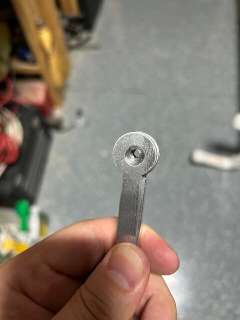

Also put the micro switch in to make sure it fits. Its a hair loose, but I don't want to glue it in until I know if it needs to be higher or not. Moving it higher may present an issue as the top left corner is hitting the base of the stalk.
