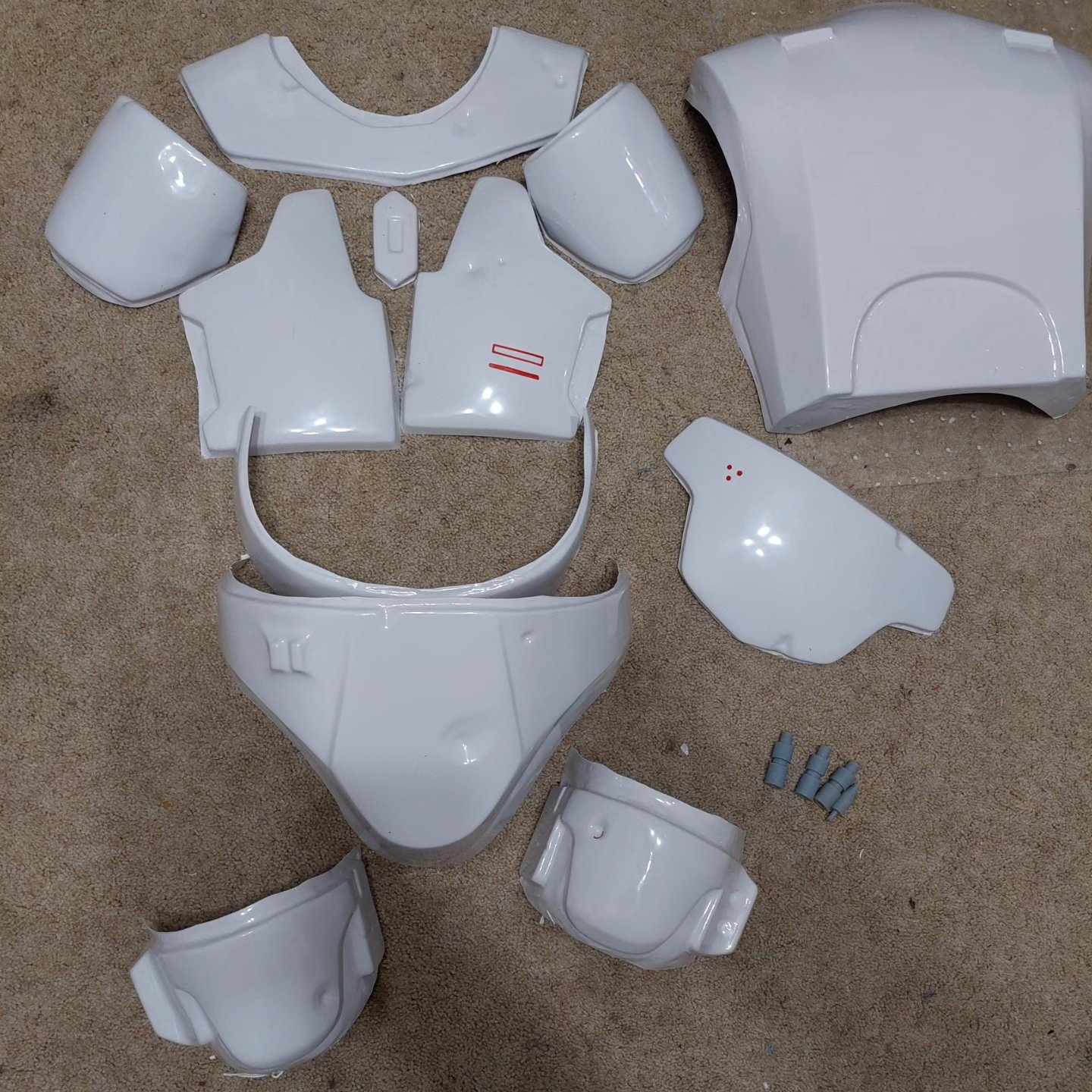

Then there is the new vac-formed armor from MinuteFett...

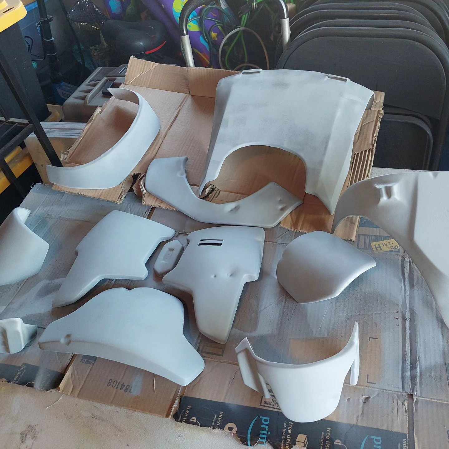

So, after hours of trimming, sanding, and prepping, I applied the first layer of primer/filler.

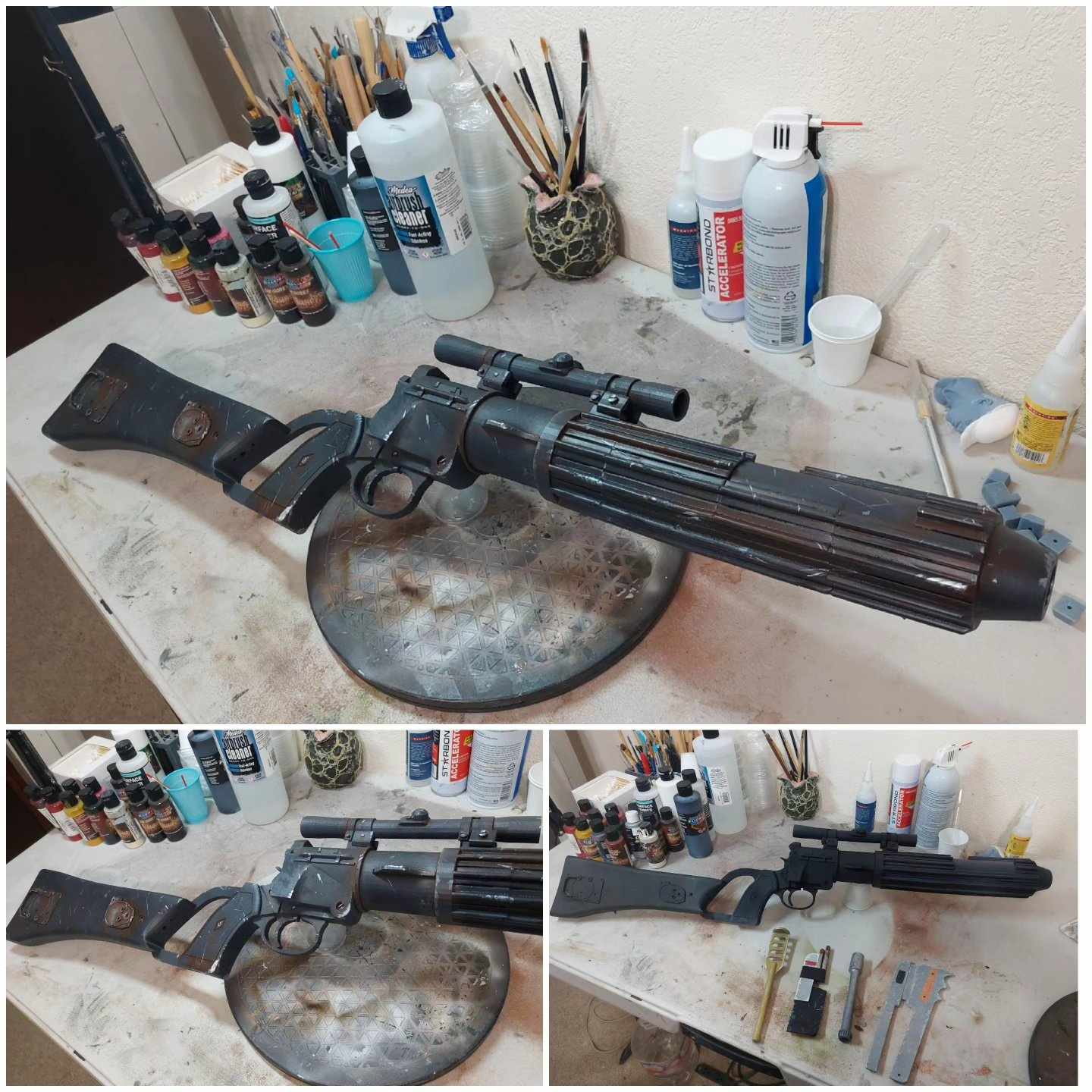

And here is my first attempt at 3D printing: the EE-3 carbine that I assembled, painted, and displayed until I have a finished kit.

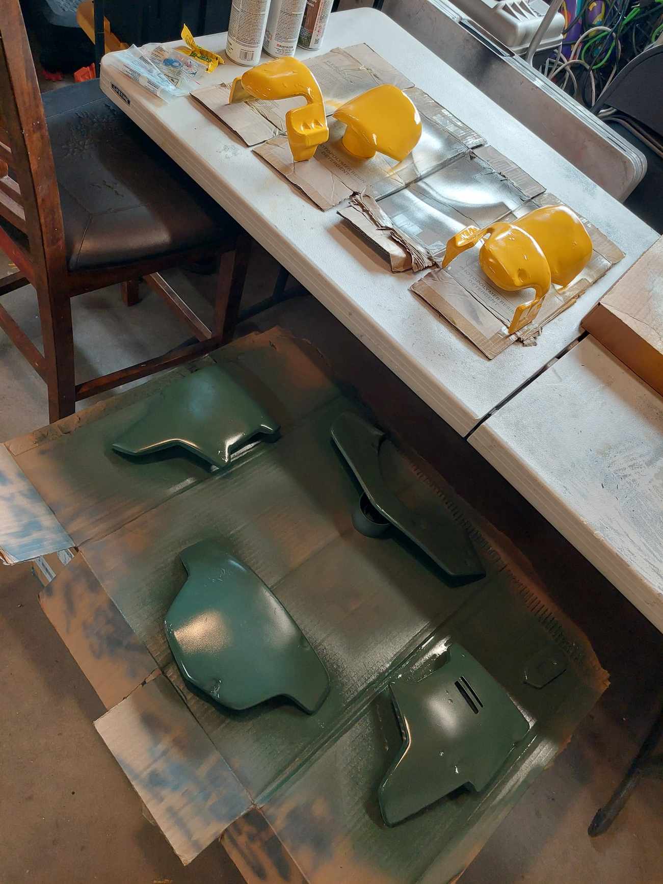

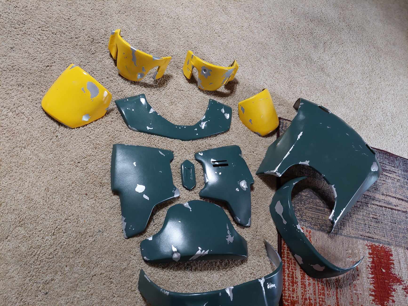

I was able to get all the pieces covered with the metallic silver base and then the damaged areas masked with masking fluid.
Next up was getting each piece painted with the base color.
Once they were all dry, I began the tedious yet satisfying process of pulling all the masking fluid off to reveal the silver underneath.

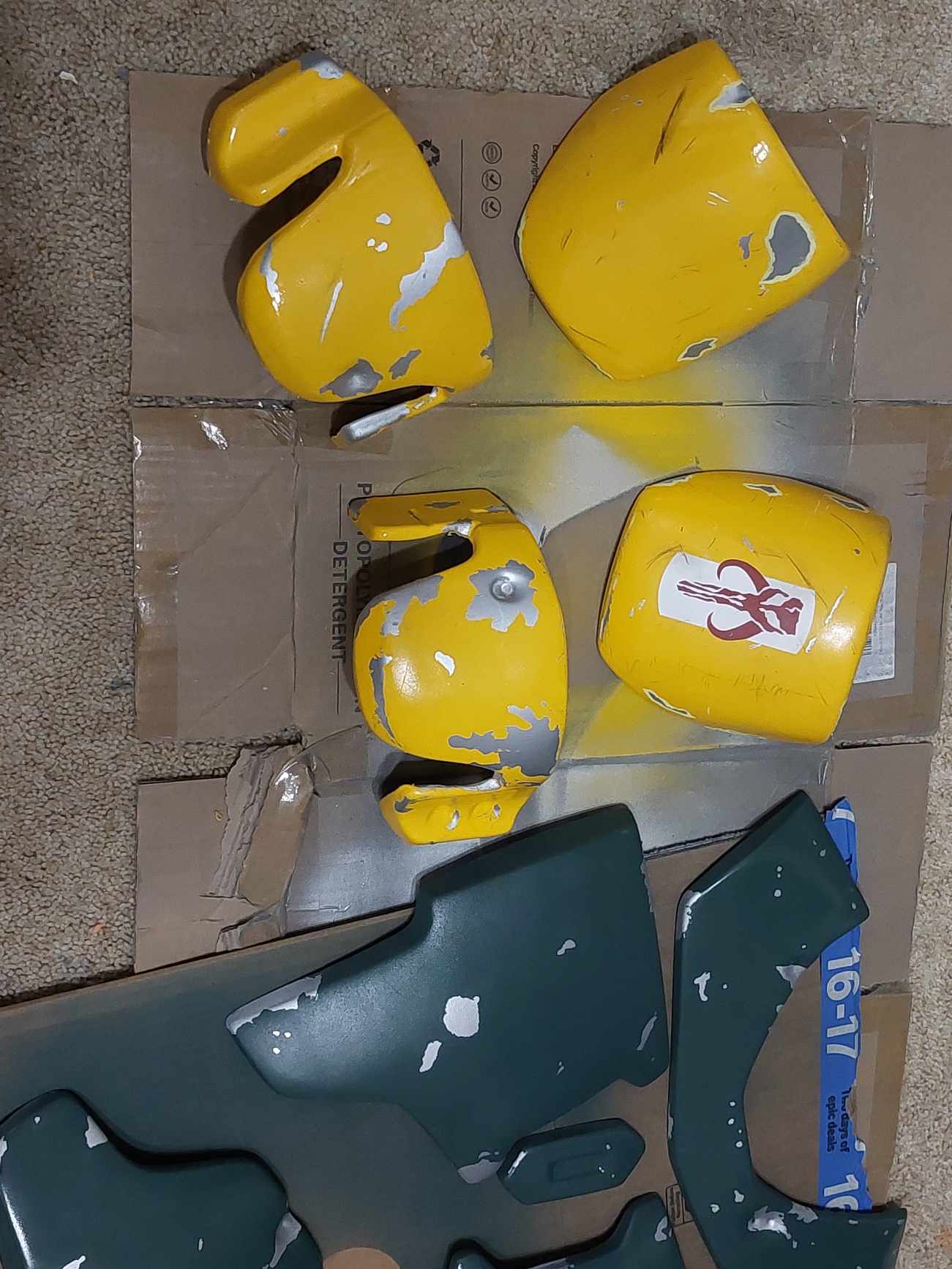

Next, I added the mythosaur skull and started to add the pale yellow around the damaged areas on the shoulder armor. I still need to finish all the pale yellow areas, add the orange tones, and continue on with the weathering, but it's beginning to look like something, at least.

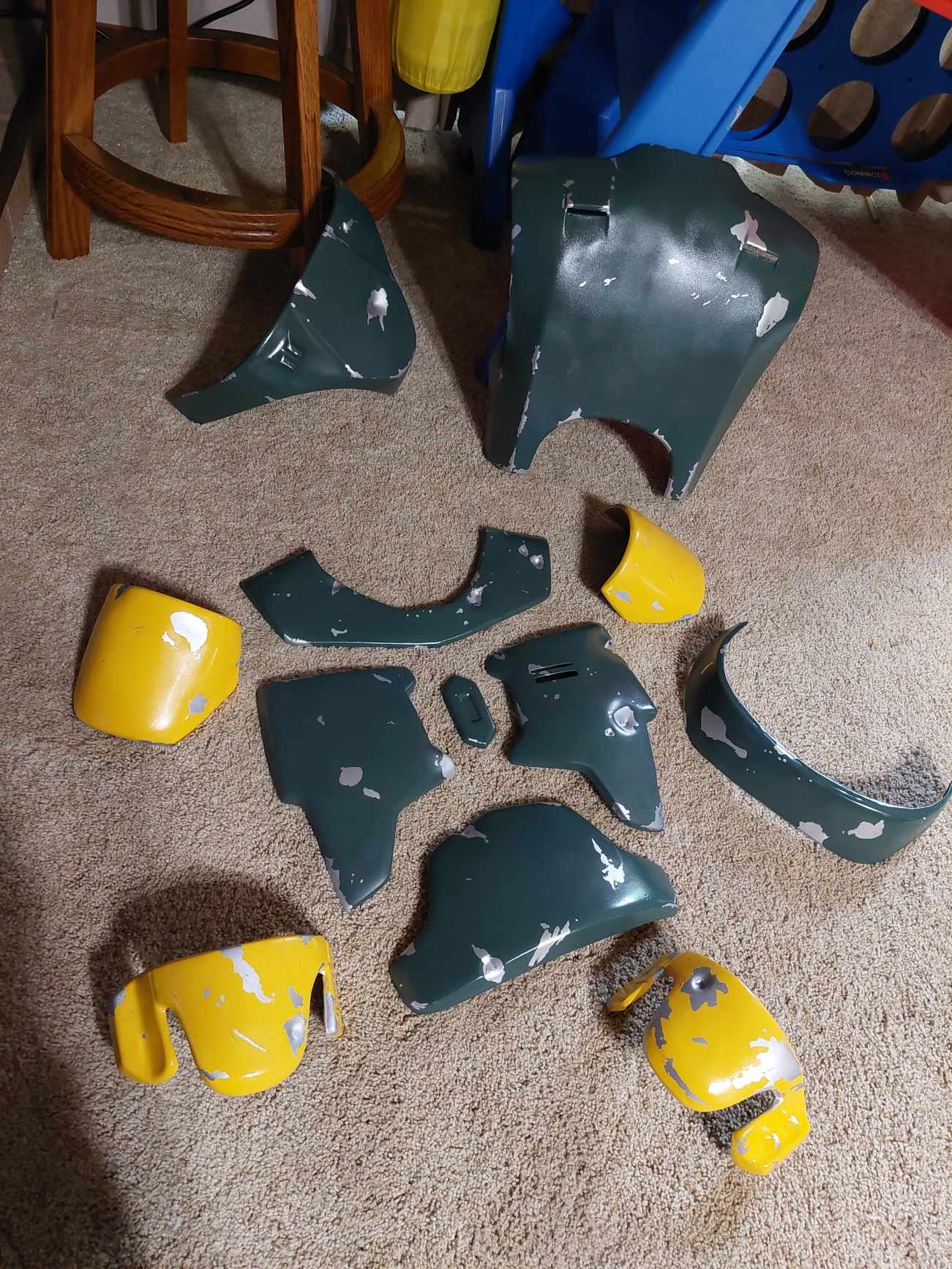

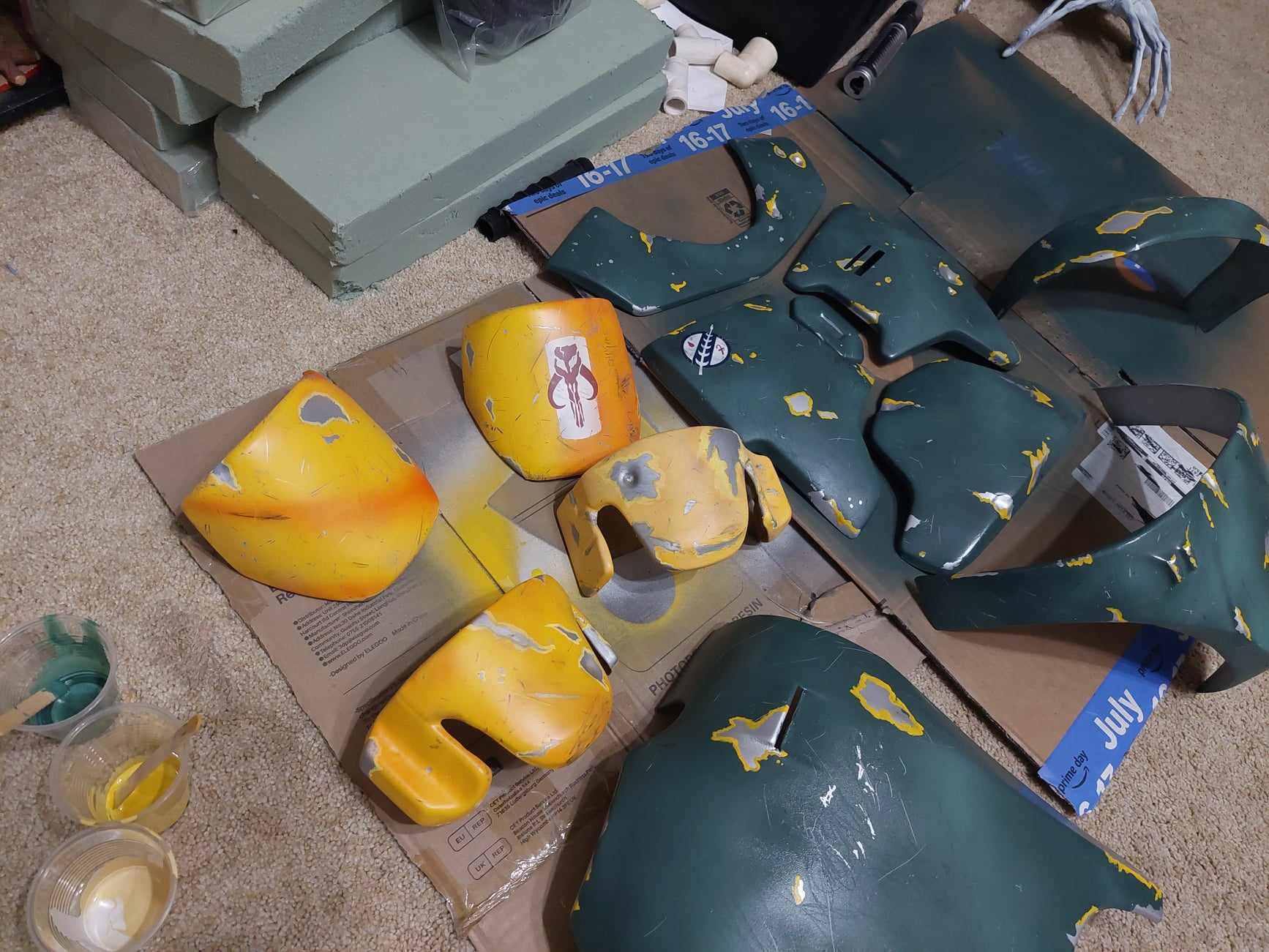

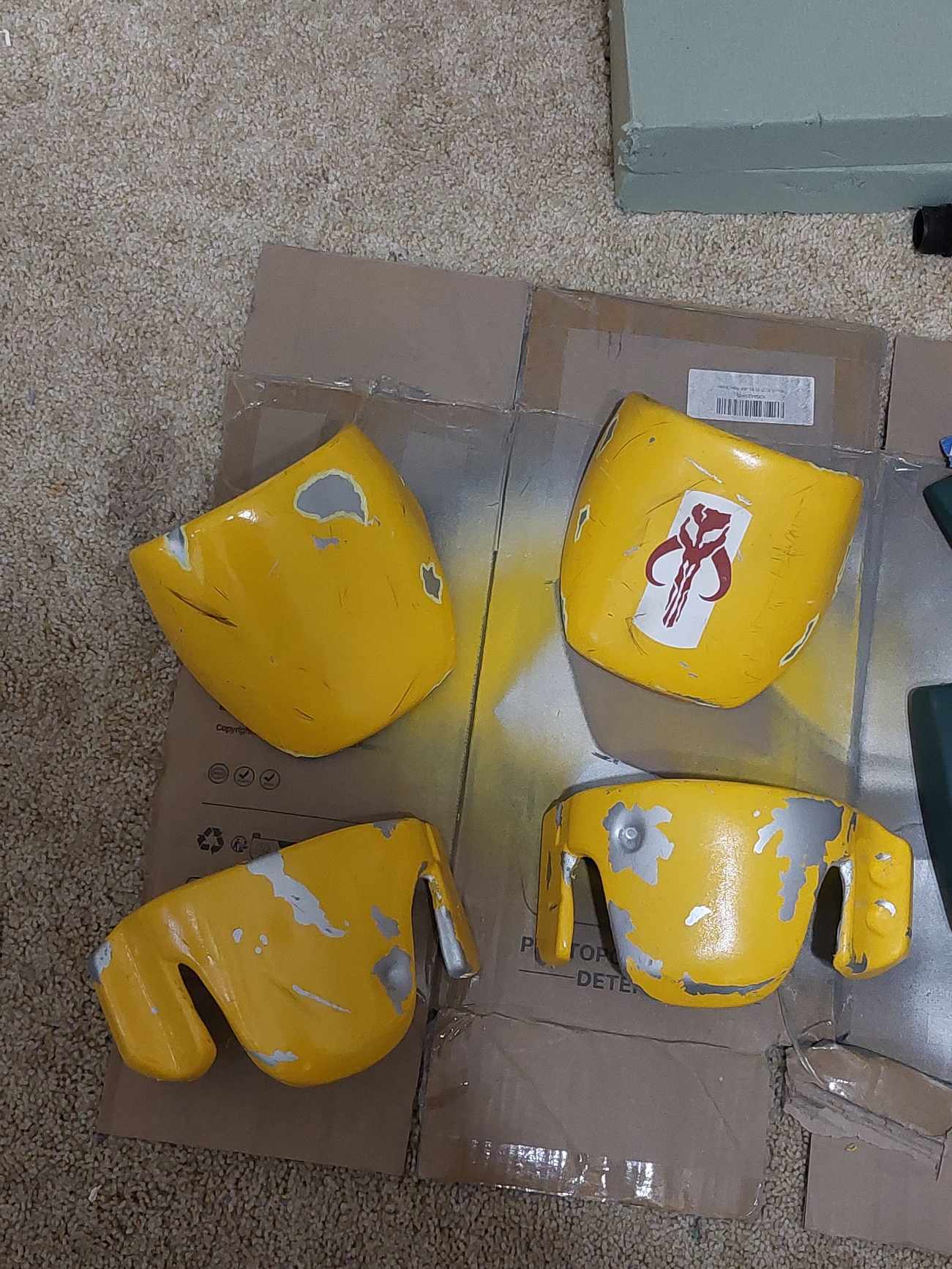

I painted and weathered the shoulders and knees. I had to play around with the colors a bit while mixing to make sure I got the right combinations since there is orange present on three of the four pieces. Since the right knee is the ROTJ Hero and the left is the PP2, I had to make sure the colors reflected that and tried to get the damage and everything to match as closely to the reference photos as possible.

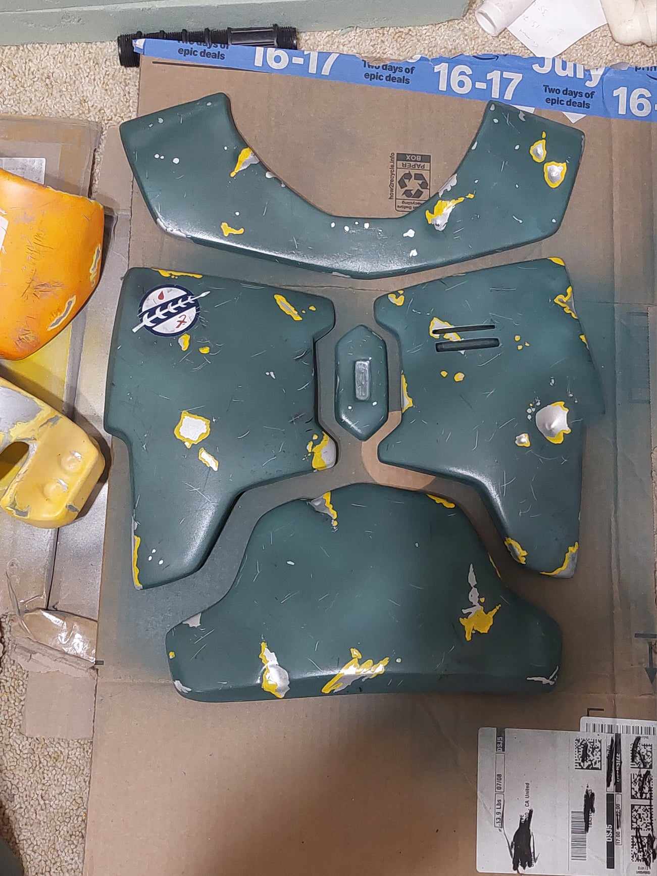

After the shoulders and knees were done, it was time to focus on the rest of the armor. I misted lighter greens throughout to show the wear and tear in areas, as seen in the references. I added the yellow edge damage, scratches, and the chest emblem. Some dirtying effects have been added, but I still need to put the black splatters and finish everything off.

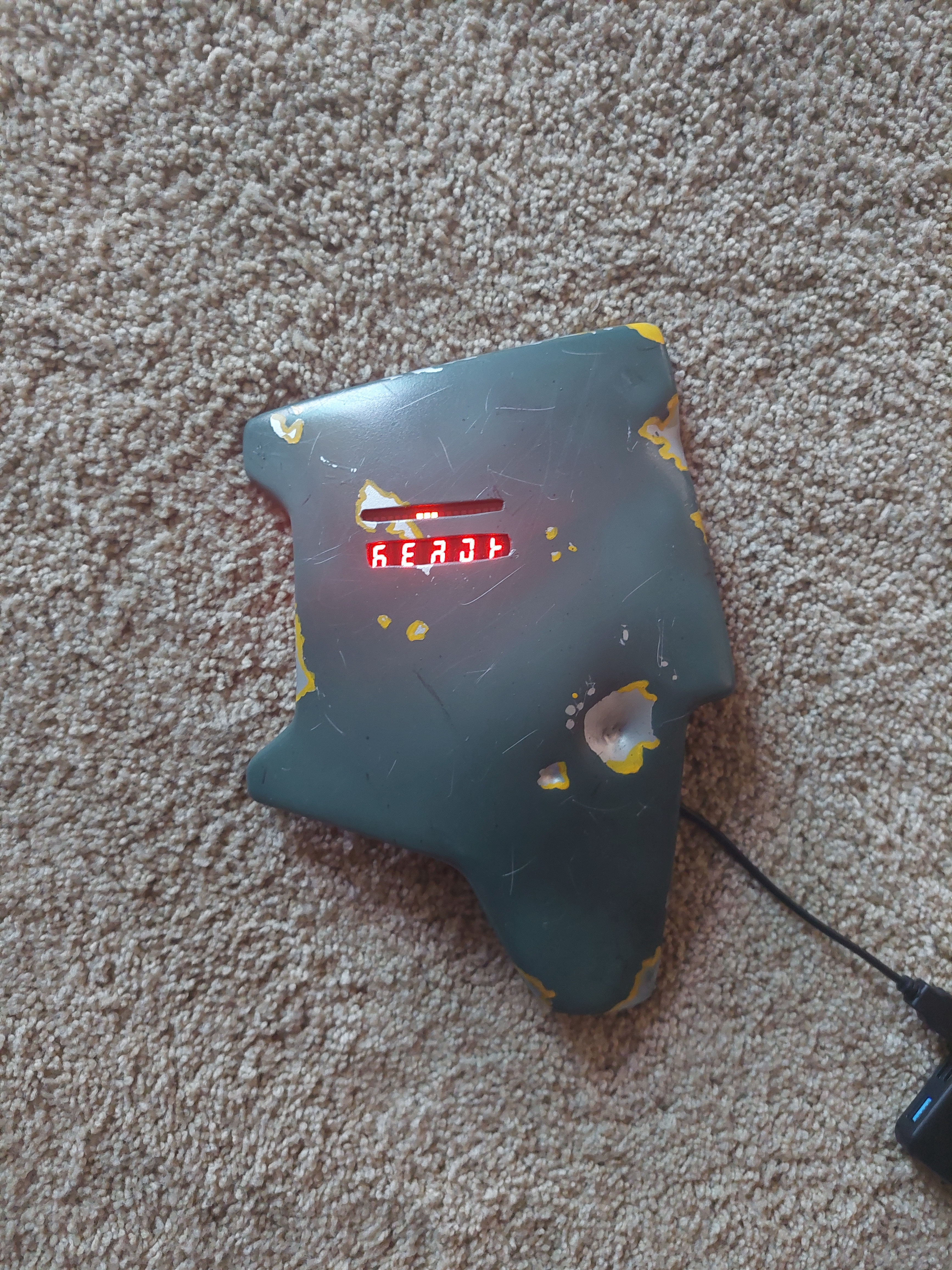

I installed the display in the chest and also trimmed all the return edges as I realized they were a little too thick in some areas. So further photos should look much more accurate.

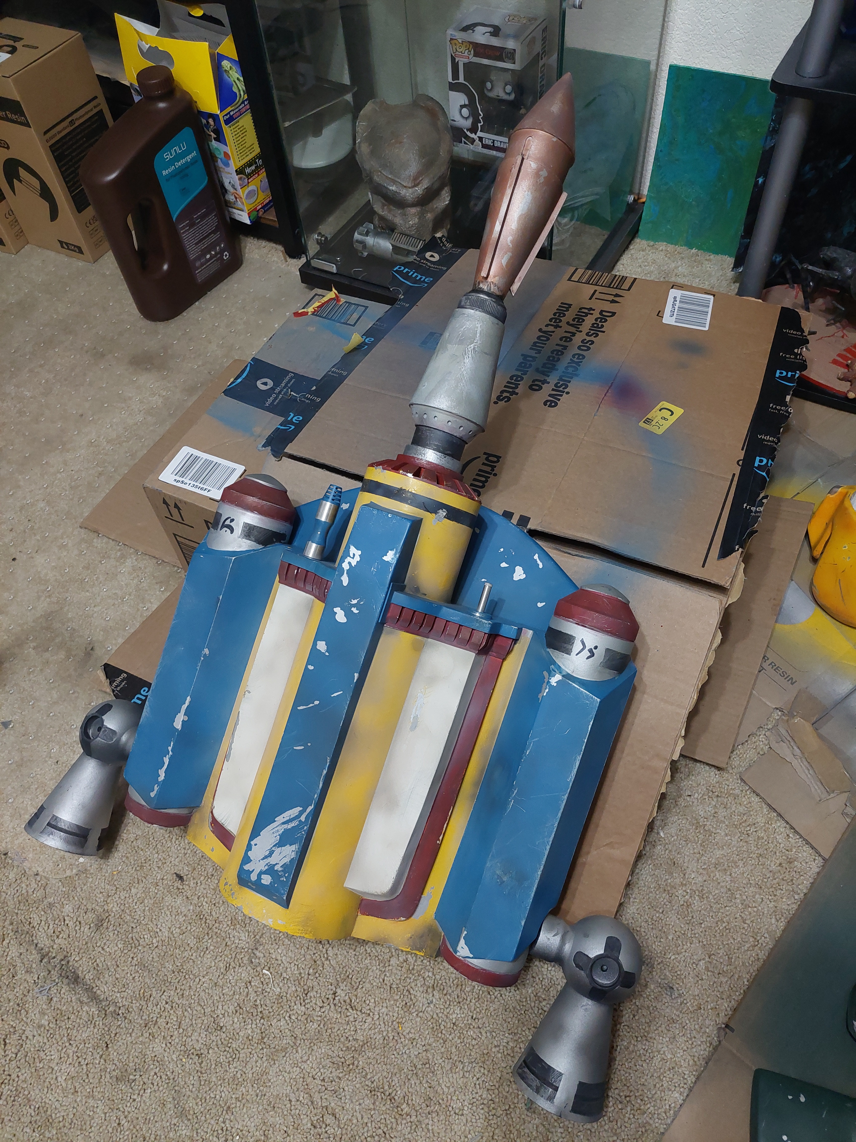

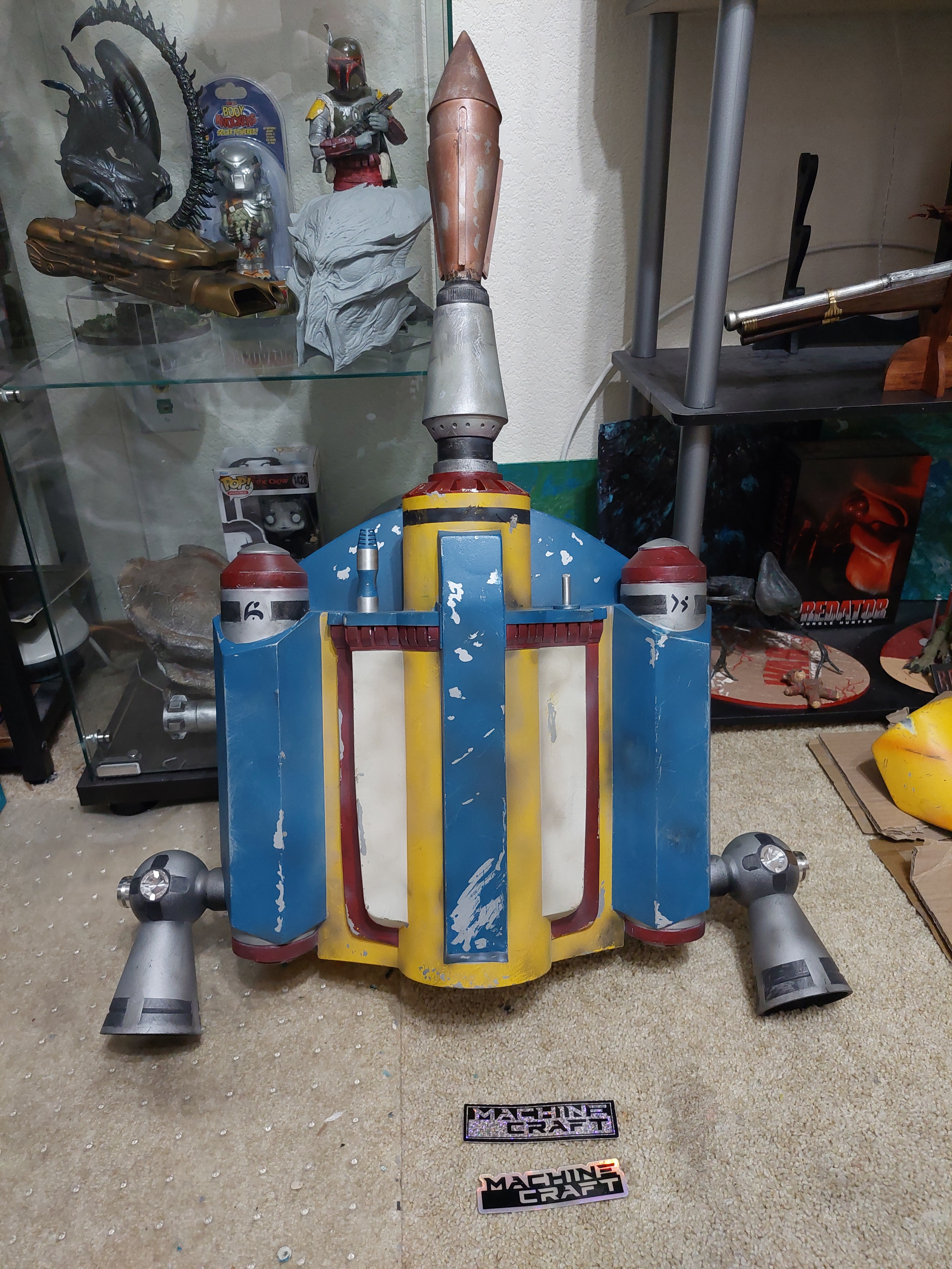

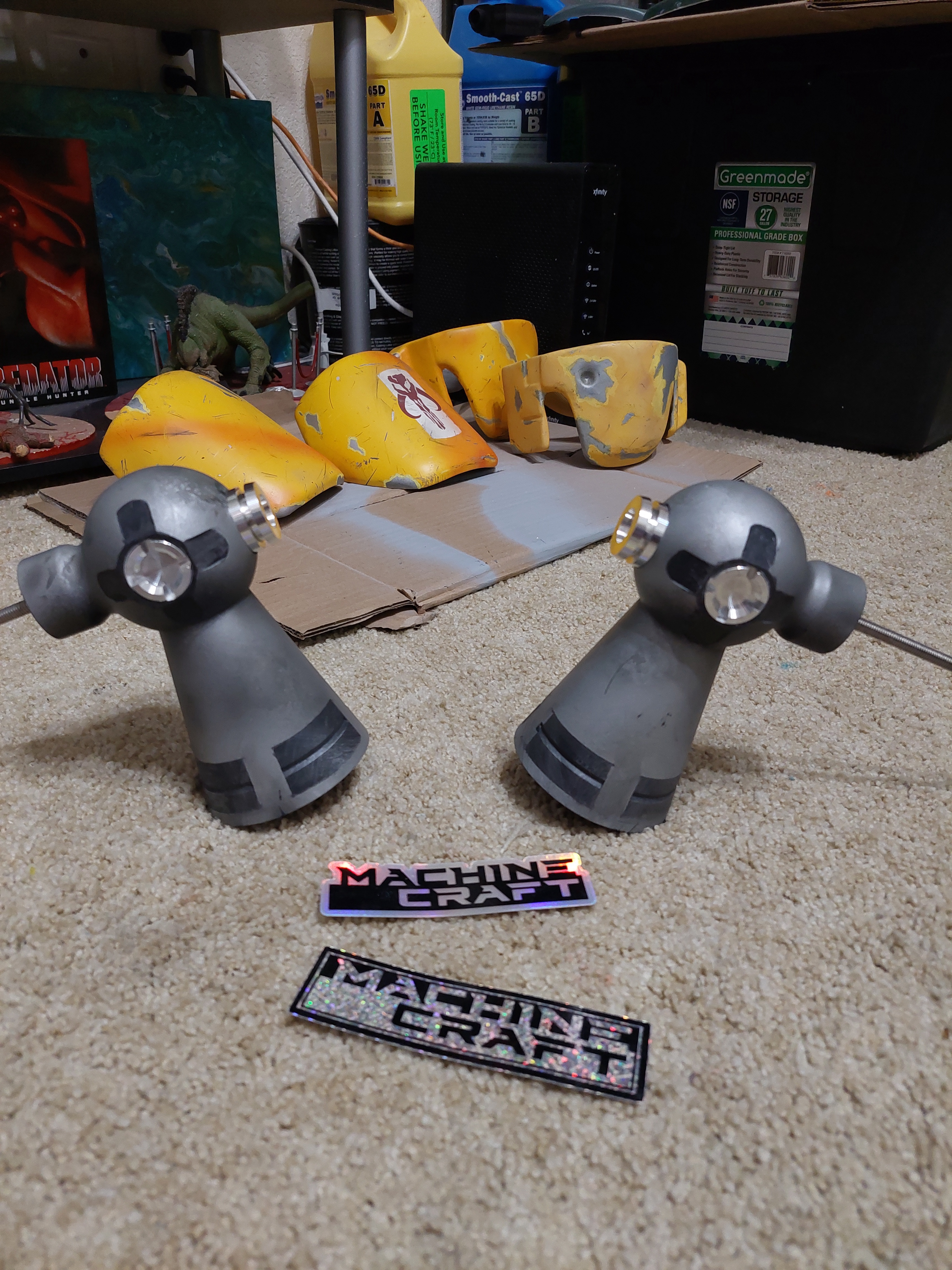

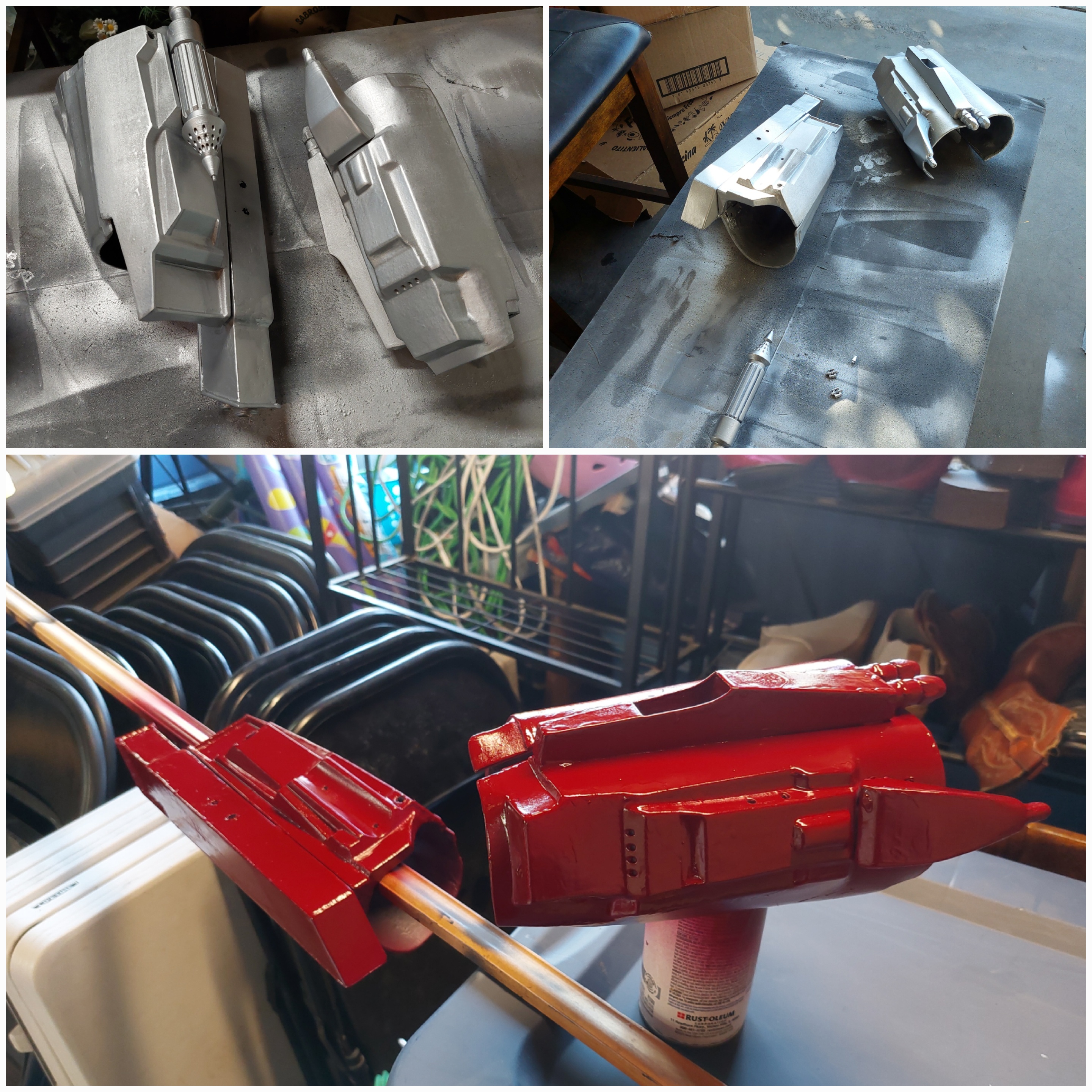

I pulled out my old Bobamaker jetpack and primed that. Fortunately it's survived all these years and only lost a thruster so I just had to print two new ones from MachineCraft Replicas as a replacement. After I had all the pieces together I painted it.

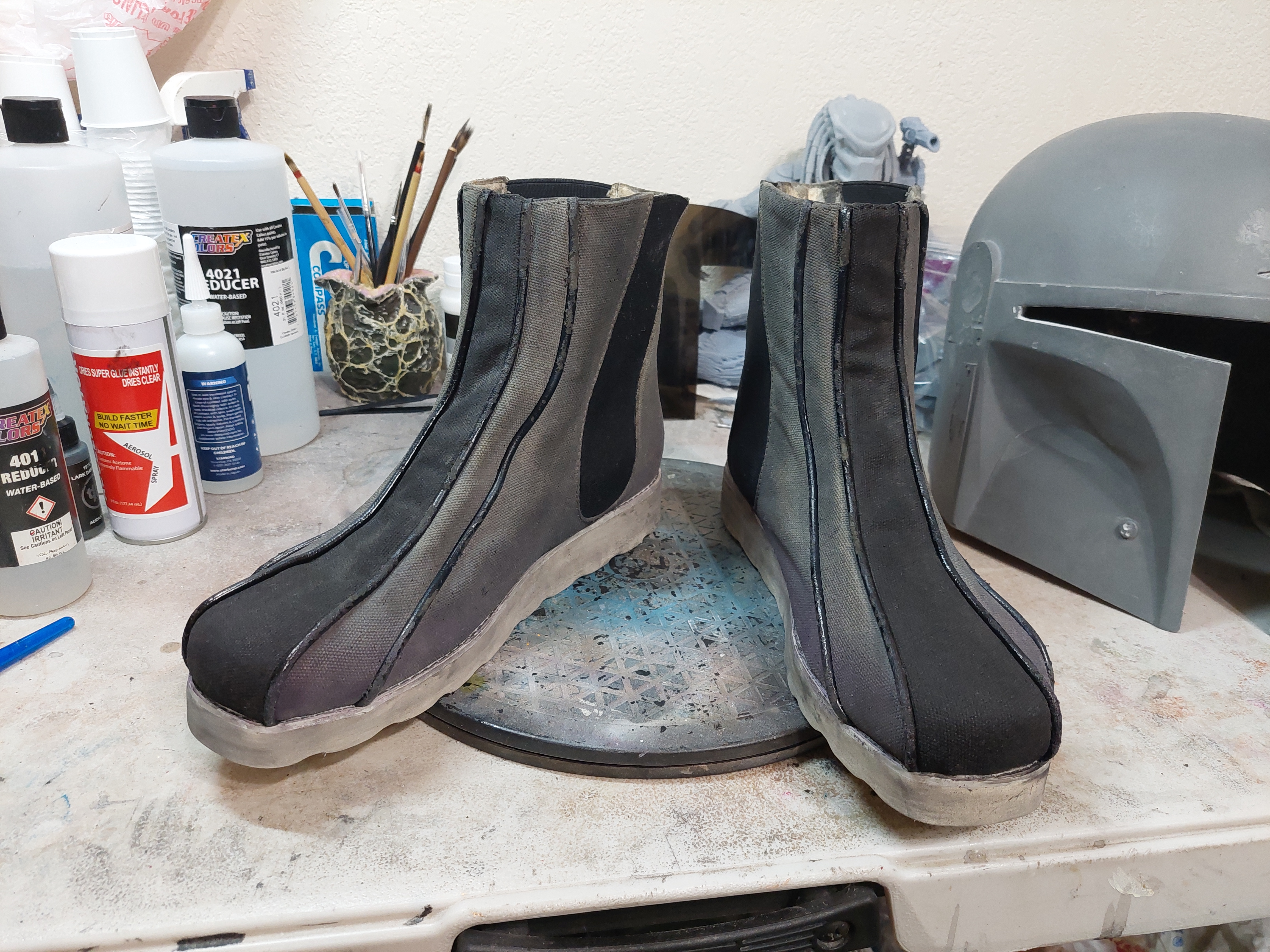

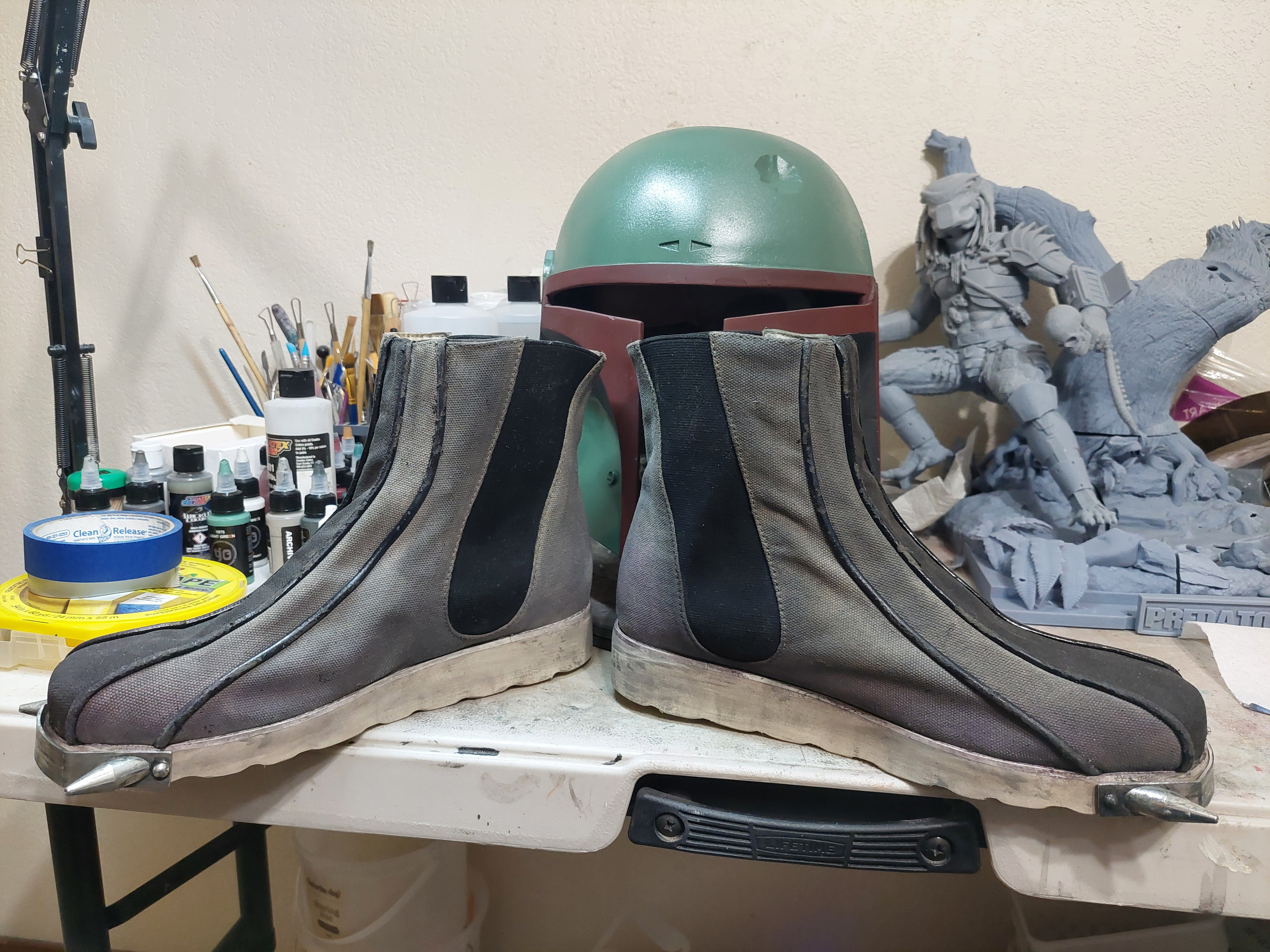

Then I switched over to footwear. I took my old MOWS and painted and weathered them. Now I'm just waiting on the toe spikes from MachineCraft Replicas and I can finish that part.

The jetpack greeblies and toe spikes came in so I got those installed...

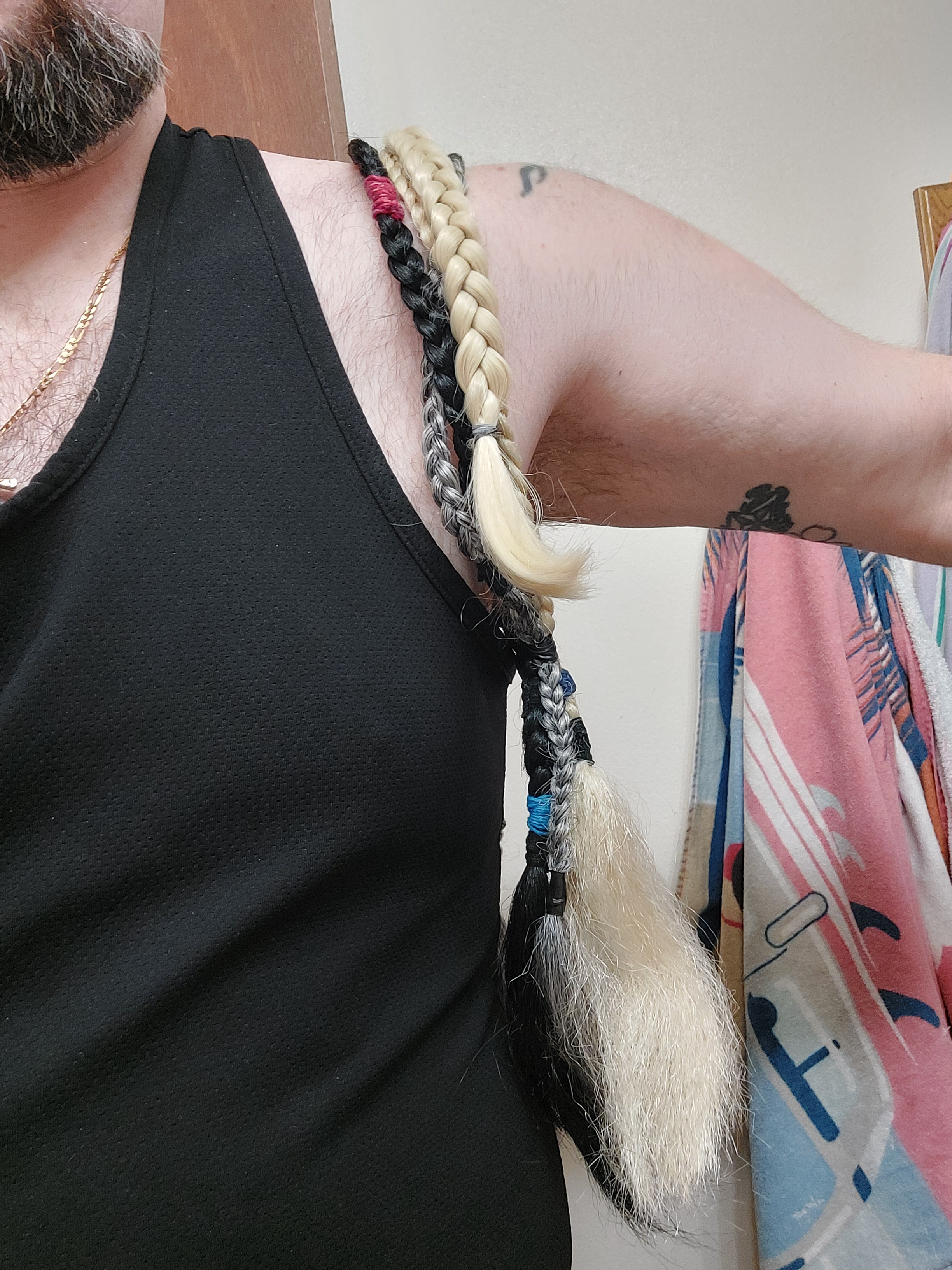

Then I dyed some thread brown, blue, and red and braided a bunch of hair to make some braids. The ROTJ SE braids aren't the easiest to see clearly in the promo photos, but I think I was able to replicate them as best as possible along with the CRL. (The one of me wearing them may look odd because it's reversed due to it being in a mirror.)

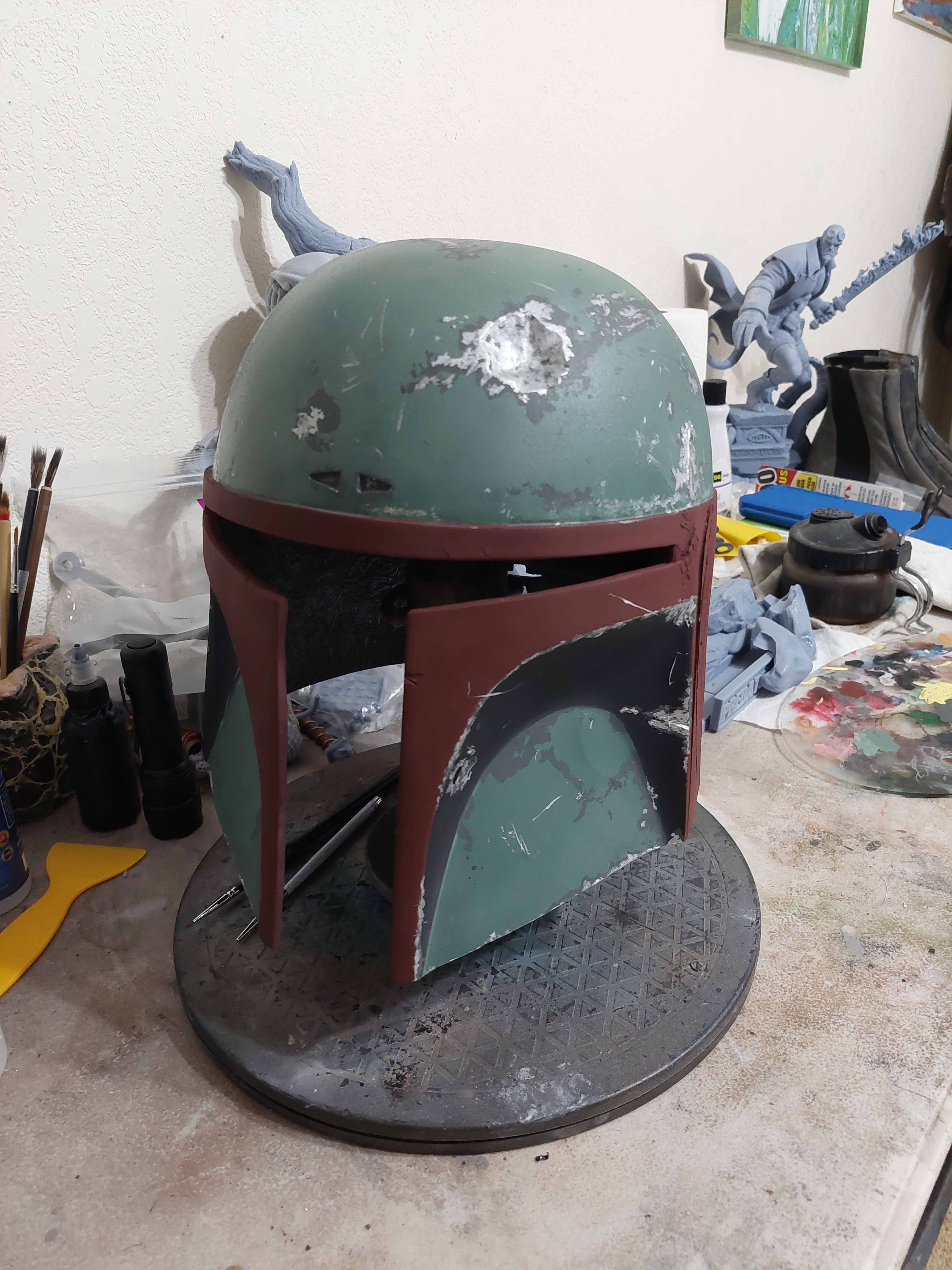

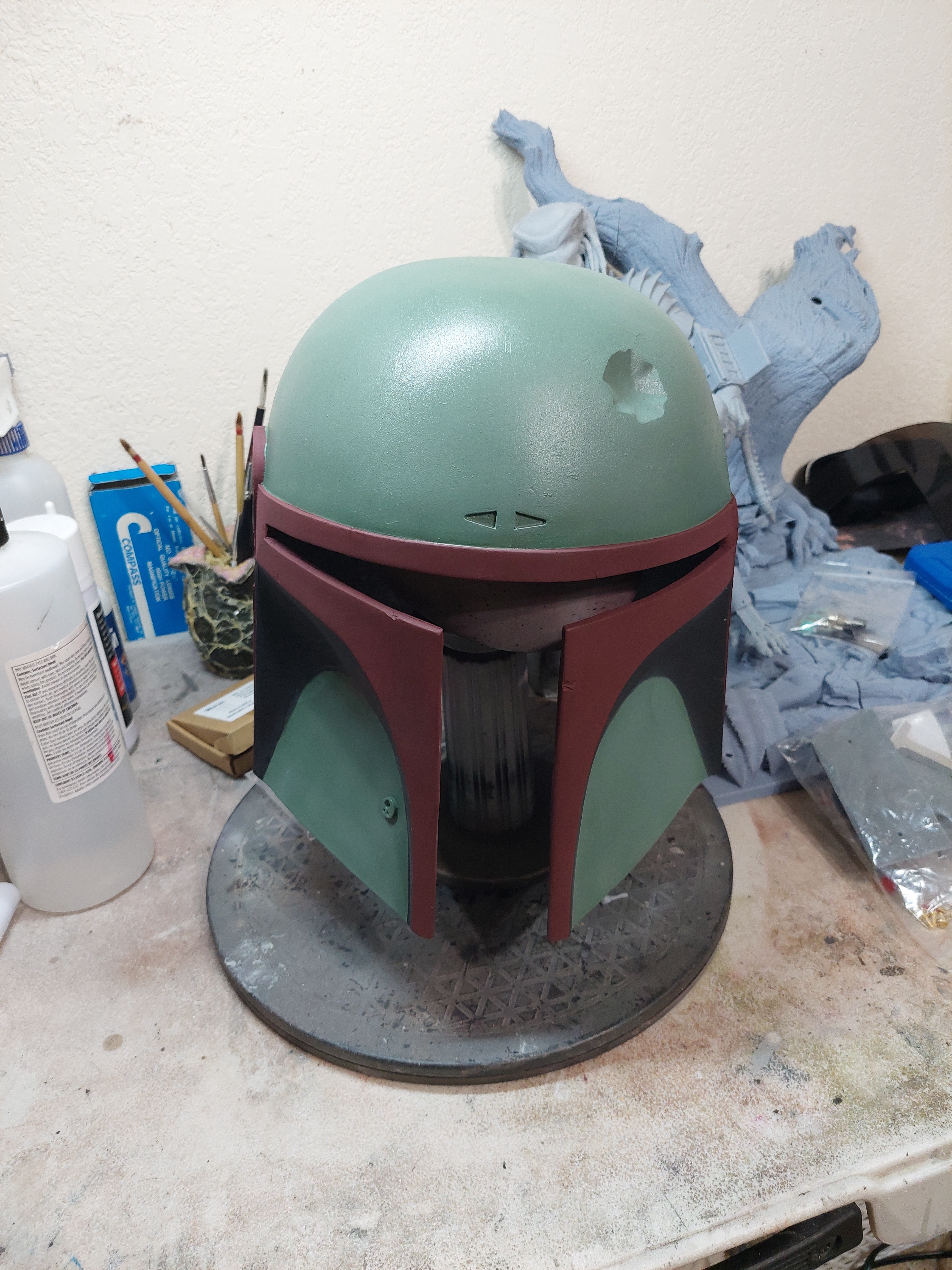

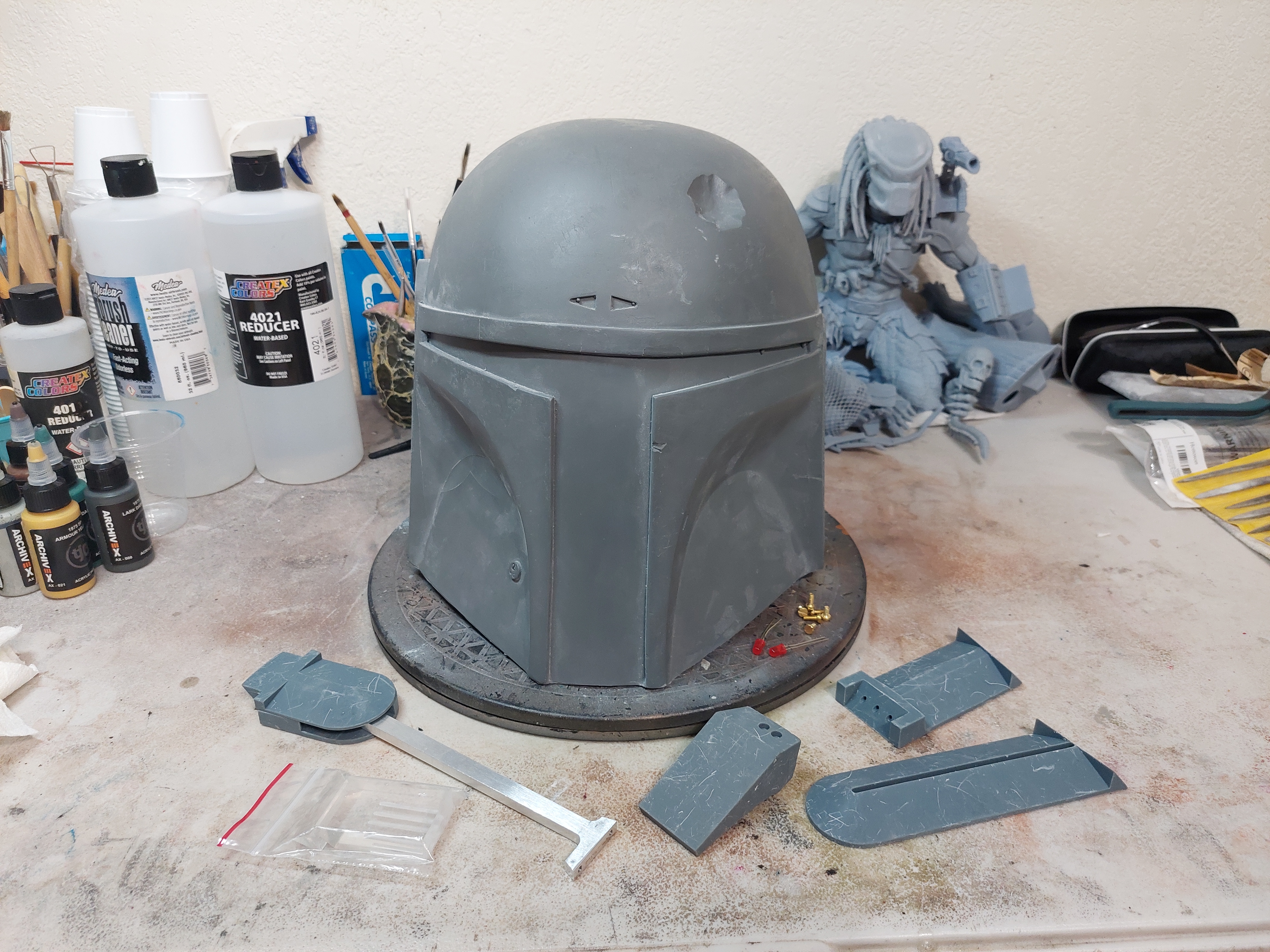

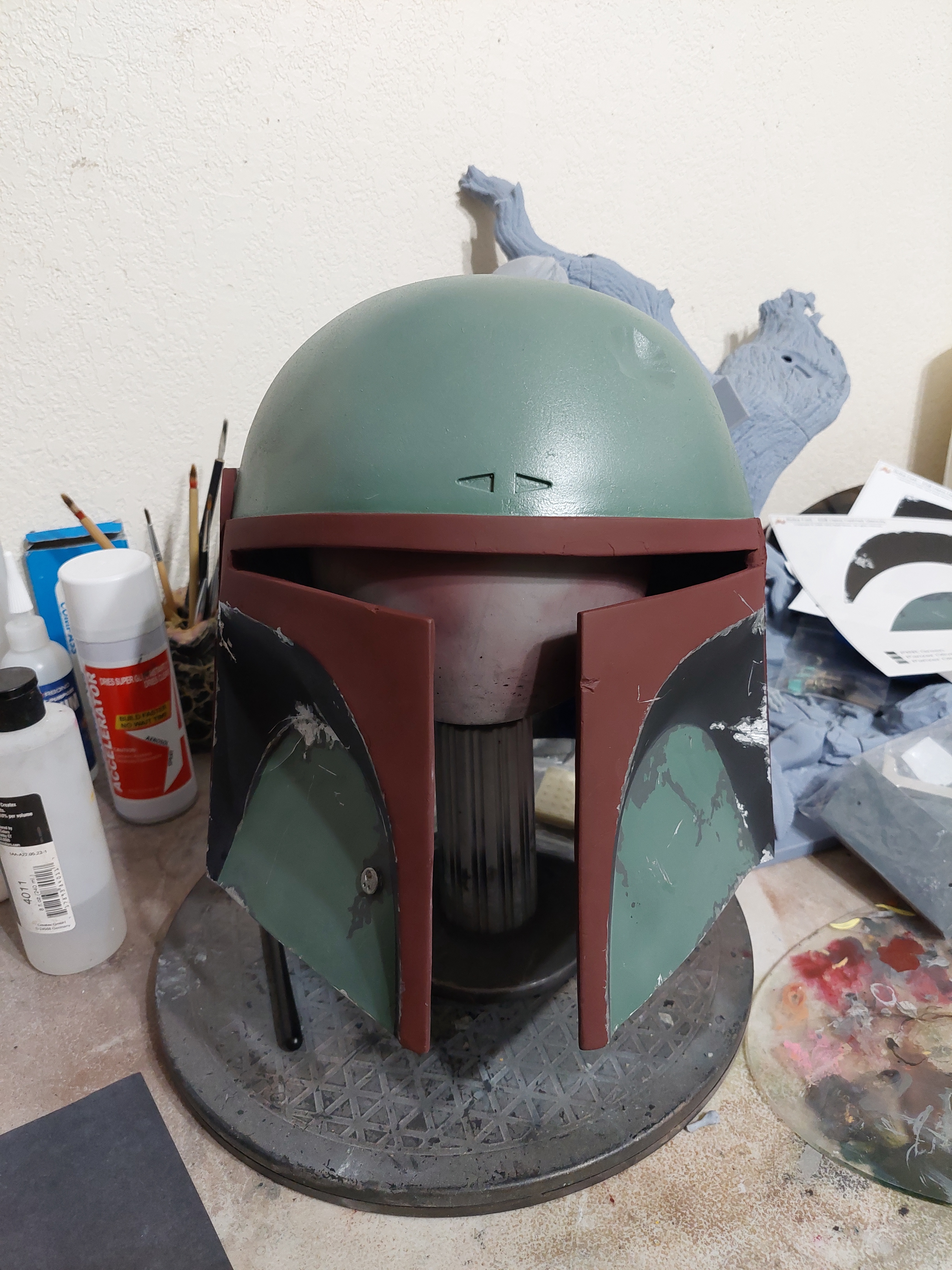

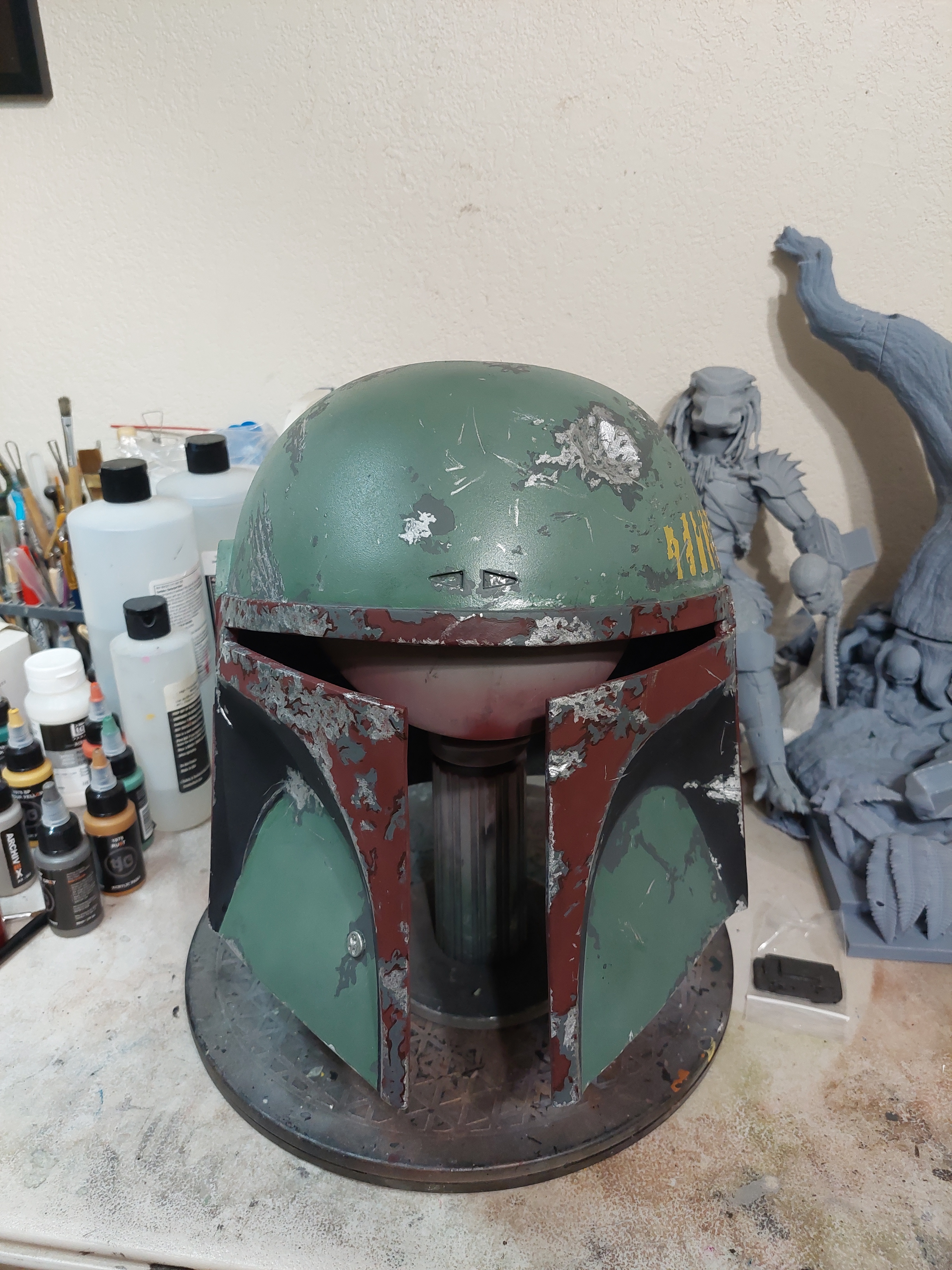

Then it was onto the helmet. I cut out the visor and slots on the back for the MQ-1 piece, then began the paintwork. So far I've just got the base colors down and I'm just getting into the detailing.

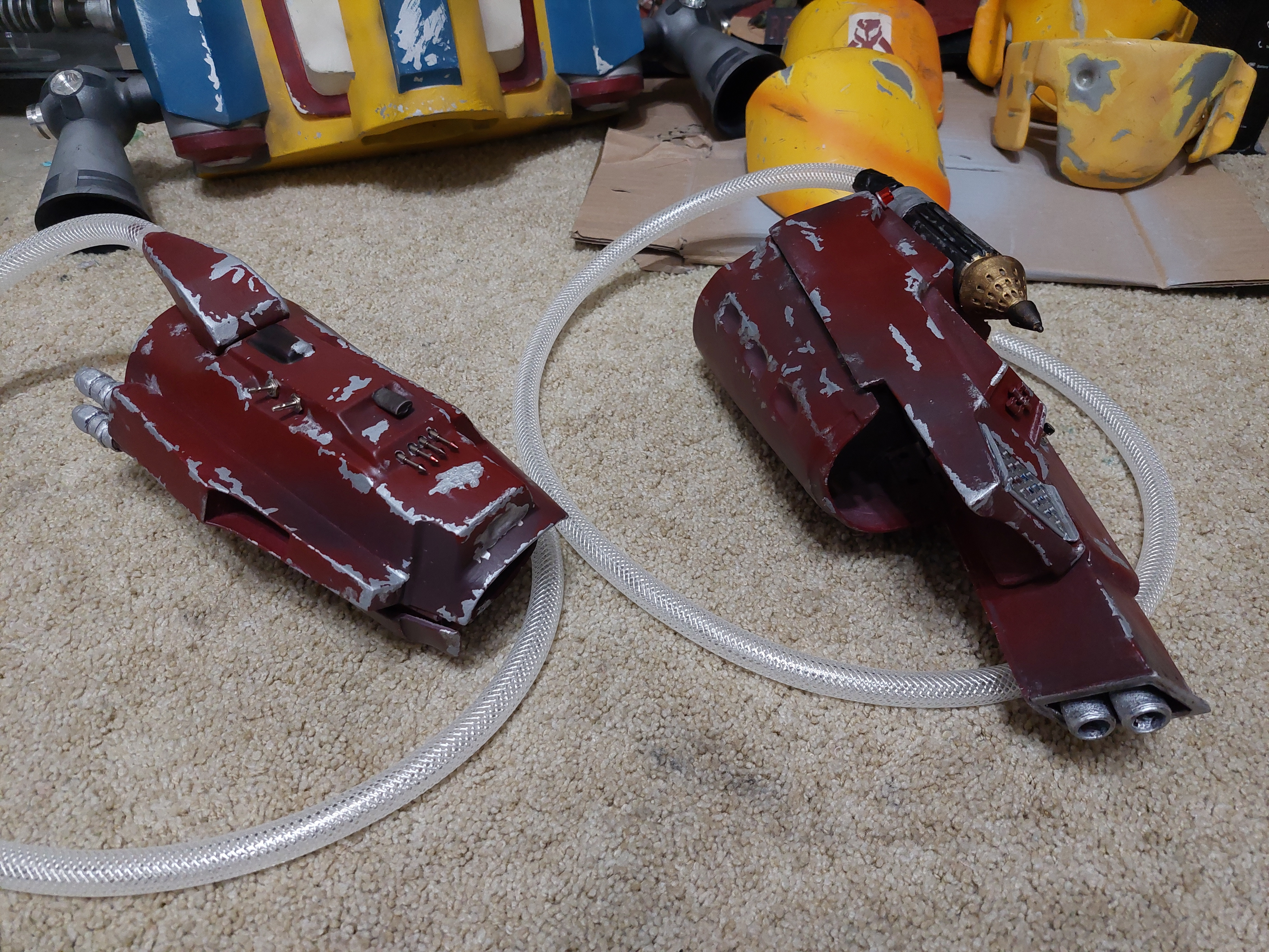

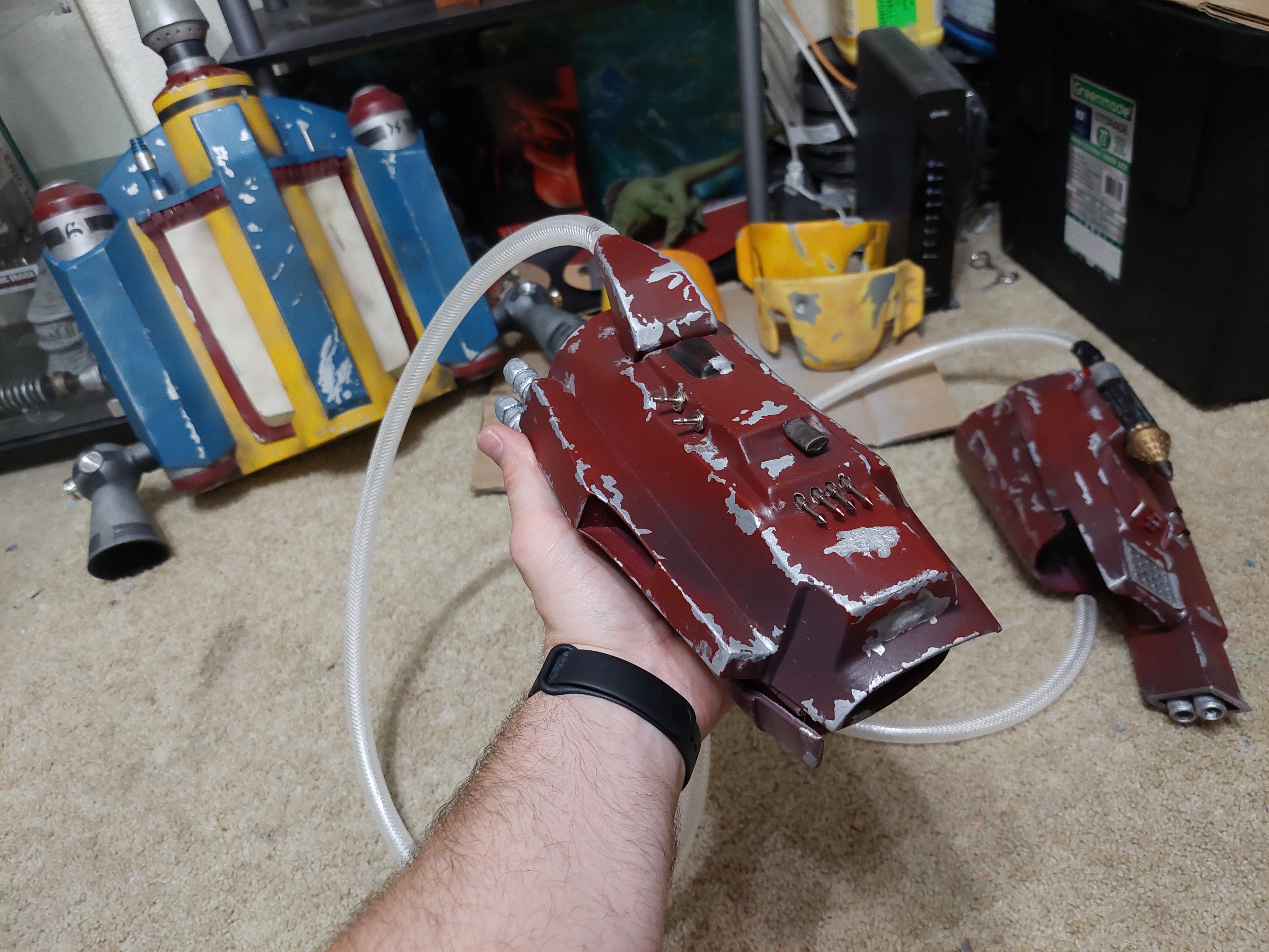

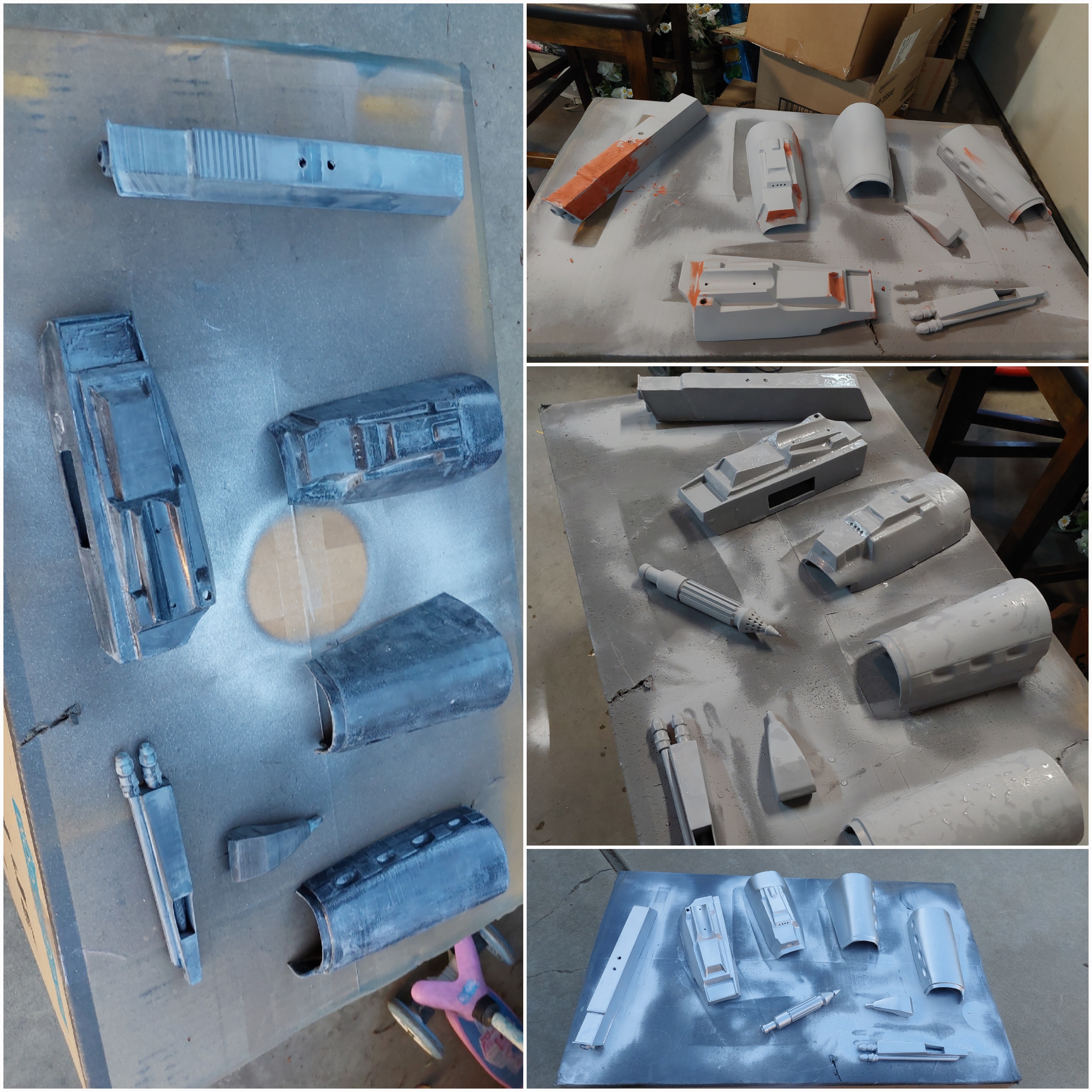

I was able to spend a little time this weekend and get started on the new gauntlets. They're 3D printed and then strengthened with fiberglass. After sanding and filling, I applied the silver base and then masking fluid. The red tone has been put on and once dry I'll be able to start working on the weathering and remove the masking to reveal the silver.

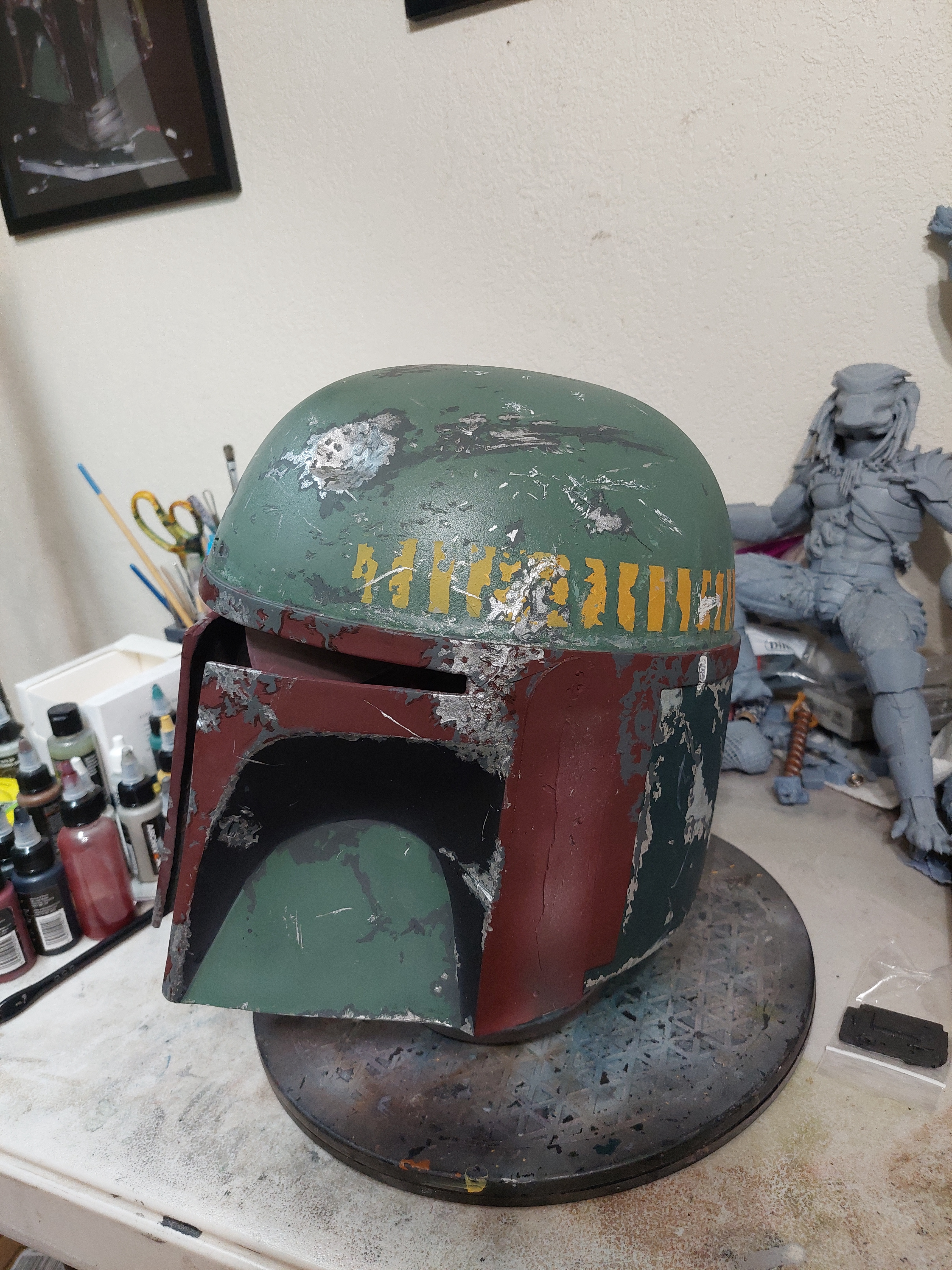

While the gauntlets dry, I worked on the dome of the helmet. I was able to get most of it done, and will tackle the killstripes next before finishing the last weathering/damage, and then get to the mandibles and ears.

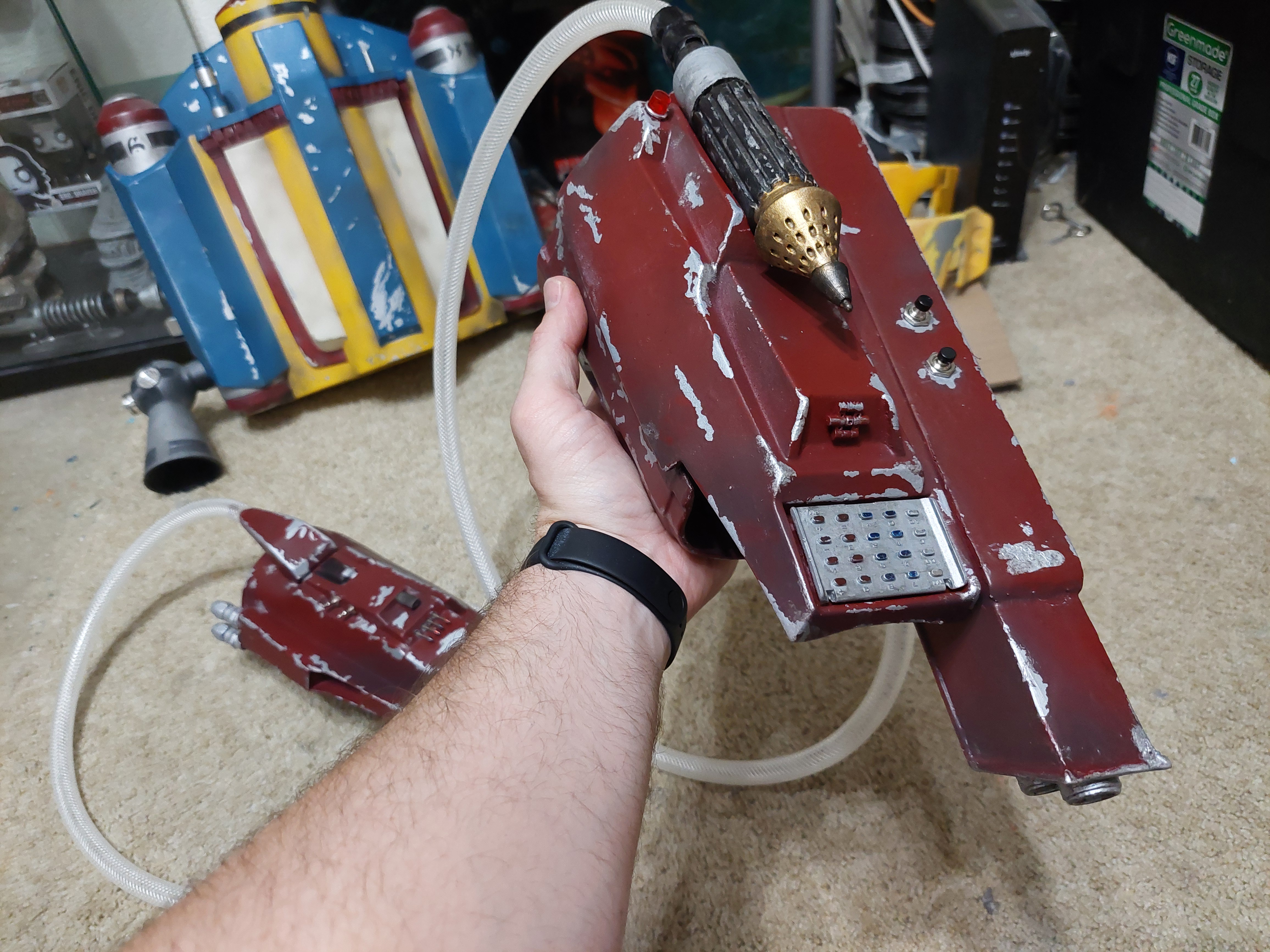

This week I was able to get the final touches of the gauntlets done. All the paint work was done, then Alco switches, red light, momentary switches, darts, and Mq-1 keypad were all installed. I'll need to weather the hoses as they're too new and the tape holding the one to the rocket will be replaced with silver tape when I get some, but other than that I'm happy with how they turned out.

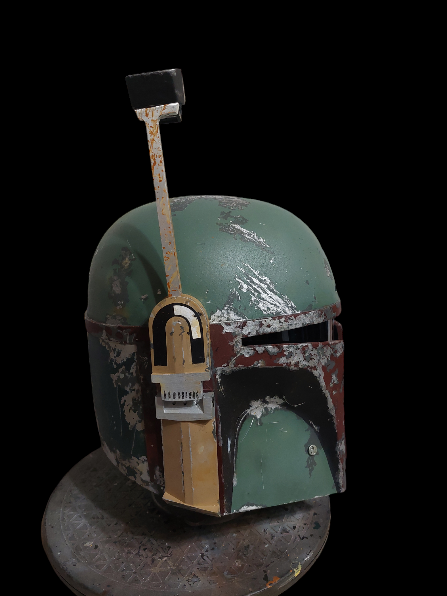

Then for the helmet... I added the killstripes and further SE damage/details. The front mandibles now have their damage, now I need to work my way around to the back of the red areas and keyslot area. Then it'll be onto the ears before I do the final weathering all over.

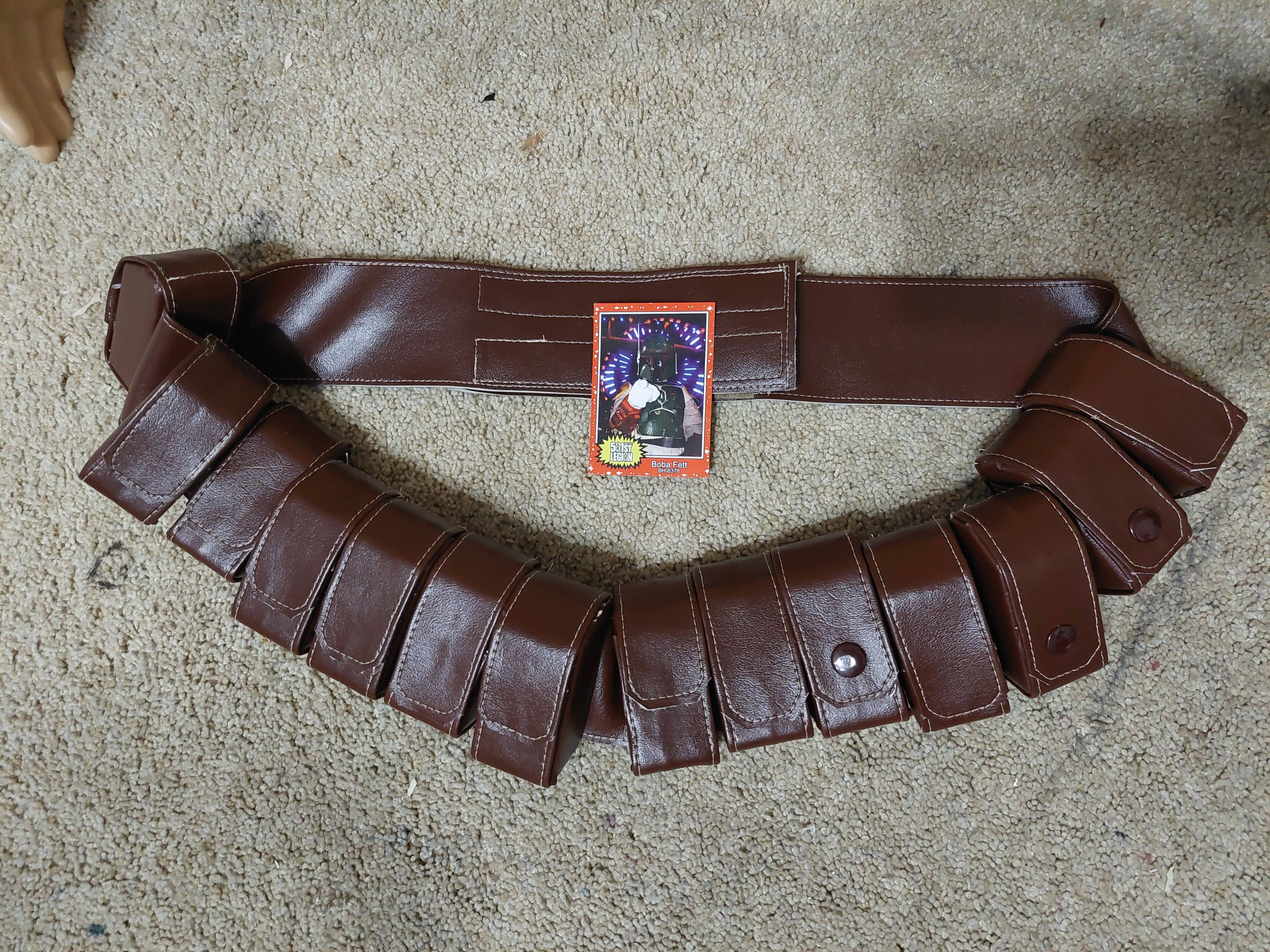

Pretty stoked that I've had a few different items arrive for the kit recently. The new girth belt and ammo belt have both just shown up and look great.

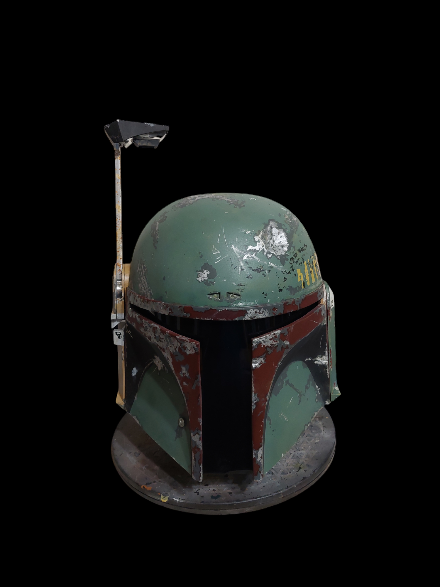

Also, the outside of my helmet is now complete. I finished the extra scratches, black and white marks/paint, crack repair, and the other various details that distinguish the SE from the ESB. Next up will be the interior.

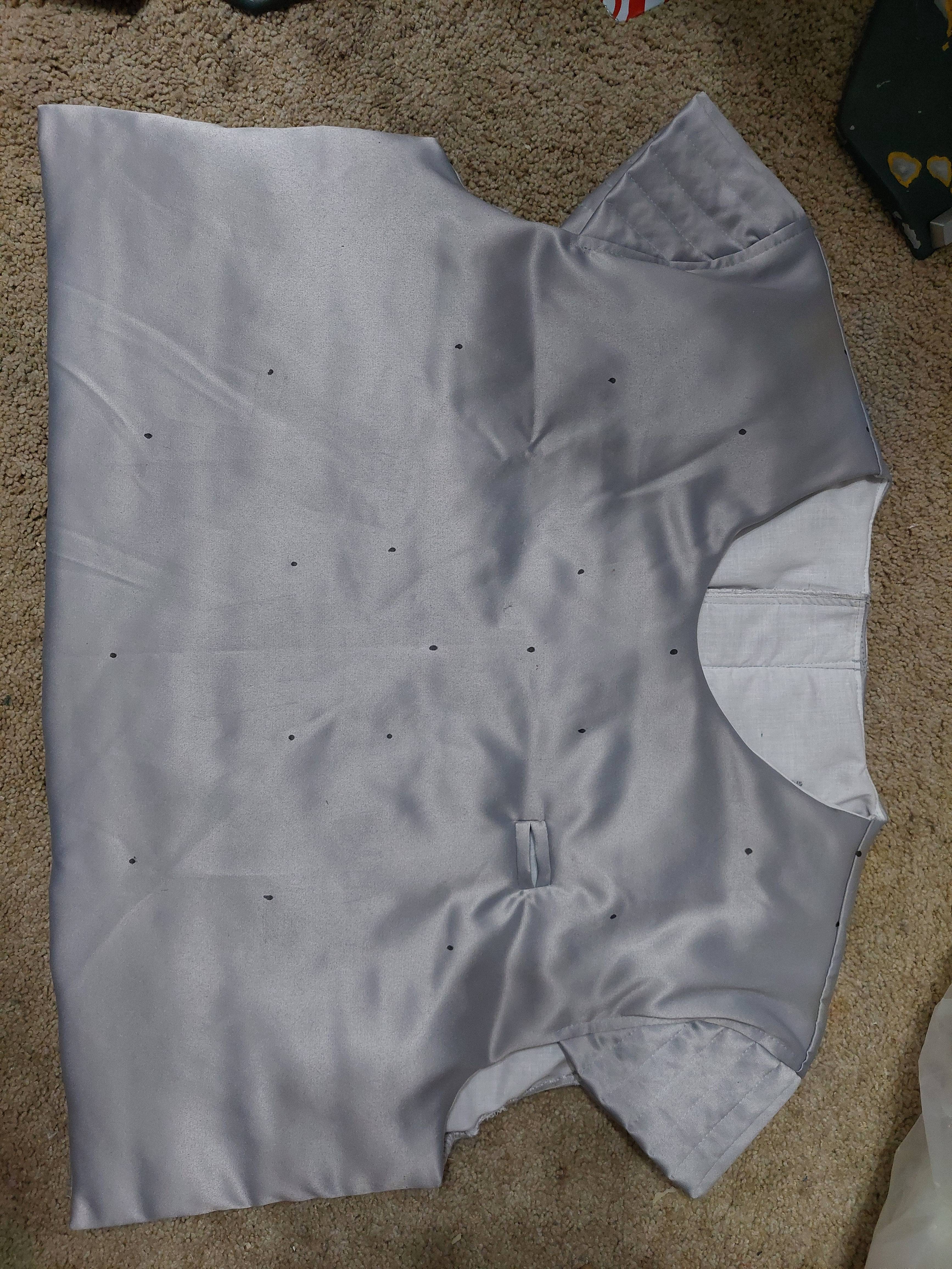

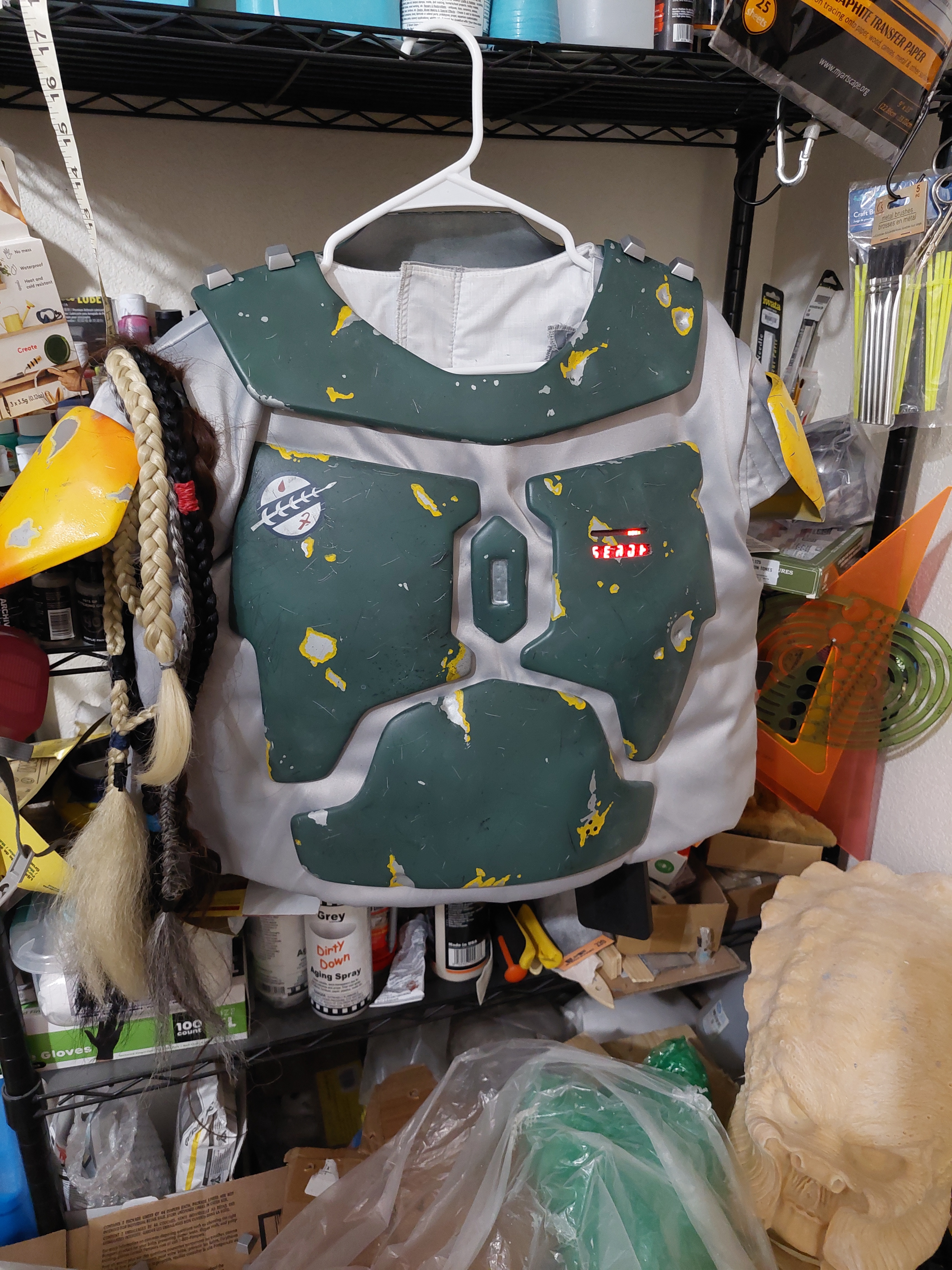

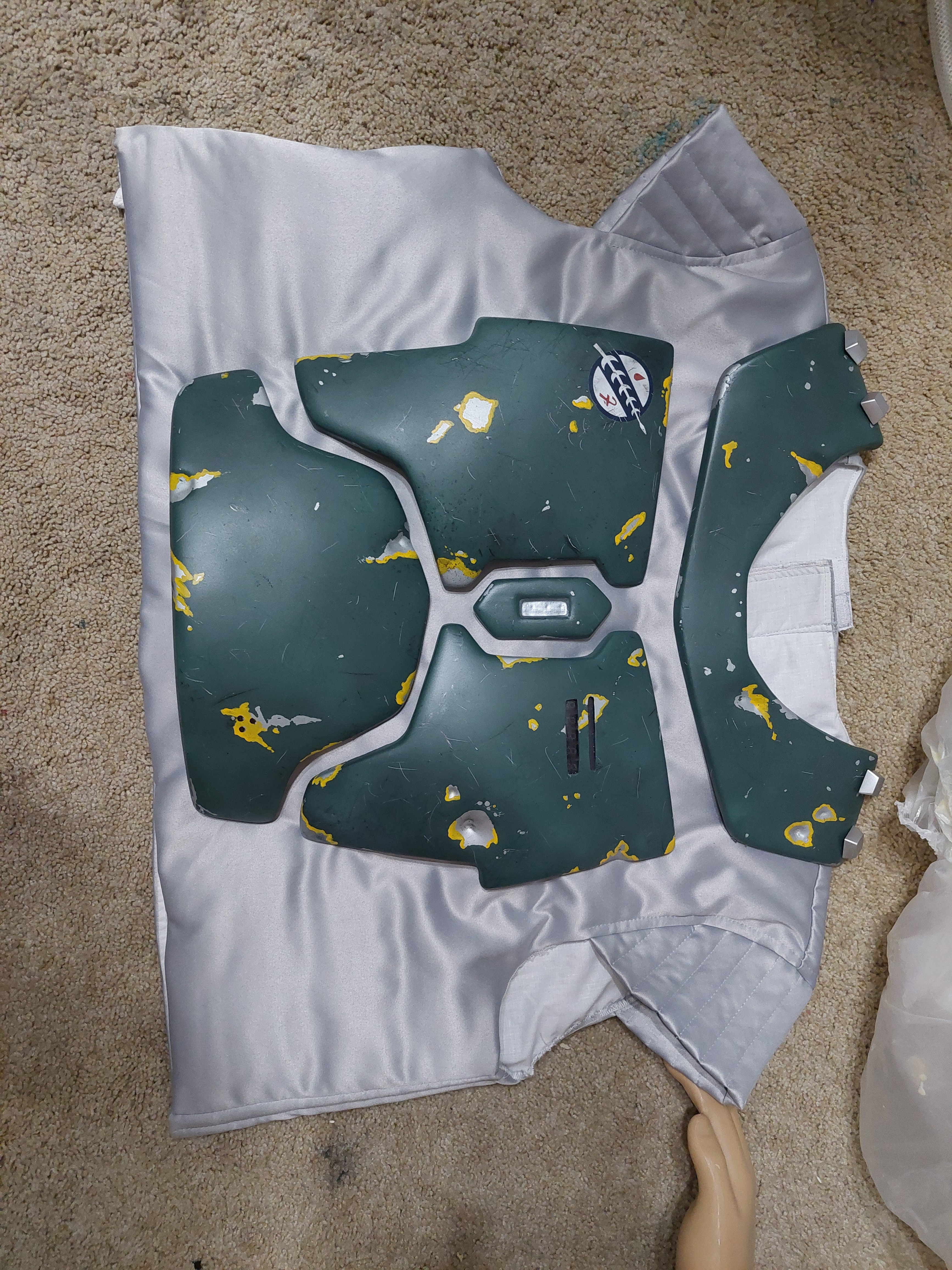

My flak vest finally arrived so I got to work attaching armor. The first step was making cardboard templates to make sure the holes lined up so I didn't ruin the vest.
Once I had my templates, I placed the holes and then installed the fasteners.
Then it was just attach the armor to the vest since I had already placed the opposite attachments on the armor prior. And here's how it looks so far with the chest display lit up and braids on...

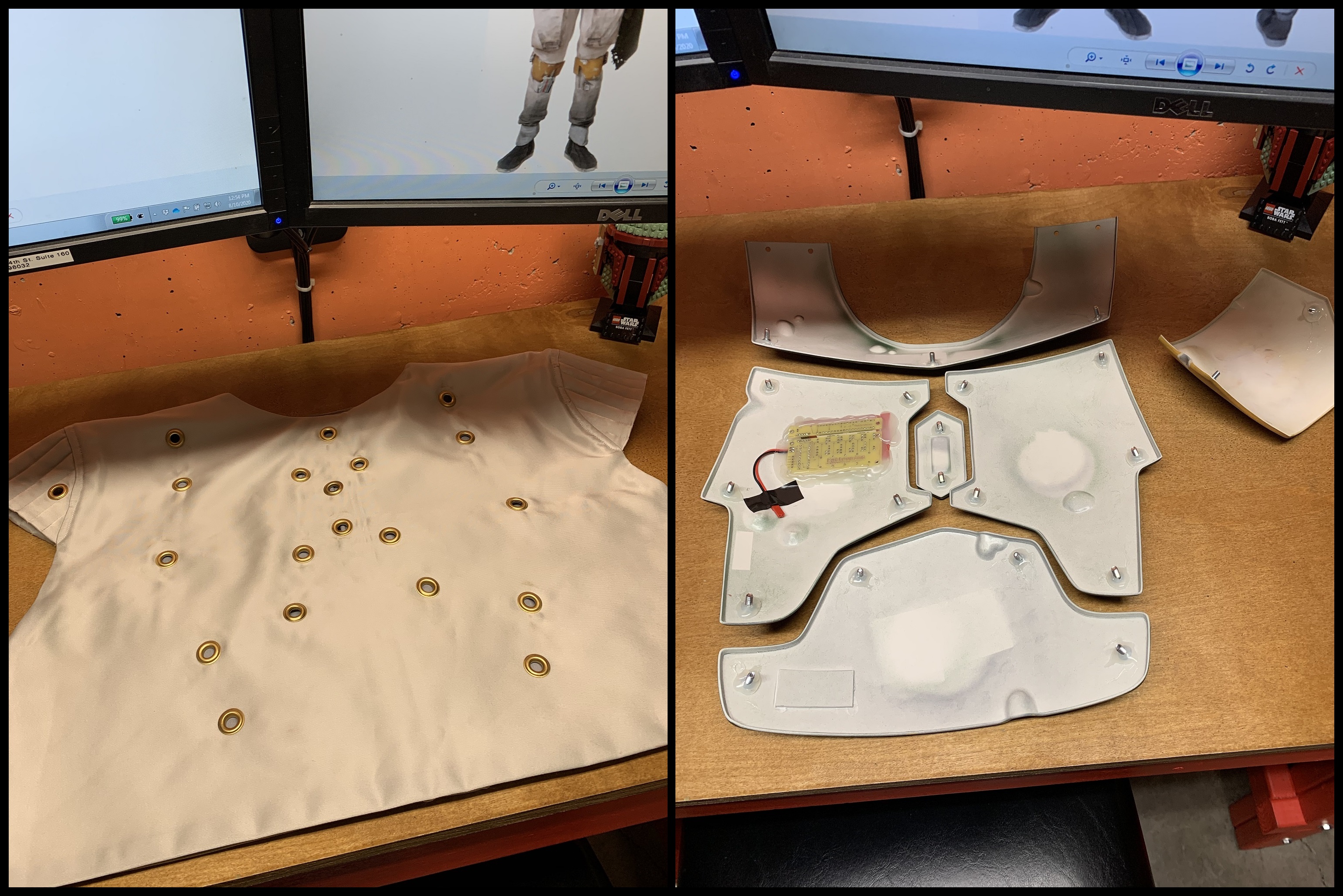

You are not alone in that endeavor! Was about 3 hours of work for me (I did the grommet and bolt method). I remember I started at 9am and was done by about 12pm that day. Worst part honestly, was trying to get the armor situated on my vest accurately and then with a pencil marking where the grommet holes go on the vest and hoping like hell that they will meet the bolts on my armor plates. Oh and all the while taking into consideration that the vest will curve around my torso. And then measuring it 3 more times to ensure it was good. Then, sweatily installing the grommets. But if done correctly, you'll have a great looking set of armor that hangs beautifully on a vest.....and you do! So sometimes taking your time pays off.
So, great job - keep er' comin'!

Thanks Iron! Yeah it's certainly time consuming, and you're right, taking into account curves and everything certainly comes into play. I love the bolt idea and was contemplating that to be a little more screen accurate, but I'll see how the snap fasteners do for now before overhauling anything in the future.
Hopefully I can get some photos this weekend of everything being worn to see how it's looking so far before I move to the next phase.

Yeah, I too contemplated the many solutions. From Velcro, to snaps, to push back pins. But in the end, for me, rather than potentially experience an embarrassing moment of falling armor off my vest while out in the public, I opt'd for the tried, true and tested method of the grommet/bolts. I was forewarned about it being a major pain in the rear but I was able to trudge forward and brought it to the finish line. And so far.....4 years later, never had an incident. For me, I epoxied the Stainless Steel bolt(s) to the armor, and then used Stainless Steel Nylon Locking Nuts to secure the armor to the vest....
I have a complete write up of it in my WIP thread if you so wish to check it out.
Iron's WIP ROTJ - Page 6, Post# 108 and Post# 114.
Would like to hear what you think of your method and how well you think it works!

I'll certainly keep you posted on longevity of the snaps, especially once I try it all on and move around in it for awhile.
Also great writeup on your post for the bolt and grommet method! Looks like another great WIP thread I'll be delving deep into tomorrow for any tips and tricks. Thanks for the recommendation.
