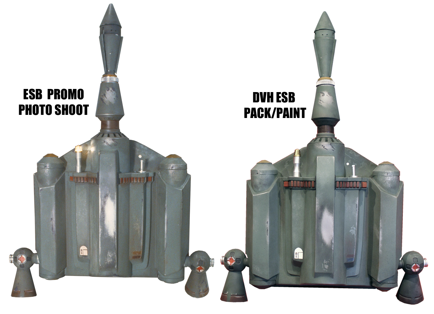

Jet Pack ESB Jetpack paint up"How-to" w/color list!

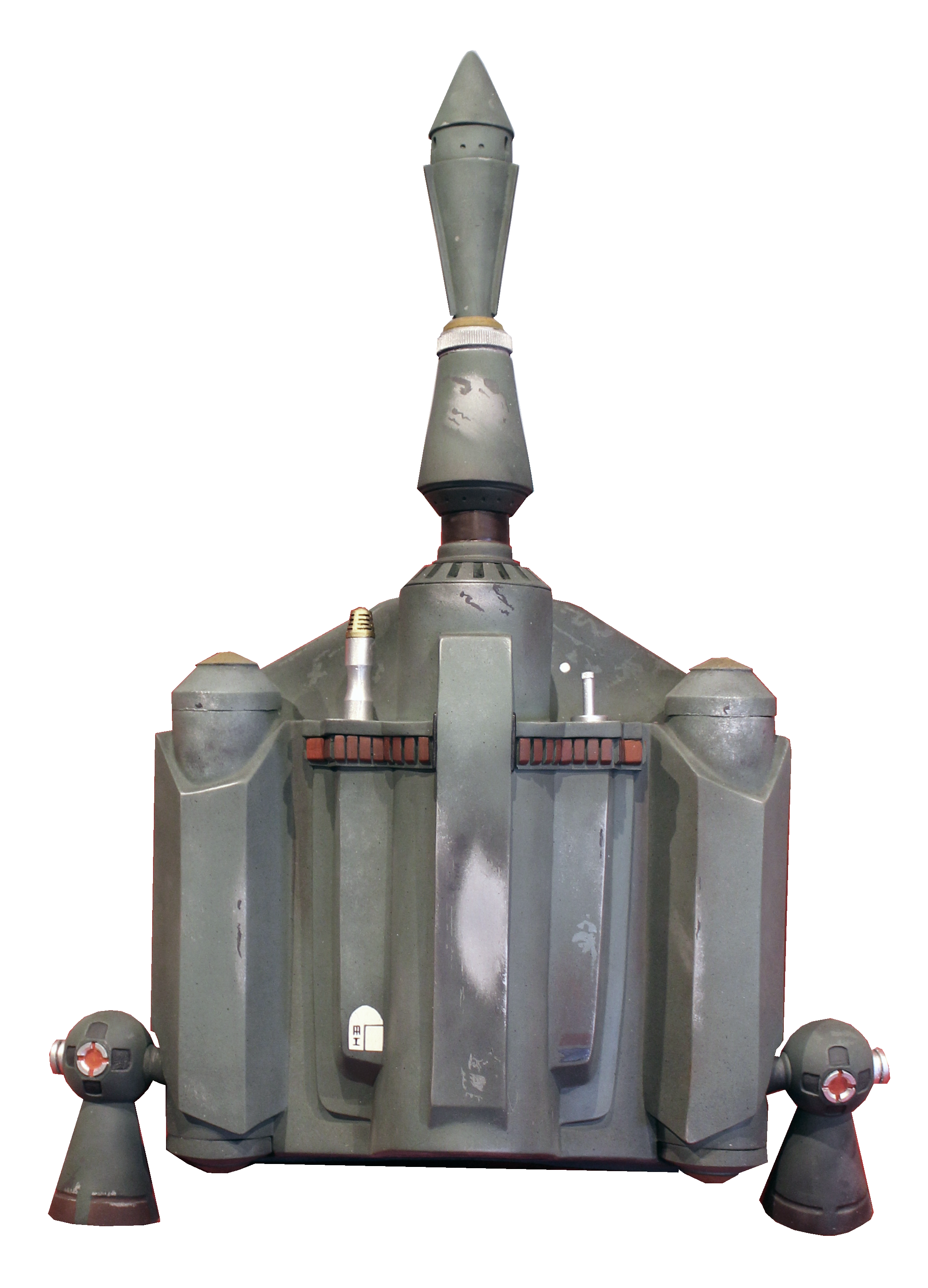

I have updated the color list for this paint up. Check out the first post in the thread and step 5. the process is pretty much the same, but the final outcome is a much lighter color, more in line with the ESB promo shots which have been determined to be more accurate than we originally thought. This is a newer paint up:
