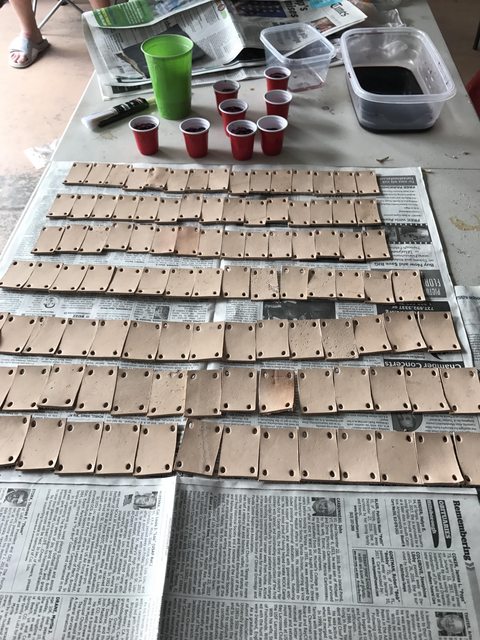

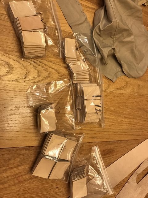

Saturday: unroll and cut into the leather. 2 1/4 inch tall strips cut. Then the individual squares, all 180 of them.

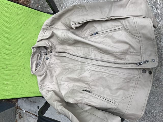

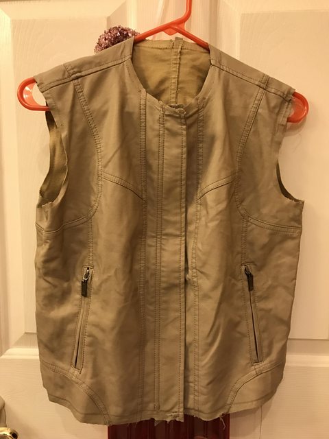

I ordered a faux leather jacket off Amazon ($15), hoping to alter to work for the vest. Future ambitions have a real leather vest, but I want to be more sure of myself, and sewing leather is a little scary. Got the jacket, removed the sleeves, collar, bottom cuff, and lining. Trailing some acrylic paint to get the lilac grey I'm looking for in the vest.
And sampled my dyes on scrap leather pieces to end the night...

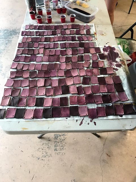

Sunday: goals for today. Punch 4 holes in all 180 squares. Dye each square, front, back, and sides, cut lacing (minimum of 75 feet), and dye it. With some help from the neighbors, got it done!
