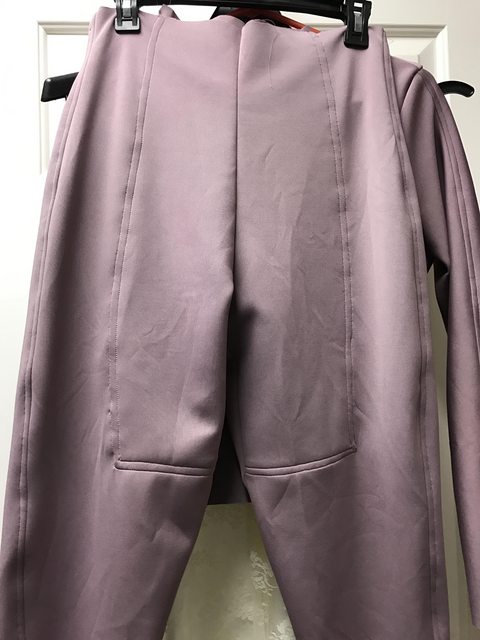

Very nice! Don't forget the welt seams in the front too. I have to rework my own near the knee, as the person I had paid to do that part (long ago!) made them curved, not angled.
I ended up just doing inserts for the welt seams for my suit.

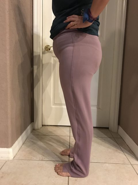

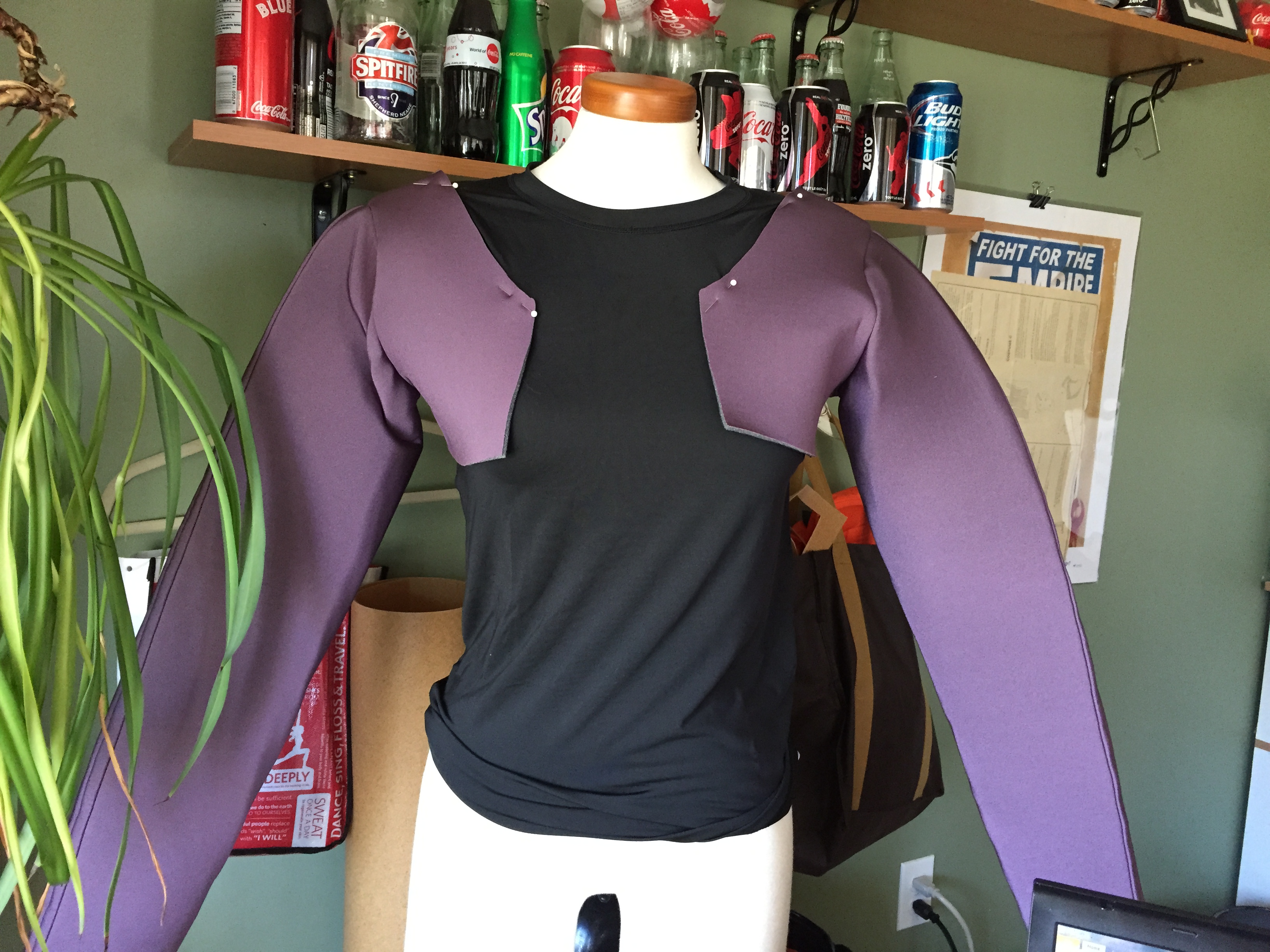

My one suggestion with this suit is line it with sweat wicking material. My top is really just sleeves: the vest and chest plate cover the athletic shirt I sewed them to:
I can't believe out of the pics I took with it on, none from the front. "welt" seams are on the legs. I plan on wearing wicking type pants and shirt under this, although this material is not nearly as bad as I was expecting it to be, and I'm in FL. I will be cropping the top, once I have more of the armor pieces and the vest done. My next piece to tackle will be my boots and the veil/hood pieces. Need to stop by Tandy...

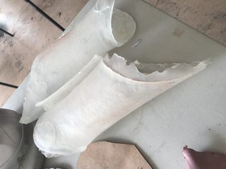

Got the inside of the helmet cleaned out, and it goes on, I can even get my hair in a bun, up inside the helmet! YAY!!

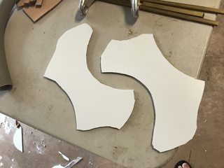

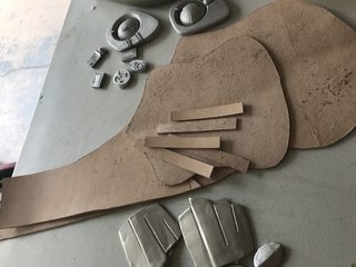

I got the chest armor pieces cleaned up, covered in 2/3 ounce leather, and cut out some thin ABS for the insert part

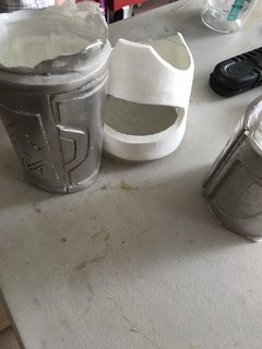

Got all the rest of the cast pieces cleaned up
Shoe guards cut out of thick ABS
and got the recessed notches started. Ordered some new files from Amazon today to get the squared off ends that I need

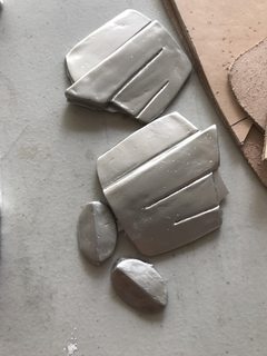

Got the "writing" transferred over and cut out of the chest plate
And a coat of silver paint

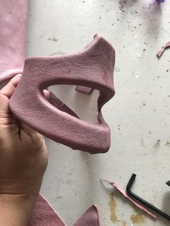

Covering the shins with the leather.. not fun!
But I personally think they turned out amazing!
Got the leather cuff covered, not terrible, especially after doing the shin

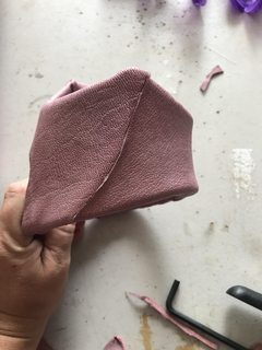

I found so interesting how you covered the cuff. I'm working with this piece right now and I don't know where the leather join is! Your join is at the back?
OMG! You're making a really good work.
Mirval - there is a small ridge/line on my cuff, so I used that as my seam point.
