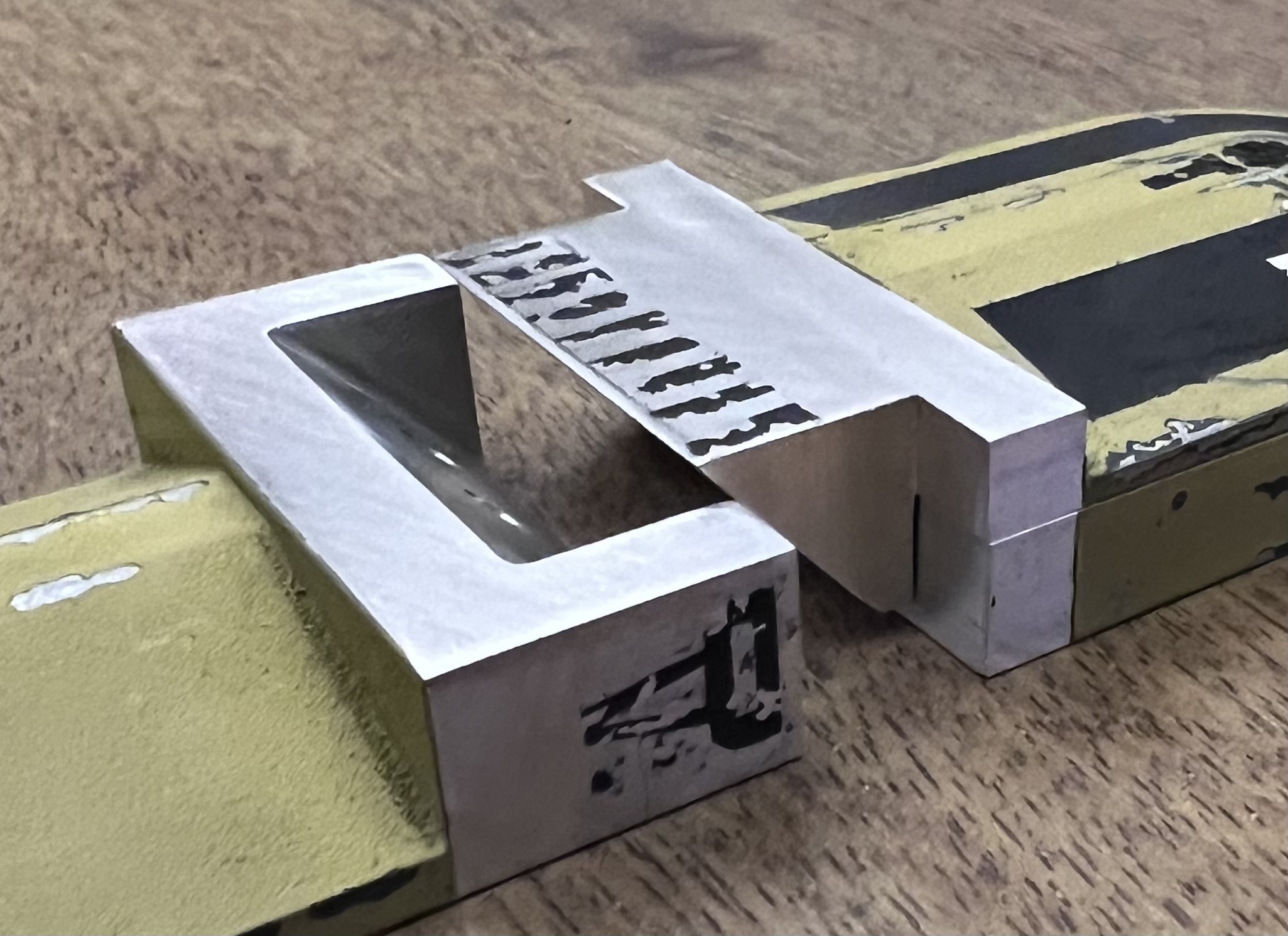

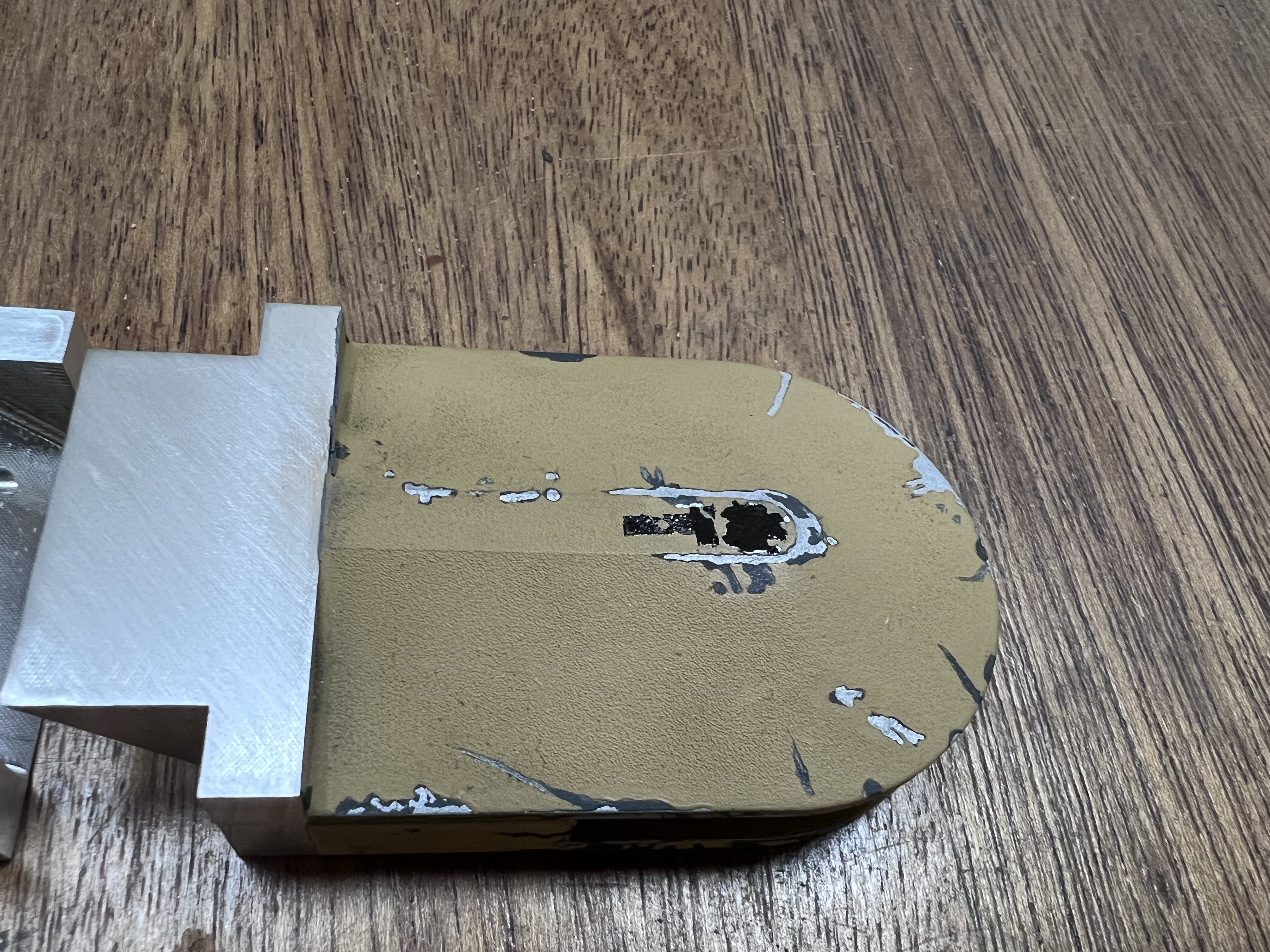

Right ear is almost done. Just need to do the black arch. I also need to do the black lines on the upper ear but struggling to think of how.
The raw aluminium will need etching primer for the paint to adhere but I don’t see how I can do that just for the black stripes. I guess stencil but they seem way too intricate and small for that to work.
Any ideas? Is there a go-to source for decals people use?

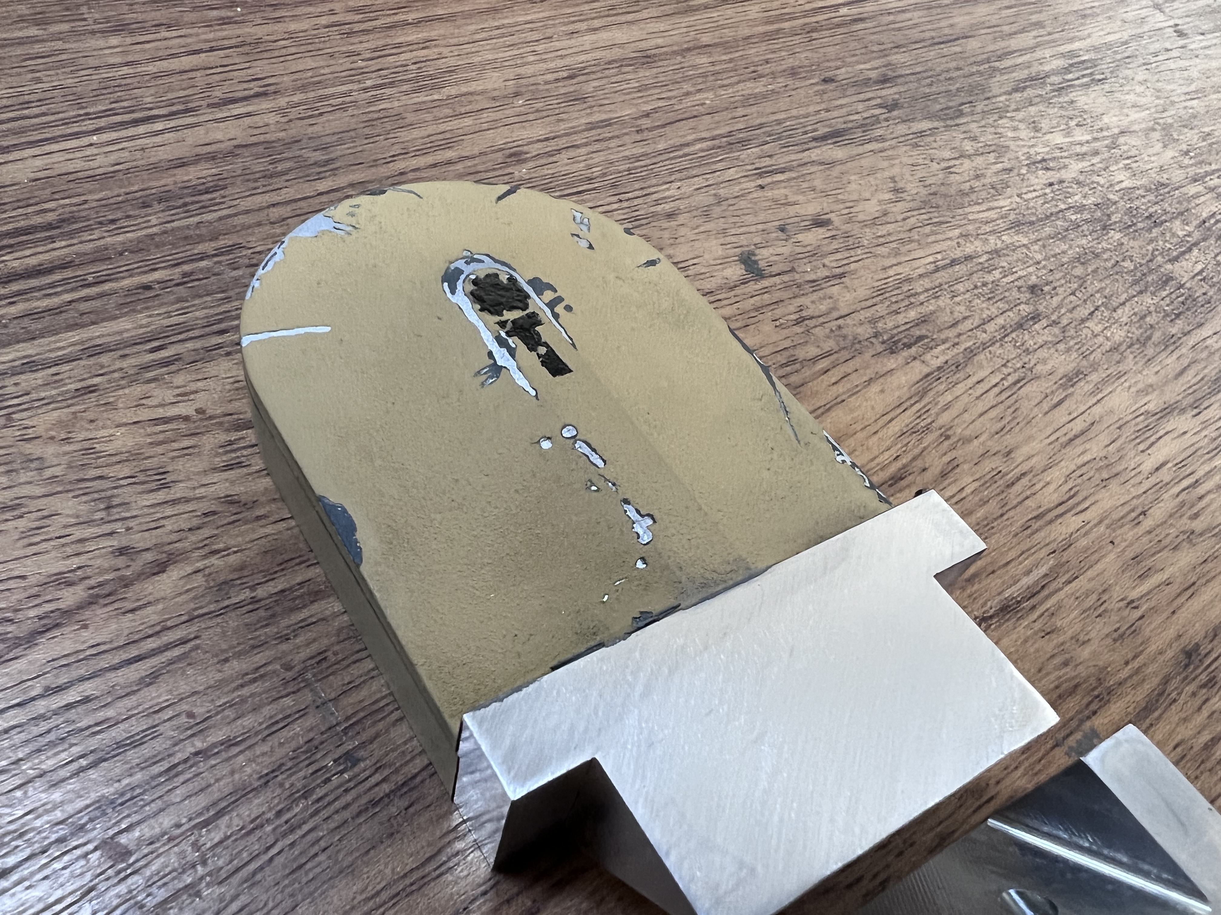

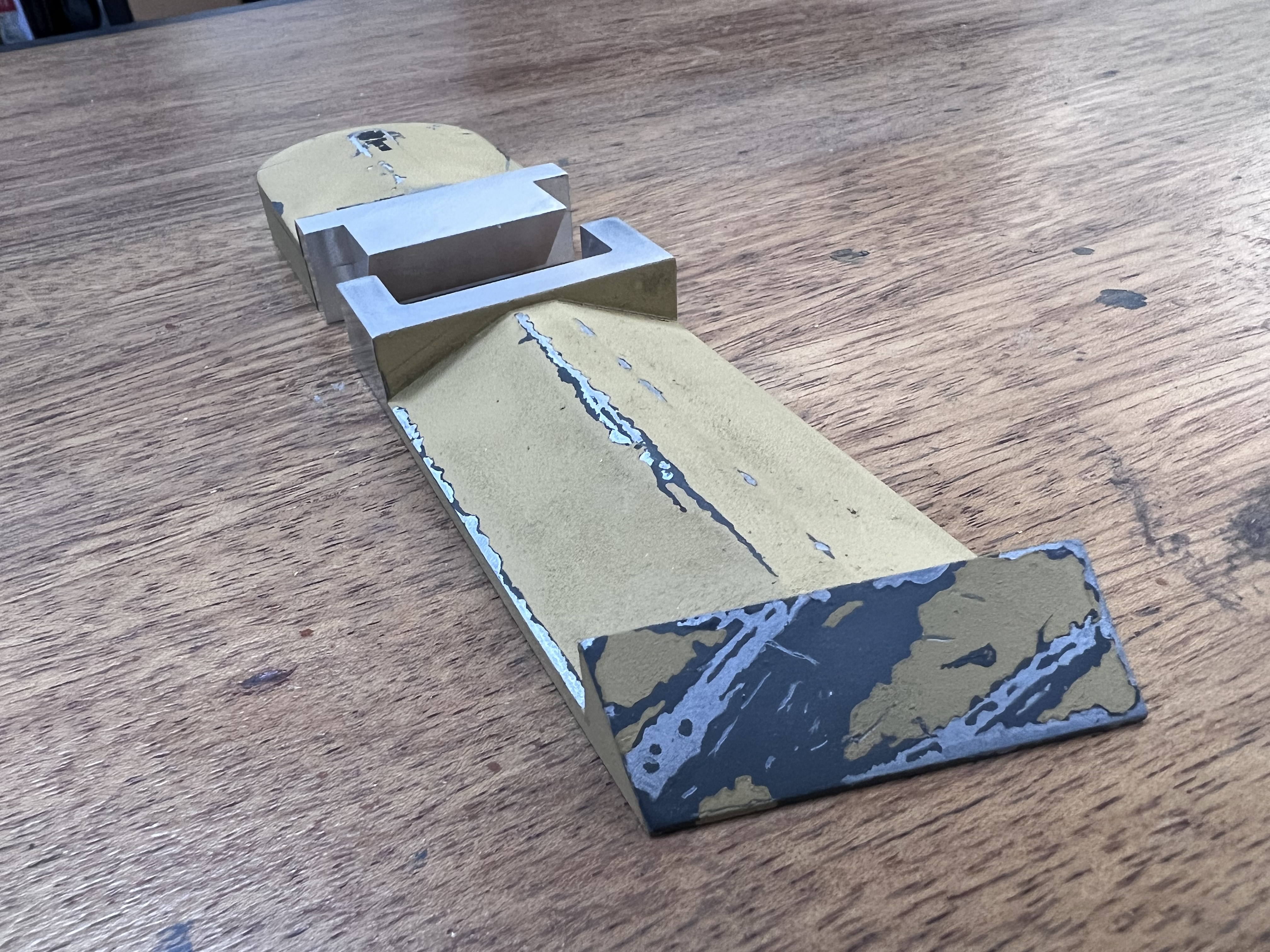

So, I’m ready to call the right ear finished. I’m hugely proud of how the stripes on the upper part and the ‘decal’ on the lower part came out.
In the end, I painstakingly masked out the shapes by hand with what felt like microscopic bits of masking tape and then I used the masking fluid to block out the worn sections.
Hit both shapes with etch primer and then Matt black.

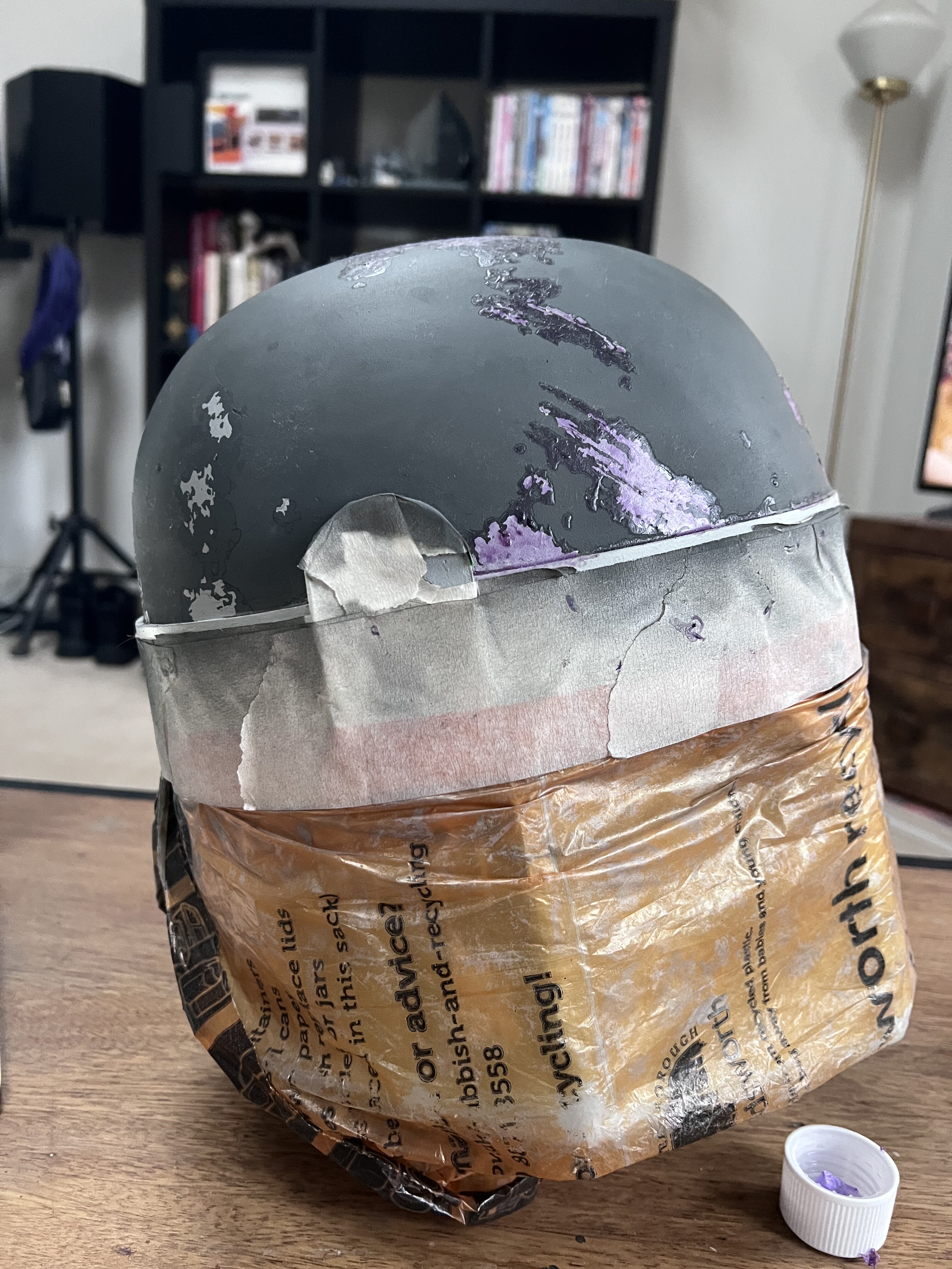

With the ears done, and still not wanting to face the rest of the helmet, I thought I’d make a start on my SideWinder EE-3. I plan to follow this excellent build thread but realised I’d need some milliput for a start, so while I wait for that to arrive I bit the bullet and got the helmet out of the cupboard. This is where I was at 8 months ago:
It was t as dusty as I’d expected it to be but there was dust. I wasn’t sure how best to wipe it down without disturbing the maskol and I was very confused about what stage I was at and whether or not I’d finished the grey damage. I also realised I’d painted the kill stripes damage just above the headband in silver when it actually isn’t.
Anyway, all these things and the fact that I just feel I could do better overall led me to the difficult decision to start again on the dome. Sandpaper and acetone at the ready, here I go. See you soon (ish) …

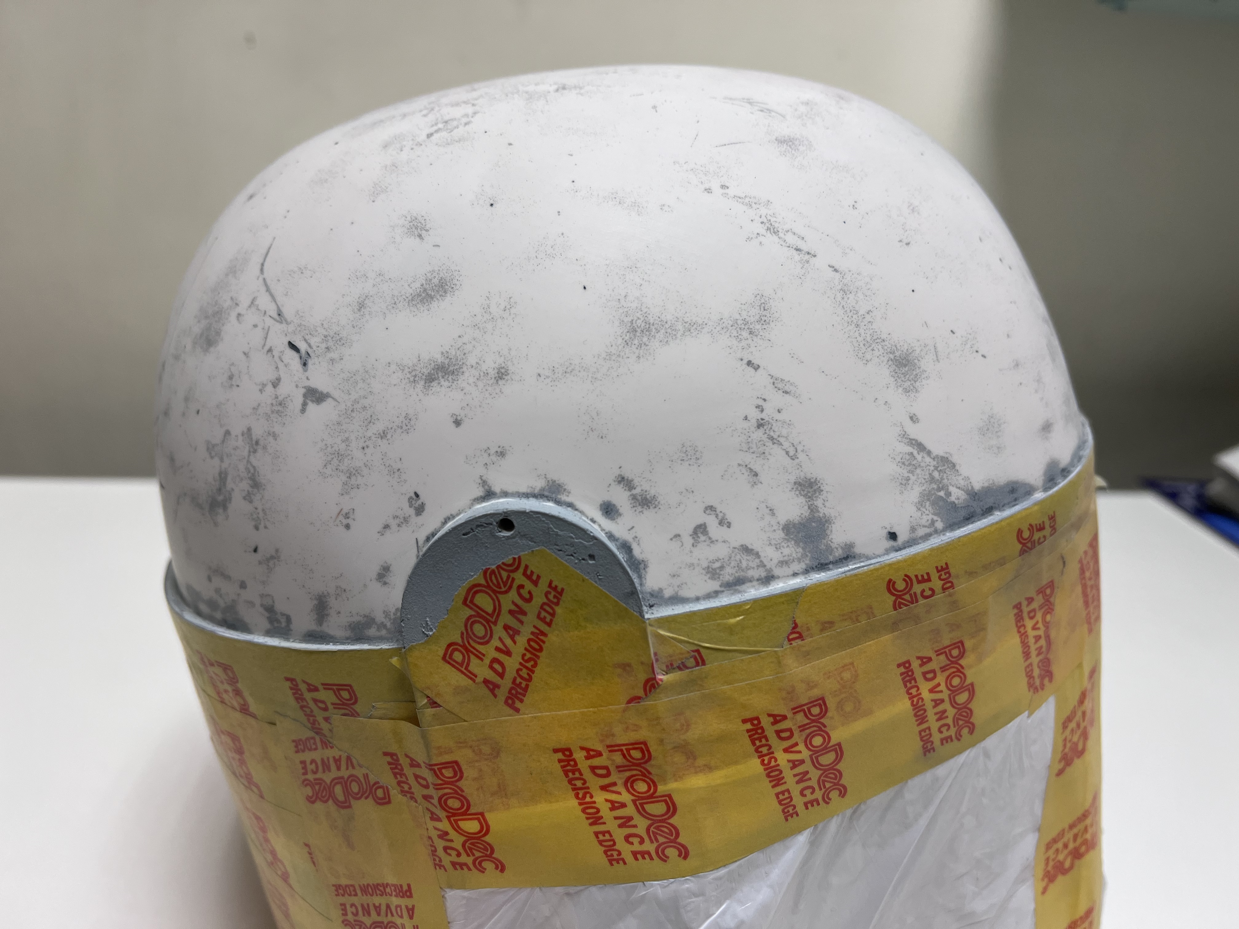

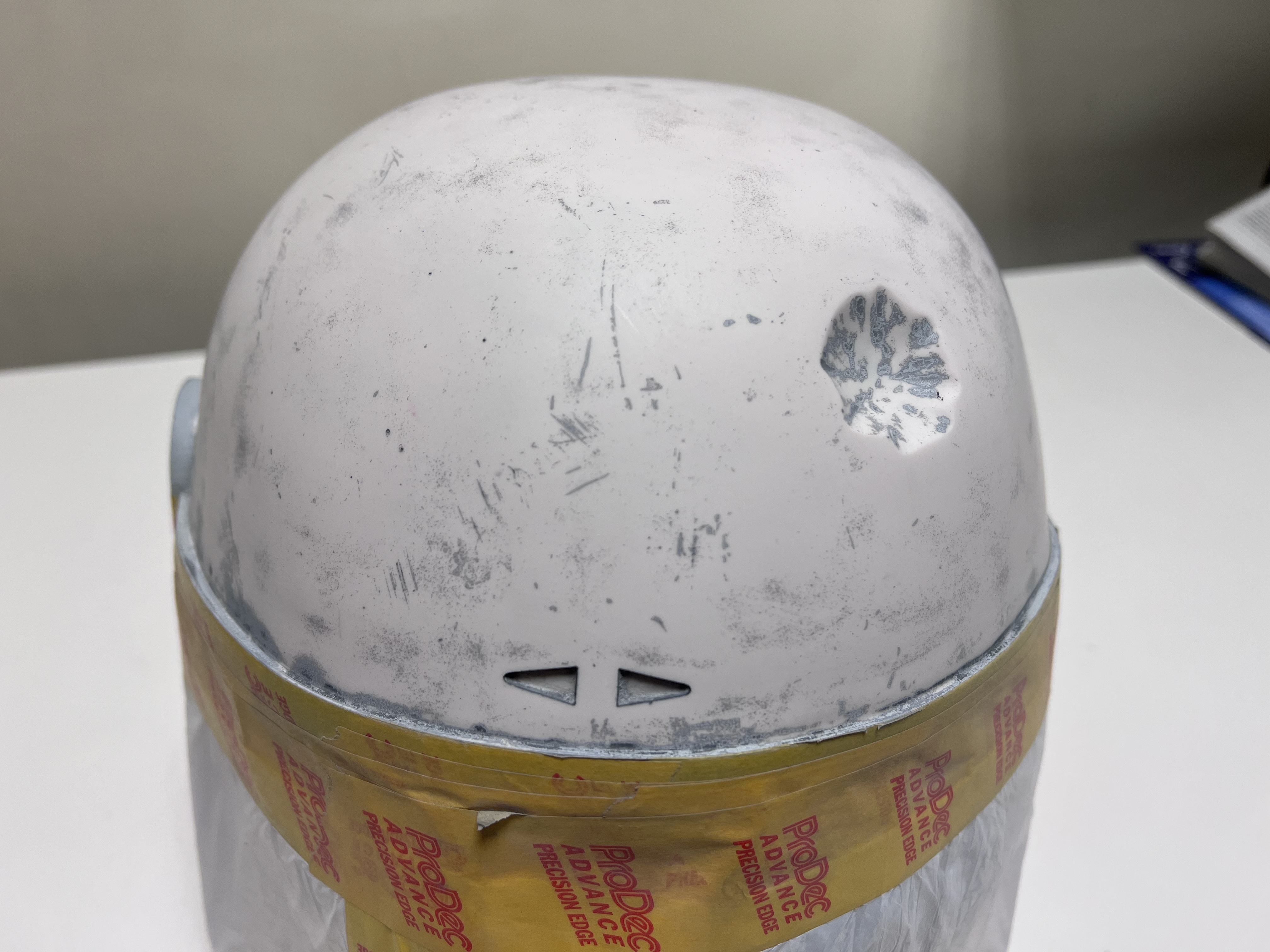

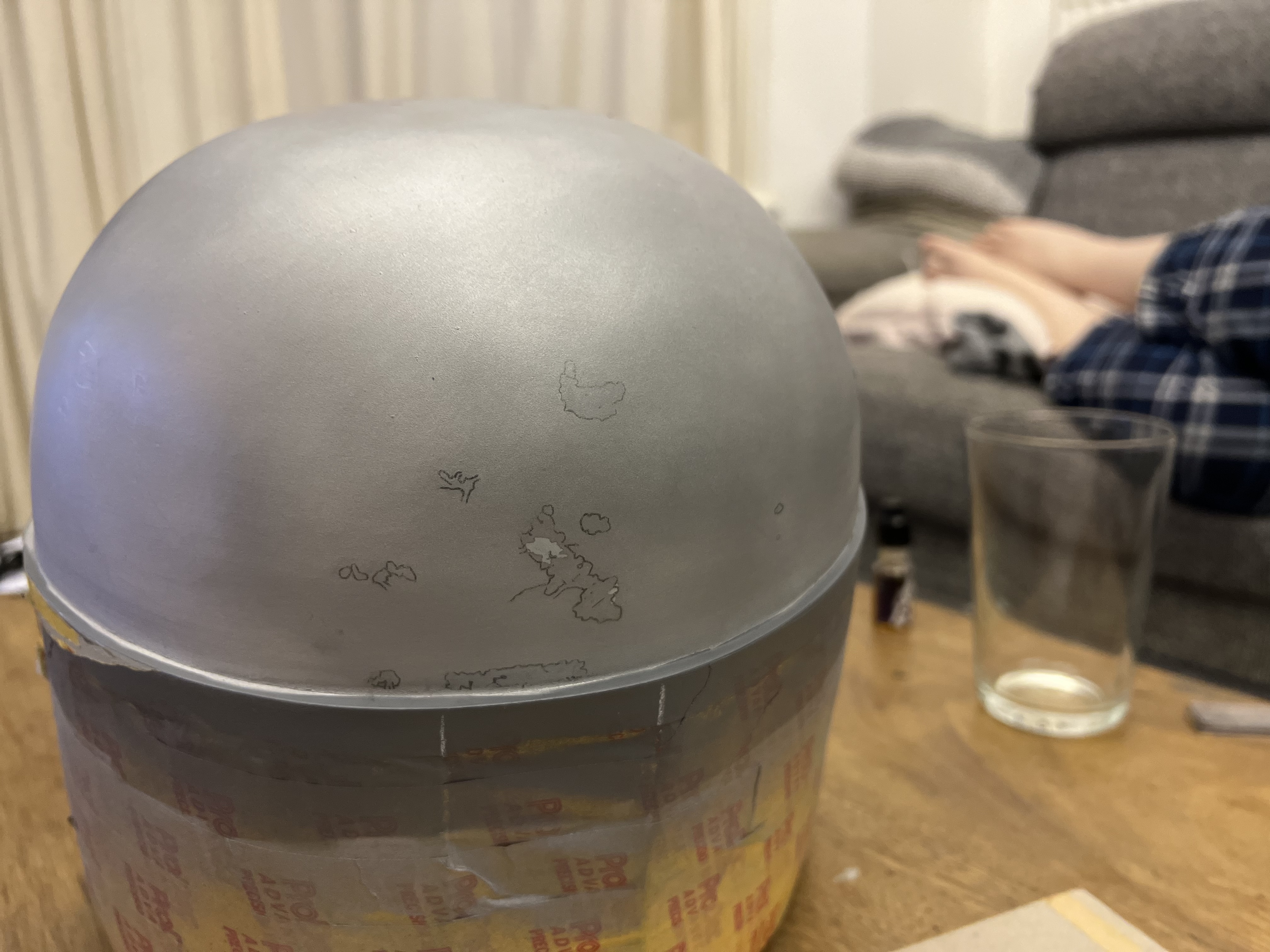

Ok, back to square one:
Some positives and negatives to take from this.
A downside is that all that lovely surface damage has effectively been filled so it won’t show up after this, however - I was concerned that it’ll be a nightmare to line the stencils up and make sure they match perfectly with the physical damage. When they inevitably don’t, it’d drive me crazy.
not much to update at the moment, got the base grey on the dome and the damage marked out and masked. I was all ready to lay the silver down and then discovered my tin of #11 had gone clumpy so I’m awaiting a re-up on silver 11.

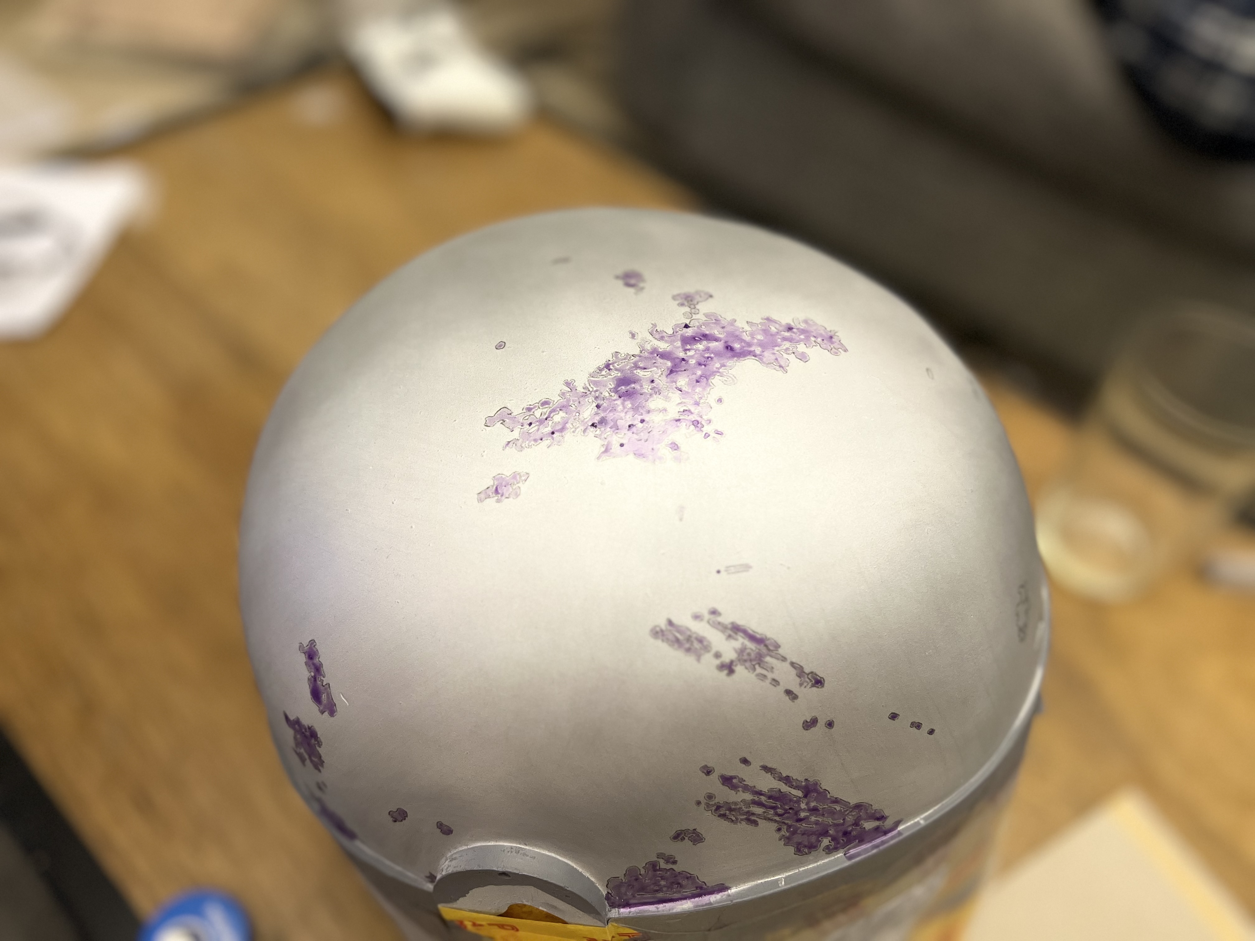

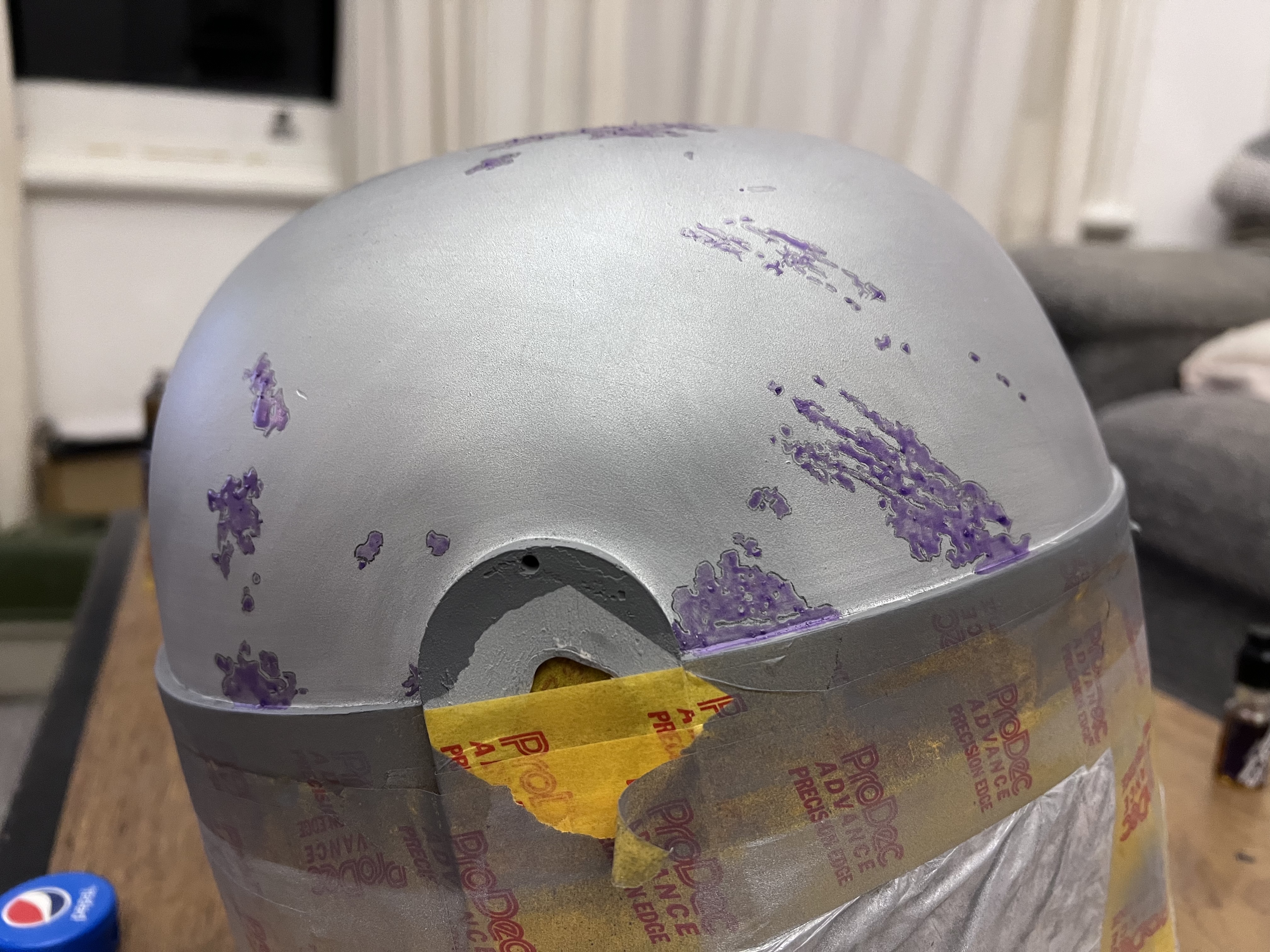

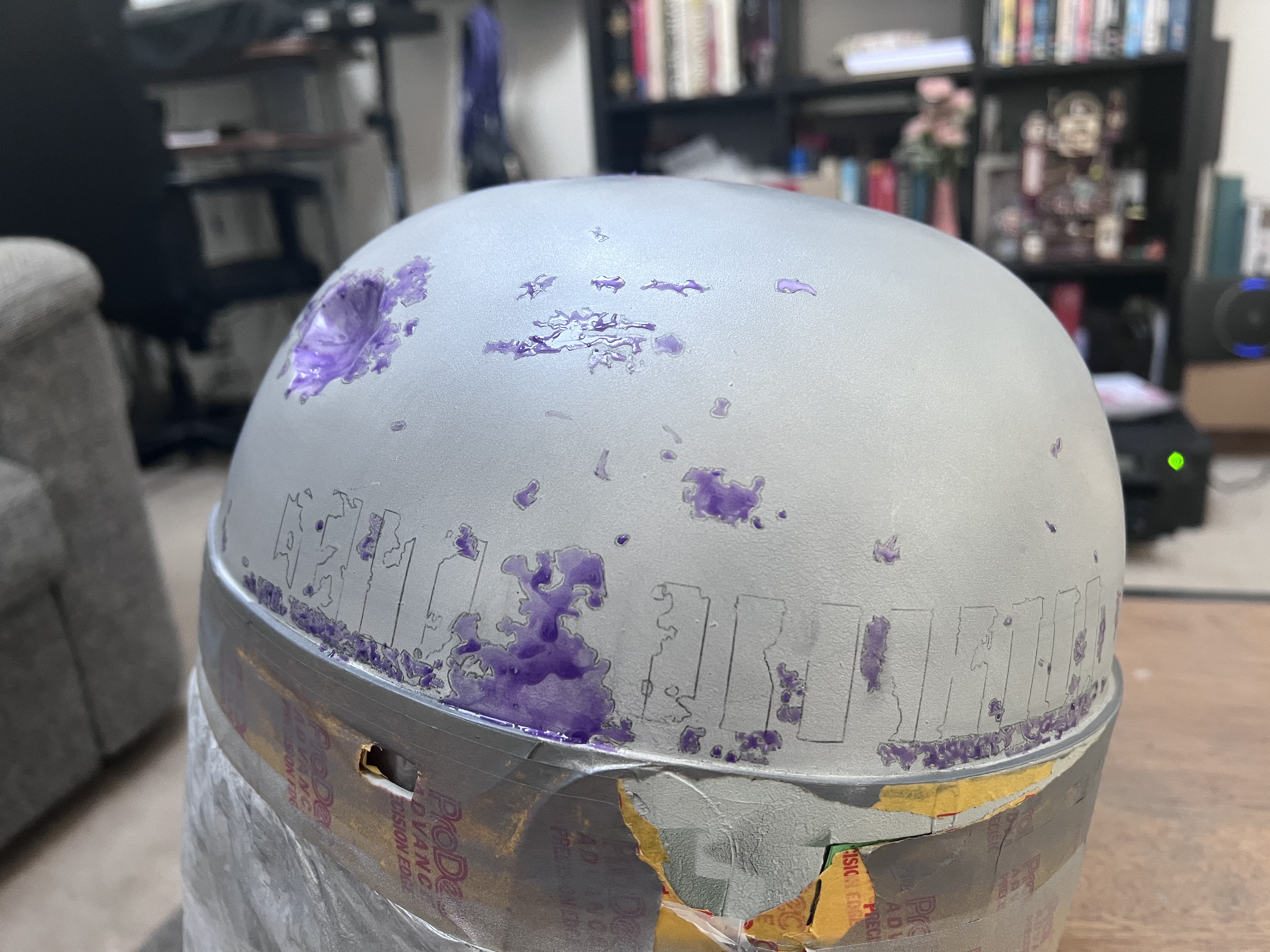

Quick update on masking the silver damage areas:

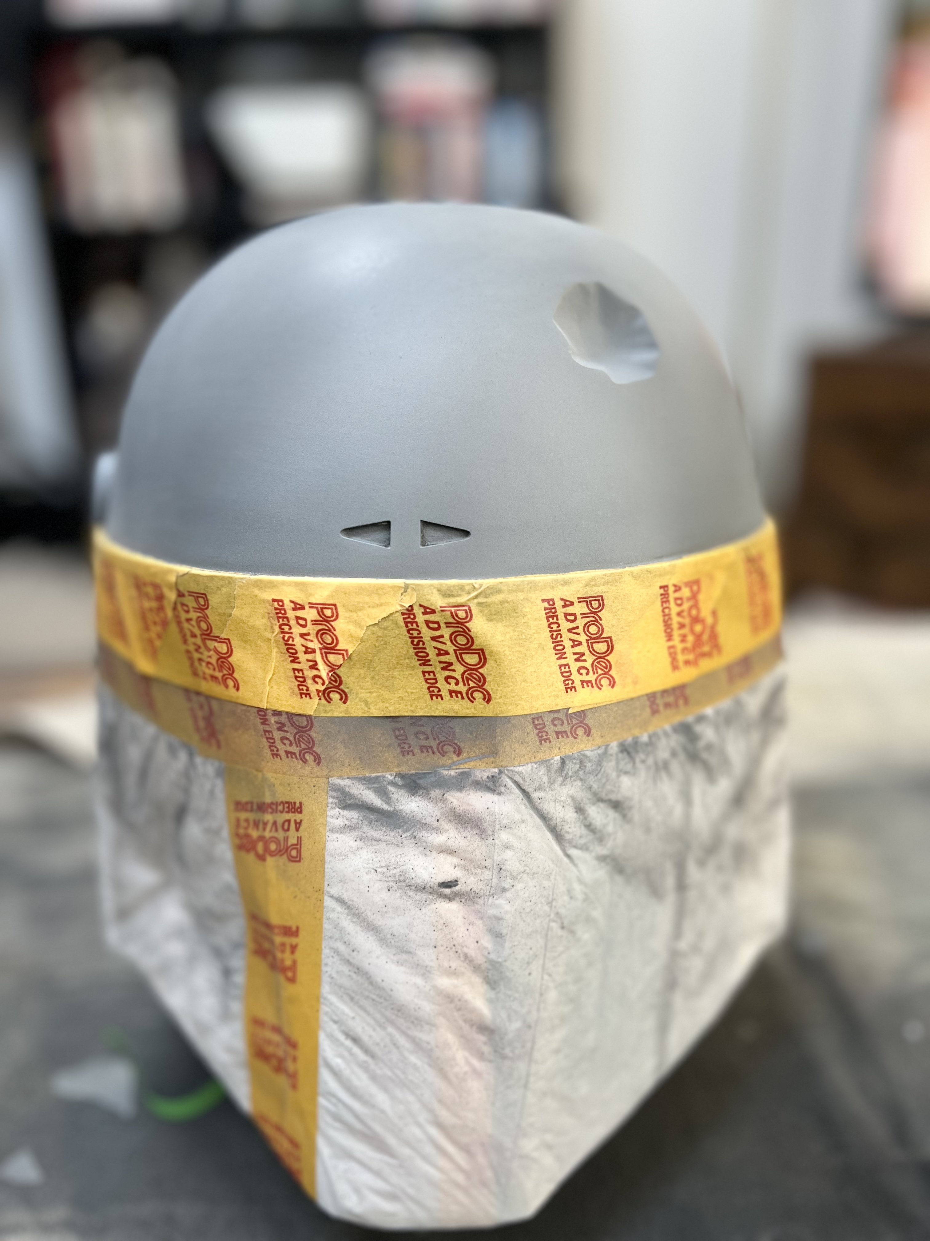

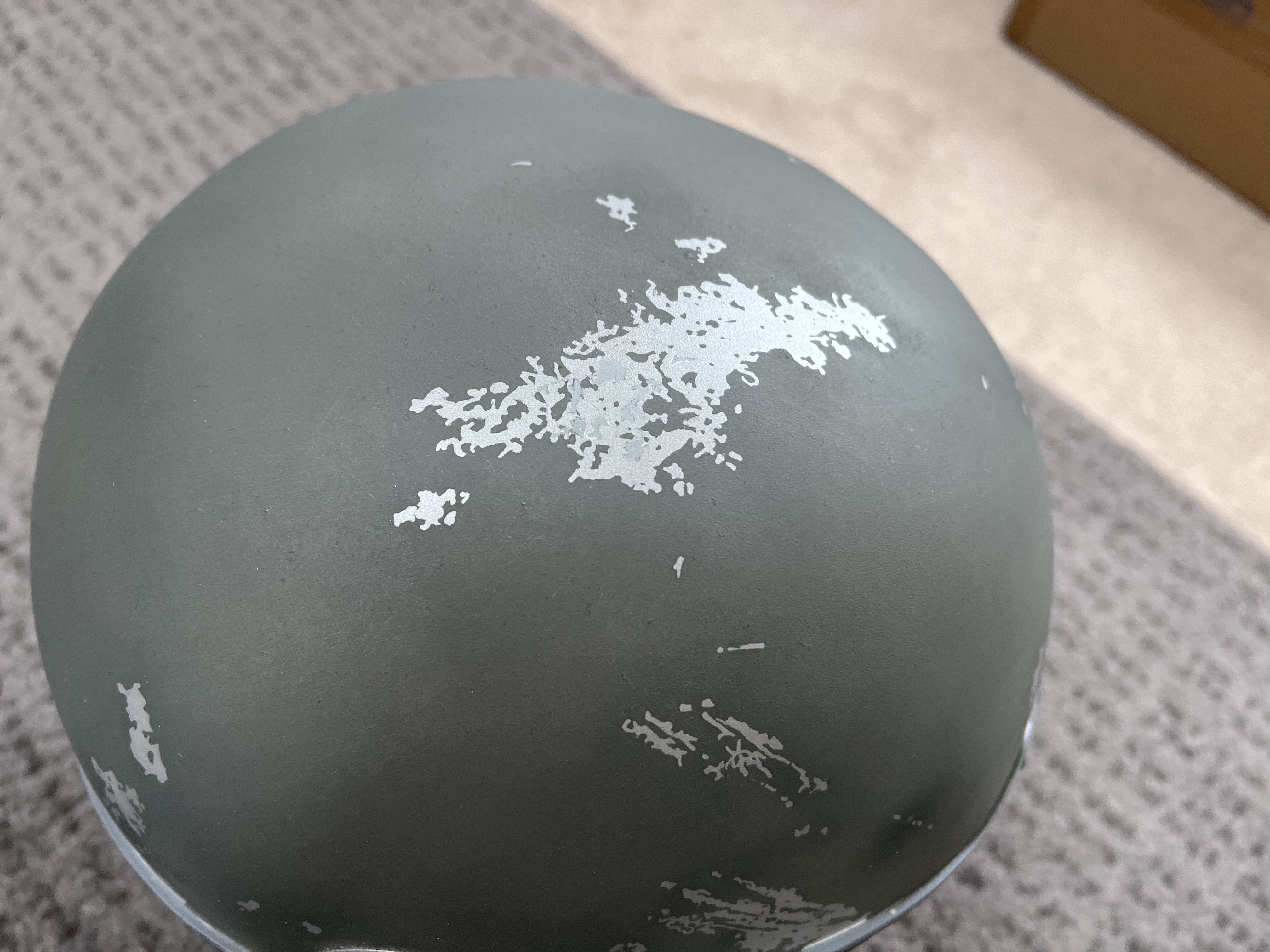

Think I’m done with masking the silver damage areas.
Included the kill stripes so I could nail the placement of the damage on that side. Obviously they won’t be masked at this point though, it’s just for alignment purposes. I’ll go back and do the finer grey detail within the silver damage once the grey layer is on.
Majority of the scratches missing from the back. I did toy with the idea of trying to mask them but ultimately decided to scratch/paint them in later.

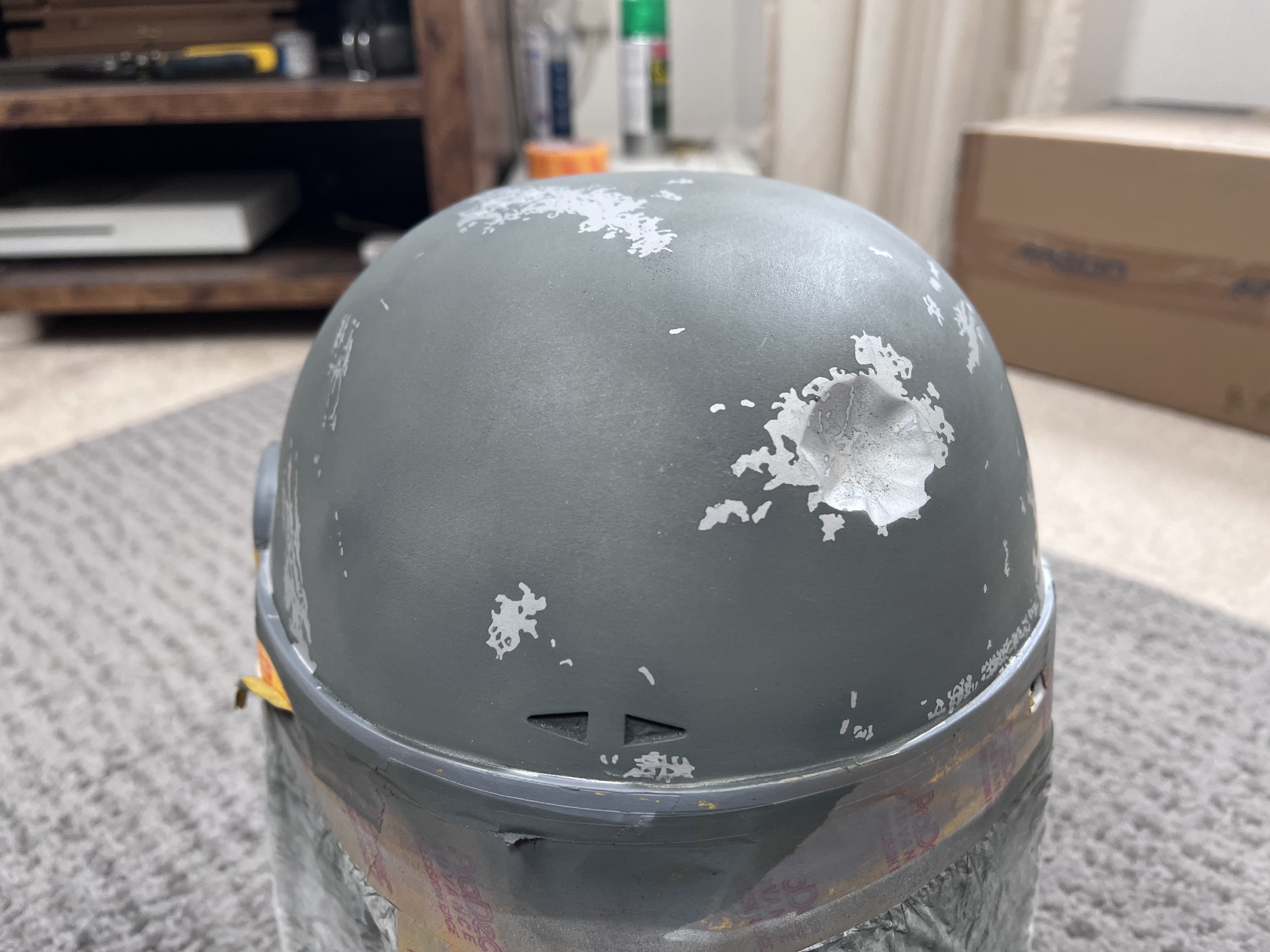

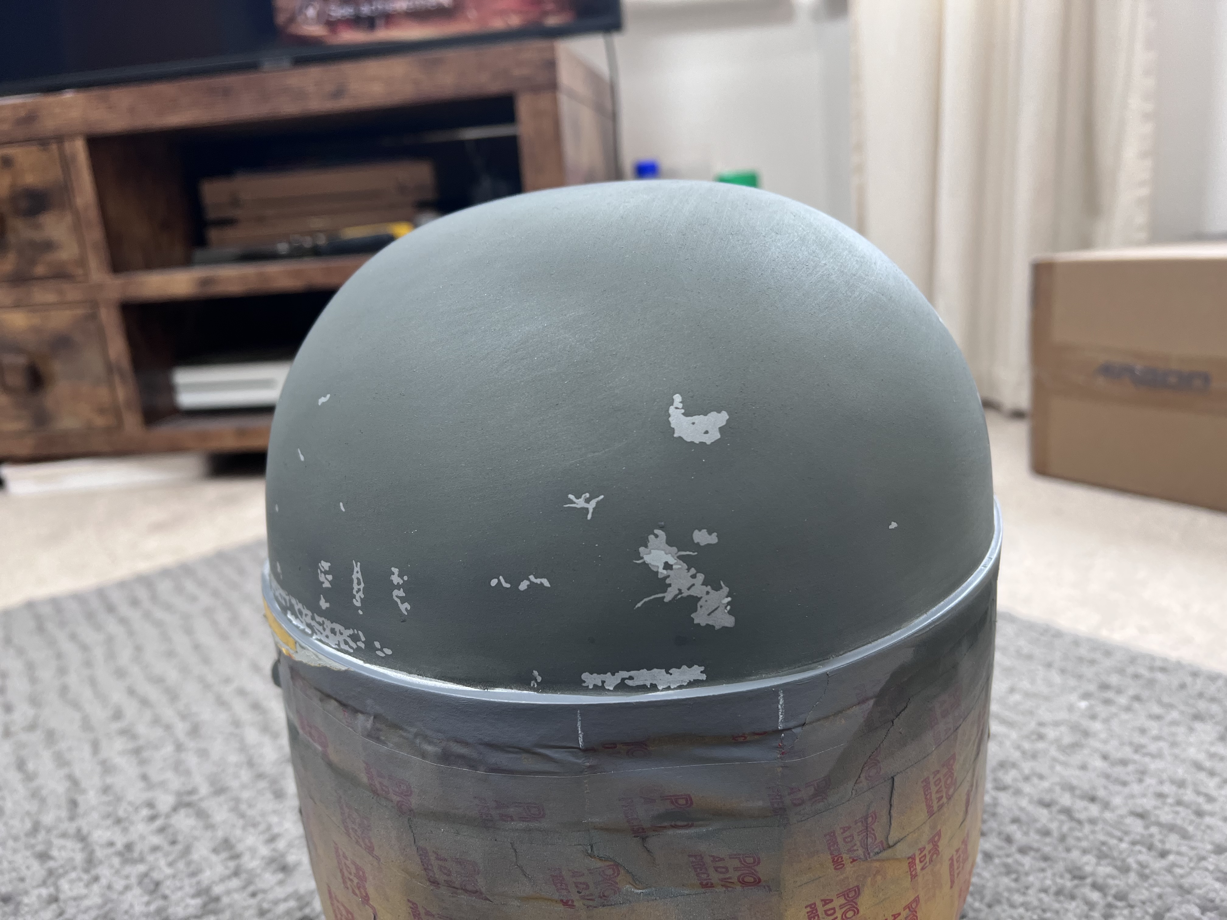

My grey #79 turned up this morning so I was able to get the next layer sprayed on.
