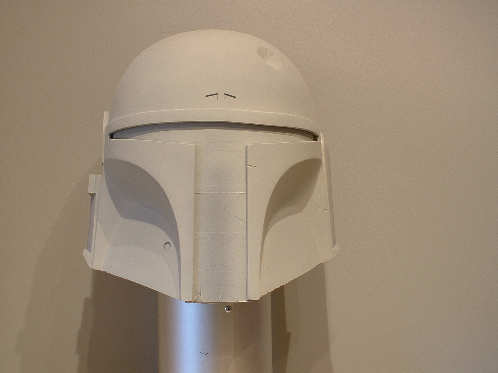

I thought i would document the process again as i try to improve on the last one. I've planned a couple of tweaks to the techniques and colours. The helmet has a white gel coat which will be scratched back to in certain areas, a thin grey primer coat and the first layer, the light grey Humbrol 147, which is actually blue/green/grey...
1. thin coat of grey primer
2. light grey base coat 147

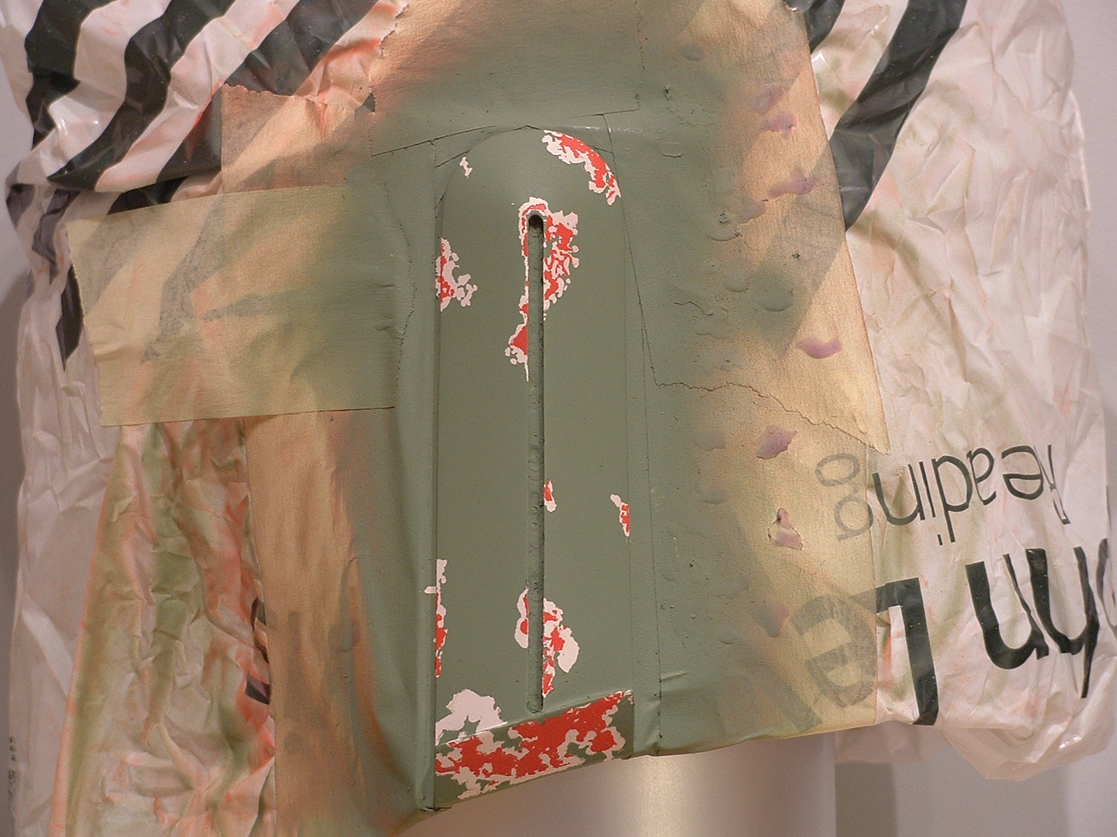

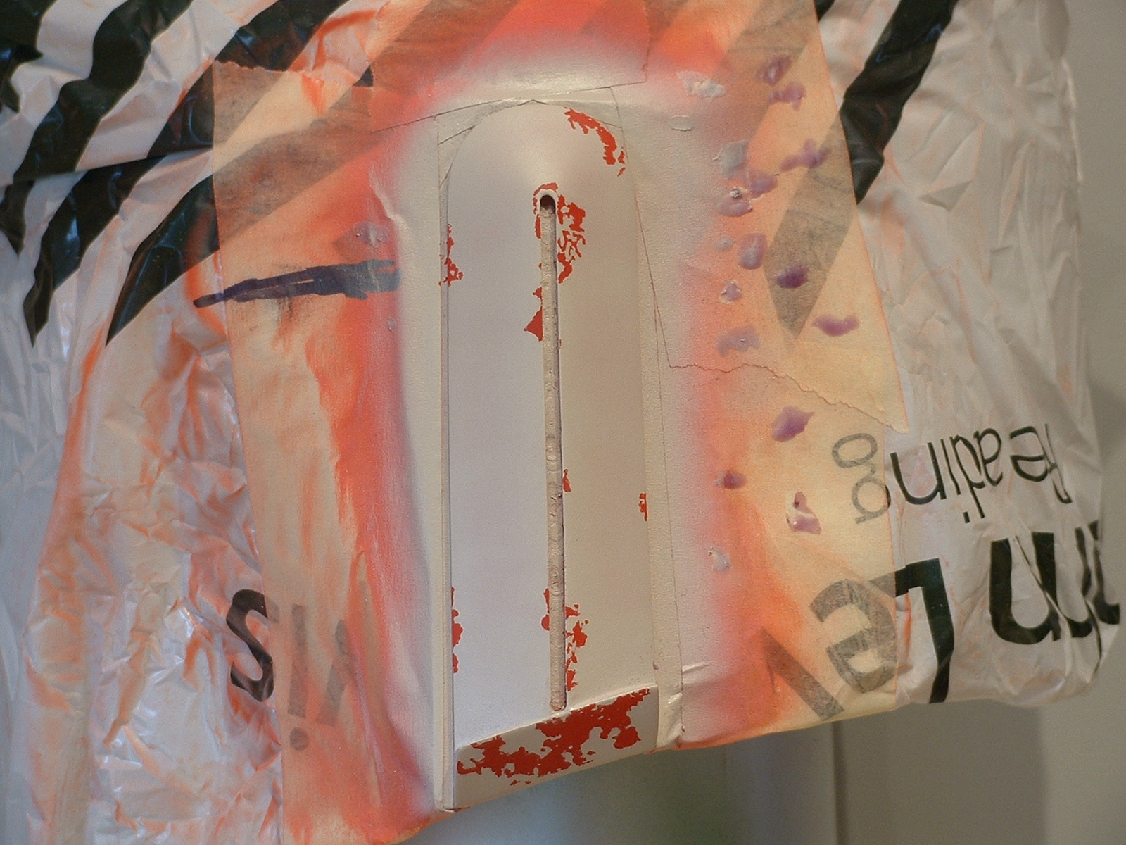

3. mask entire helmet except L/H ear spray red 60
4. liquid mask red damage spray grey 28
I used a water soluble white pencil to roughly outline the next layer detail, i've done this to ensure the scale of the layer is as accurate as possible. I also peeled back the liquid mask in areas with a compass point to create sharper detail where needed before painting.
