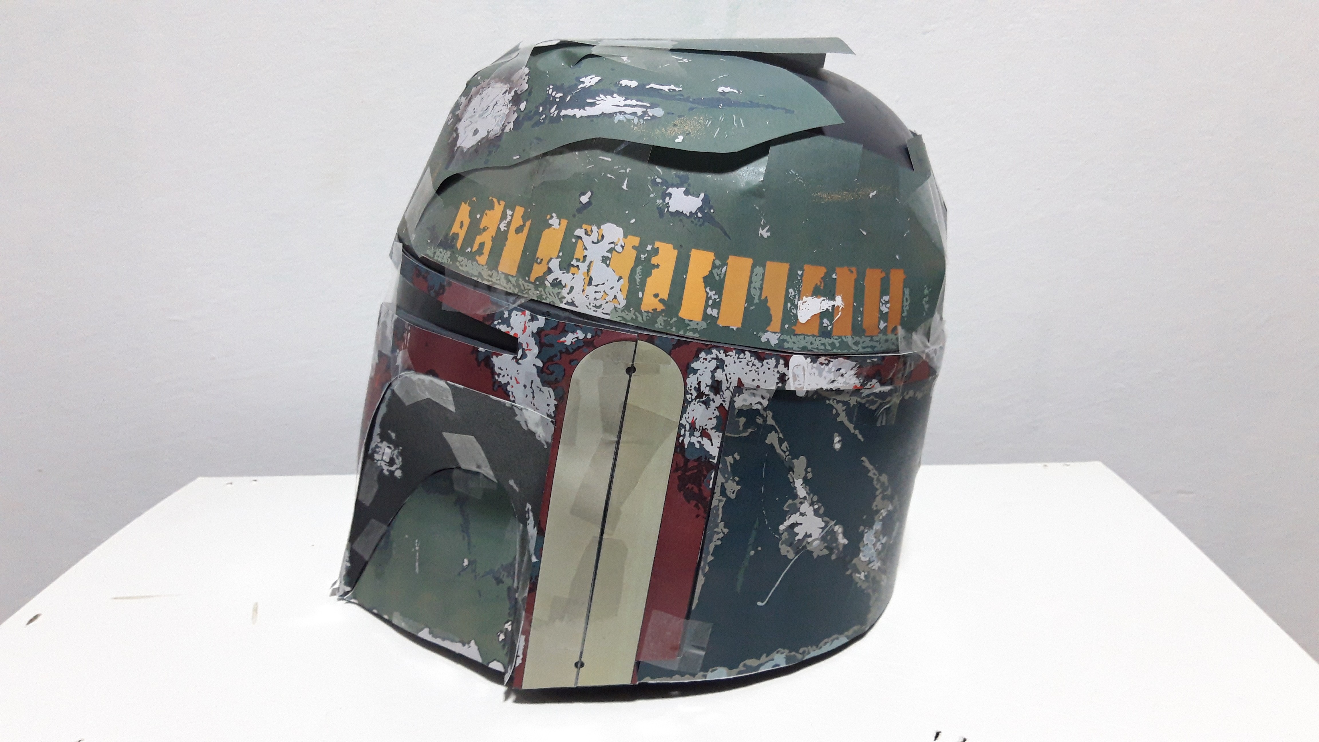

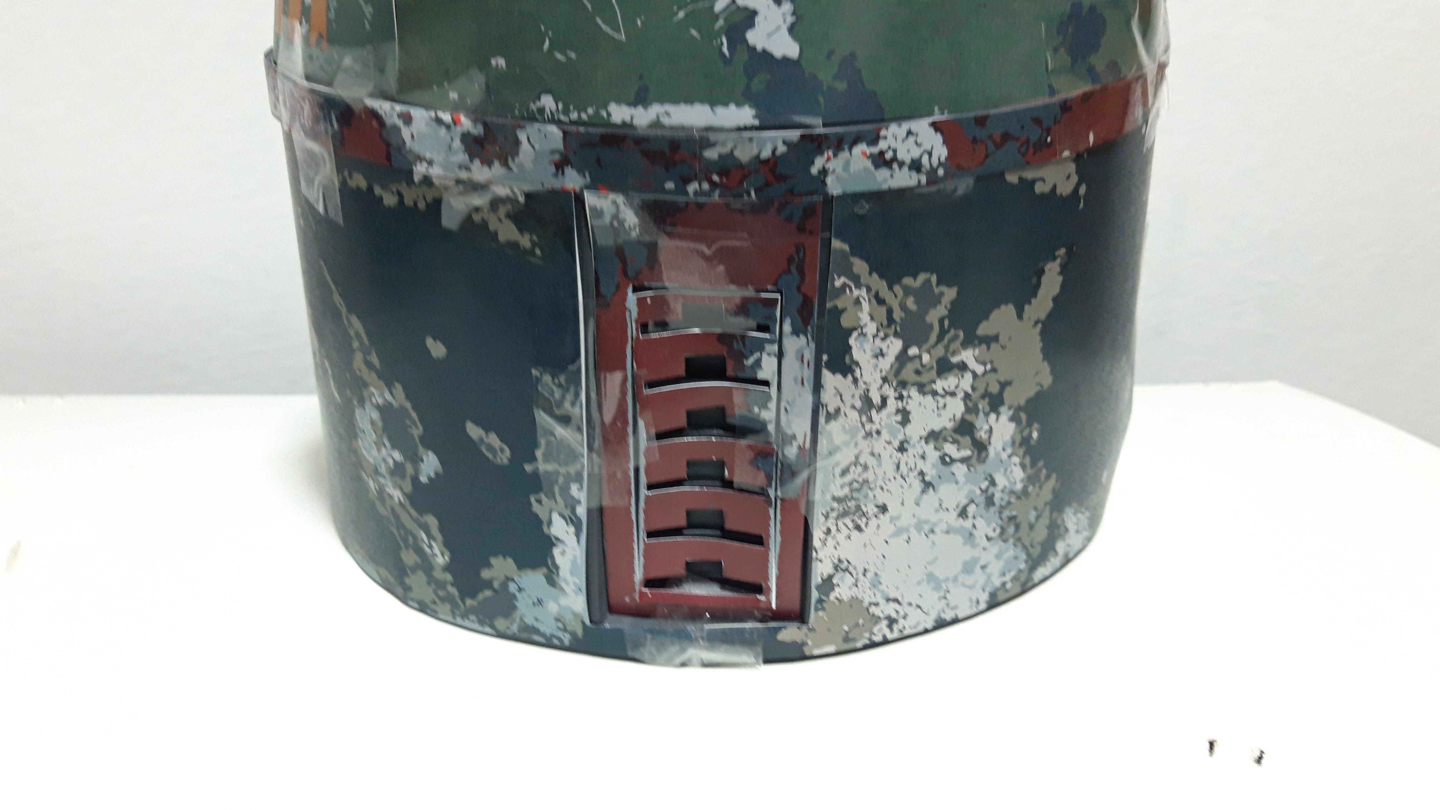

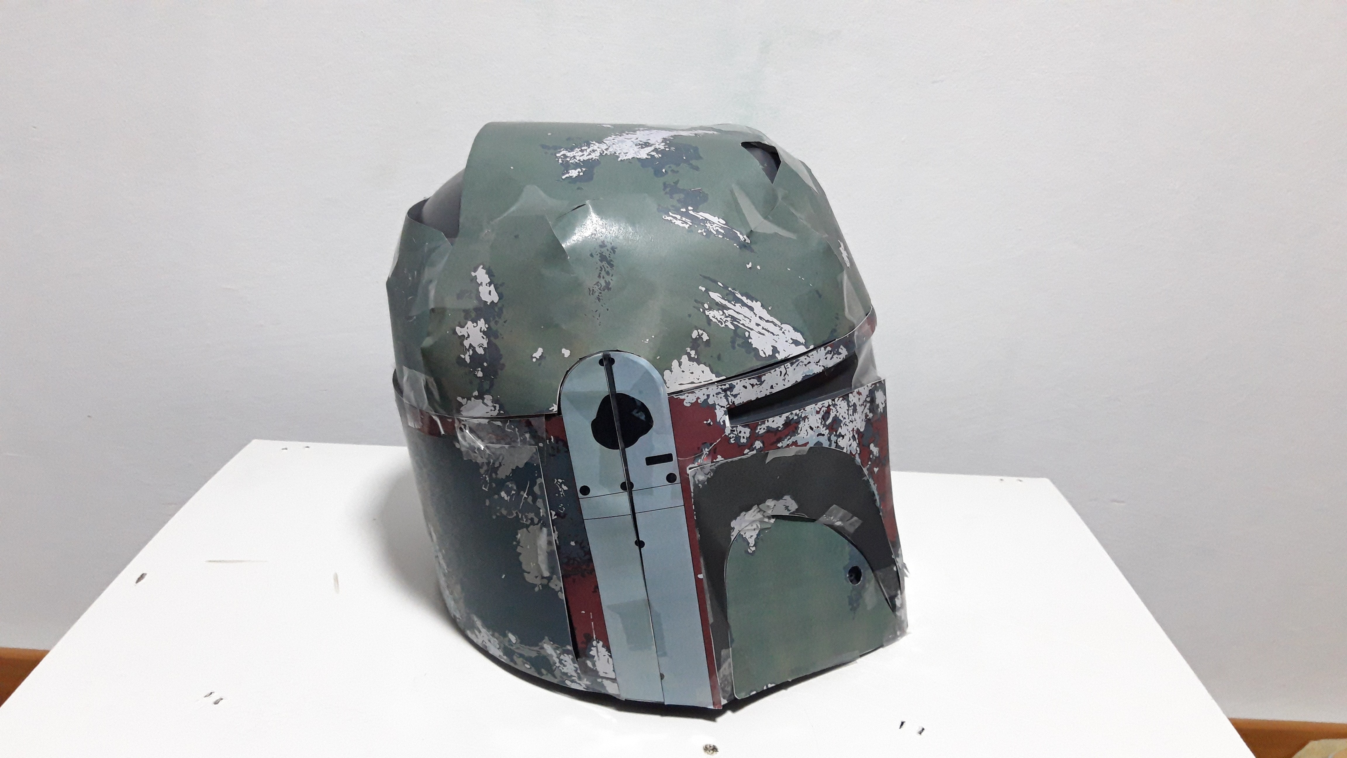

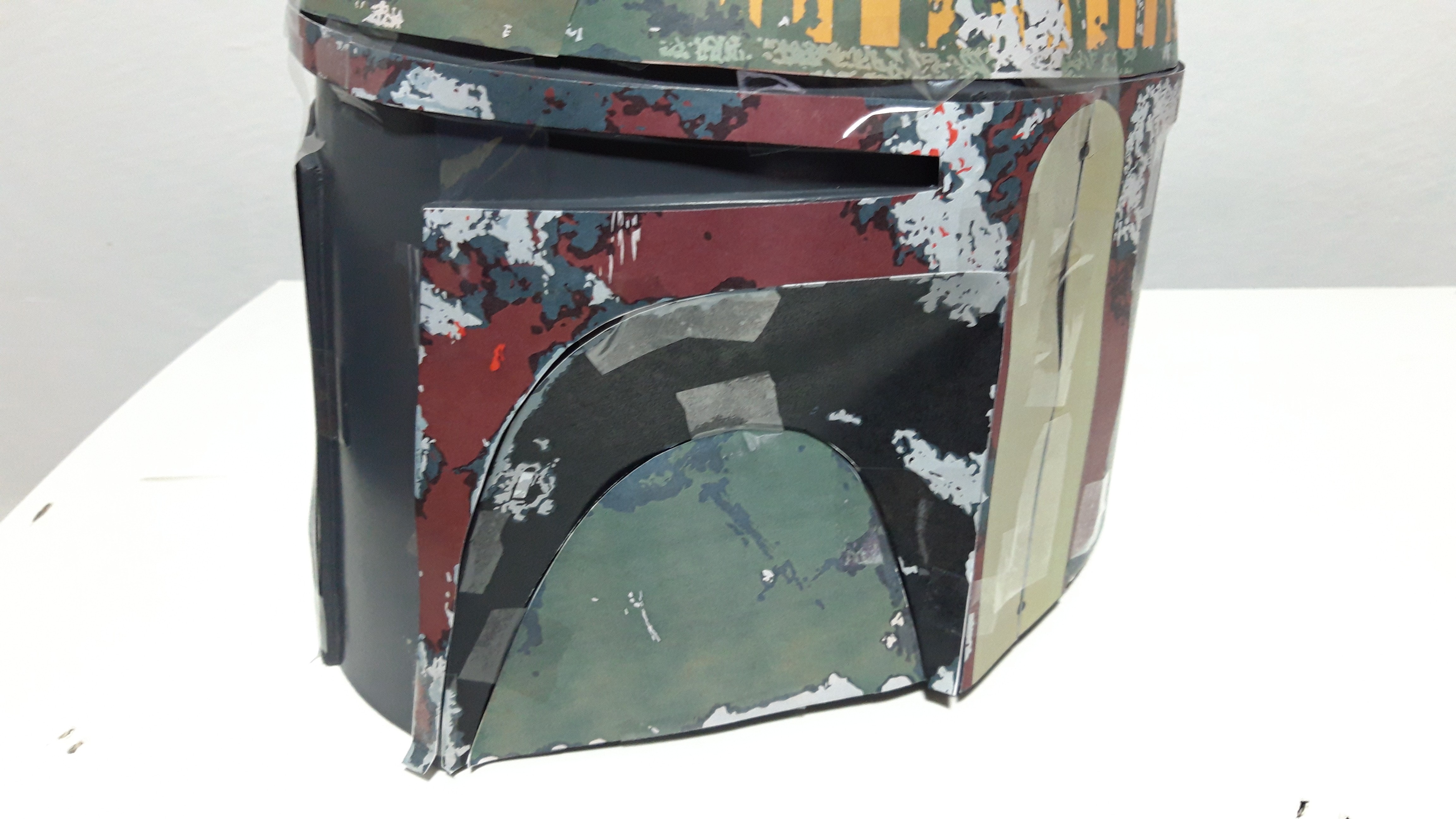

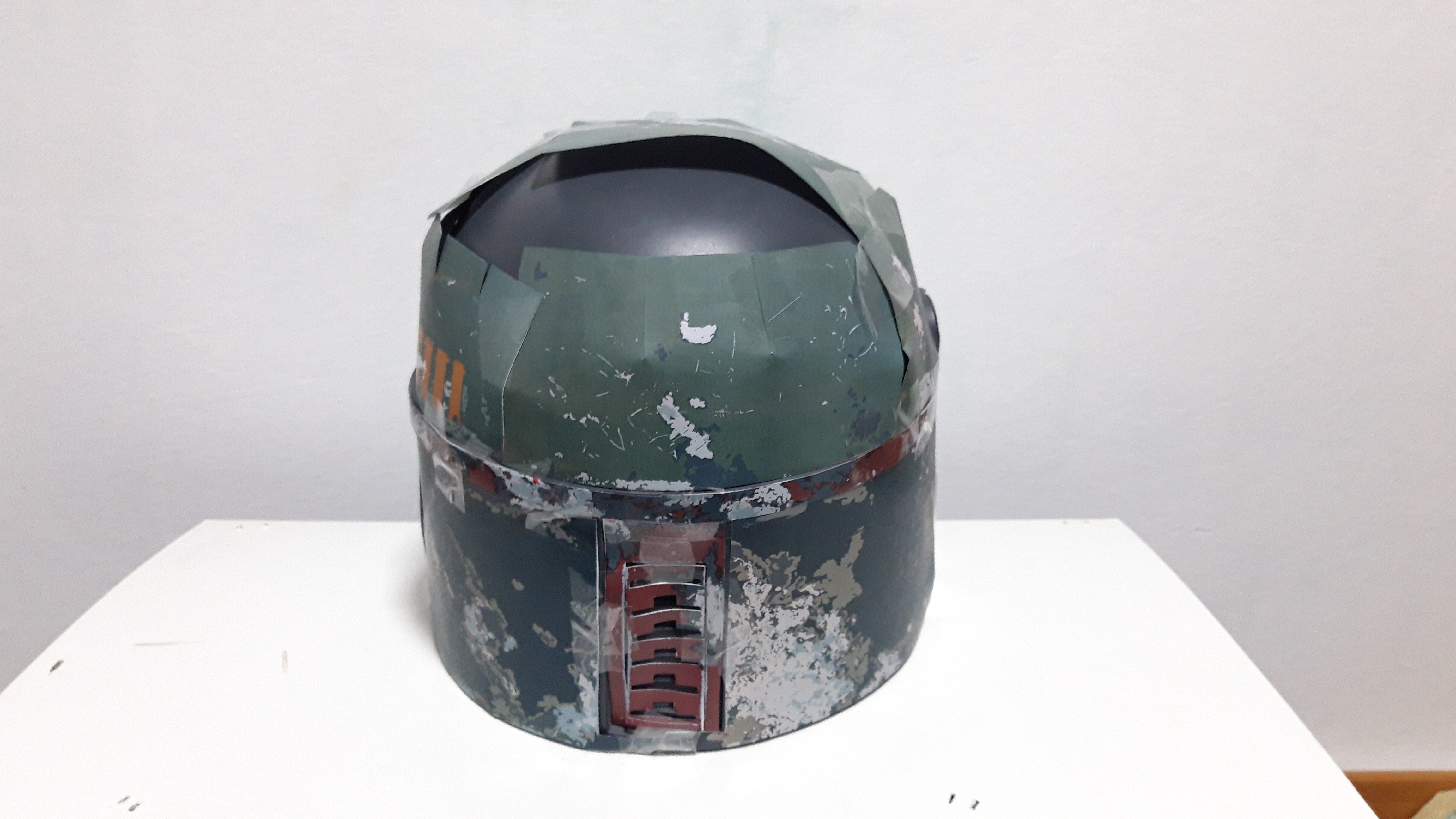

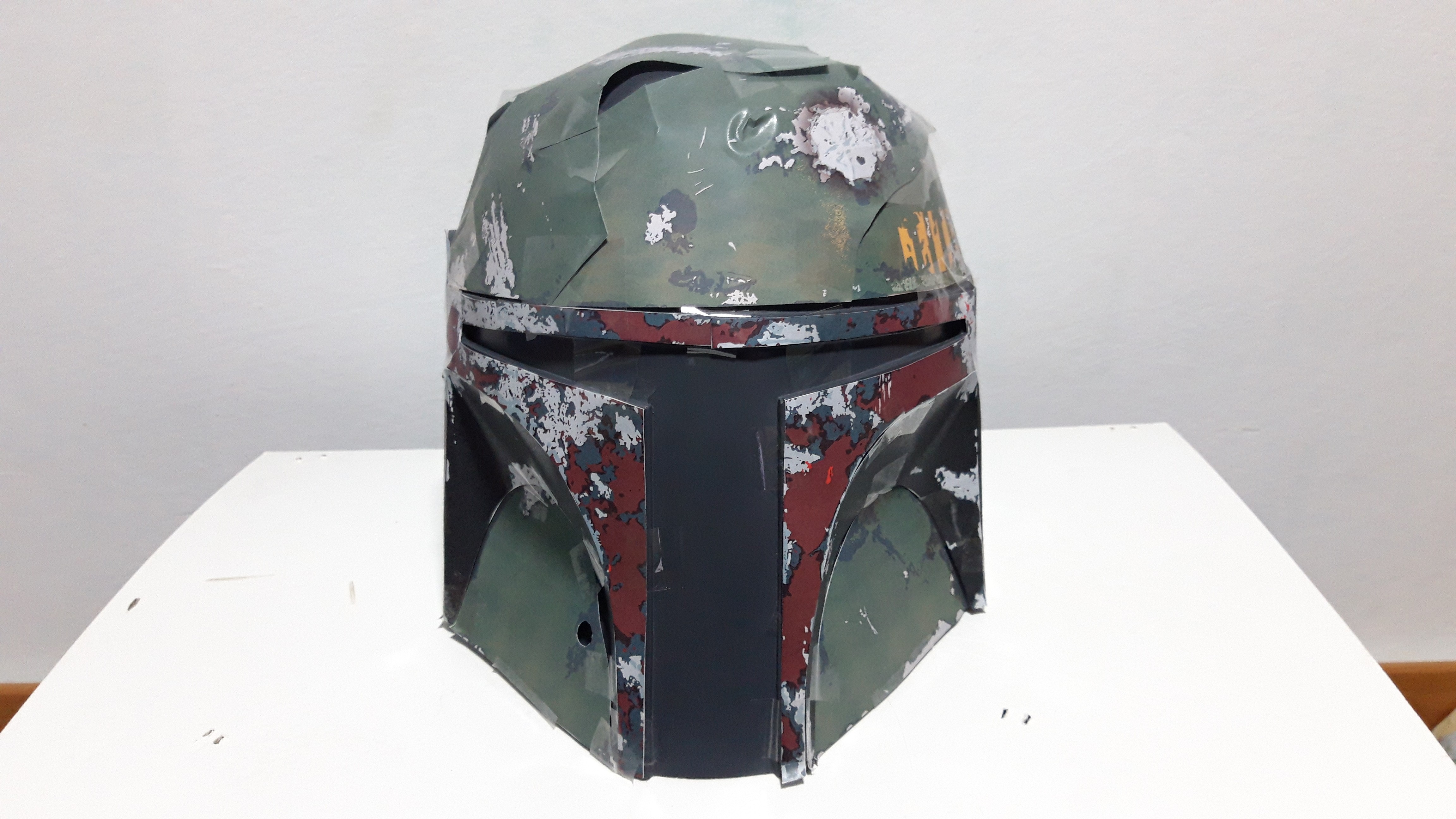

Here are some photos I took a while ago with my RS helmet covered with the cut-out ultimate stencils (these were printed with the fit to page option):
20220111_183808.jpg 20220111_183823.jpg 20220111_183848.jpg 20220111_183902.jpg 20220111_183939.jpg 20220111_183950.jpg 20220111_184027.jpg
It's a 99,5% fit, which is more than enough to line up all the major shapes. There are some small modifications I did for the ultra stencils that will increase the accuracy of the overall shapes.
You should always print the stencils with the fit to page (or fit to printer margins or similar) selection, because when this option is selected in the printer dialogue, the black border should be visible around all sides. The MF and WF helmets are somewhere 3-4, maybe 5 generation casts, while the MC-ESB and RS helmets are 2nd generation casts; the shrinkage is increased with each generation in comparison to the original helmet.
View attachment 221524 View attachment 221525 View attachment 221526 View attachment 221527 View attachment 221528 View attachment 221529 View attachment 221530
