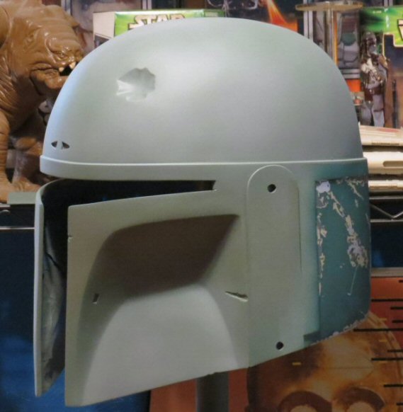

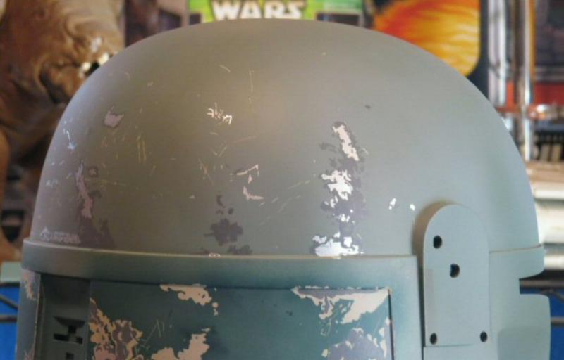

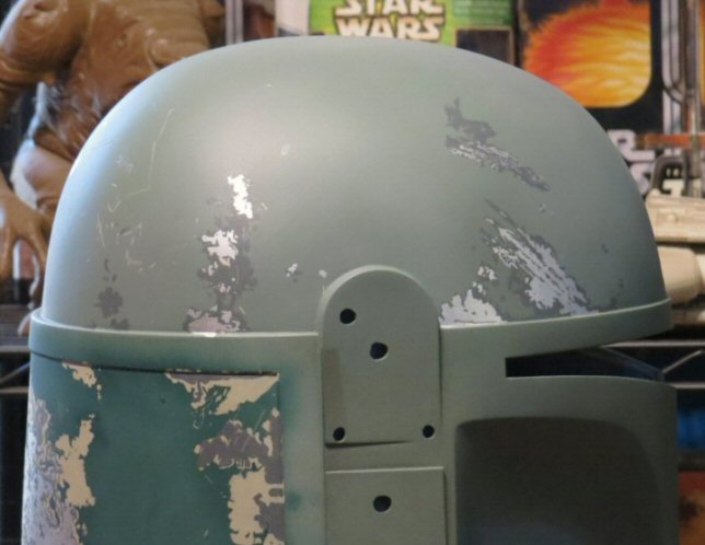

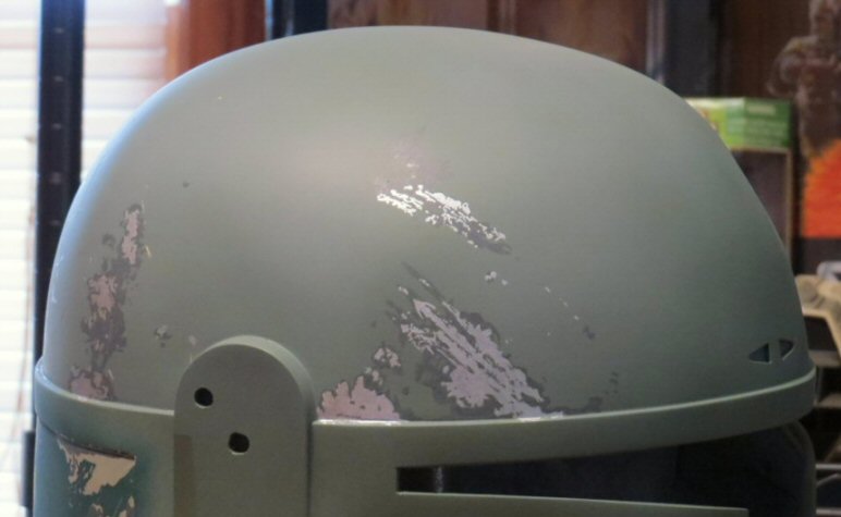

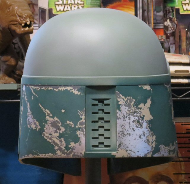

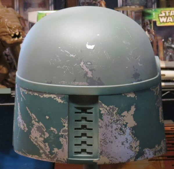

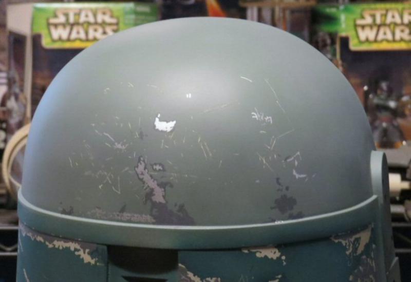

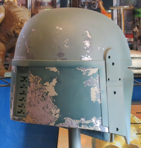

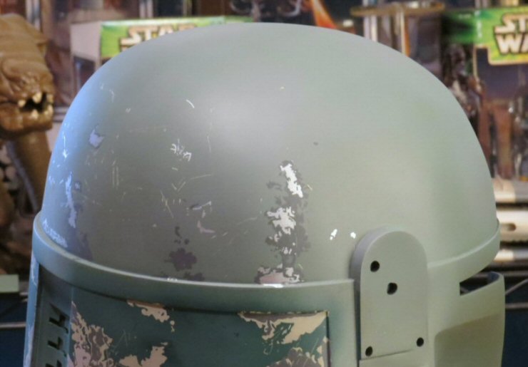

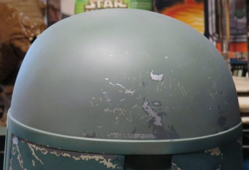

Got the dome and inner cheeks base coated, and did the first weathering pass.
When I do the weathering, I mix a lightened shade of the base color and apply it in cloudy diffuse patterns
all over the surface. Some areas receive a slightly higher concentration of the lightened color, and others
just a misty, patchy coat.
Keep in mind, the contrast may look a little odd in these pics. That's because the dome/cheeks are "naked"
at this point.
After the gray and silver damage is applied, and especially after the red for the mandibles and
band is laid down, things will look more normal.
When I do the dome and cheeks, I also lay down the same base coat on the left ear. I simply don't weather
the ear piece. That way, I can use it to gauge how much I'm shifting the color when I weather the helmet.
Next I'll begin applying the gray and silver on the dome. It'll be a gray and silver world for a while now!
