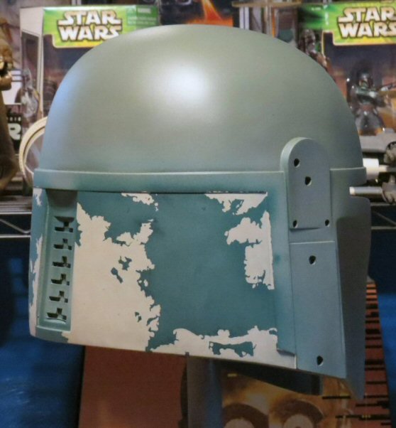

Making good progress. :) Got the rear panels masked off and airbrushed the blue-green shade. As usual, I used my
Winsor & Newton masking fluid to block out the shapes. I finally had to buy a new bottle of W & N after about 5 years!
My original bottle just got too thick to be very usable.

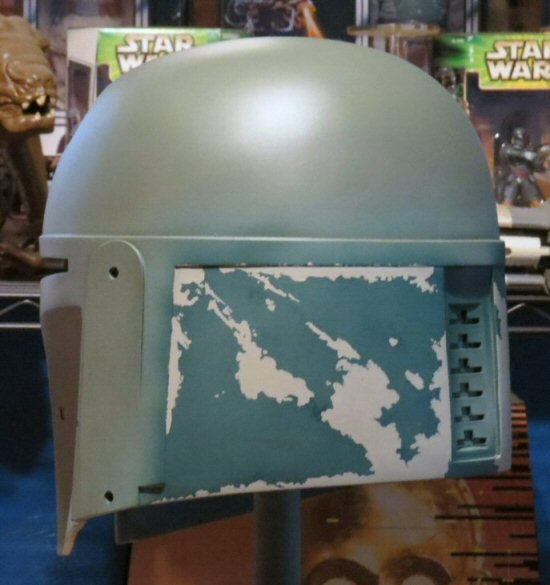

After unmasking, I pulled up some reference pics and used a small detail brush to tweak the edges between the beige
and blue-green. I do this on all my paint ups. The masking fluid can be coaxed into some pretty intricate small shapes,
but I'm never quite 100% satisfied with all of the shapes. Here are a couple of pics.
On the left panel (above) there are some small details that I don't even bother masking off when I spray the blue-green.
I just do them topically afterwards during the tweaking stage. That's one advantage of painting in the "Layeropical" method. :)

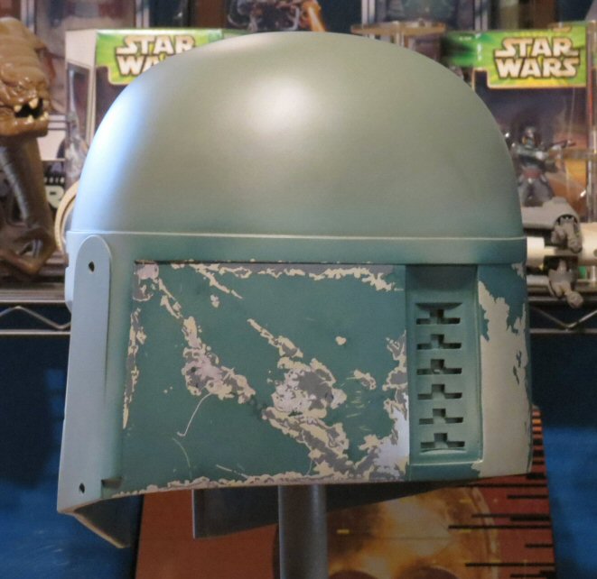

Got the left rear panel complete. When I detail a section, I break it down into several painting sessions. With the left
panel I began with the silver and then did the gray. Once the painting was done, I used a sharp metal tool to add the
very thin physical scratches. I'll use this technique again on the rear portion of the dome, and several other locations.
I'll begin the right rear panel by stenciling the silver/gray areas. Then I'll begin with the giant silver scrape *sigh* :lol:

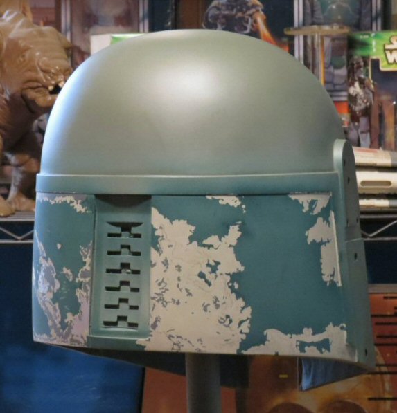

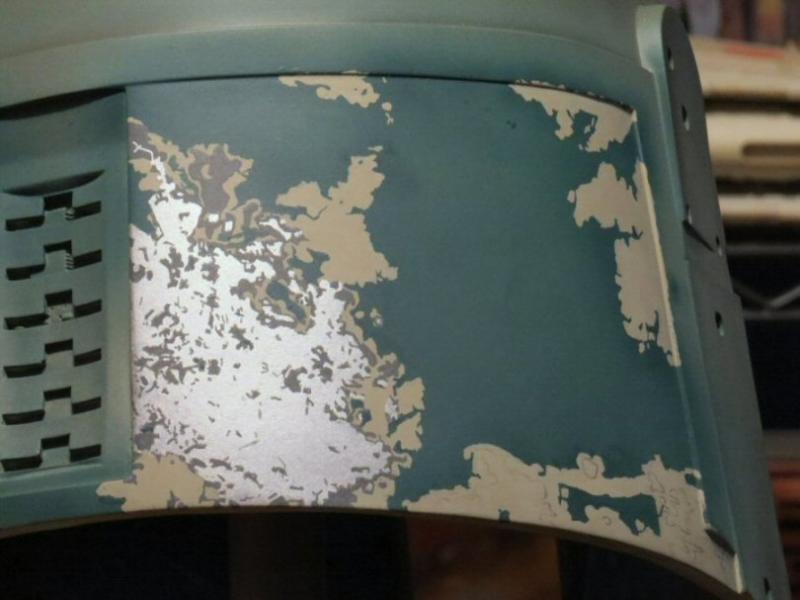

UPDATE 2: DAY 5
Beginning the giant silver scrape on the right rear panel. When I do this, I begin by stenciling on the major shapes.
I include some of the "major" gray chips within the silver and paint them on before the silver. These give me some
landmarks to guide me in doing the whole network of tiny chips and scratches once the silver is down.
After I lay in the silver, I'll go back for a second pass with the gray to finish the small chips, as well as
the gray that mostly surrounds the silver.

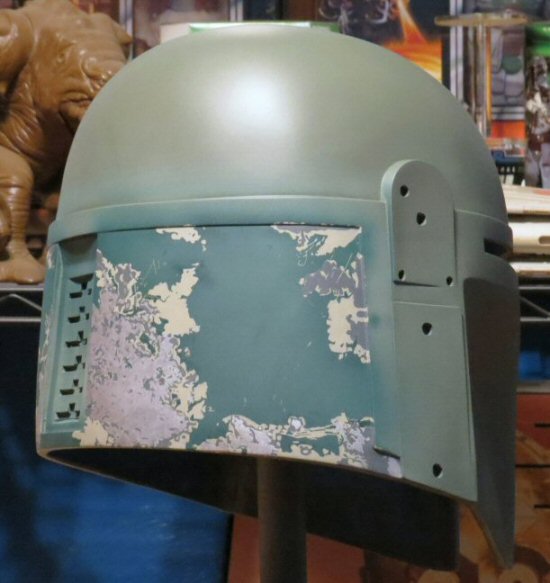

UPDATE: DAY 6

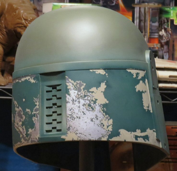

Whew! Got one big stage done on the right rear panel. This is the result of several sessions from yesterday afternoon
to this afternoon. All those tiny chips make me cross-eyed! :lol:
It's hard to get a good shot with even lighting since this area curves around the panel, but here are a couple of different angles.
A bit closer. . .
You might notice the stencil lines are already in place for the lower right section. I'll begin this tomorrow and then
move on to the upper right section to complete the panel. The pale contrasting gray will be added at the end of the project.

How do you get the silver to look so even? Ive tried to lay down silver topically to sharpen edge details with a brush and it seems i cant avoid brush strokes or unevenness.
Thanks a lot, guys!
DV, the silver is pretty even, but there are some variations that don't quite come through in the photos.
The Floquil Bright Silver is by far the best silver paint I've ever used. It goes on smooth and levels out really nicely!
UPDATE: DAY 8

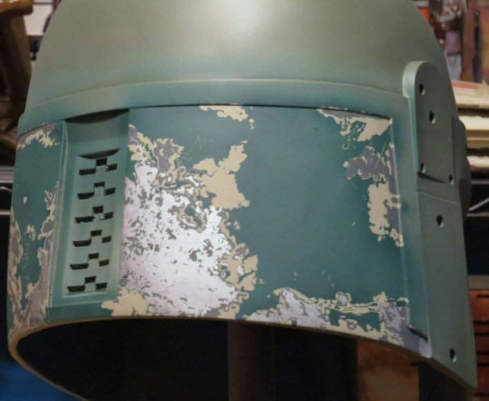

Don't have nearly as much time during the week, so it took a couple of afternoons to finish off the right rear panel.
There's just a touch of silver that will be added later along the top edge of the upper right section. The position of
the silver is closely tied in with the detail on the "hat band" so I wait to add it until I do that part of the helmet.
Here are a couple of shots, including the small physical scratches.
