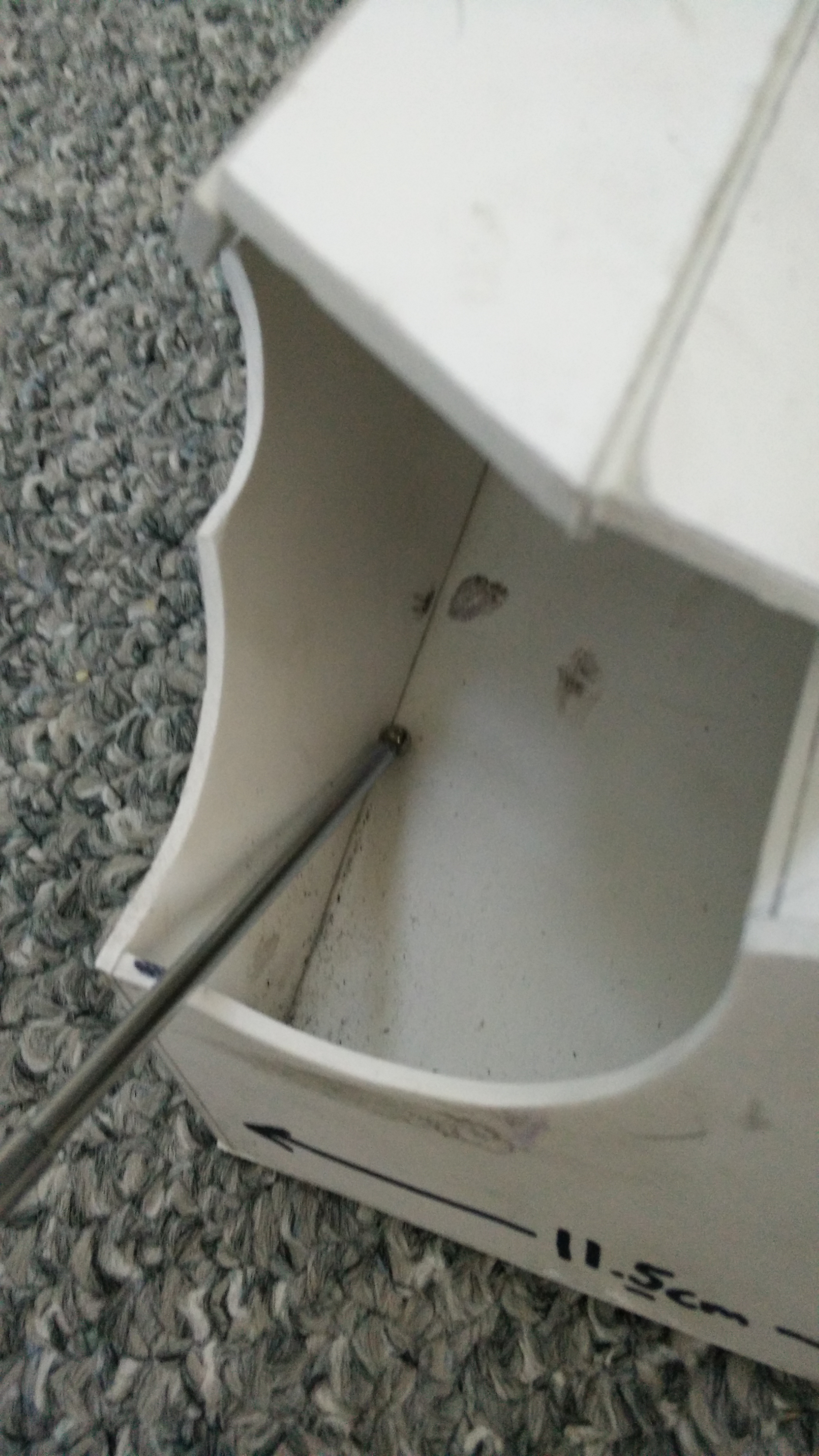

As for the inside of the joints, is there anything I can apply (again, maybe some kind of glue or filler) to help give these pieces a little strength? (more than just superglue):
I believe someone on here mentioned a product they used for this. My dad suggested maybe a silicone caulking.

As an update, I ended up using DAP Alex White All-Purpose Caulk to reinforce the "seams" on the inside of the jetpack. As for any remaining gaps, I used DAP Alex Flex Spackling since it's flexible and sandable.

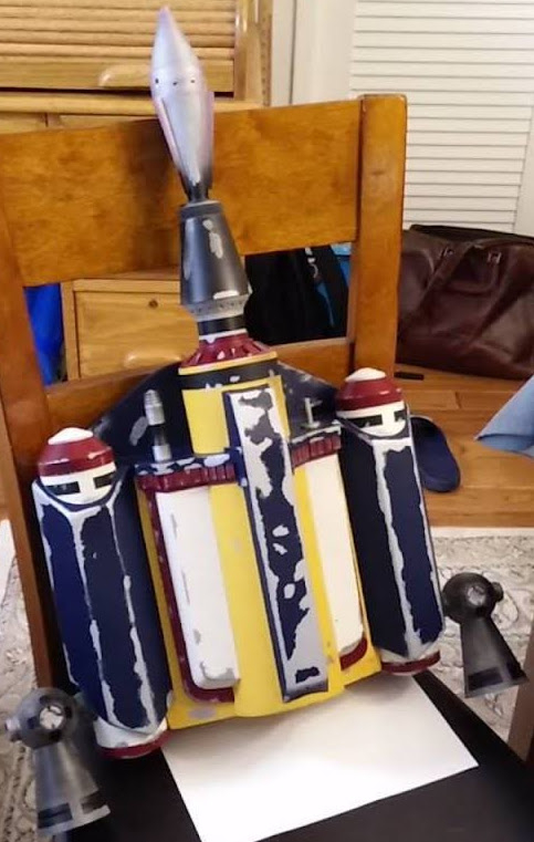

In the interest of documentation for future people who might see this, I think the DAP Alex Flex Spackling turned out pretty well on my jetpack.
Here's my pack made from Sintra, cardboard, 3D printed parts (PLA+), and spackling as filler:
The colors came out a little wonky in the pic, but the body is regular Rust-Oleum Inverted Striping Yellow (the one that technically requires a machine to spray; it's more orange in color than the one intended for hand use).
The blue is Rust-Oleum Satin Midnight Blue, which is probably a little dark, but closer to the correct Pantone color than Rust-Oleum Satin Ink Blue, just a little dark. If I were to redo it, I'd go with the Ink Blue, and just mist some black on to darken it.

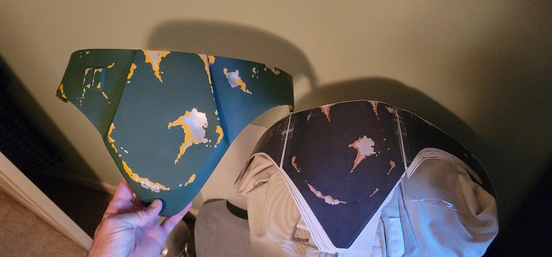

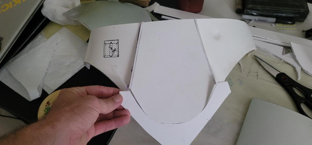

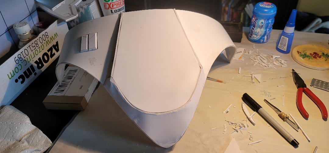

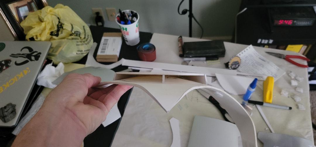

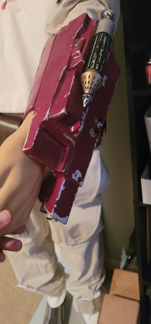

Hey Gents,
All my armor is handmade with 3mm sintra, with exception to my purchased back plate. I used superglue to connect the panels/pieces together after cutting them from stencils. I've used DAP, I believe it's called. It's a drywall spackle that goes on pink and dries white. Which is kinda nice for those who sit and watch it dry so we can get right back to work asap. I found that it's cheap and works great. Yes, mixing with a lil water makes it a lil more spreadable in those tiny gaps. Sanding is a breeze but you gotta go light as it's easy to sand too much. Any pin holes can be filled with spot putty. Here's a few pics of almost finished guants and codpiece. You can see the pink cap tub. Thats the DAP filler.

Afterthought: It's crucial to scuff-up the sintra to give the DAP something to bite onto. I've also sprayed a few coats of matte clear over the sanded DAP before priming and painting. I feel like it might help sealing it if it's near a bend or somewhat flexible part like knees. My 2 cents...enjoy.
