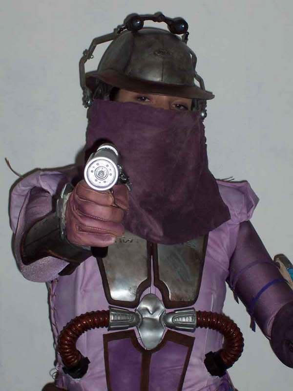

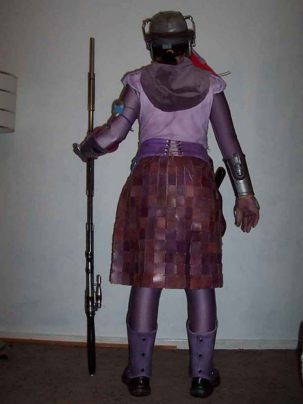

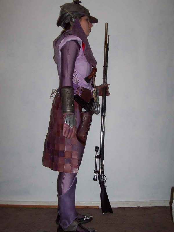

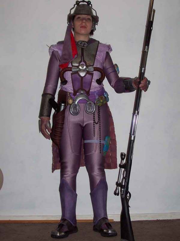

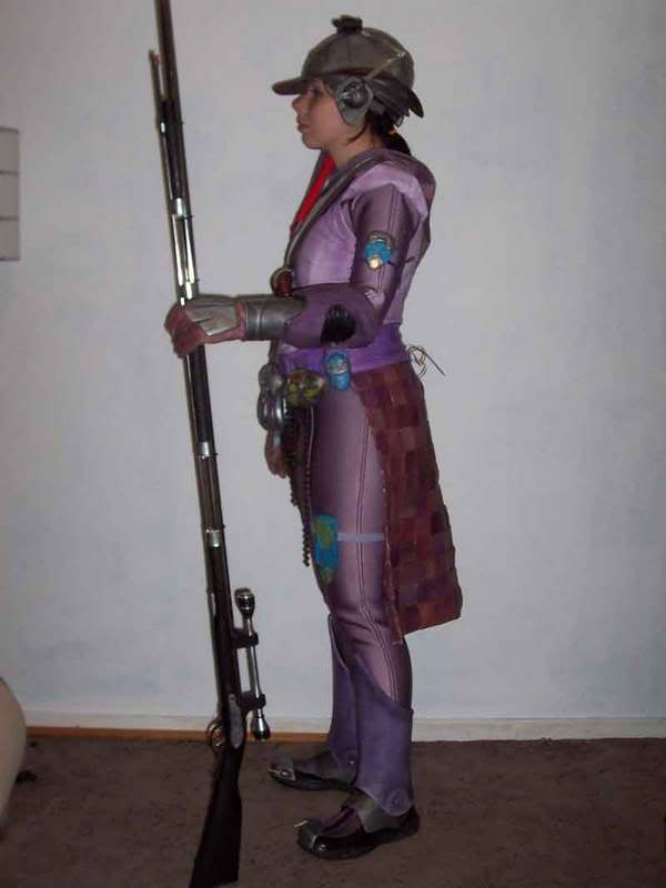

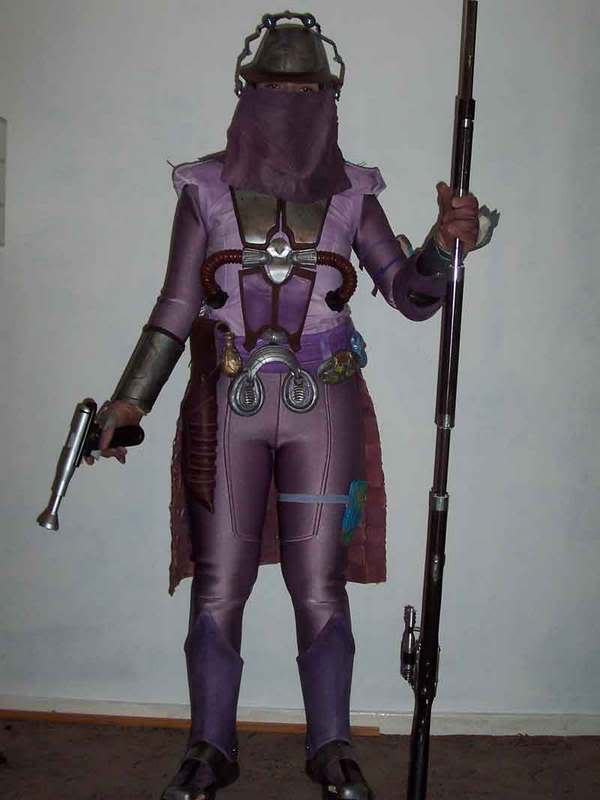

First time its all on and i felt like i was in a straight jacket all over LOL. How cool though to finally be a Zam. I saw it in the mirror for the first time and kinda couldnt believe it was me. Needs bits tweaking still as my hand plates kept falling off (we just stuck em on with tape for the photos)
Thanx you all sooooooo much for being here and posting up all the info and links and sources and advice for this costume over the years and years ive been trying to do it. Without you guys this would either have never been possible or would have taken years longer!!!
If anyone sees anything that could do with changing or improving then let me know, for example the hoses, we need to work those out better. The tension pushes the vest outwards. So how did you guys fix that?
Weight of the blaster on the belt, pulling down etc. How have others fixed that?
wow...looooooking good becky!!! I think you guys did a great job...as far as the hand guards...try some industrial strength velcro..thats what jamie and i used...as far as the hose issue...maybe some sort of snap on the inside near the hose connects to the under suit? on a second layer of leather in the inside? and maybe just a small wire from the holster to the skirt belt may help with the weight of the blaster and holster? just some quick ideas...
