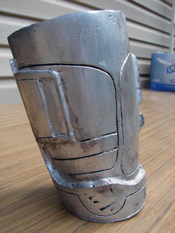

actually no :lol:lol::lol: I used my small experience with the greebs and applied it to the gauntlet...came out pretty good i thought for a first go at it...the hardest part was getting the leather on the cuff beleive it or not...

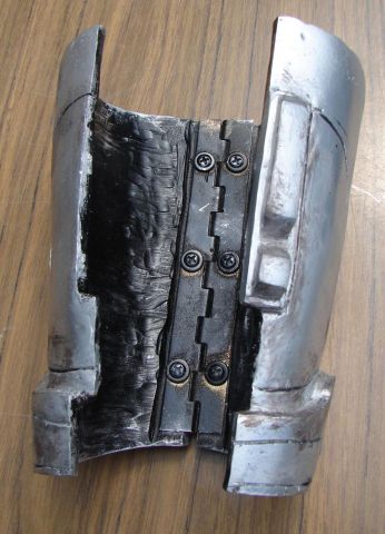

process was easy in the concept...I sculpted the full gauntlet and then put it into a cylindrical container that was just a tad larger than the piece...poured the mold material around the outside. when it was set up i cut the plastic bucket off then made a slice down the mold material from top to bottom in an area where i knew it wouldnt make a difference in the final cast and be an easy sand off if a line showed...I then put the mold into an identical plastic bucket and put a clay "arm" inside the gauntlet mold to save on wasting the plastic resin. I then poured the void with the casting material (a liquid plastic). Once that was set up the fun began...forgot to spray the clay which made for a real time getting it out of the inside! The inside also was still too thick, but i didnt want to go to thin. Dremmeled out the inside so it was a decent gauge thickness to fit Jamie's arm. The other tough part was cutting the spots for the hindged opening. My dremel cut off wheel wasnt deep enough so I had to carfully chisel the remainer by forcing a very tiny screwdriver into the crack and work it very slowly. once I had the "door" seperate, final clean up and sanding went faster...then some base of krylon fusion satin black and touch up with rub and buff...(silver leaf first, then pewter to dull some select spots and finally some roman bronze for the dirt and rust look) The hindge was actually secured with small computer screws that did pop out the back(pre-drill first to avoid a split)that I just filed off with the dremel and then covered with bondo.
The only other issue was the side greeb on it...I casted it way to big and had to dremmel the whole thing down and redetail it with a small pointy dremel bit. We will be installing two earth magnets in the opening to have it stay secured while wearing it...like you, im starting to like magnets for certain things.
I'm sure the second gauntlet will come out a bit better, but that too will be a whole new story with the cuff section. The worse part about doing this stuff is the cost of the tinsel 70-25 mold compound....its in the area of 120 bucks shipped to have enough to make the molds for the two gauntlets and maybe a couple greebs...thats the scary part...pour the mold on faith and hope it works out cause it can be real expensive if it doesnt...:lol: we've been lucky so far.

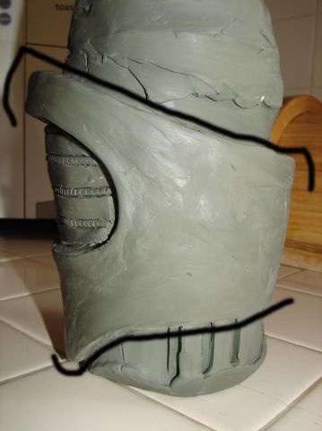

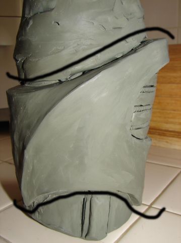

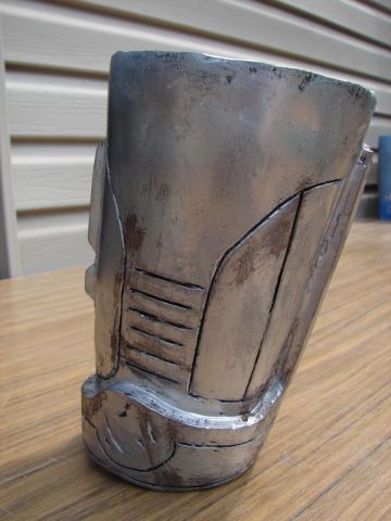

so with the right gaunt finished...i was able to use the old sculpt for that to sculpt up the bottom part of the left gaunt..once this is casted, I'll make the top cuff section for it...
I learned from the first sculpt and cast that it is easier to make a deeper cut into the clay for the hinge cut out line to make it easier to cut ofter casting...I also decided to spend less time smoothing as the liquid plastic im using sands smooth pretty easy...especially with thin one as there are less areas that are not flat on this gauntlet. The detail scores are deep enough so when i sand the sides they wont disappear.

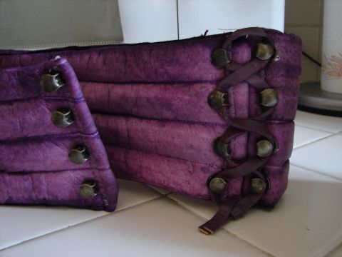

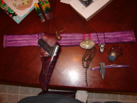

also pictured it our finished up cummerbund belt...Jamie took it into Worcester and stopped by a cobbler who installed the antique boot hooks for us! man that was a tough thing to find...

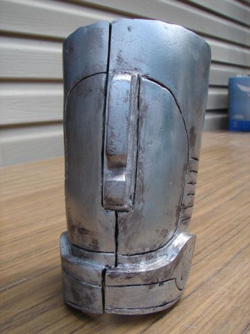

and here is the left gauntlet minus the cuff top..which should be done by the end of the weekend :D
it should be noted that i really didnt worry too much about the smoothness of the overall gauntlets as they seemed to be pretty banged up and weathered...figured the imperfections would add to the look as well as the speed of completion :lol: :lol:
sl tk8456
Dude, you've done blindingly well on these parts :)
Those eye hooks are great too. Nice find.

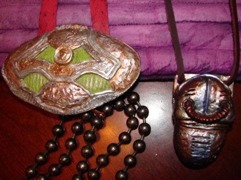

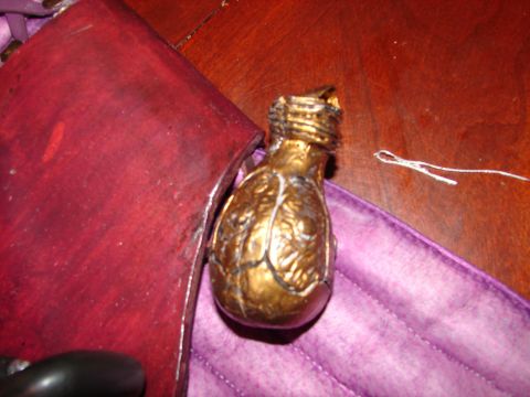

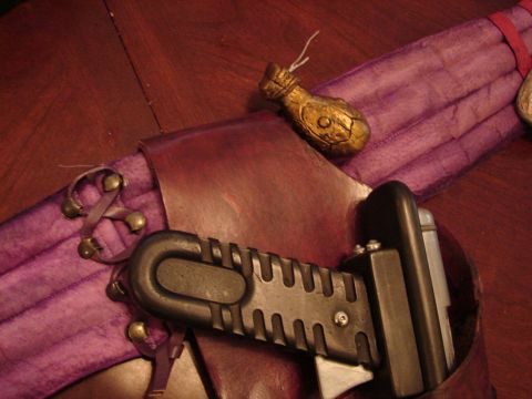

here is the belt finished up with all greebs attached!

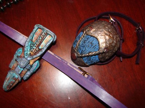

and some geeb close ups...

beyora
So, since you're here, I wanna ask... On the greebly to the right that I ordered from you, why doesn't it have the top part the leather straps go through?
JDFett
That I found was easier to make cleaning that piece off completely and epoxying a small leather piece to the back, extending it and squaring it off to match. Then punching holes in that to feed the leather through.
That worked for me and its actually what you see in that final piece. The casted part I dremelled off as it casted really thin and just seemed more secure with the leather piece.
I used a heavy gauge leather and painted it to match the rest of the piece
