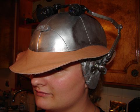

Helmet is here! Thanks again Cal!!!!!!!!!! awesome stuff as usual
so we got the ear guards and the two greeblies on..whole lot of dremmeling to get this to fit her, but alas...it's on her head!...ive got the binocs half weathered but not yet attached to the helmet because of obvious reasons...paint...rub and buff and weathering...plus the brim dying...but here is Jamie looking all zamish...she make a cute zam, but then i'm partial to what i see...LOL

so seeing as i had a few moments before i remembered the troop this week ;) I thought i would do up jamie's helmet...everything is done and weathered with the exception of the brim...need to soak it, dye it and stain it up...the only problem and the reason it's not done...ran out of purple dye doing the skirt...soooo..new trip to tandy in the comming week to get that as well as eyelets for the vest and the right size punch and setting tool for them...
here's some pics of the helmet as it is now...hope you enjoy...

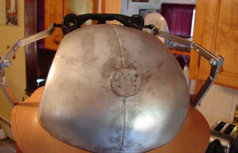

back weathering
left side weathering and connections
back details/hose ect...gotta figure out a way of getting the brim to stop sinking down...
right side weatering(forsome reason in the reference pics..zam has a cleaner right side... ;) :lol: )
I had to actually resess the nuts for the binocs in into the ear guards so they would fit flush with them....worked out okay seeing as it was plenty thick to make a hole for the nut...
