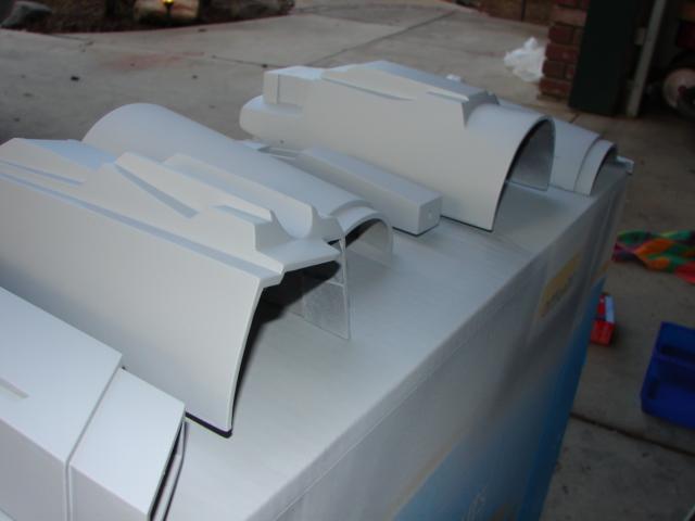

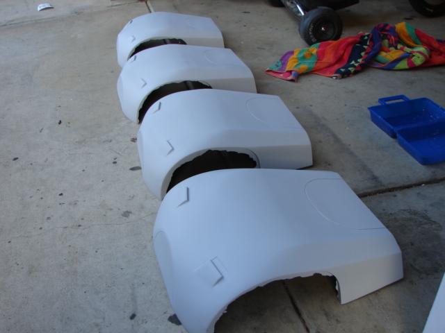

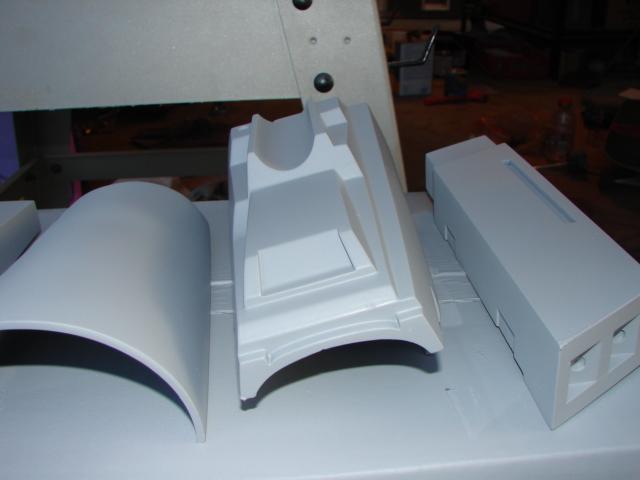

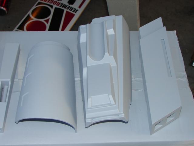

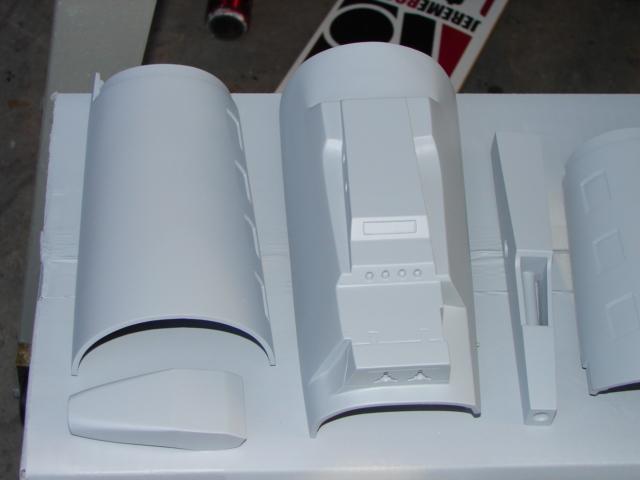

Gave everything the final coat of professional auto primer with the spray gun today. Just need to do a little finish sanding to get everything nice and smooth, glue the hose fittings to the whipcord housing...and then they'll be ready to mold.:thumbsup:

Thanks. The type of feather-fill primer I used really works good on smoothing everything out...so I can't take all the credit. Unfortunately it also smooths out the fine details you want too keep, especially if it's sprayed on thick. So I have to go back and fine sand all the sharp corners and edges back, as well as re-etch the marks on the right gauntlet by the darts:facepalm...but it's worth it!:)
I wish I could throw some hinges on them and take em for a test run, but it'd ruin them for molding...and then I wouldn't be able to share!:)
The length is still 8.5", and the inner "circumferences" are still approximately 9.5" at the wrist and 12.75" on the forearm, with the left gauntlet being adjusted accordingly so it sits slightly lower on the arm like in the ref. pics. Only reason I know this is because I did a test fit with leather gloves on before cutting the shells into halves.
