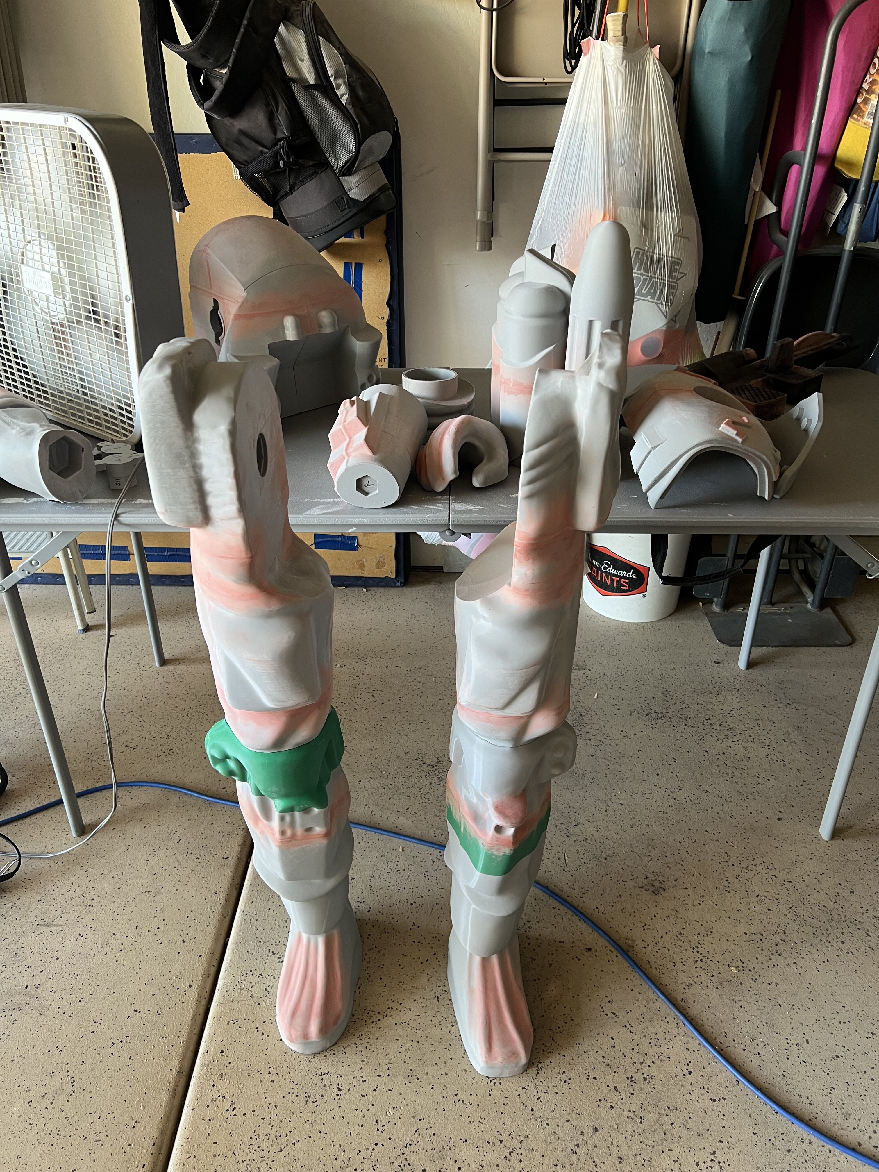

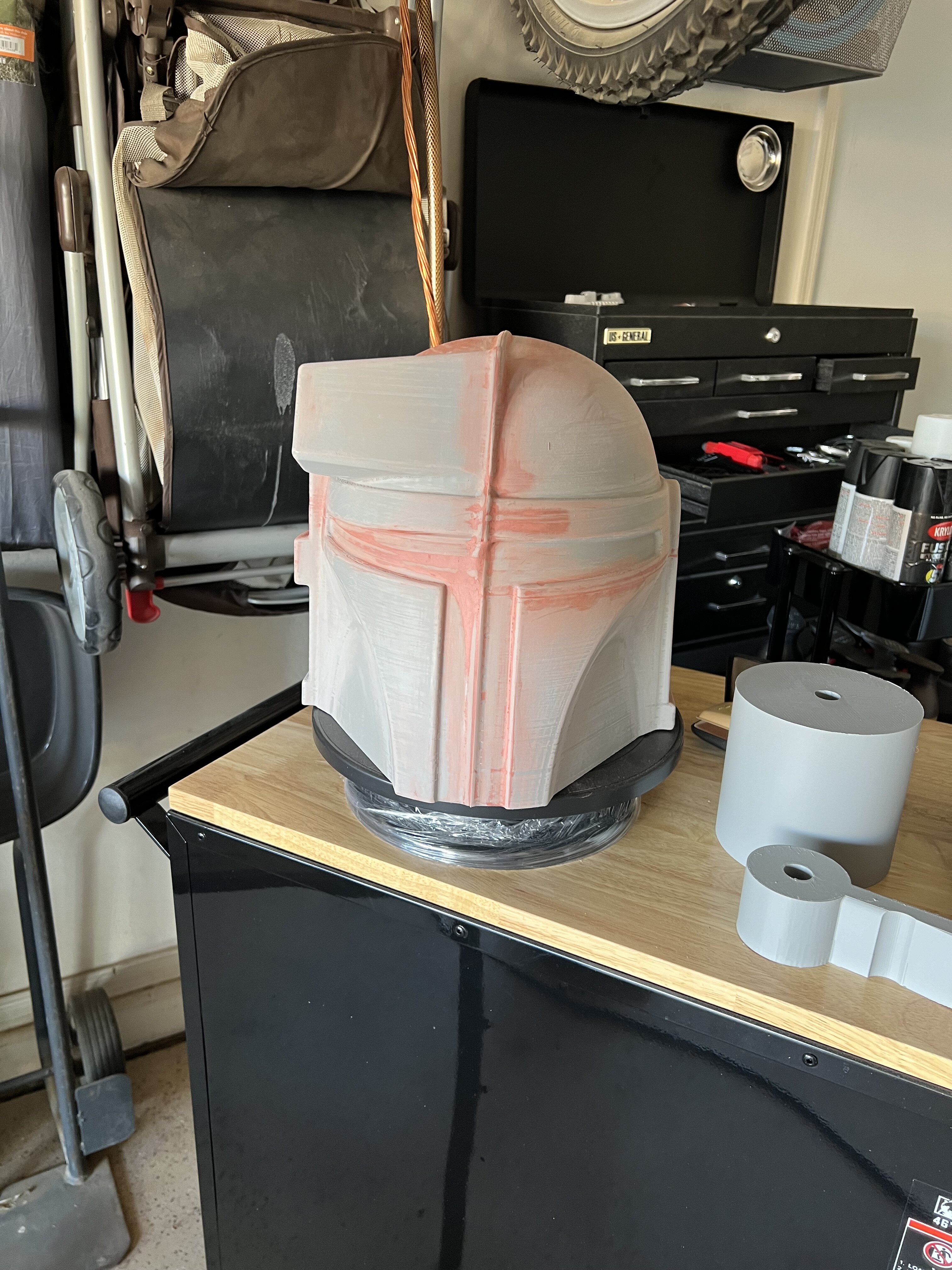

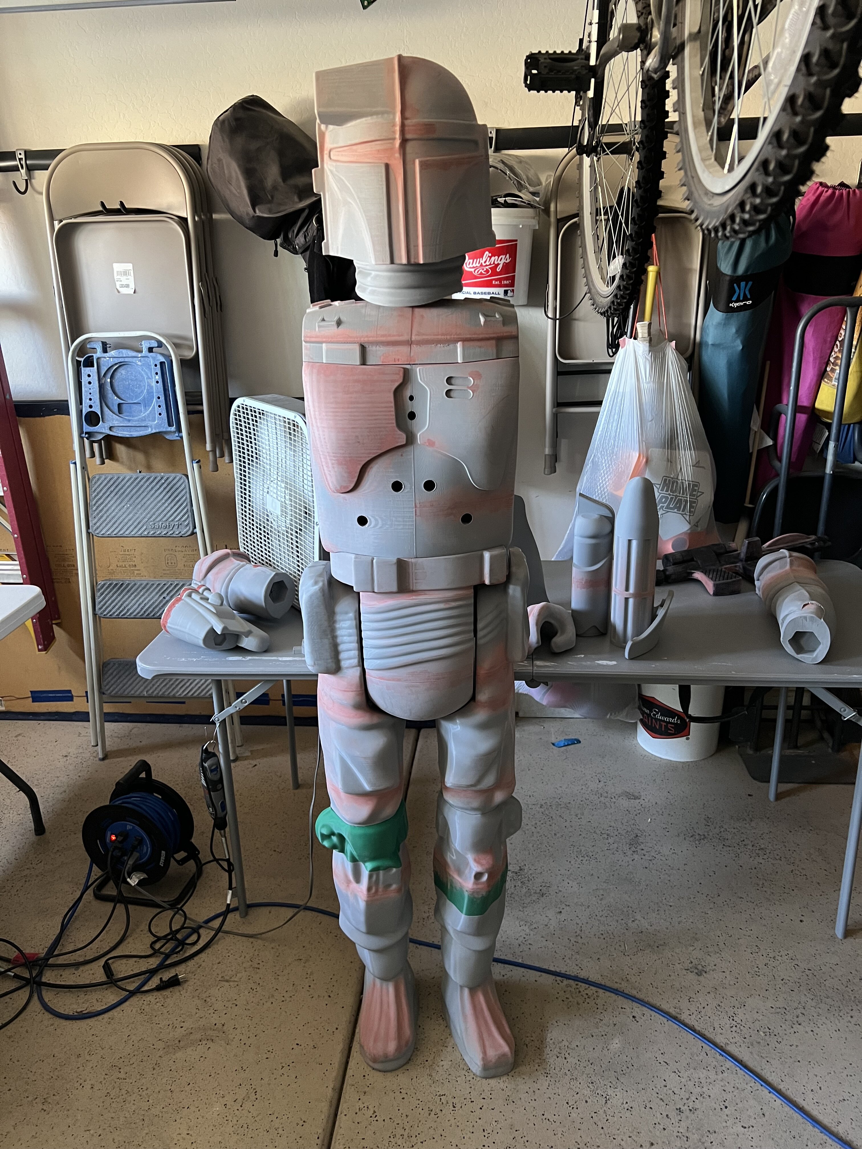

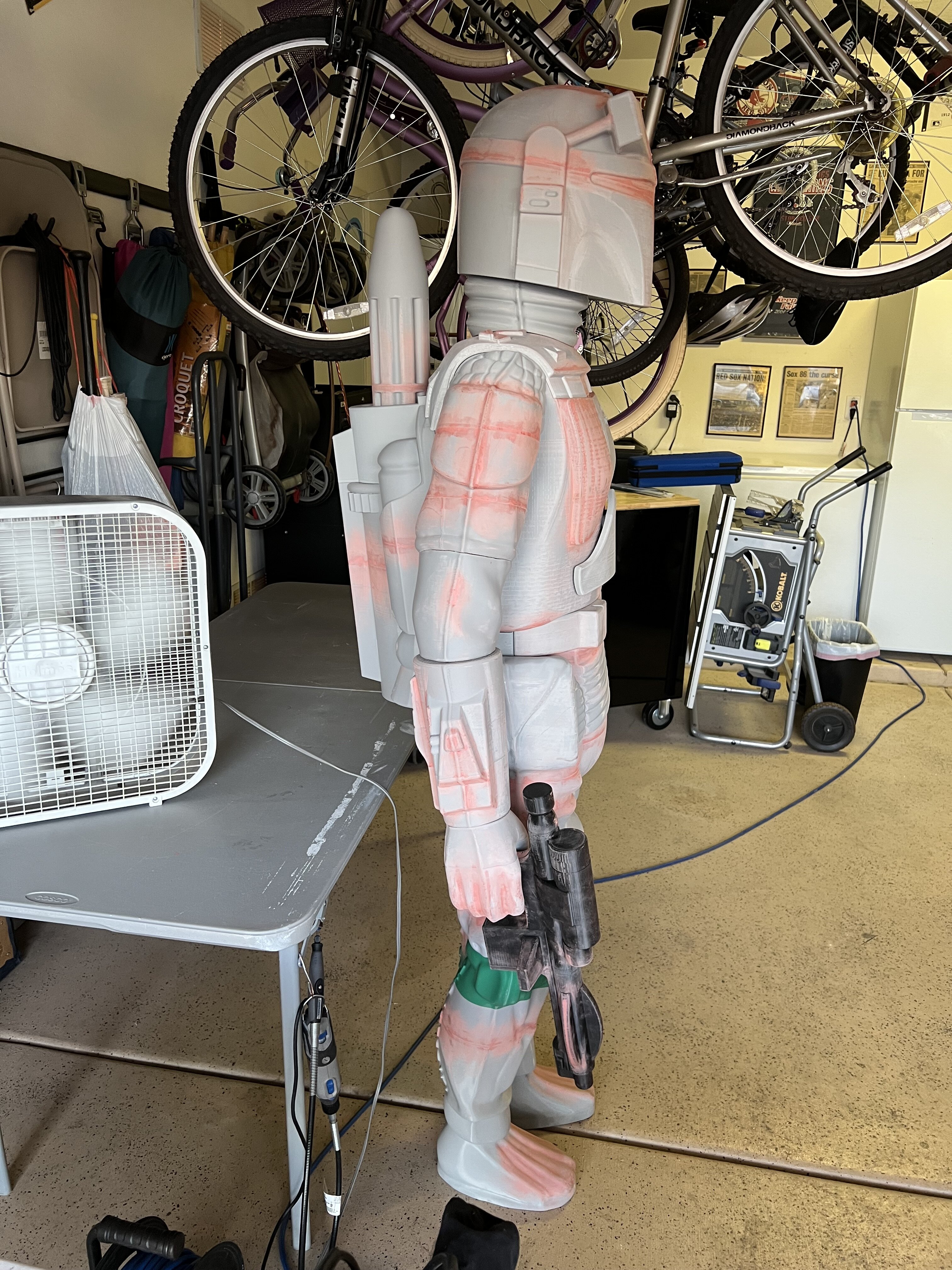

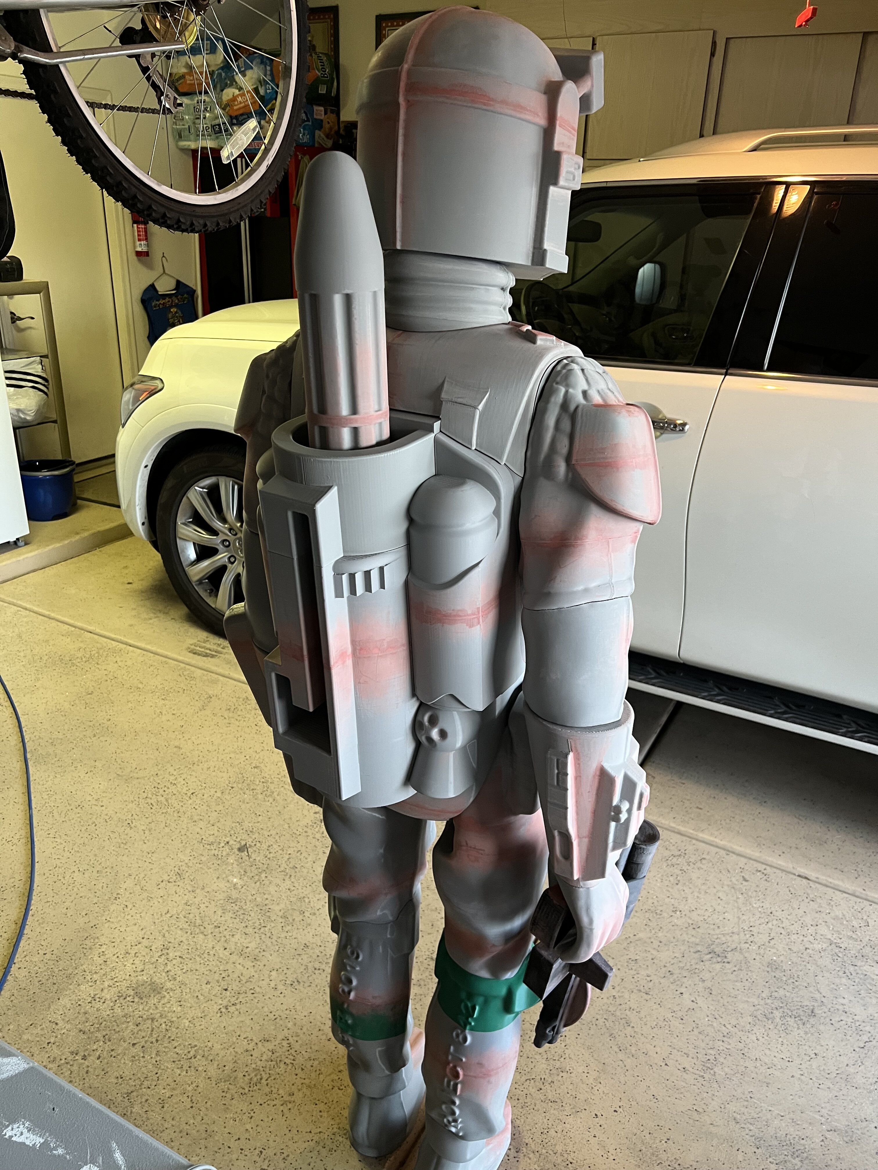

Got some more sanding done and one final mockup before everything gets washed, primed, and painted. I still need to install the rocket firing spring and lever. Not gonna lie, this build was much tougher than I was expecting, but seeing it at this point is incredibly satisfying........

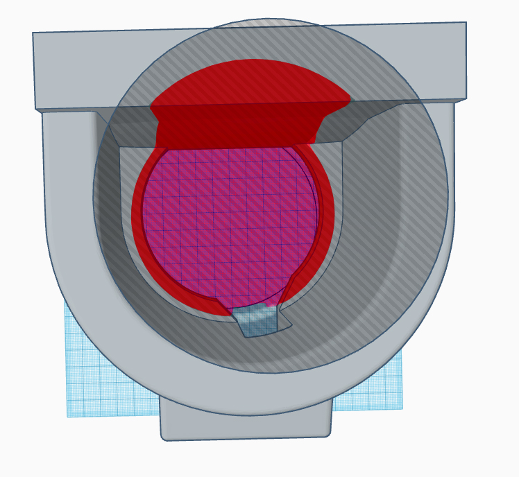

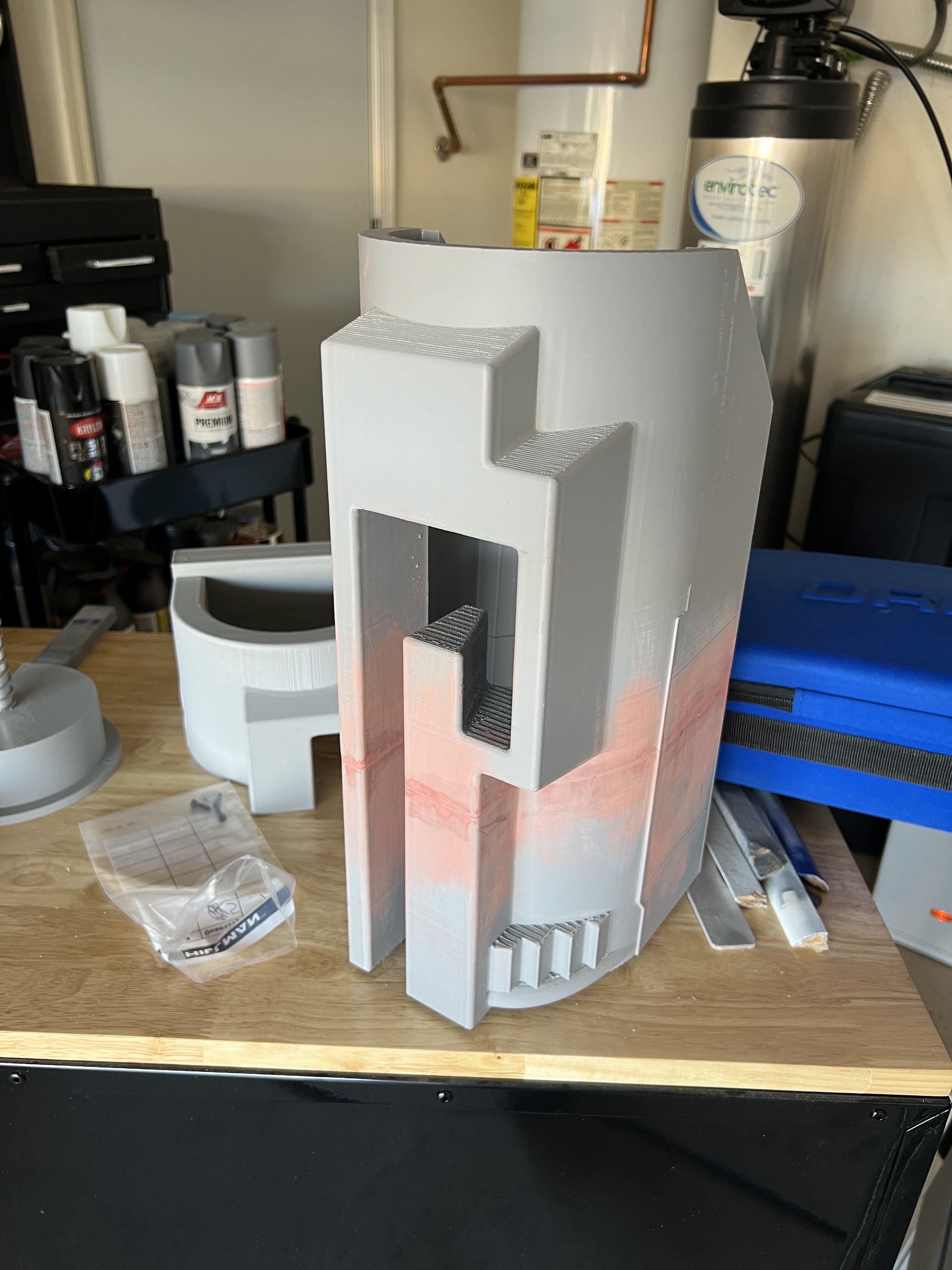

So today I tried to finalize everything before I prep for paint and ran into yet another issue. When I assembled the jetpack to test the rocket firing mechanism I noticed the rocket would not lower into the jetpack. It seems, for whatever reason, the opening of the top "cap" of the jetpack was too small for the missile to go all the way down. Also, the back wall of the jetpack was canted in a manner that even after opening the bottom with a Dremel, it still wouldn't lower.
So I also Dremel'd out a section of the back wall and that worked, but it looked like hell. So, I modified the file and I'm reprinting it.

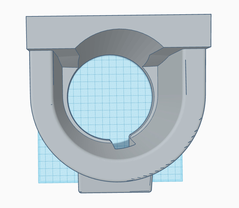

Below you can see in red the ideal amount of material I had to remove...............
And how it looks modified.............
The lower lip is still maintained so the plunger will still stop when firing the rocket and won't come out the top.
Another solution would have been to just resize the rocket and reprint it. But I didn't want to do that because 1), I already had the aluminum rod and spring and those would have needed to be replaced and 2) I wasn't going to be happy with the proportionate size of the new rocket to the size of the jetpack, it would've looked too small in my opinion.

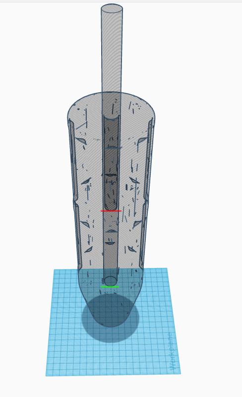

A second issue was the hole size in the rocket itself. The hole didn't extend enough to the top, so when I pulled the lever and plunger down, the missile would hang on the aluminum guide rod. If I let the plunger go it would just collide with the bottom of the rocket instead of smoothly pushing it out the top; and it didn't launch but a few inches. Having the plunger smack the rocket was not gonna work for me. I could have cut the rod down some but I wanted to keep the original length to help keep the rocket straight, and it also makes it easier to load.
The red line below is the original end to the hole, the green line is the new one. Now the rocket will stay on the plunger when it's pressed all the way down.
