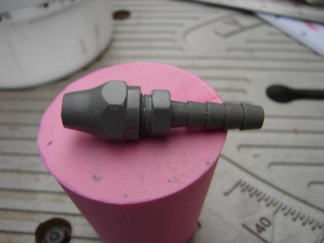

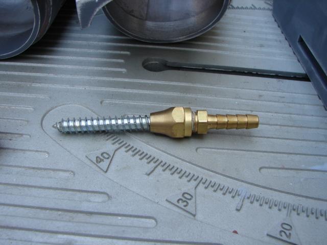

A few pics of the right hose fitting. I carved it from a bad pull I had laying around of a kid Jango flamethrower. It's made of feather light resin so it carves easily and takes a skin of bondo well to fill in all the little holes.
Thanks foxbatkllr. That's a tough call without an actual pic. I'll compare the pin diameter they give with the Home Depot stuff to see if it's any different.

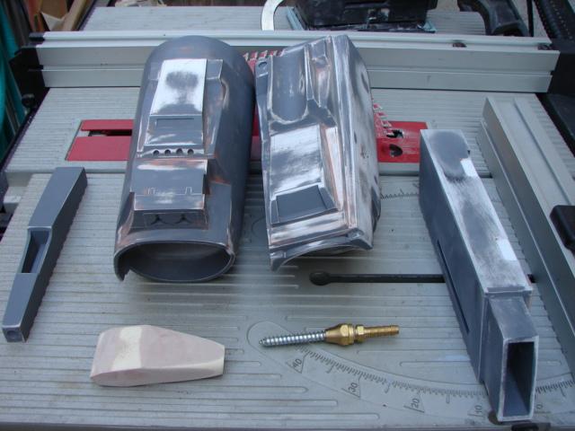

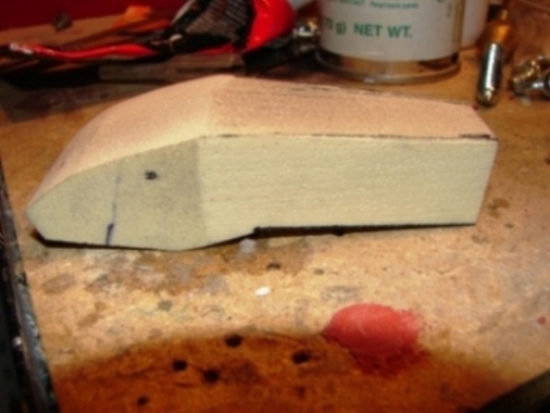

More build up pics.
:confused:)Stayed up till 3 last night...I was in the prop making "zone"!:lol:
Finished the right gauntlet top hose fitting housing and side hose fittings (which will be molded for duplication). The side hose fittings can also be dissasembled and attached to 2" brass nipples to make the flamethrower nozzles for molding purposes. Also carved the small recessed rectangular areas on the bottom of the flamethrower, and did some general spot filling before giving everything a good sand for a coat of primer today.
I'm beginning to see the light at the end of the tunnel now.:thumbsup:

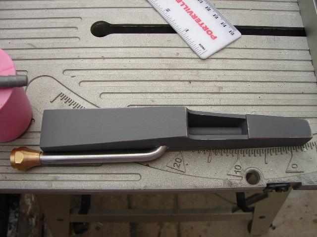

Ok, Ok, now to the serious stuff. I need your guys' input about the metal tube that goes underneath the whipcord unit.
My question is, would you rather I incorporate one into the mold so that it is resin and permanently attached to the rest of the unit (exactly like I did with my kid gauntlets), or would people prefer I leave it off so that a real metal tube could be inserted in place there. Only problem with the latter option is that we'd have to find a good source for the metal tube that fits the bill. In the past, I've used the metal shafts from garage utility hooks, but I think they're a tad small in diameter.
