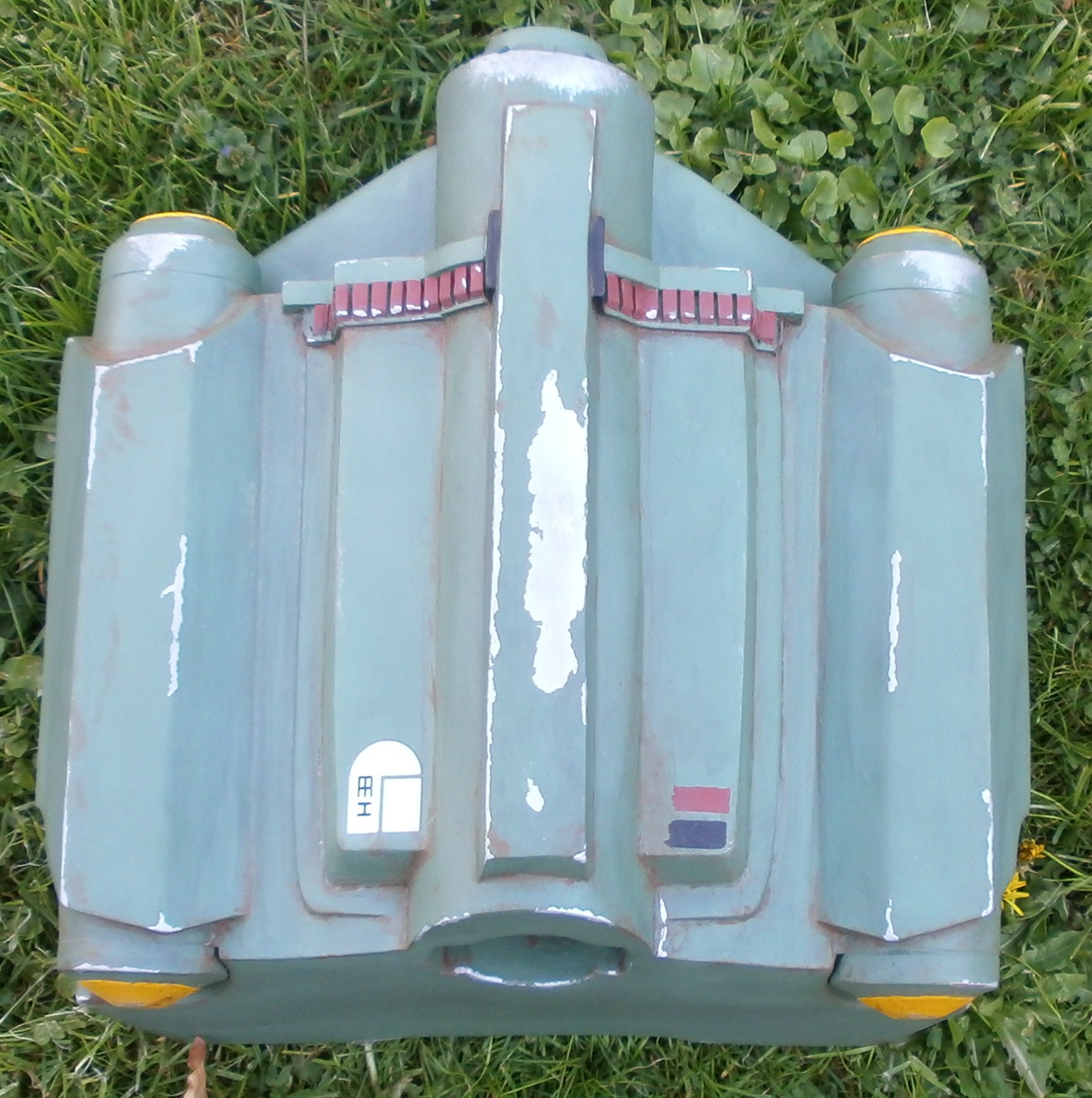

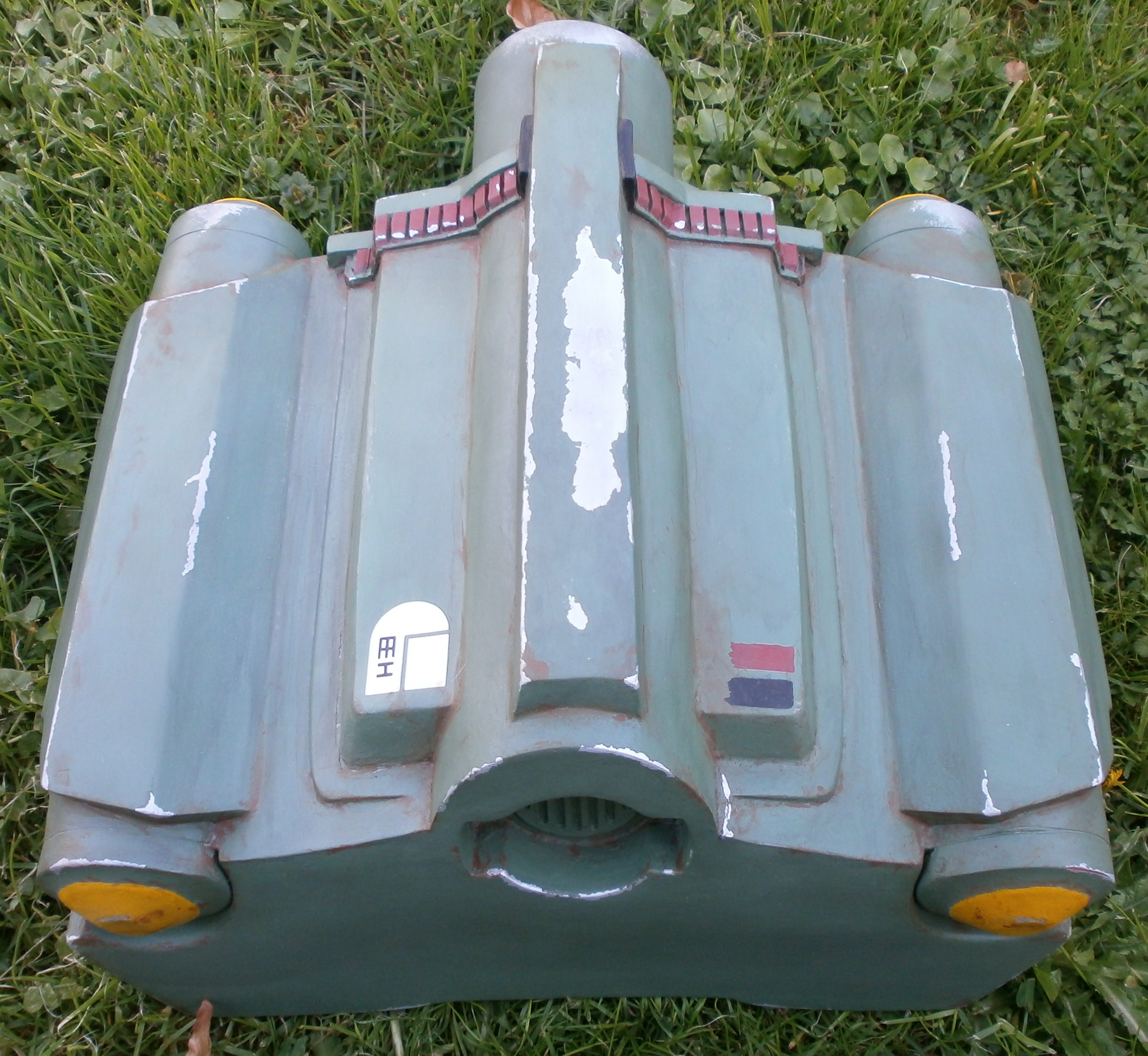

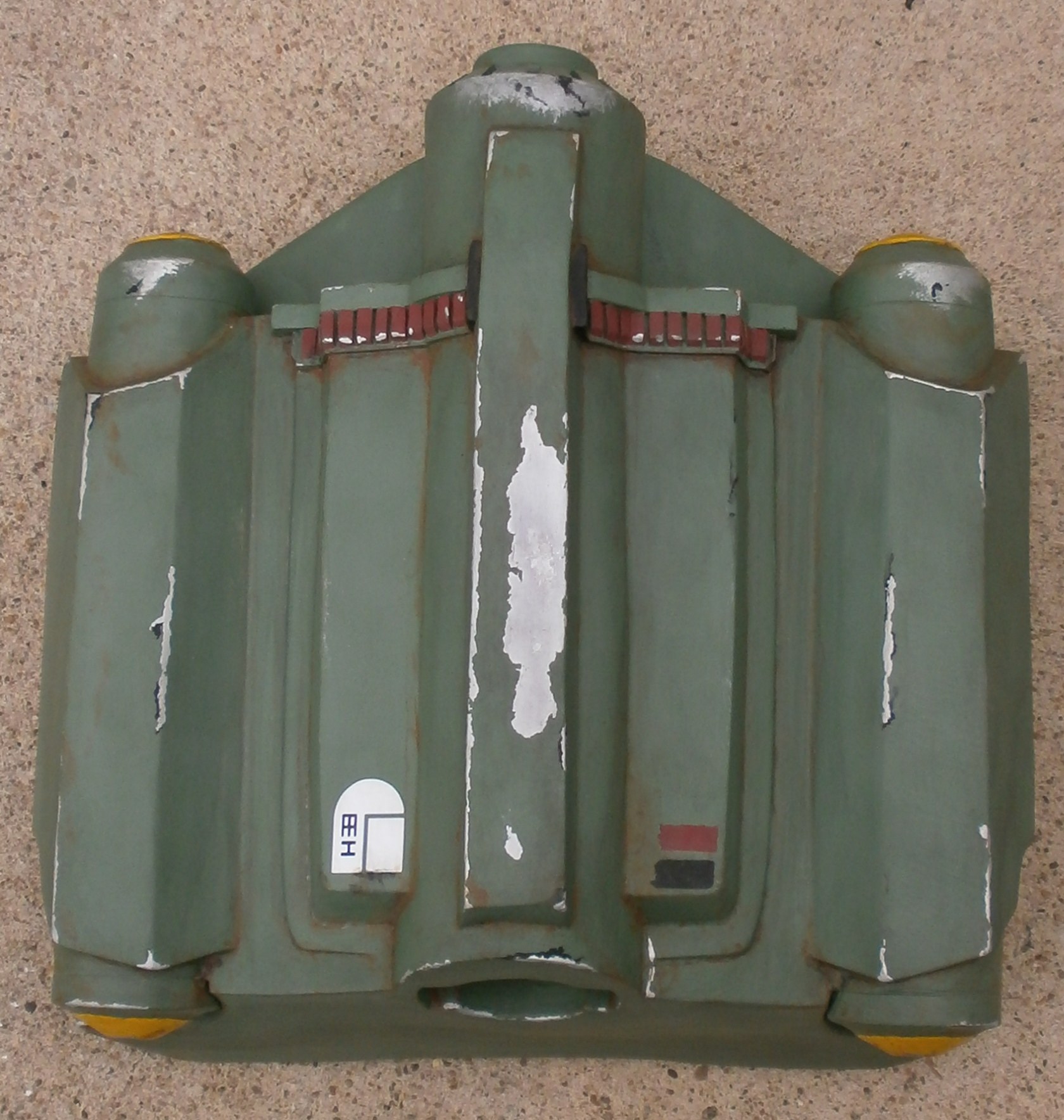

Found some time to do the first weathering layers. Did some small black and a heavy brown wash. ;)
How do you go about doing a "fine" blackwash? I've never blackwashed anything but I looks great! Any advice?
Sent from my SAMSUNG-SM-N910A
Thank you!
Here´s how I do it:
You take a cup with a little bit of water, put in one or two drops of black acrylic paint. Then take a brush and put some of the water/acrylic mixture on the object. Leave it for some seconds up to half a minute and then wipe the mixture with a paper towel away. This you´ll have to repeat until you got the effect you want to create. Hope this helps? :)

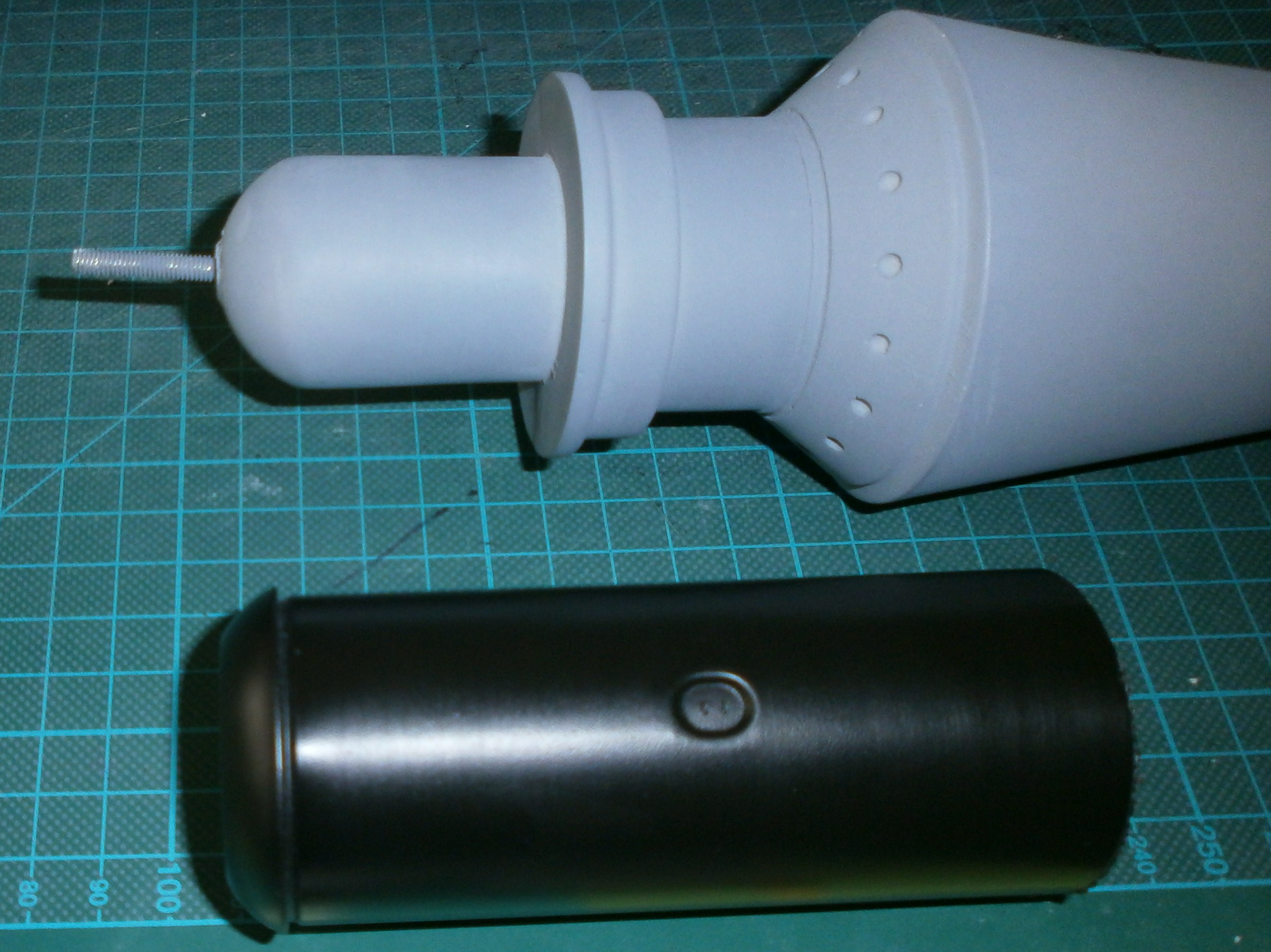

I start with the rocket:

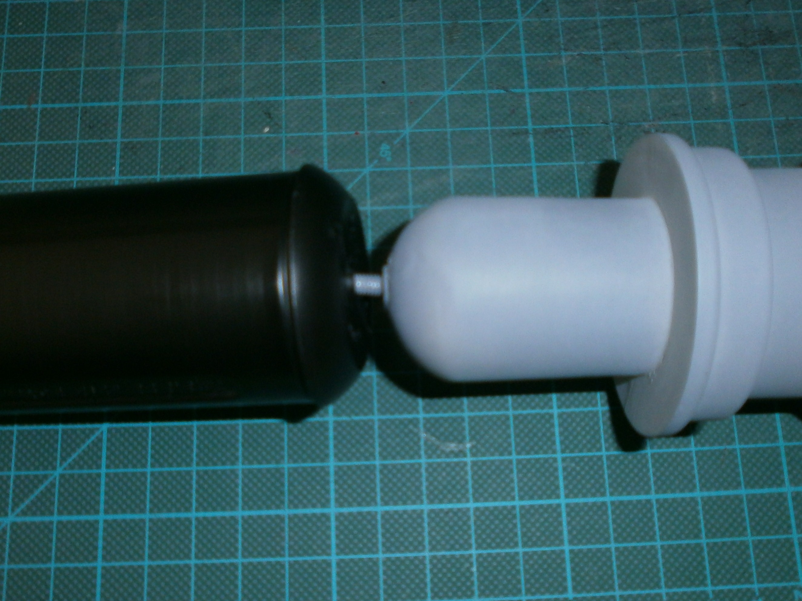

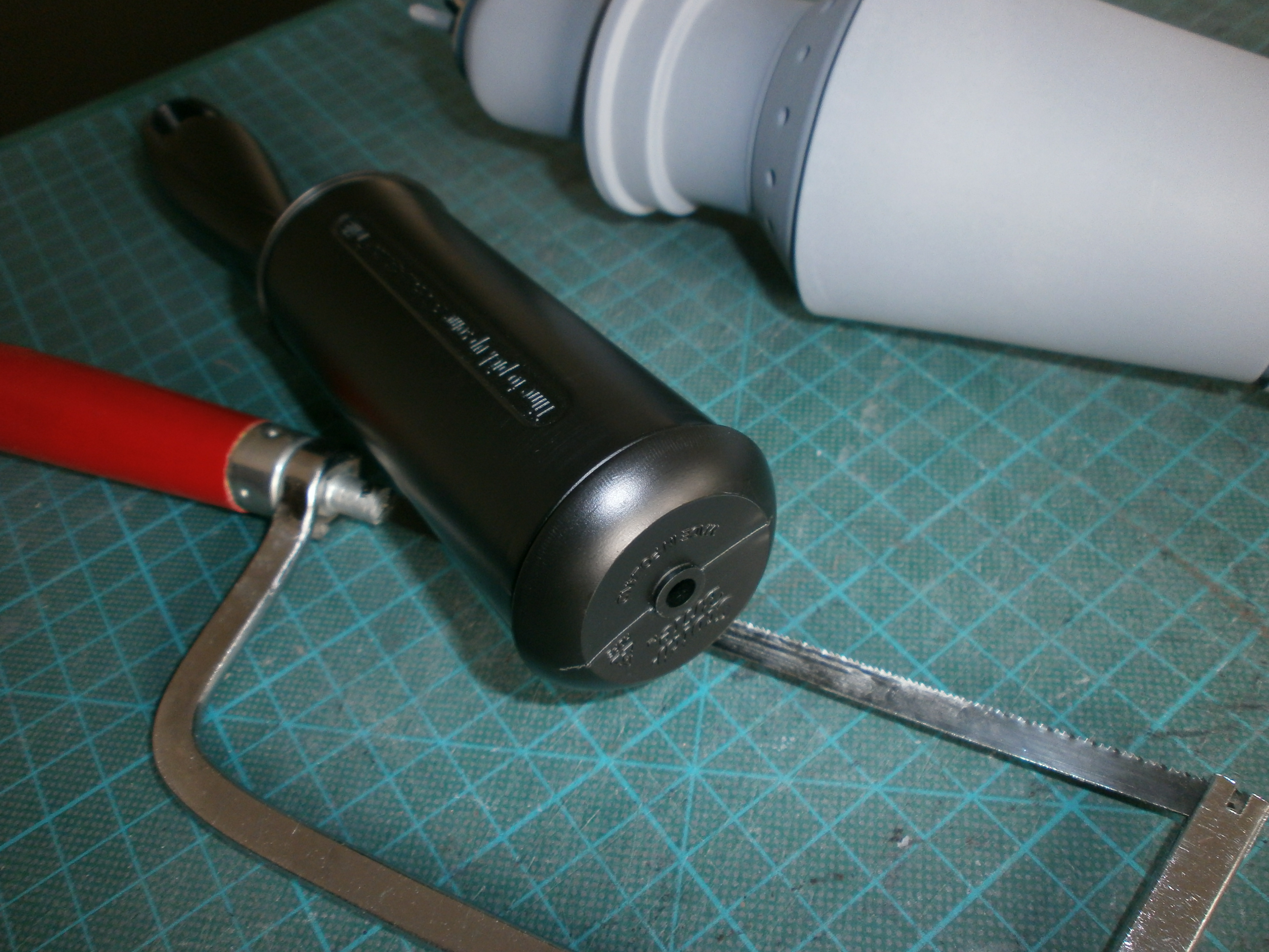

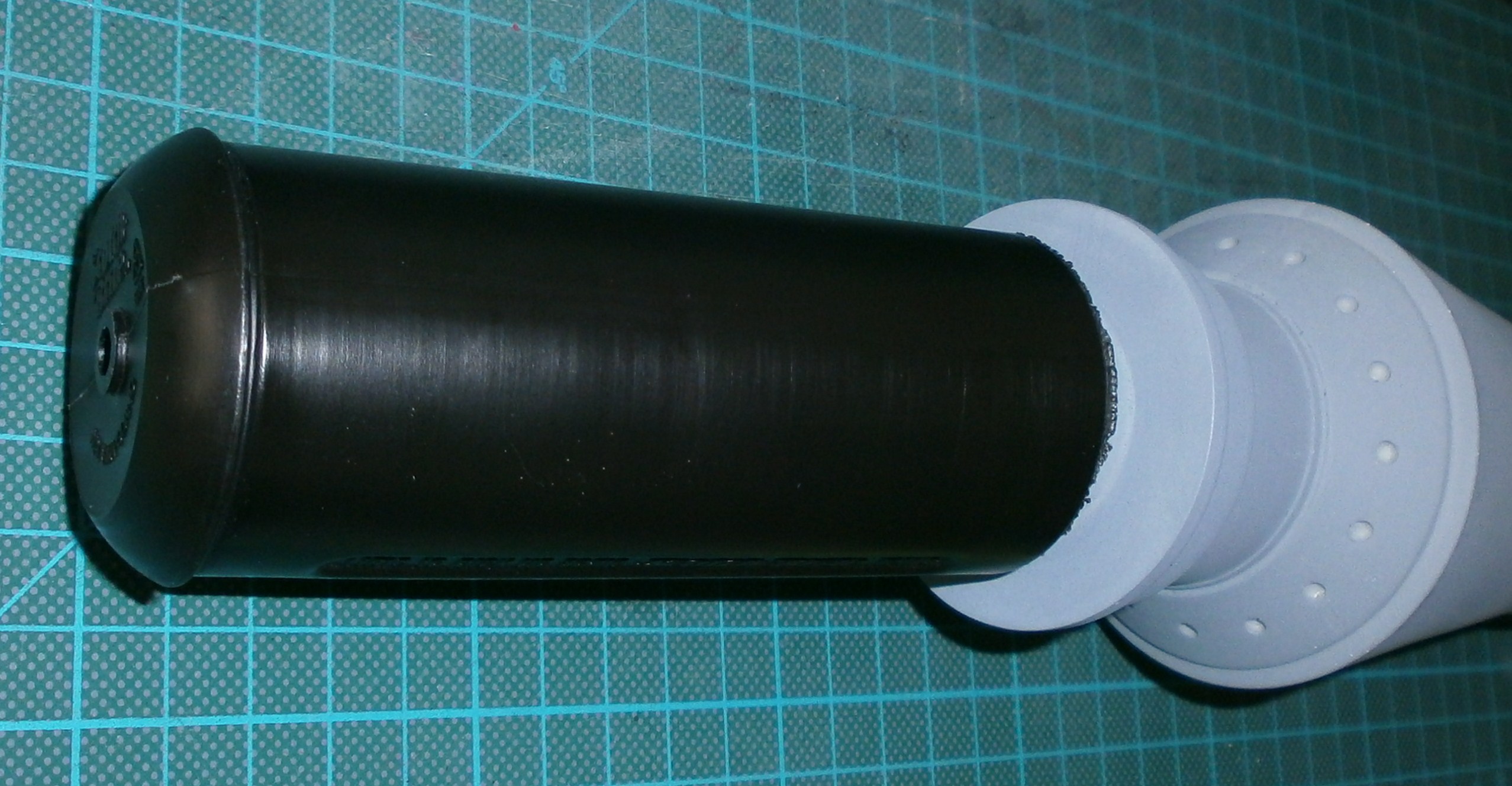

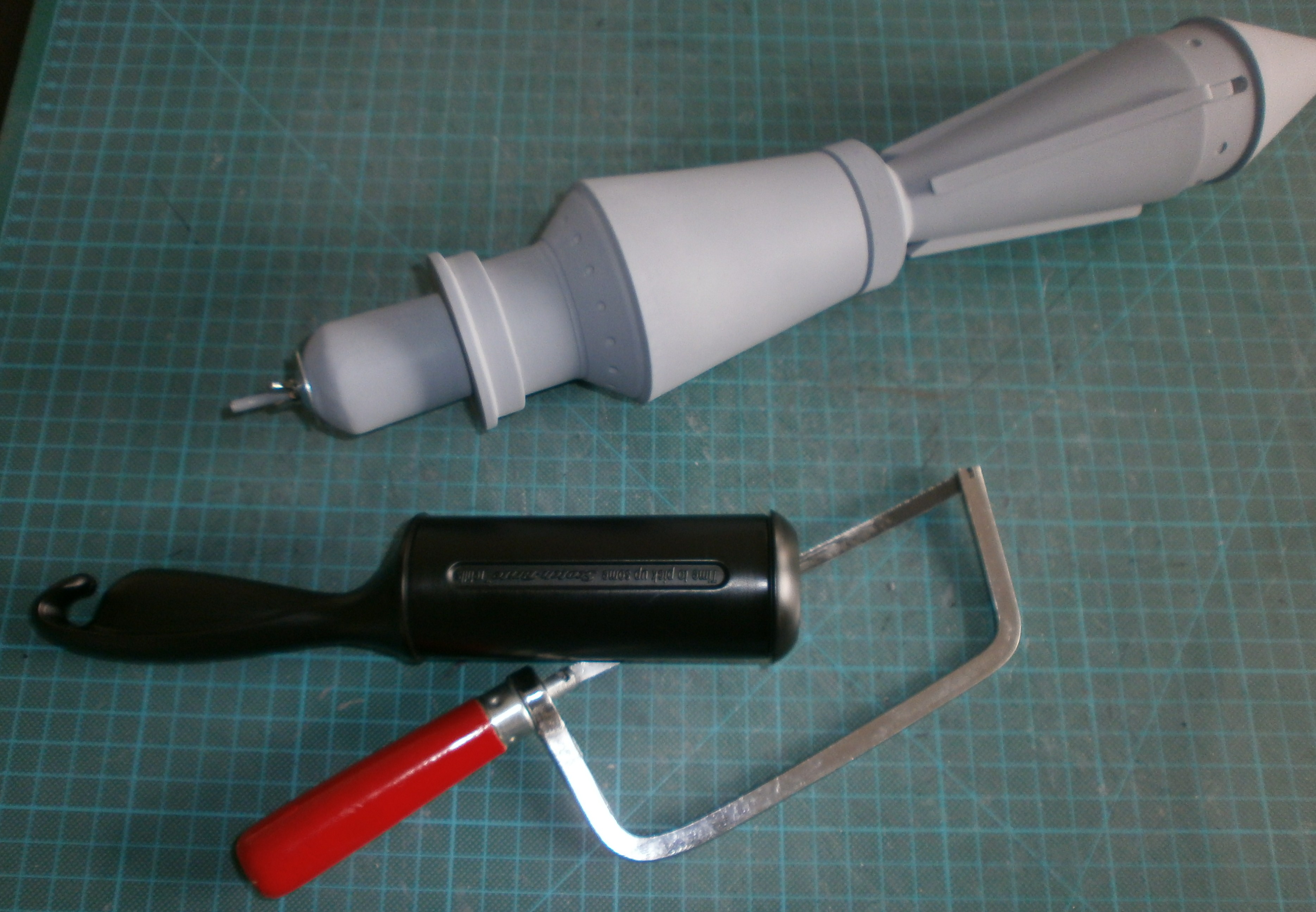

I found an older plastic lint roller in one of my greeblies boxes, which has a slightly bigger diameter than the end-tube of the rocket. It also has a perfect hole, where the screw of the rocket can go through. This lint roller will sit inside the jetpack at the end.
Then I cut away the handle. I´ll cut the lint roller tube shorter in the end, so the end-tube of the rocket will slip in till the screw comes out completly.

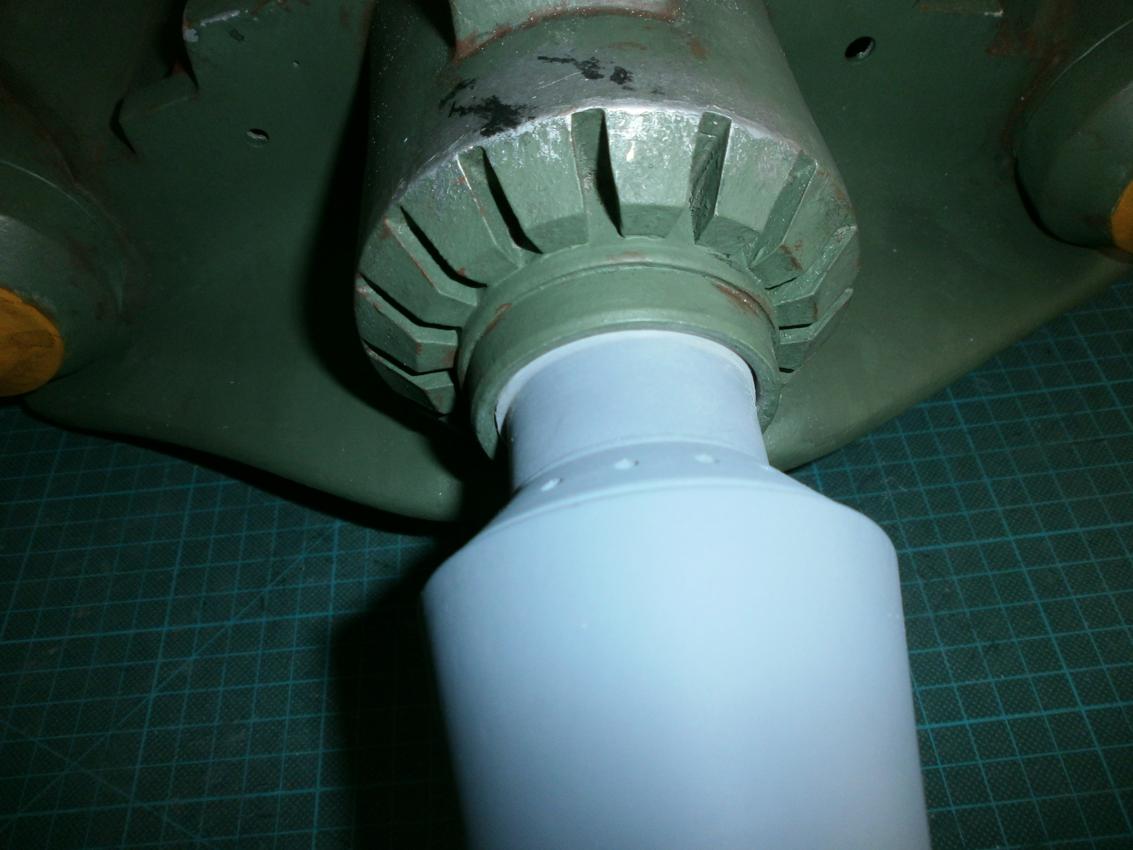

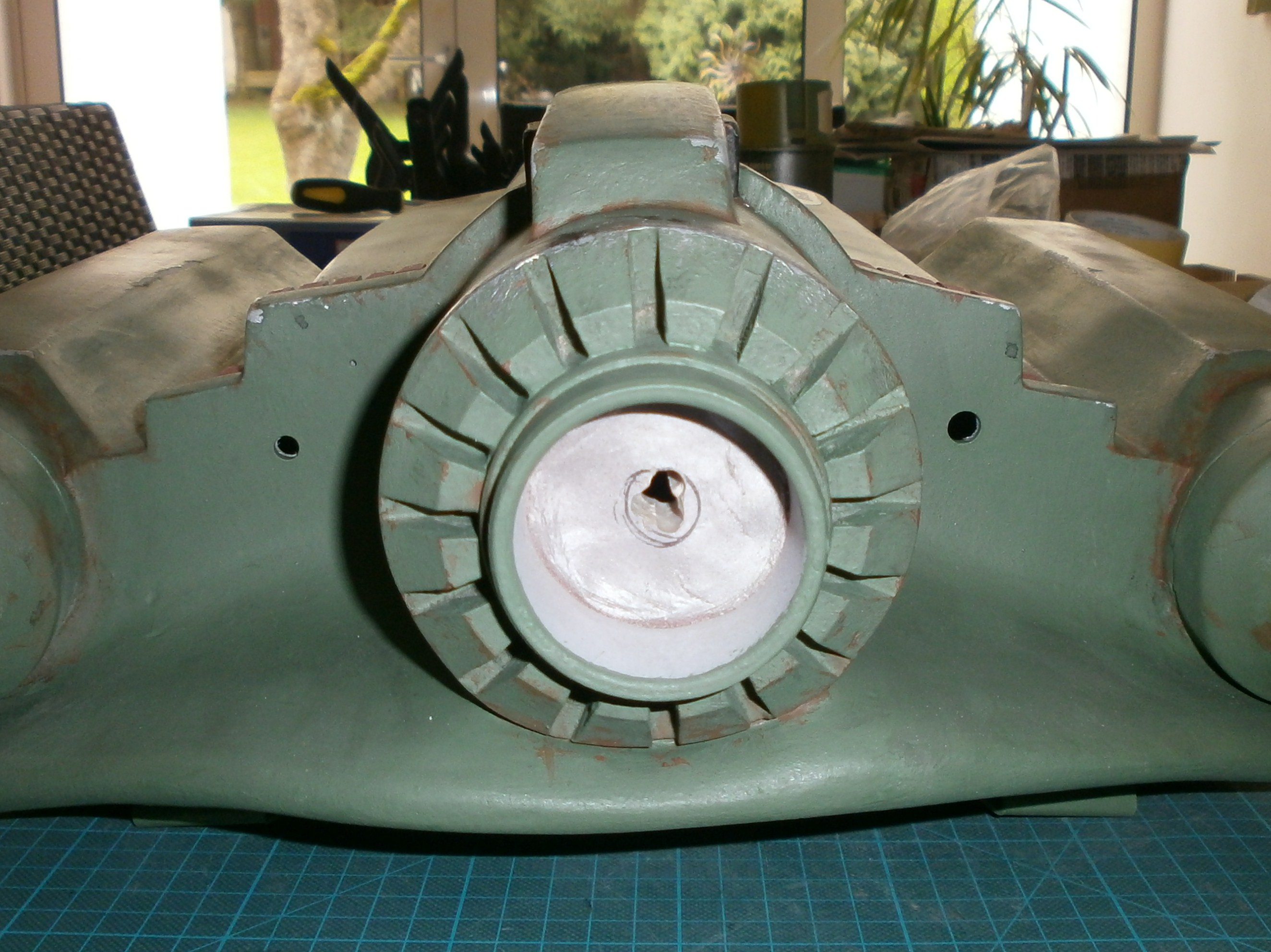

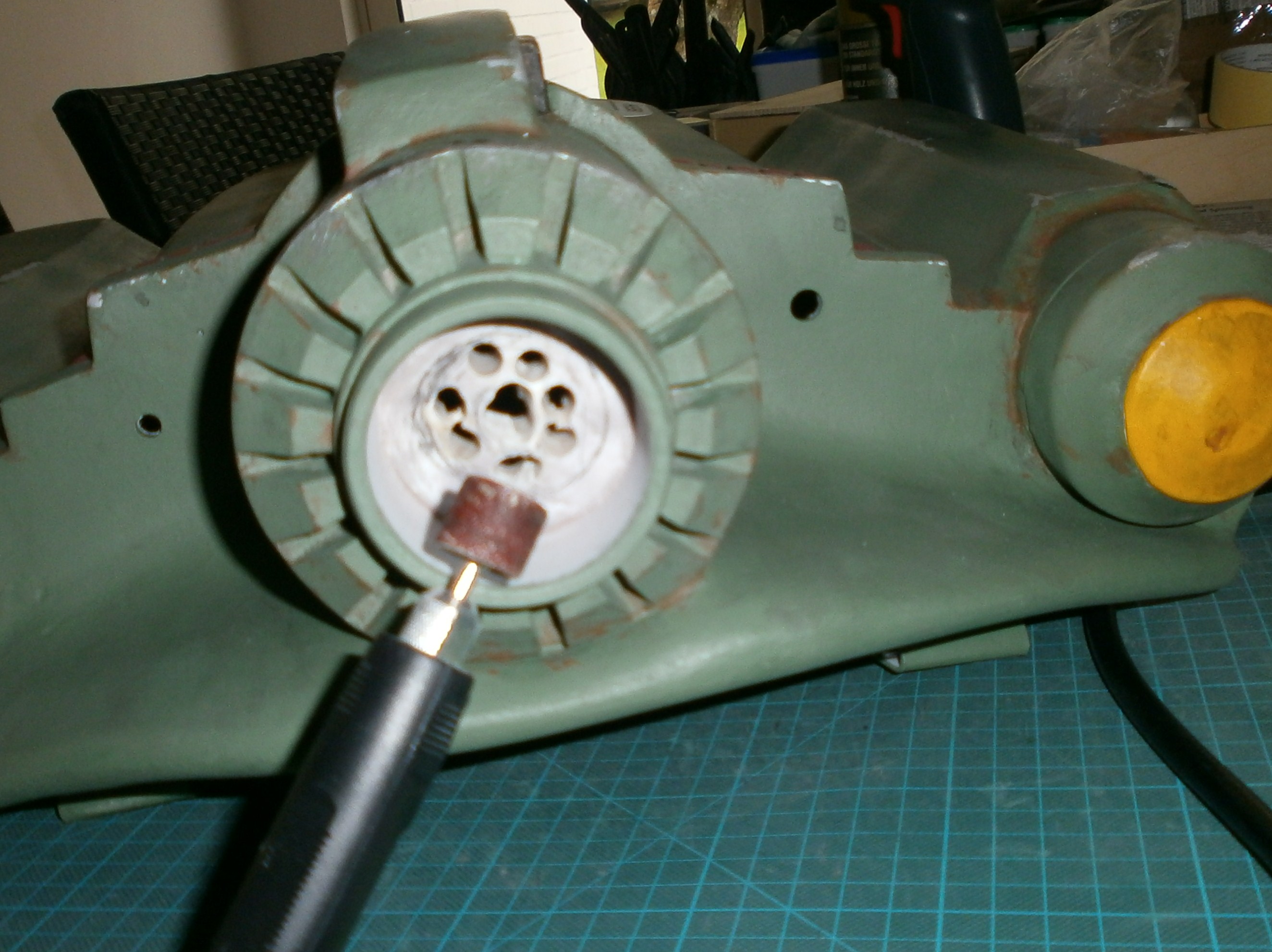

Now I used the tube draw a guideline, where to cut the hole for the rocket end-tube. After that I started drilling holes, which I make bigger and bigger, so I can use a dremel to finish the big hole.
Sooooooooooo.......

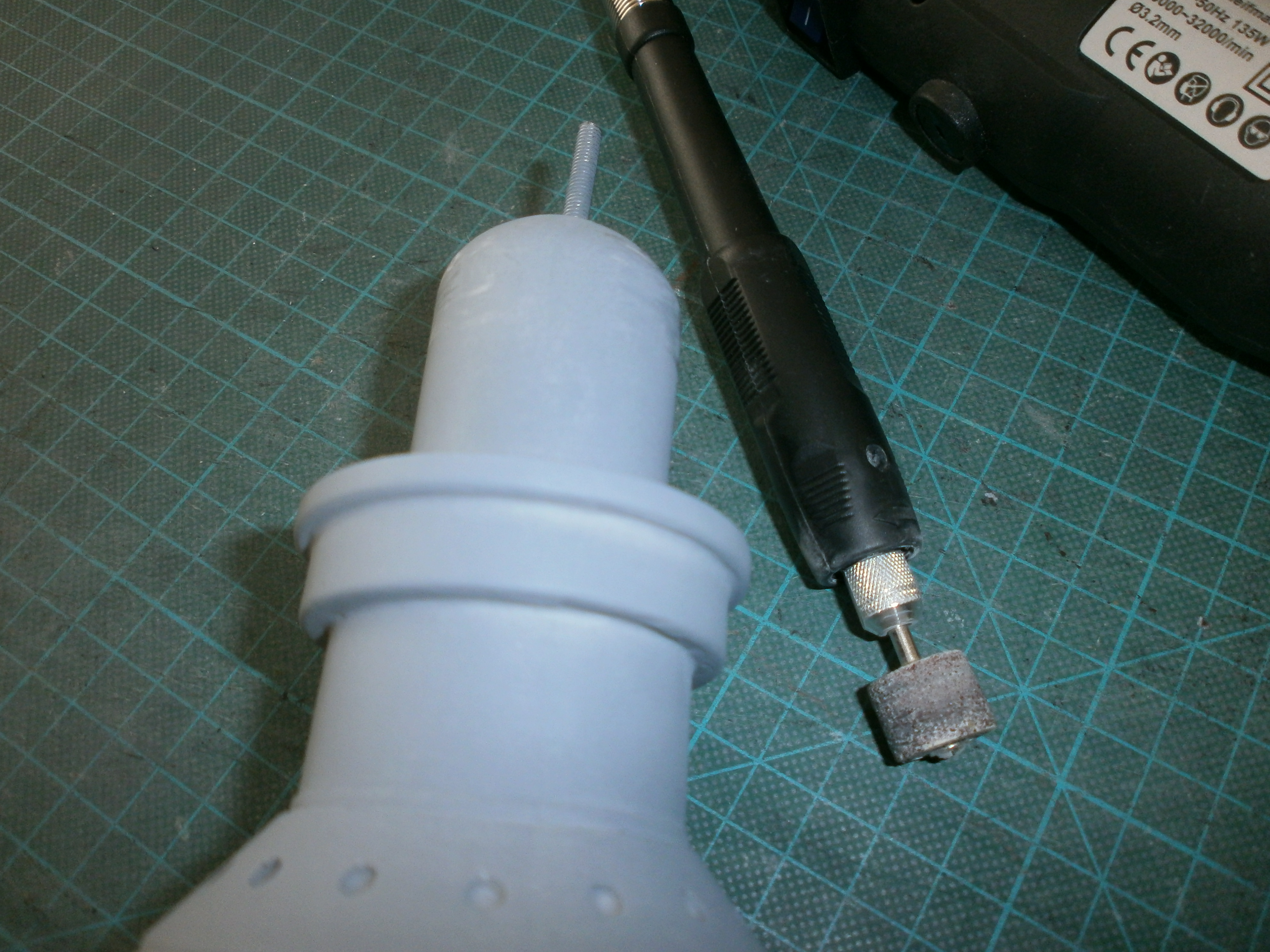

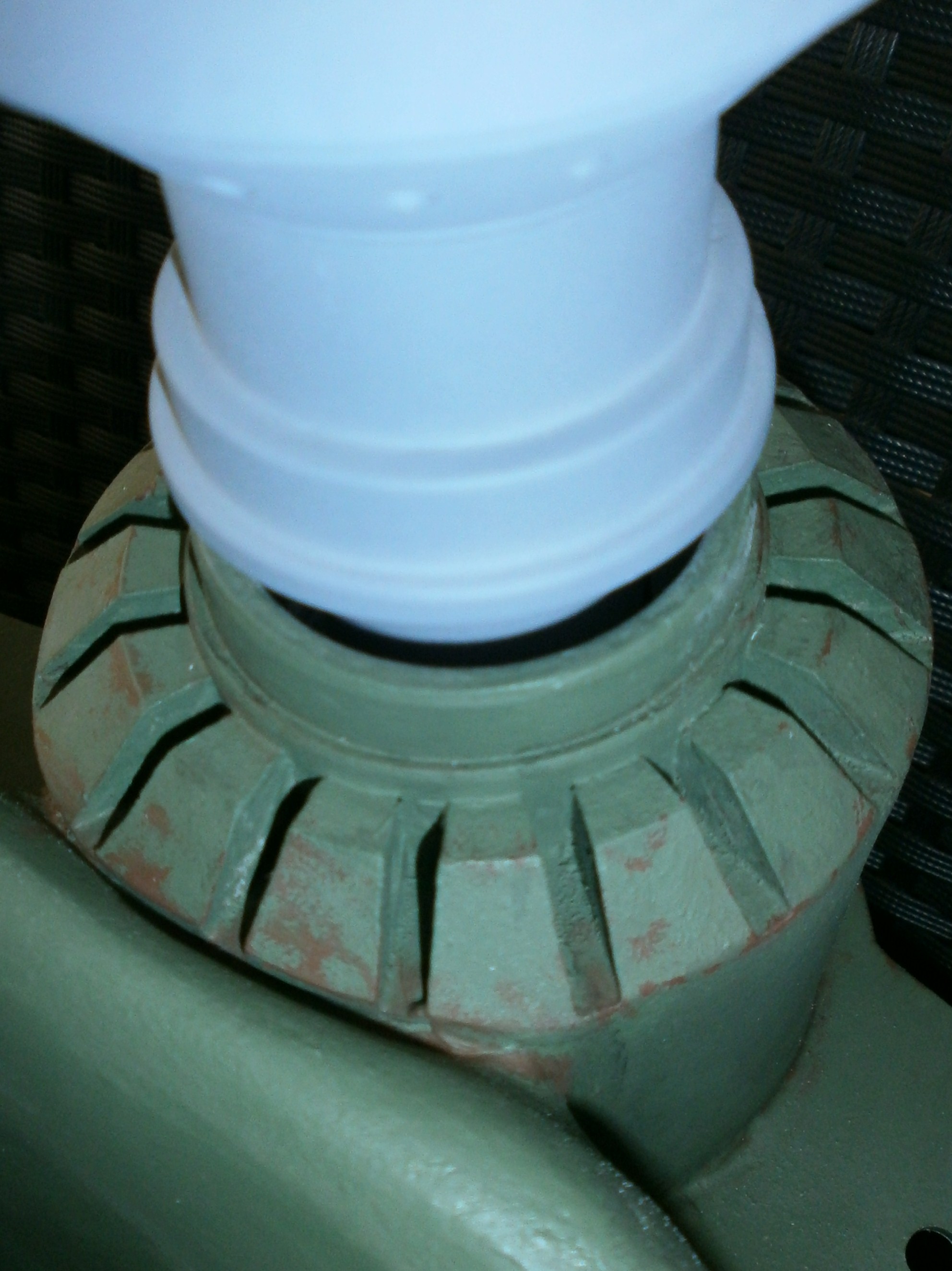

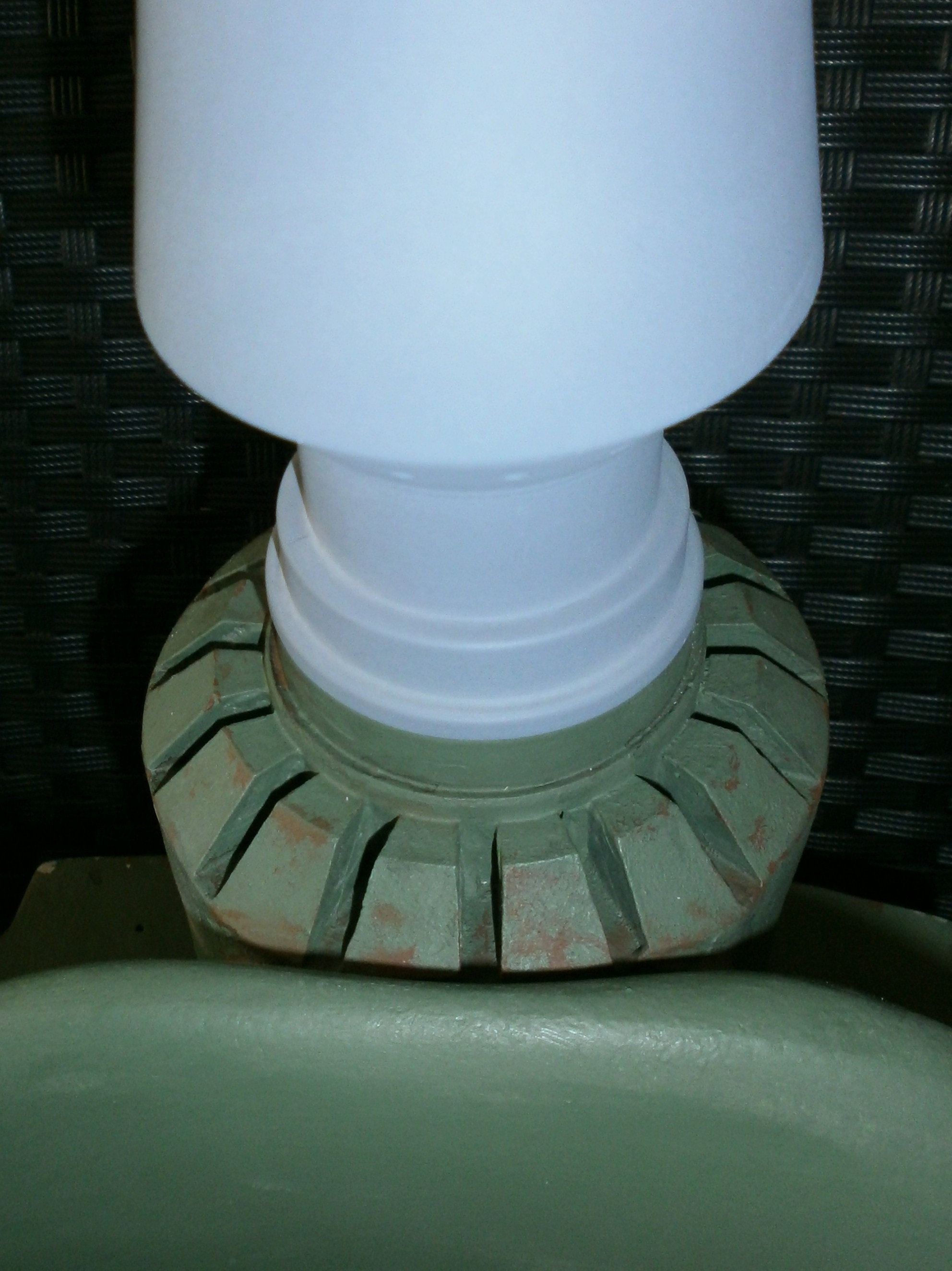

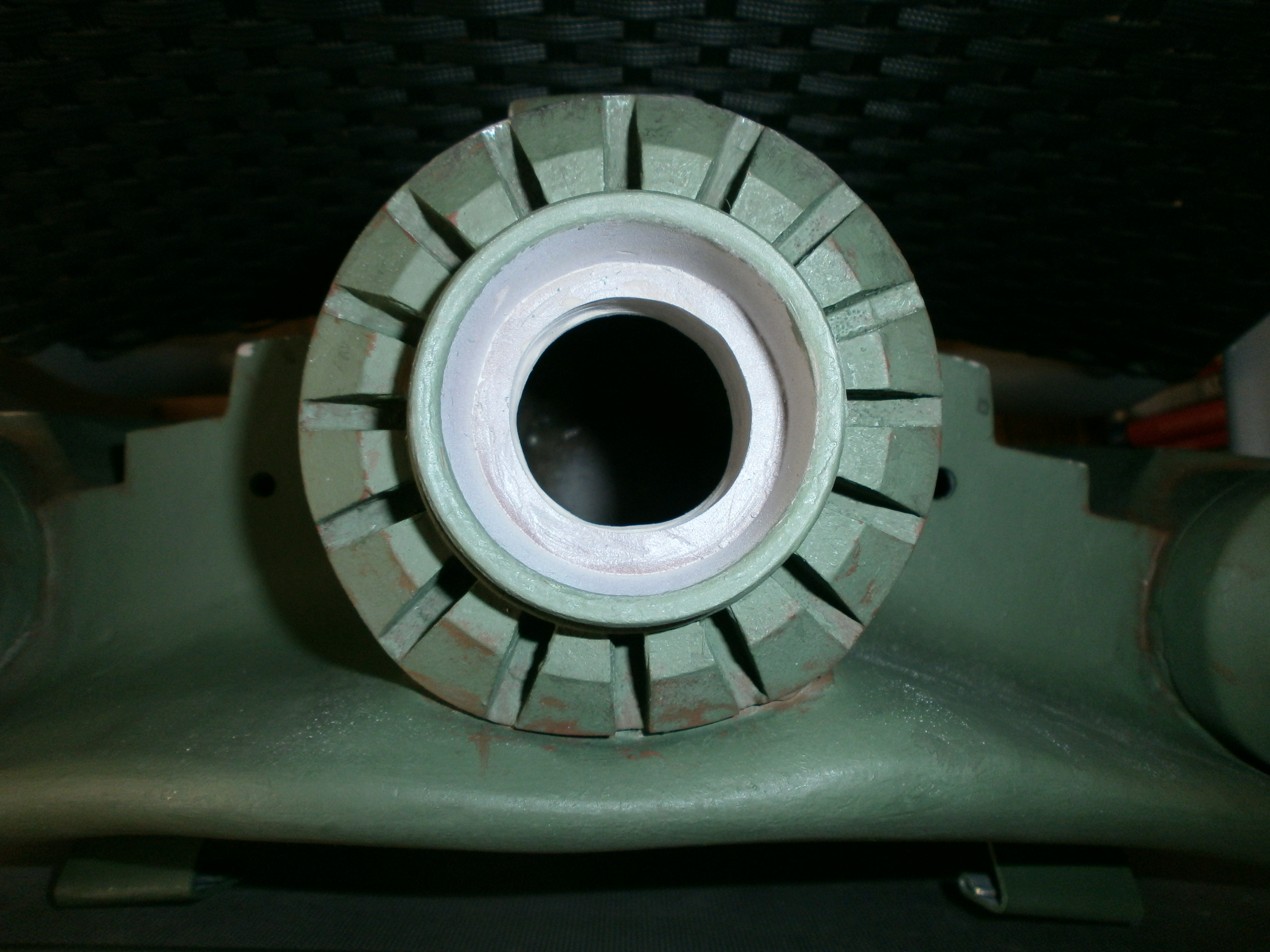

Finished the hole. Now the rocket slips into the jetpack, BUT: I´ll have to sand down the little step. It hurts to do this to the beautiful rocket...

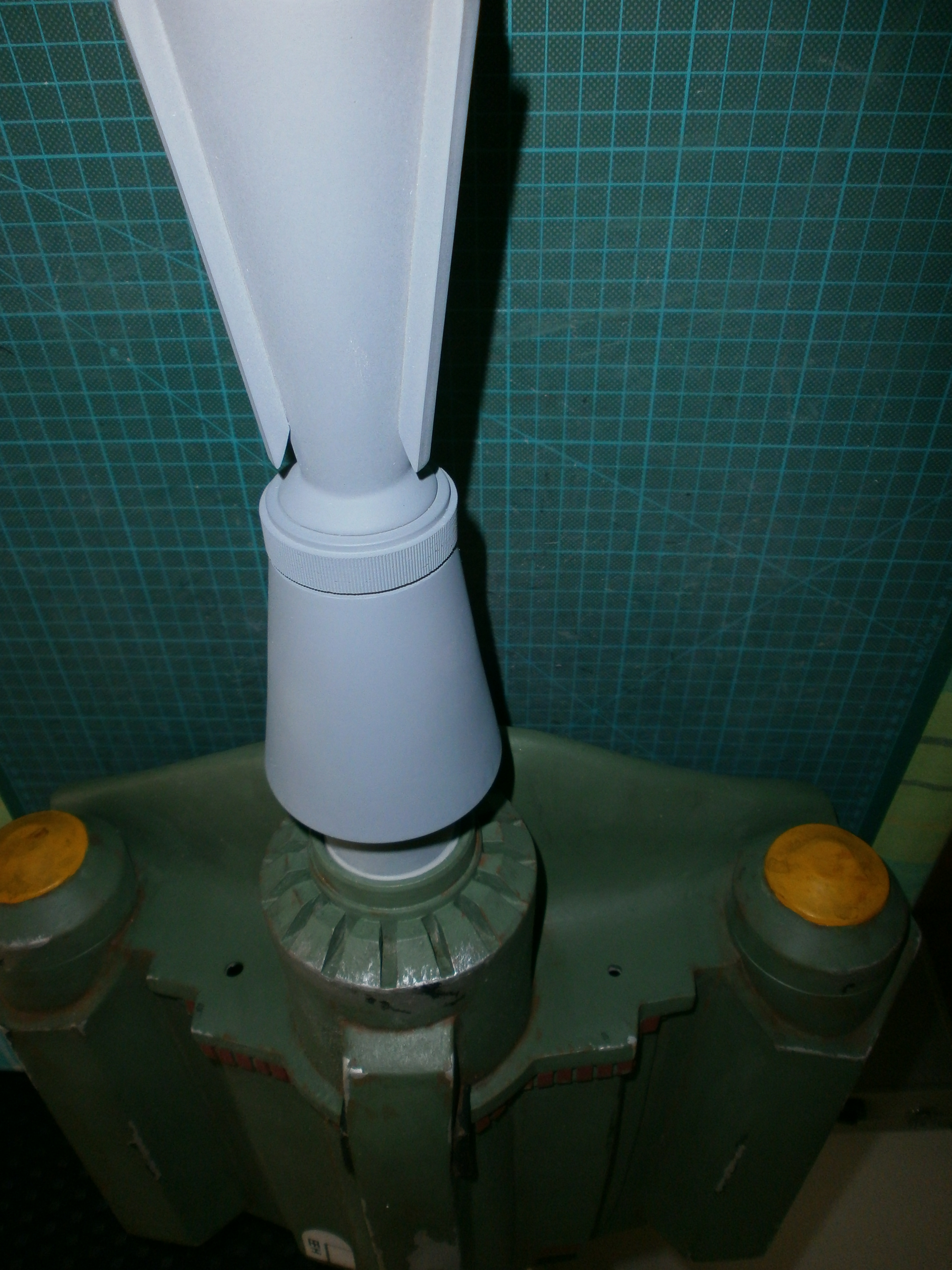

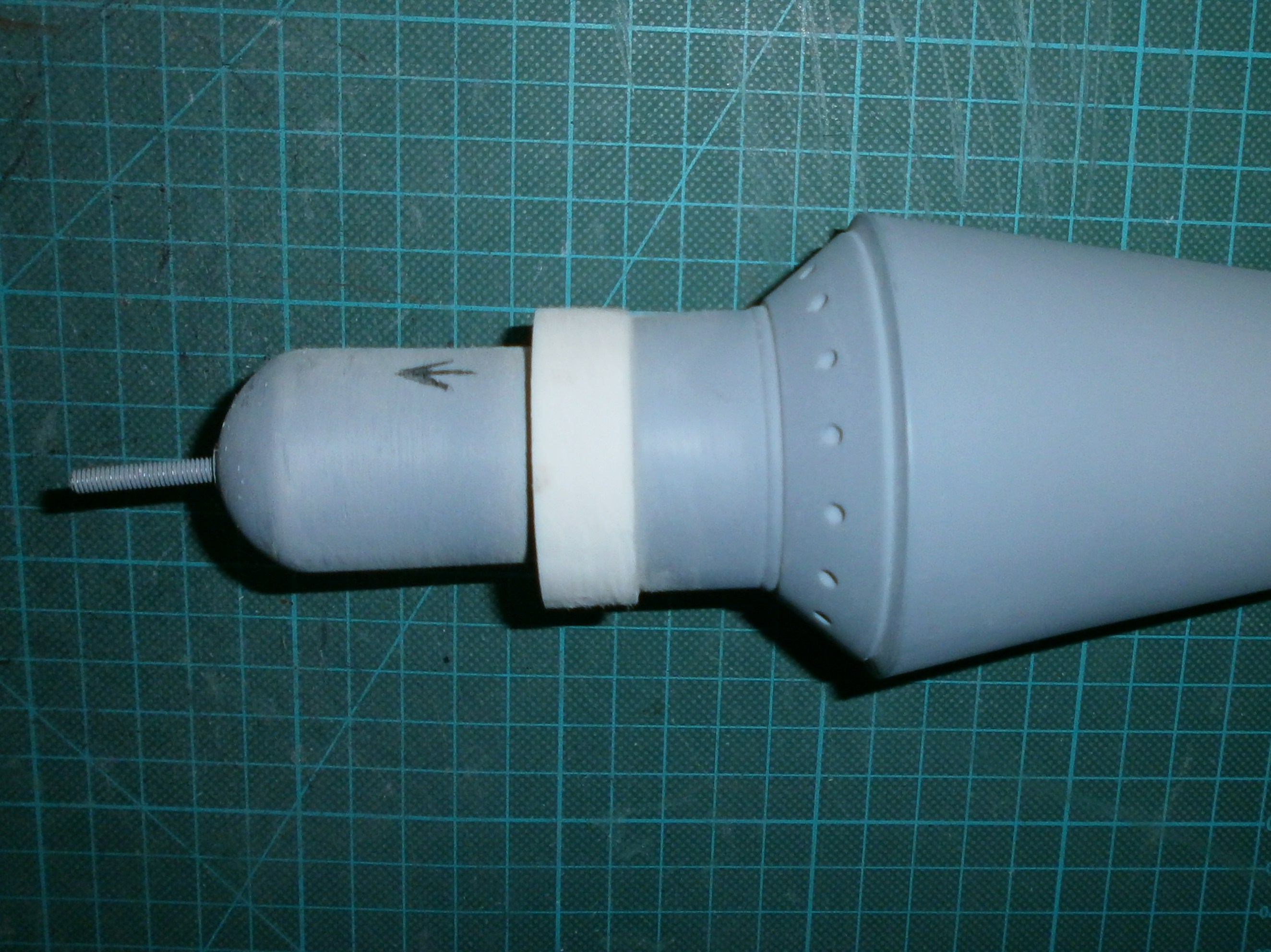

Sanded down the small step. Now it fits like a glove!
Marked the "front side" with an arrow. ;)
Next will be some work on the inside, to build a base with the lint roller tube, where the screw of the rocket will be fixed.
