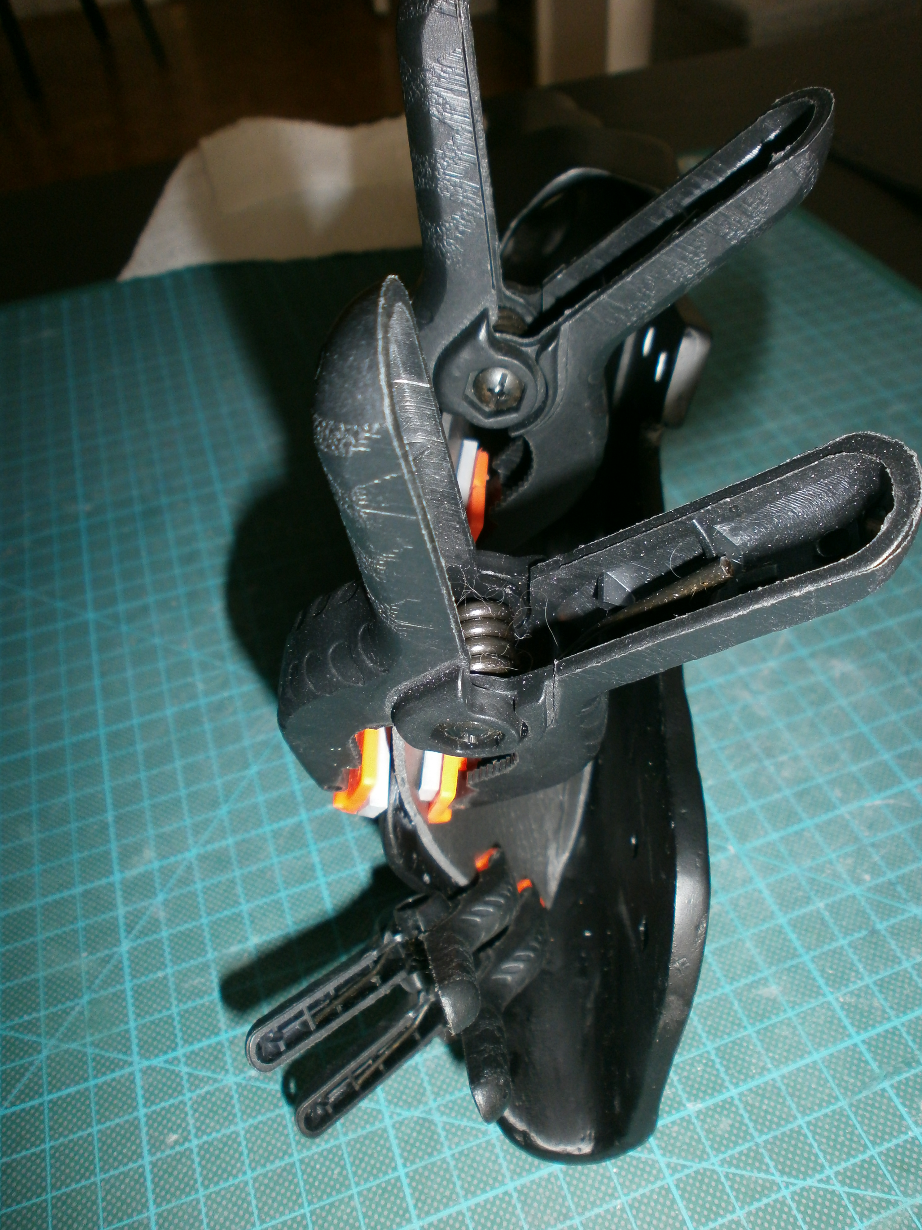

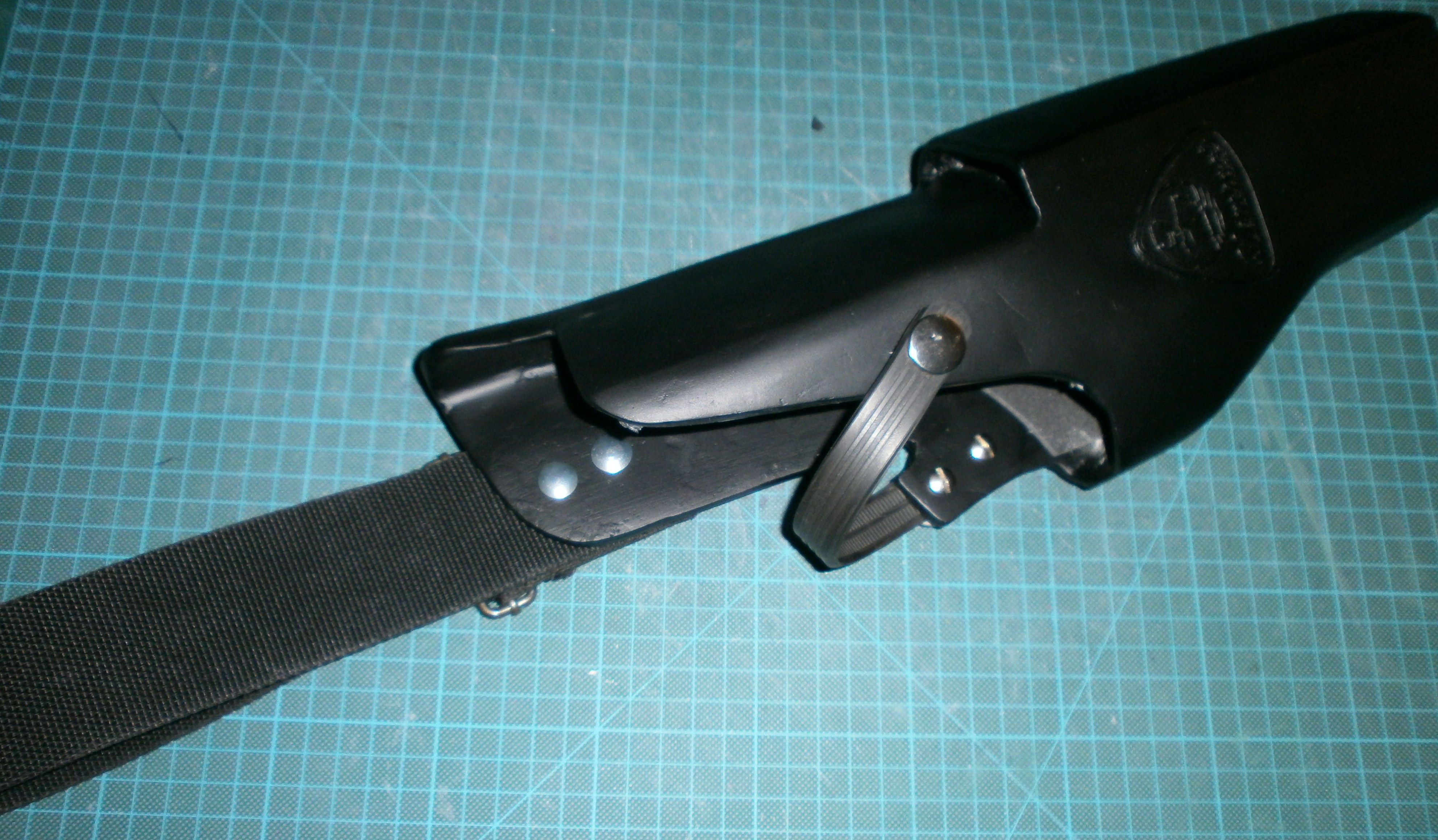

Sunday update: worked on the fibreglas holster. Time for some strapping...

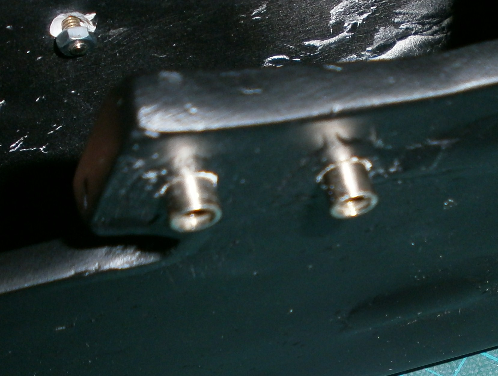

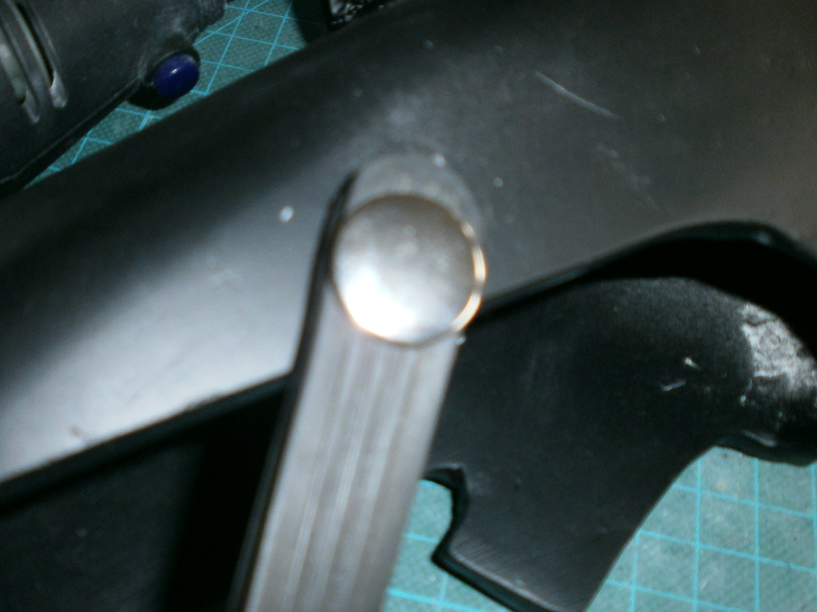

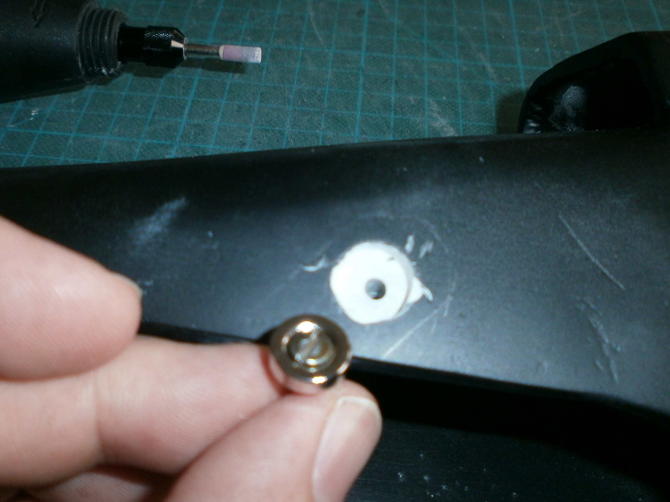

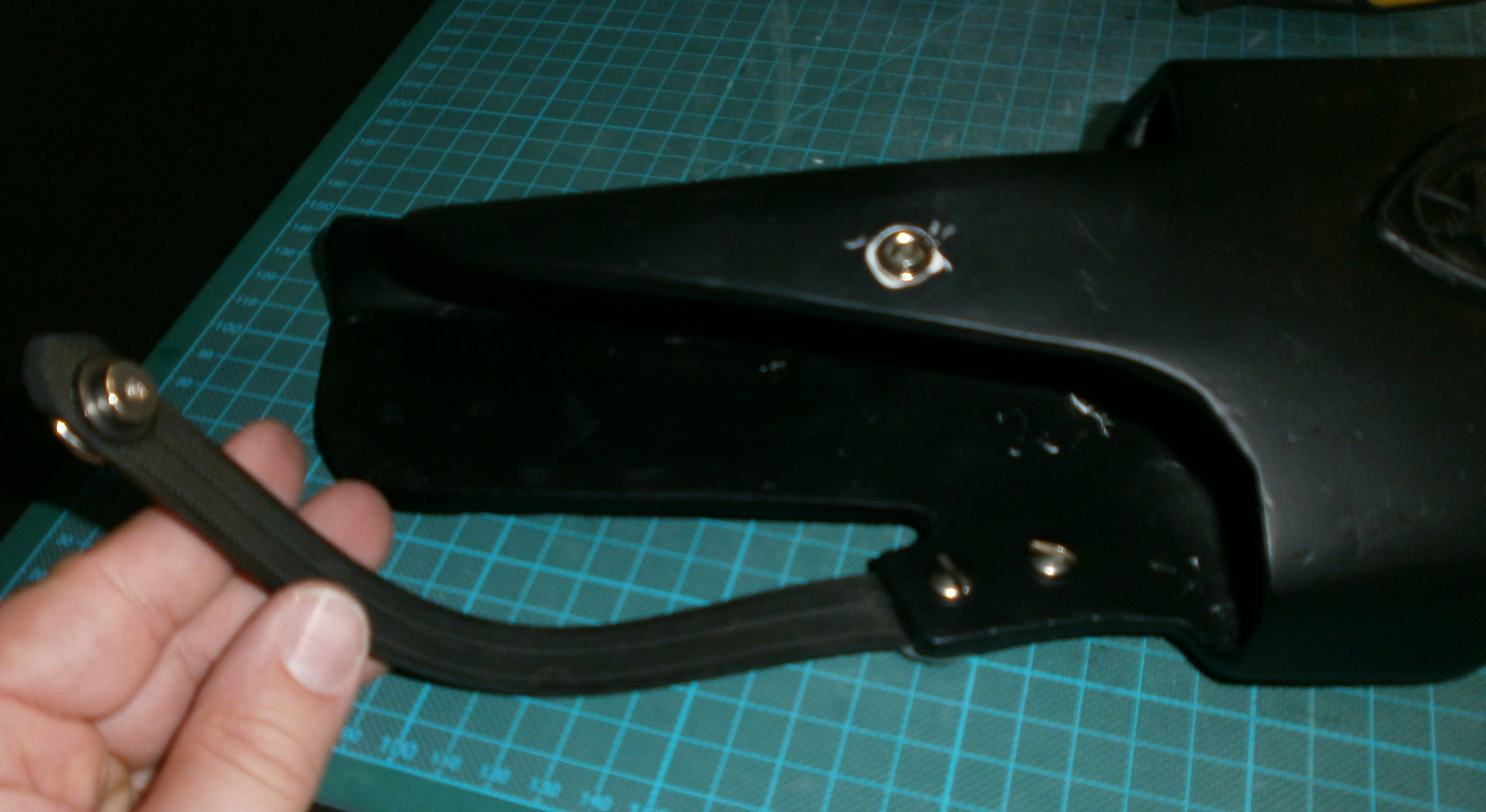

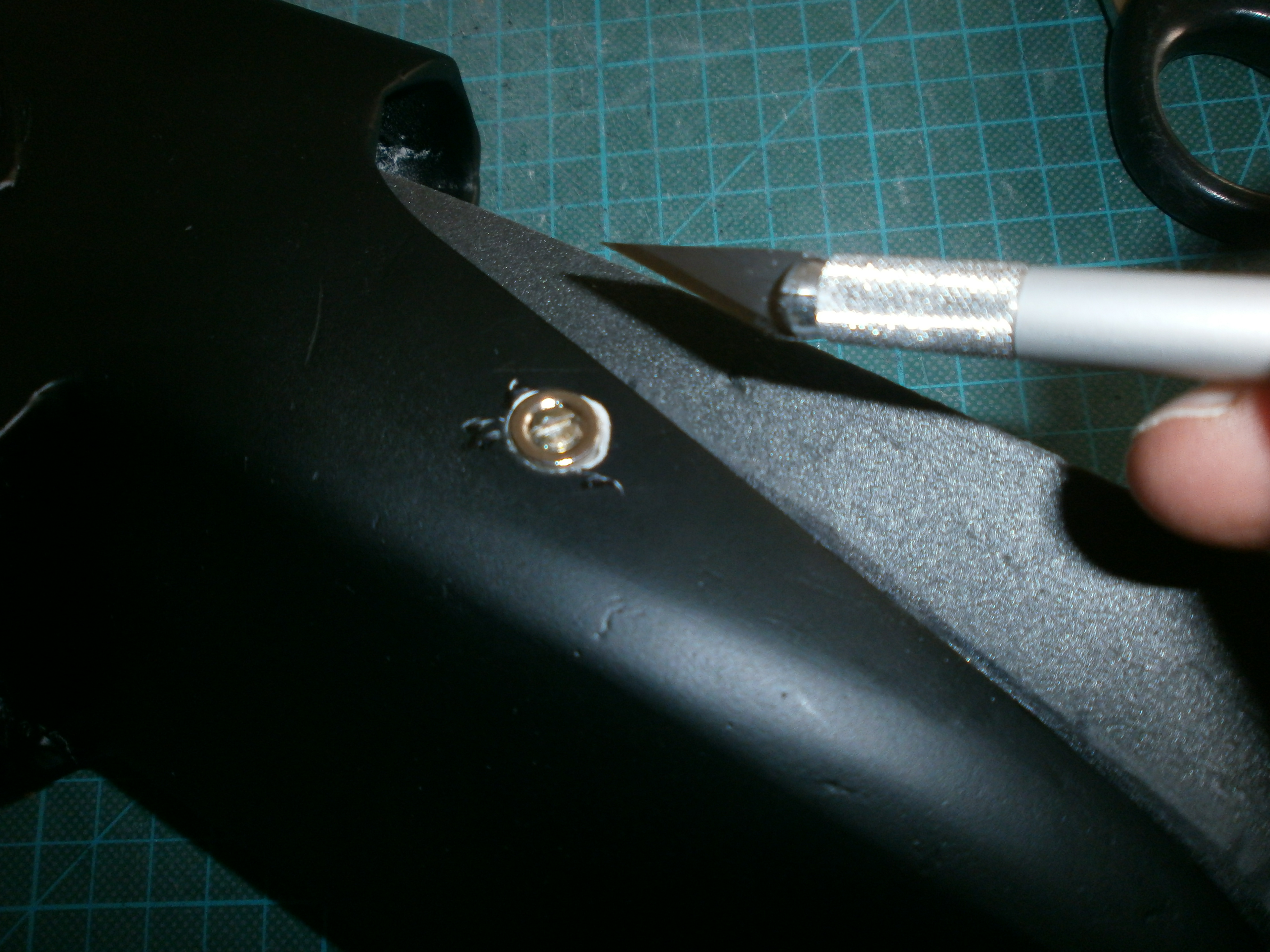

I used a heavy duty rubber band (is used for bikes), two N52 rare earth magnets (with holes for screws), a washer and a knob from an old jacket for the fron part. For the back two chicago screws and two washer.
PB130889.JPGPB130892.JPGPB130890.JPGPB130894.JPGPB130896.JPGPB130898.JPGPB130897.JPGPB130900.JPGPB130902.JPGPB130904.JPGPB130905.JPGPB130906.JPGPB130908.JPG

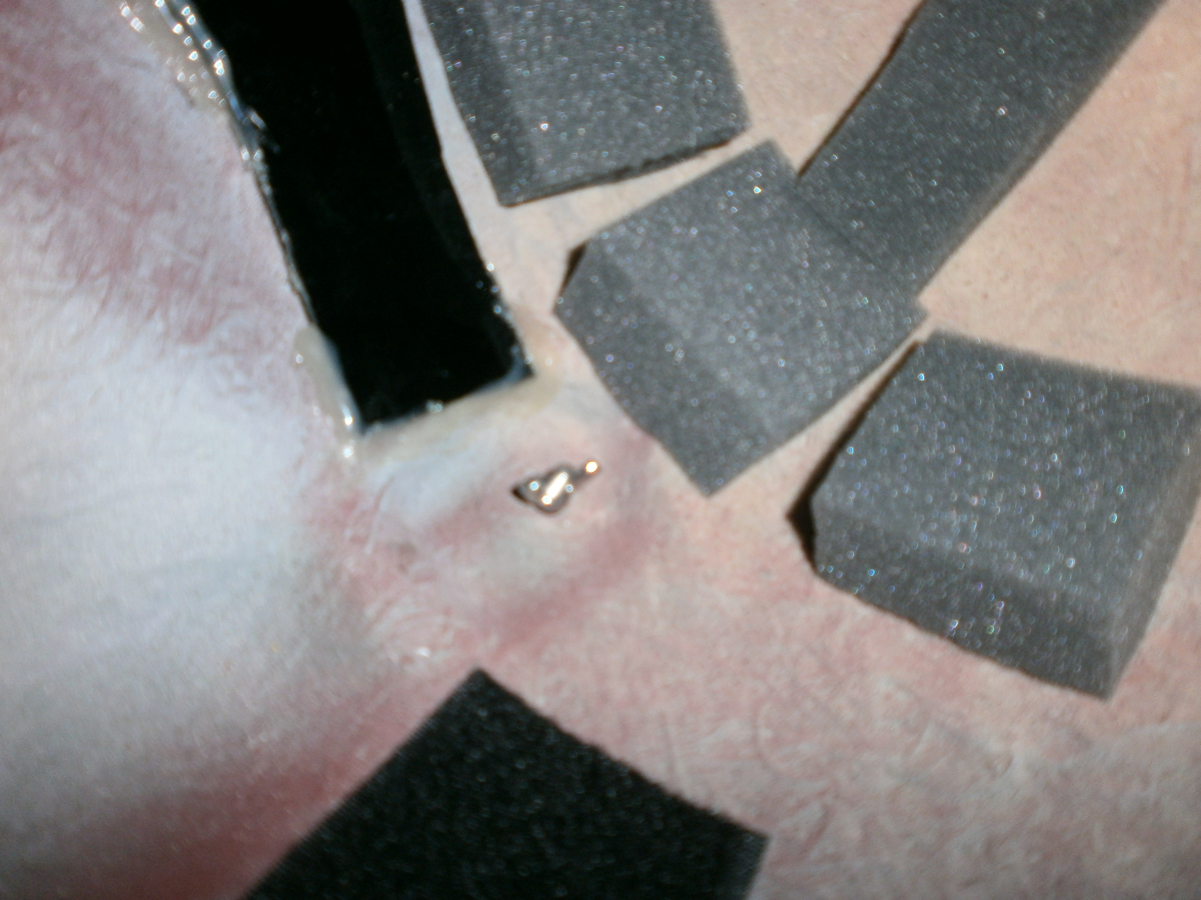

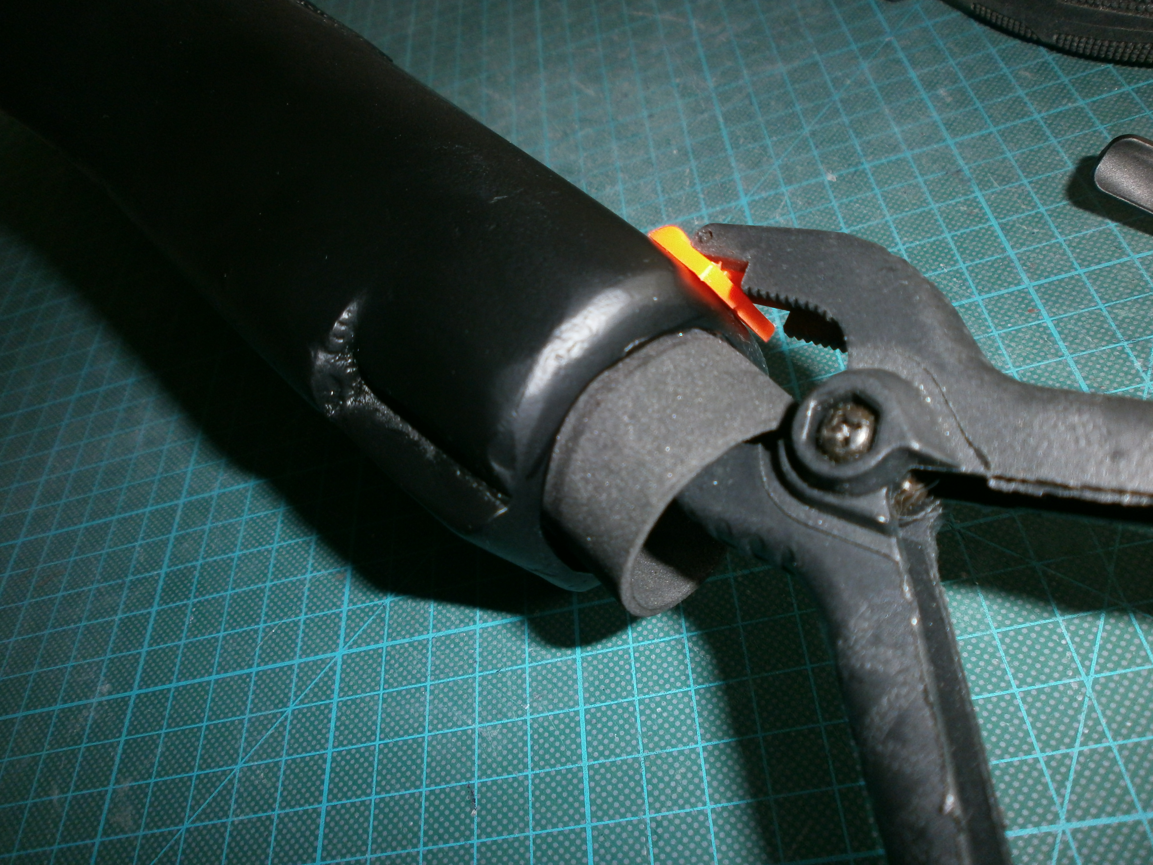

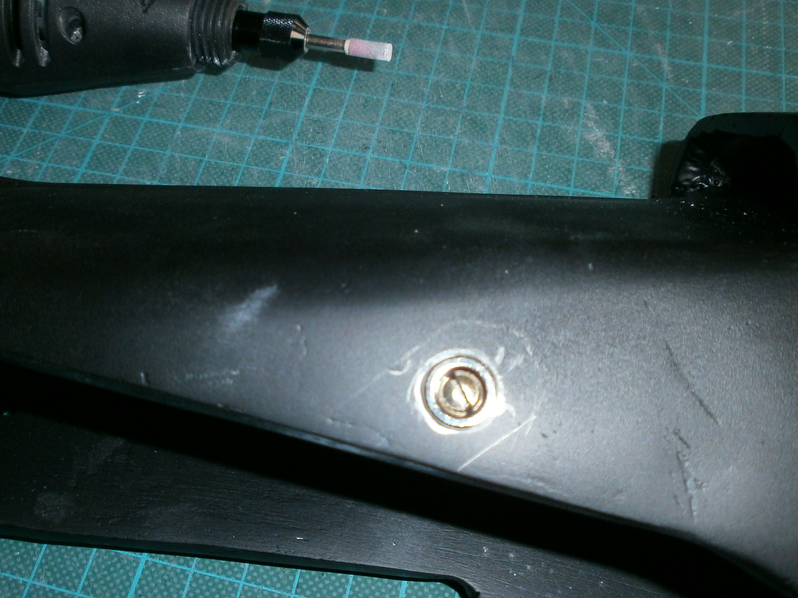

I was so nervous drilling the holes and being afraid of breaking the fibreglas... I cut the rubber strap too long... ;) So I´ll fix that, after doing some padding with softfoam, to keep the sidearm scratching on the minor rough inside of the holster. :)
Continued the strapping system of the holster and made some padding with black and anthrazit craft rubber.
PB150893.JPGPB130910.JPGPB150889.JPGPB150890.JPGPB150891.JPGPB150894.JPGPB150895.JPGPB150896.JPGPB150897.JPGPB150898.JPGPB150901.JPGPB150902.JPGPB150903.JPGPB150904.JPGPB150907.JPG
The rubber strap is shorter now. I thing it looks much better.
Now all I need is to find the accurate material for the belt loop (I used some old adjustable webbed belt) and fix the scratches I did when drilling the holes...

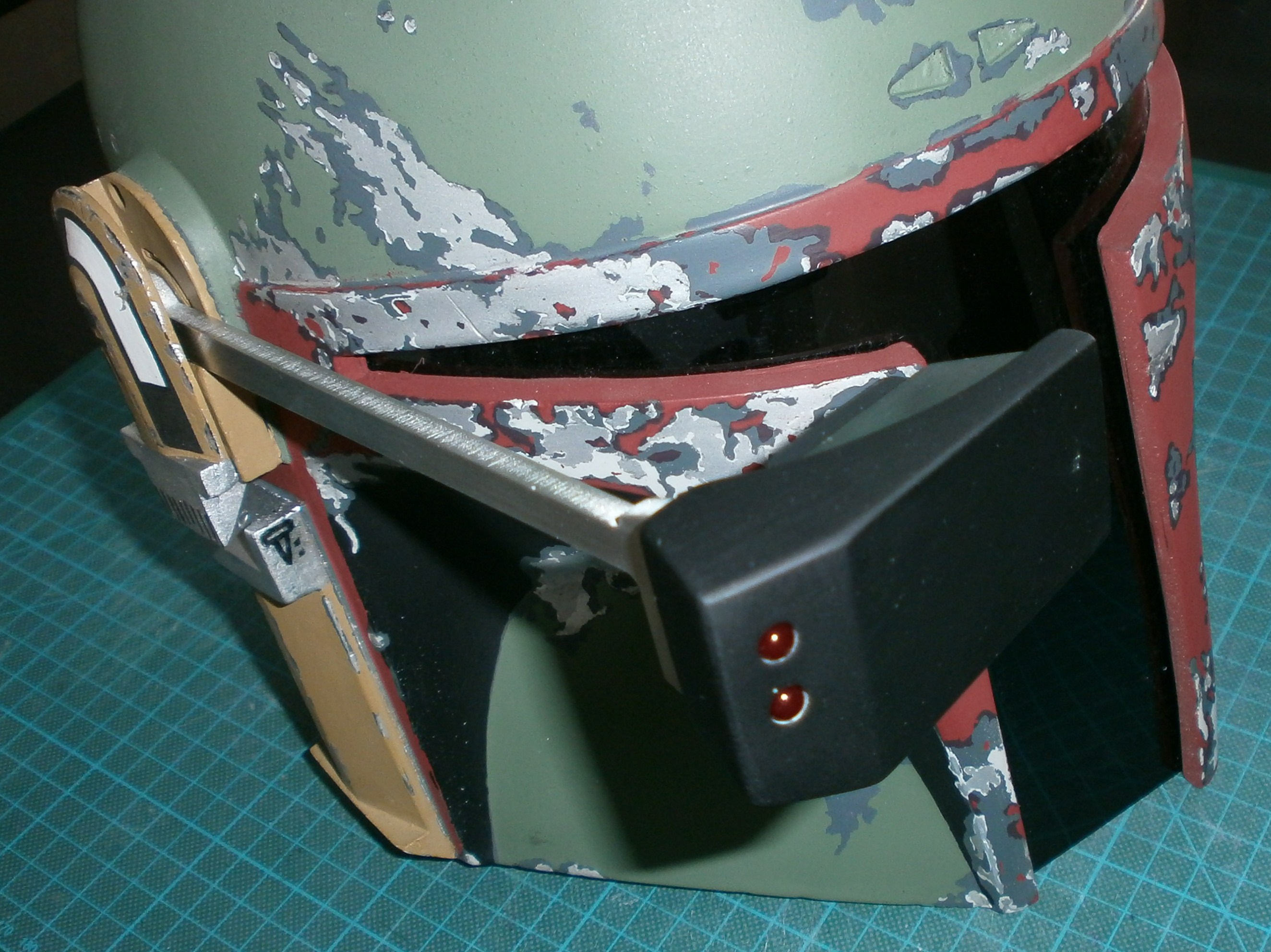

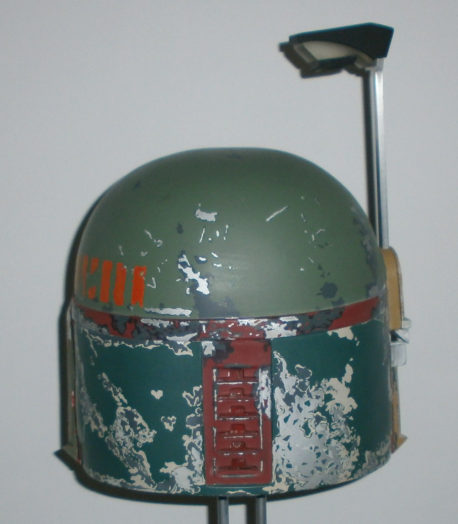

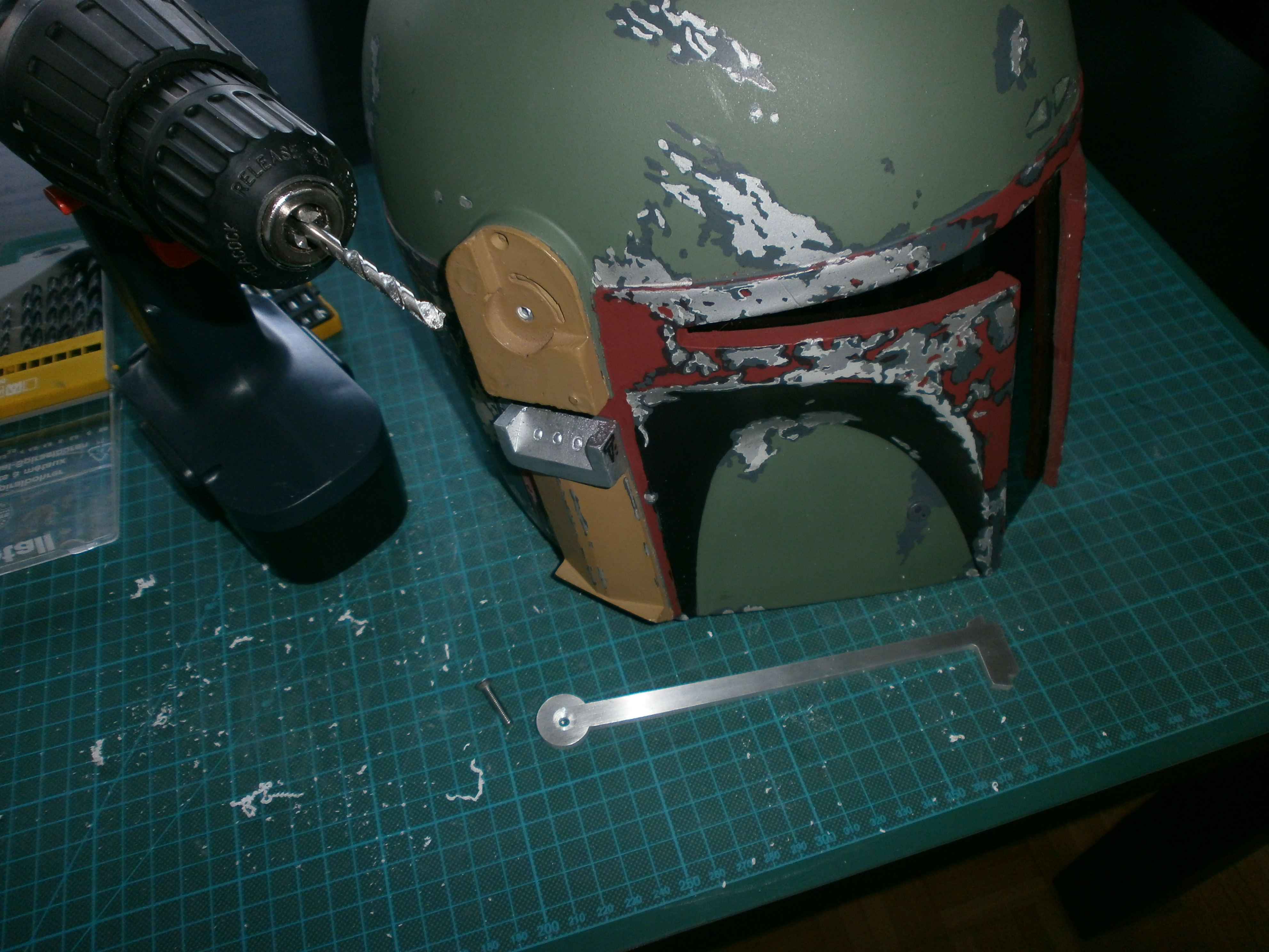

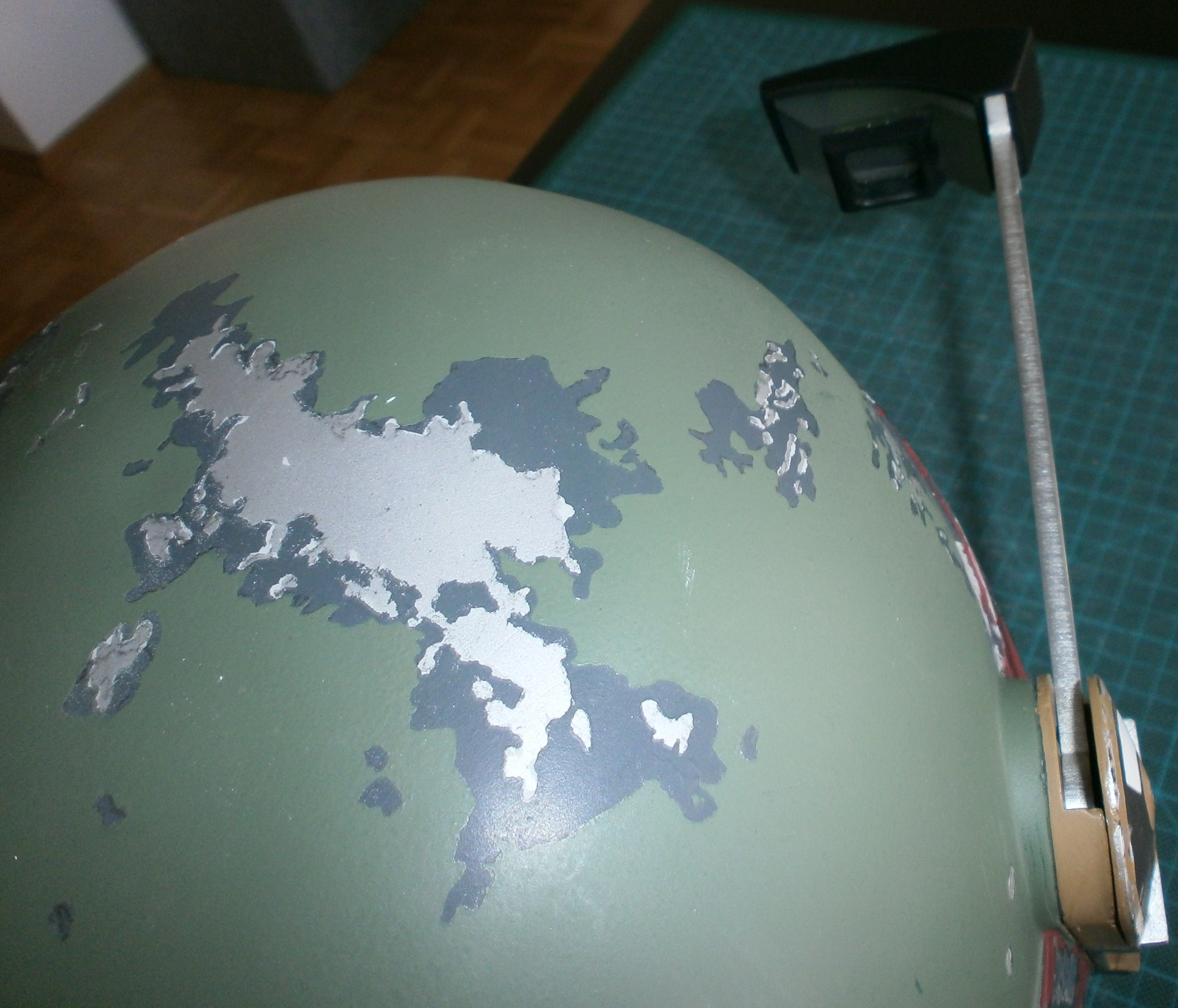

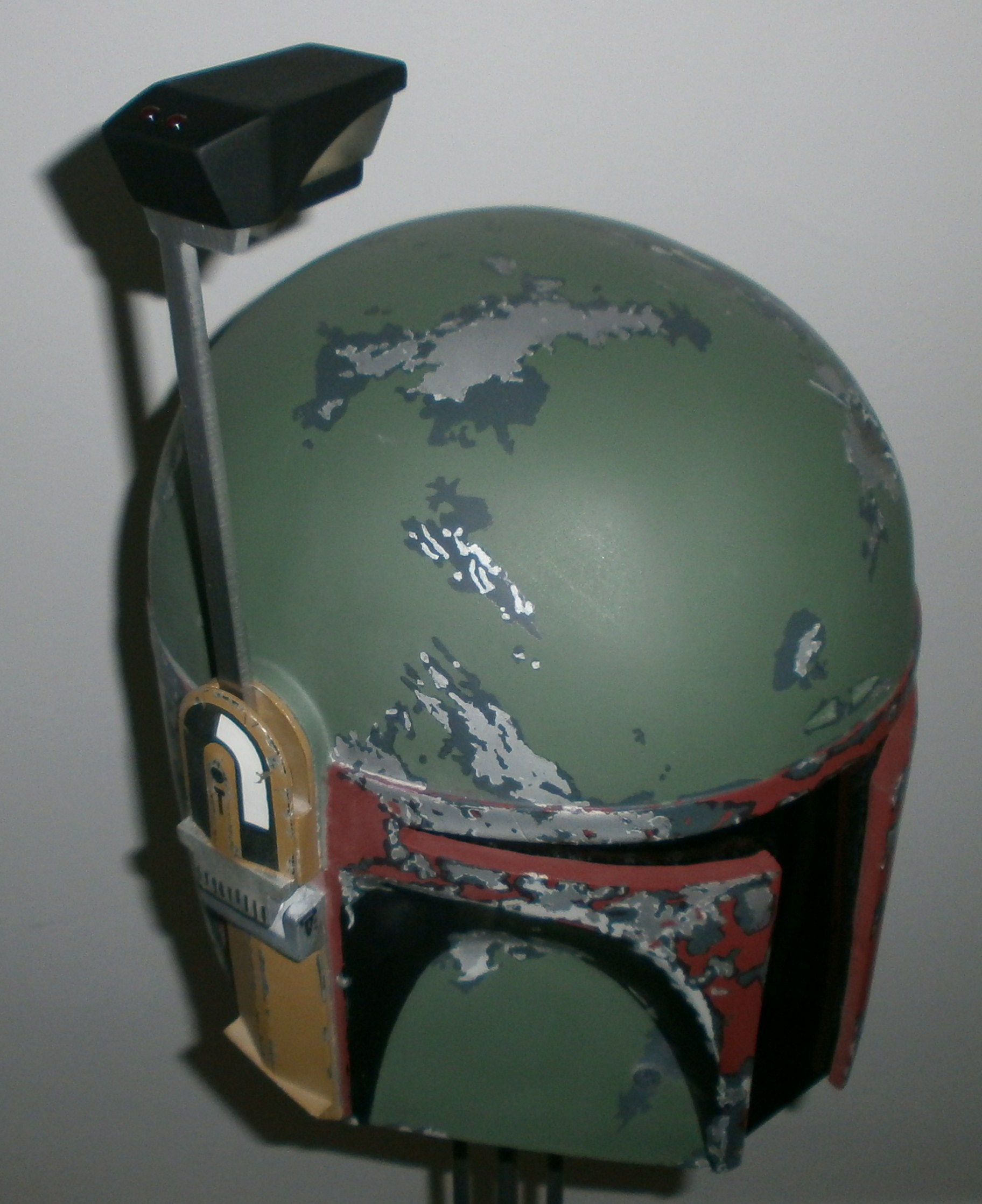

Recieved my Bobamaker Deluxe ESB Rangefinder and aluminium Stalk. A quick 5 minute installement. ;) It´s perfect!
PB230892.JPGPB230893.JPGPB230894.JPGPB230895.JPGPB230898.JPGPB230899.JPGPB230900.JPGPB230902.JPGPB230903.JPG

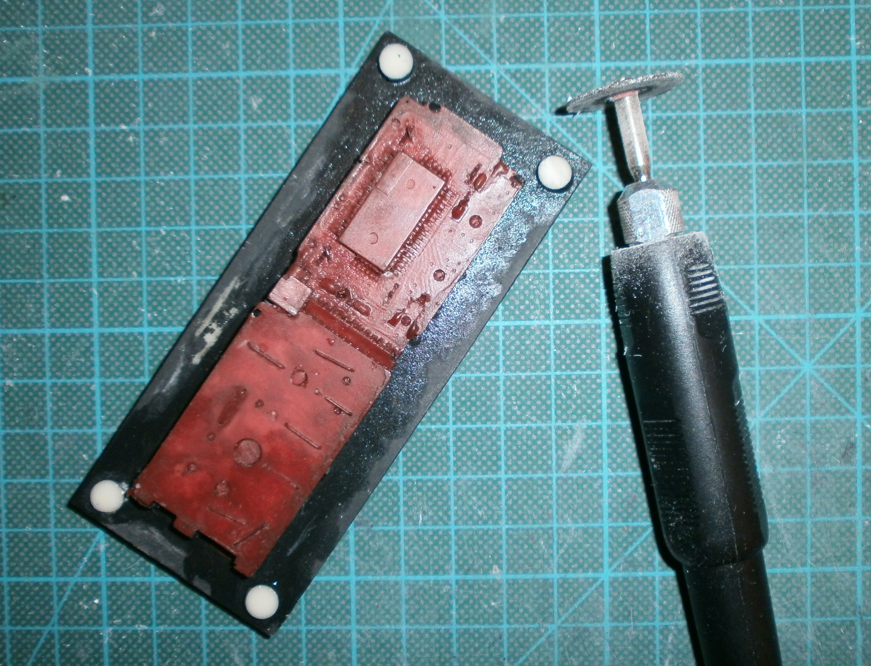

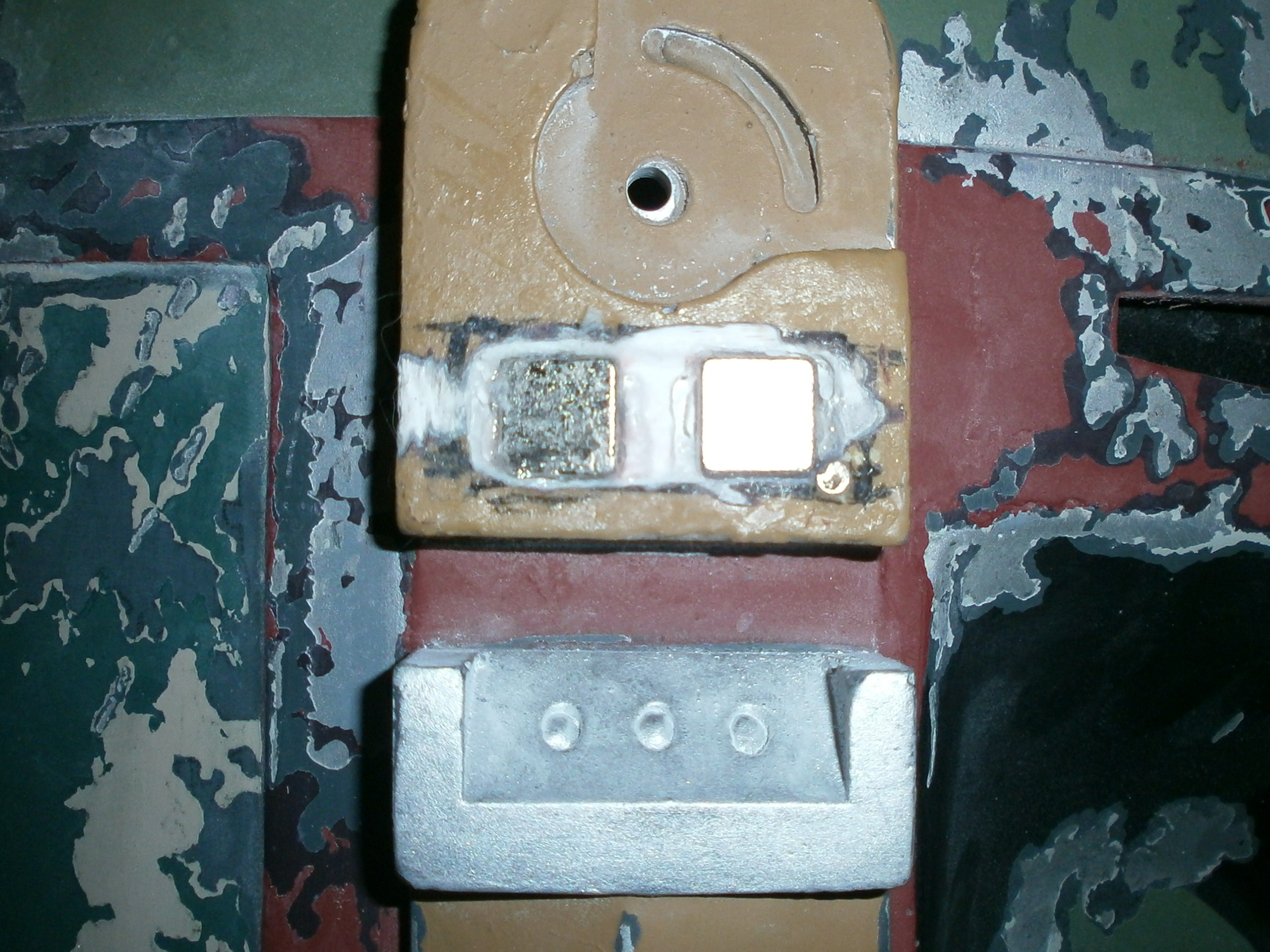

Next I will rework the right earcap. The magnets are not strong enough and it doesn´t fit perferctly...

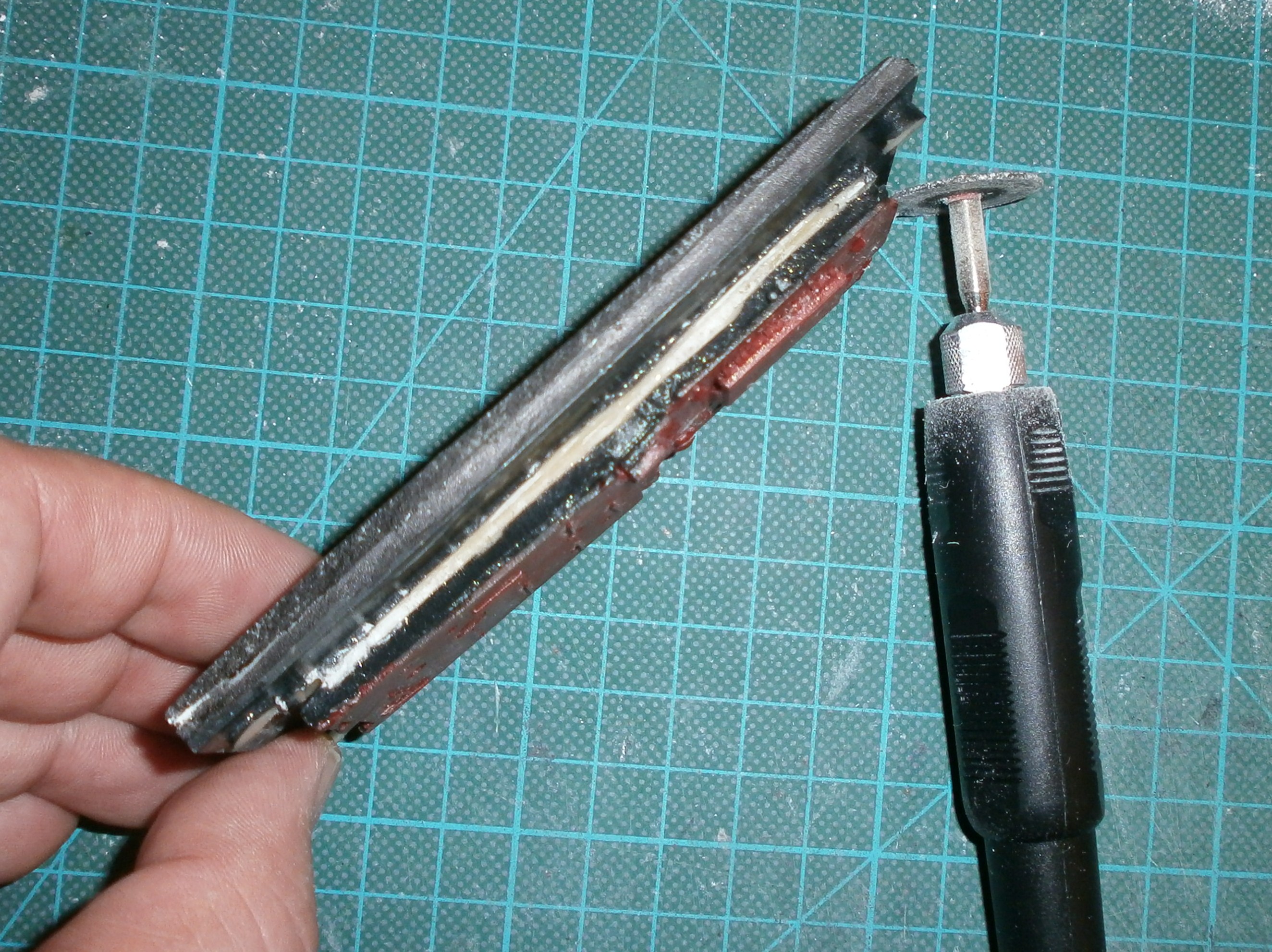

Nearly finished the helmet: 4 new stronger N52 rare earth magnets built into the right ear piece and fixed the MQ-1 circuit board (it was too huge).
PB250892.JPGPB270893.JPGPB270894.JPGPC080897.JPGPC090901.JPGPC090904.JPGPC090905.JPGPC090906.JPGPC090911.JPGPC100913.JPG

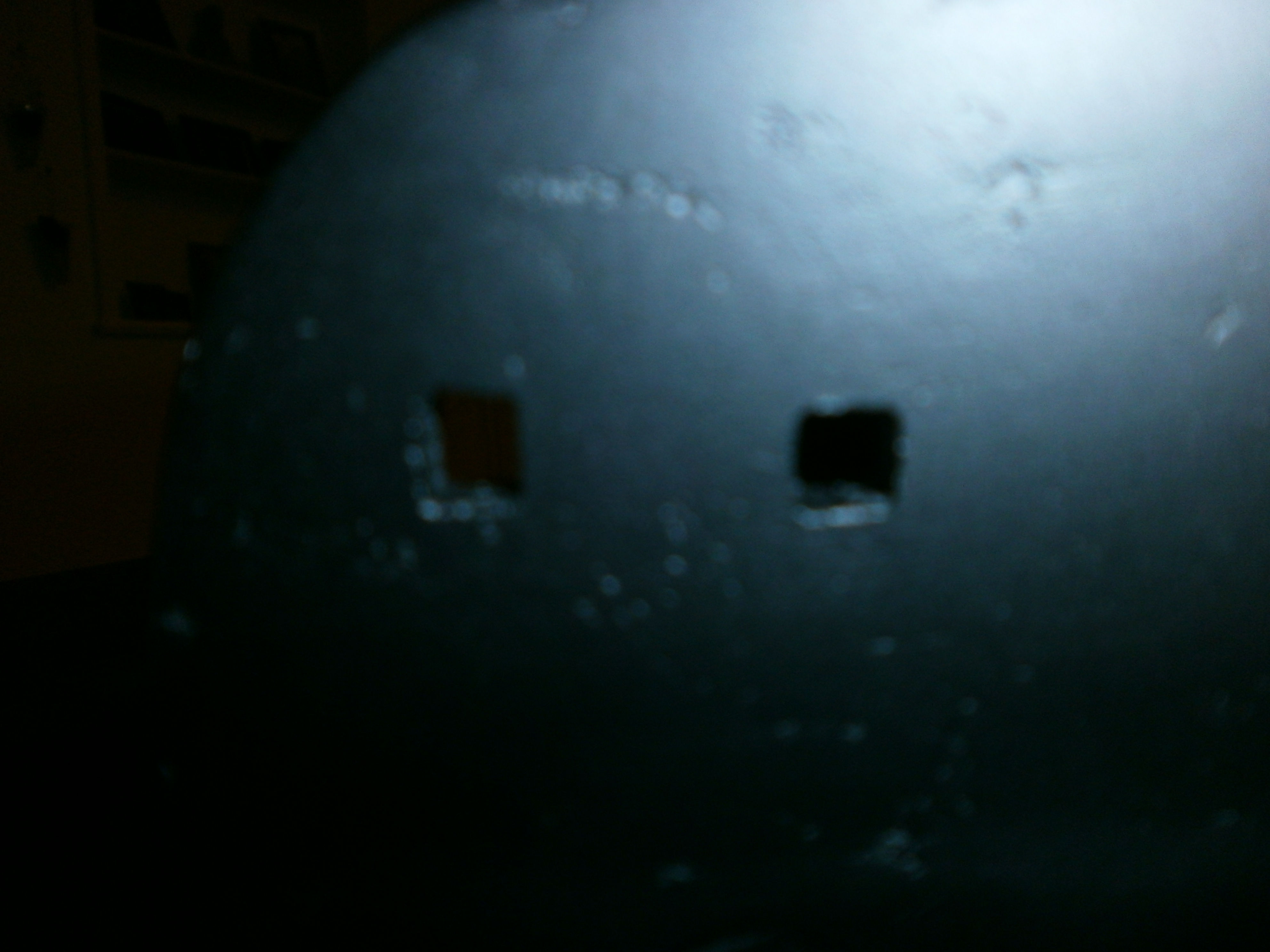

Next will be putting 2 fans into the helmet...
Cabling two radial fans with a 2 AA batteryholder which includes a switch. The fan on the left side I had to hide behind a soft net (antislip mat), because it is too close to my ear. The right fan blows cool air to my mouth area and the left one to the visor. Hope to troop some hours on december the 17th on our local cinema premiere of "The Force Awakens" without taking the helmet off. :)
