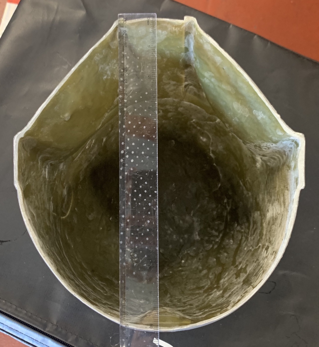

New helmet has landed in the UK and is out for delivery. This helmet was cast in TC 1630 with fiberglass in June of 2020 and has the following measurements:
Length: 10 4/16" (-2/16" or -3mm from the ESB Hero)
Width: 9 3/4" (-1/16" or -1.5mm from the ESB Hero)
This helmet has significantly less shrinkage than the first helmet that was sent to Elstree, which was cast in gelcoat resin with fiberglass.
Is this measured from the outside or the inside?
Is it possible to create a pic where these measurements should be taken? Is length from back to front of visor when the cast is sitting flat? What is the measurement for height? Is width the farthest most points of the casting at the ears? Assume ears are excluded?
Who took measurements of the original & when? Are they very reliable?
Thanks in advance

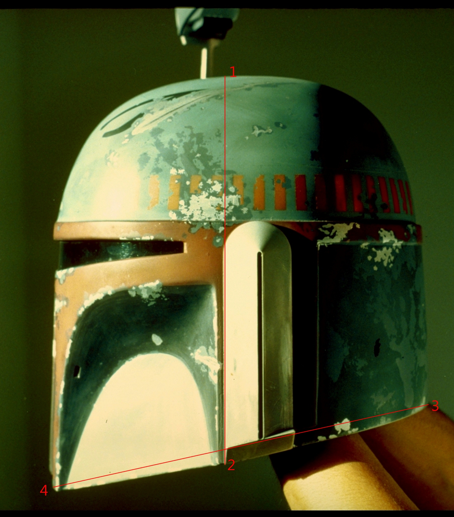

Usually from back to front means from the outside of the rear keyhole to the outside of the T-visor's bottom line (from point 3 to 4). My measurement is 265 mm.
The height is a bit harder to measure, but you'll have to use a flat object (like a ruler) to position it flat under the ears then measure from the center- inside of the dome to the ruler (from point 1 to 2). My measurement here is around 260 mm.

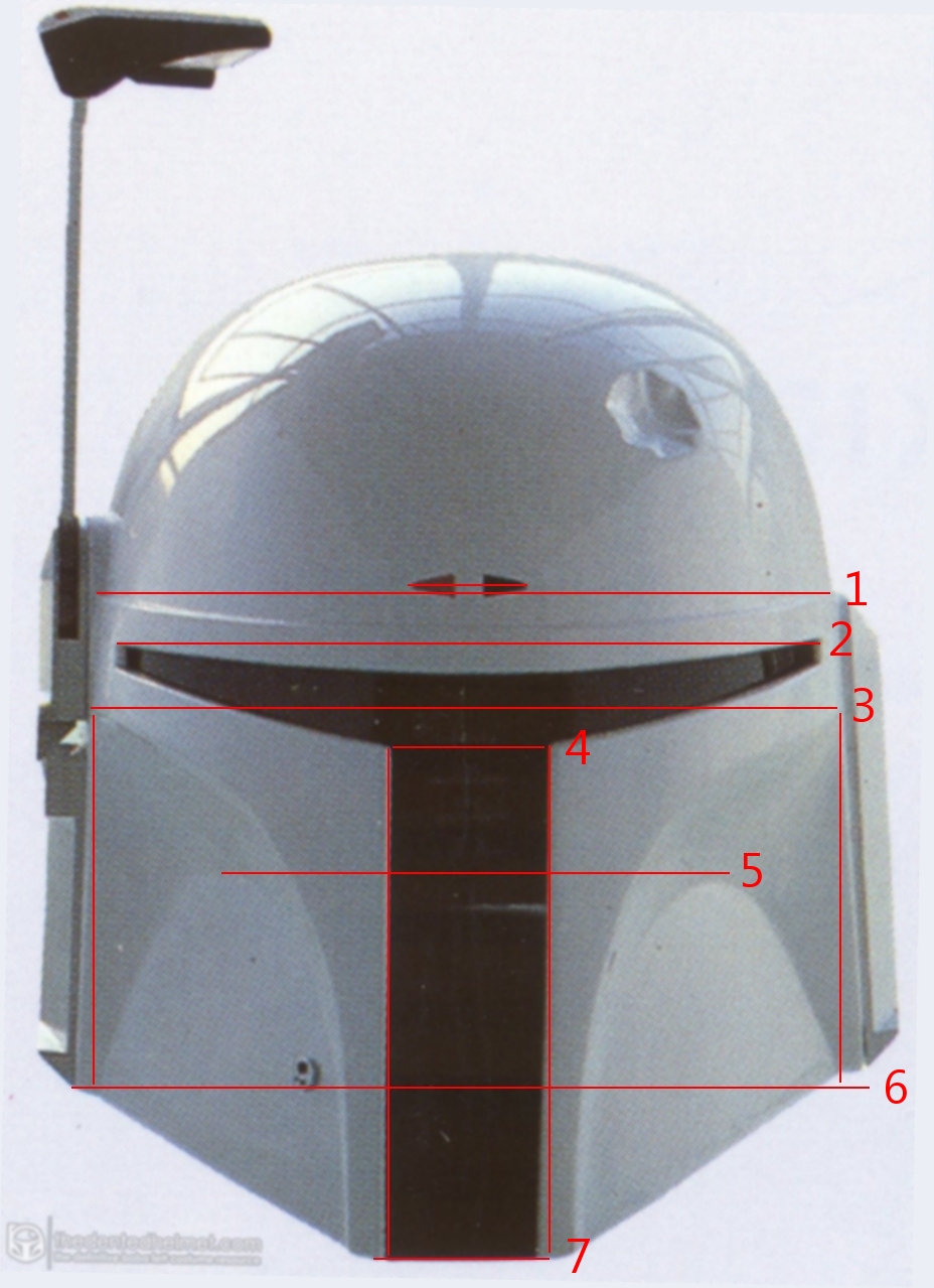

Usually without the ears and is measured from the lower corner of each cheek (along line 6). I got here 247 mm.

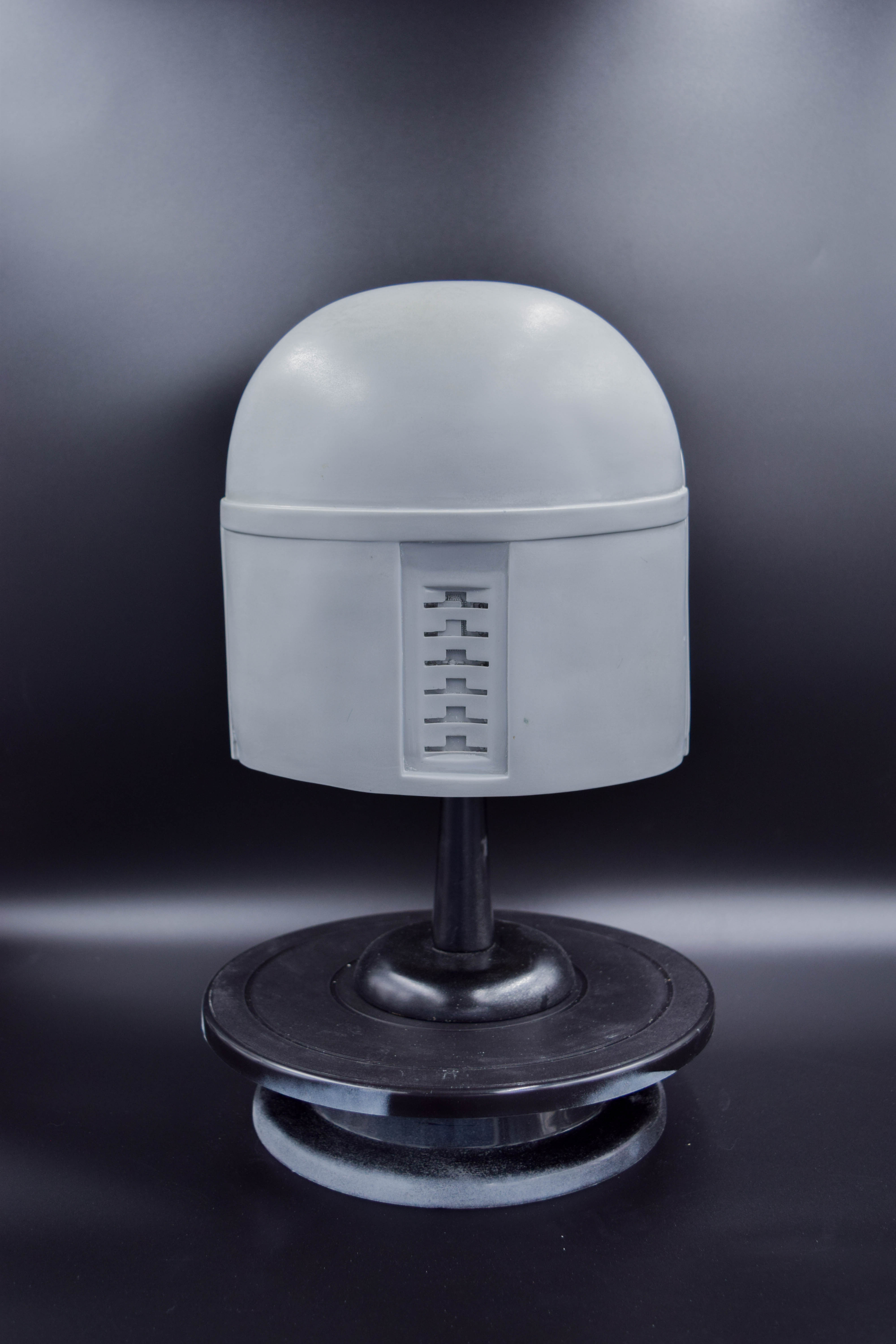

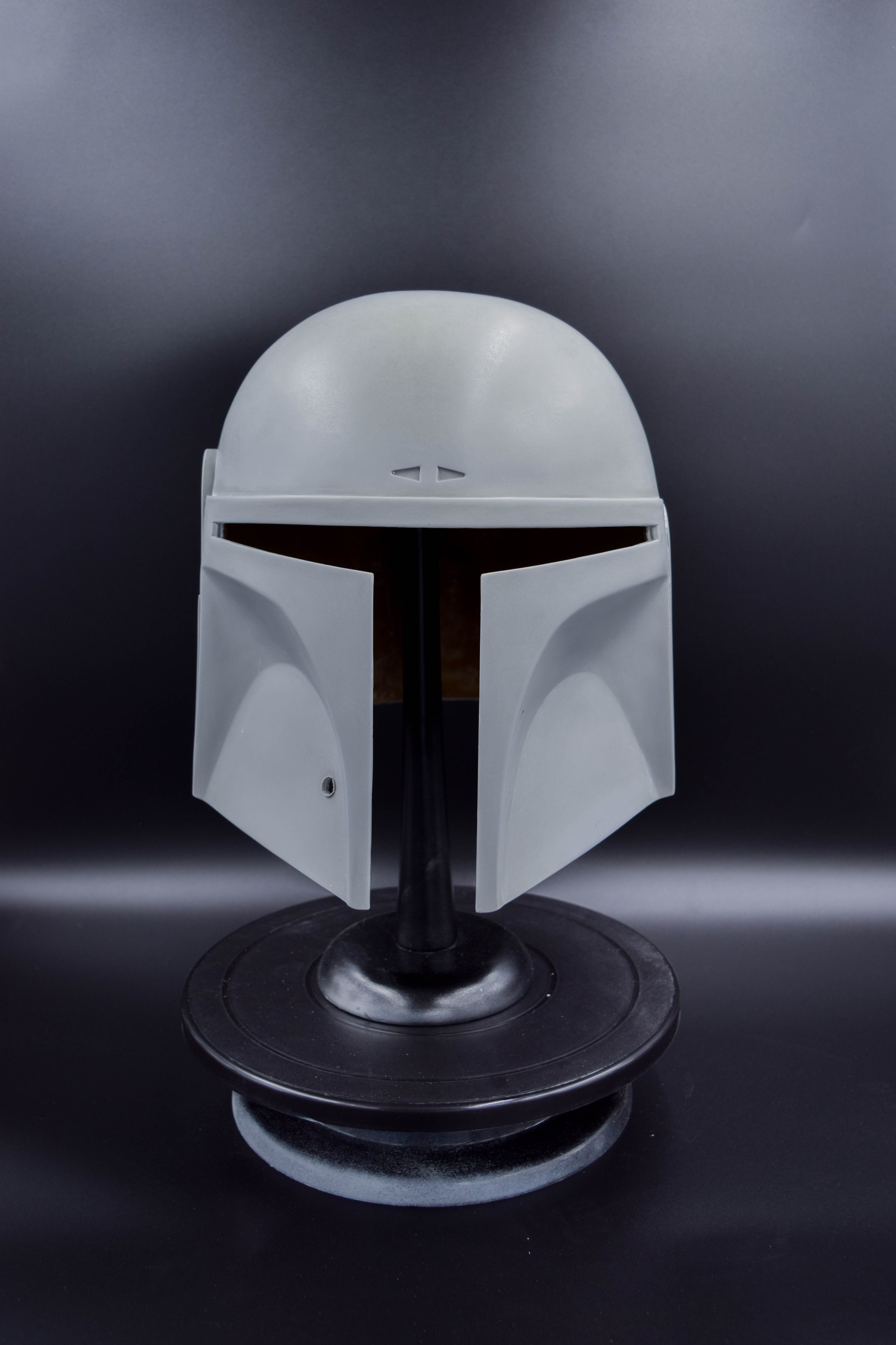

Ears are excluded. The length and width that have been provided to me are the length and width of the ESB Hero. As with just about everything related to the ESB Hero these days - it reportedly goes back to the EFX molding in 2012. The G1, G2 and lossless G3's out in the wild reflect these measurements. This is generally how helmets are measured for length and width. Below is a photo of a raw G4 Hero, which suffers some slight shrinkage in length.

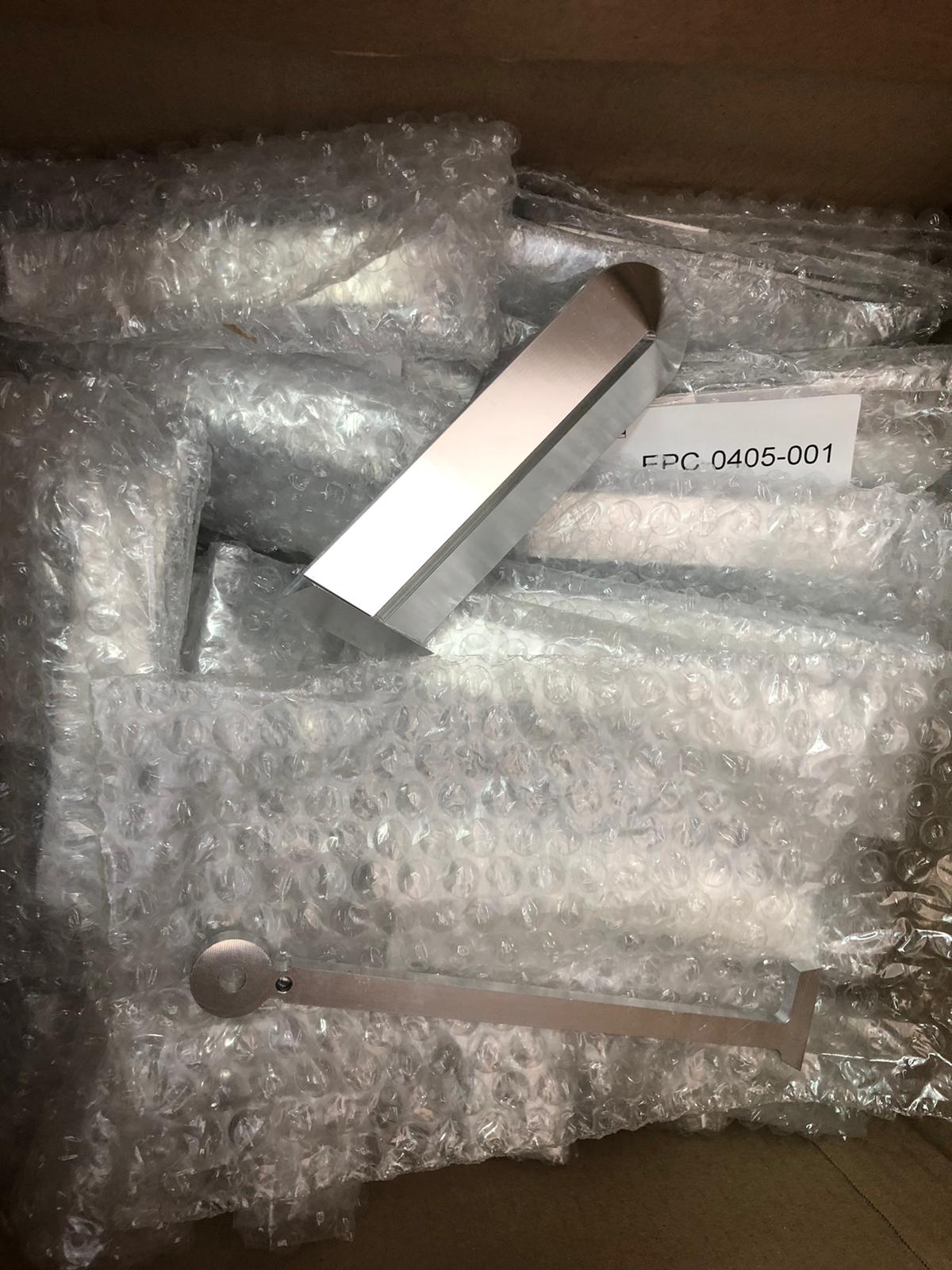

Here are some updates from John a couple weeks ago.
The rangefinder stalks were all drilled in one go and from only one end (top down). Pretty impressive.

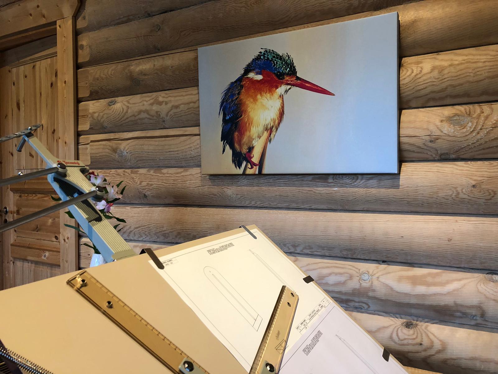

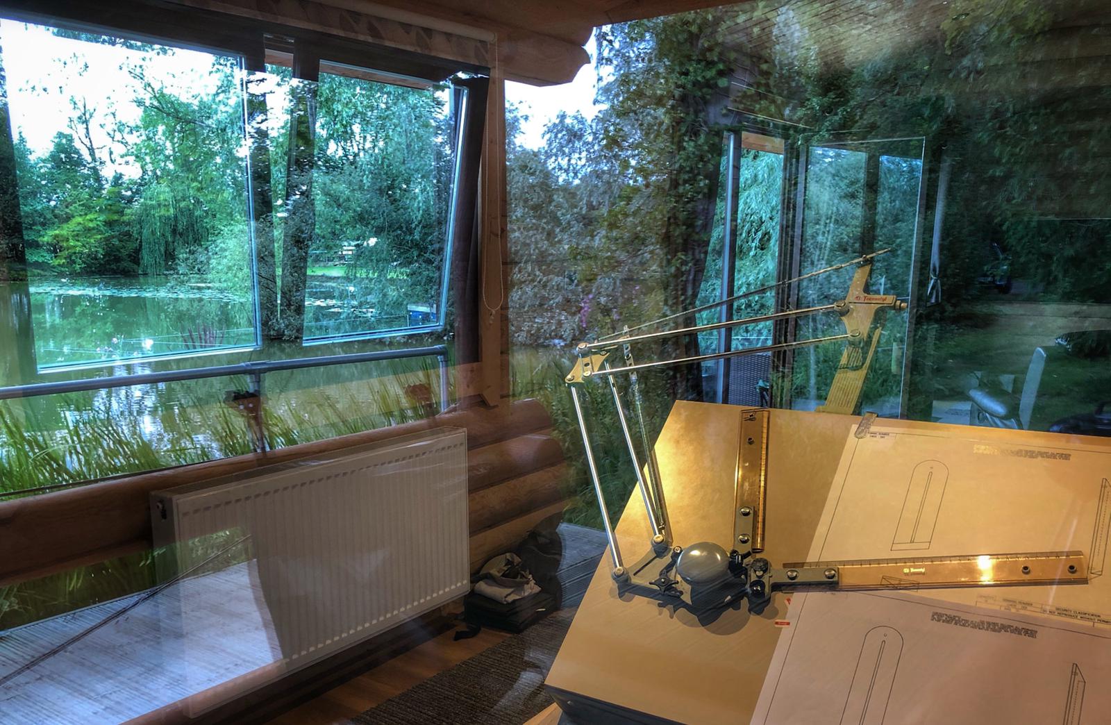

And another update from last week. John has been working on re-drawing the final "original drawings" on the proper draftsman's paper while on vacation.
Thanks for the update! Stuff like that just takes time (the drawing and the ear-making), especially since it is his free time. Seeing a tiniy bit of progress is much appretiated nonetheless! THis project is just amazing!
Also, whereever John spent his vacation is just beautiful!

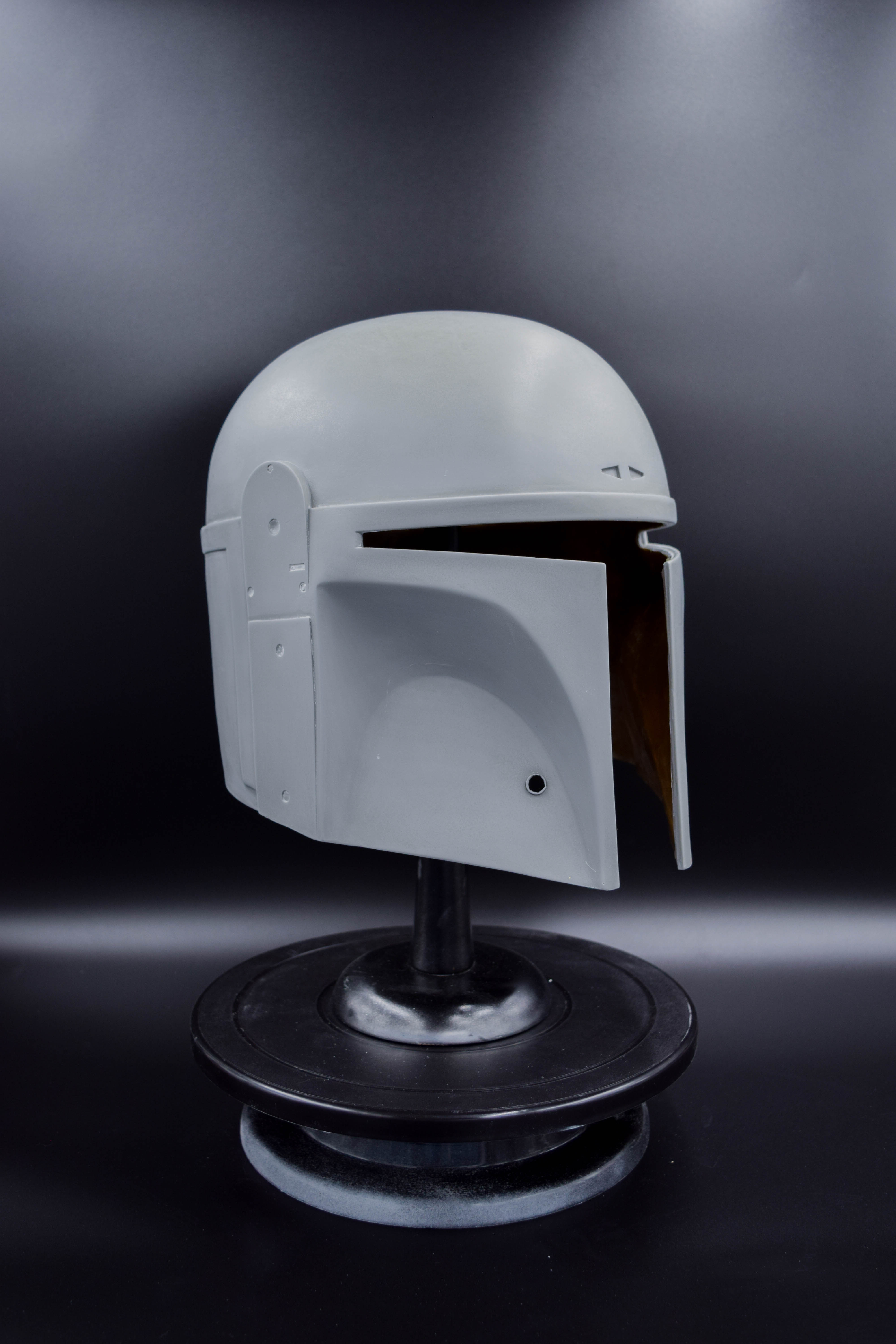

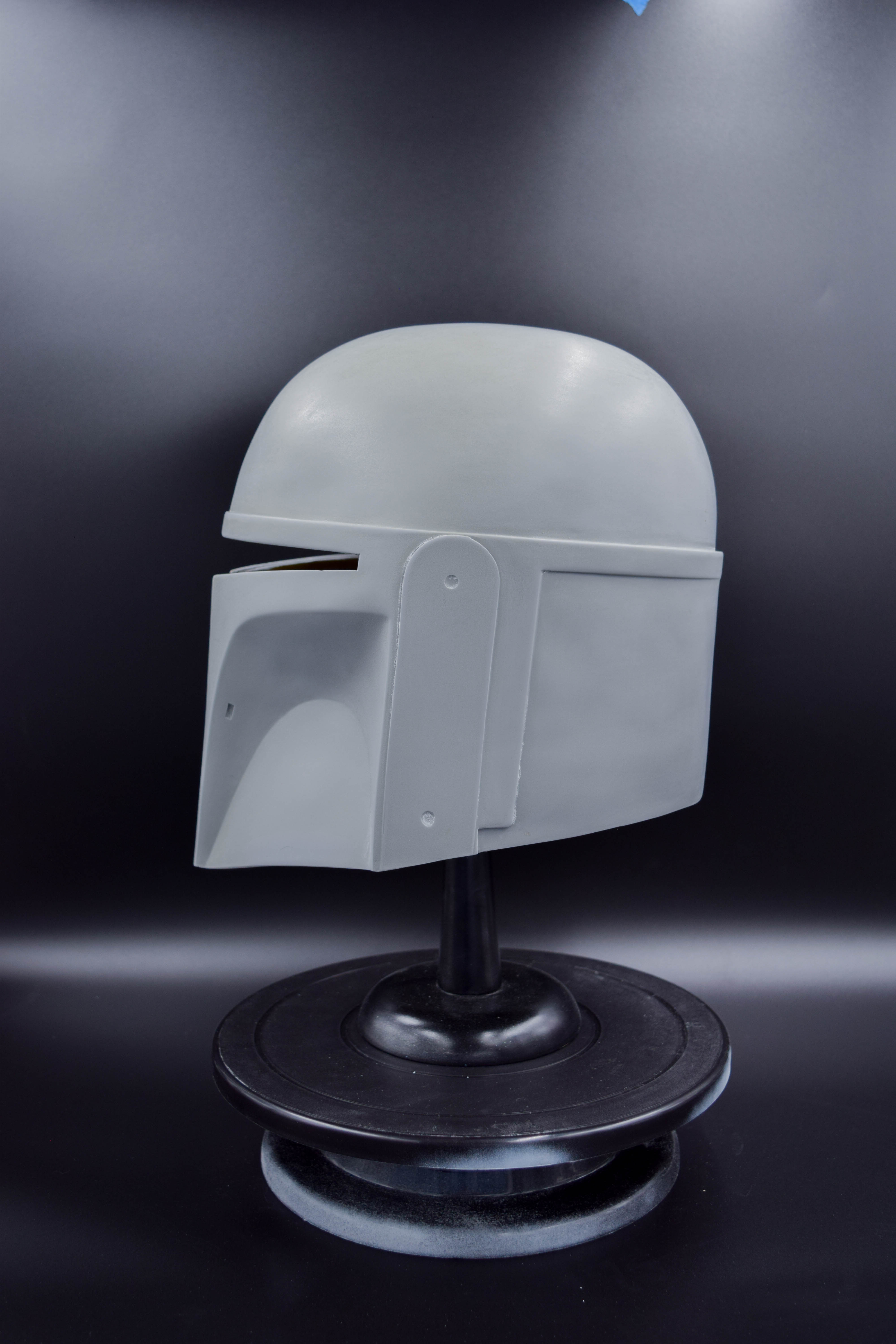

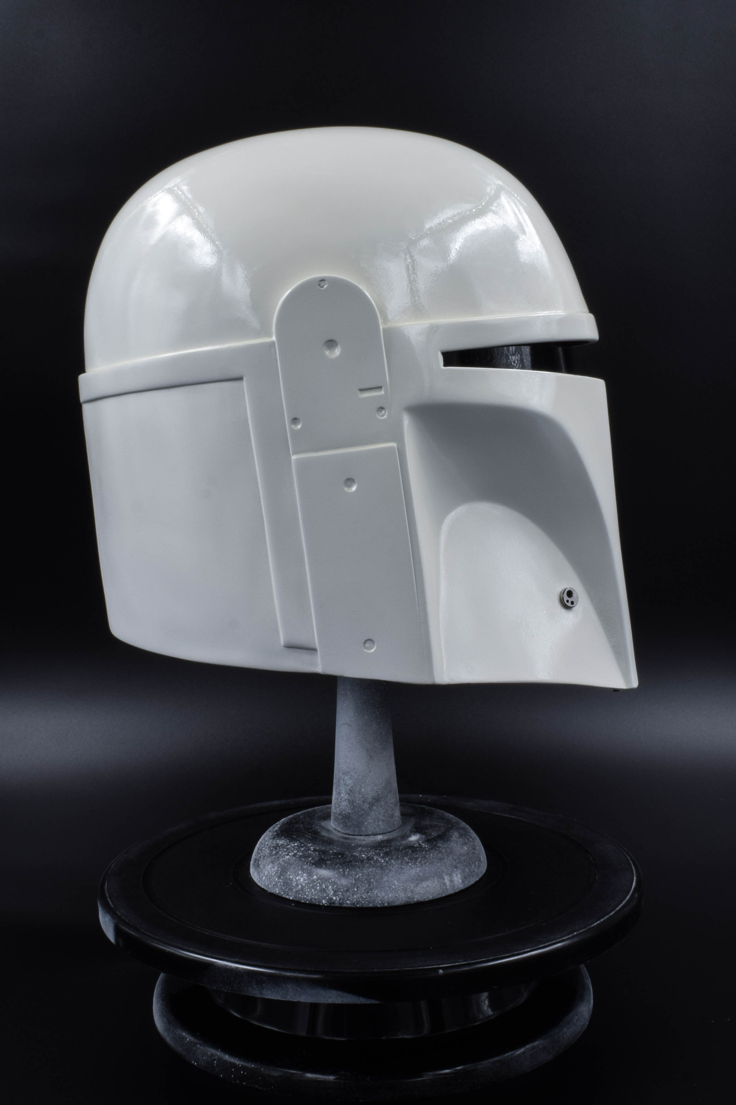

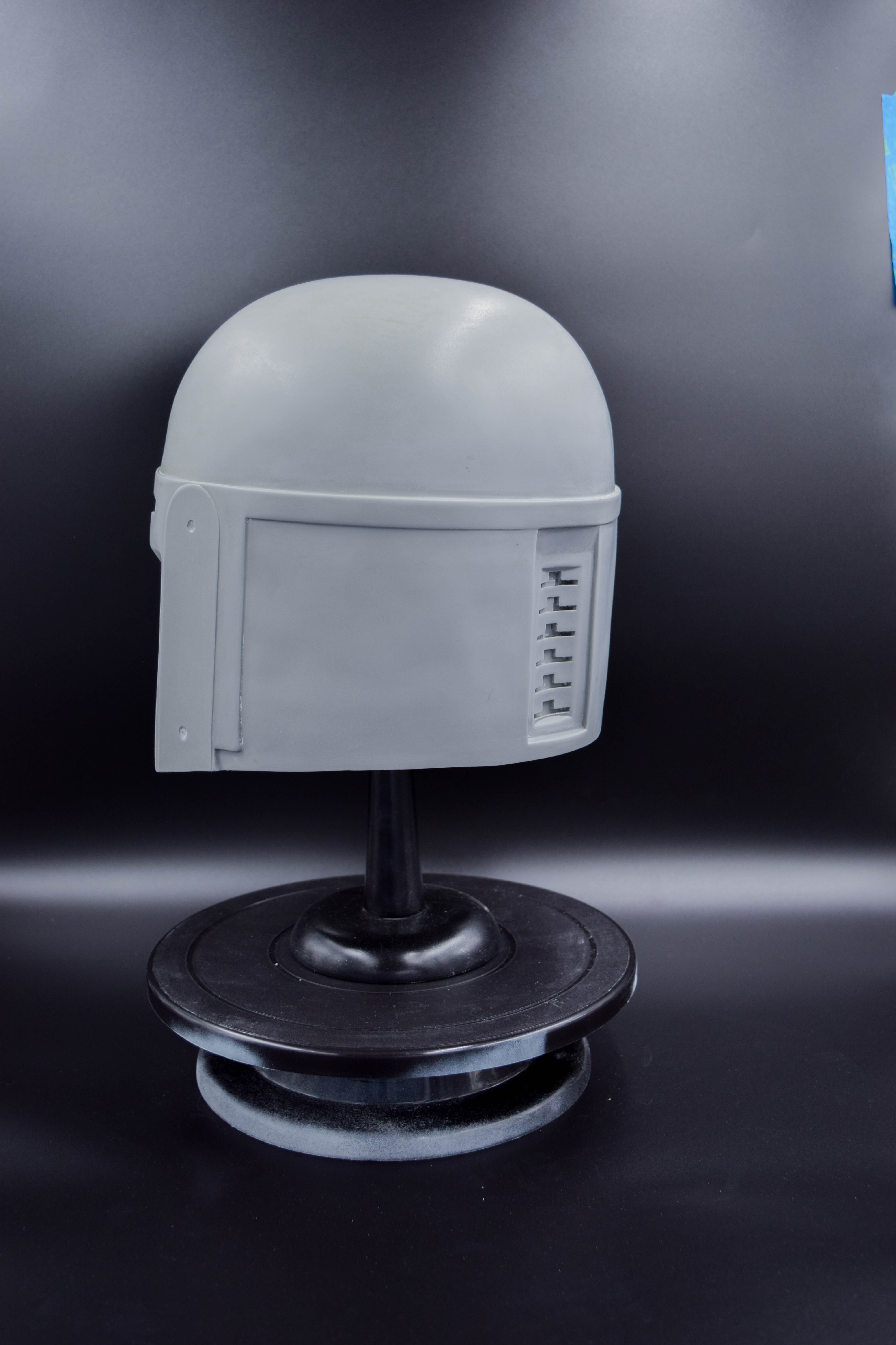

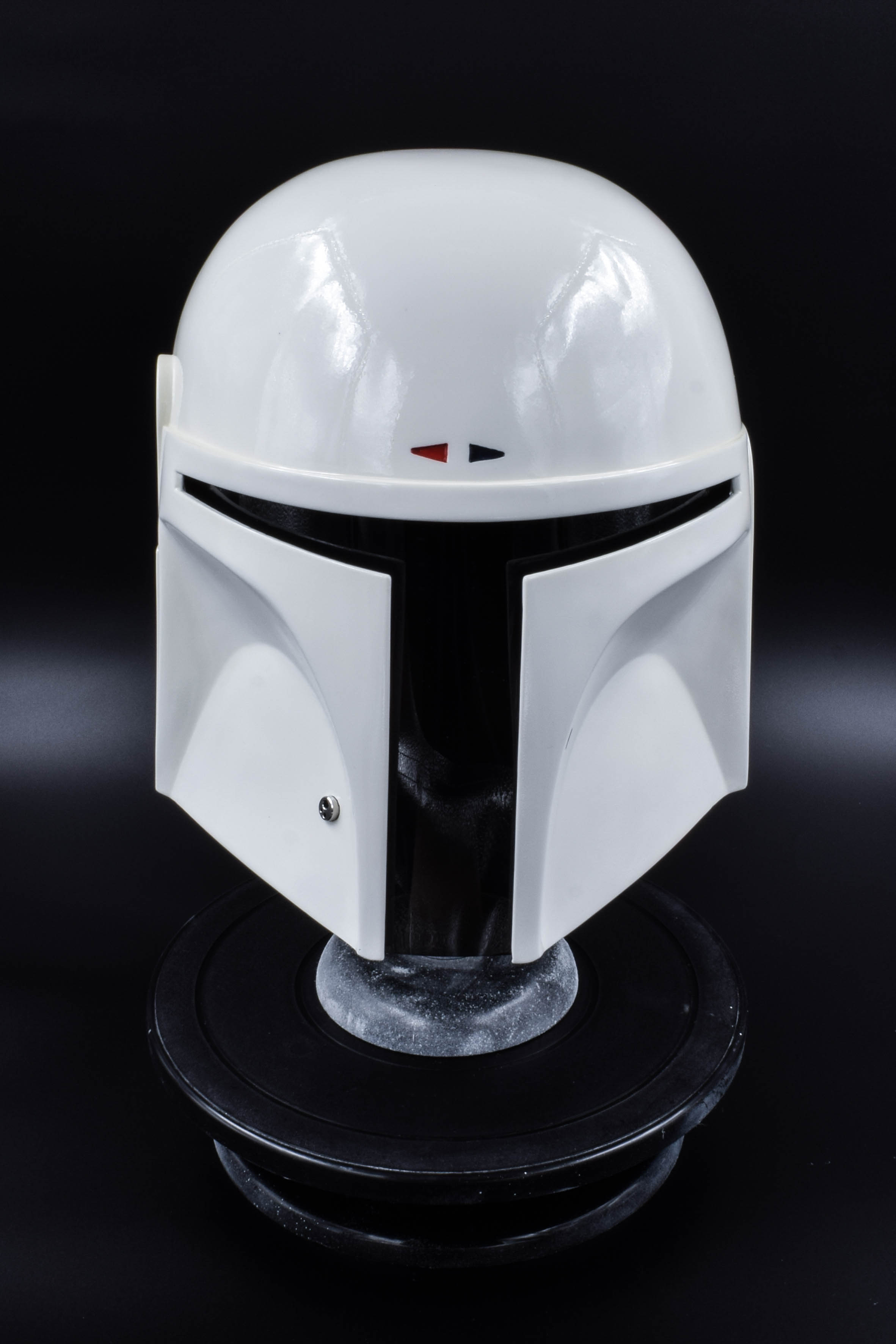

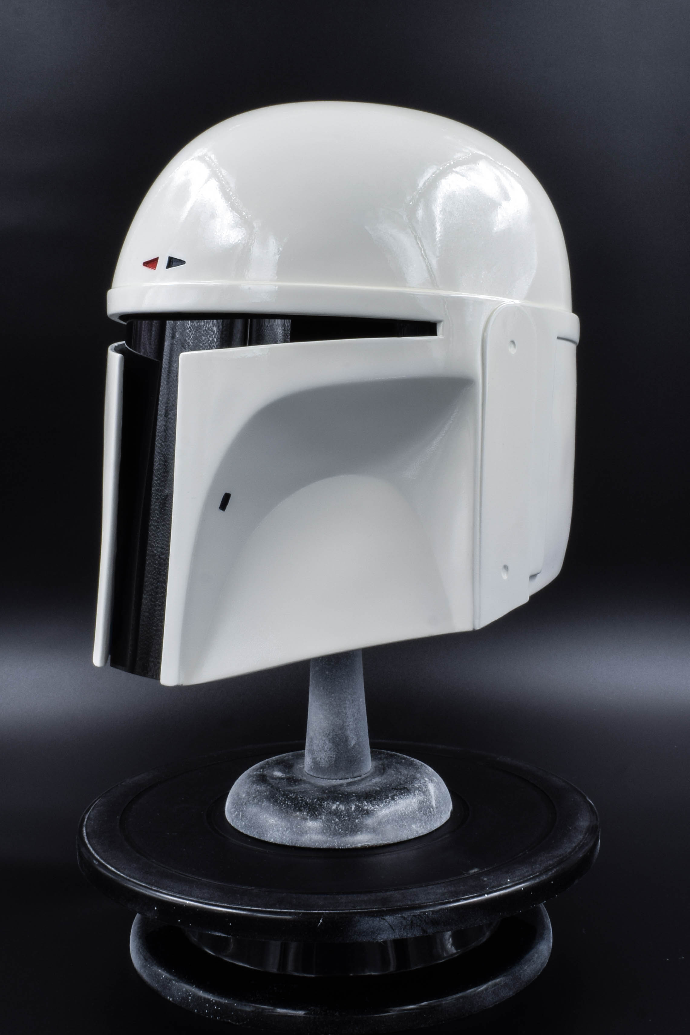

Received the Dentless Supertrooper helmet for John today. Did a preliminary trimming and wet sanded it. Hoping to get more done tomorrow. Will be sending it to him painted white with a gloss clear coat. He will be installing the visor, borden, rangefinder assembly, ears and MQ-1.

Well my part of the Elstree Precision Co Ltd Dentless Supertrooper helmet build is complete. Time to ship it to John and let him get their metal ears and the other components fitted.
I learned several lessons prepping this lid. Proved more challenging than I thought it would. Not perfect, but I’m happy with it. The helmet itself is fantastic and well built.
Borden and visor are temporarily taped in. John will he installing them similar to how the originals were installed.
