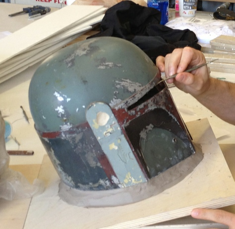

New helmet has landed in the UK and is out for delivery. This helmet was cast in TC 1630 with fiberglass in June of 2020 and has the following measurements:
Length: 10 4/16" (-2/16" or -3mm from the ESB Hero)
Width: 9 3/4" (-1/16" or -1.5mm from the ESB Hero)
This helmet has significantly less shrinkage than the first helmet that was sent to Elstree, which was cast in gelcoat resin with fiberglass.

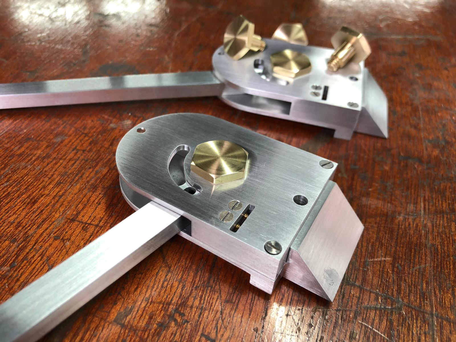

More progress!

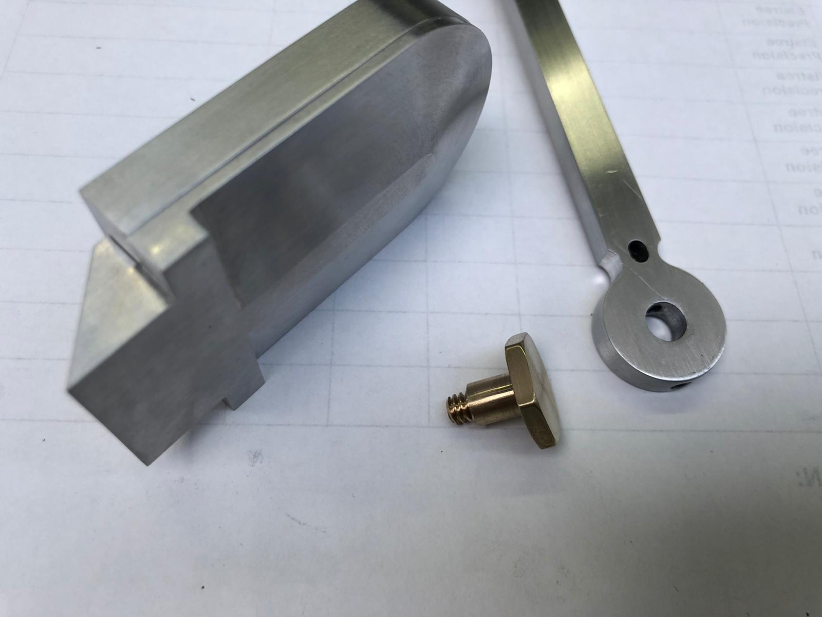

John finished the bolts a few days ago. He recreated the Whitworth thread pattern of the period.
And as of today, the bolts are completed & fitted.
On the brass bolt... I had a problem with my FPH2 ears from Machinecraft in that, there wasn't enough threaded material to compensate for the thickness of the helmet fiberglass... so the brass bolt wouldn't thread into the front plate/range finder stalk cover...
These look flush on the back... with no thickness of helmet material space...???
KaanE
The entire area around the bolt gets cut out of the fiberglass. The bolt just tightens against the backside of the ear.
