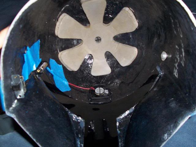

Hey, you know I thought about doing that, having fans blow air out the back vents for a "realism" effect. You can see how I placed mine in my helmet, just posted the pics. The reason I put it there, is because it was a small fan, and that I felt more of it on my forehead, then on my left side. I aslo put the switch in a location that is easily accessable, yet subtle. The whole set up is pretty simple. I did it through common sense. I went to radioshack, looked and found the smallest fan, a 12V fan, which was surprisingly $13. I then proceeded to those large drawers of switches and battery packs, and found the one way switches and got a pack of those. I then purchased a small battery holder, I believe the packaging said it was a "N" battery? Just ask them for a 12V battery, its really small, and you can match up the battery holder. You will aslo need a sodderin Iron.
The connecting of the cables is simple.(NOTE: do not have the battery in while connecting unless you want to be shocked) The fan has to cables, the Black, which is the neutral, and the Red, I beilieve for hot? Anyways, you take the Black cable from the fan, and sodder it onto one of the switch prongs. There are two sperate prongs on the switch. Male sure that the exposed portion of wire is addequetly attached to the prong. Then taking the red wire from the fan, and the red wire from the battery pack, twist together the exposed wires, and then sodder it so it dosnt come apart. After that, take the remaining Black wire from the battery pack and sodder it to the other prong on the switch. Once this is done, put the battery in and flip the switch and it should turn on. Another thing, for neatness, I cut the wires down so that I could lay it straight and flat, without having wires flaying everywhere. I hot glues the parts in and used tape to hold the wires together and hold them down. Heres the set up.

I stopped in Radio Shack earlier today and picked up the same micro fan you bought, but they didn't have the same one way switches, nor the same power supply/battery holder. In it's place, I picked up a single AA battery holder for the power supply, and a micromini toggle switch-although I do have another push button switch I found here, shown in the below photo, albeit a bad pic...Before I go soldering things together incorrectly and burning up the fan motor or the switch I thought I'd ask and see if the fan will work fine before I go hooking it all up. So what do you think?
Thanks again for your help, I appreciate it. I thought this was going to be a major ordeal to set up, but so far it's not been so bad. Hopefully the parts I picked up will work sufficiently. The only issue I think may be the power supply/battery holder. Electrical work is fairly foreign to me as I've said, but hopefully with help from folks here I'll get all my wiring etc done myself. Now I just need to find a tutorial for setting up an led spotlight on my gauntlet(s) and/or helmet, as well as blinking/non-blinking colored lights here and there also and I'll be well upon my way...
Well I hope im helping you with this. From your pic, you have what you need, however, ive never used a toggle switch. One though is that your gonna have to get the smaller battery pack so that you can get the 12 Volts needed, or els it won't run to its best. So thats what you should do.
