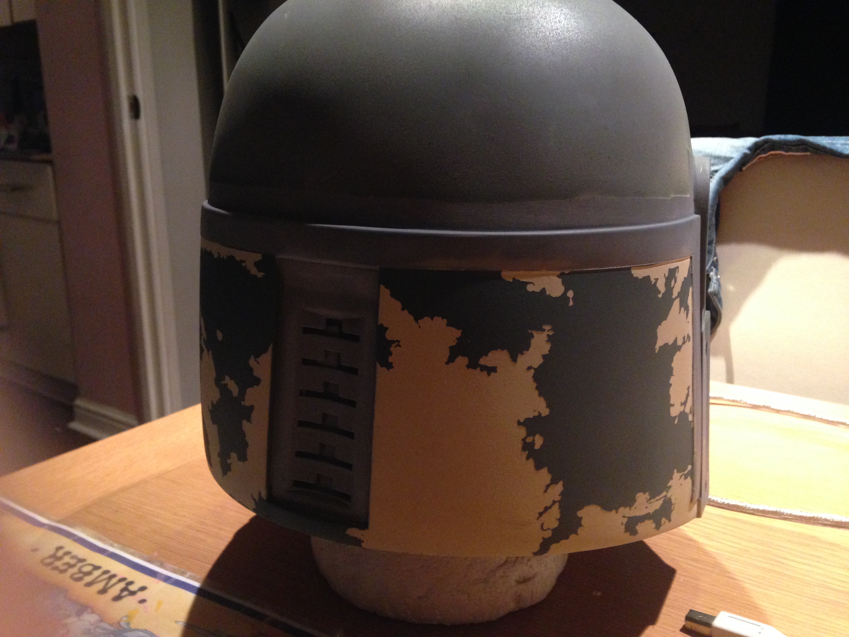

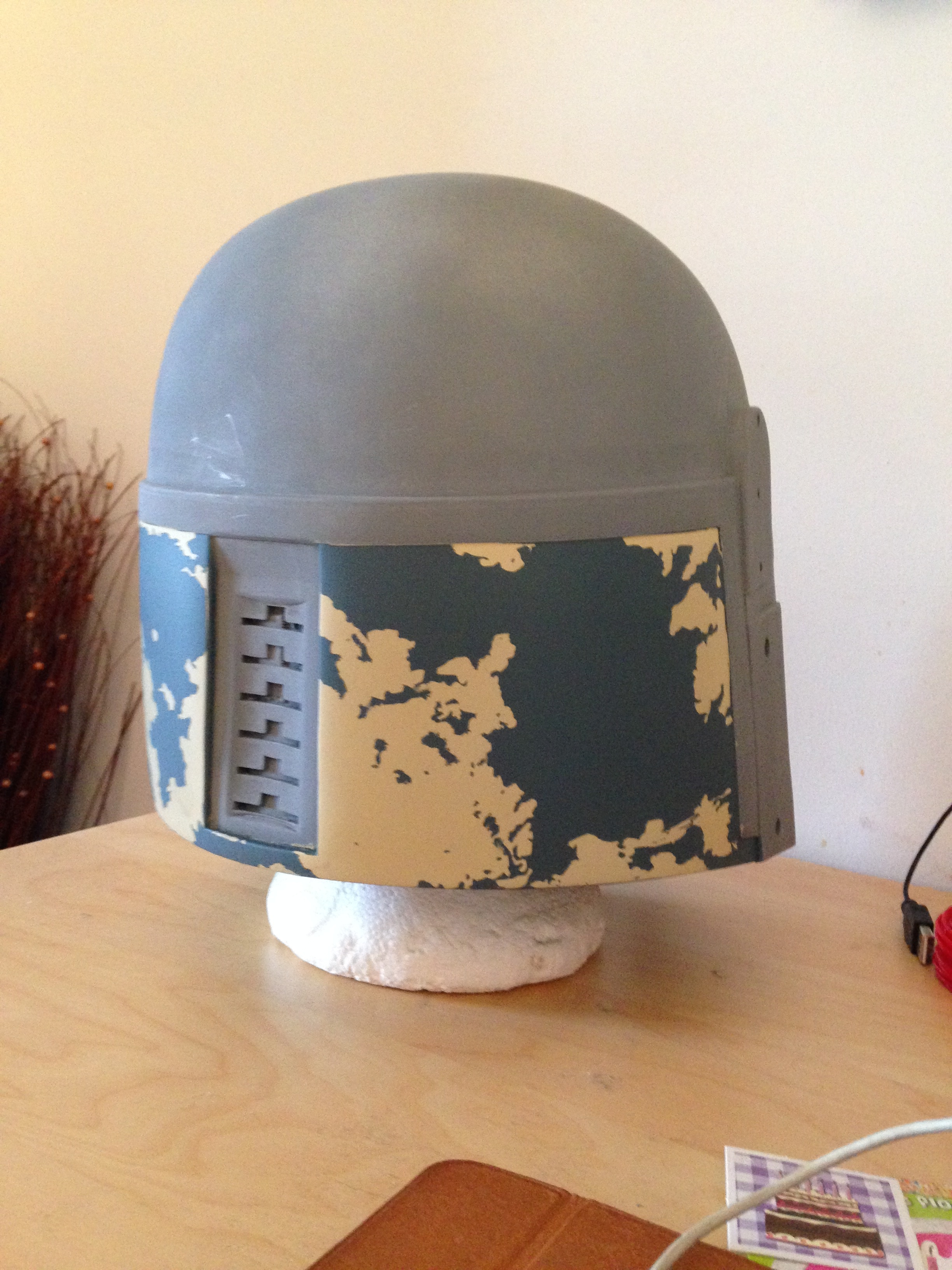

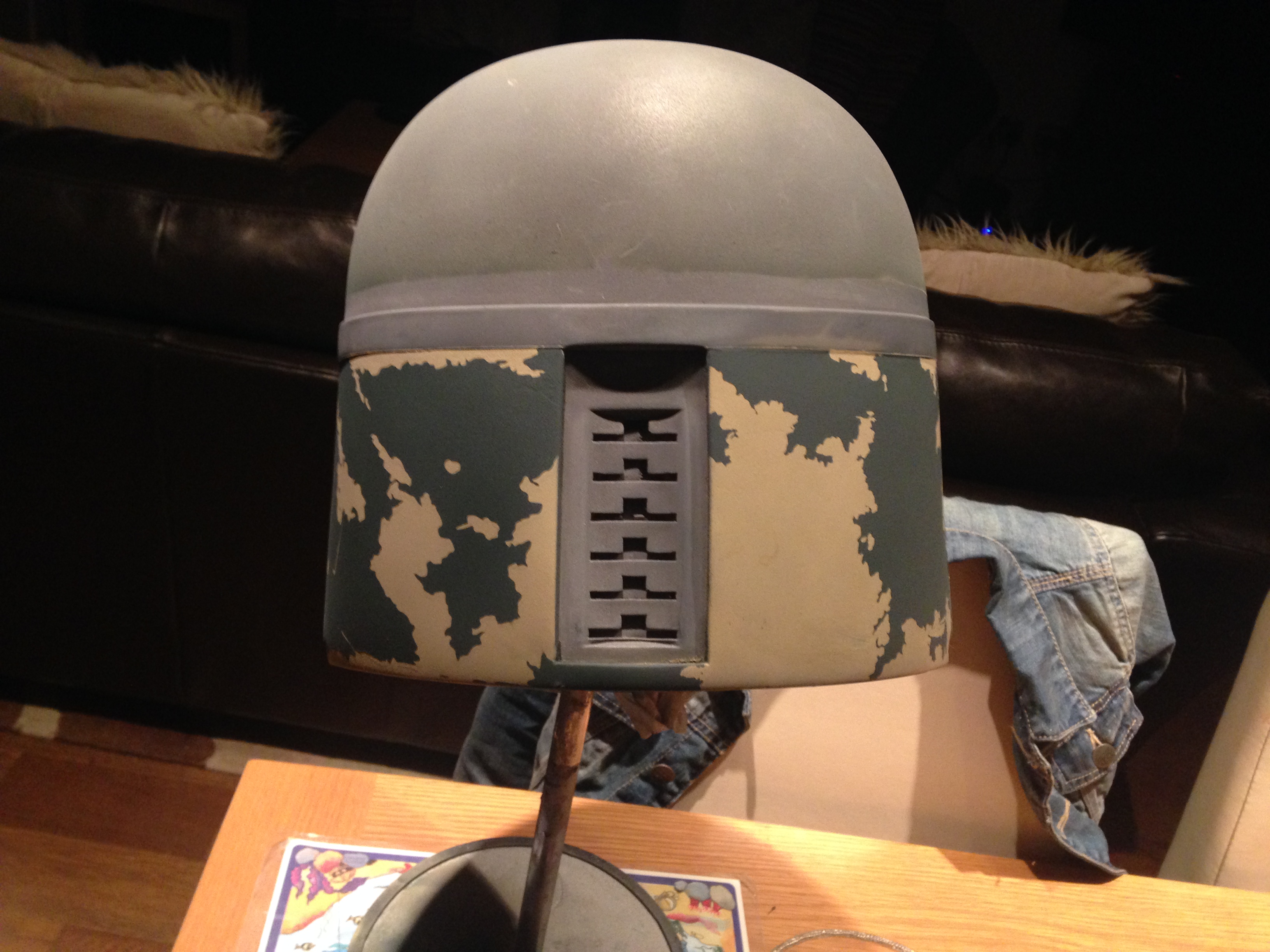

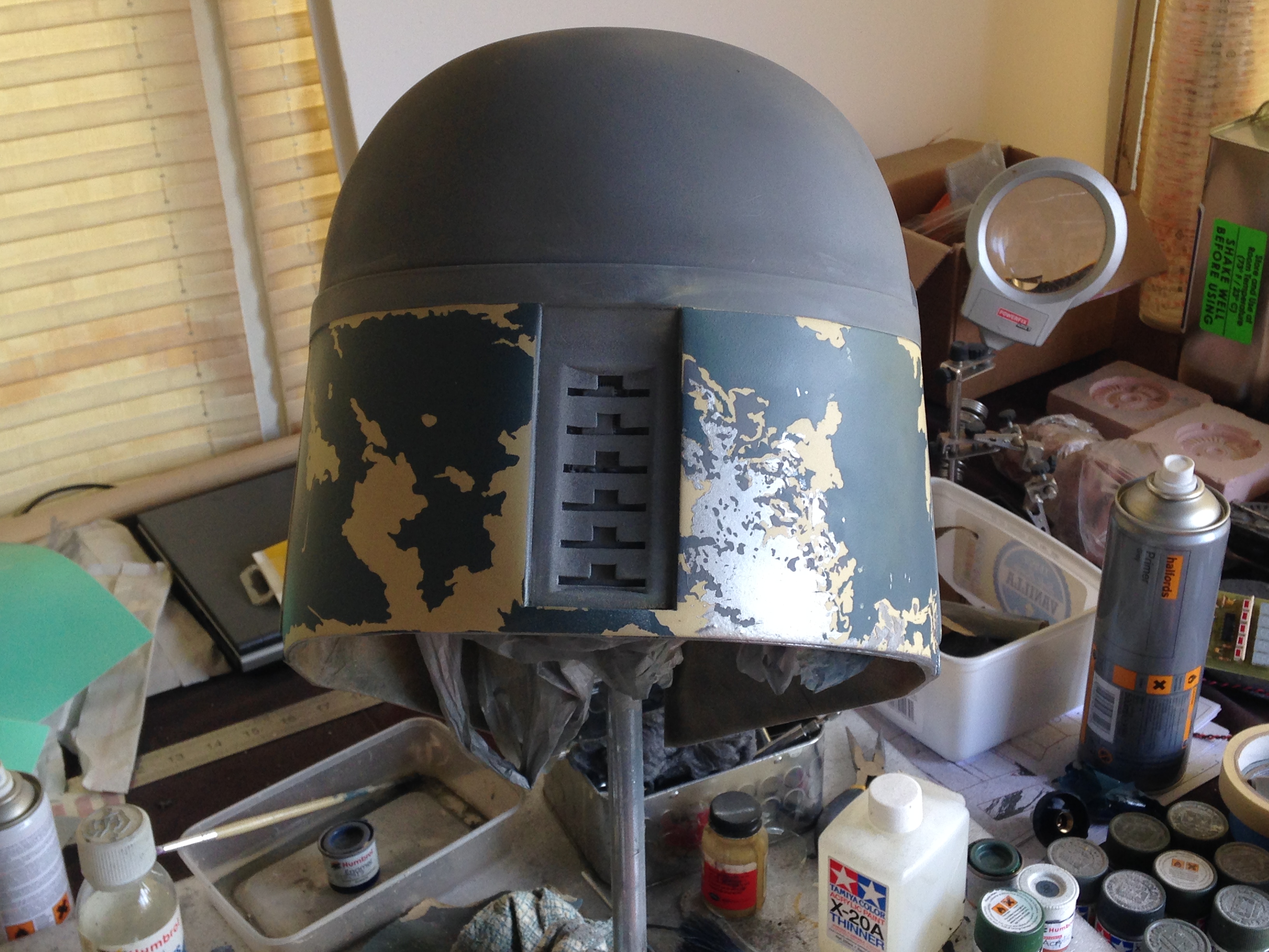

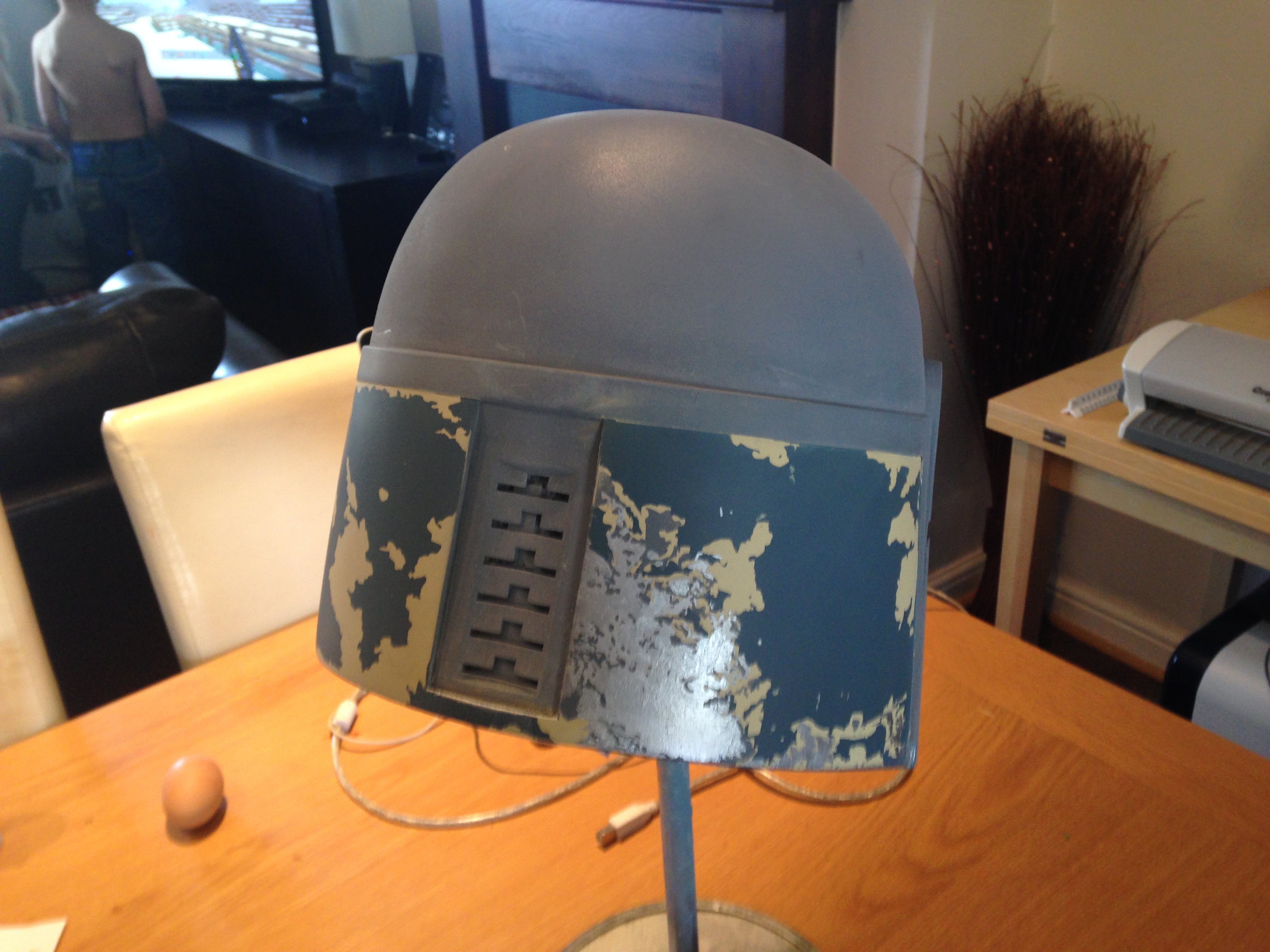

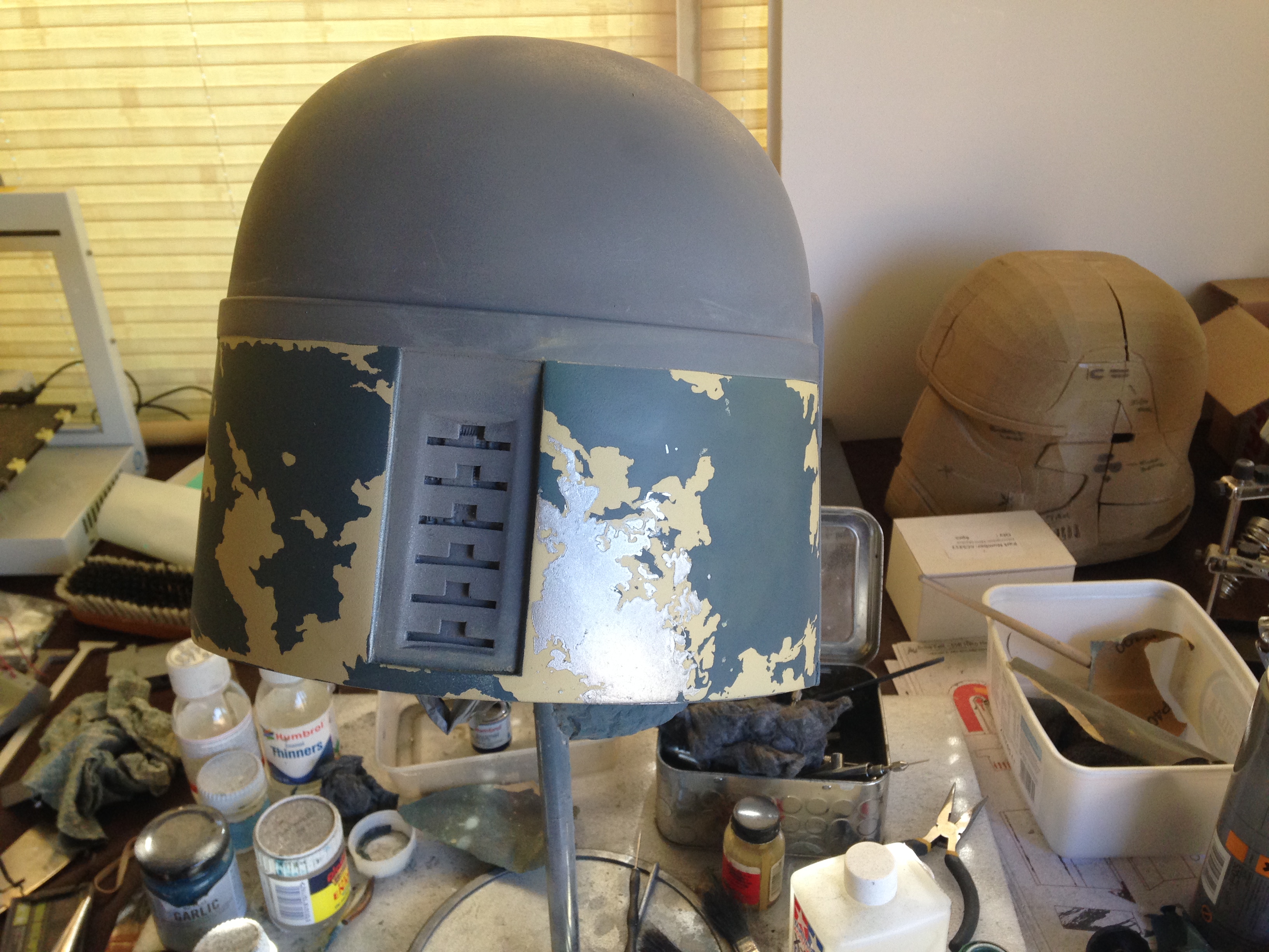

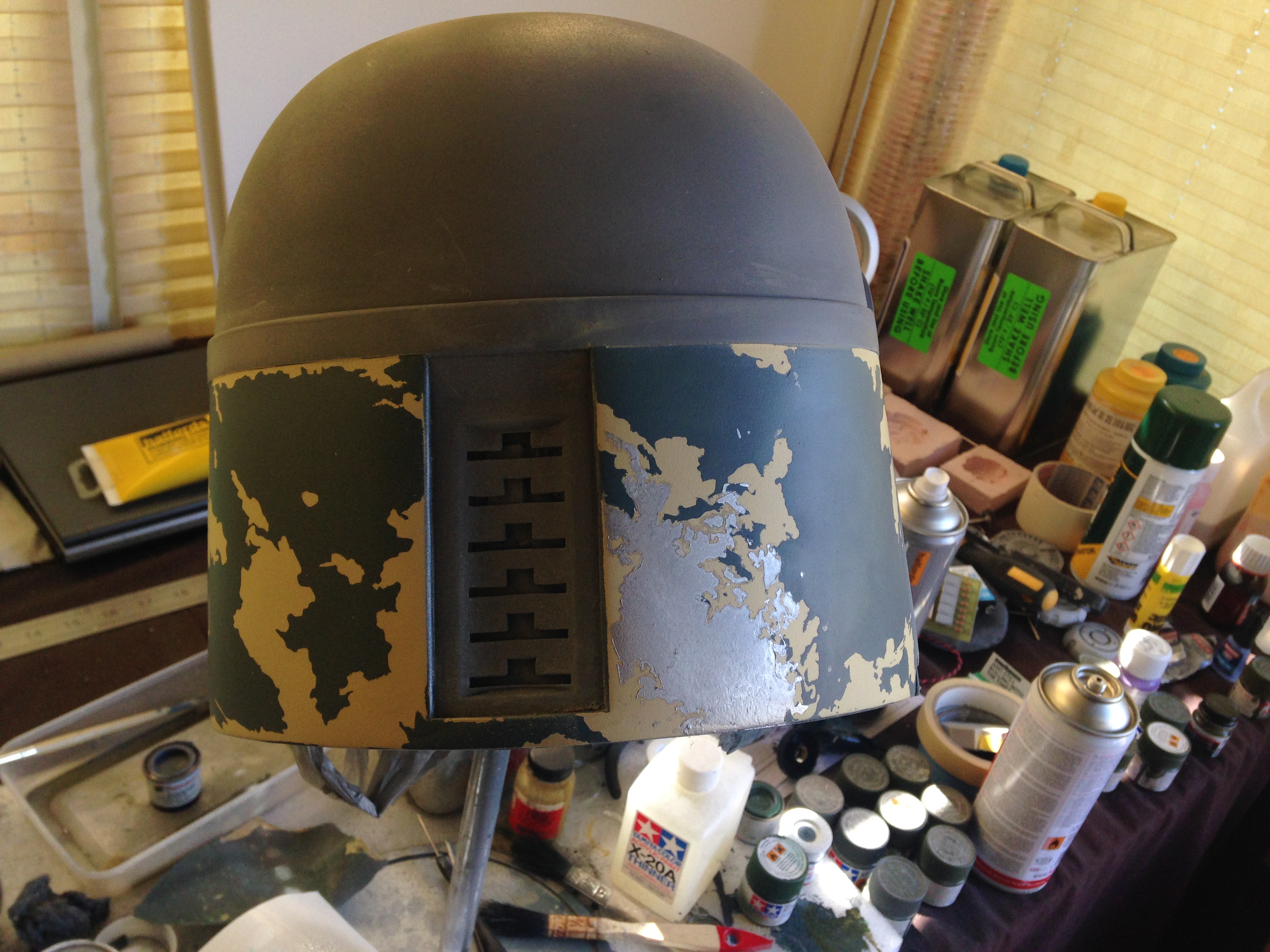

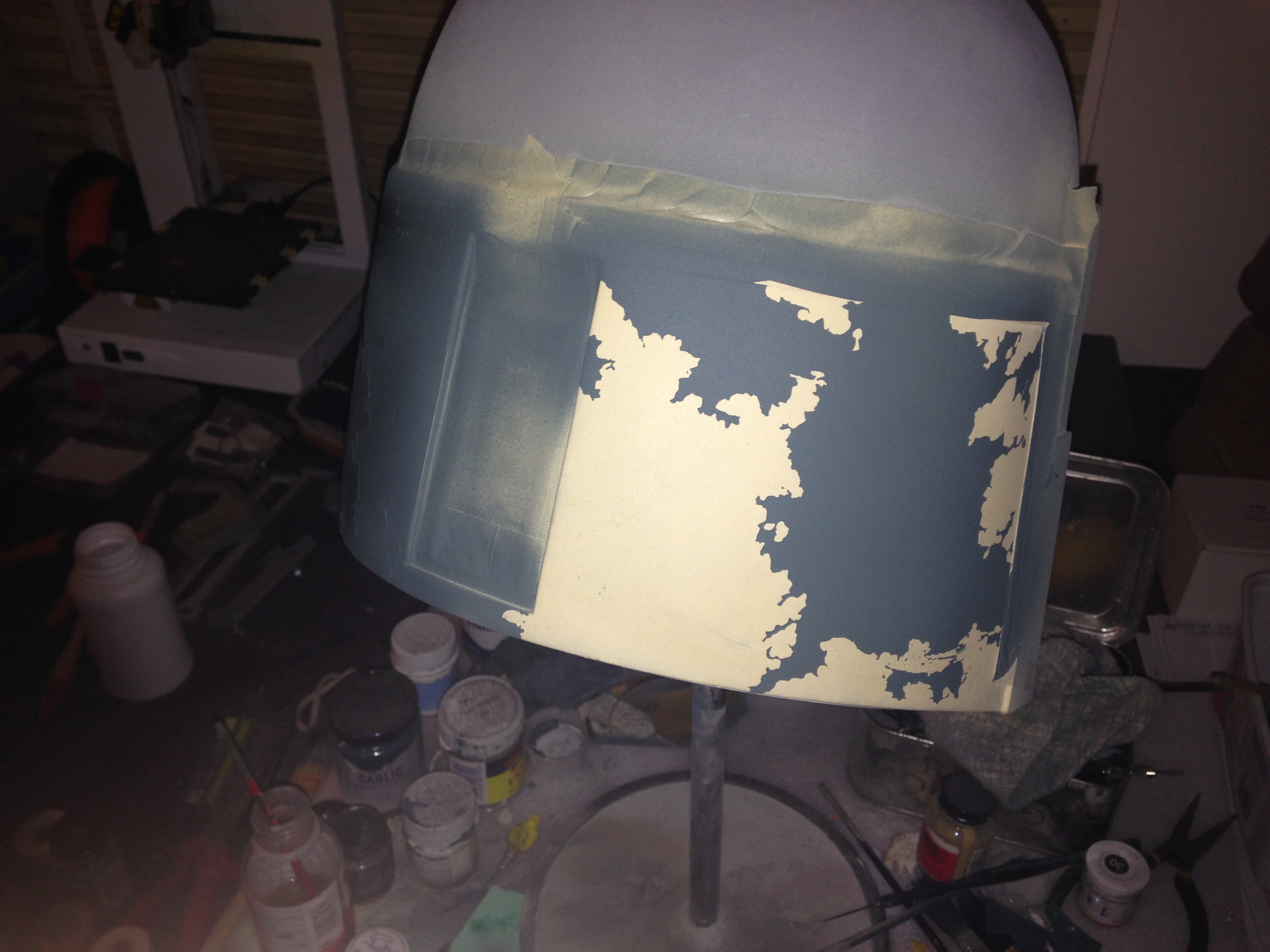

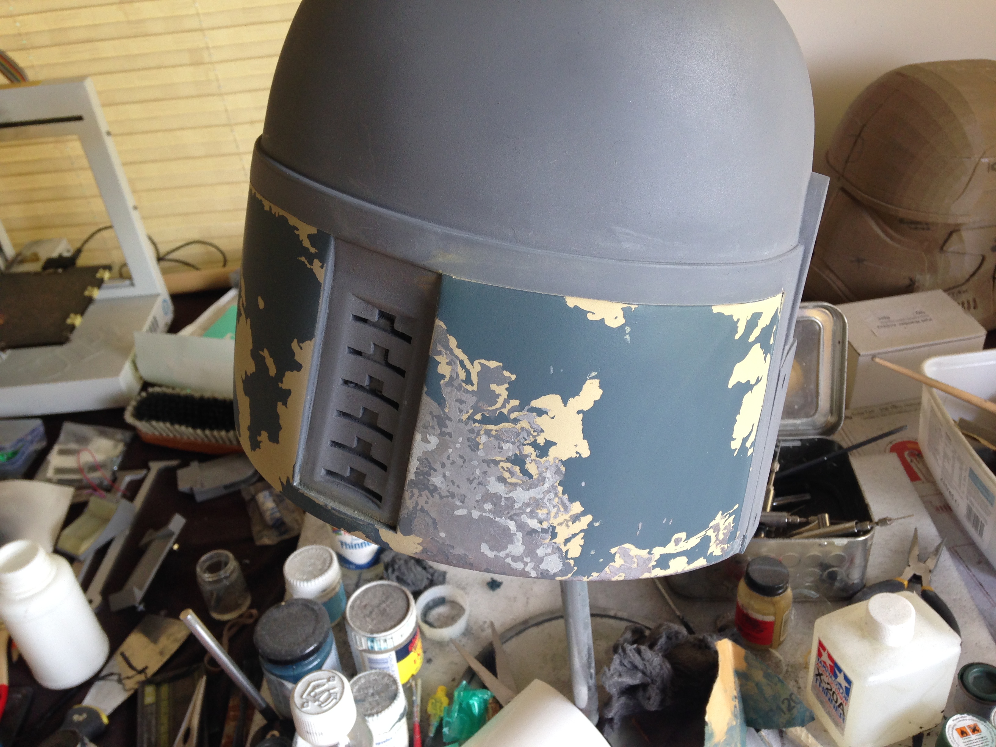

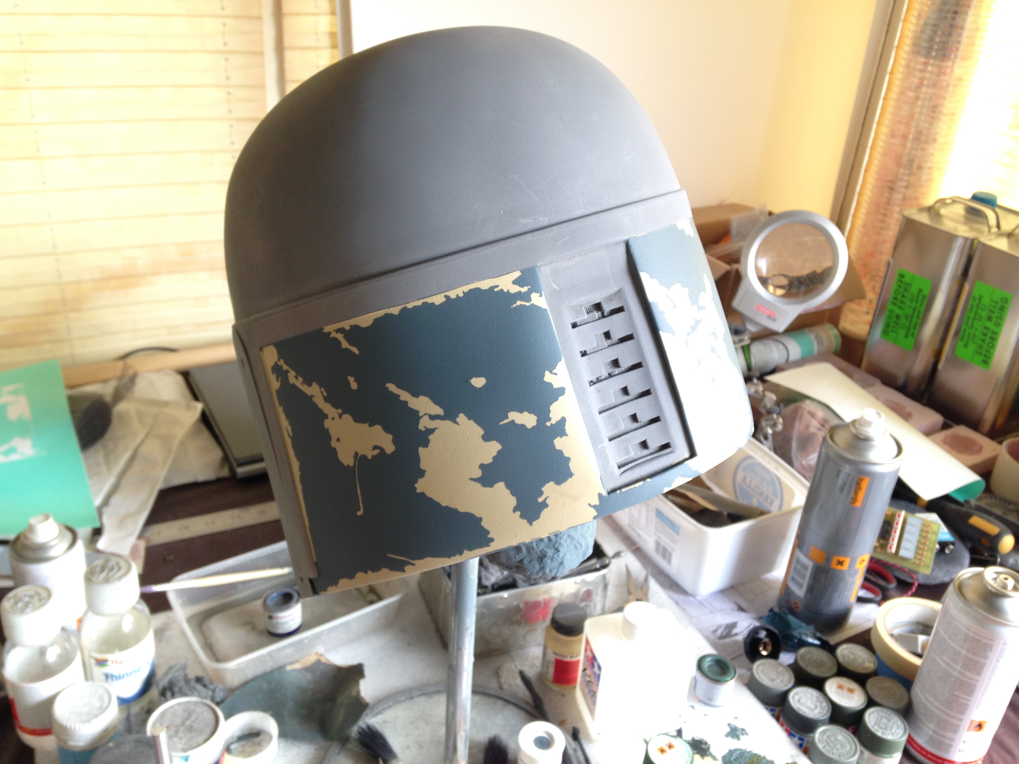

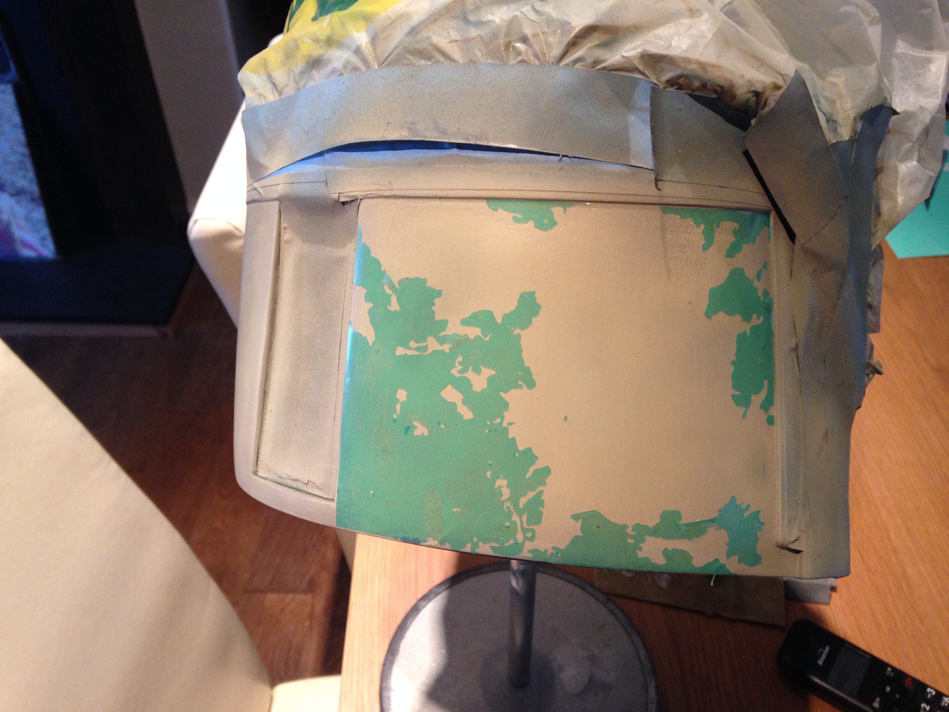

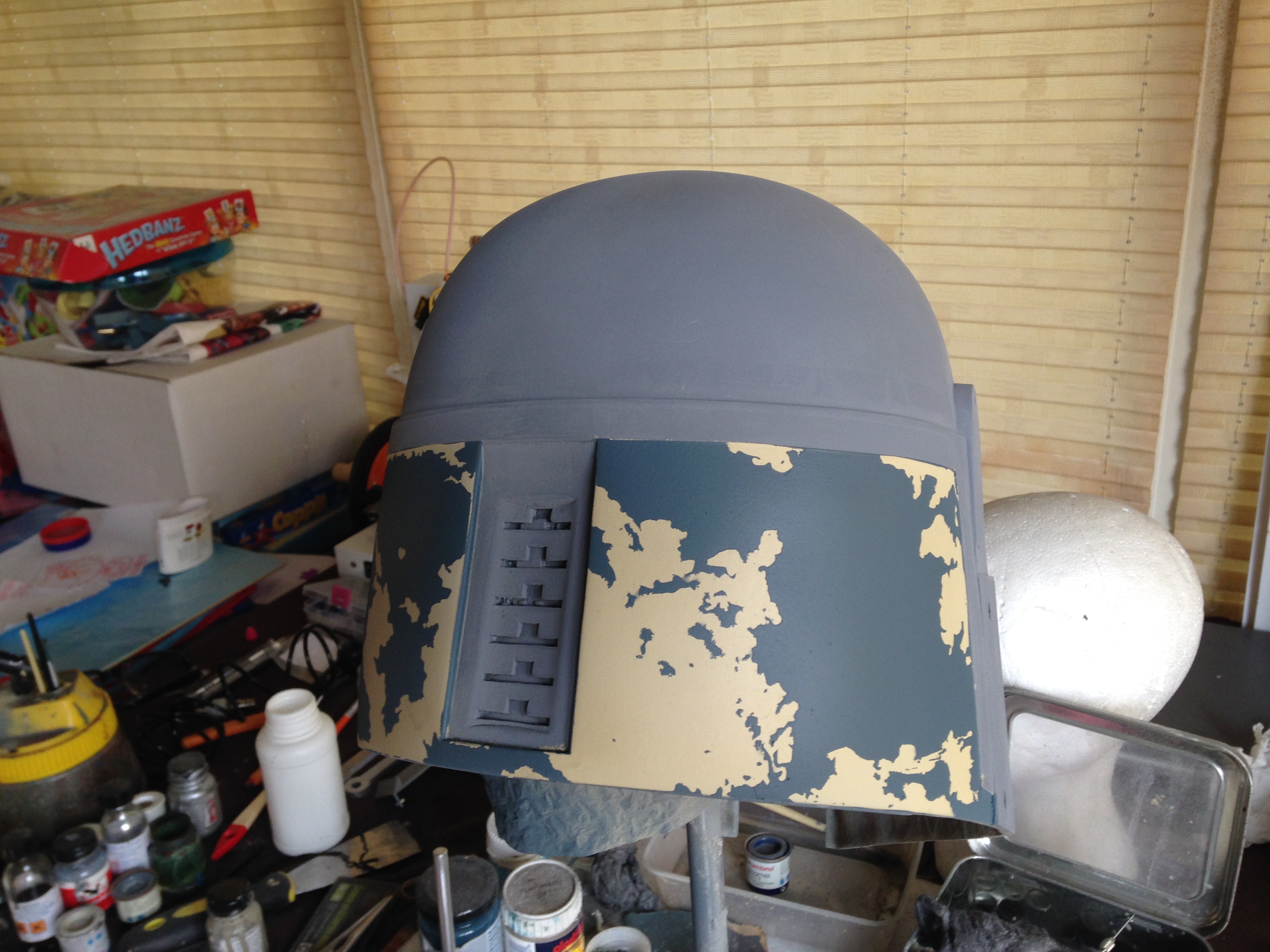

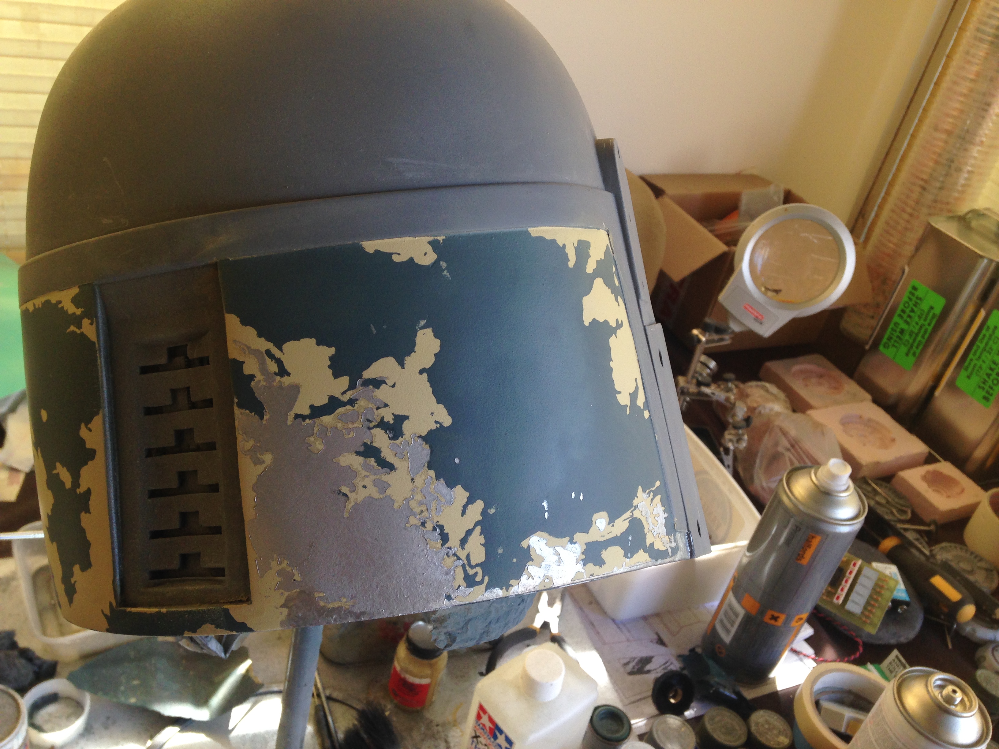

Well its been on the cards for a while so I've decided to take the plunge!, I started painting my FPH2, but disaster struck so this is my eight attempt or seventh can't remember now, but Im finally happy with my colors on the back panels,
I used floquil Concrete dusted with humbrol 103 for the creamy color, then using my craft robo I transferred Richy D's templates into silouttes and made stencils, for the greeny blue I used the recommended green 76 and blue 96 but then changed to cockpit green and blue 96 which gives it a nice color I think!, Once dry a nice rub down to blend them in, now for all the detail, GULP!any way Ill keep you posted hopefully this will go ok ....its quite nerve racking!

Thx for the comments and its lucky I mixed a big batch, as Im starting again thats twice today, I cant seem to do what I think looks acceptable theres just something not right and its bugging me so back to the cream!!!!

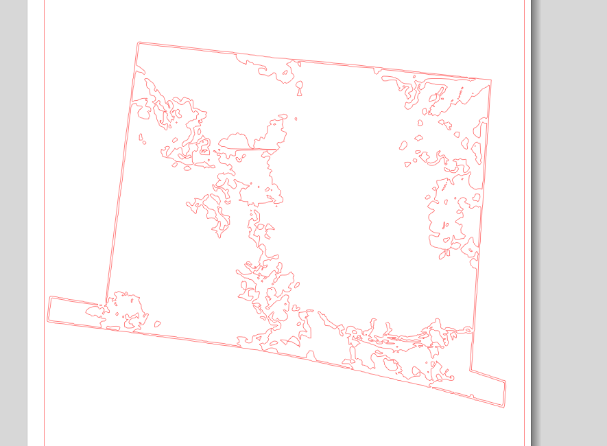

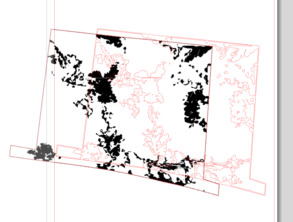

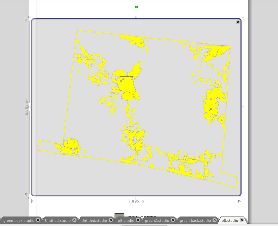

Hey I'm using masking film 8.5 inches wide so about as wide as a4 on a 5 meter role i just cut the length required, then I exract a page from either Rafal or Rich D's excellent templates then using silhouette i trace the image I need and then adjust the size to fit(which is never right!!!) then send to my craft robo and hey presto, Ive just finished my 12th attempt at the back using Rafal's temps this time,

ah thanks, I just ordered a 10 yard roll of masking for my plotter. I am cutting test pieces right now out of vinyl, just to see how it all will work. the problem I am running into is deciding what order the color layers should be done :)
are you creating negatives to make stencils at all, or are you just masking?
dansam
I had the same problem .....the order I do it in is the cream first, mask off then apply the greeny blue, then stencil the silver, then stencil the reefer grey then finally the base grey then use rubbing compound to blend everything, I use them as stencils the only thing I mask is at the start and thats the cream.

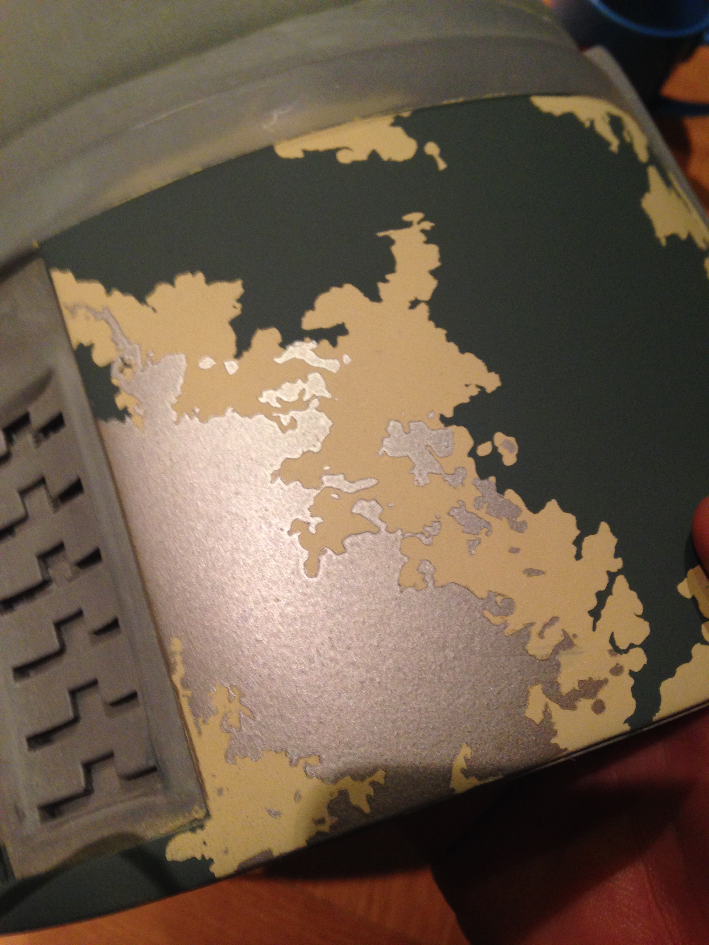

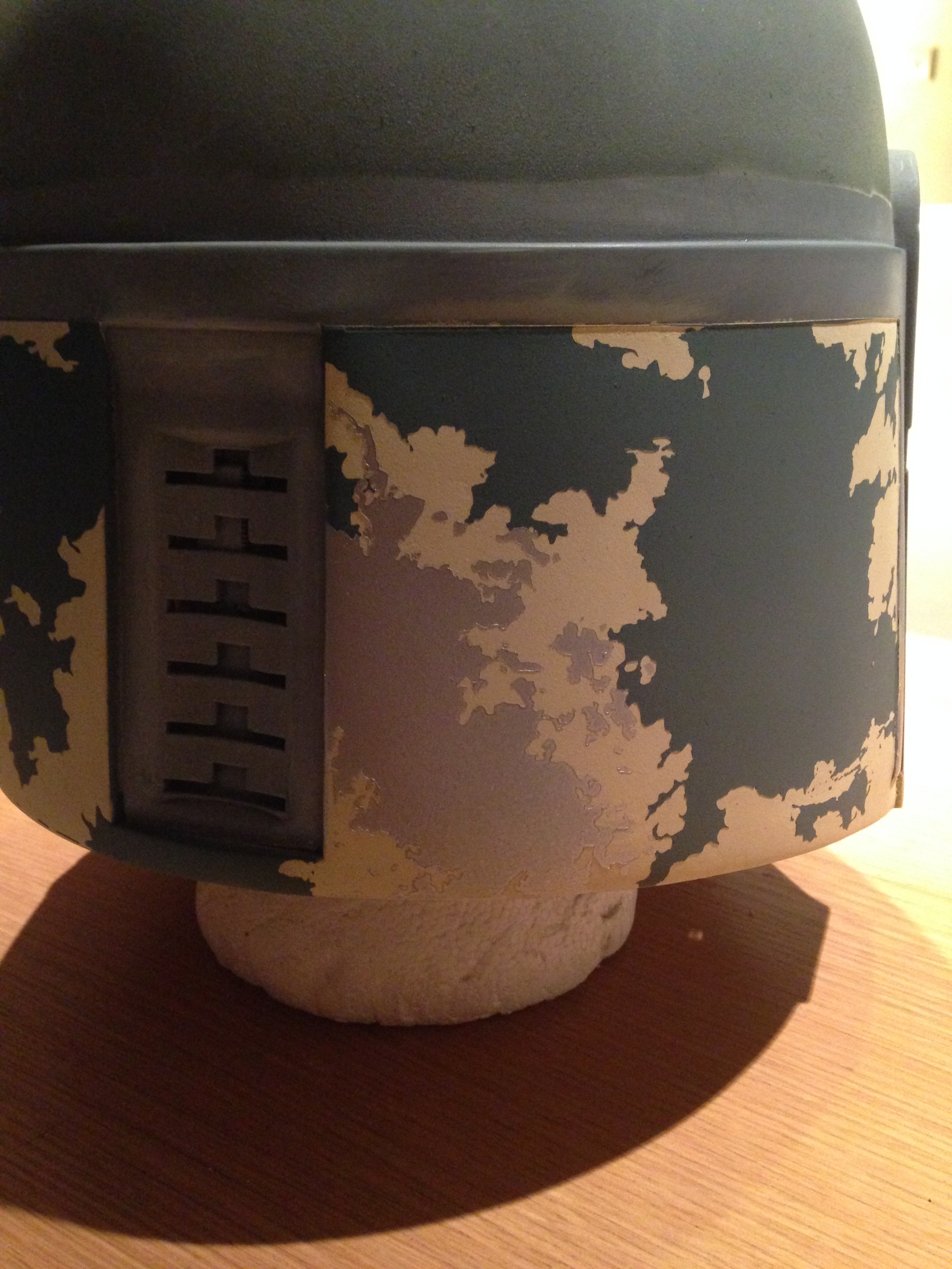

Hey everyone thx for the comments, Ive been away for a week having a break with the family now back to business, ok so Im onto the silver now, because I'm doing this topically I've thinned the silver humbrol 11 down a lot, you find that the metallic floats to the edges giving it a bit of depth, so I stenciled the large silver area now I am going to do the grey areas then come back to the silver so Im gonna use the polyscale reefer grey, just got to get the stencils arranged and cut!
