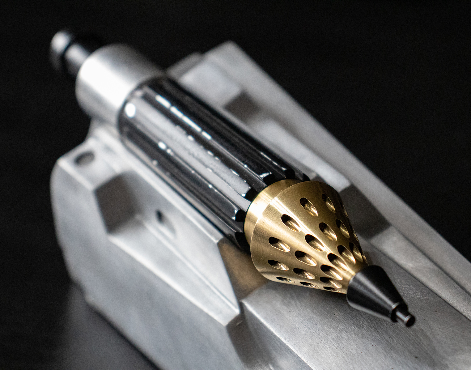

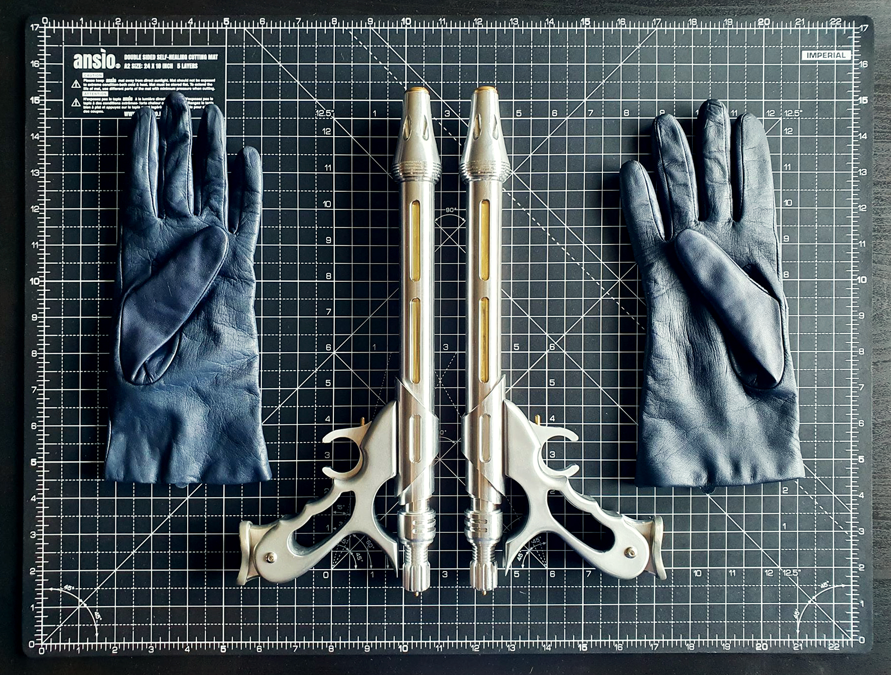

Blasters x2 from Dark Energy Creations
Finished up and ready to go. Made from Aluminium, brass, pewter and cast plastic (painted with Alclad 2 lacquer). Triggers work red LEDs in the flash hiders. Full build video over on YouTube. These took me far to long to finish!

My DEC blasters and gloves. They are Fownes (womens) navy lambskin in an XXXL (9). I would say if you have medium to large hands as a man, they should fit ok :)
To get a better fit with the gloves, remember that leather can stretch. Heat them up with a hair dryer, but not too hot, because you're going to need to pull them on your hands to stretch them and you don't want to accidentally burn yourself. Flex your hands, make fists, etc until the leather cools to skin temperature, they should be fitted for you at that point, and shouldn't shrink after that, unless you get them wet.
Awesome tip thank you!!

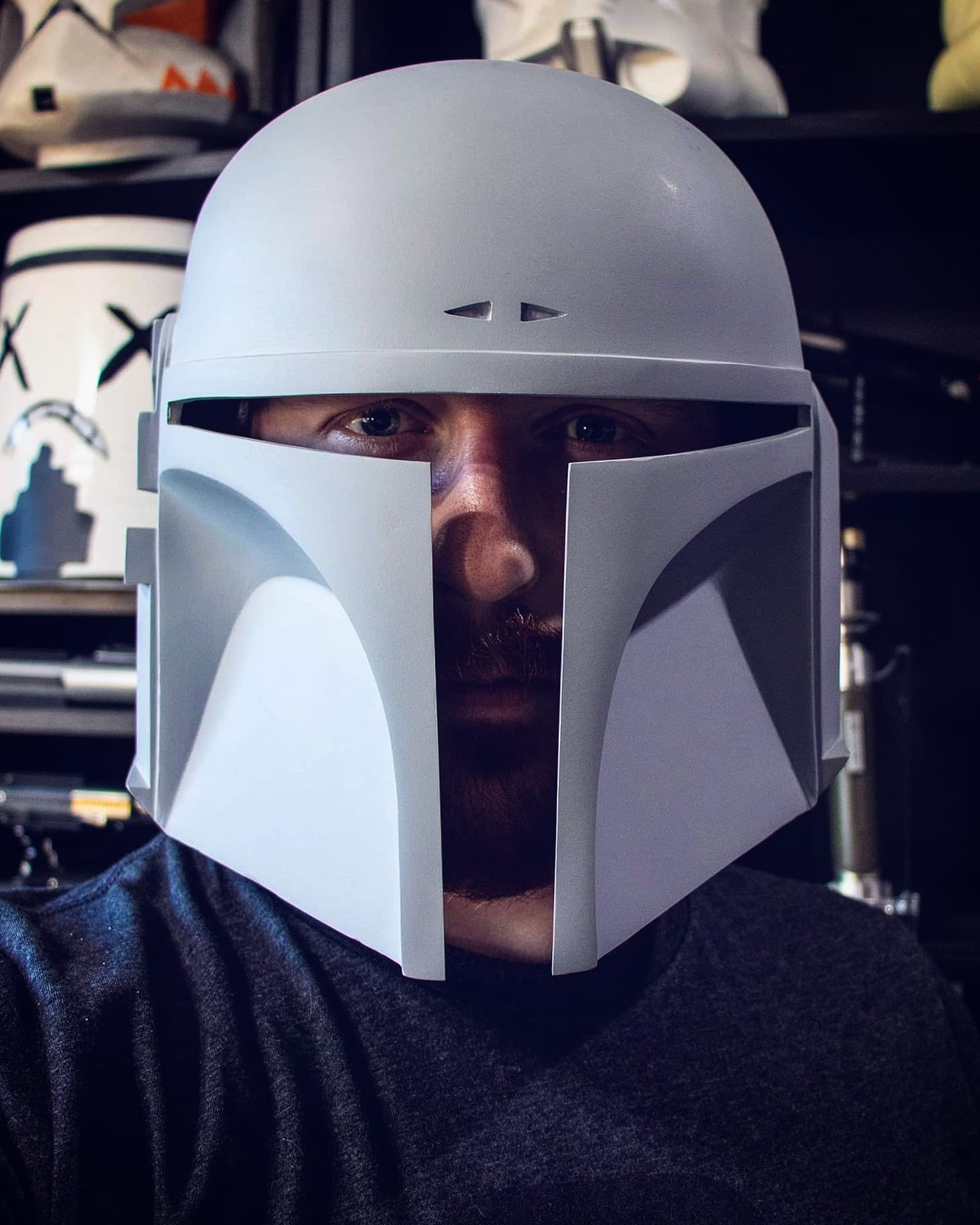

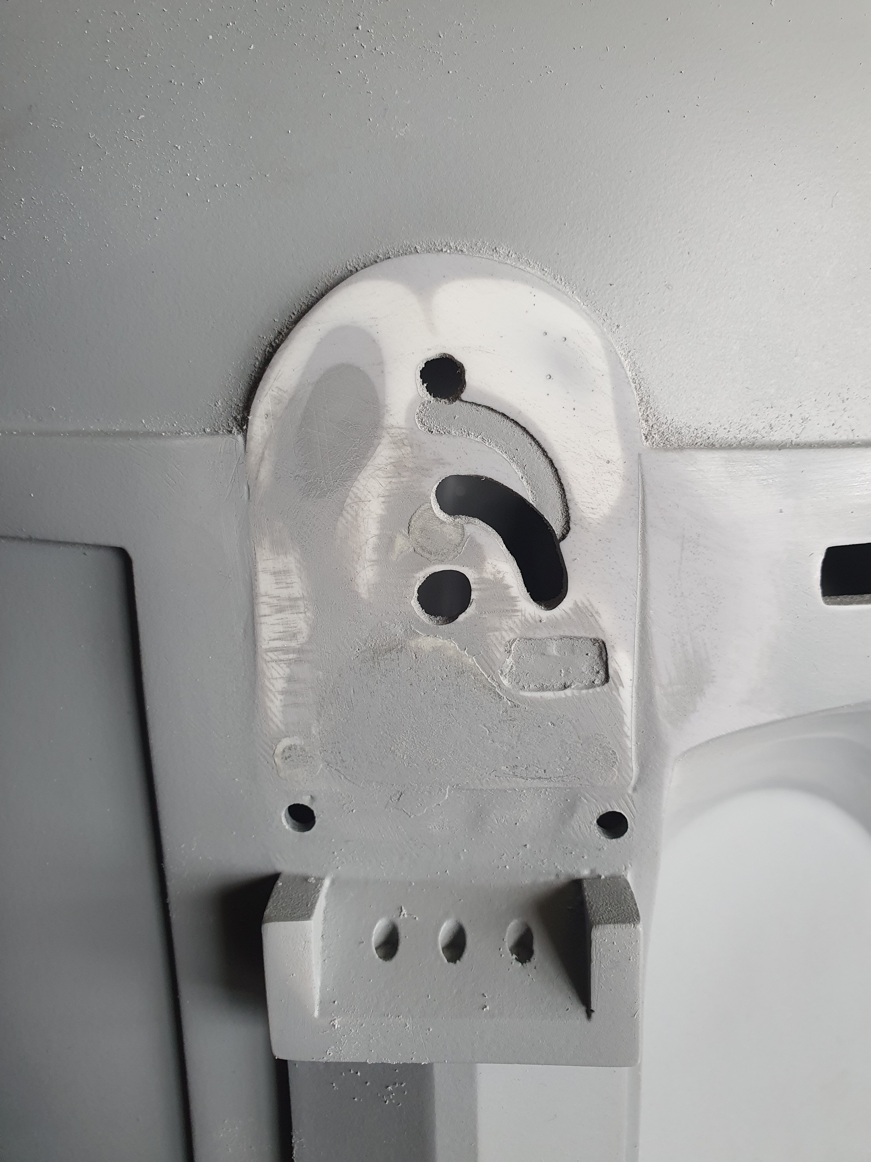

The helmet kit as I received it. Pretty good cast and trimmed out. A few issues to sort out, including the slight warp at the front, pretty easy. Less easy is fixing the right ear which is cast in.

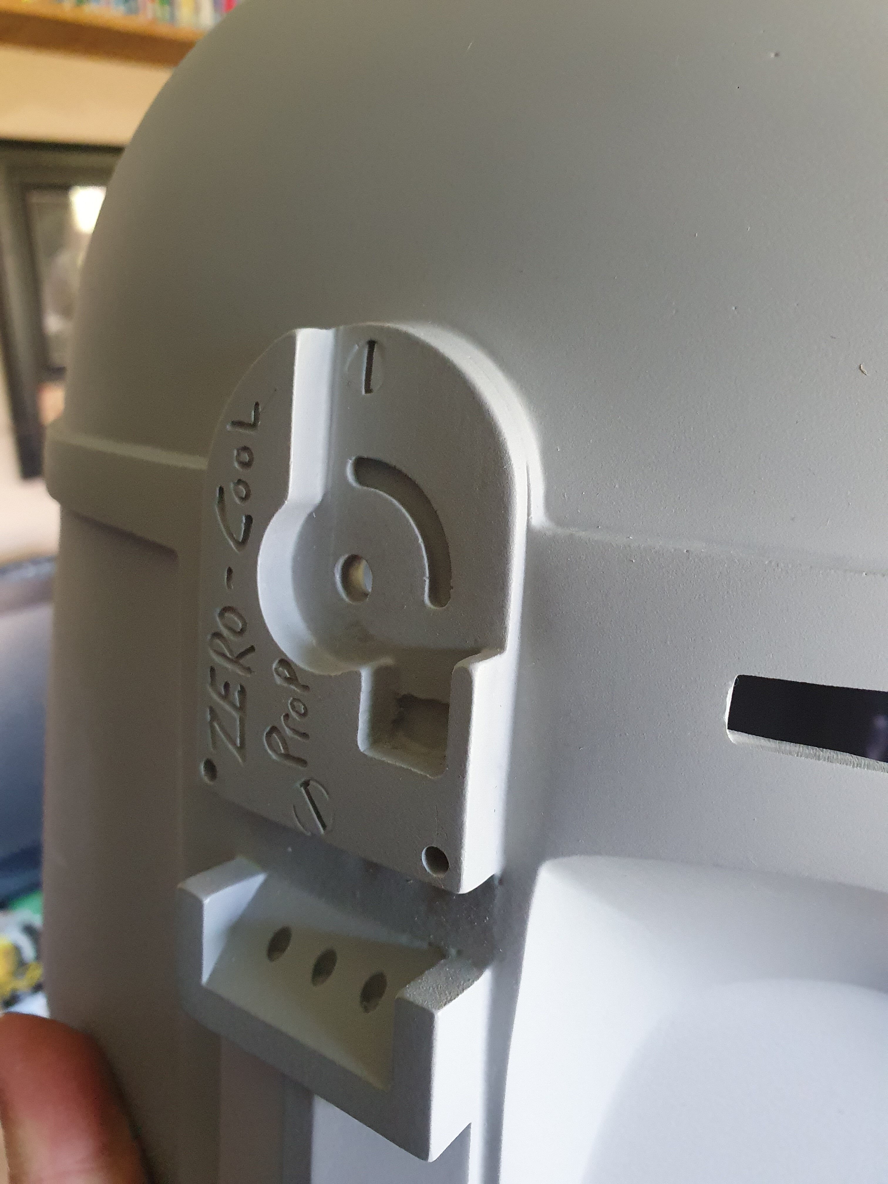

But! allows me to upgrade my helmet
First step, grinding it off, filling the gaps with Apoxie sculpt and then remaking the holes. A little rough but will be covered up
