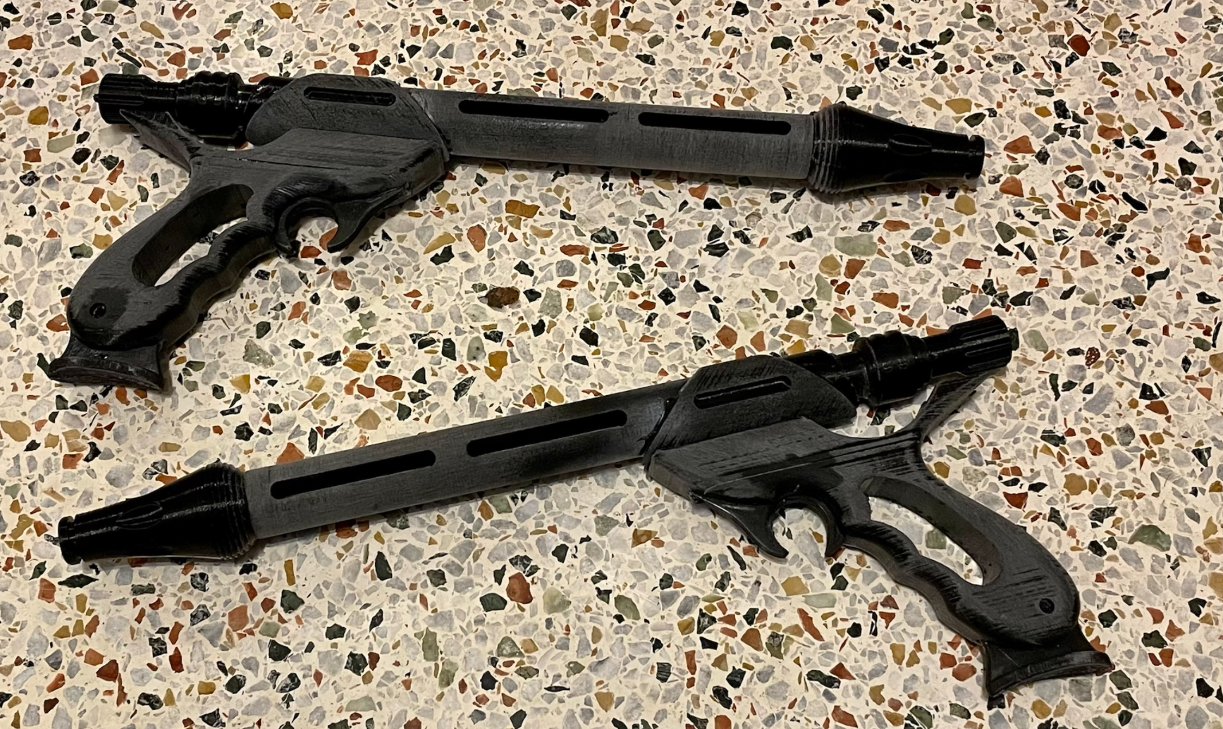

Well the weather started to cooperate until it didn't. Paint definitely smudged when reassembling the different parts, but plan to add some weathering around the rougher areas and I realized after I glued the triggers in that they are suppose to be chrome. But I say for a knock around pair of blasters, these will work just fine!
One day I may look for a full metal set for special occasions.

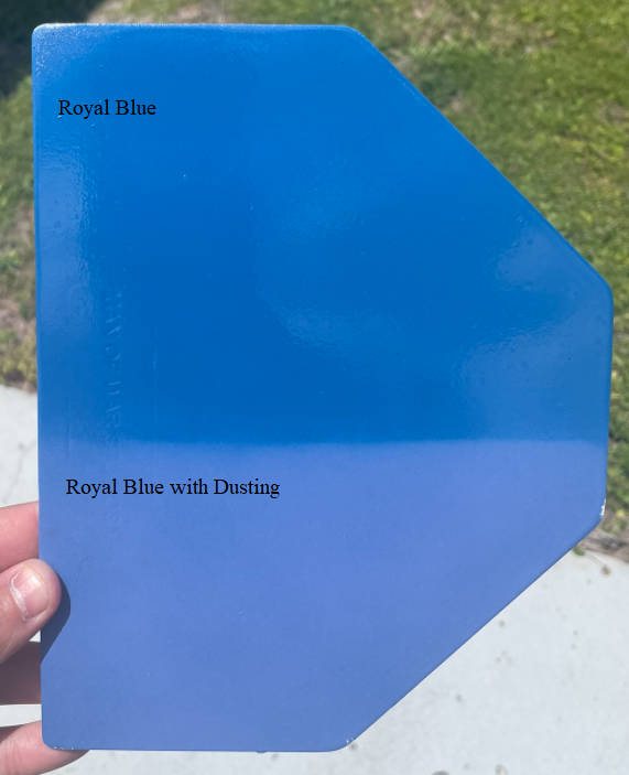

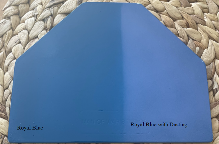

Almost done painting the jetpack, but curious what to do about the blue color. Based on an older thread, it should be a base coat of the Royal Blue and a dusting of the Blue Hyancinth and a dusting of a Purple, which I do not have the Purple on hand.
I used the detachable back piece to show the difference in the Royal Blue and a Royal Blue with a dusting of Blue Hyacinth. Any thoughts on which should be the color I go with? Just Royal or Royal with dusting?

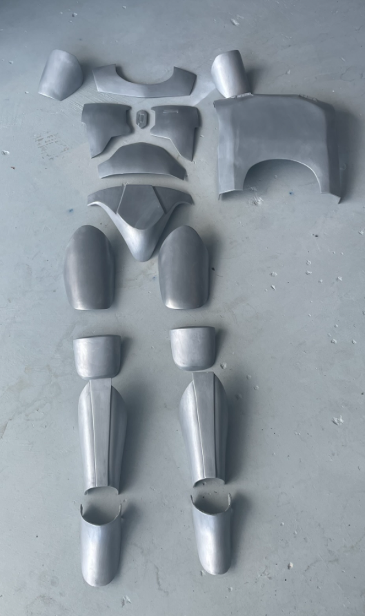

Unplanned update, but I was tired of looking at the armor in the box so decided to give myself carpal tunnel and sand and polish up all the cold cast. Lighting is pretty bad in my garage so the shine doesn't really come through, but I am super happy with the results. The cold cast really gives it a "real" weathered look.
Used a 220 grit to knock off most of the top layer and then finished up with a pretty thorough buff with steel wool and then mothers mag and aluminum polish. Word of caution, I would NOT use acetone with cold cast. Maybe that should be obvious, but I am so use to use it as a cleaner on metals. It almost put a pretty good stain on my cod piece.

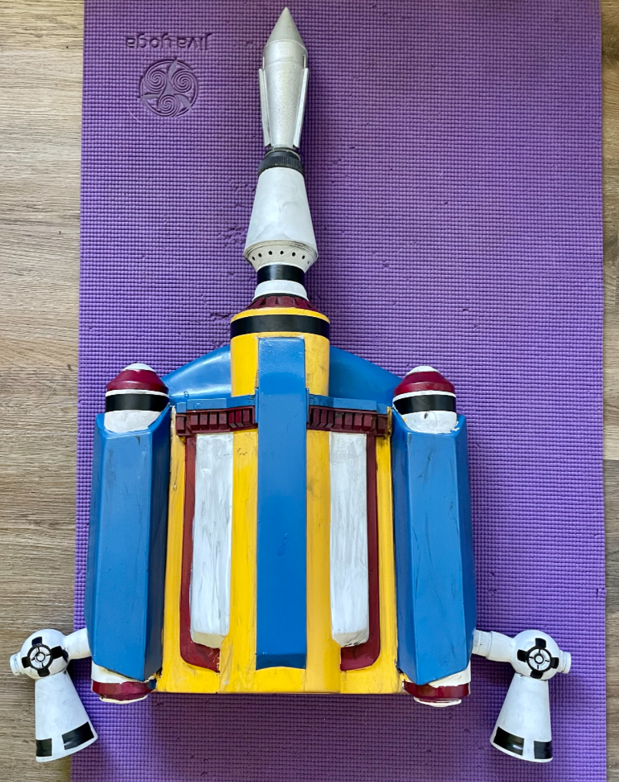

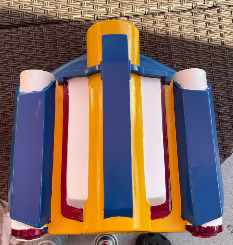

Jetpack definitely needs a few touch ups here and there, but honestly this was my most feared part of the whole build. I consider myself a VERY below average painter/taper/whatever you want to call it. Followed the SaxeCoburg thread (huge shoutout!). Started with white, then yellow, then red, the blue. Lots and lot of tape and patience and a bit over a week for that enamel paint to dry, I am beyond happy with this result. Will let it dry all over for a few days after the touchups and then hit it heavy with the weathering. Ordered some decals from Lucky and have the other small bits painted as well and will assemble once its clear coated. BIG step done in my book!
Did some light weathering, will get back to it once the decals arrive. Going to add magnets to keep the rocket attached to the base and attach the thrusters through pvc.

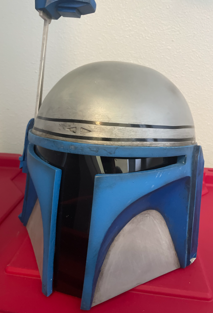

Small update for the weathered helmet, used the same technique as the armor. Watered down black and raw umber acrylics and dabbed into corners then dabbed dry with a paper towel. Used steel wool to knock down any spots that were too dark. I may go heavier with the bucket and armor later on, but for starters gonna keep it a more subtle weathering. Pictures hard to do it justice as well.

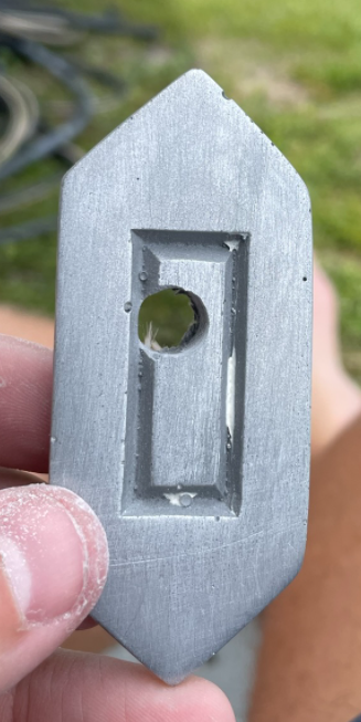

Good news always comes with some bad though. As I was dremeling the back of the center piece to get the snaps to sit more flush, I poked a hole straight through the front. Will have to source a new one, but if that's the worst mistake of this build then I will be a happy camper.

You could fix up that center piece and the repair wouldn’t be noticeable.
Just mix up some 5 min epoxy, tape off the area that needs to be filled and fill from the back. You will probably need to sand a little to get it flat and then hit the center rectangle with rub n buff. No one will ever see the repair but you, and only if you look close.
Yah pretty easy fix, but Dave at DC Props was awesome and is sending me some hoses for the gauntlets and said he would go ahead and include a new center piece as well. I'll definitely hold on to it with the mistake just as a good luck charm!

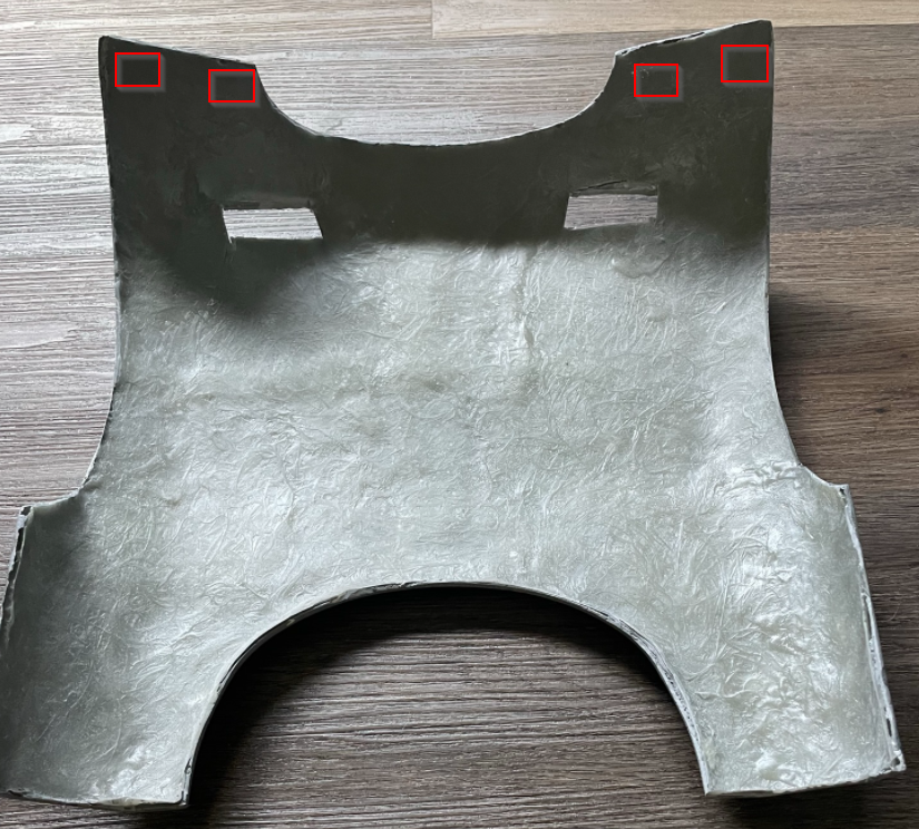

Question for the Jangos out there, do you all just do two snaps or rivets or whatever you use per side on the top of the back plate near the shoulder? Before I punch the holes I was hoping to get some clarification on what's "standard". The armor and shoulders are all secured down in pretty much every corner, but wasn't sure what worked best for the back plate and I assume it needs to come on and off when suiting up and desuiting to get the jetpack situated. Also seems like attaching near the shoulders and letting it hang more or less seemed good enough.
If you all add anything outside where the picture in marked feel free to chime in. Thanks!
Cruzer used a hook and eye set like this (https://www.amazon.com/Kenkio-Sewing-Closure-Trousers-Silver/dp/B07CKHTJH8) at each of the 4 locations you marked. Hook on the back plate and eye on the vest. In-between the locations you marked he used another single button snap.
