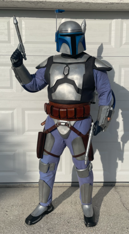

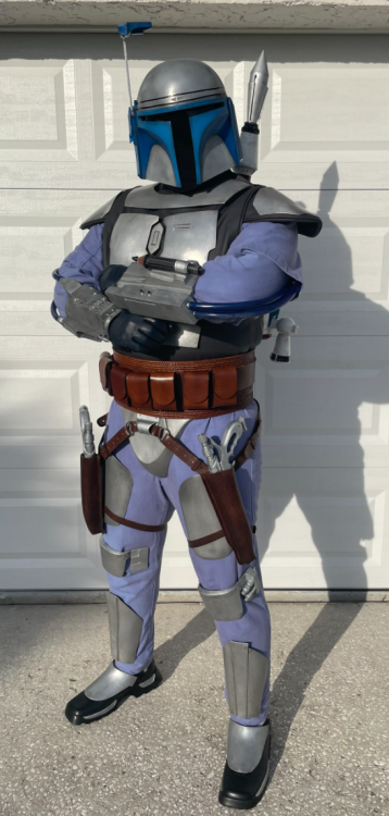

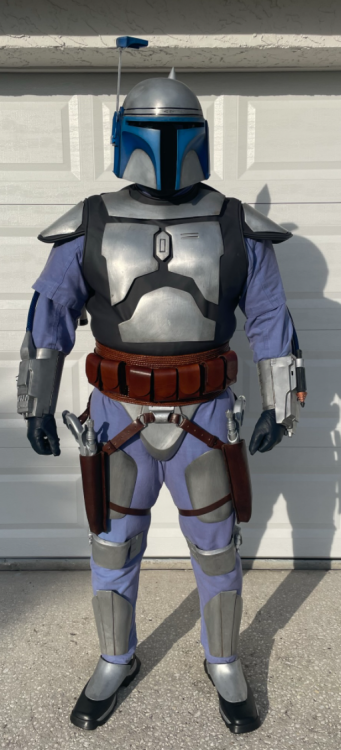

So here is the final result and I gotta say I am very happy with the end result. It still actually comes across a bit darker in pictures, but I think it looks spot on to a lot of reference shots.

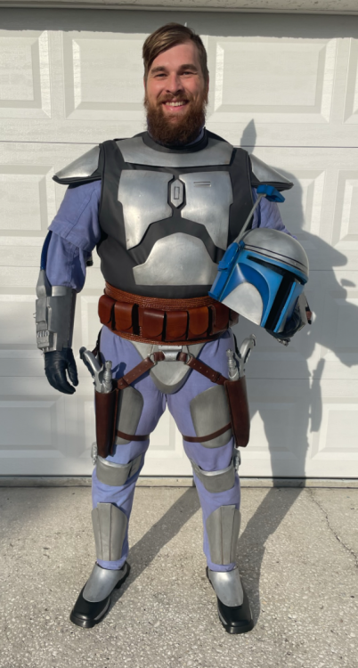

I am approved! Since I am a retired member I do have to attend a troop to reactivate my status, which should be in just a couple weeks at Fanboy Orlando, but the costume is DONE! Of course as we all know any costume is never officially done, I am sure I will make some tweaks here and there after wearing it for a few hours.
Thanks to everyone who helped along the way. This costume is going to be around for a long long time! Can't wait to start trooping after all these years!
