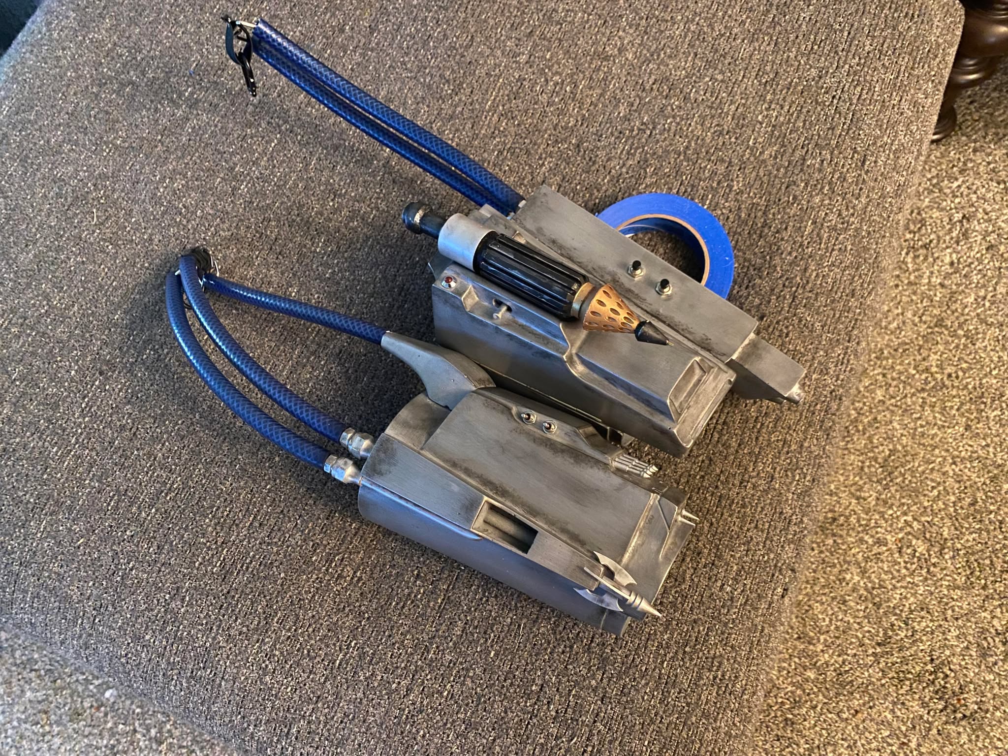

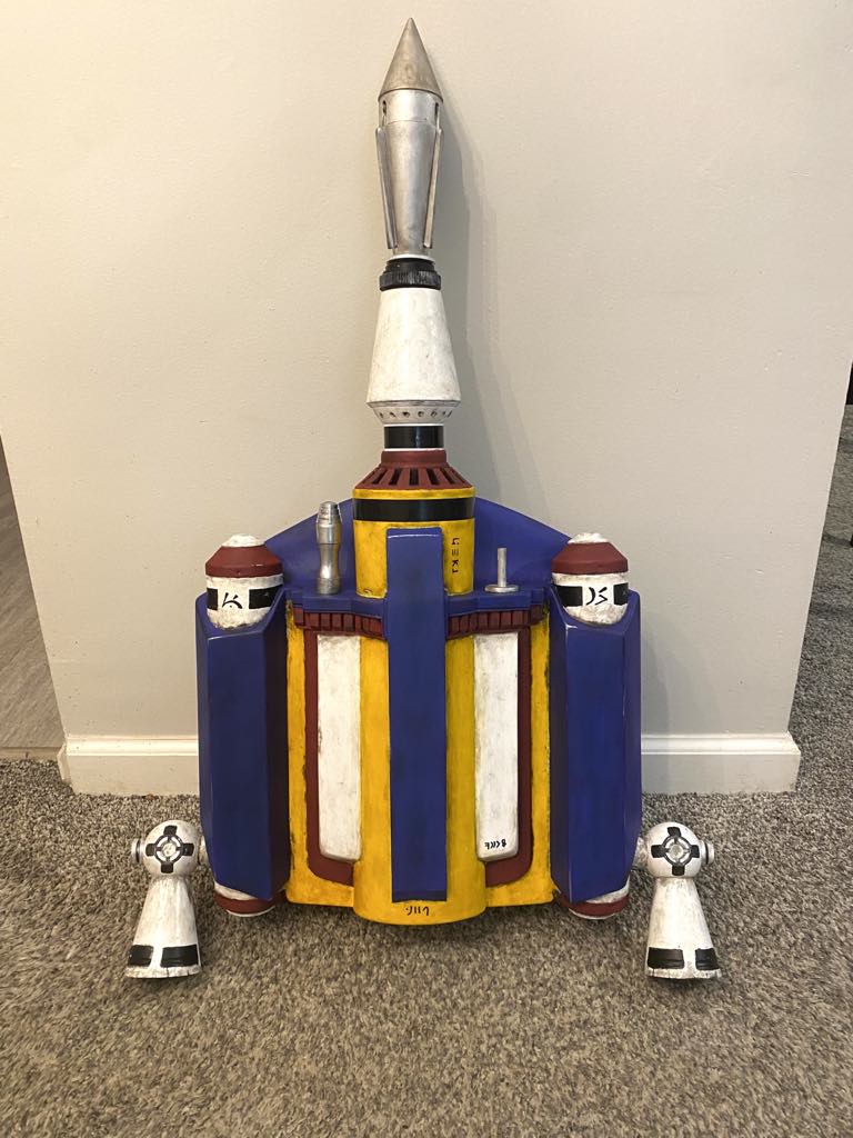

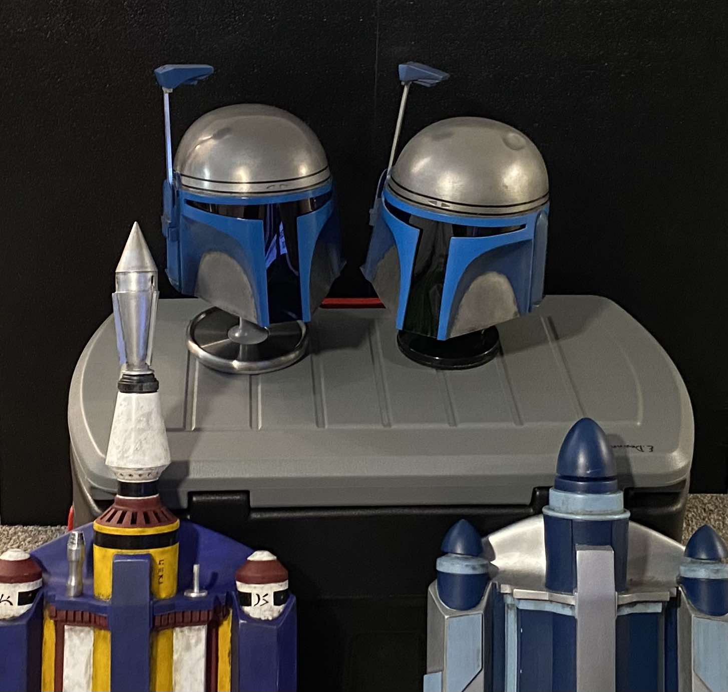

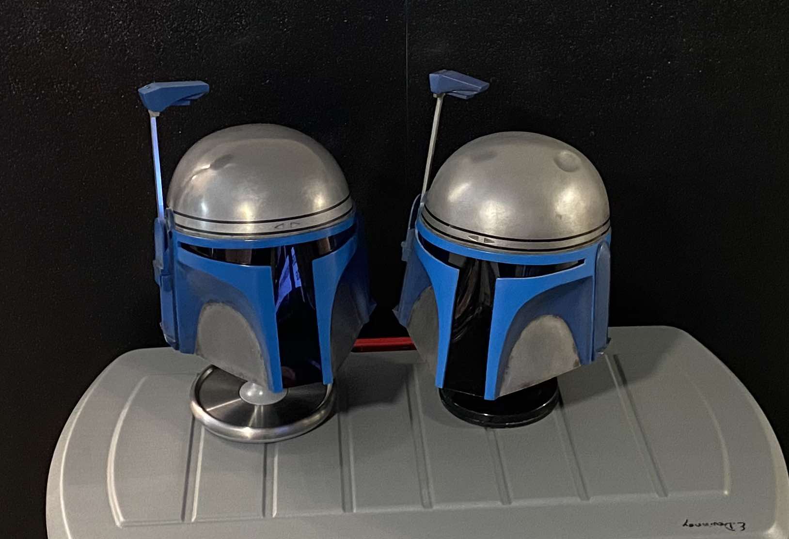

Sometimes I like the Kamino look more, and sometimes I prefer the Geonosis look. Sometimes I prefer a dent and sometimes I want a clean look. I understand that the paint jobs on the two helmets are very different - need to lighten up the visor on the non-dented helmet - but it's nice to have options!
Denuo Novo helmet (left) and Cruzer's helmet (right). Both jetpacks by MoW Studios. The kamino jetpack was painted by myself entirely by hand using acrylic paints and Rub'n Buff (no spray paints or airbrush). The geonosis pack was painted by Christian.
Wow. That MOW jet pack is killer. Looks so clean. You have the dream set up. Really really great job!
I’m not the biggest kamino guy but I personally hate the dented helmet. Cruzer, minute, wasted, and boba maker make great helmets. I’m not the biggest fan of the Denuo novo helmet. The stock also fixed in place is also super weird. Even tho the actual prop helmet is like that but idk small things like that bug me. They screwed a lot of people out of a lot of money.
Thank you for the kind words. Yeah I agree, I much prefer the clean look without the dent. The only reason I got a dented one was too get approved with the JT-12 jetpack with the 501st.
The Denuo Novo helmet isn't bad, but there are definitely better options for the price they were asking for it. It is pretty accurate, just needs a new paint job as their choice of shades of blue are too close to each other (the lighter blue needs to be lighter than it is) and some weathering. I got it back in 2020 and options were pretty limited at the time I was purchasing but it is a really high quality helmet in person. Just needs a little work. The rangefinder not moving is kind of a pain when traveling with it, but otherwise I prefer it in the up position.
I am currently waiting for WF to be open for commissions again to get a new dent-less helmet though.

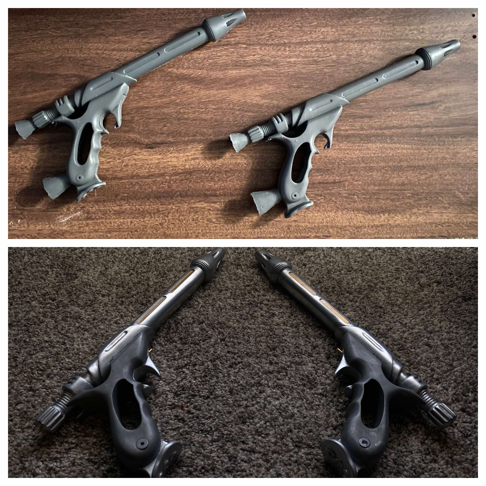

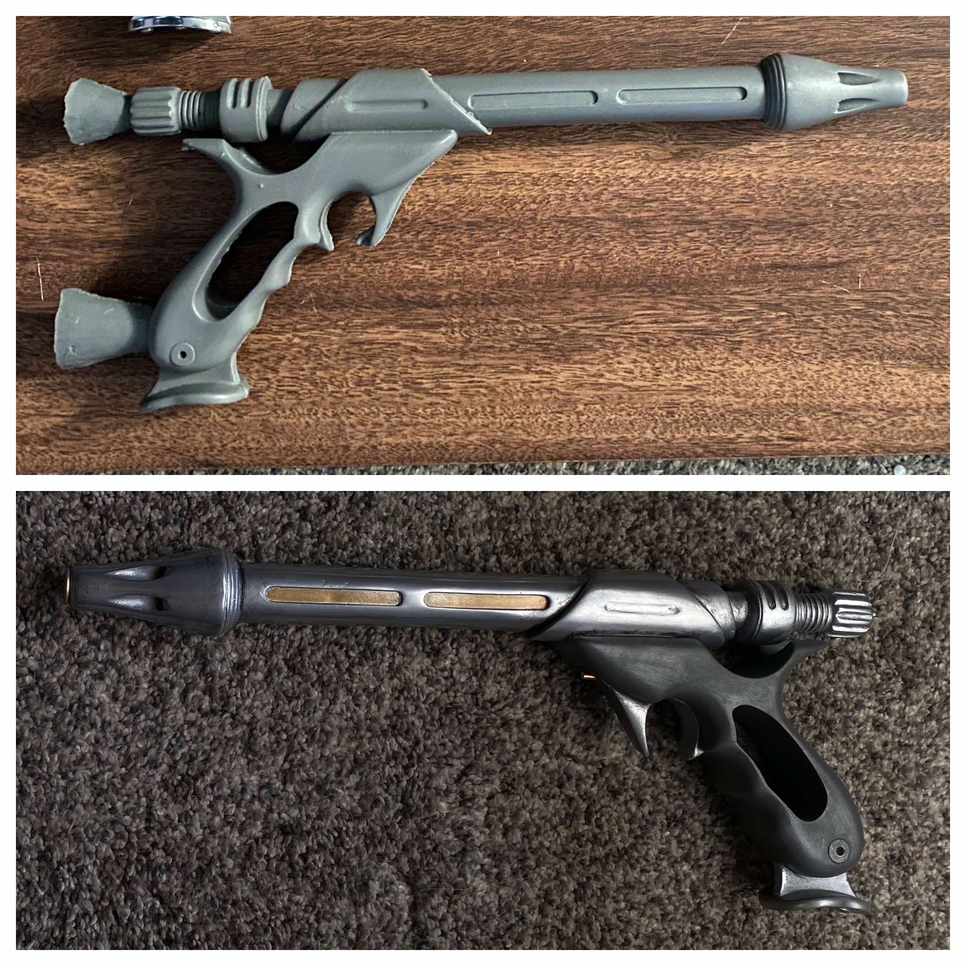

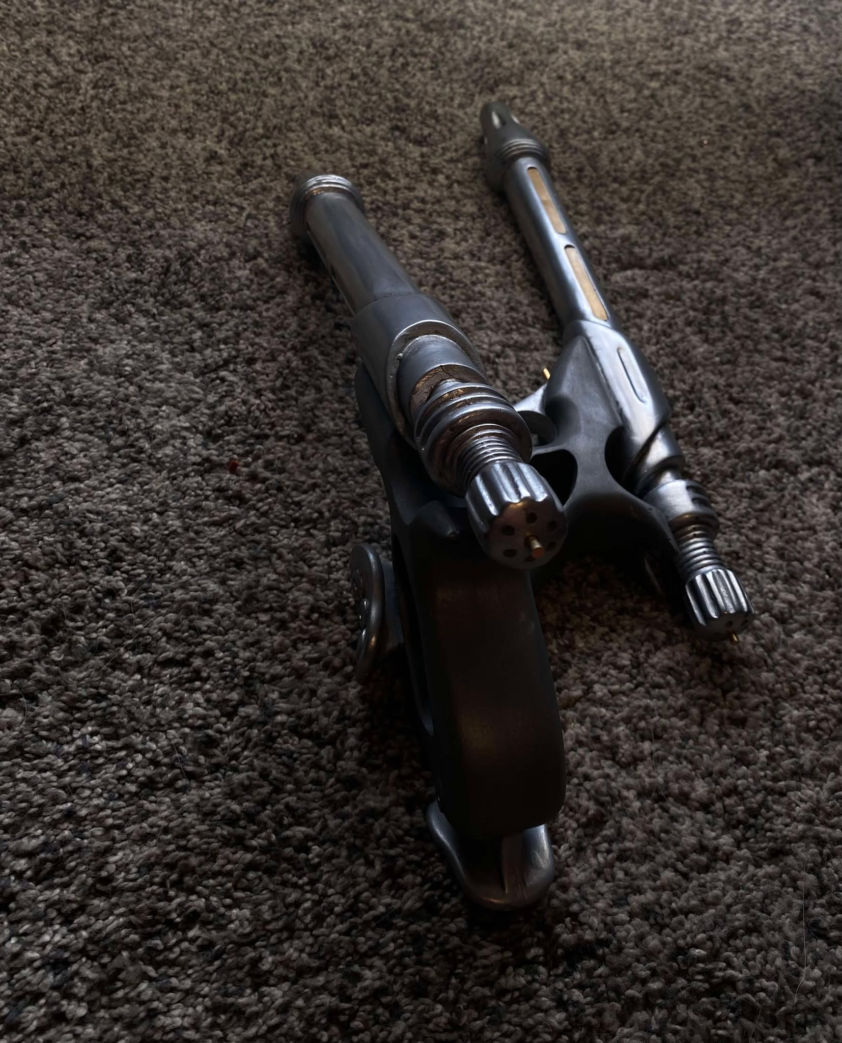

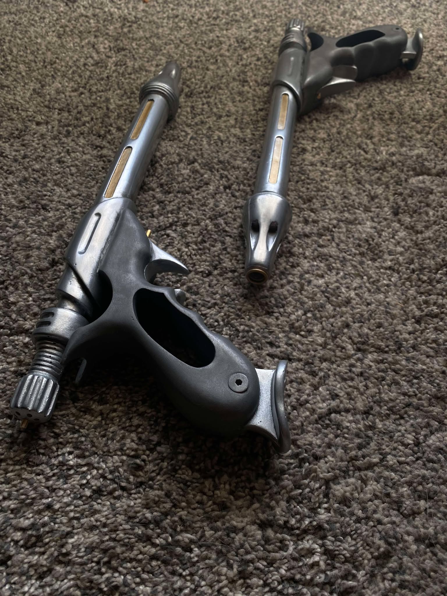

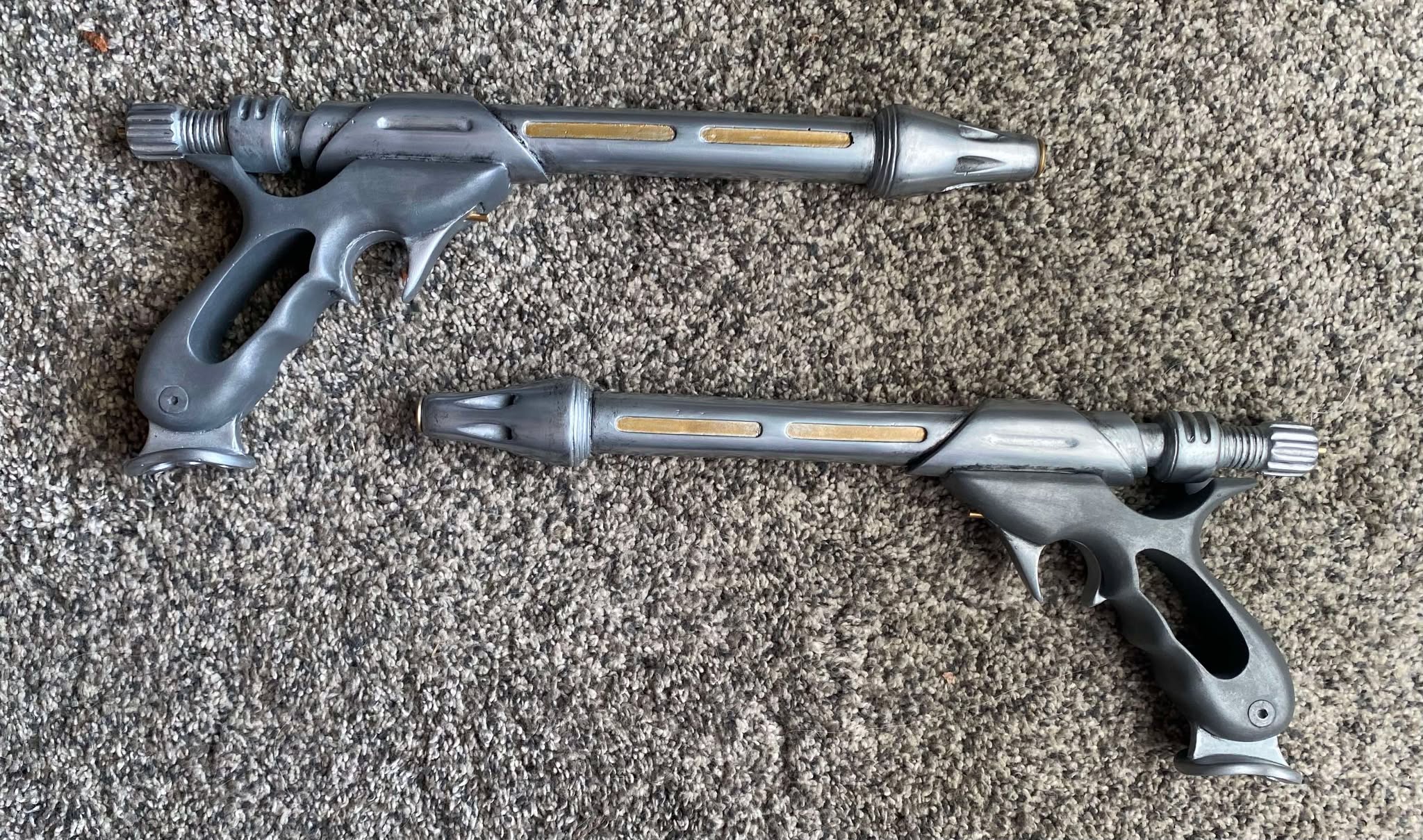

Finally worked on the resin lineage Westar-34 blasters. Almost finished with them, just need to add some metal screws in place of the resin cast mock screws and add a trigger guard on the right blaster.
I first used a dremel to remove the sprues on each blaster followed by sanding (a lot of sanding) and then painted with a gray primer. I then wet sanded with a fine grit and went over each blaster with very fine steel wool.
The grips were painted with a medium gray and all of chrome parts were done with Rub'n Buff. Lastly I drilled the 6 little holes in the "hammer" of each blaster, glued a bronze o-ring at the end of the "flash hider" and added the brass pins.

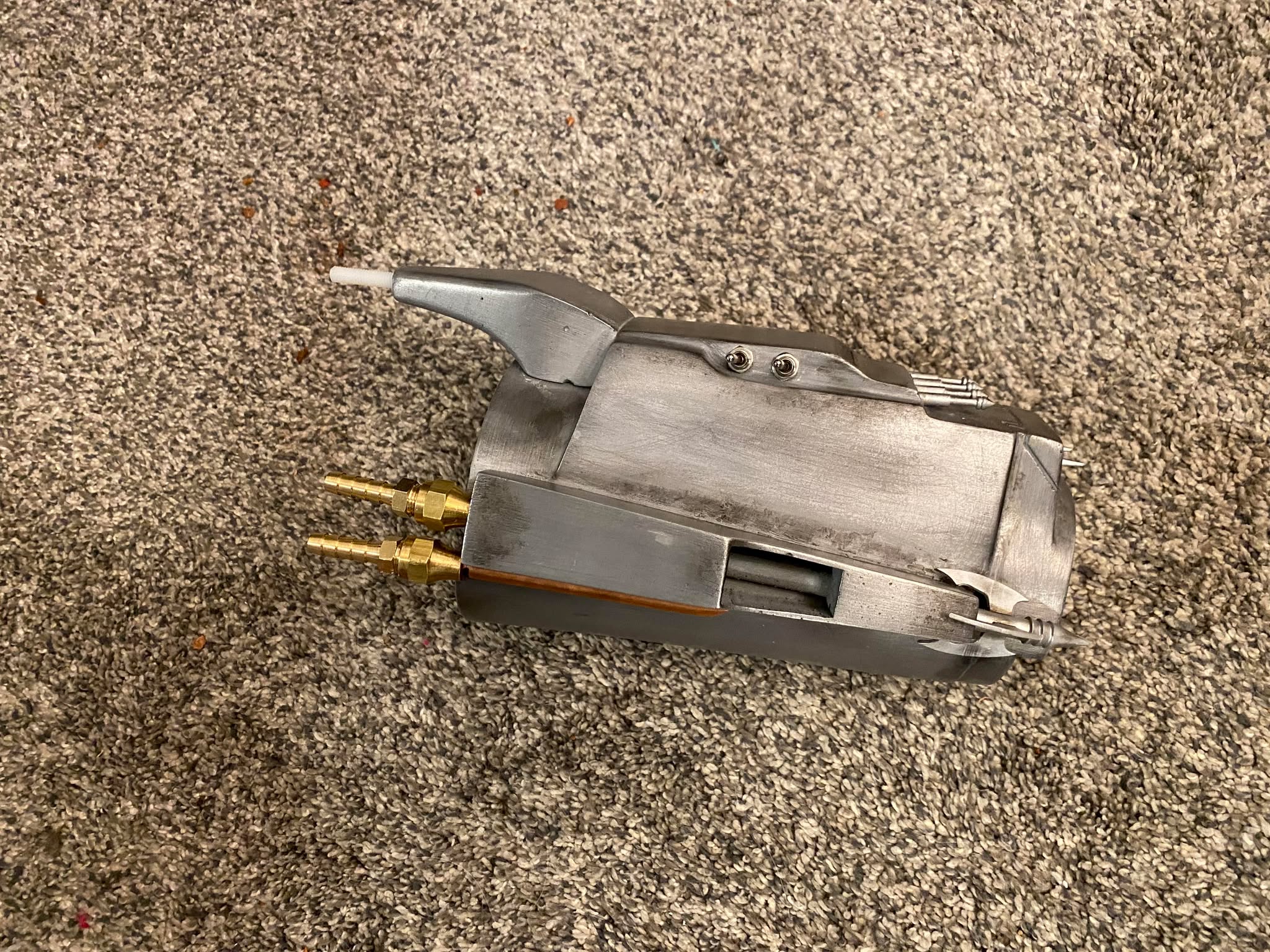

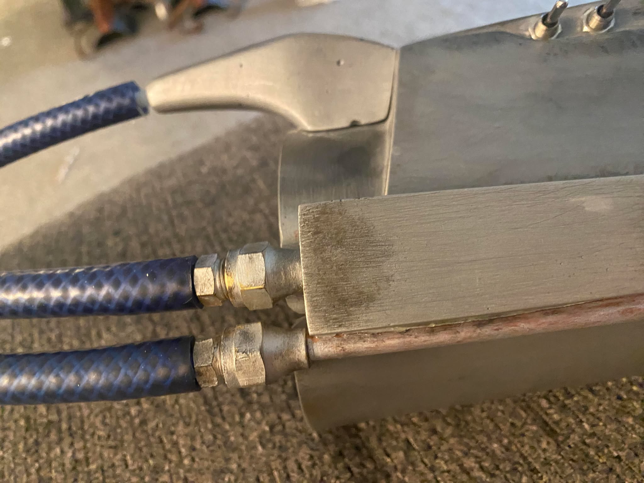

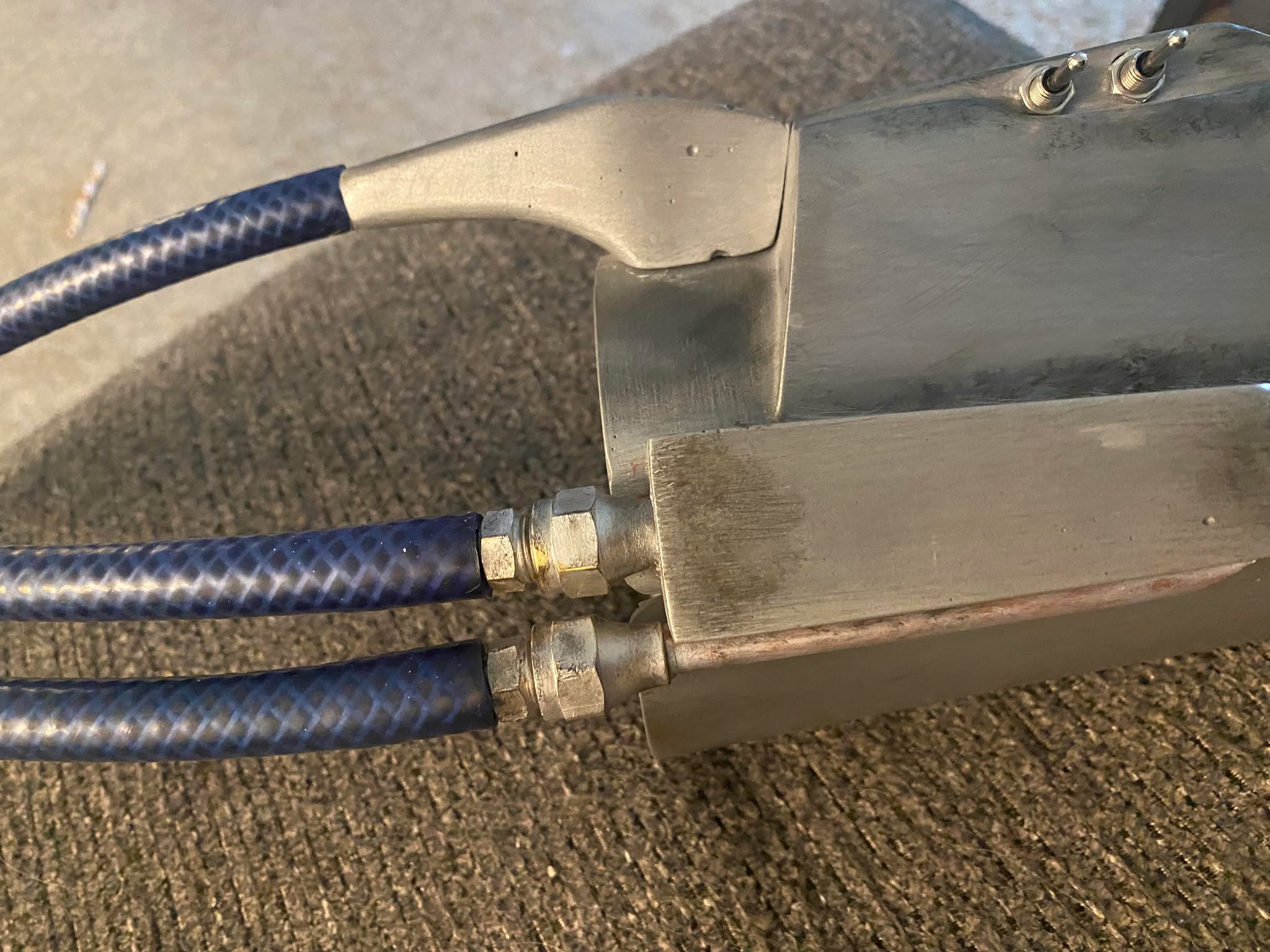

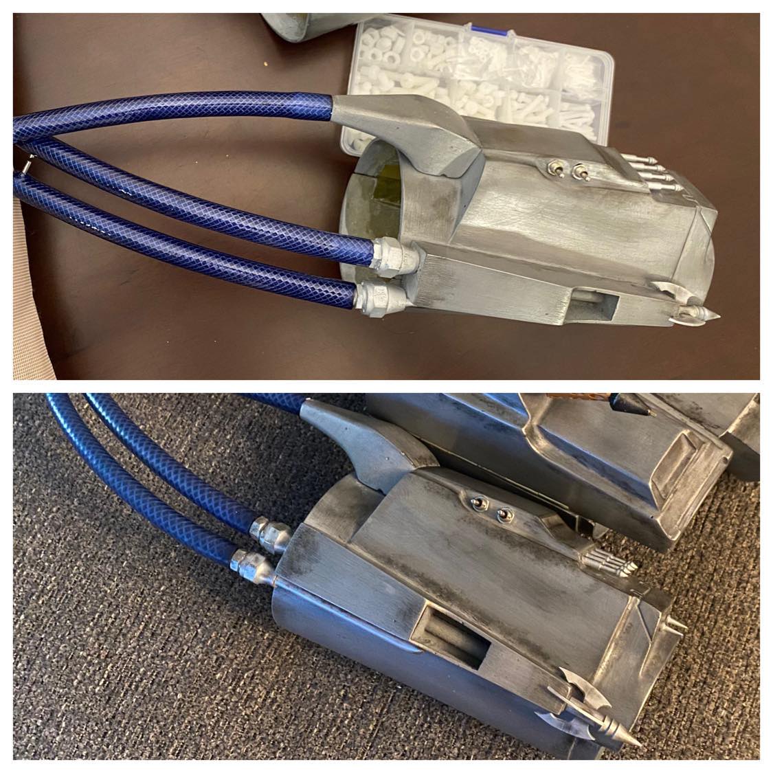

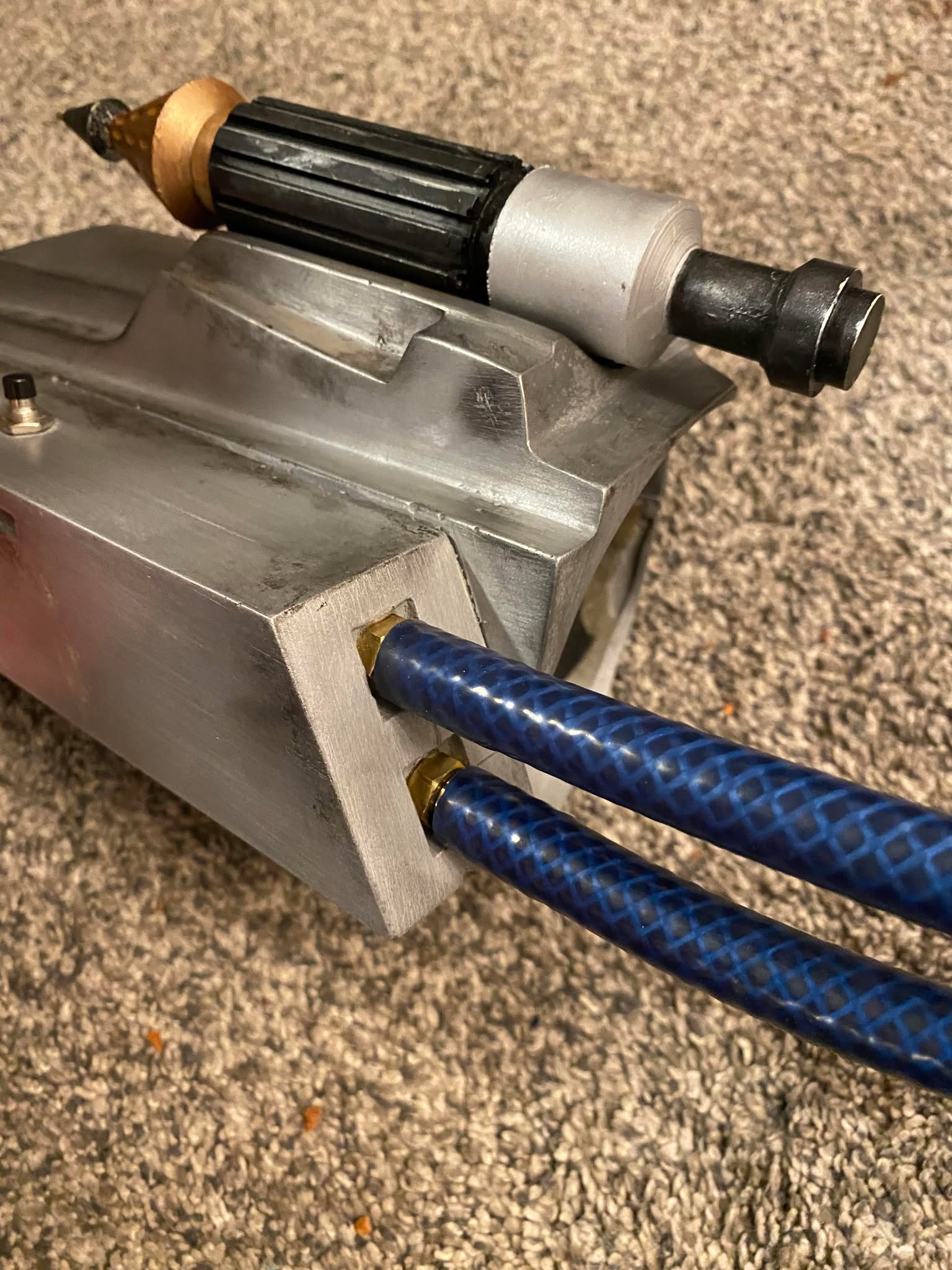

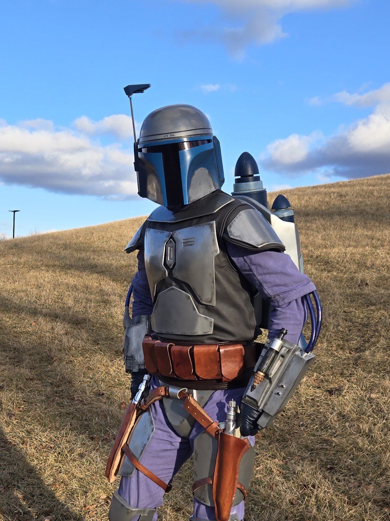

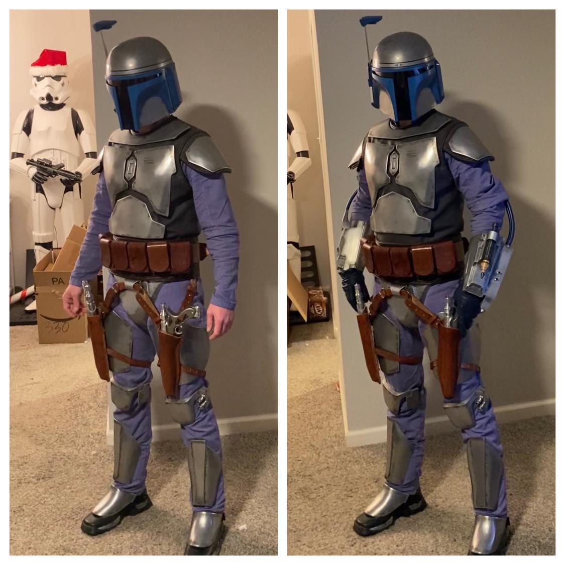

Some small updates to this build. I am currently waiting on a set of MinuteFett gauntlets, but in the meantime I have been upgrading my DC Props gauntlets (I wasn't happy with the resin cast flare nuts that were provided with the gauntlets, mostly due to them being oversized and not having the proper taper).
I ended up purchasing the accurate metal hardware (hose fittings, flare nuts and copper pipe) and attaching them to the gauntlets.
I then painted the hardware silver and applied weathering as per the reference pictures.
I did the same with the left gauntlet (minus the flare nuts) and attached my newly dyed hoses. These hoses are much more accurate and were from the same vendor that Cruzer used when selling his gauntlet kits. The hoses were dyed using his method with the old version of Rit denim blue dye (powder).
Before and after:
I also made adjustments to my armor and girth belt placement. I moved the girth belt and cod armor down a few inches to give my torso armor some more space. I think that it looks better now. Before and after:

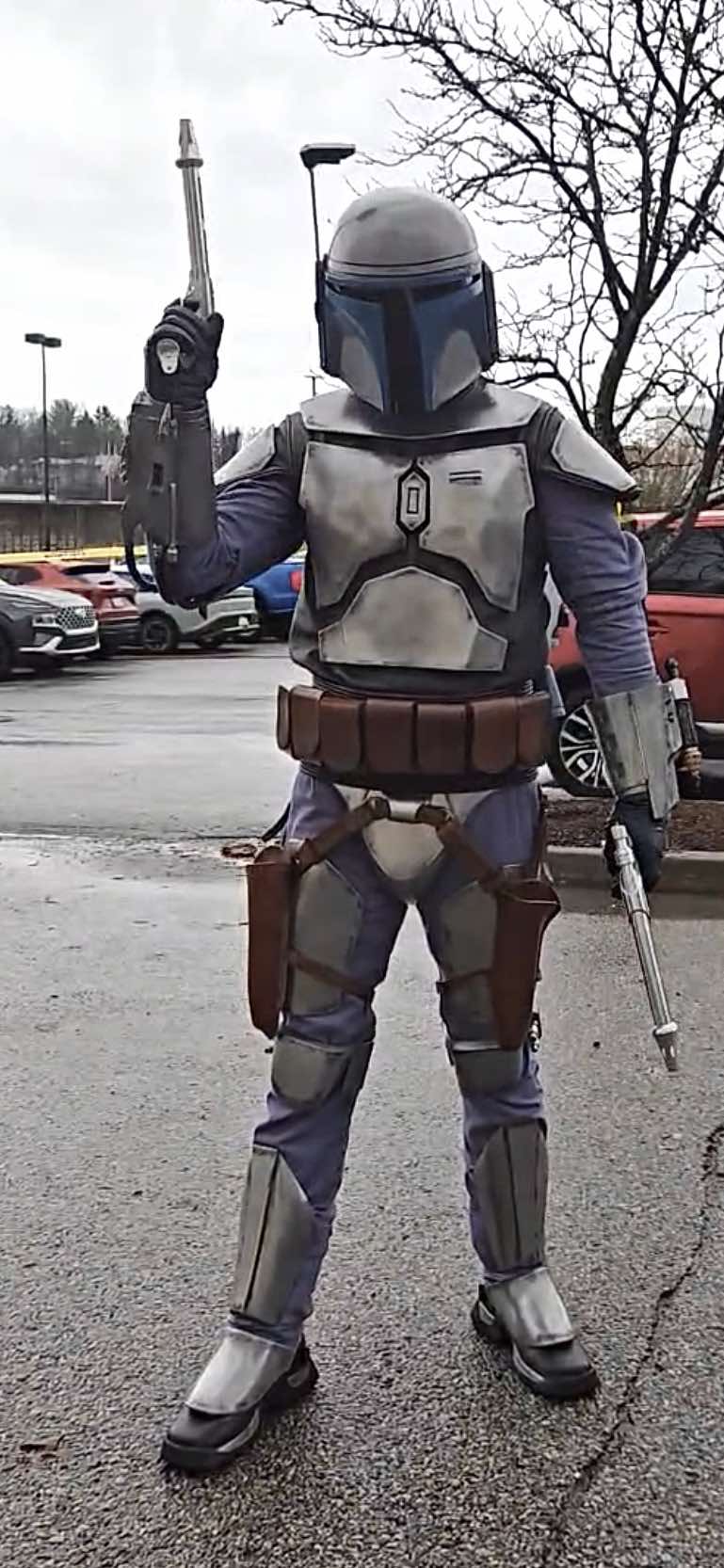

Attended Steel City Con with my Jango and made some more minor adjustments to girth belt placement and armor. I think this will be Jango's final form, at least for now. Might make some minor adjustments to the thigh armor/holster placement, but I am really happy with how everything fits now.
Wore Jango Friday and Saturday, switched to Boba on Sunday (refer to my Boba post if you're interested). Friday night we had the opportunity to stand in front of the stage while Hayden did his panel which was a cool experience. Overall, thisvwas a GREAT time! Probably the best con yet :)

Did you end up buying the DC props dented helmet too? Cruzers paint colors look more accurate but the helmet looks like it has a lot of anatomical issues. The dent looks very inaccurate. Did he say it was lineage?
Cruzers is lineage, however most of them in existence today now have anatomical issues. They suffer from the same issue that the Master Replicas boba fett helmet did since he casted them with only resin and no fiberglass. Because of this they are very prone to deforming over time, especially in warmer climates. If you look at recent pictures of Cruzer or MR boba helmets - they will usually have a really “squinty” visor. This is from setting on a shelf and the mandibles collapsing due to the pressure of the helmet on the resin.
My cruzer helmet had the same issue, and I fixed the squinty visor with a heat gun- but it’s impossible to get it back to its original lineage state. Therefore I haven't been wearing the cruzer helmet much, even with the JT-12 Jetpack. (I know, I’m breaking the rules. Literally nobody notices the missing dent anyway lol).
Also I am in the process of repainting the visor on my denuo novo helmet so that the colors are accurate. I honestly really like this helmet, it’s anatomically very good.

Honestly, I prefer the non dent as well for several reasons. I ran across a thread on some forum before with several photos from parades, promos and more about Lucas film running the non dent with the arena jet pack. Also, the Star Wars bounty hunter game shows jango use the non dented helmet with the arena jetpack.
It is safe to assume, if jango had this Jetpack, he wore it long before he got his dent on his helmet. It would be comical for someone to criticize you on it. You built that whole kit so wear it how you want cause honestly that combo looks the best lol.
As far as Cruzers helmet goes, I’ve seen people pick that thing apart not just for the visor, ears, dent but way more. Honestly, none would bother me too much except the dent not being correct. It’s even supposed to have scratches there as well.

Same, I prefer the non-dented helmet as well. Jango Fett is probably the most ridiculous 501st CRL out there simply for the fact that they added the requirement to separate dent/undented helmets with a specific jetpack. Doesn't make sense to me either.

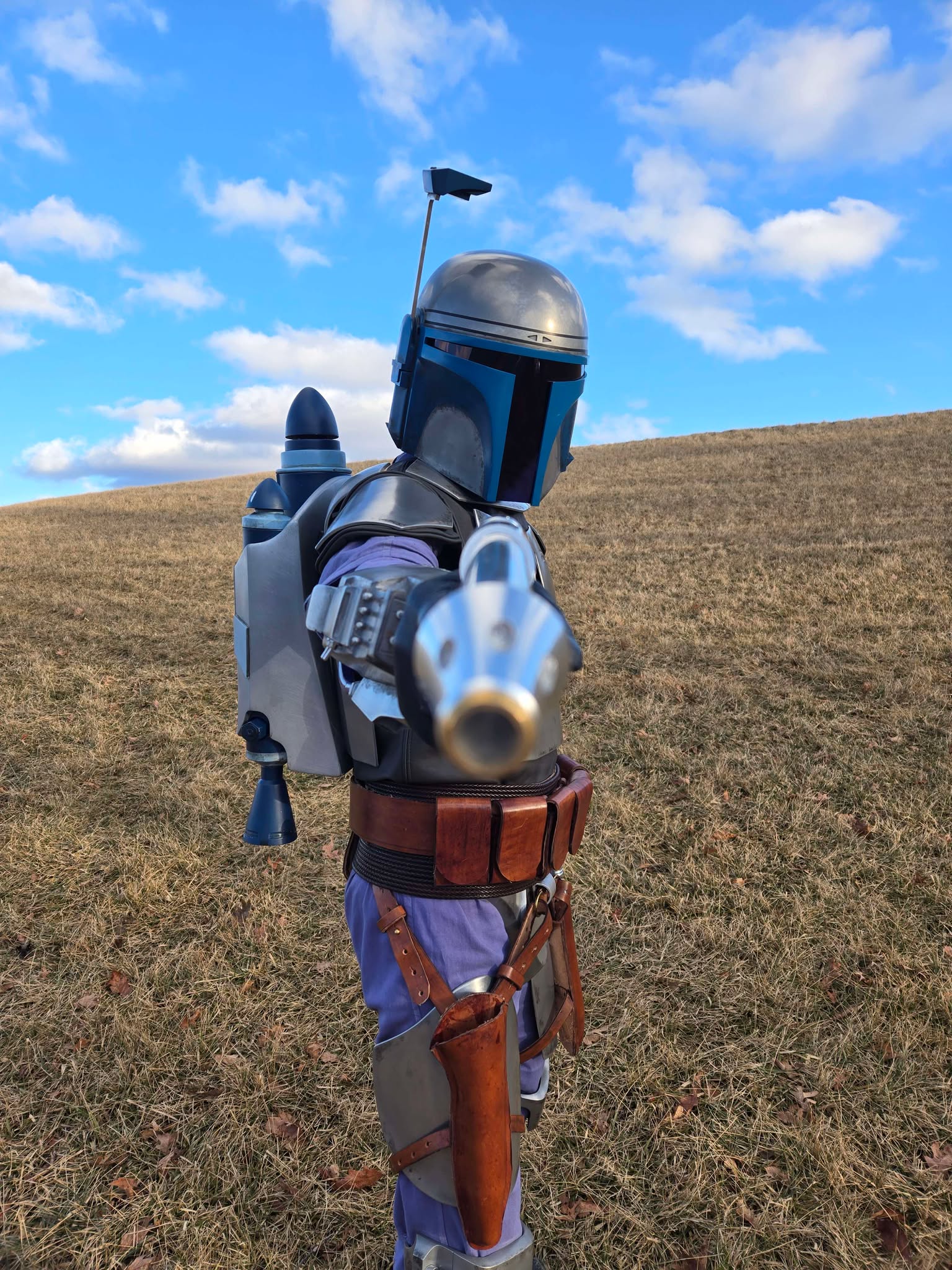

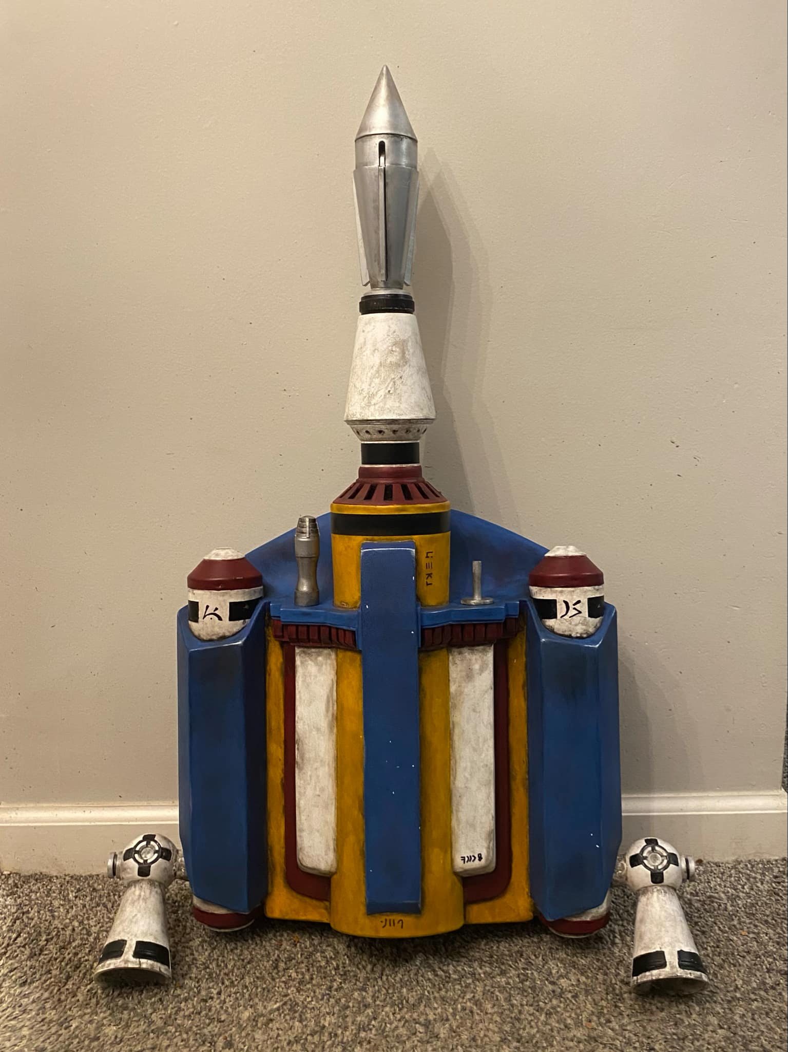

Made more adjustments to the jetpack. Dulled down the new shade of blue and also applied more orange to the yellow main body. I think I am done with this (for now):
Also went on another troop for Star Wars night at the Pirates game! Blasters weren't allowed so I didn't know what to do with my hands haha

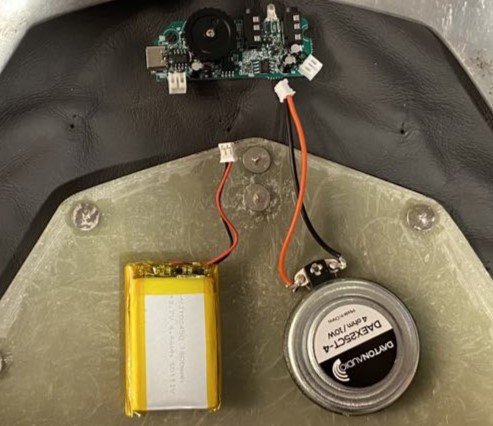

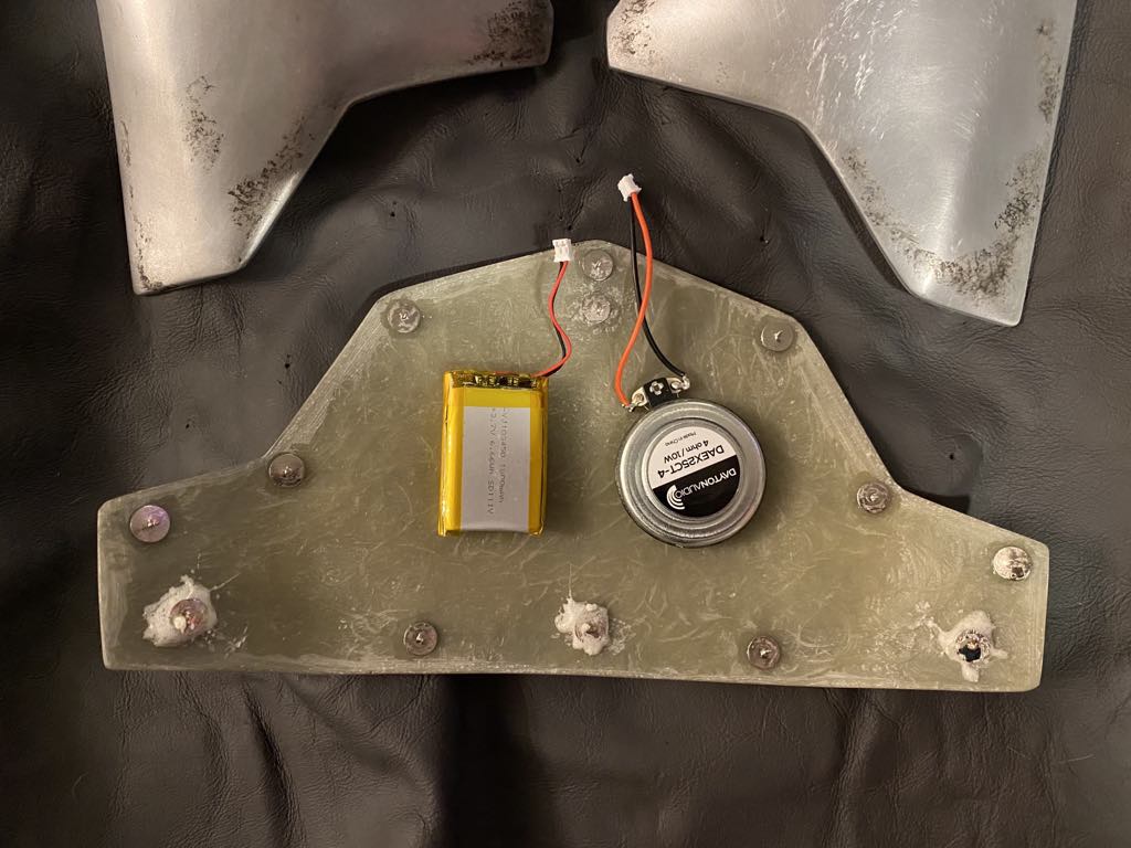

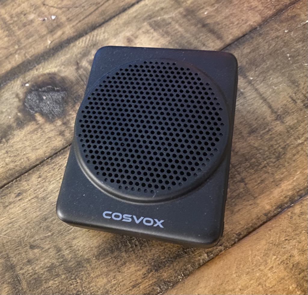

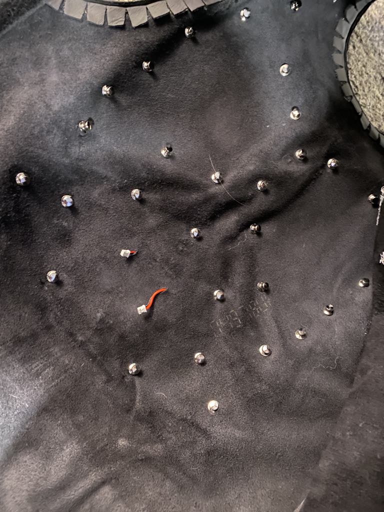

Made some changes to my speaker setup for Jango. One of the problems I have run into is the lack of useable pouches for housing an amplifier. I have been using a typical Anker amplifier and hiding it on my side under my flak vest, but this isn't ideal as it creates a "bulge" in the flak vest and also makes the sound come out of my side rather than the front.
To fix this I disassembled the amplifier, disconnected the speaker and soldered a 4ohm exciter. An exciter is designed to be mounted to a hard surface and then uses that object as the "speaker". This allows an exciter to be much smaller than a traditional speaker while producing similar levels of sound.
From this: To this:
I disposed of the amplifier housing and then mounted the exciter and the included battery against the abdomen plate. I then ran the 2 wires through a small hole in my flak vest where it connects the low profile amplifier circuit board from the amp where I can plug in my microphone. I used hot glue to insulate the circuit board and hopefully protect it from sweat during troops.
It seems to be least as loud as the speaker was, but seems to be louder to me. It also has much more bass than the speaker did. I took a quick video but it doesn't really do it justice.
