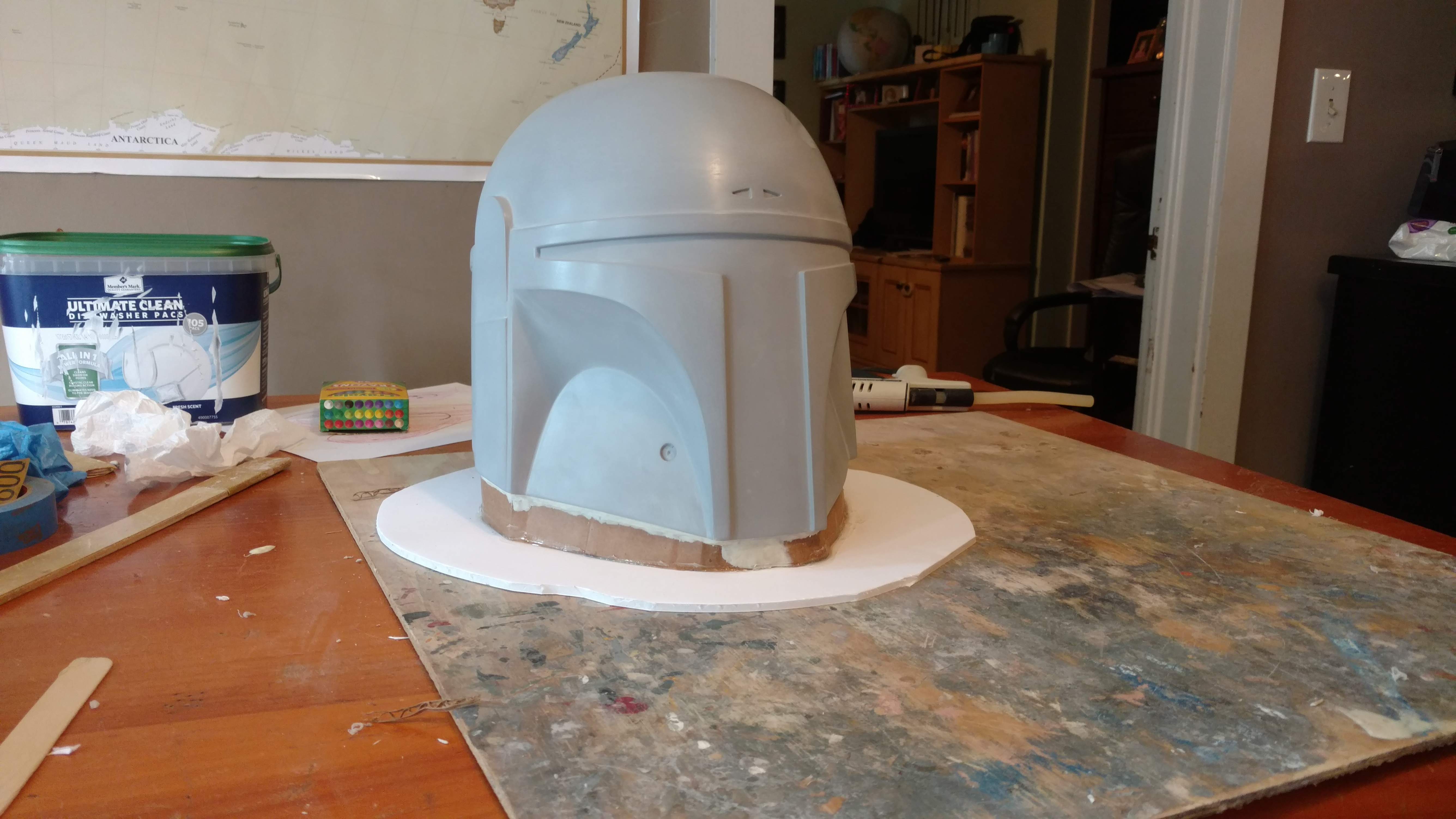

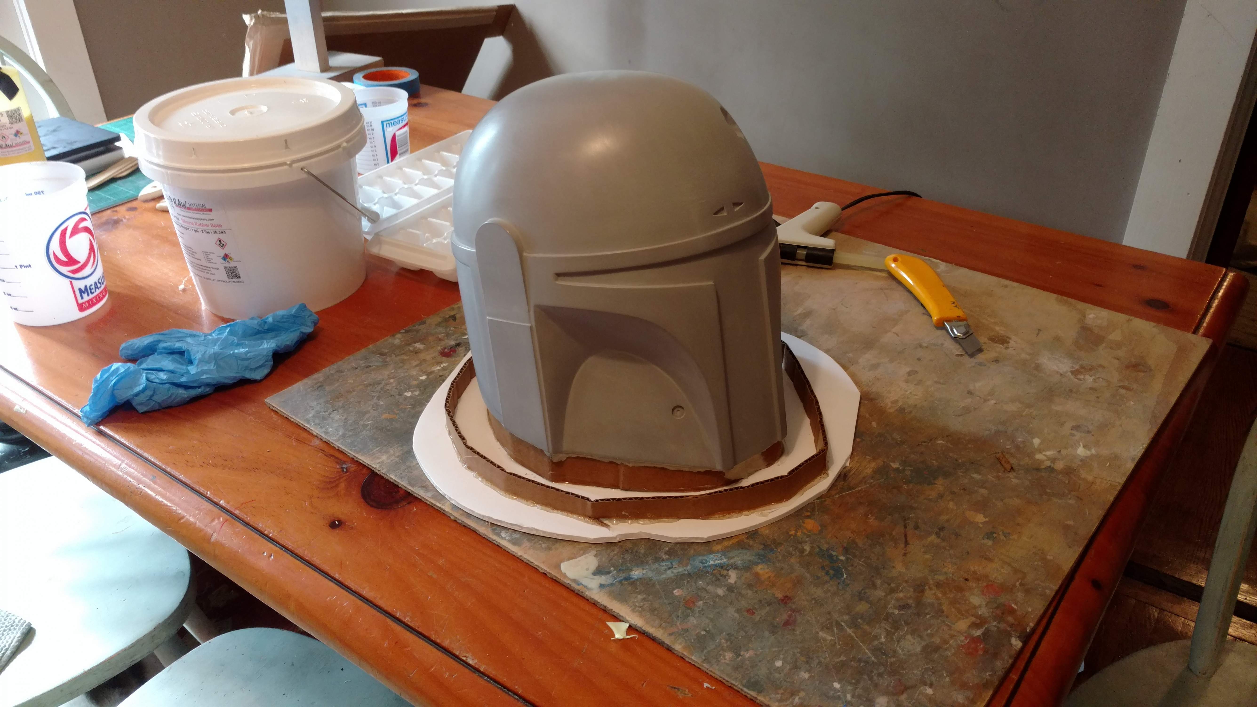

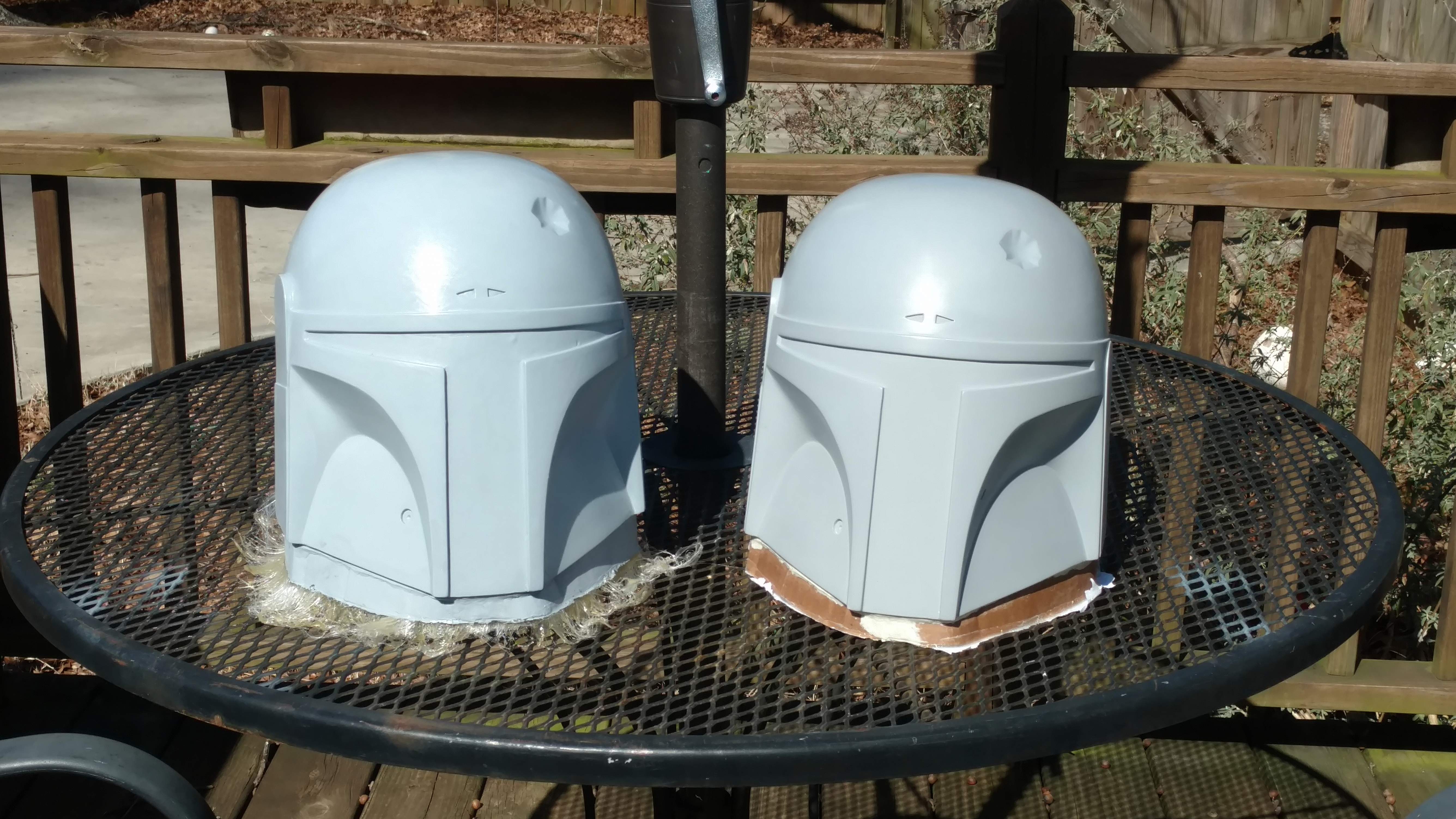

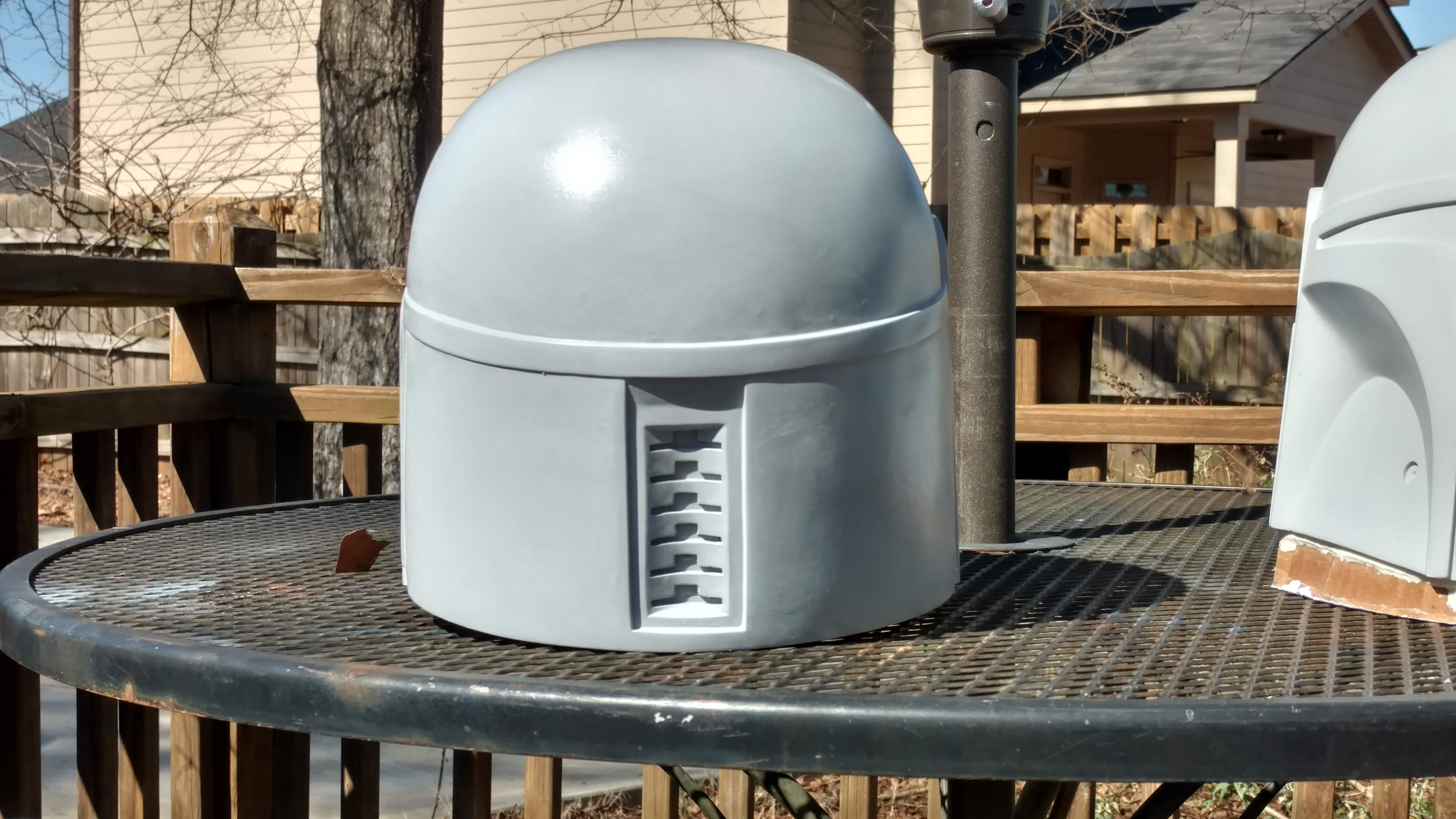

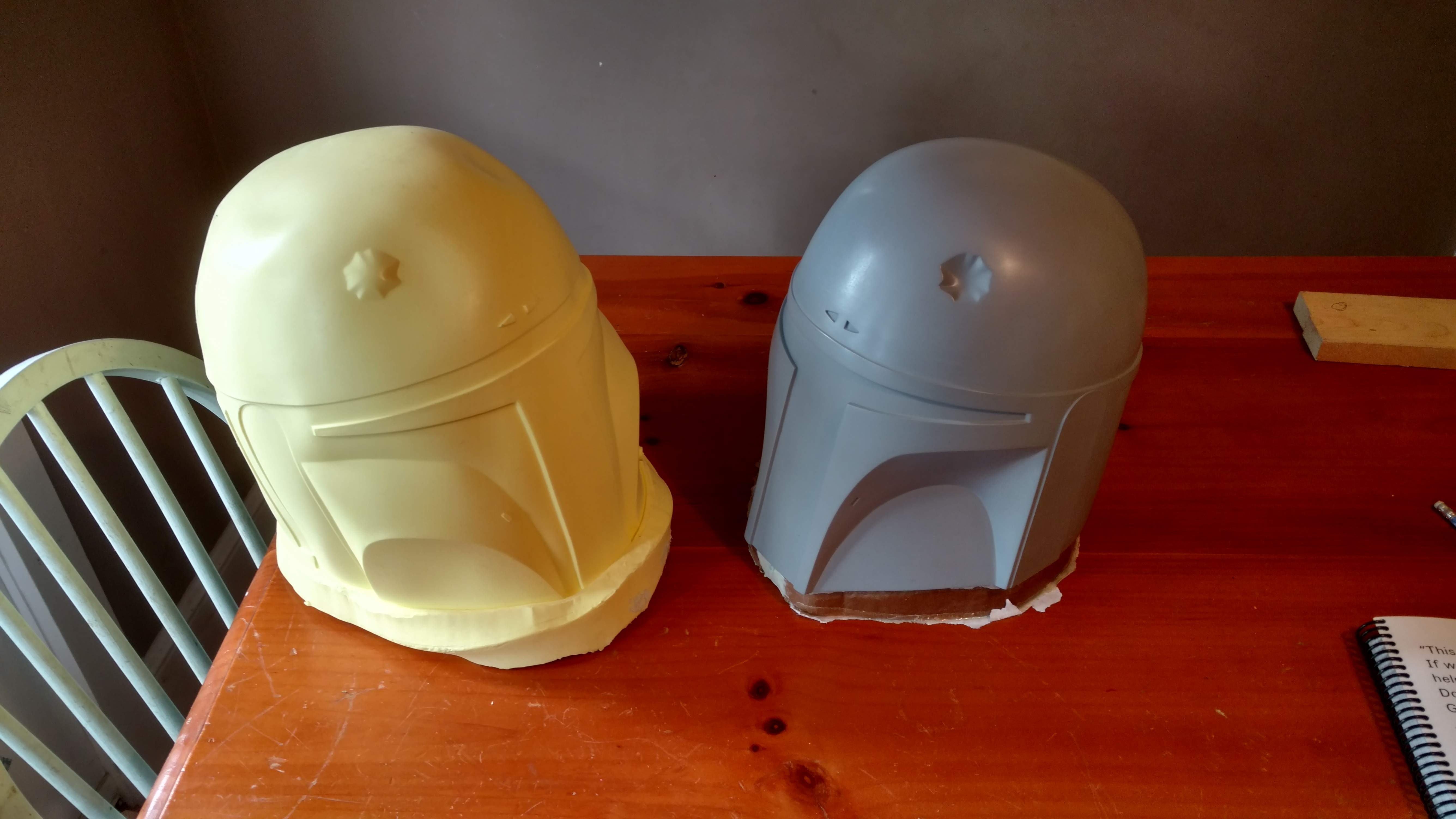

I may as well post up where I'm at with this today.

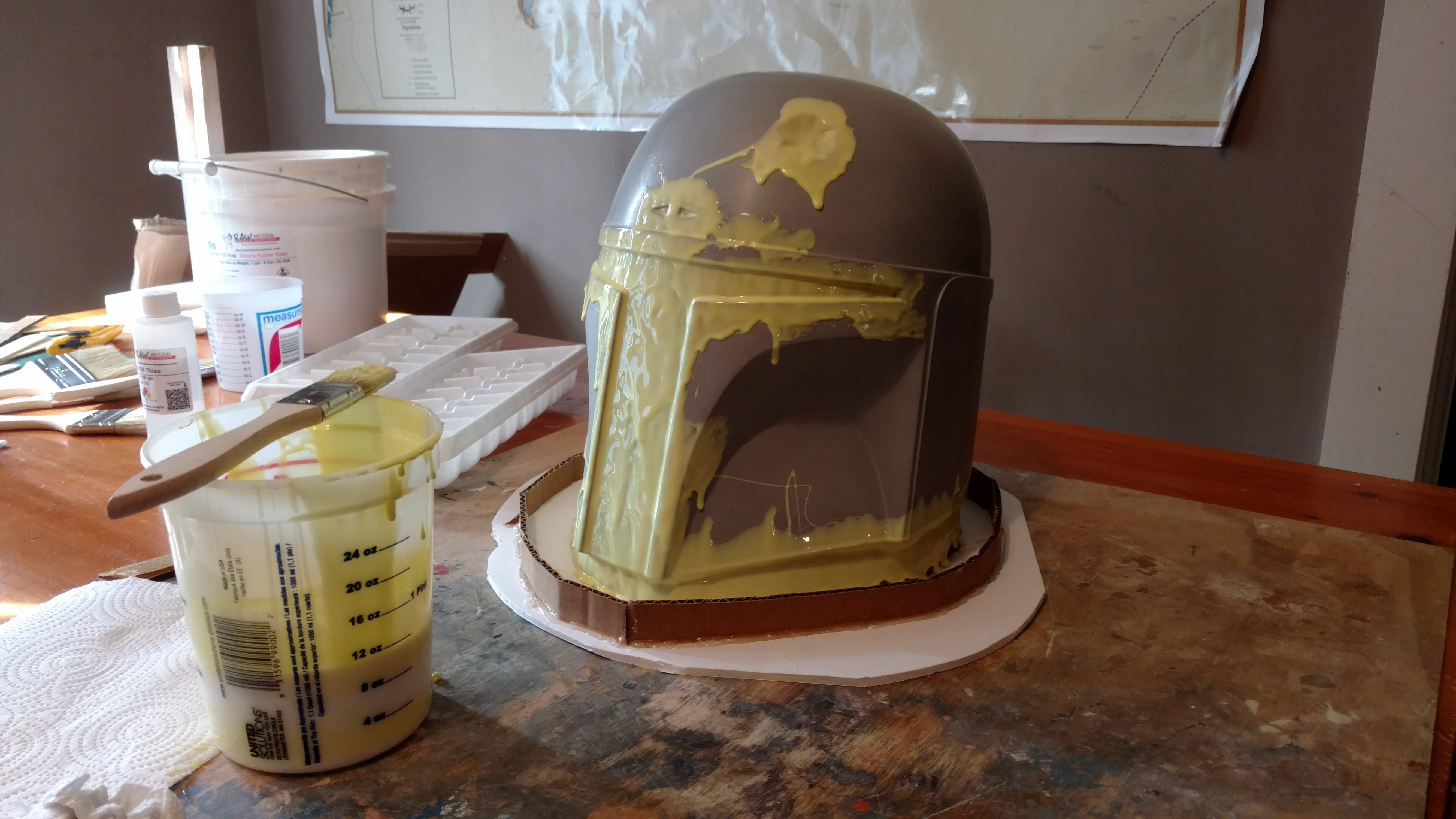

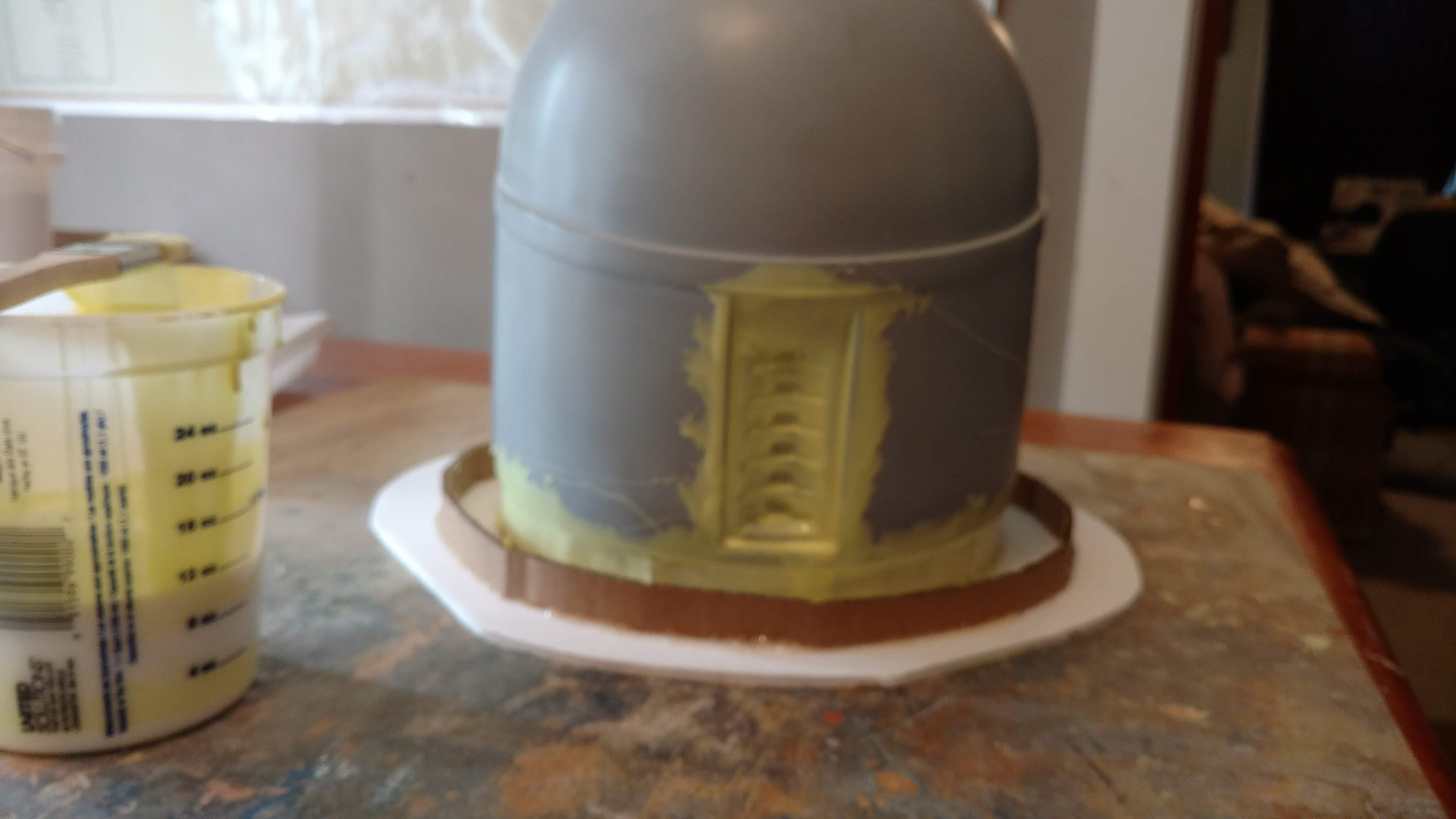

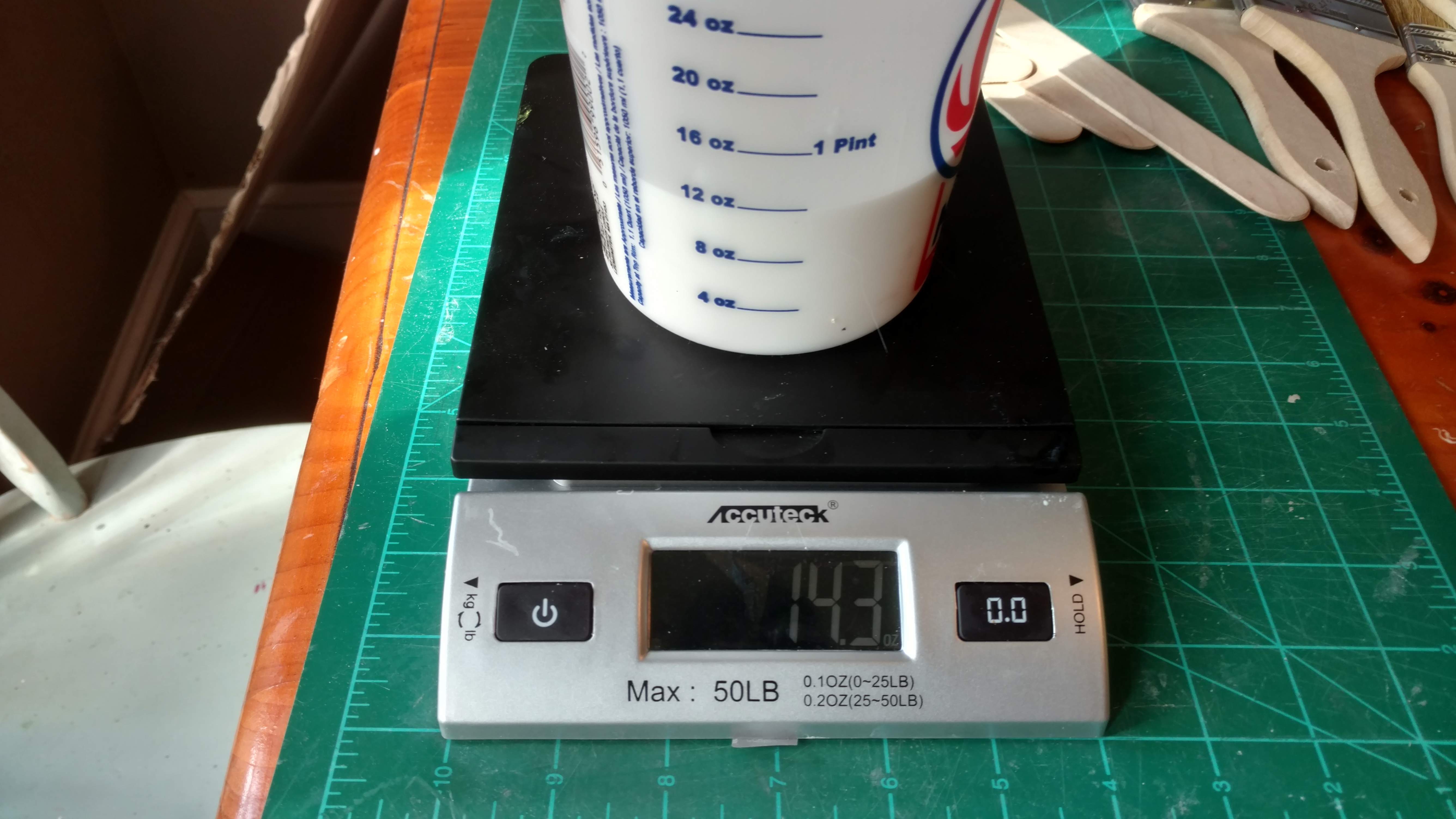

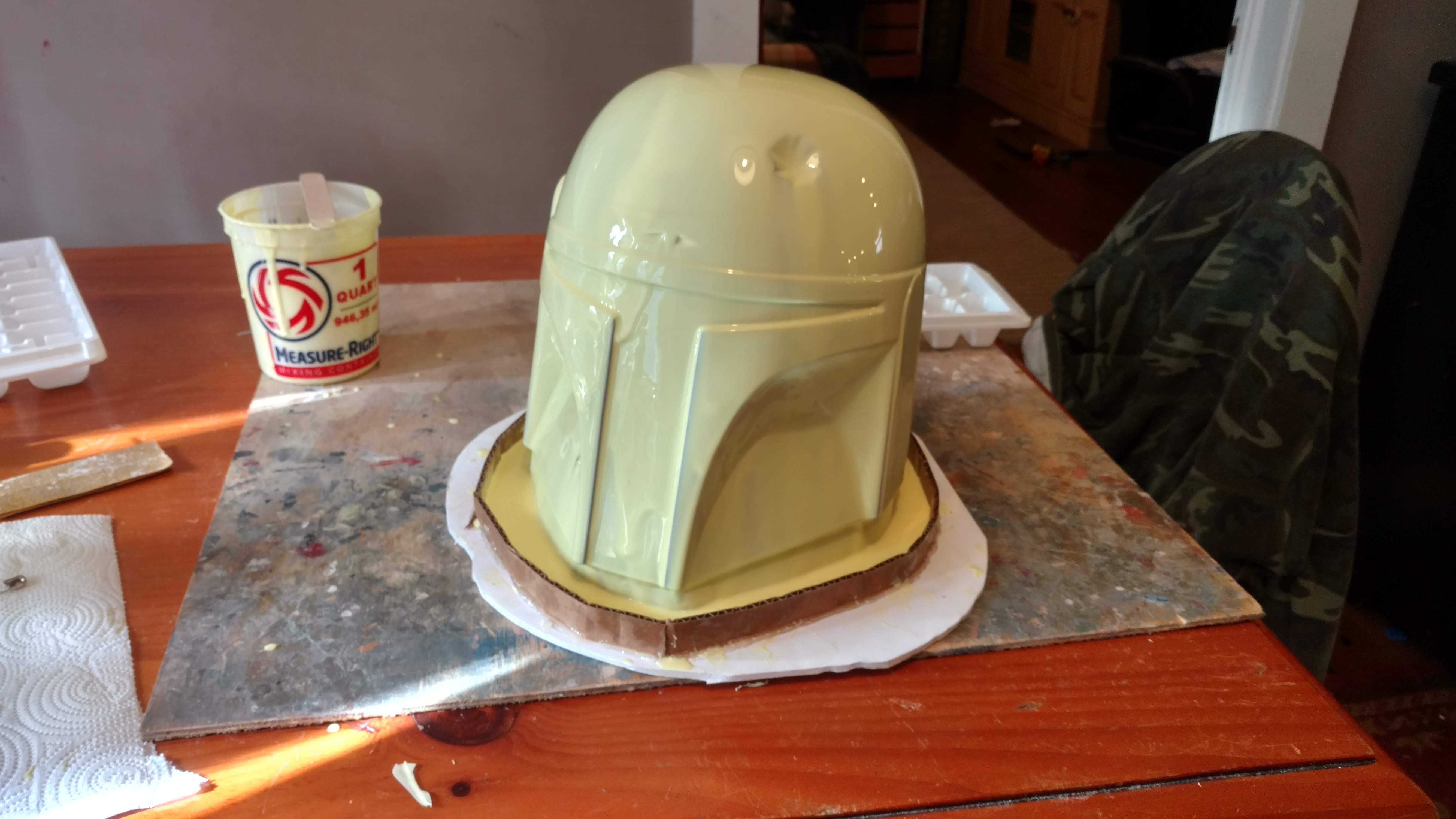

I'm working on a brush-on mold with tin cure silicone I ordered from raw material suppliers. It's pretty easy to work with...I did 1 other mold with it and had good results.

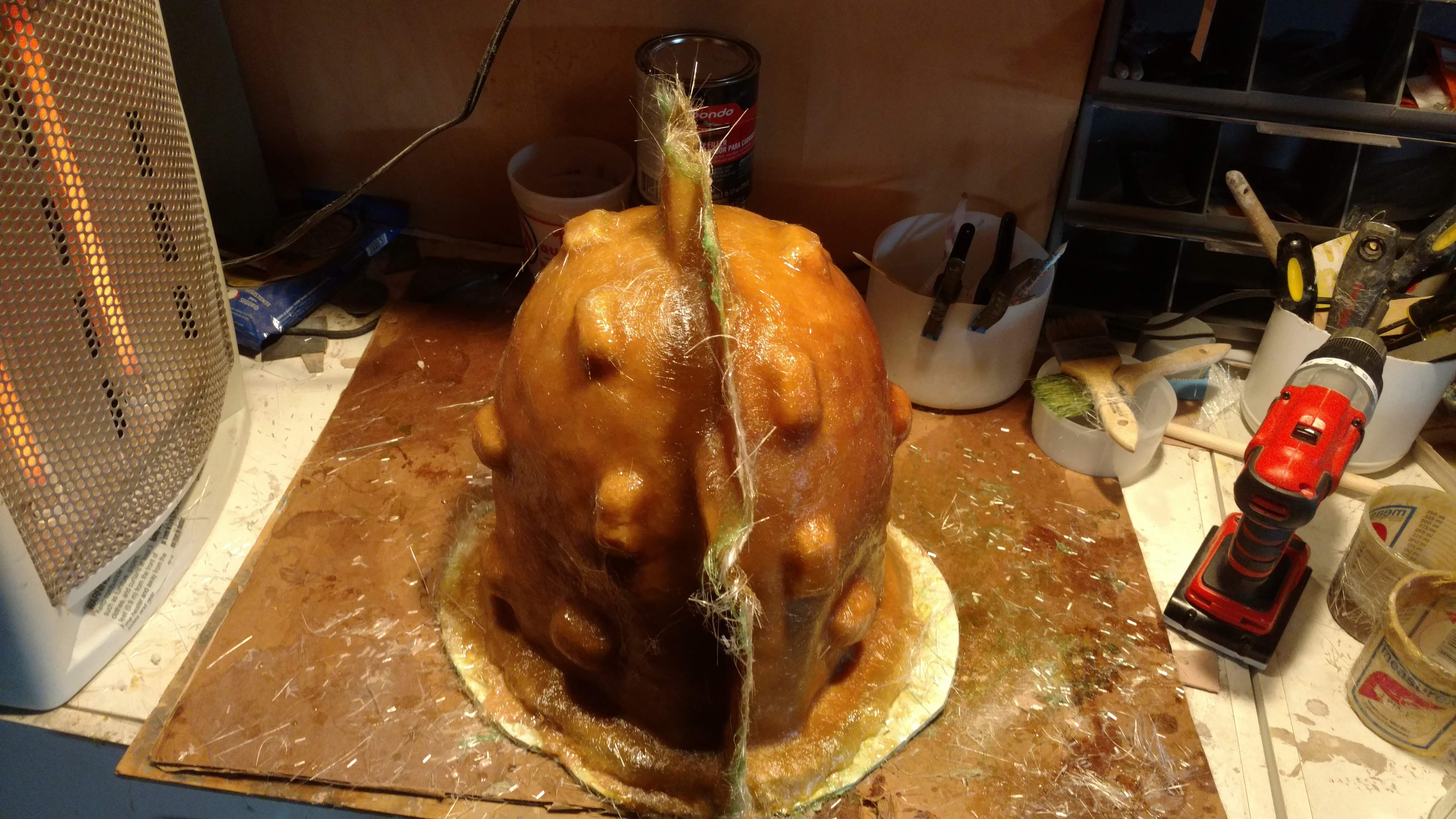

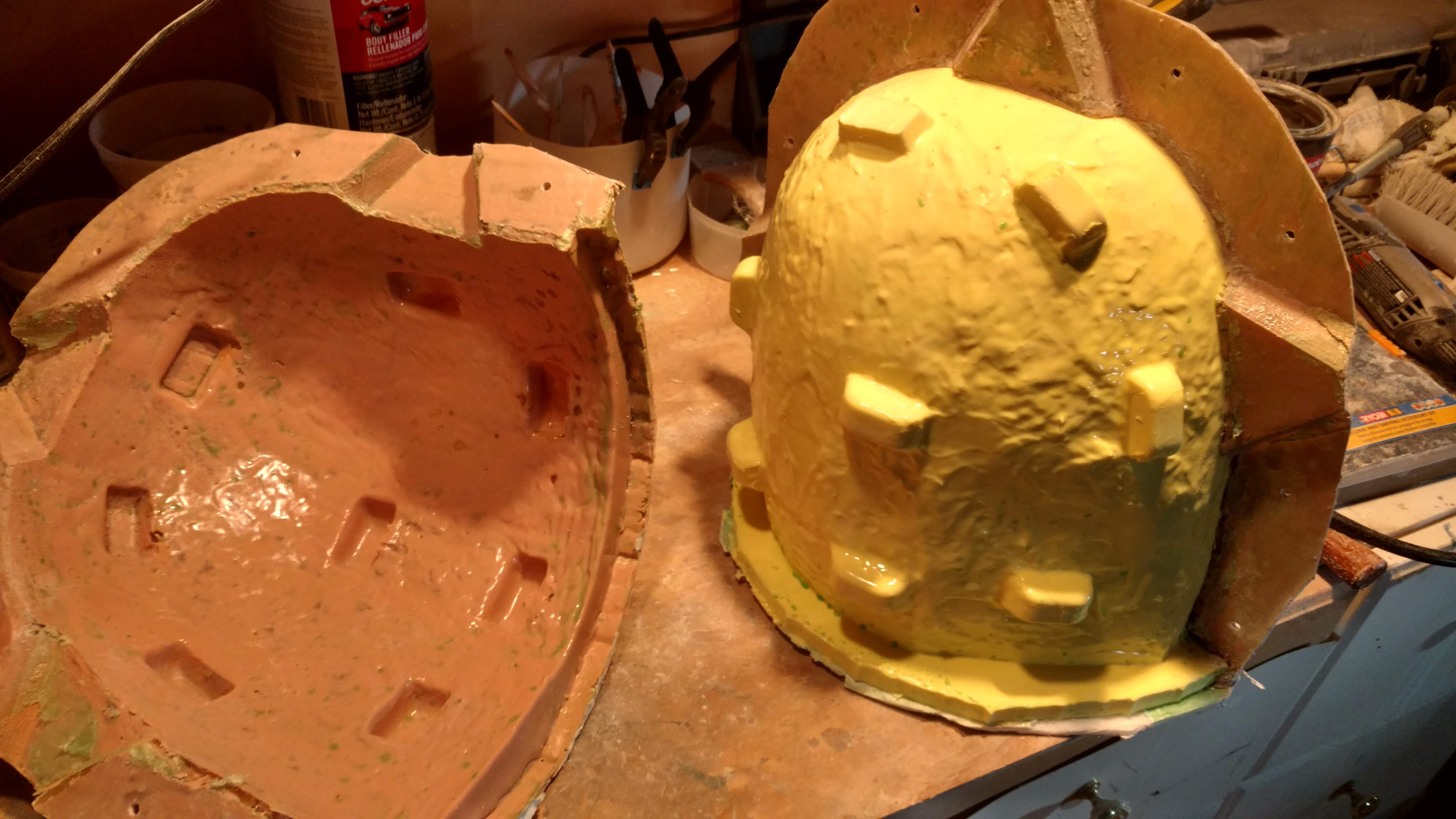

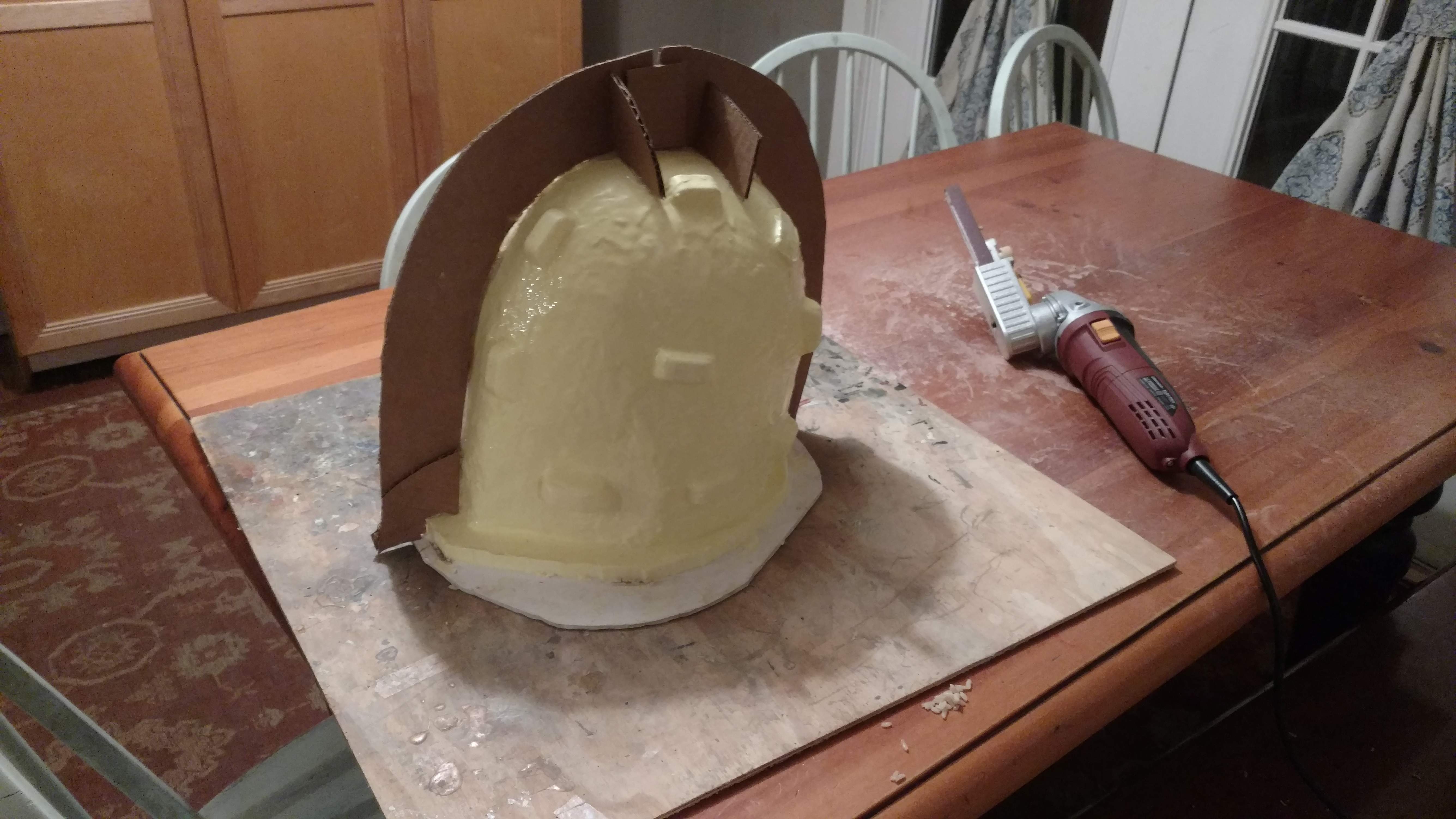

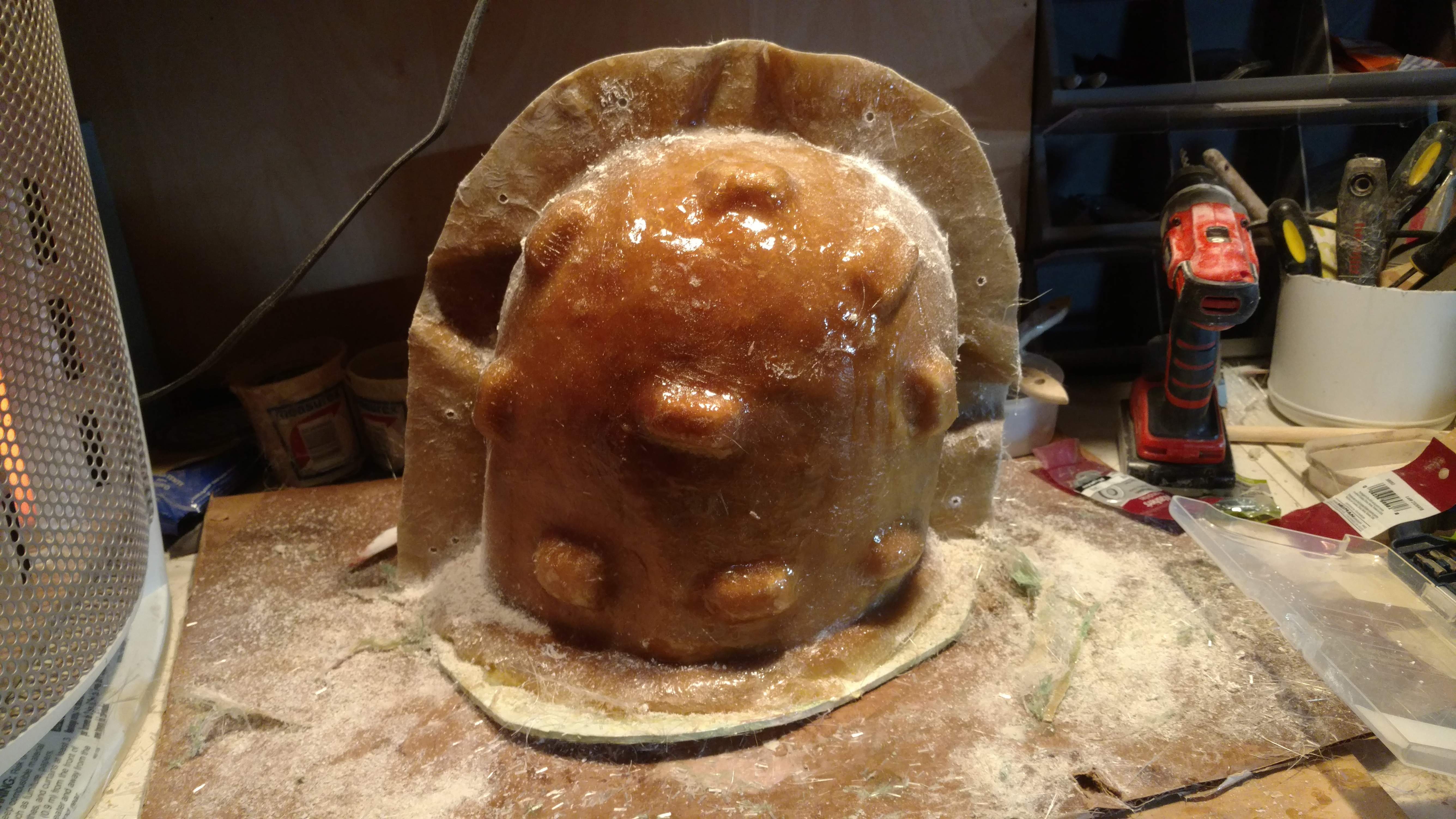

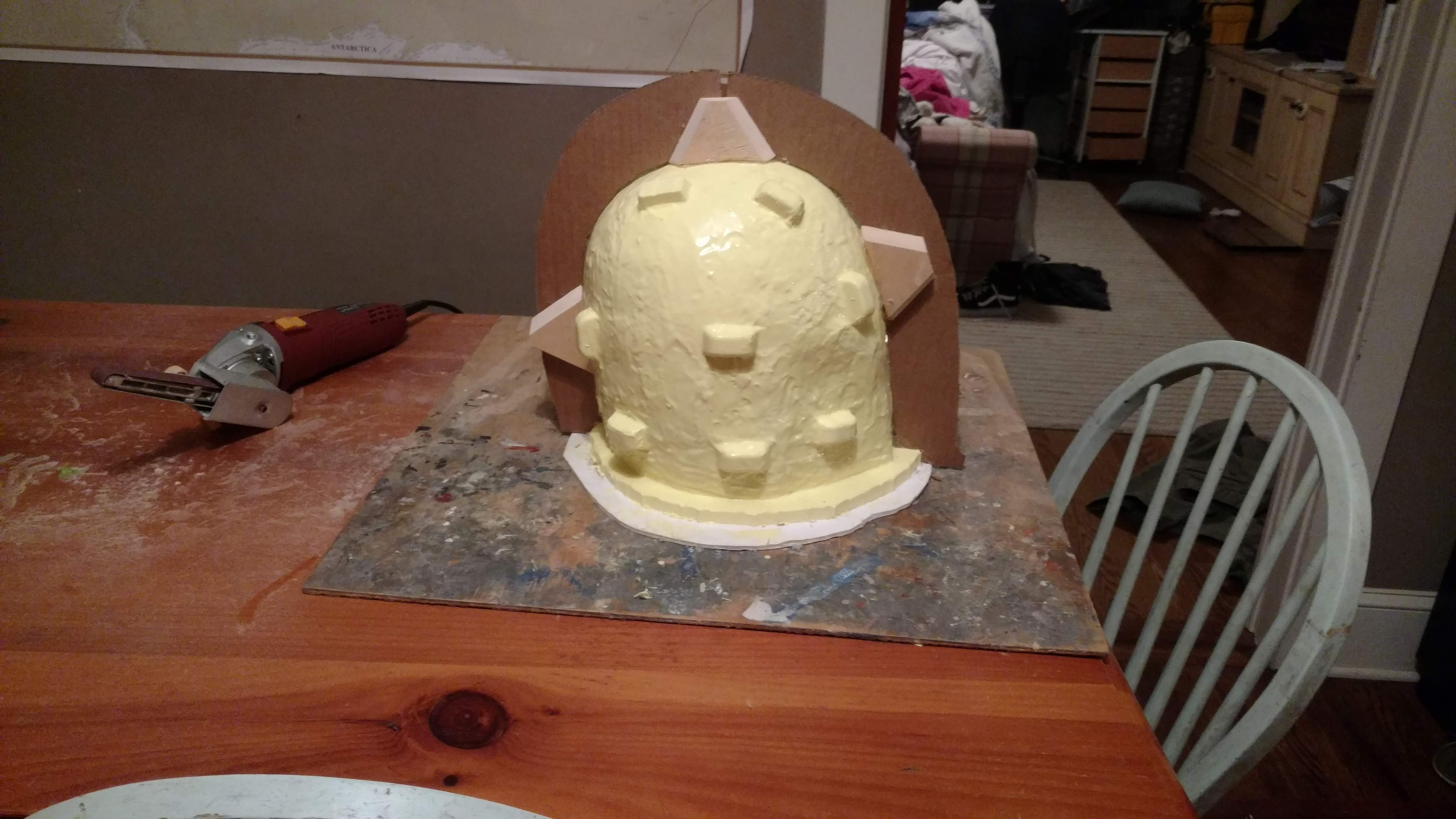

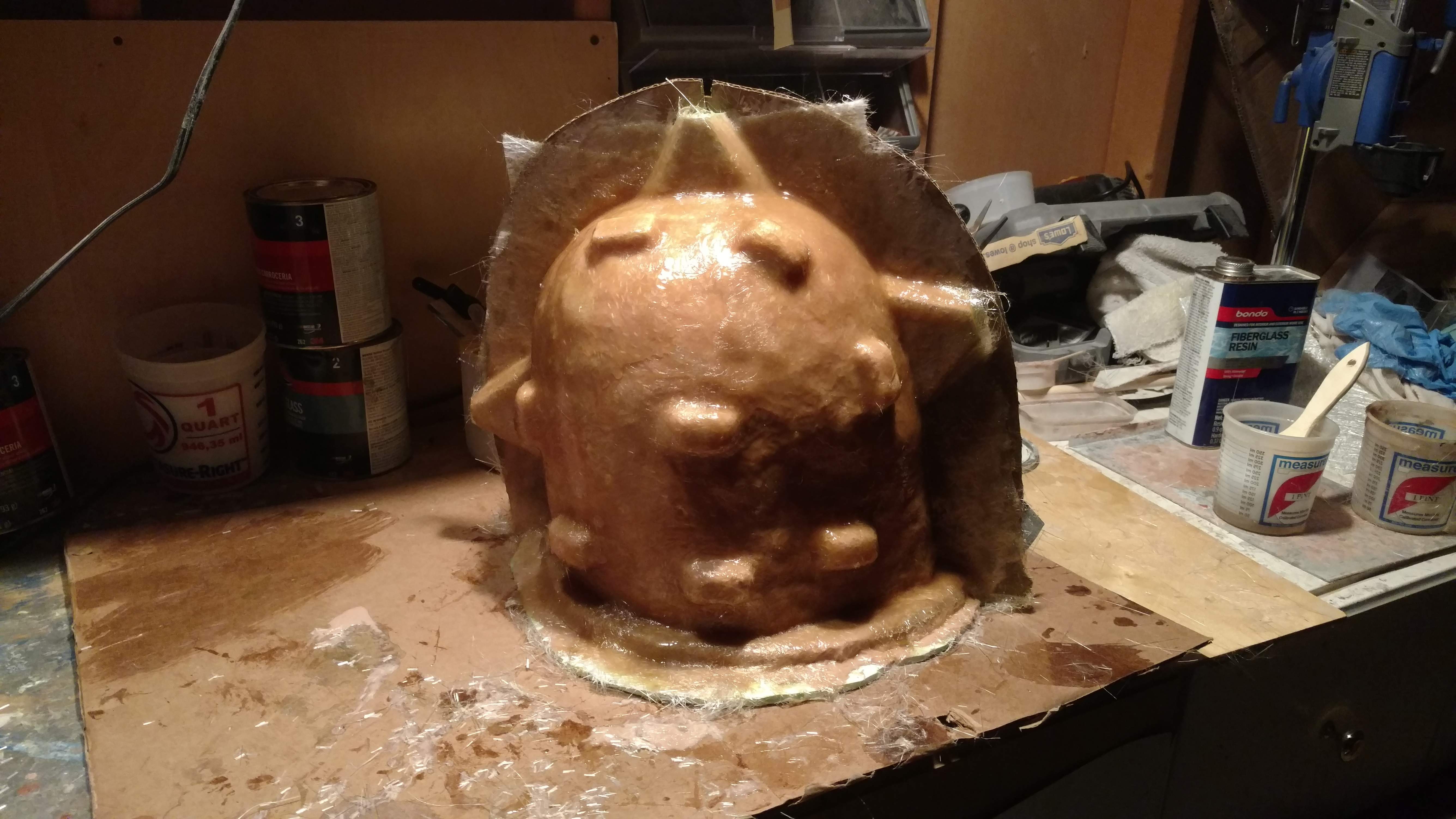

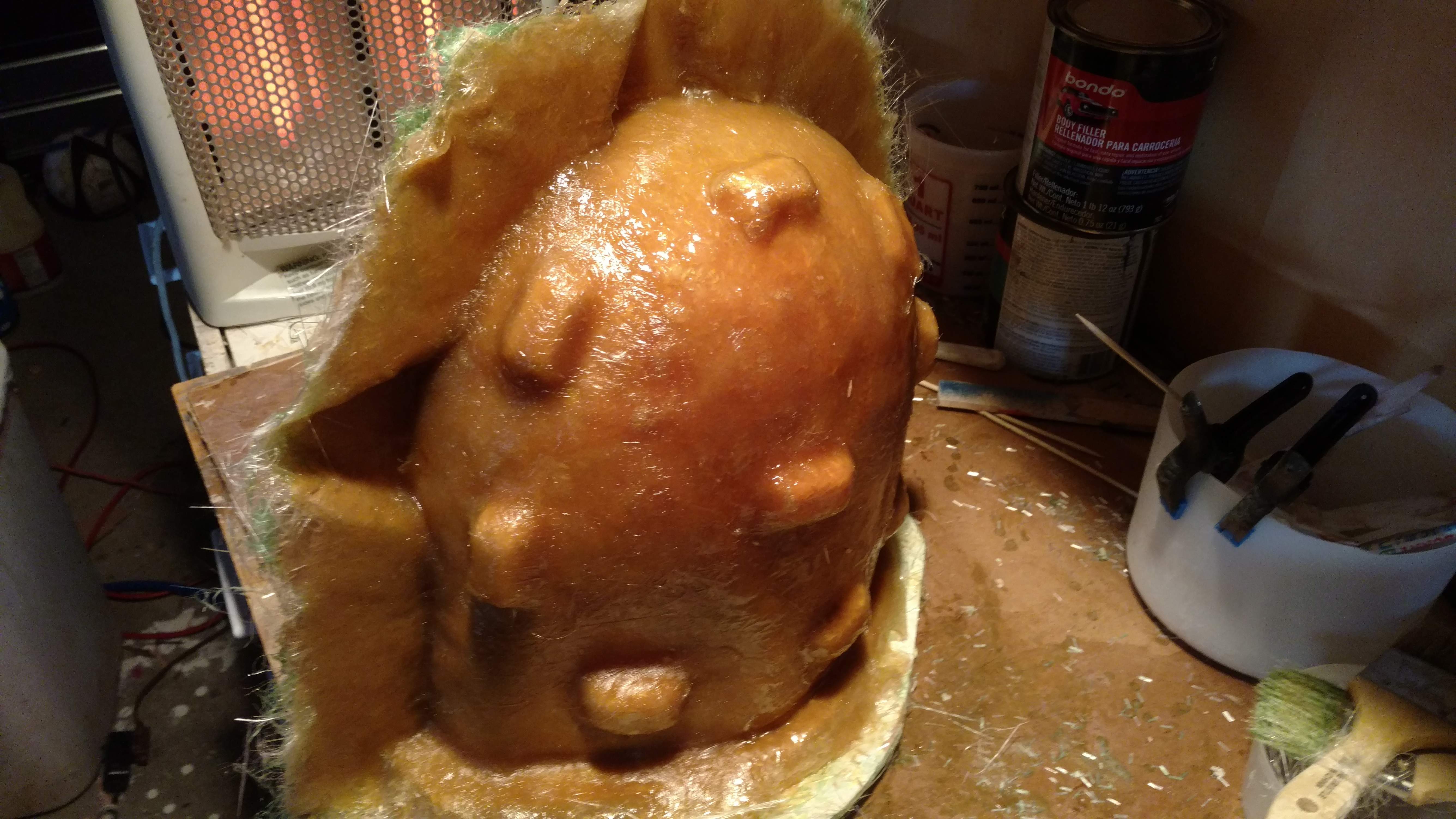

Another round of pics. Brushed on a couple coats of PVA and fiberglassed the other half of the mother mold. Also cracked it open and cleaned up the excess hairs from hell.
IMG_20160209_123050047.jpgIMG_20160209_123104787.jpgIMG_20160209_124156976.jpgIMG_20160209_130158029_HDR.jpgIMG_20160209_131447745_HDR.jpgIMG_20160209_132550111.jpg
What you see on the inside of the mother mold is just a rondo (resin+bondo) el cheapo gelcoat. Also, the silicone I'm using is shore 28, which I was able to roll of the buck with a little bit of effort without making a cut.

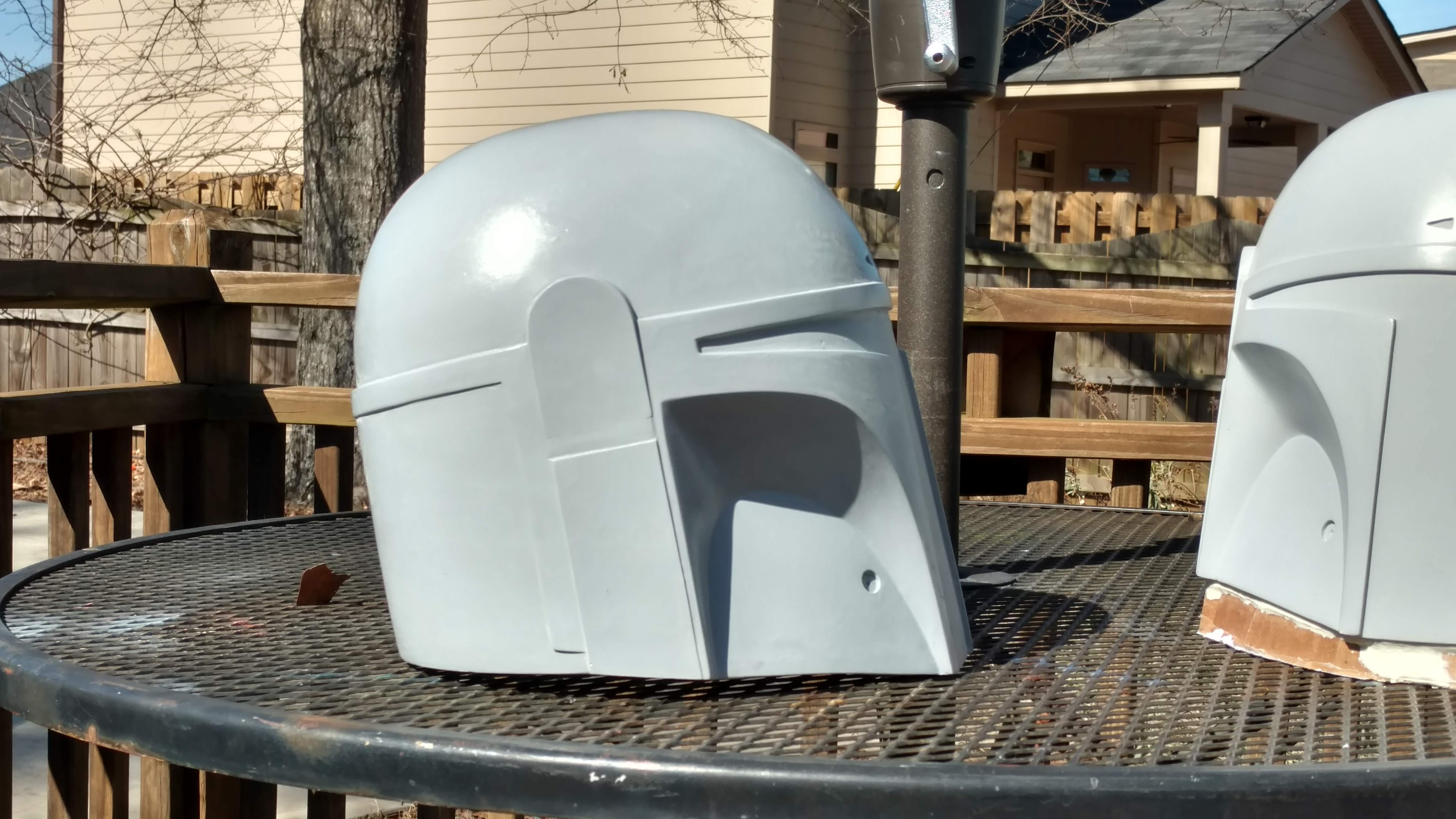

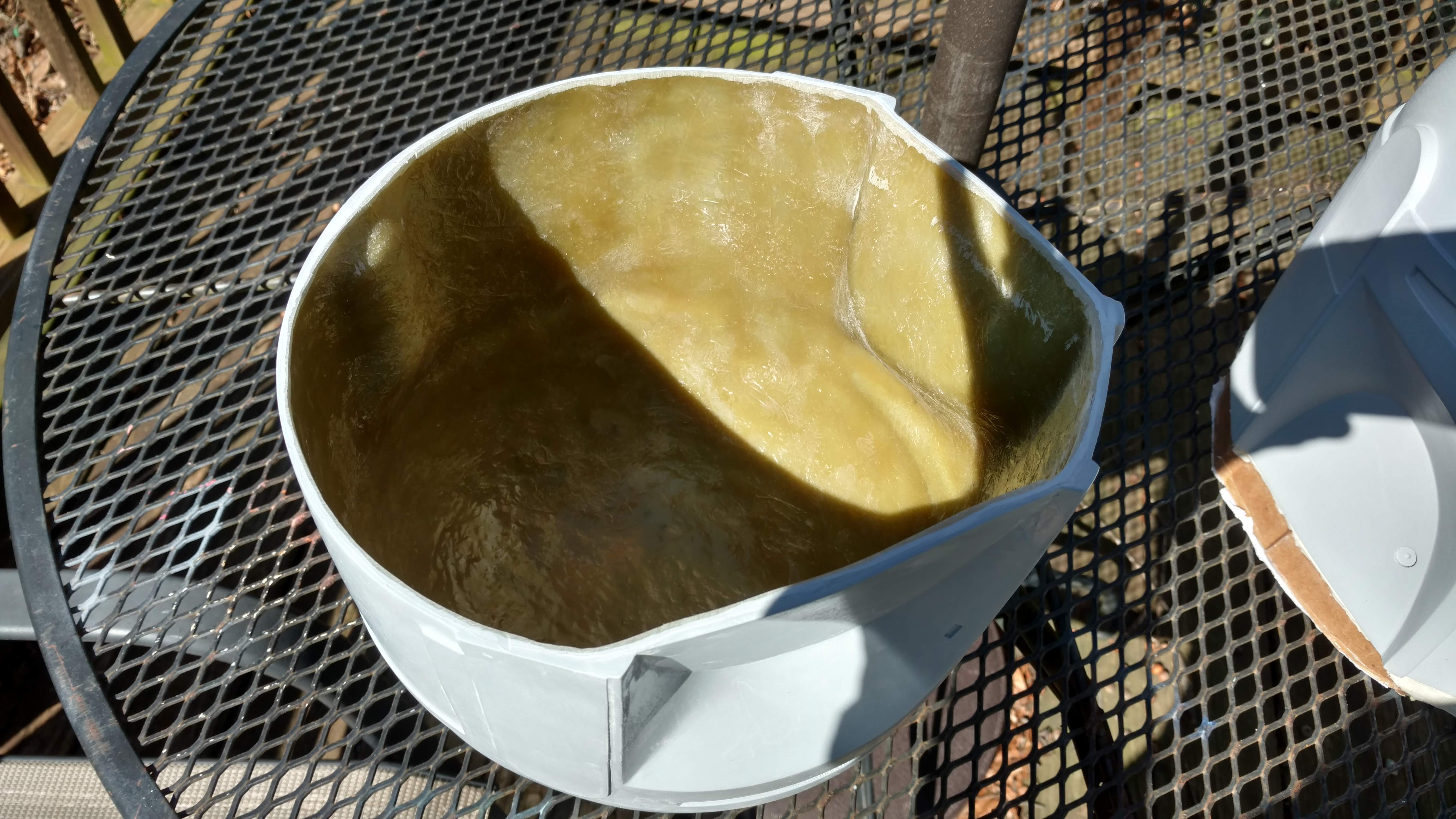

Ok, I finally got a halfway decent cast pulled. I say halfway because I believe the Stoner mold release I'm using is causing a weird reaction with he polyester gelcoat leaving a small ripple effect, which a little sanding and primer will take care of... also, I know I have a few voids in my silicone jacket behind the 1st layer which leave a very small bump in a few places which can be easily sanded out. Other than that I'm stoked about this helmet!!! I'll probably redo the mold at some point anyway.
I used 2 layers of fiberglass after the gelcoat which makes this thing as hard as a rock. I'm not sure if this is overkill. Maybe someone can chime in and enlighten me.

Now that's a solid-looking helmet! You have every reason to be stoked--that casting job looks great!! If and when you decide to make some kits, just say the word!
A little sanding is required for all helmets anyway, and that cast is already looking clean. Feel free to get some life out of that mold before you consider doing another! ;)
