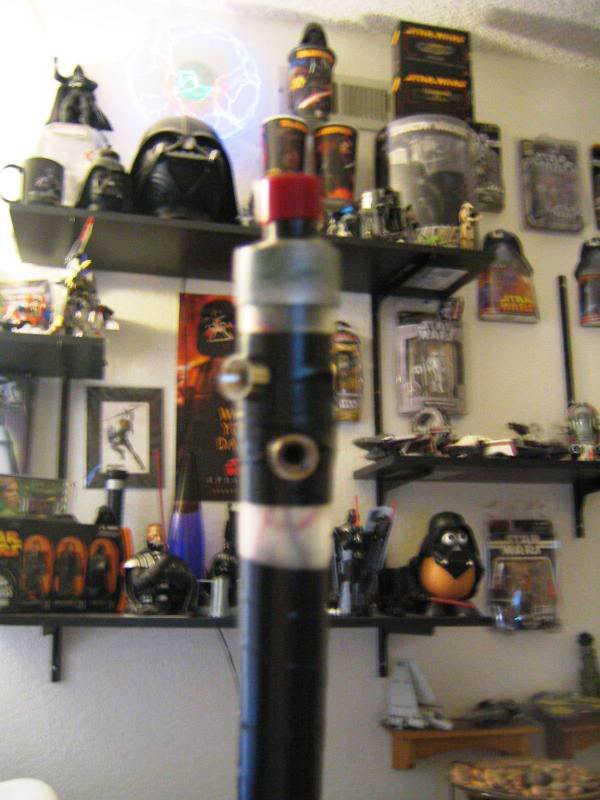

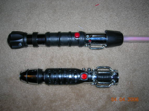

If it's the same ones I think you are talking about.Those LED's are awsome I use them all the time I used them with some home made light sabers.
and on my rifle. I just took some close up shots. I will say this taking a pic of an LED when its blinking is not easy LOL.

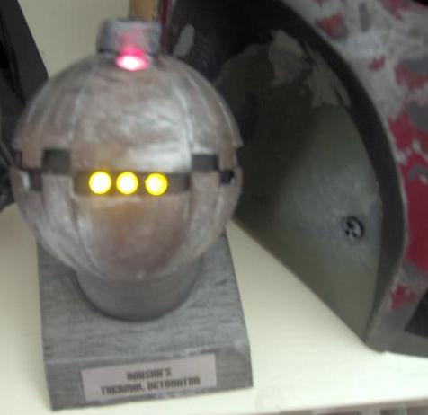

and then this is my version of a Thermal Detonator using 10 round paintball tubes I have a thigh holseter I will wear on my left leg that will allow me to carry six of these.

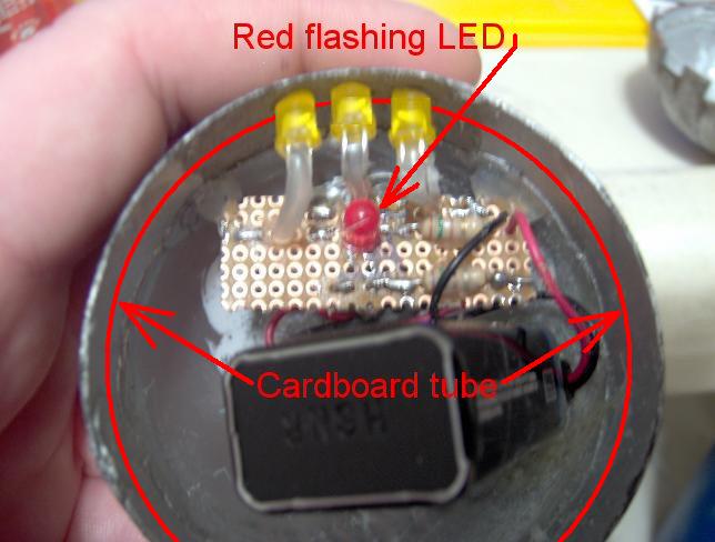

Here is a pic of the thermal detonator I made. It was my first attempt with LED's. I found out on this one that if you wire non flashing LED's in series with a Flaching LED in the front they will all flash.
That is an AWSOME detonator how did you make that??
Yeah, nice det! Where'd it come from and how do I get one for myself? Concerning making the leds blink, don't you add a specific resistor to the makeshift wiring harness you've built to make them blink?
I made it from one of the small hollow plastic baseballs you can get in the toy section. First I cut it around the seam where it went together. Then I used my handy dandy dremel to grind off the molded in threads and then a glass etching bit to cut in the grooves. For the notches in the iddle I used a cutting wheel and a hobby knife. The switch on top is made of sculpey and a model tank tread that I had in my spare parts box. The center where the three LED's are is made from a Pringles chip can but you could probably use any cardboard tube as long as it's sturdy.
You can purchase Led's that blink at radio shack. They are usually red though so I have that one on the inside wired in series with 3 yellow LED's that come through the Pringles can to the outside. The only thing is they all flash at the same time. You do have to put a resistor in front of the set up. For the red light on top under the switch I wired it by itself away from the flashers to keep it from blinking.
