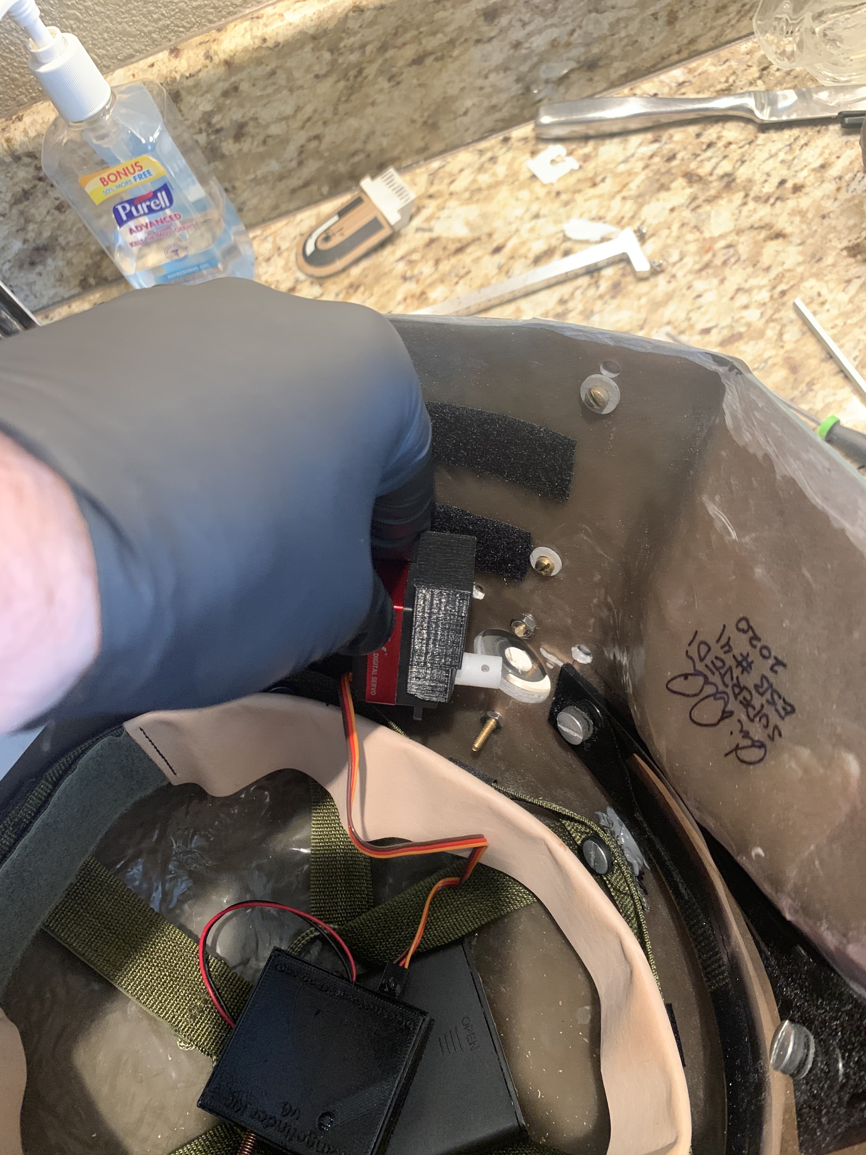

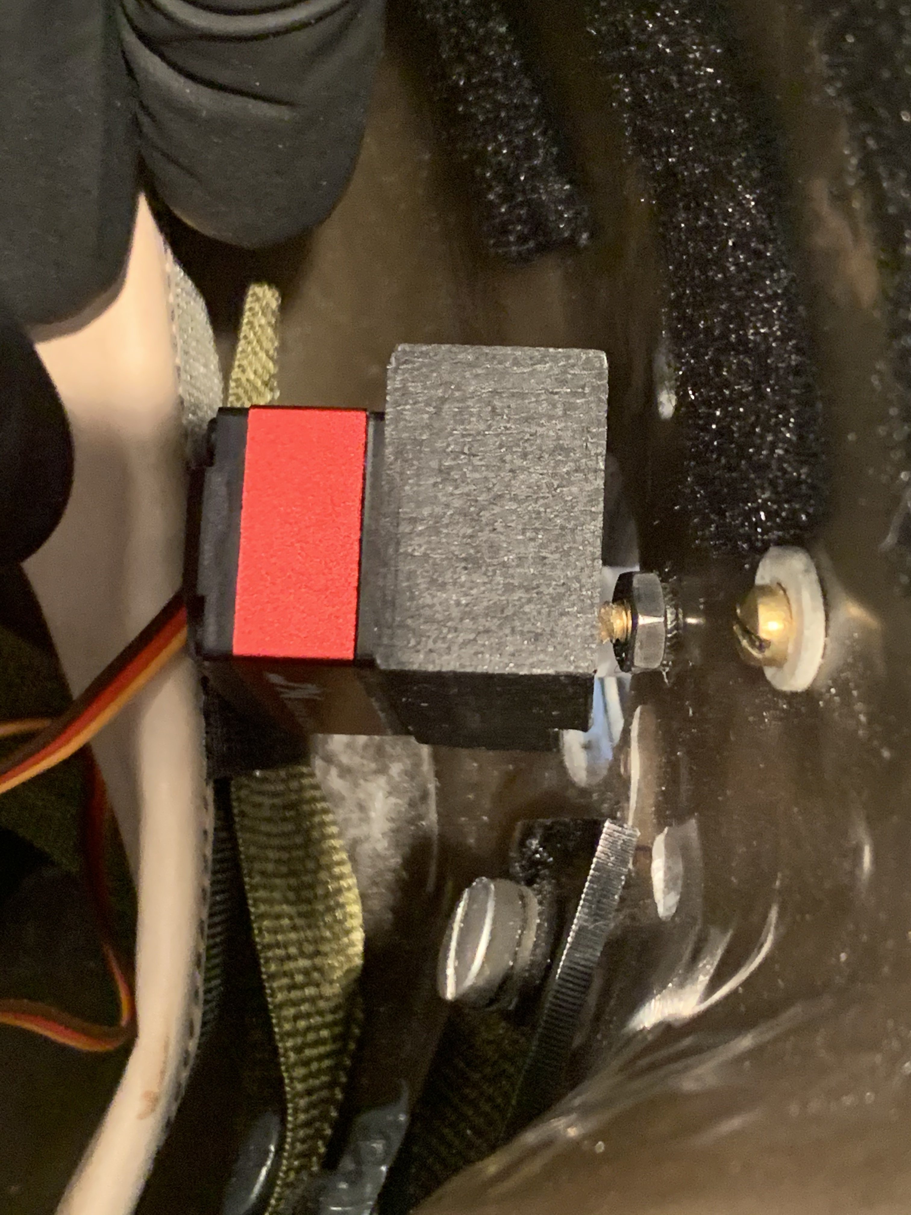

The additional nuts from the metal ears definitely make it more challenging. For the time being I uninstalled it until I feel more patient. Here is the space I am working with. I cut out some of the mount and I cut some length off of the screw, but I still can't get the RF stalk to travel straight. Might try again in the future. It was just taking to much time to figure out.

Your best option would probably be rotate the mount so the servo and bracket are on either side of that screw from the ear piece. You should be able to orient the servo in a different position to sit flatter against the helmet.
Can you change the settings on the servo for where it starts and where it ends? If I move the servo itself, the rotation is off.
Make sure the servo is set at dead 12 o'clock. 1 degree before or after can cause problems as the servo is set for a 90° sweep from 12-3. If that's the issue you will hear the servo buzzing.
Here is what I would do:
Mount the servo inside the helmet to a spot that the screws don’t get in the way. Once that’s done, turn the system on and let it go to the starting point of the rotation, then mark the shaft so you know where the starting point is. Attach the stalk so that it is in the up position and it matches the mark you made on the servo.
the servo will only turn a given amount, but you should be able to attach the stalk so no matter where the servo is mounted inside the helmet, the stalk starts and stops in the correct place.
