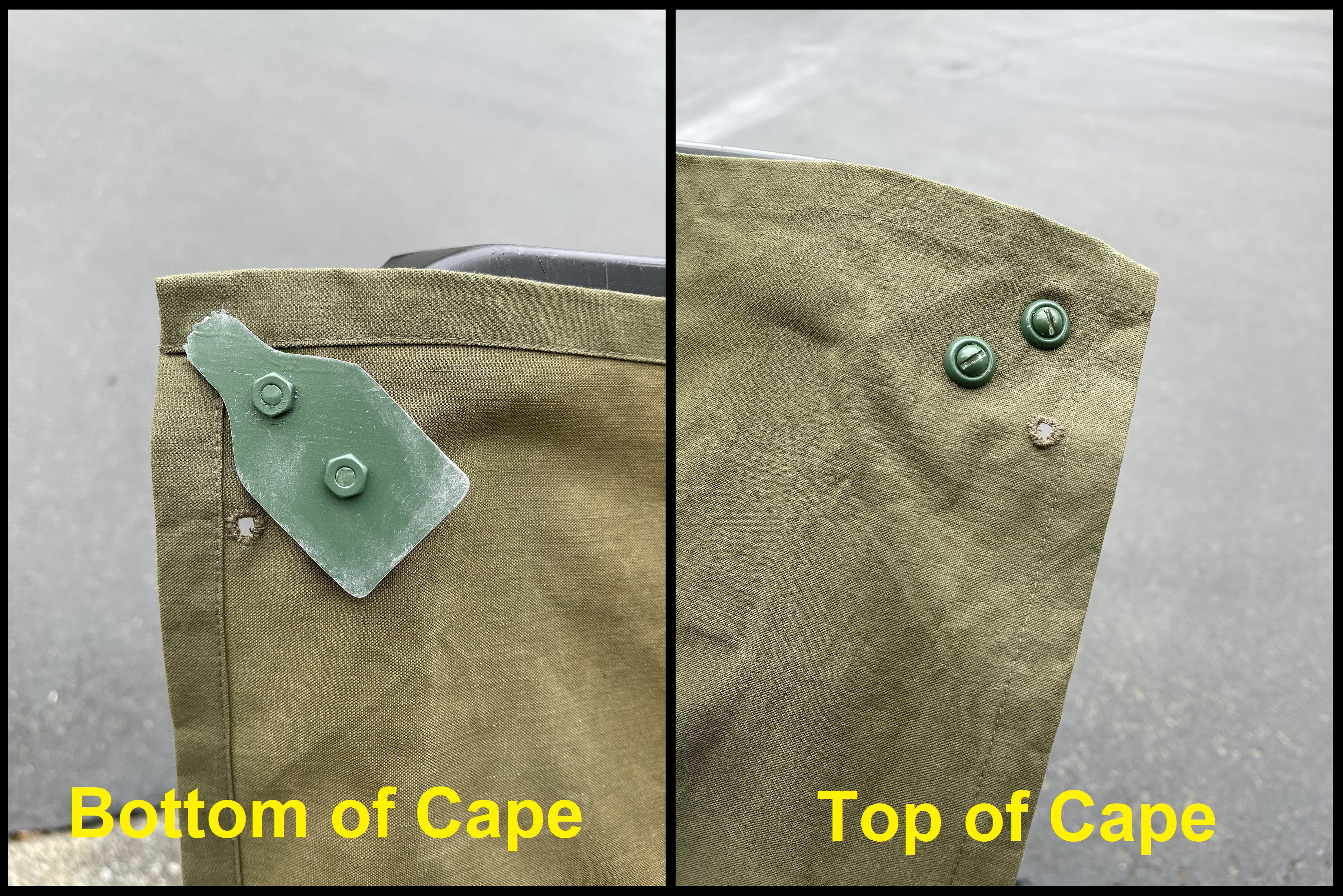

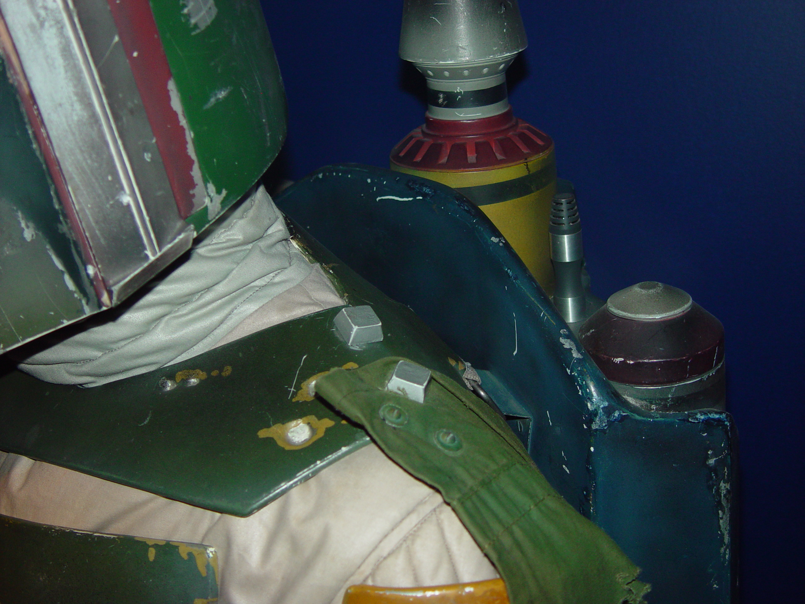

3) As you can see in the 2nd and 3rd pics I posted, my cape has a tendency to spin and cover the left shoulder bell. How do you keep your cape in place? Looking at one of the Magic of the Myth references, I can see a little bracket. Currently, my cape has 1 button hole at the very tip that the keycap holds in place.

Not sure why the cape is doing that. Is there any way to tighten down the stud that holds it?

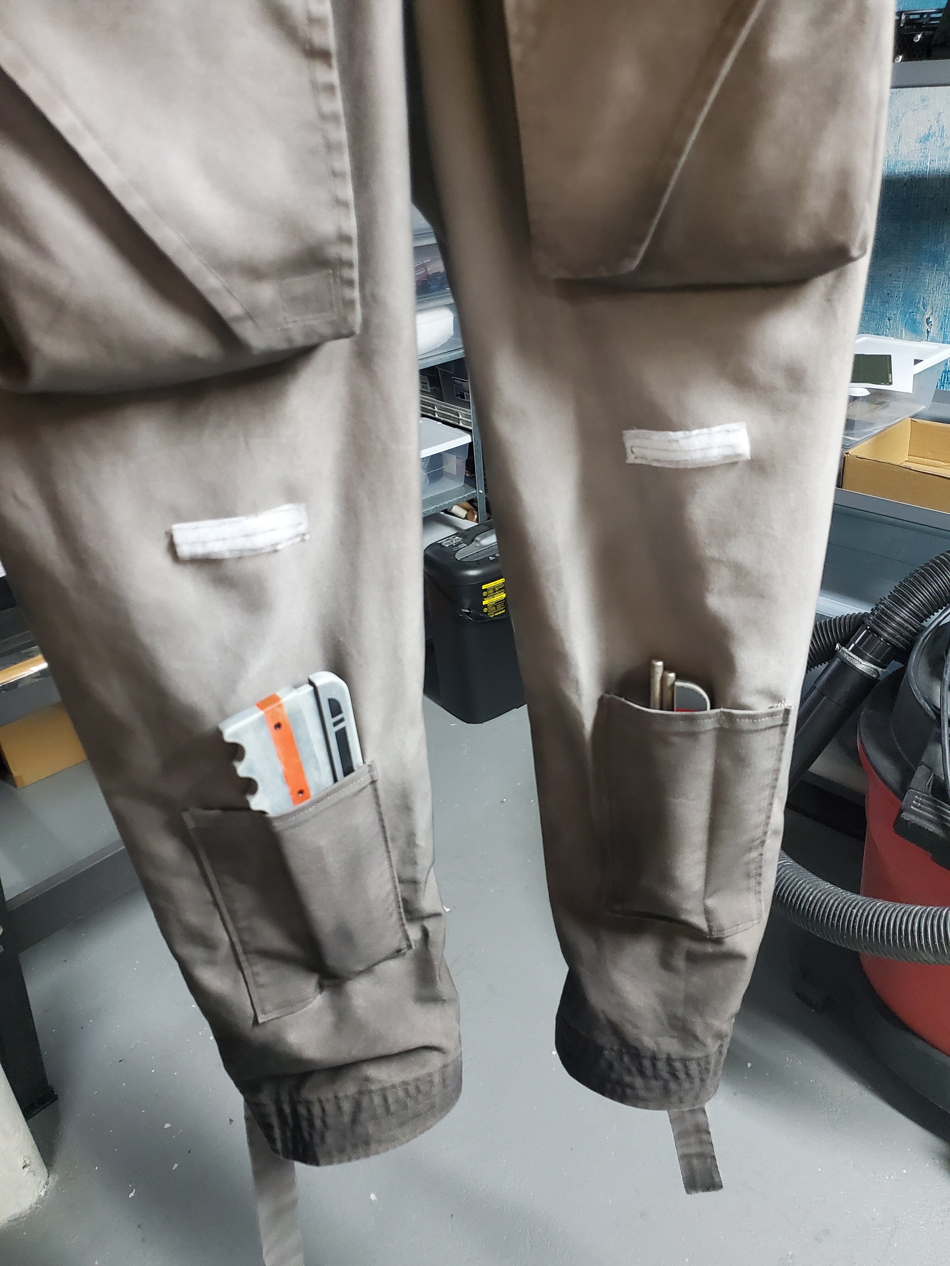

2. For the knees, velcro is definitely the way to go. Here's my setup. The elastic band in the back helps keep the knees in place as well as being part of the costume. Remember to use sew on velcro for the soft parts!
3. I think that's just the nature of the cape honestly. In the film you can see the cape covering the shoulder quite a bit. To avoid this you can tuck the cape behind the shoulder armor to keep it in place.

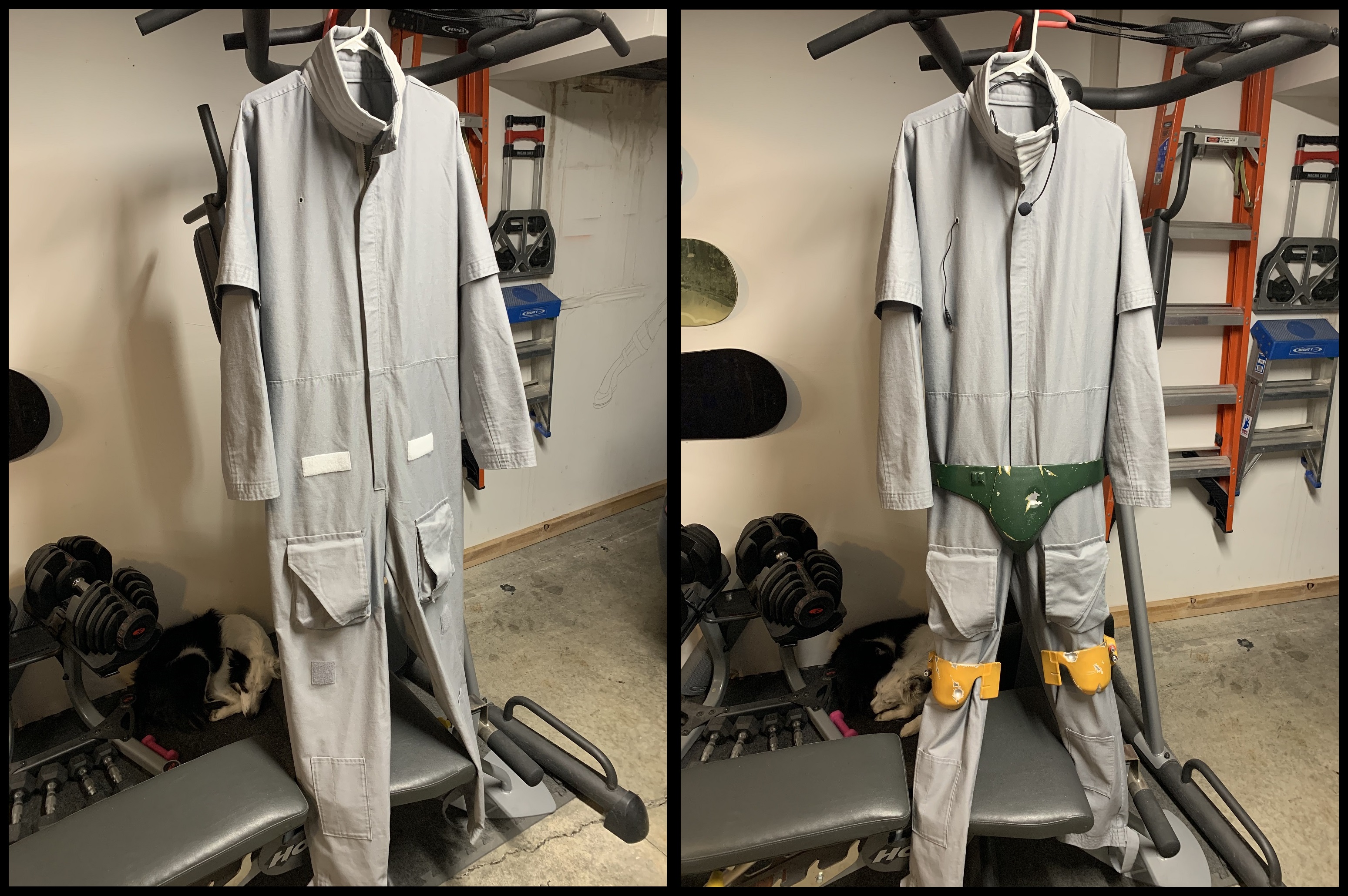

Your definitely on the right track with the velco. I've been trooping with mine a couple years now and glad to have made that decision.
And just cause I'm a stickler like that, I actually removed my Cod Armor velcro on my flight suit and changed it out to match the knee armor’s velcro, which matches the flight suit. Should be done this weekend - it’s at the alterations shop!
I clicked on your link and this pic came up - I've circled it in RED what I think your referring to, yeah?....
Based on my research not too much is known about this piece. But you can see it in a screen shot too....
The 501st makes mention of it, but is only needed if you were going for that Level II "Infamous" Certification....
I attempted to emulate it by shaping a piece from a Polycarbonate Sheet, the product is called Lexan and is advertised as Virtually Unbreakable. (Good enough for me!) To me, this is purely for looks, so it is not functional in any way and does absolutely nothing to hold the cape in place. But here is my iteration of it and the end result....
And how it looks on my ROTJ Fett....
In the coming week here, I'll be offering a small run of these "ROTJ Cape Greeblies" as an "Unfinished Kit" and as a "Finished Kit". Both kits will include the necessary hardware to mount it to the cape. So, if interested stay tuned to the Cargo Hold!

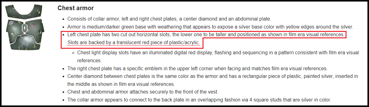

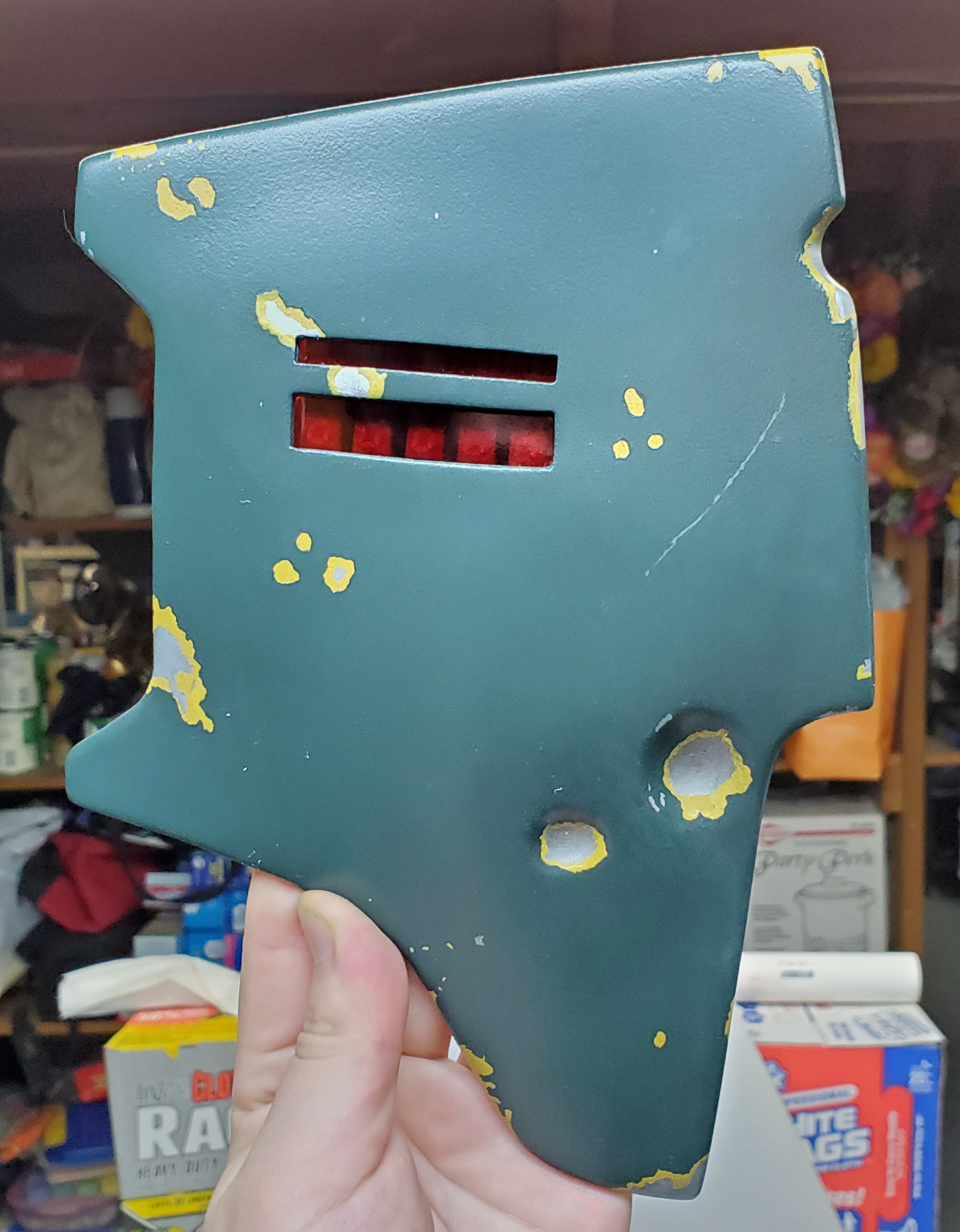

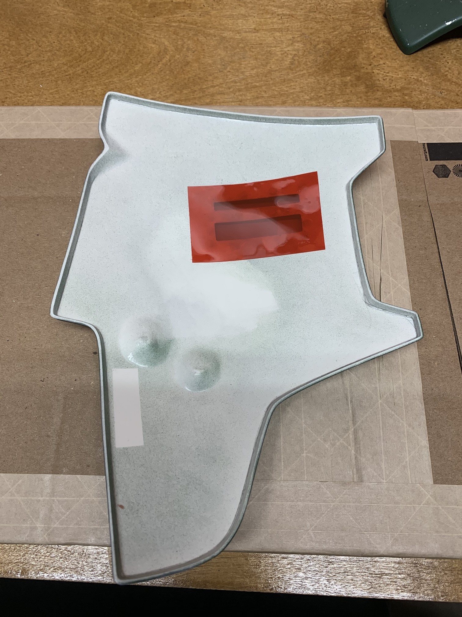

for the left chestpiece electronics, is there a piece of red plastic that sits on top of the LEDs and 7 segment displays? From one of the MotM images it looks like red. Just want to confirm the color. My costume is currently missing that entirely.
As ShortFuse & PinkFlamingos6 mentioned it is a piece of Red Film, again the 501st makes mention of this in their CRL....
With a few drops of super glue this will stick in place on the armor....
Tell you what....I have a lot of this Red Translucent material left over. Give me your measurements and I'll send you one! Take notice of mine and how much excess I have. You don't want super glue going near those openings when you press it down and potentially ruining your paint job. I'll even pick up the shipping. (Send me a PM) Many folks here have shown me some very kind generosity during my own build. So, I can definitely pay it forward here!

3) I'll start by tightening down the keycap that's holding in the cape. It's just a screw from the backside of the collar armor, so even when it's tight I think the whole assembly (screw, cape, and keycap) can pivot. If I can come up with a bracket to keep it from pivoting, I might try and implement that 3-point bracket as well. In the meantime, putting the cape on tight and getting a friend to help position it behind the shoulder bell will probably work fine.

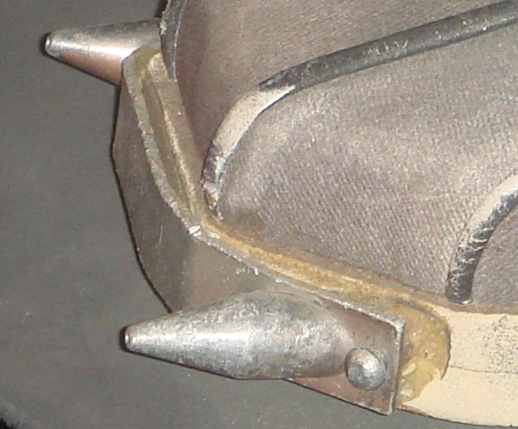

6) Bonus question: is there a specific screw size for the ROTJ toe spikes?
Using the original model from RafalFett, I measured the hole size as 3mm in diameter. Obviously I could make them a little larger if needed. If there's no specific size, I'll probably estimate based on the head size in the reference pics.

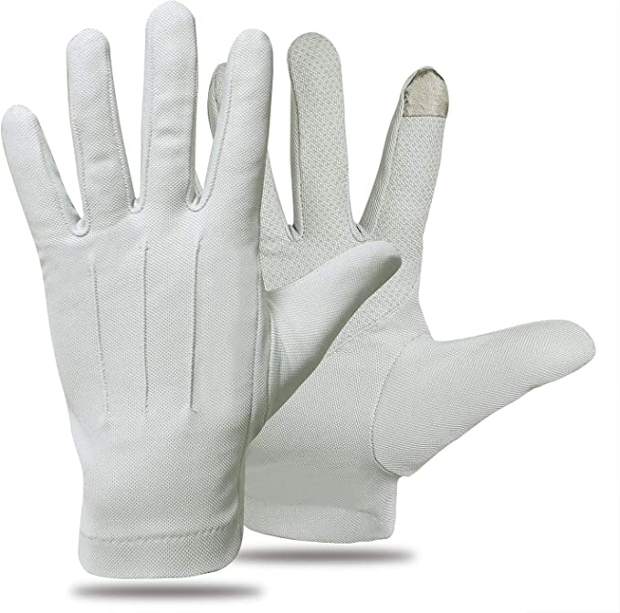

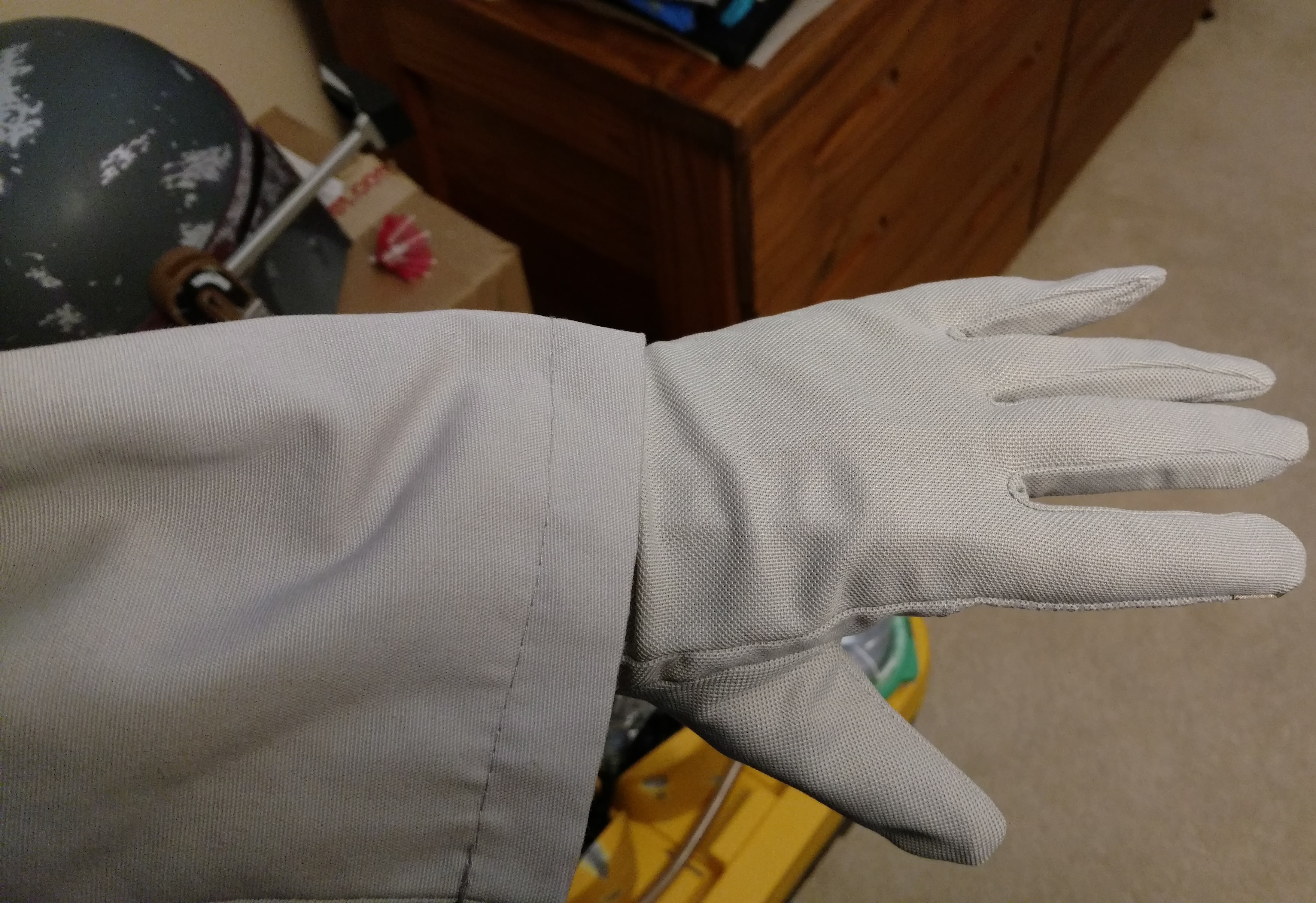

I've done a lot of searching for some touchscreen gloves that'll work as a base for my costume. The gloves that came with the AliExpress costume look OK, but are a little warm (kind of a fake leather material) that are hard to take off and don't allow you to use your phone while wearing them.
They're not accurate, but I ended up buying these for $10 on Amazon: Bienvenu Gray Driving Gloves for Men:
As you can see, the index finger has touchscreen capabilities. I ended up removing the 3 vertical "lines" by undoing the stitching from the inside. A quick steam / iron and you can't see the lines anymore (might not be necessary since they'll be covered by the white fabric, but it could give a little more hand room).
I must say, the gray is nearly a perfect match in color to that of the AliExpress costume:
Idk if that's accurate to a Fett costume, but my mentality is to match the gray of the flightsuit, gloves, and shoes before weathering.
The only things I don't like are a) that the fabric has a looser "weave" to it than the flightsuit, and b) that the other side of the glove has clear / beigeish rubber balls on it for grip. Might be handy if you are handling your phone, but I don't think it's completely necessary. Overall, I'm very happy with them though.
Next I'm going to get some white fabric (and I think some foam?) and hand stich the white parts onto the gloves. I've found some tutorials on this site before, but haven't searched for them recently. If anyone can point me towards some good tutorials I'd appreciate it!
