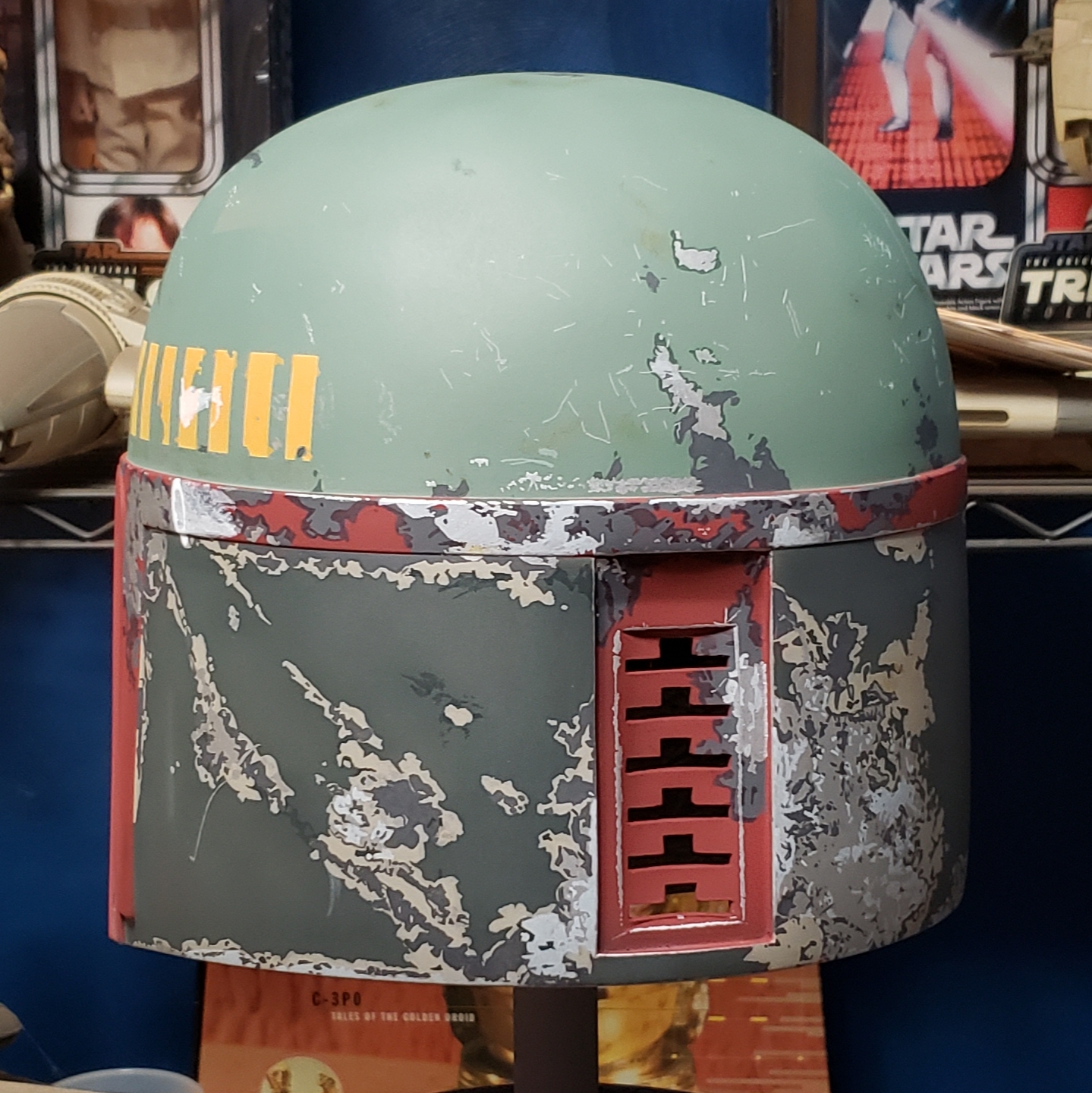

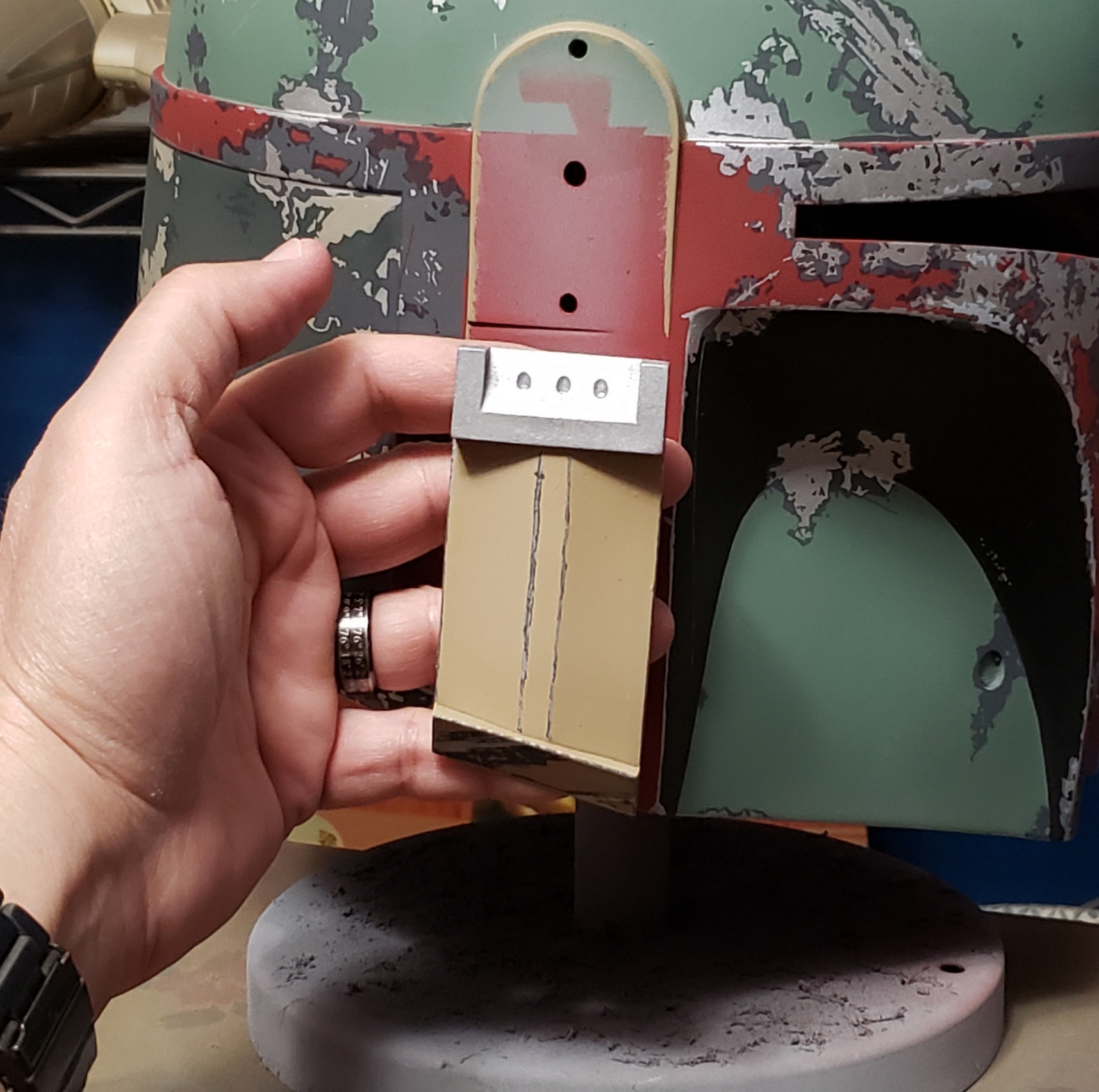

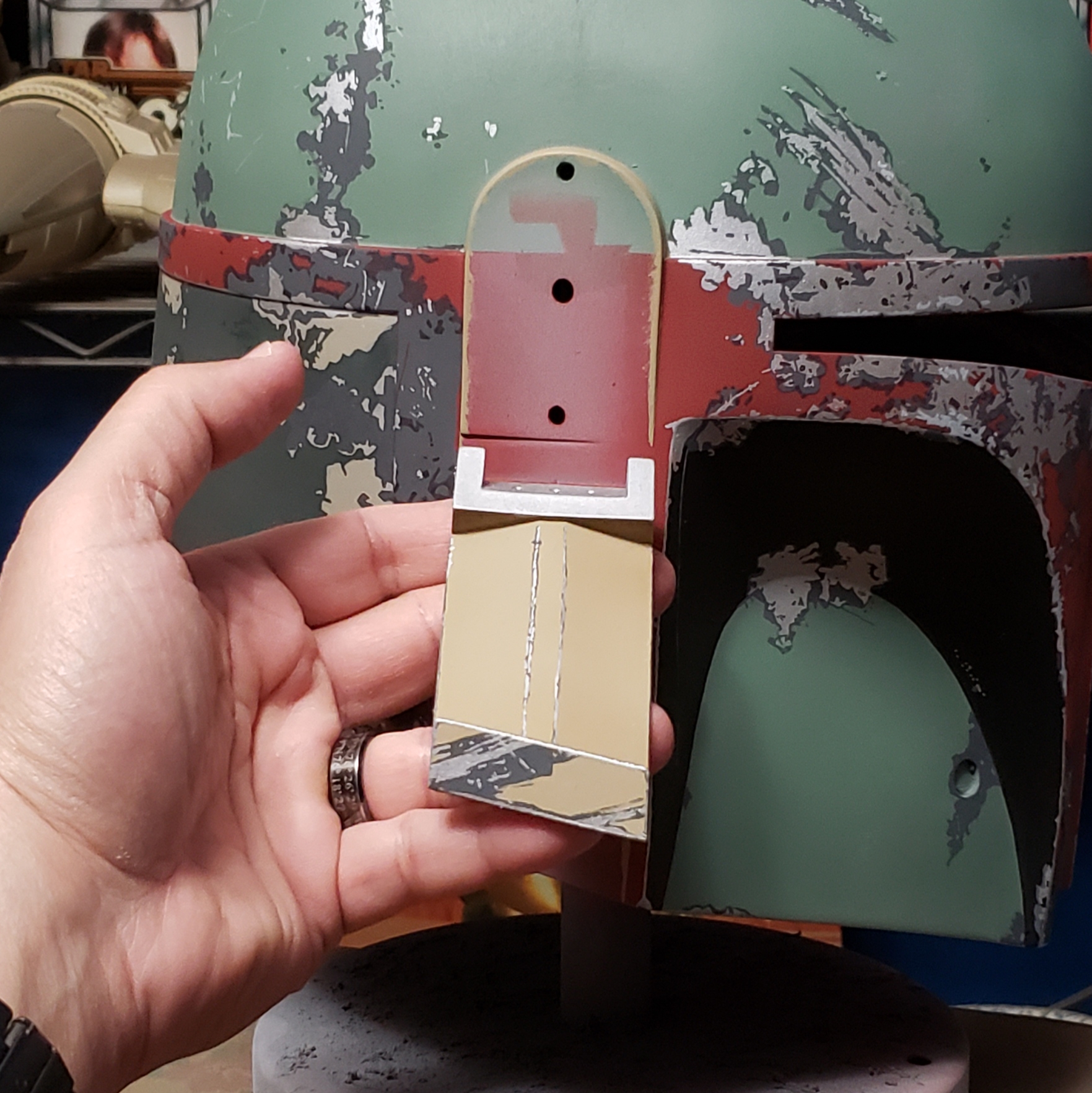

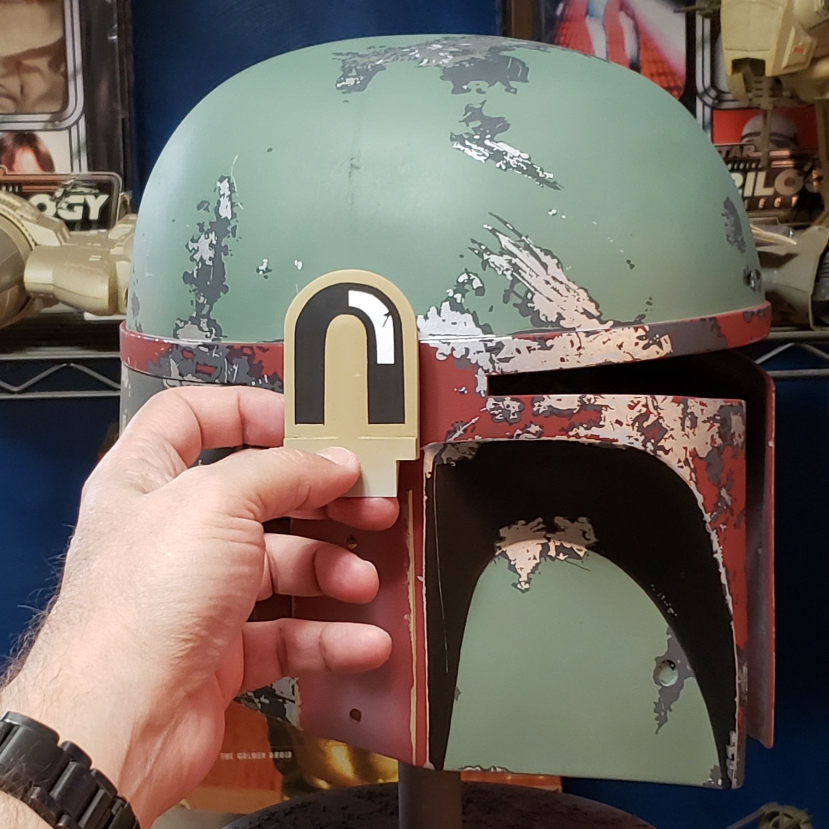

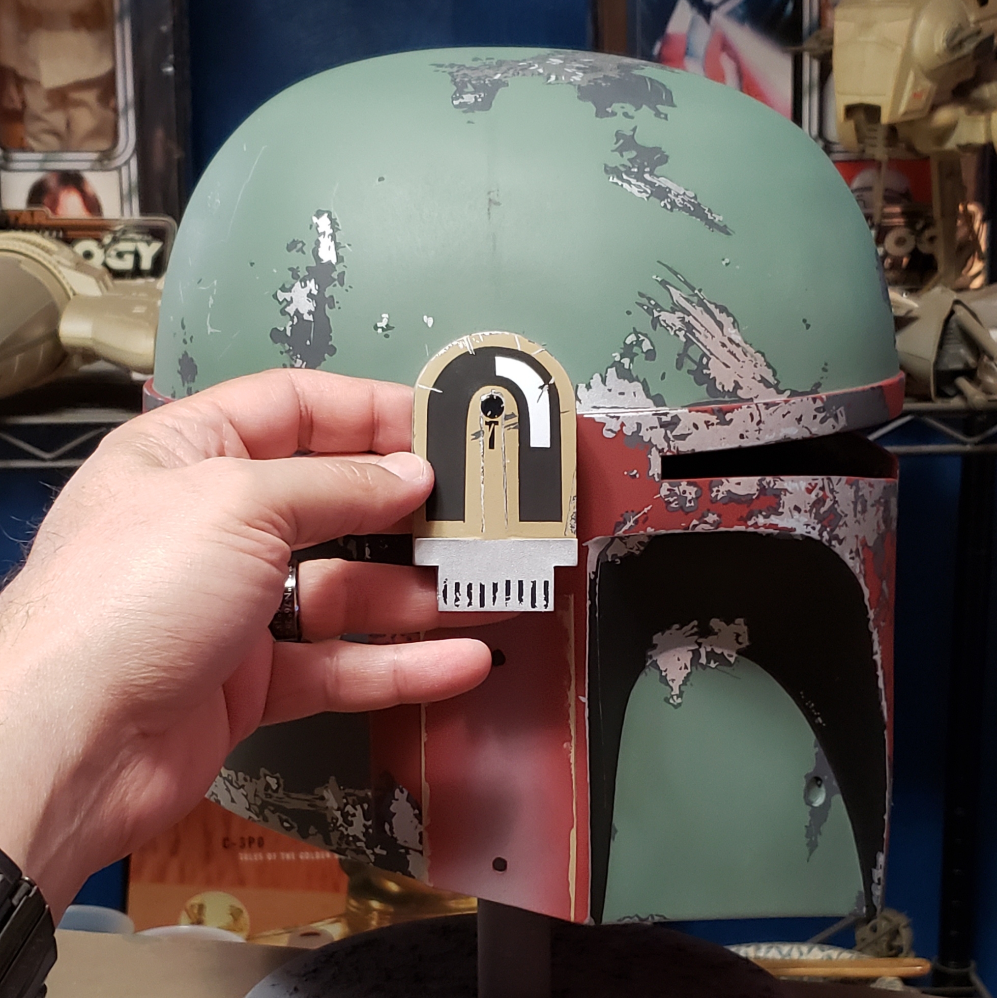

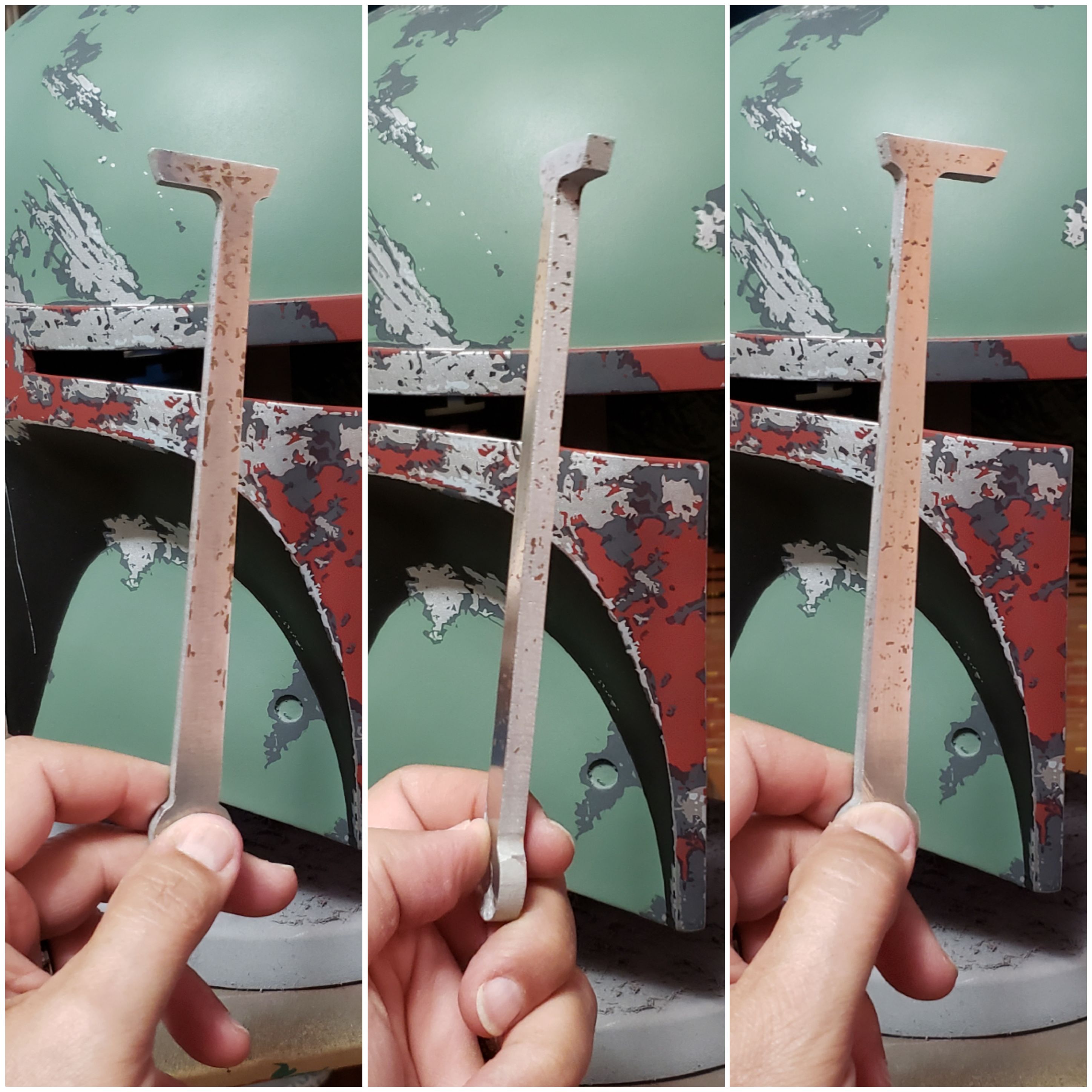

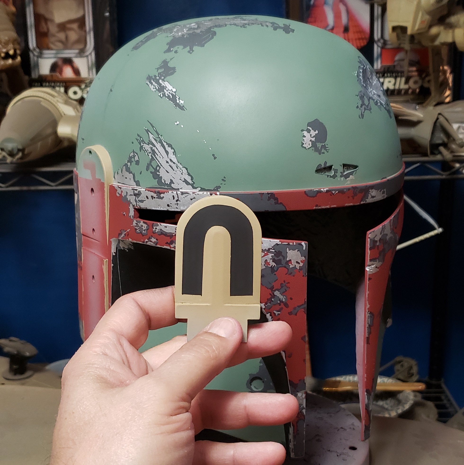

Got some color on the ears.

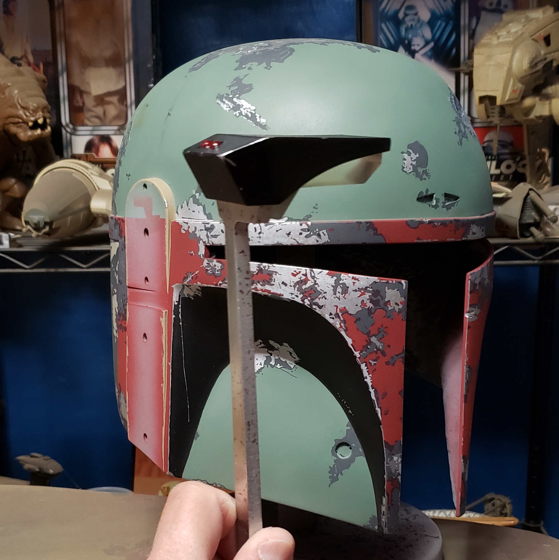

Visor time!

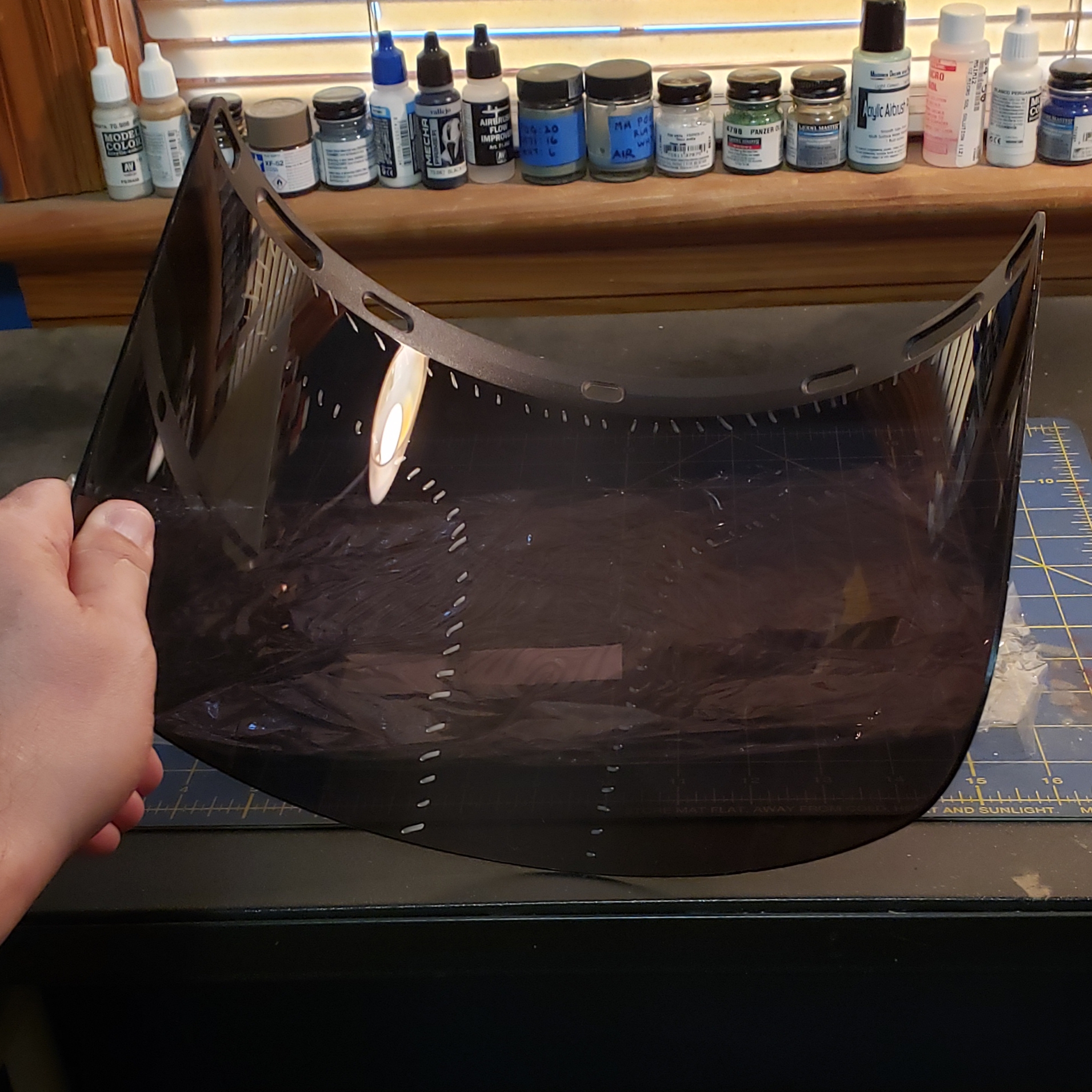

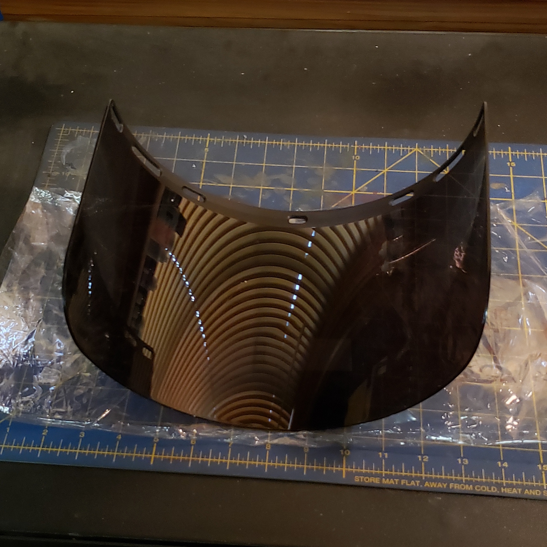

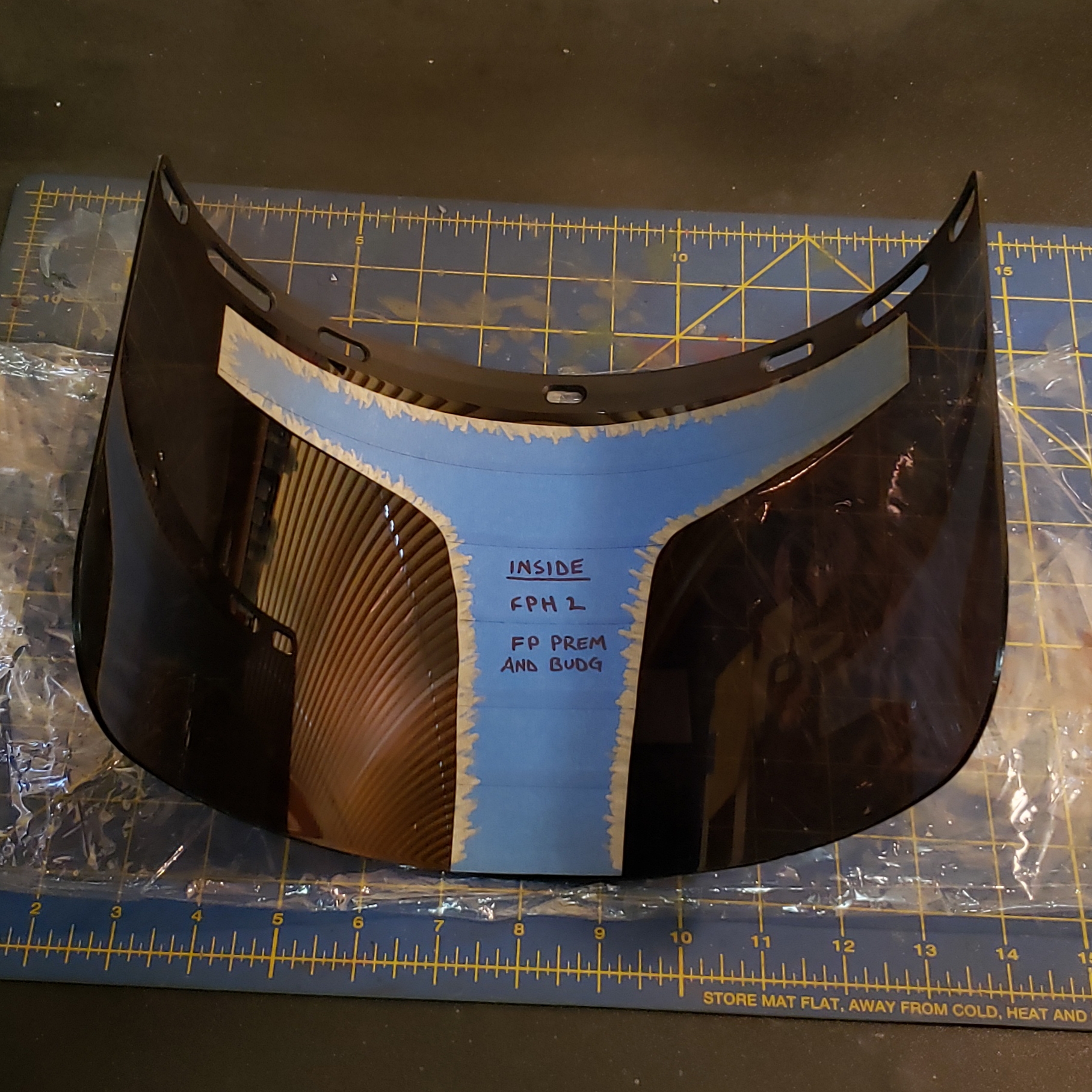

I cut visors for my commissions from polypropylene welding shields. These are a dark smoke gray color, and they're lighter and more flexible than formed acrylic. Here's a shield as I receive it.

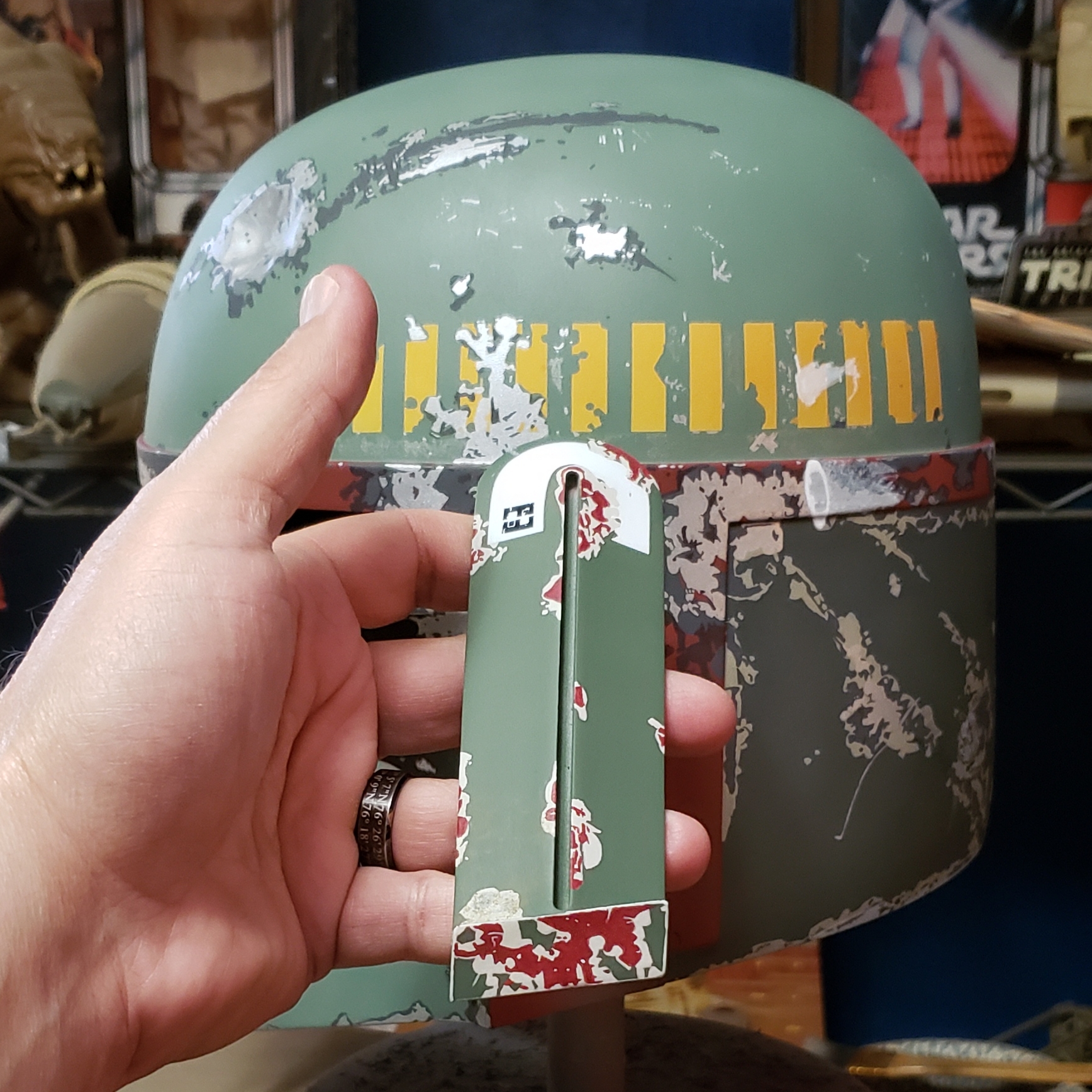

I have some visor templates that I've made to fit the various types of helmets. To cut the visor, I lay the template onto the welding shield.

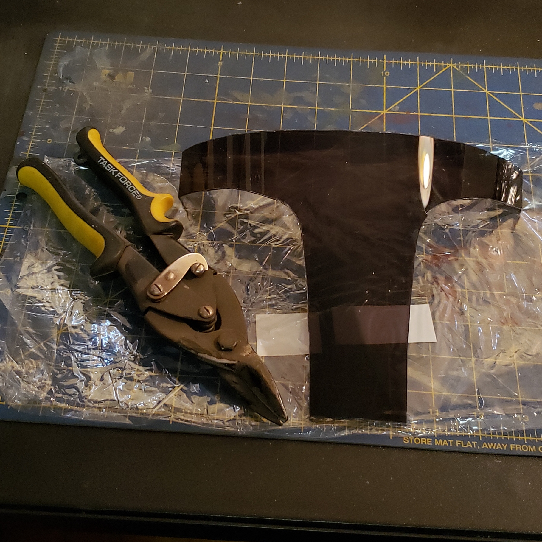

I mark around the template with a silver Sharpie.
A few minutes with some tin snips gets me a nice custom fitted visor.

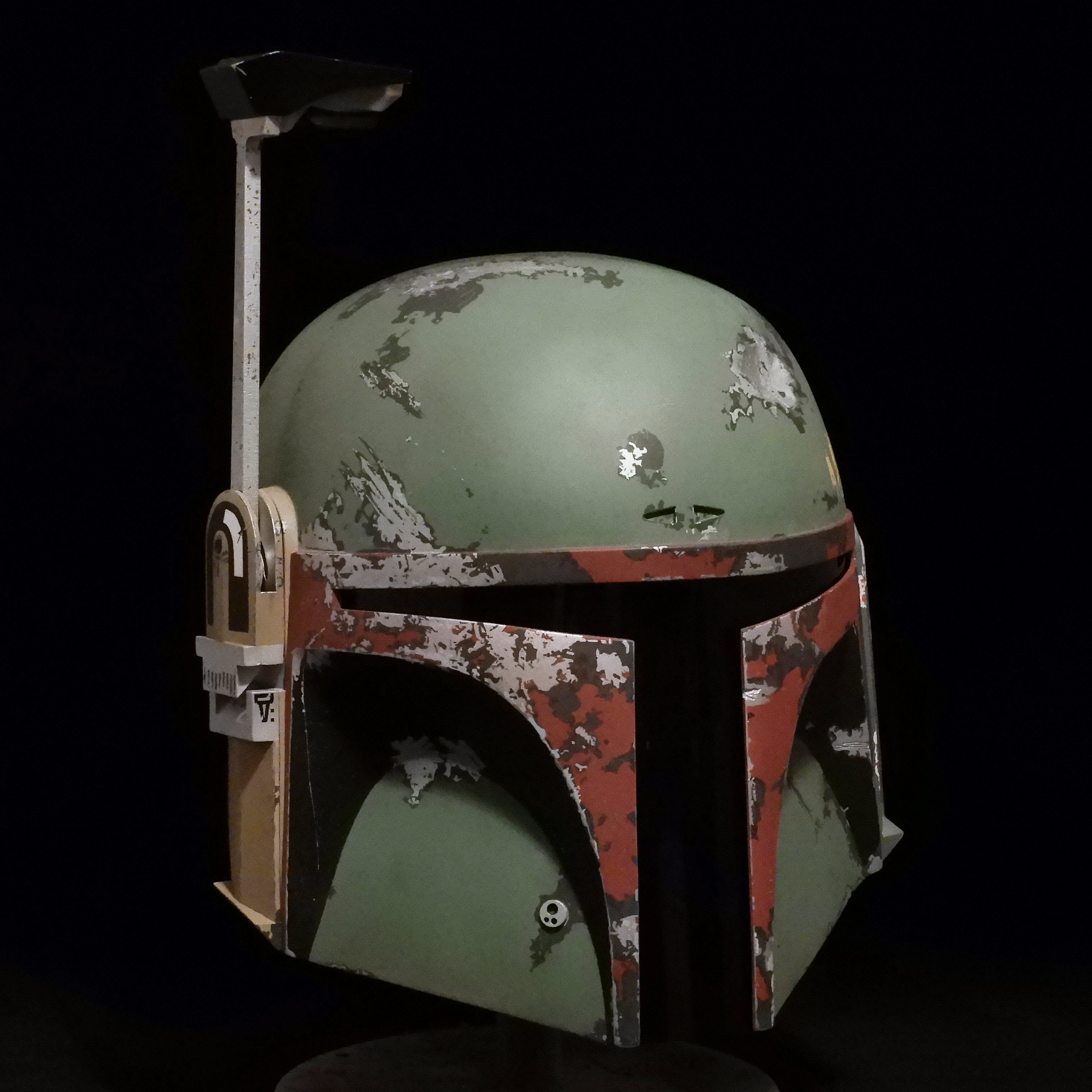

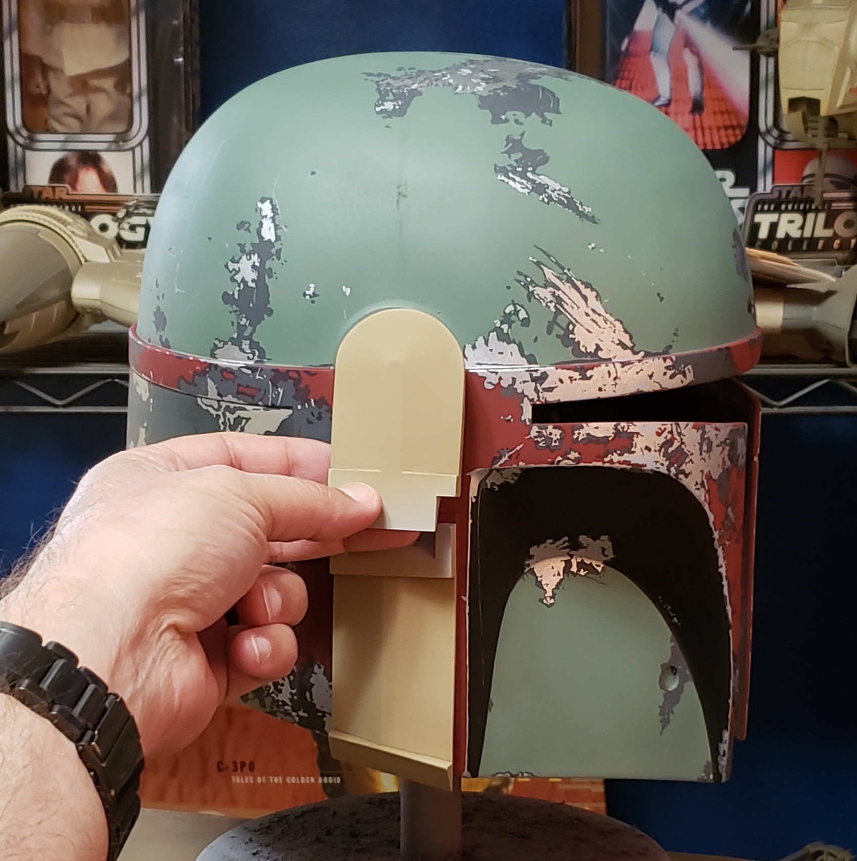

I'll mount the visor later today, and this helmet will be finished! (y) :)

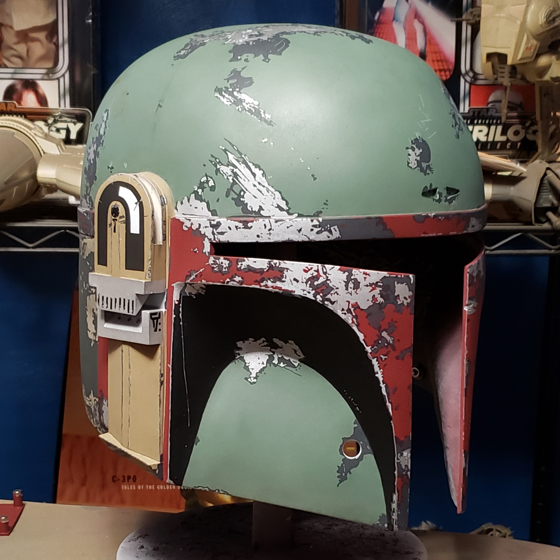

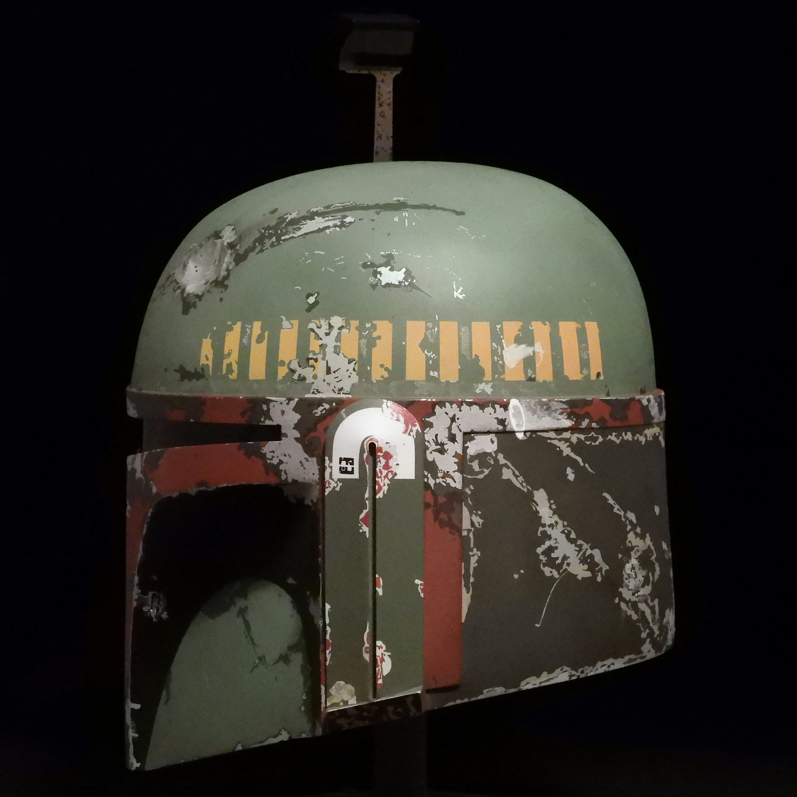

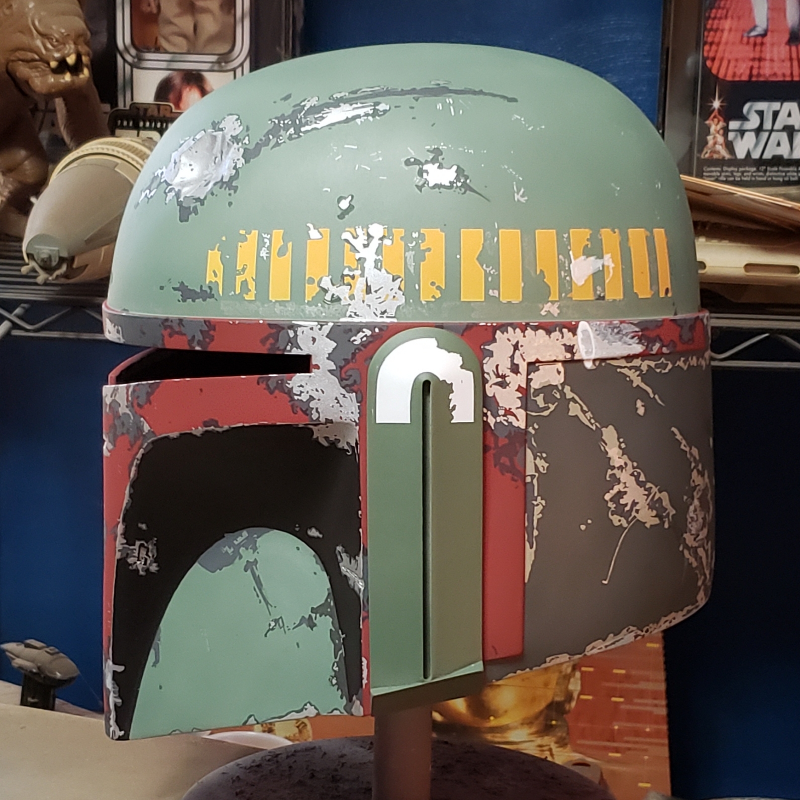

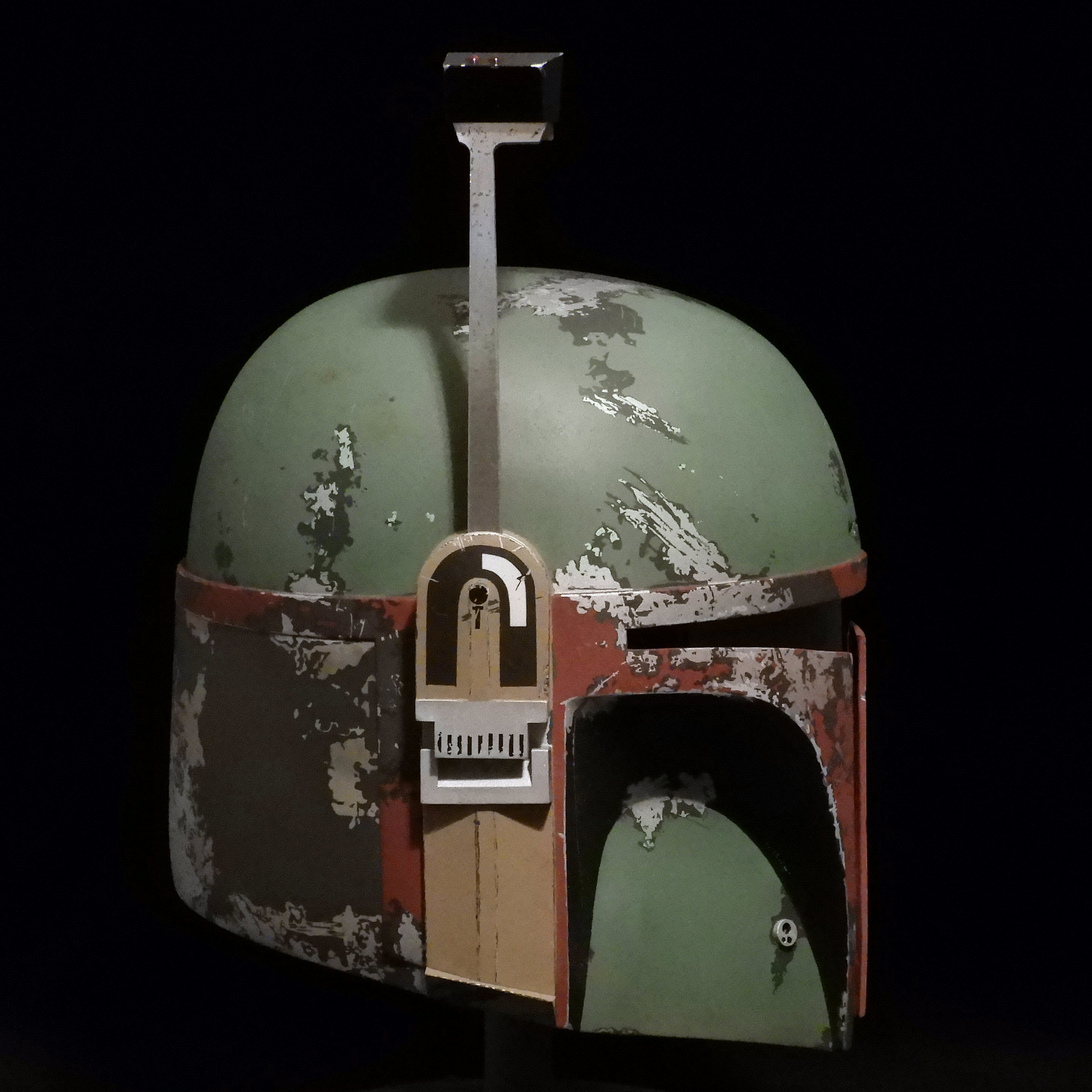

And here it is... ESB helmet number 37!

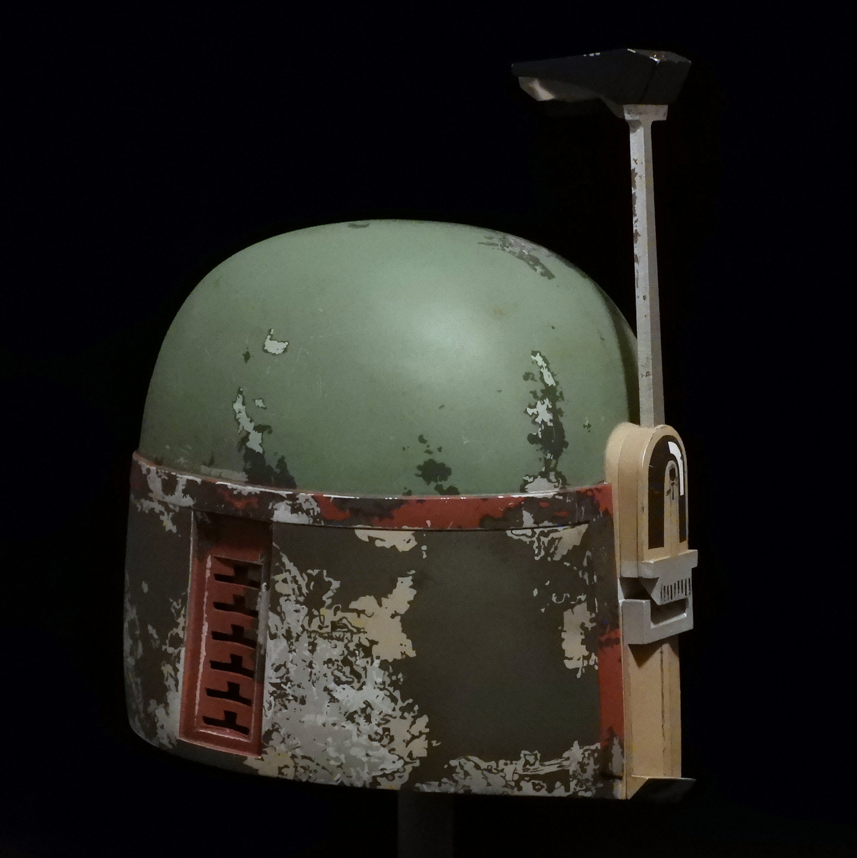

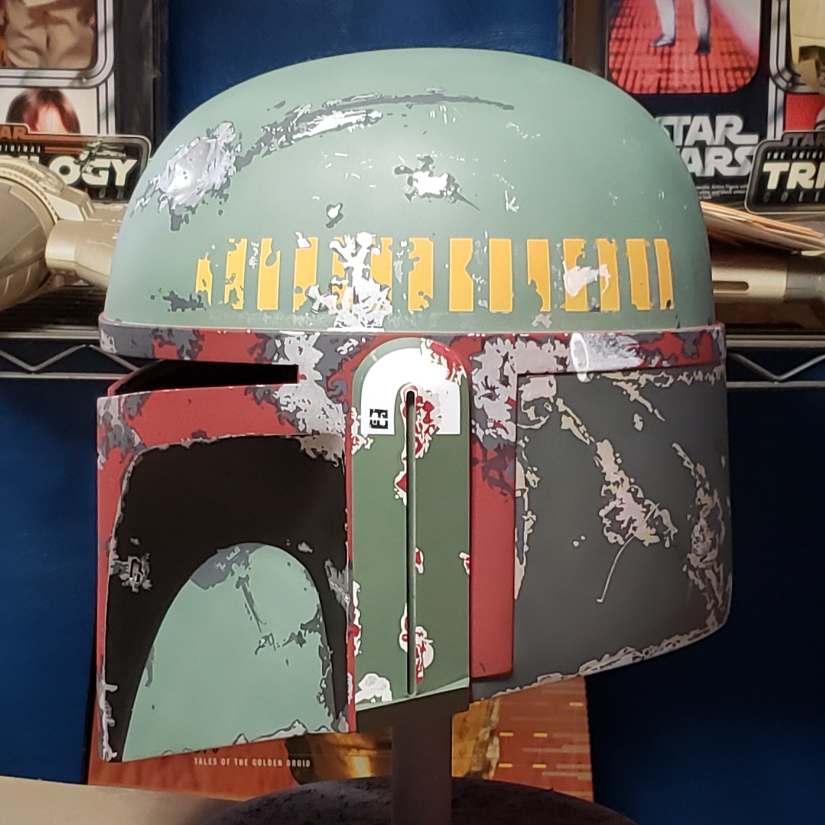

This was a lot of fun to work on. It's really satisfying to get things to this point.

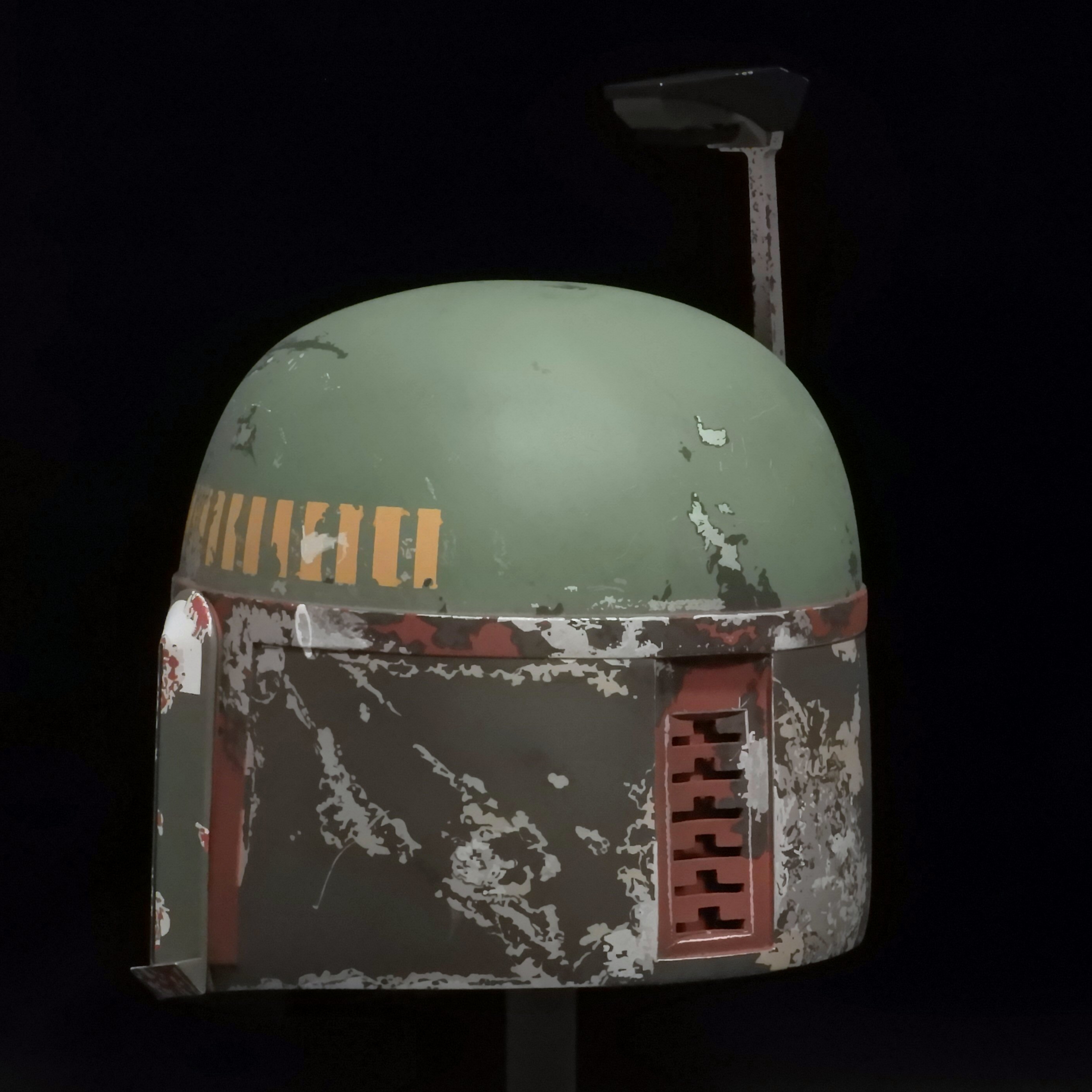

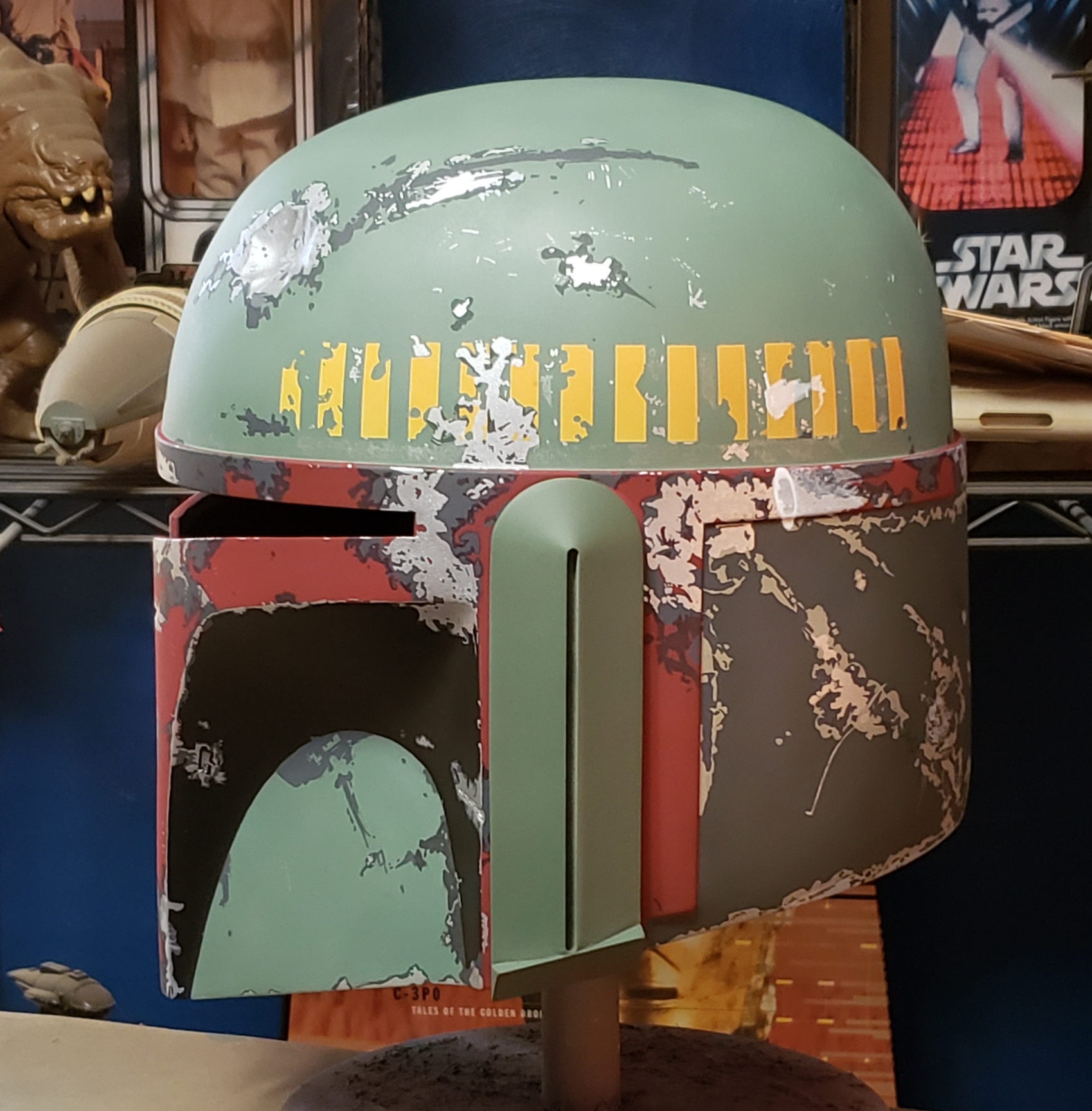

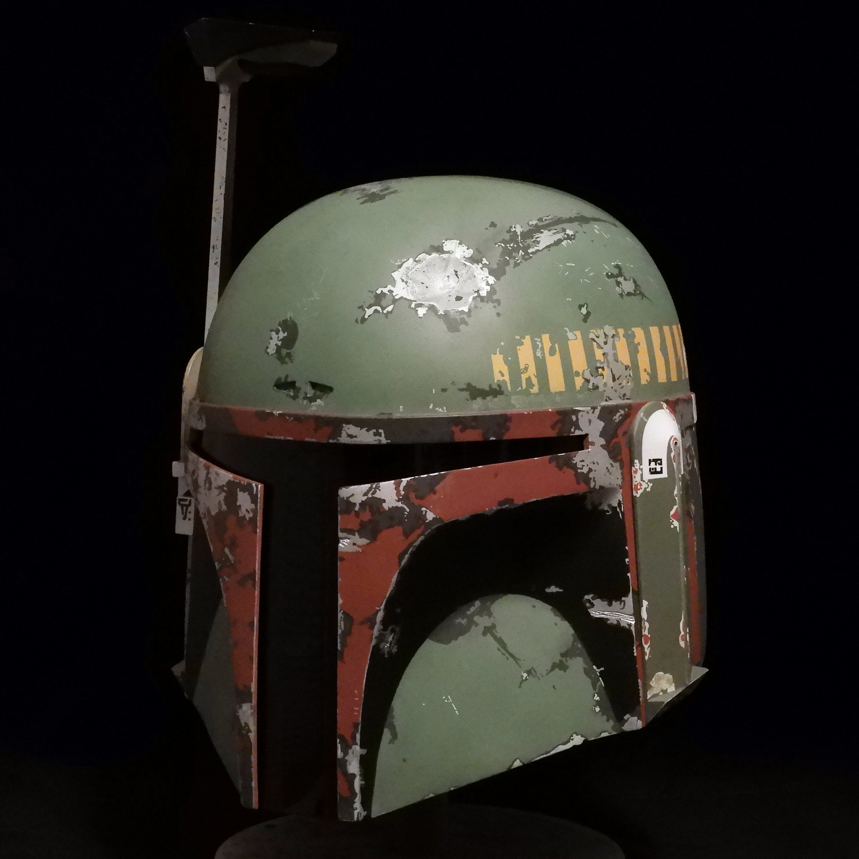

As always, I'm a little sad that I have to pack it up and send it out, but I know it's going to a good home! ;)
