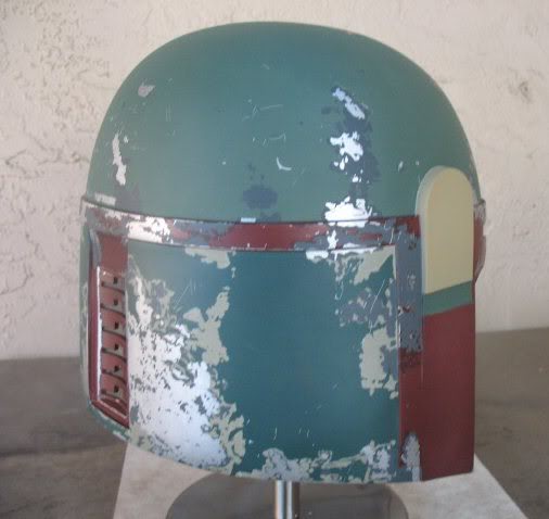

UPDATE: November 23rd
Two steps forward, and one step back. :o

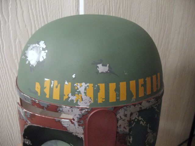

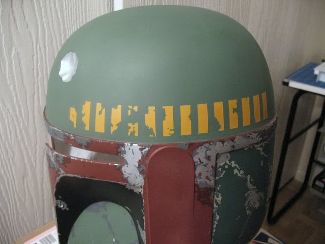

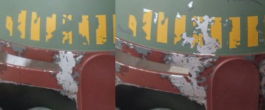

Not sure what happened exactly, but somehow I managed to make a pretty big error in transferring the damage area around the upper left corner of the T-visor. Everything in that section came out compressed somehow. :confused I noticed it when I was painting the damage in and around the killstripes.
Here's the area I'm talking about. It's the mostly silver area just below the most broken killstripe.
It took me a considerable amount of time to figure out how to mask things so I could respray my mandible color without losing all the work I've done so far. I finally managed to get everything masked off, and used some fine sandpaper to smooth out the silver/gray/maroon areas I had painted. Once it was smooth, I crossed my fingers and sprayed the area again with Boxcar Red enamel.
After removing the masking, I was left with a nice undamaged surface to repaint.
After allowing time for it to dry, I remeasured the damage and redrew my transfer, double checking as I went to make sure it would look correct this time.
Now that it's repainted, it looks MUCH better. Here's a side-by-side of the before and after.
Prior to working on the repainted area, I had finished detailing around the dent and the damage all around the killstripes.
I still have to go back and do the very fine scratches in these areas and then the big streak coming back from the dent. After that, I'll paint the big weird scrape on the top of the helmet, and then all the main painting will be pretty much done! :D I'll still have the ears to do, so that'll keep me busy for a few more days.

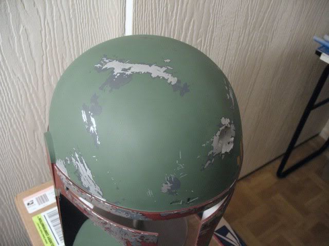

UPDATE: November 24th
Almost there. . . almost there!

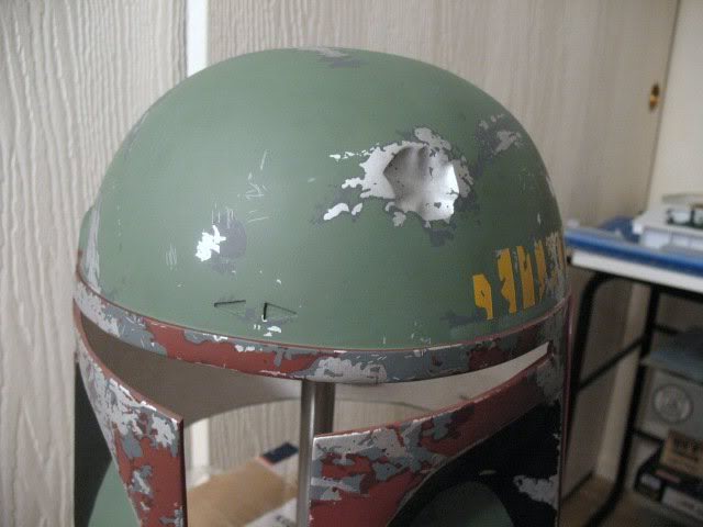

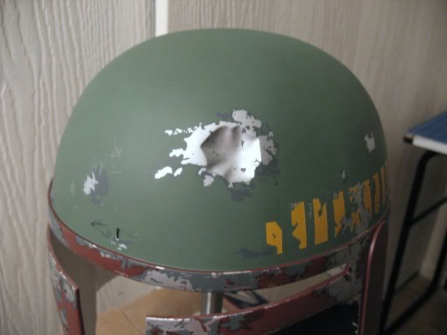

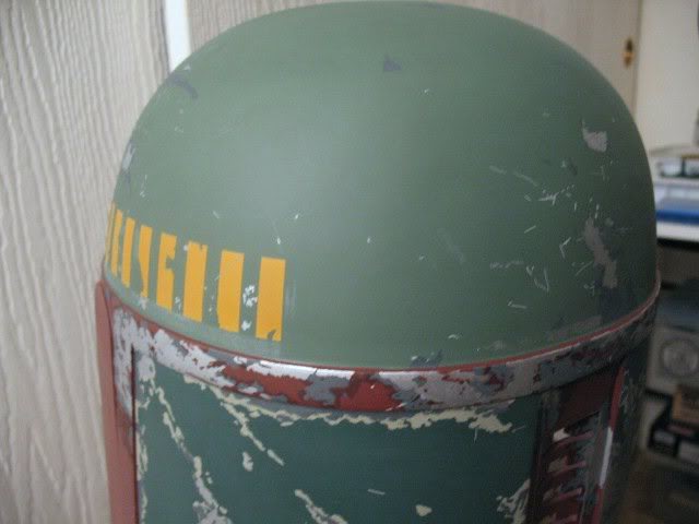

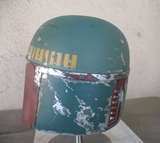

Got just about all of the major painting done on the helmet. I finished the streak coming back from the dent, and also did the small scratches all around that area. I think I sprained my eyeballs looking at ESB screen caps trying to figure out what was there in the movie compared to what happened over the years as the helmet traveled to all the exhibits. :lol:
I also did that big scrape across the crown of the dome. I had to use several reference pics and really study the shape of this area, cuz it really changes shape depending on perspective.
Added some more of the fine scratches around the front area and behind the killstripes. Not sure how visible it is, but I also added the slight fade below the killstripes. I hope this will still show up after my clearcoat! :facepalm
So now, all that remains on the helmet itself is the molded-in arch for the upper RF earcap. I usually save that till I'm ready to paint the ears. That way I only have to mess with my airbrush once.
I did some very minor sanding on the ear parts today and gave them a coat of Tamiya gray primer. So tomorrow I'll be able to do the color coats! :thumbsup: :)

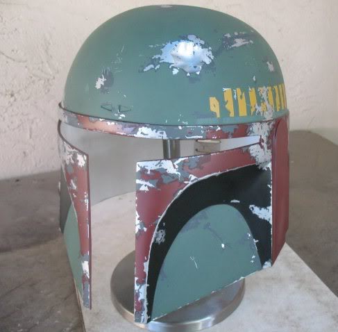

UPDATE: November 25th

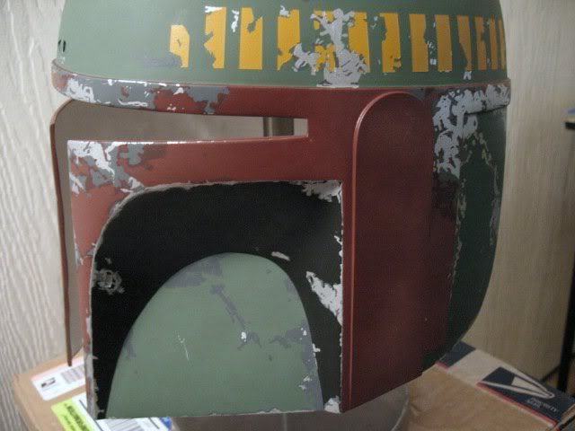

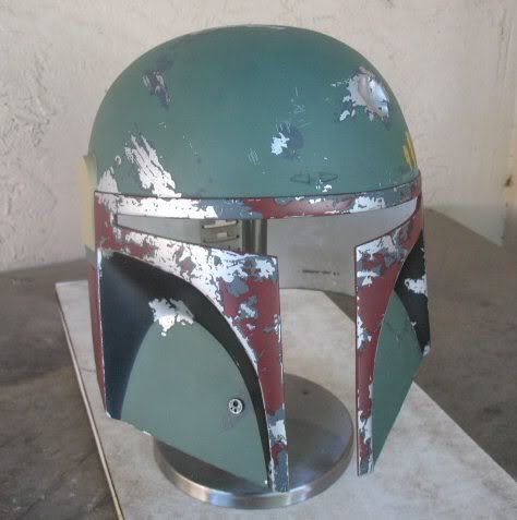

OK, all major painting on the helmet is done! :D I masked and sprayed the RF ear arch when I painted the other ear pieces today. Just a little touch up along the masked edge, and that was it.
Still have the clearcoat and pastel weathering to do, and then the very last things I'll add will be the white 'thumbprints.'
I took a whole bunch of pics out on my balcony in indirect sunlight. These are much closer to how the colors look in real life. (Huh? What's real life? :lol:)
Here's a selection of today's pics.

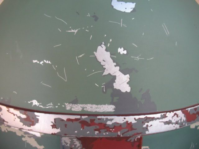

And a close up of the back just above the keyslot area. For some reason, I just love this part!

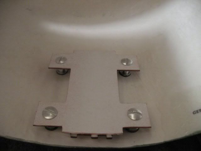

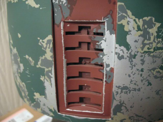

Well, it was back to work today. . . real work, not working on the helmet. So of course, I didn't have as much time to devote to Boba. But this little project was started last night, and finished today.

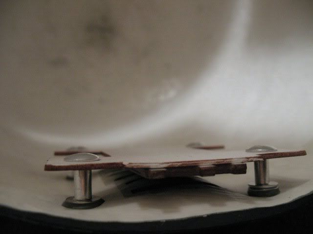

Using JLuck's excellent circuit board bracket idea, I built one for my helmet! It's not as pretty as his, but it does work very well! :thumbsup:
I cut out a piece of .060" styrene just slightly larger than the MQ-1 piece. The circuit board is just slightly narrower than the keyslot openings, and I didn't want any hollow space to show on the sides. I drilled holes just like JLuck describes in his thread, and put the hardware in place. I'm not using T-nuts like him, but some small aluminum screw posts instead. I held the whole assembly in place inside the helmet, and marked where I wanted the screw posts to go. I then put some JB Weld onto the base of each one and epoxied them into the back of the helmet.
Due to a very slight asymetrical shape on the inside of the helmet, one of the screw posts didn't quite touch. I super glued 2 very thin washers to the screw post (before JB Welding the bracket) to get that 4th "leg" to touch.
The whole assembly holds the MQ-1 part very close to the keyslots.
And here's how it looks from the outside. :D
