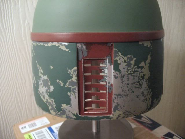

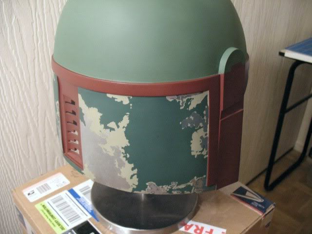

Kind of a smallish update today. I began painting the damage on the back right panel.
Same colors, same techniques. I got the upper right corner, and the lower right area complete, and have blocked in the big silver area just to the right of the keyslots.
Still have to go back and detail this area, but I won't do all that craziness till tomorrow. :)
An overall shot:
A closer look at the lower right area.
Gotta give my eyeballs a break! :lol:

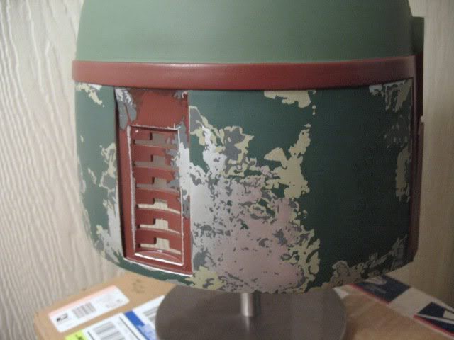

UPDATE: November 15th

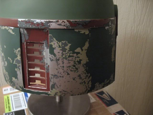

Whew!! Man, that right panel is a killer! :p These 2 pics show several hours work between last night and this afternoon. I did all the detailing in the big silver area, using SP Lark Dark Gray, and some of the blue green color.
I also got the keyslot area done, using those same 2 colors plus PRR Maroon for the darker reddish damage. These are the same 3 colors I'll be using for a while now as I begin to work my way around the 'hatband' toward the areas around the ears, and around the front to the mandibles.

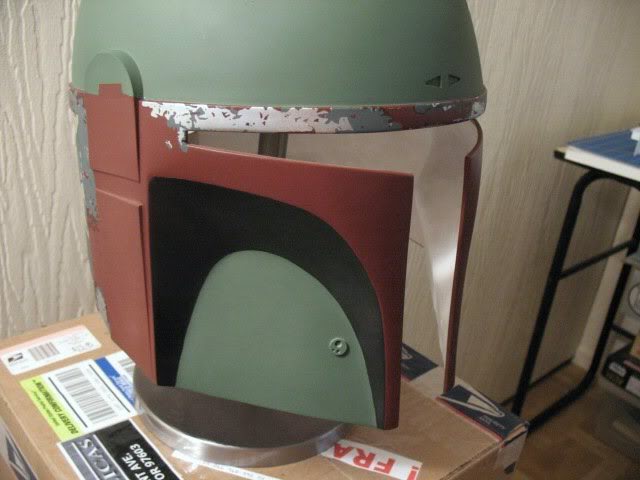

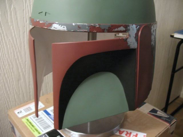

Started working on the band. I began above the keyslots, and have made it to the vertical part behind the right ear. I'm using those same 3 colors described earlier. Next will be the left portion! :)

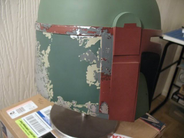

UPDATE: November 17th

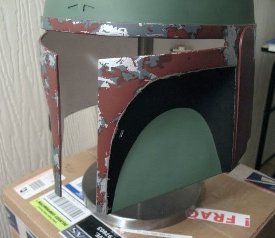

OK, been fairly productive today. I've finished the back half of the red band and have done the front section above the visor cutout.
Here's a couple of angles.
Next come the mandibles themselves! :D

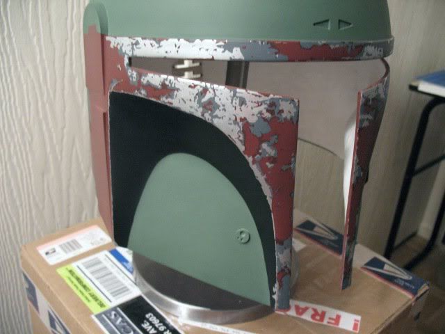

UPDATE: November 18th
And so the weekend draws to a close. My goal was to use the past 2 days to work the mandibles, since they're so detail heavy. After a lot of squinting and head tilting and numb fingers, I got 'em done. That right mandible is just cwazy! :p
The colors still look pretty stark. But after weathering and dullcoating and spattering, everything will tone down quite a bit.
I'll start working on the cheeks during the week! :thumbsup:
