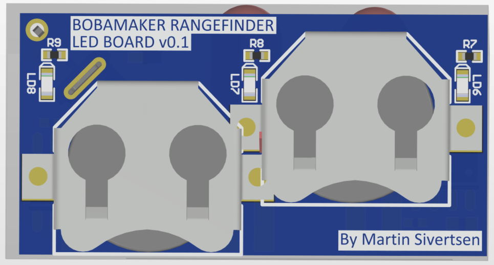

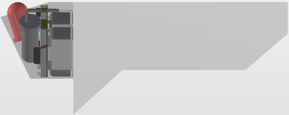

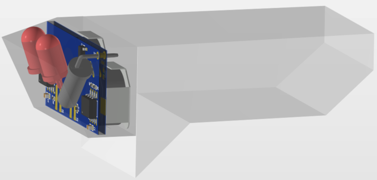

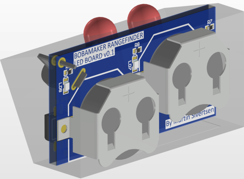

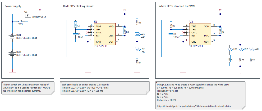

I'm in the process of painting up an ESB Boba Fett helmet made by Bobamaker (link), and these last few weeks I have been tinkering with making a self contained LED board for the Rangefinder (as the aluminium stalk is not hollow to draw wires through), so I can have some blinking LED's when the rangefinder is lowered.
The board is designed to fit inside the small cavity right where the red LED's are, beside the Perspex block.
I was planning to make this just for myself, but if it works as intended I can probably solder up a small batch of 5 to 10 boards if anyone is interested.
I haven't finished the design and ordered the boards yet, but I'll update this thread with the progress.

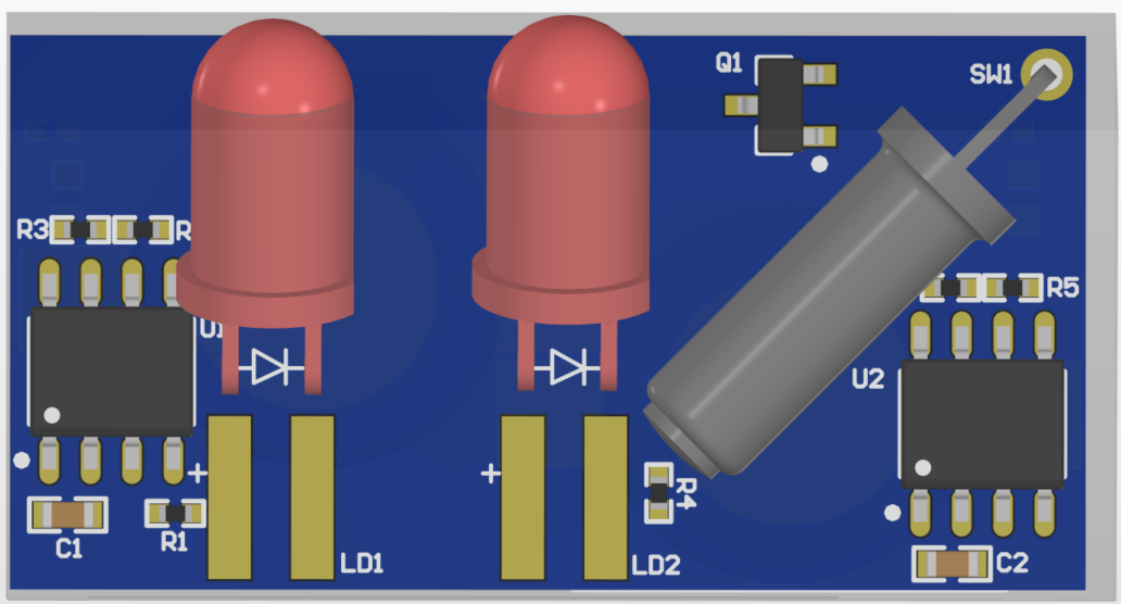

Contents:
  • 2 x LR44 battery holders
  • 2 x 5mm red LED's
  • 3 x white SMD LED's - To provide the white light into the Perspex block. You can probably drill three holes in the Perspex block and insert "grain of rice" LED's where you solder the leads onto the pads of the SMD white LED's (removing the SMD LED's first)
  • Rolling ball tilt switch
  • MOSFET that gets "turned on" by the tilt switch
  • 2 x 555 timer circuits
    • One to handle the blinking of the red LED's with where each LED is on for 0.5 seconds
    • One to create a PWM signal that dims the white LED's currently with a 50% duty cycle
Here are some images:

Schematic:

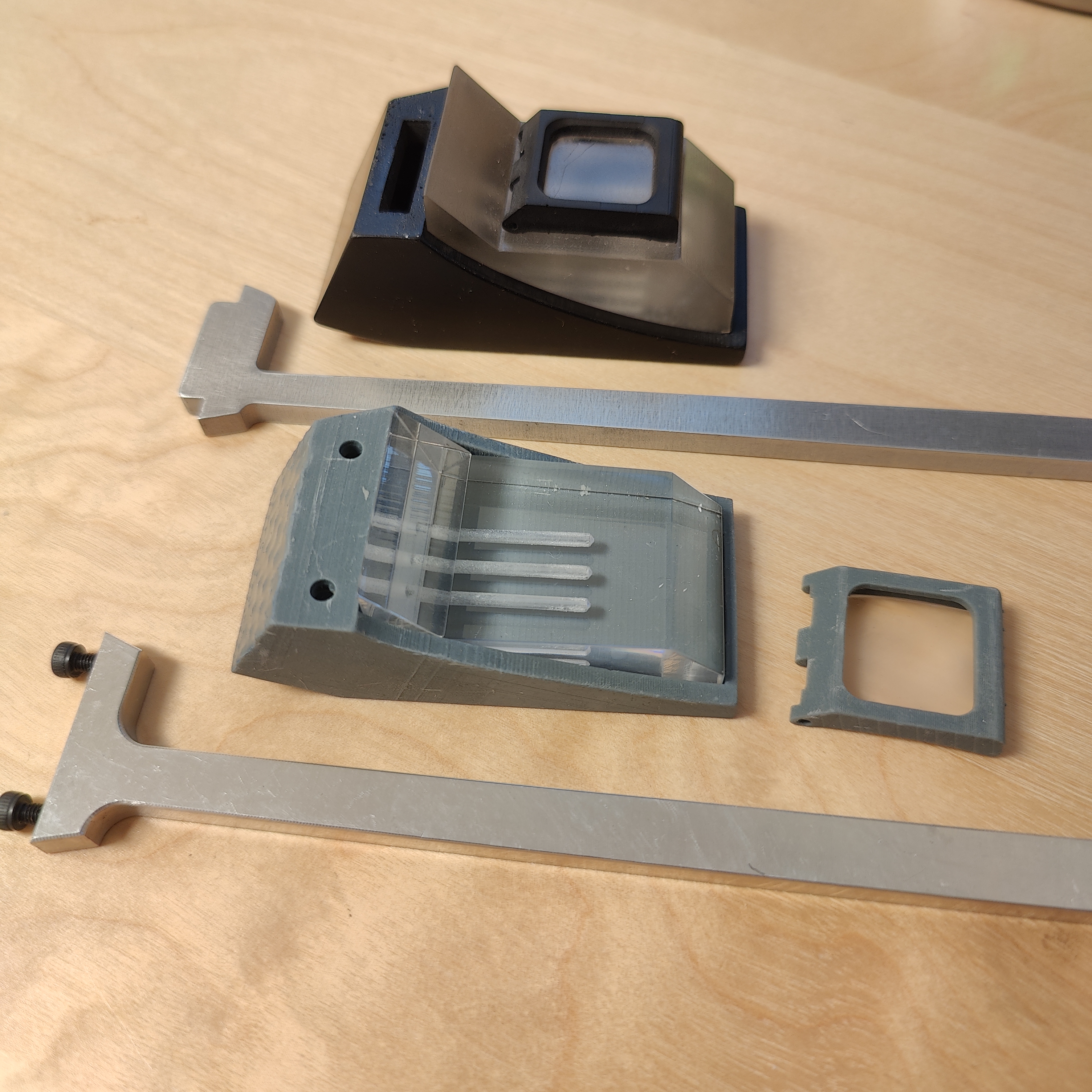

FWIW, if you want to get a hollow stalk, they are available at the link below. I have the deluxe kit for the entire ear set if you want any pictures, close ups, or measurements (as much as I can).
That is a great design. Love seeing electronics at work!

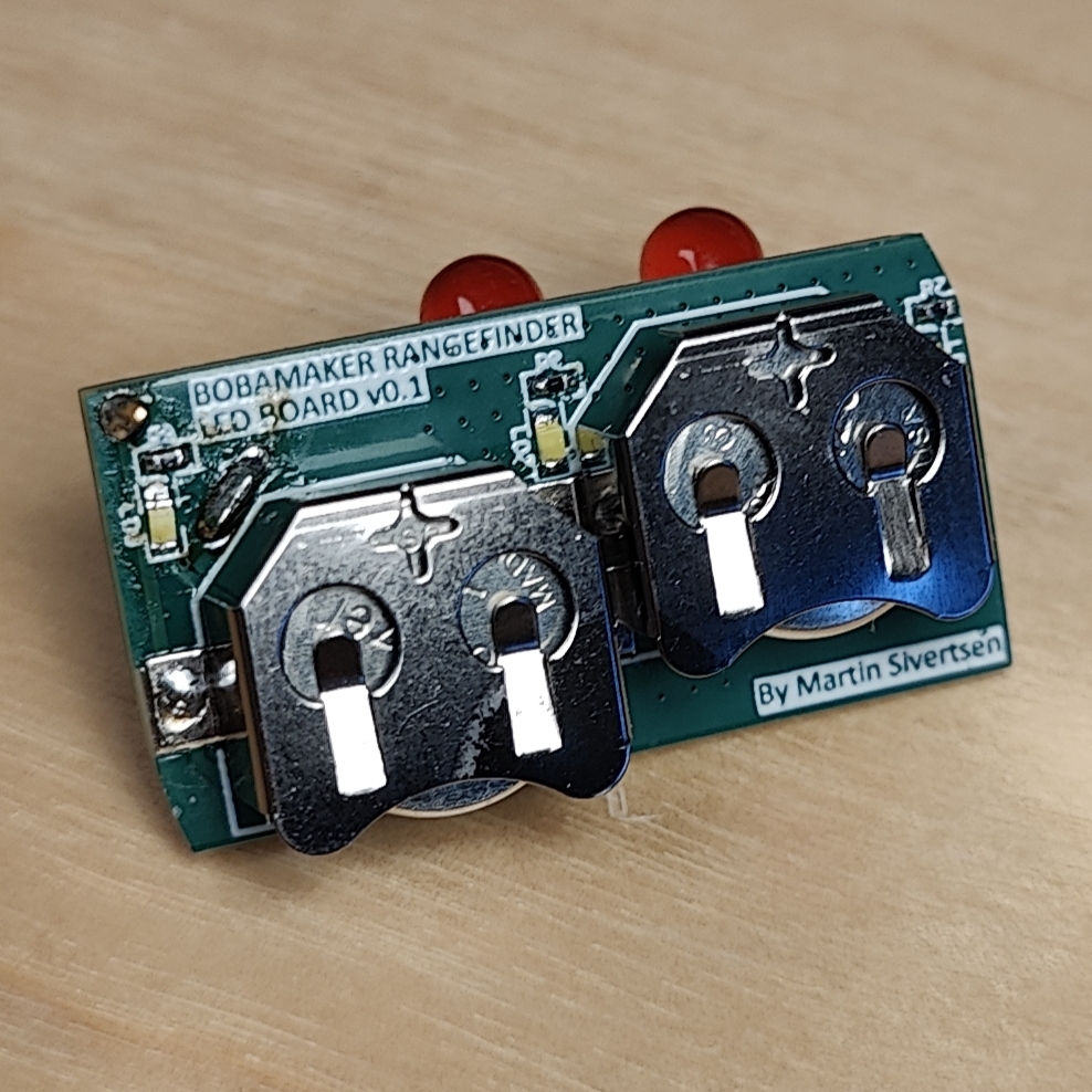

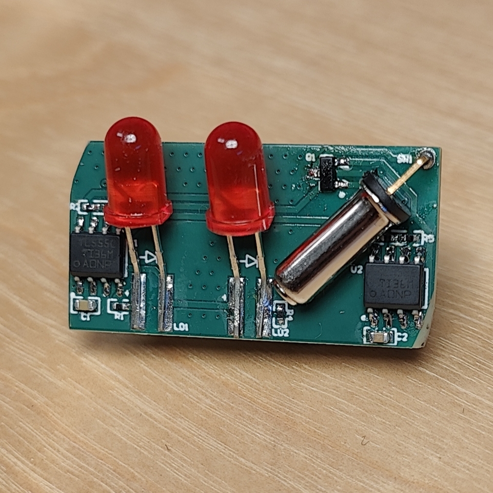

I got the PCB's from the manufacturer and soldered up the first prototype.
There are two bugs I need to fix, but that should be easily done by modifying the existing board by soldering on some resistors. One from the N-MOS gate to ground to force it to turn off when the tilt switch is in the open position.

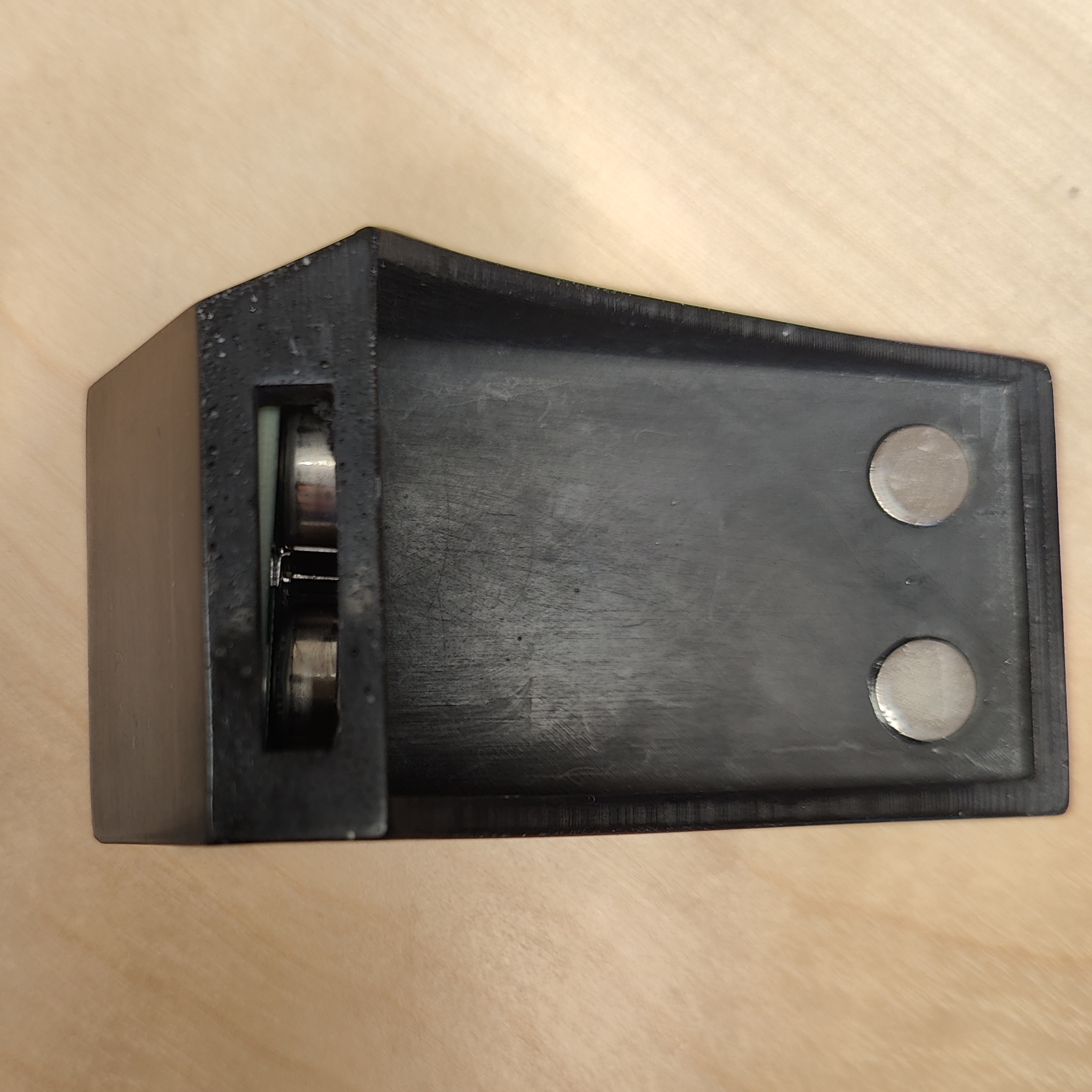

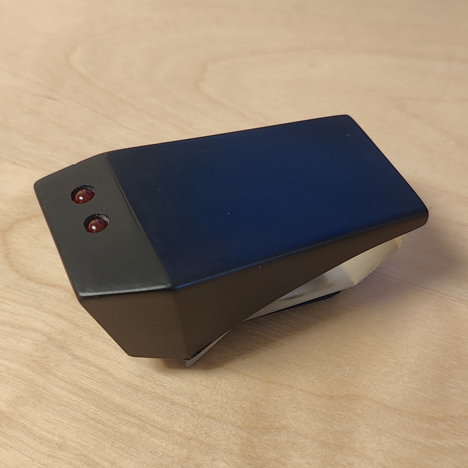

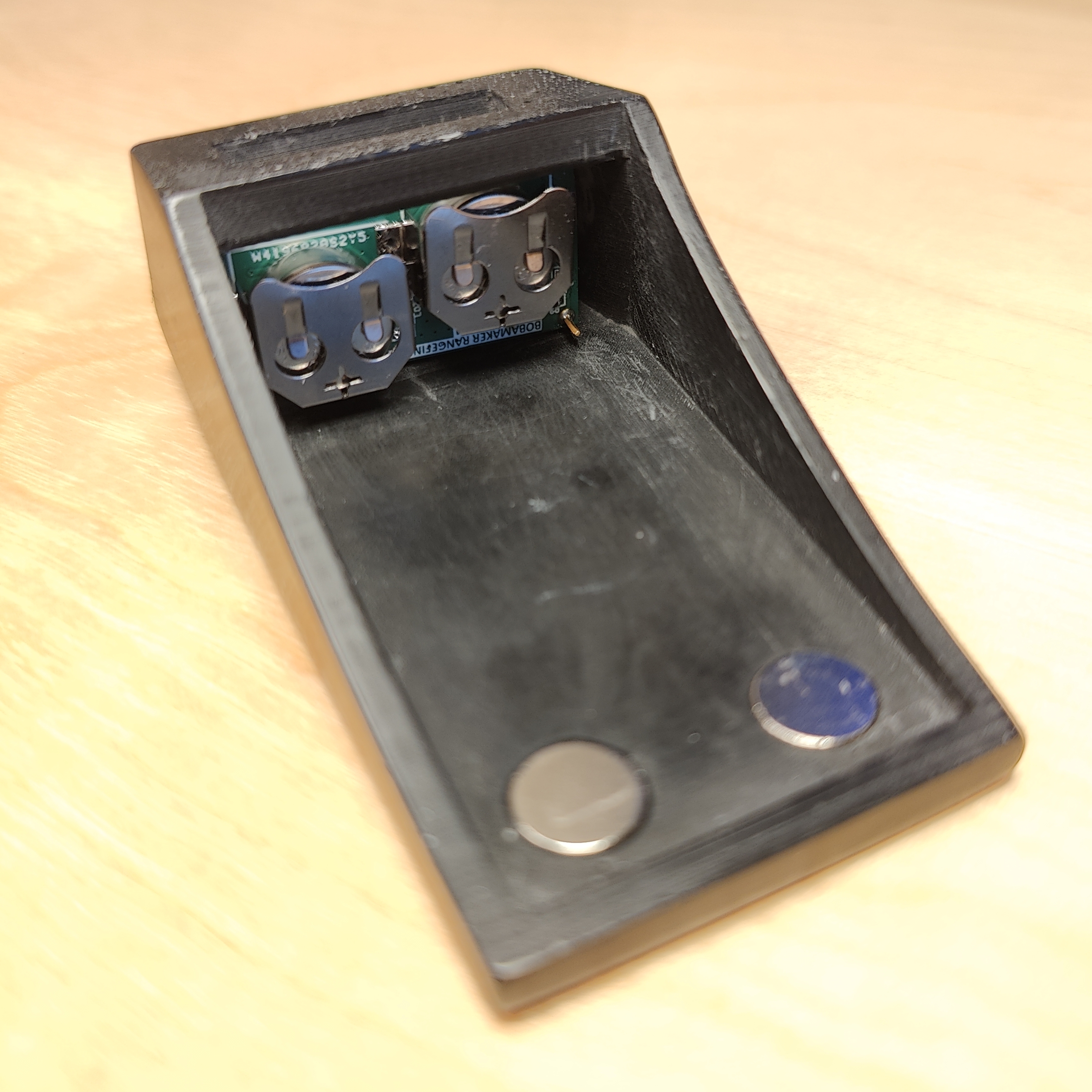

Here it is inside the range finder. It's a snug fit, and I had to remove a tiny bit of material using a rotary tool with a grinder bit to accommodate the pin from the rolling ball tilt switch, but it didn't take much.
When I have fixed the bugs I'll post a small video as well.
I have parts for five boards, so if anyone is interested in one of the remaining four just shoot me a message.
